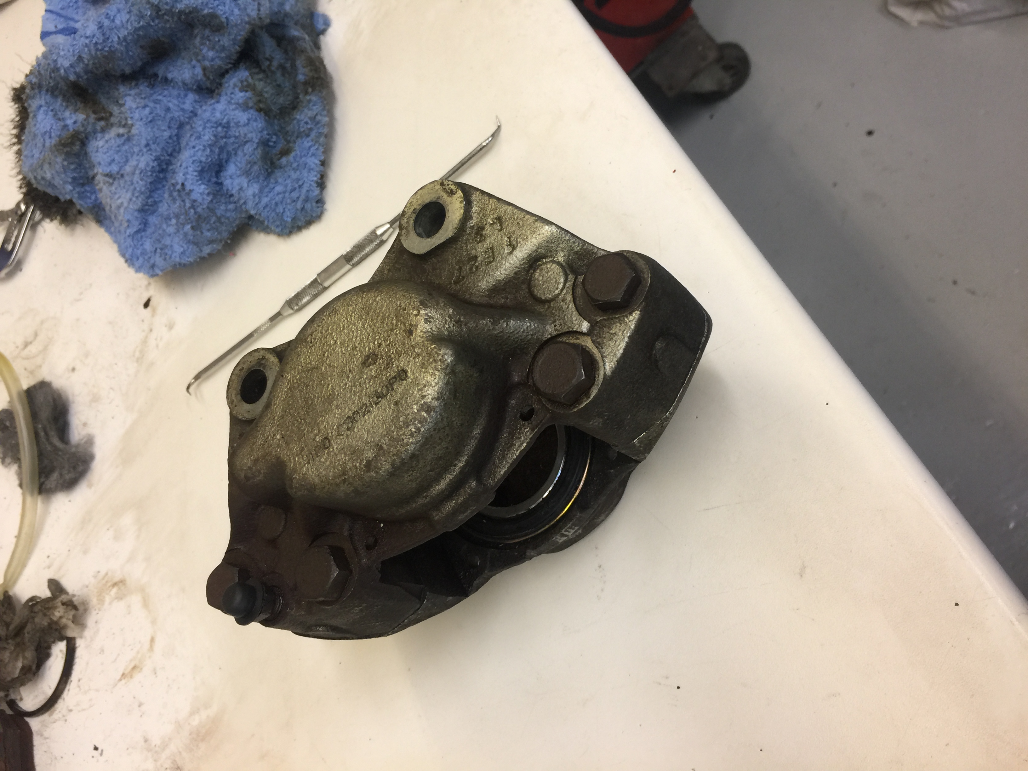

Started with the front brakes. How do I extract the pistons?

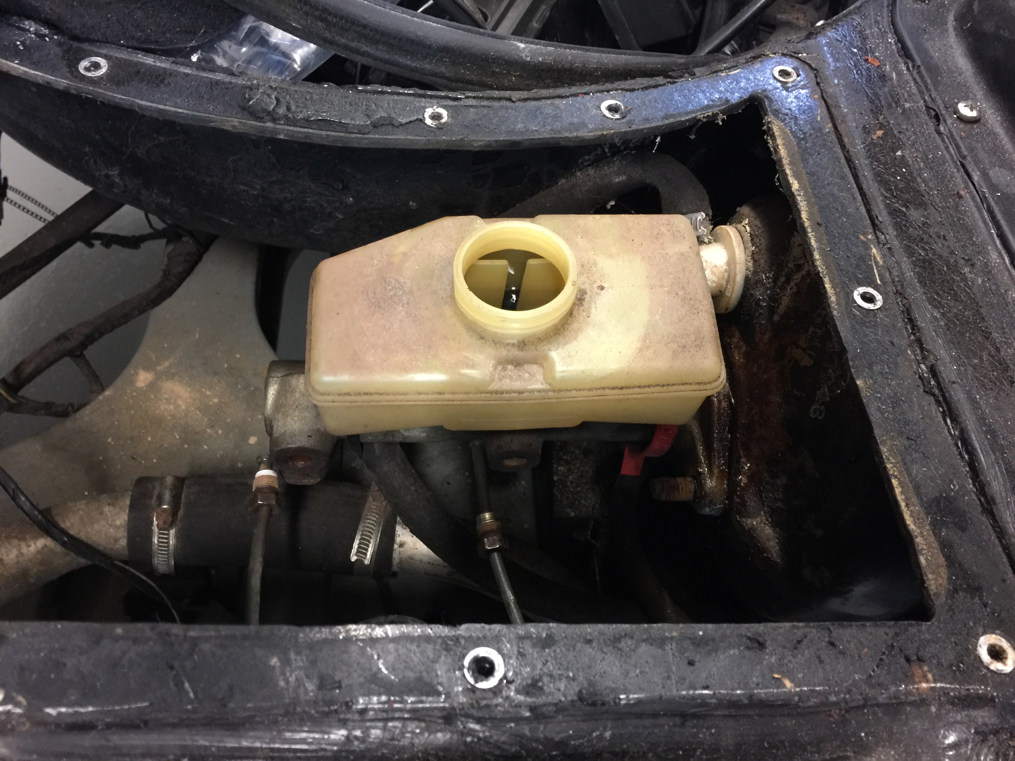

Is the MC supposed to come off after I undid the two nuts?

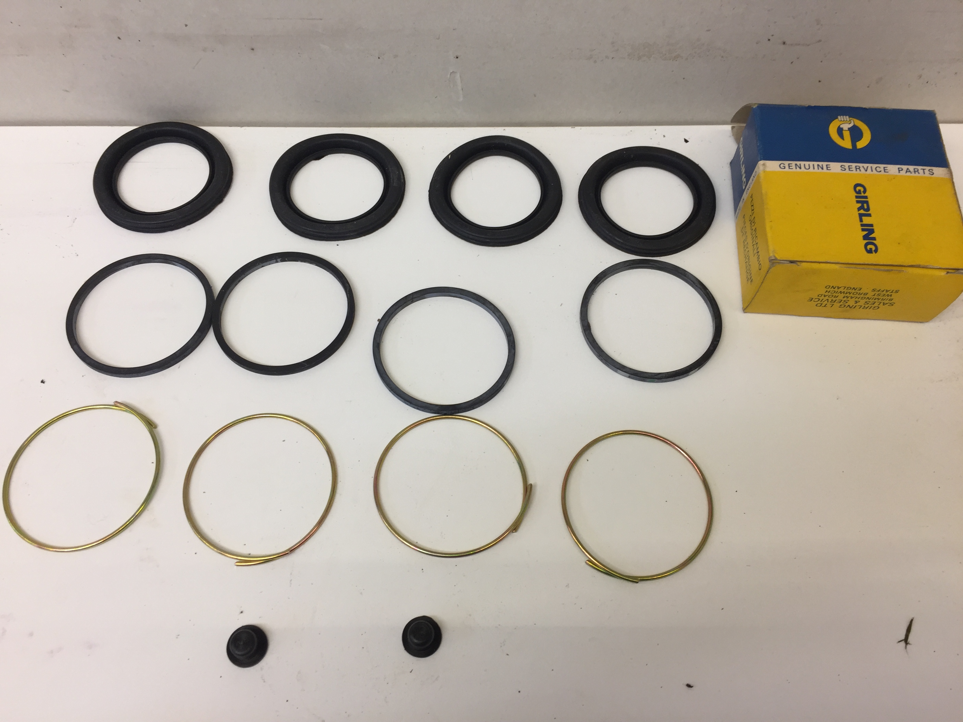

What are the thin gaskets in the rebuild kit for?
MC reluctant to separate from booster
Caliper separated

Is the MC disconnected from the pedal? If it is smash it with a hammer.
Put the calipers back together then pump grease into them. That'll get the pistons out most of the way then use pliers and a thick rag to pull them out all the way.

The thin gaskets (you mean O rings?) Seal the pistons. The larger ones are dust shields. Once you have the pistons out you'll see what I mean. Good luck pal.

The brake MC looks rusty and is stuck, so I caved in and ordered a new one, a Saab unit. Readily available here in Scandinavia. Tie rod ends have also been ordered.

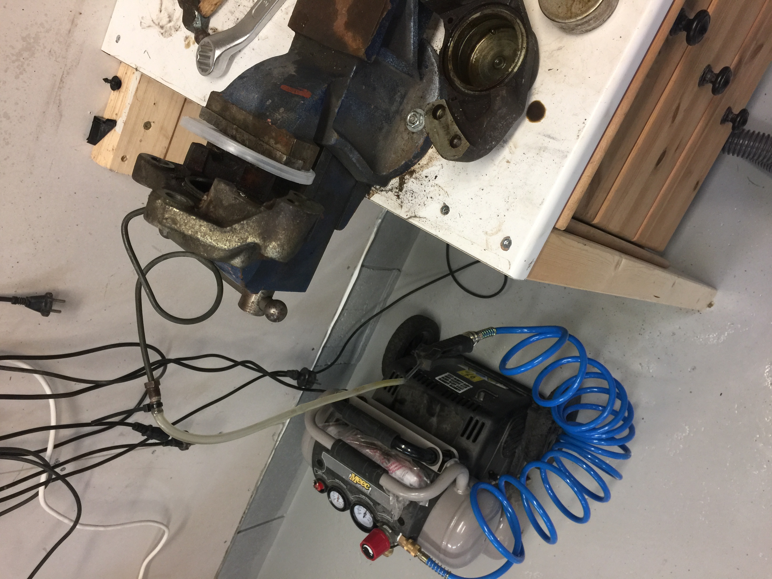

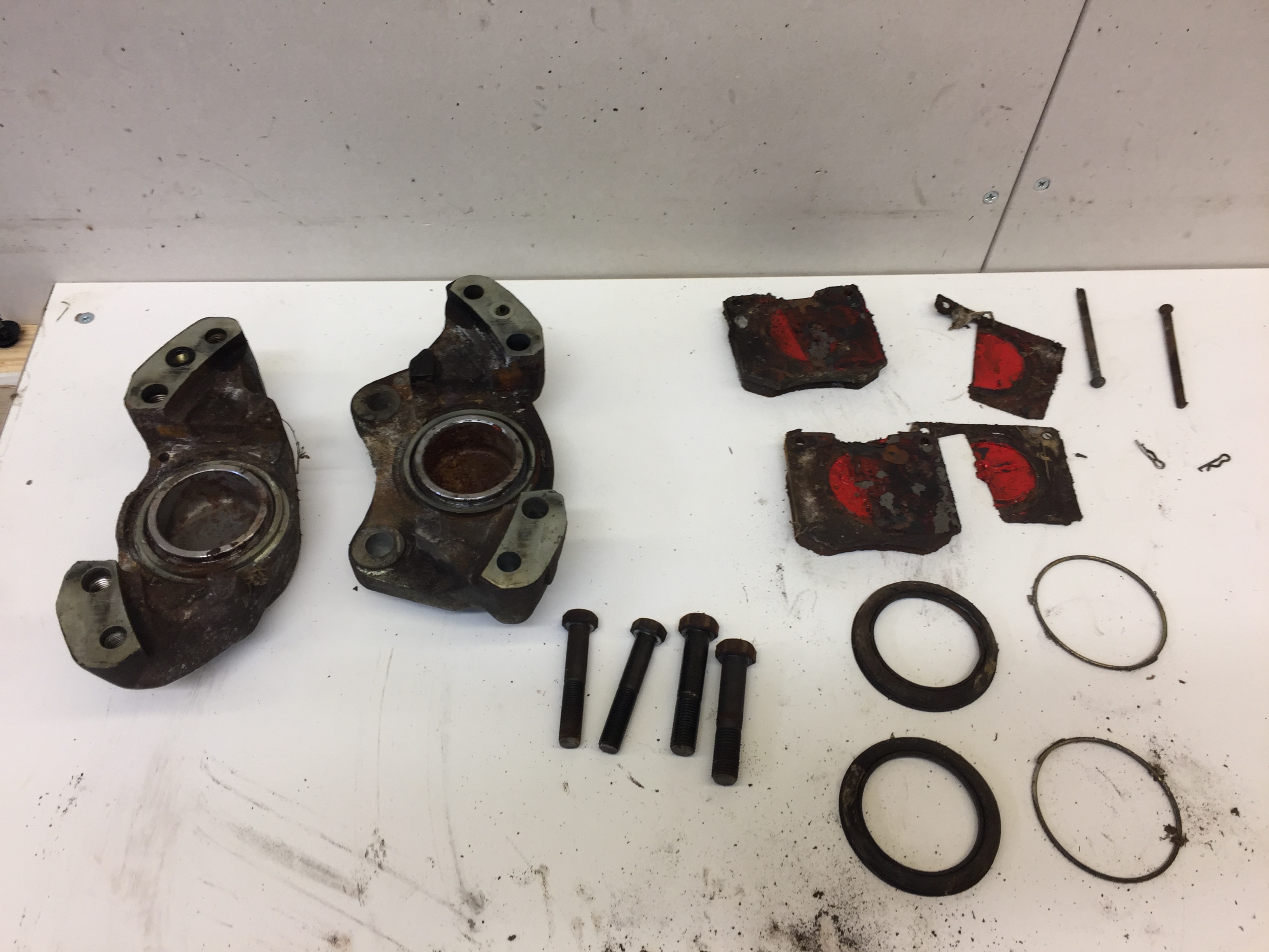

Today I successfully popped the caliper pistons using pressurized air. It took all of 8bar pressure, and then they came out like a gunshot!!!
After that I honed the cylinders and cleaned the pistons, luckily no rust.
One caliper done, three to go. Next one will be quicker.
Done!
Piston popping rig
