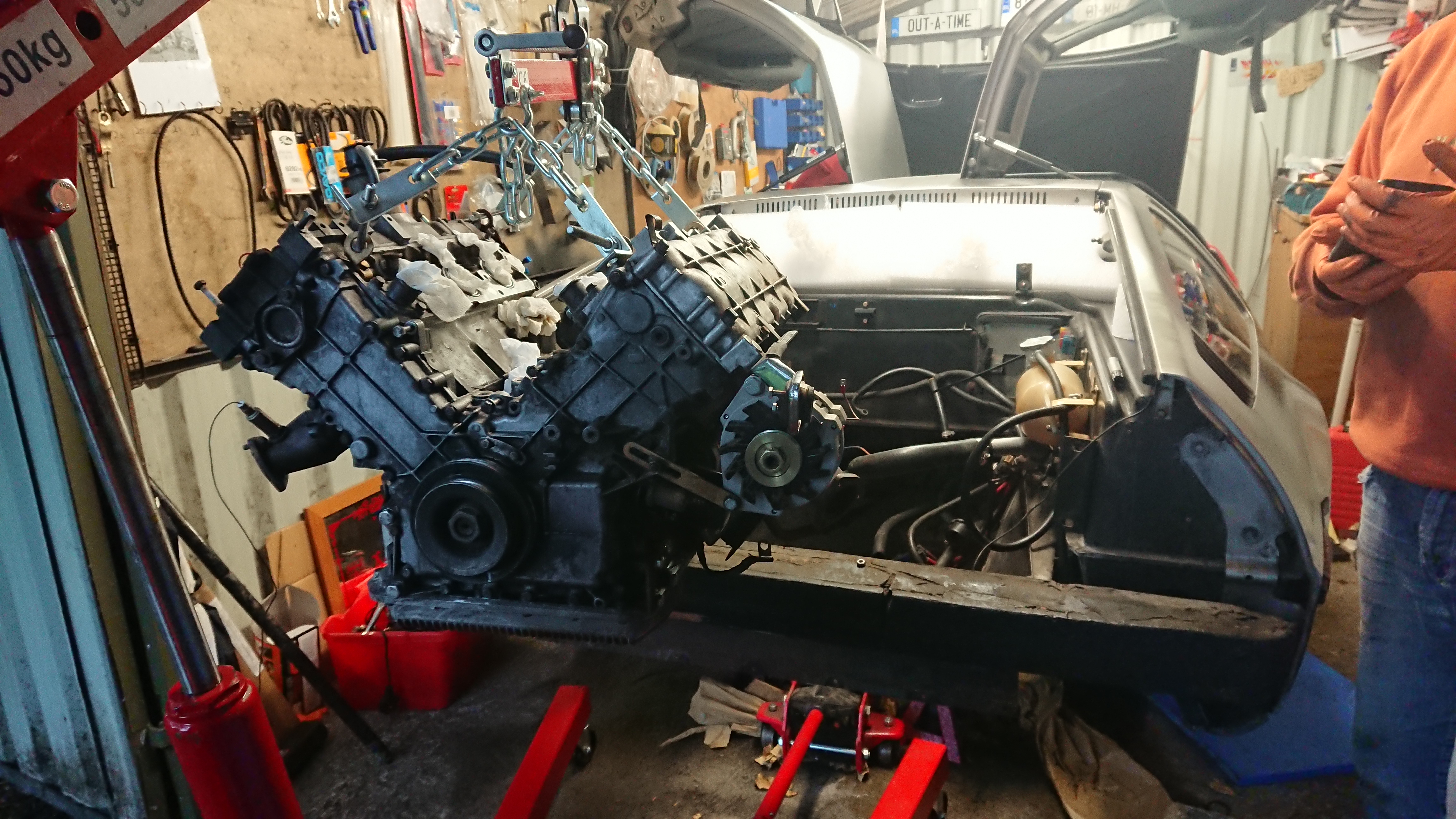

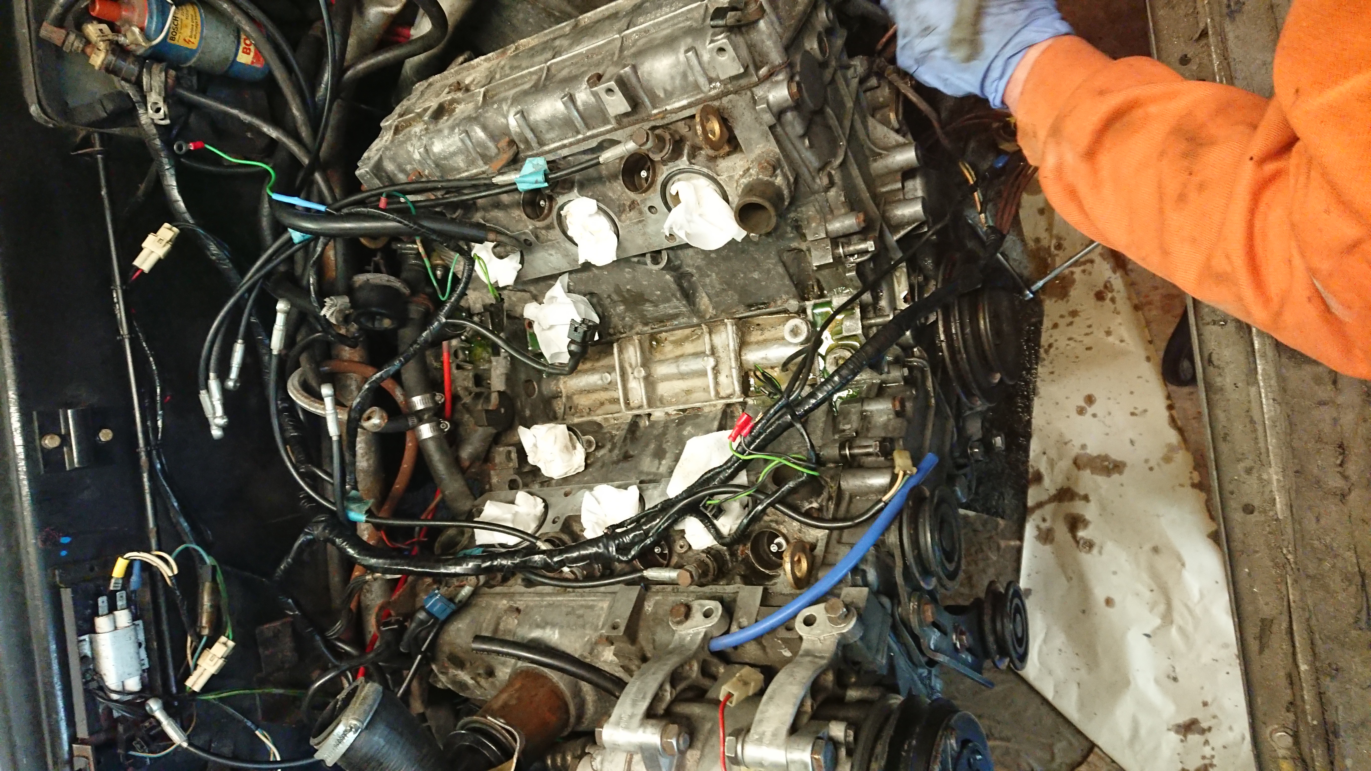

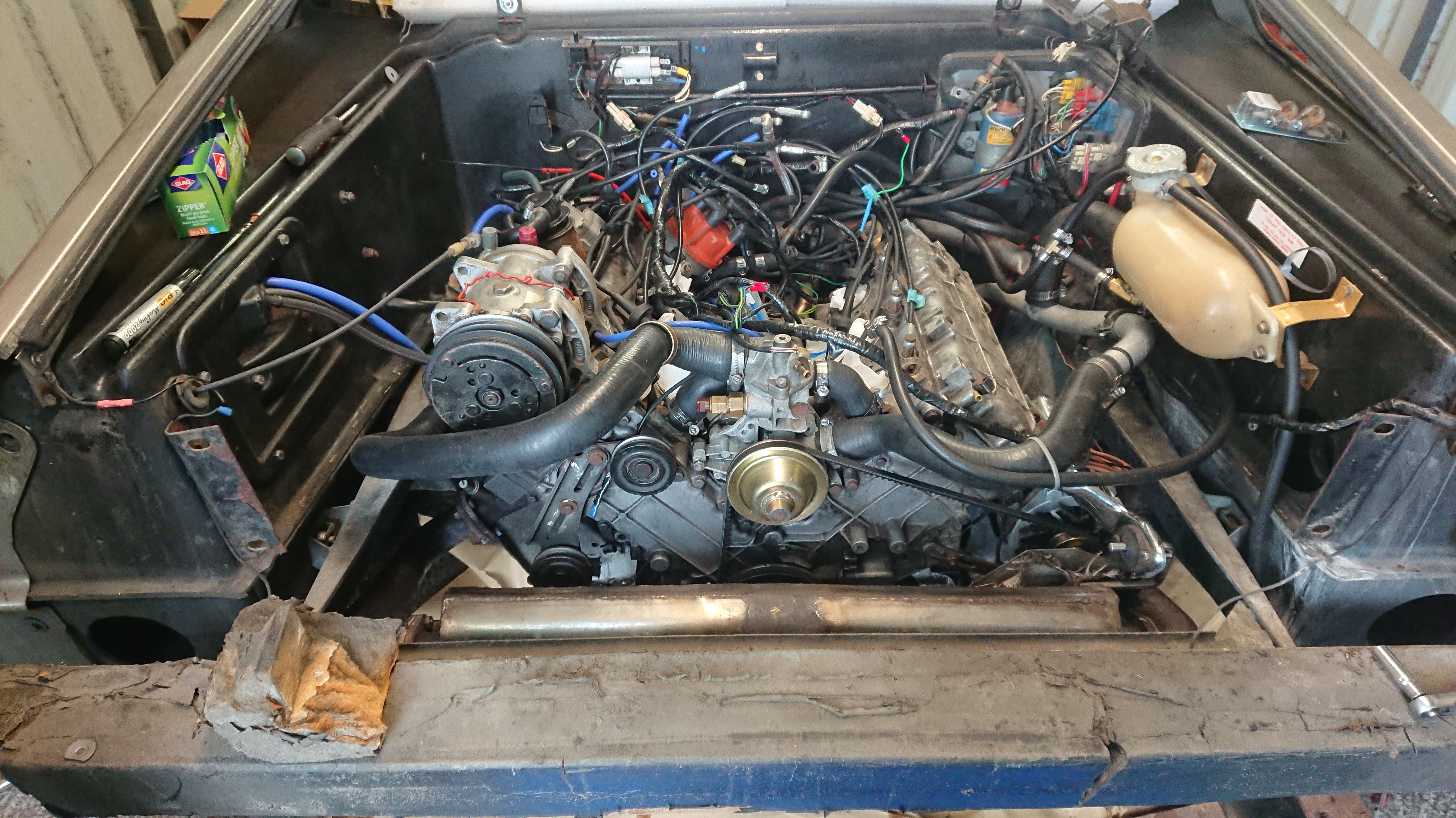

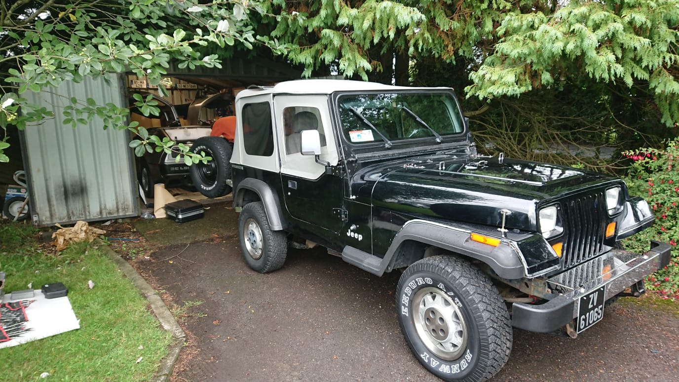

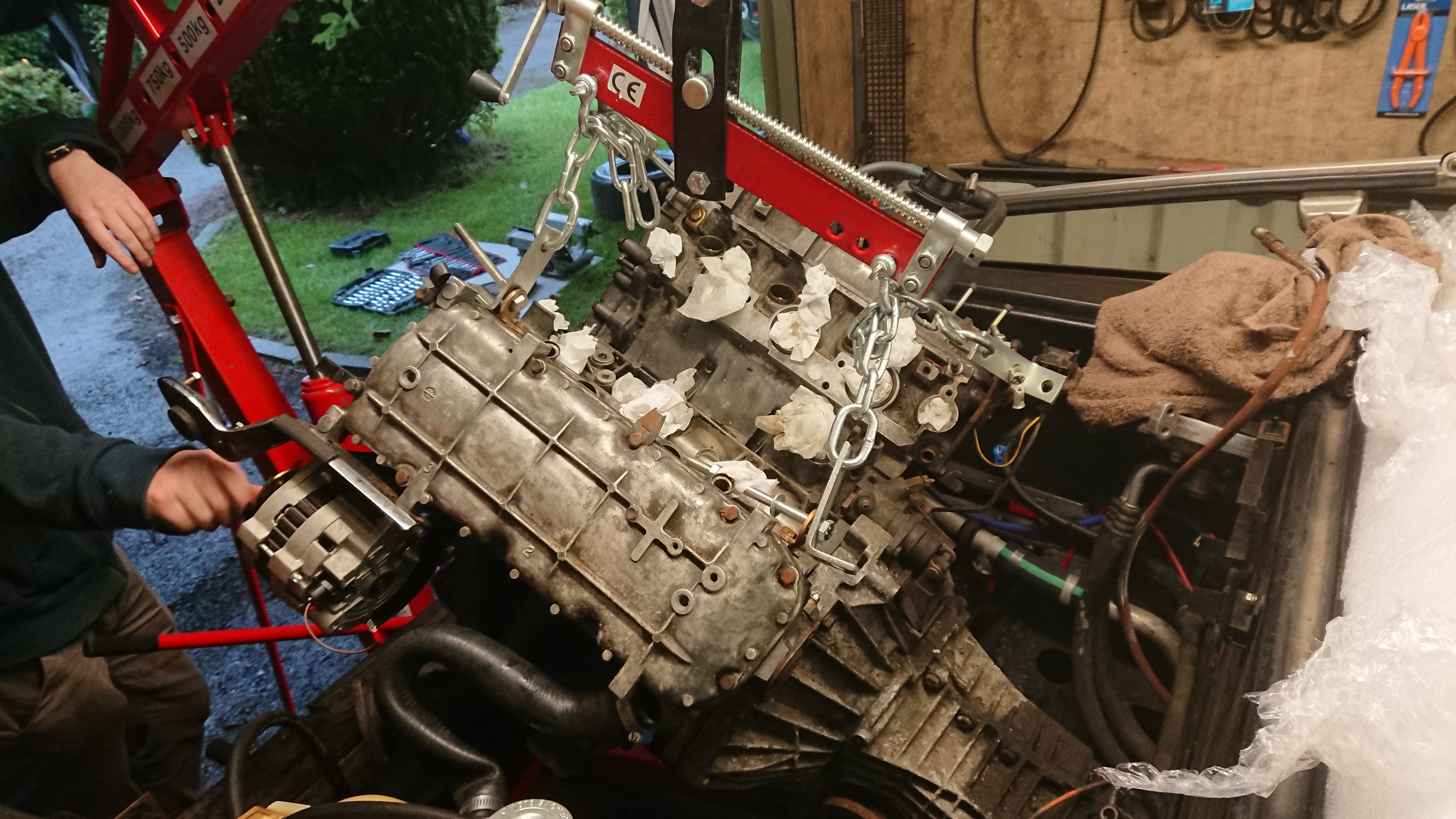

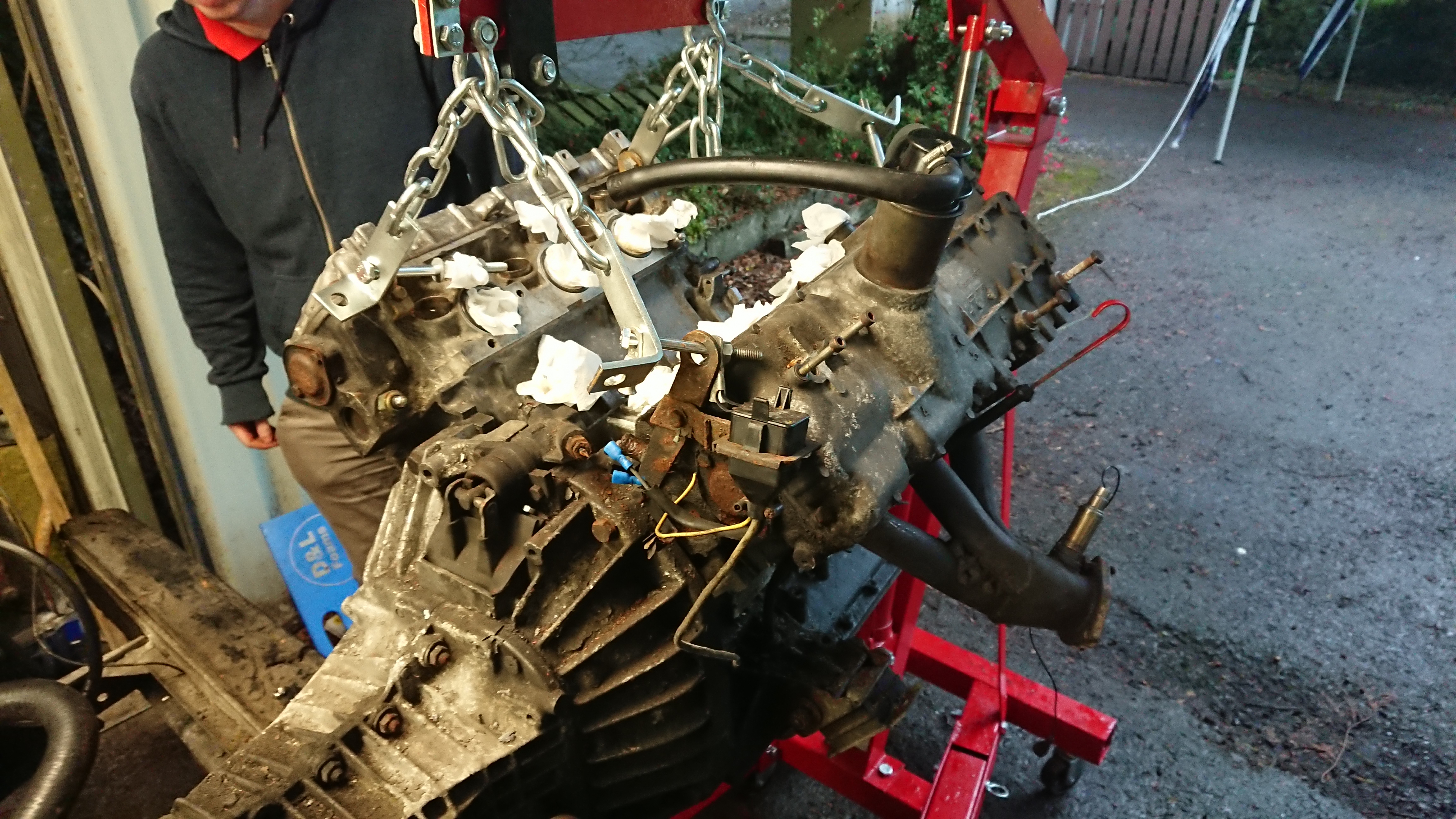

Postby cis6409 » Sun Sep 09, 2018 4:24 pm

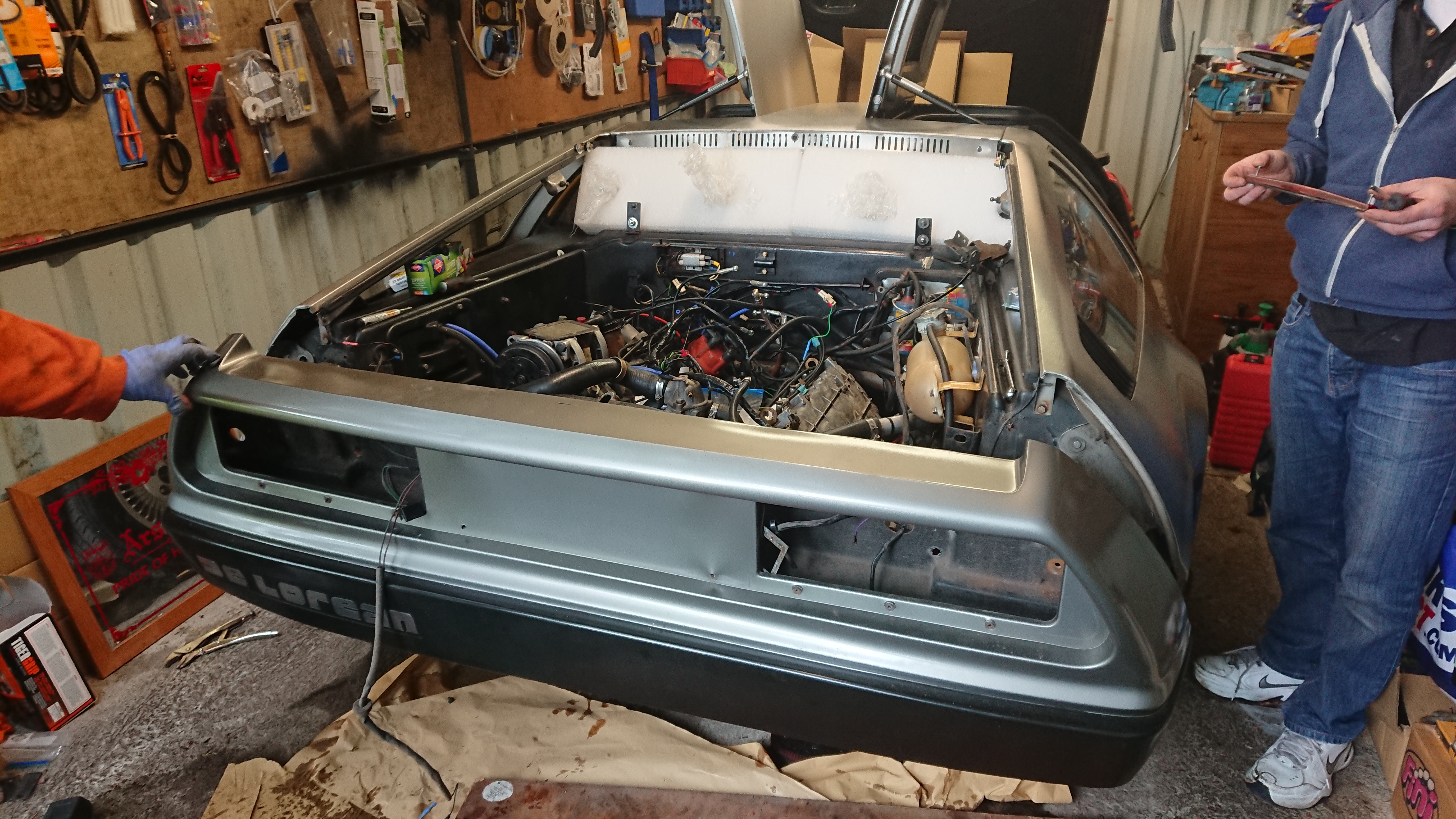

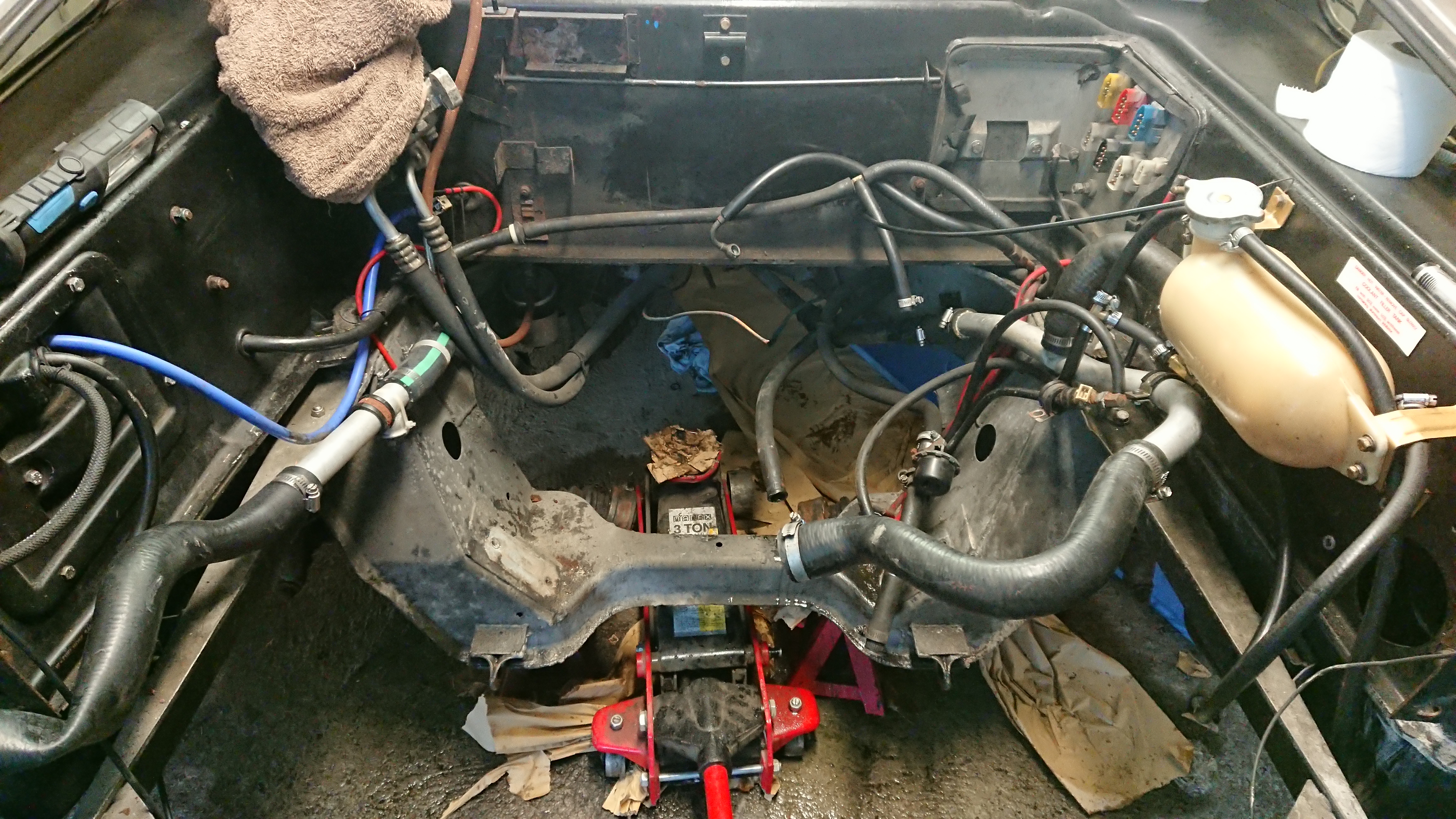

Got a bit more done
Bumper starting to come off

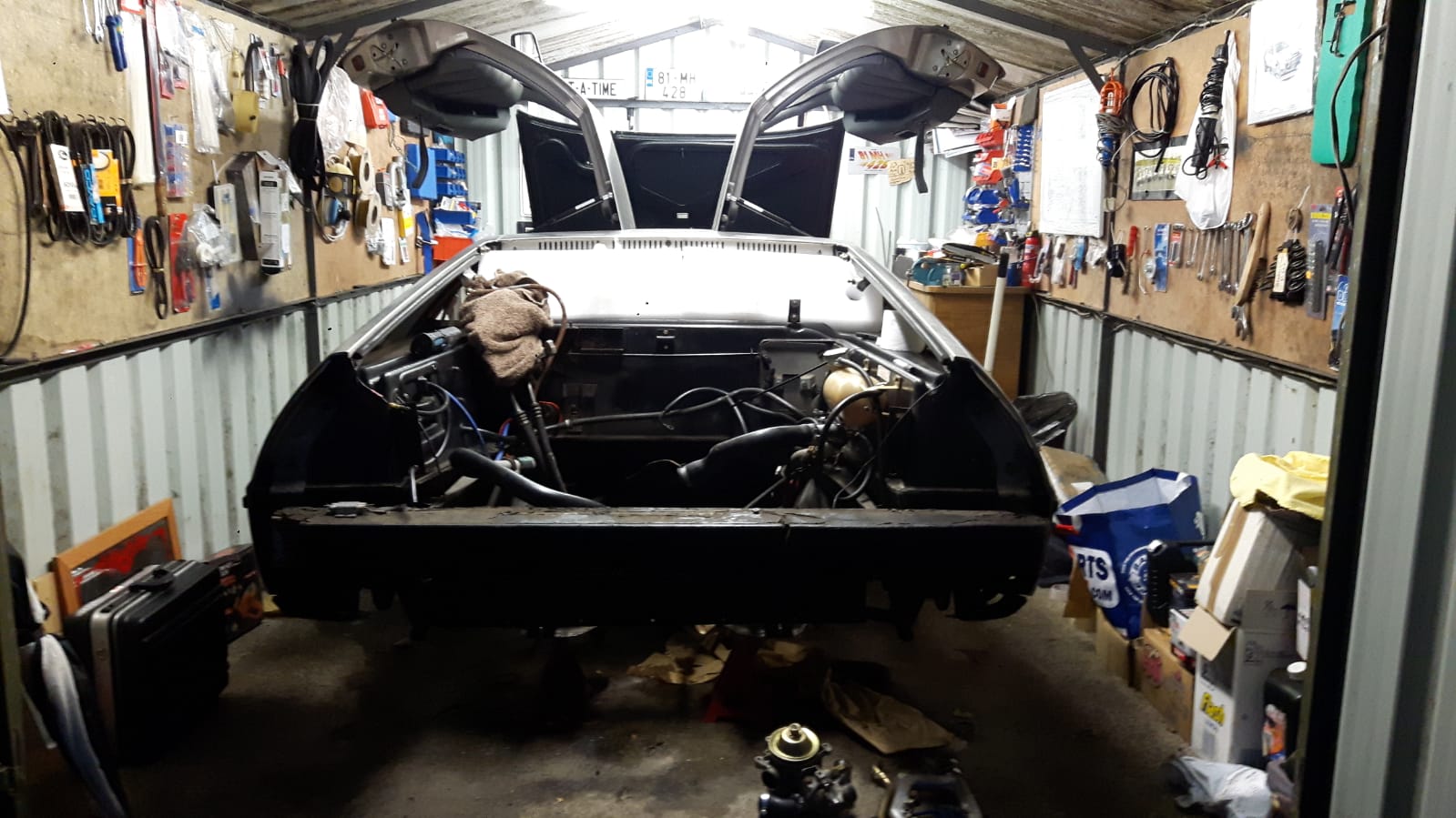

Re: Vin6409 engine rebuild

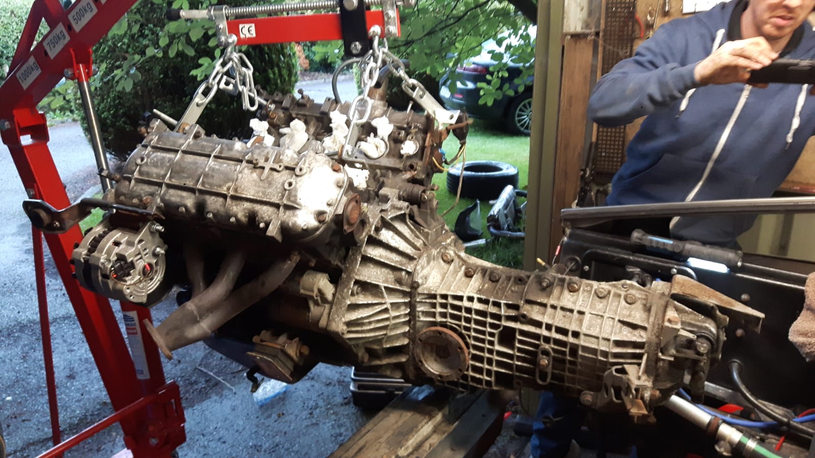

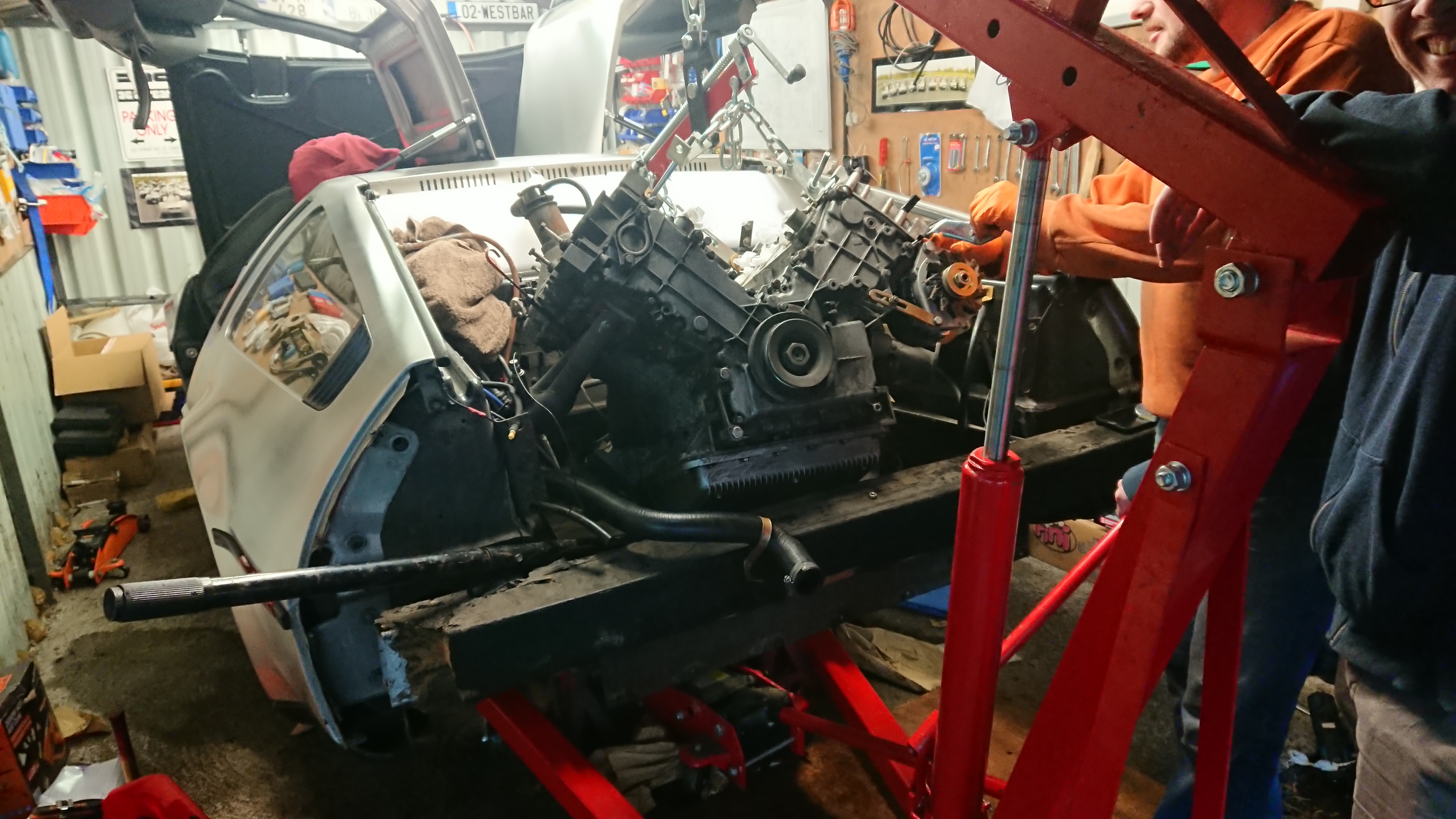

Postby cis6409 » Sun Sep 09, 2018 4:31 pm
More
Offical bumper off presentation

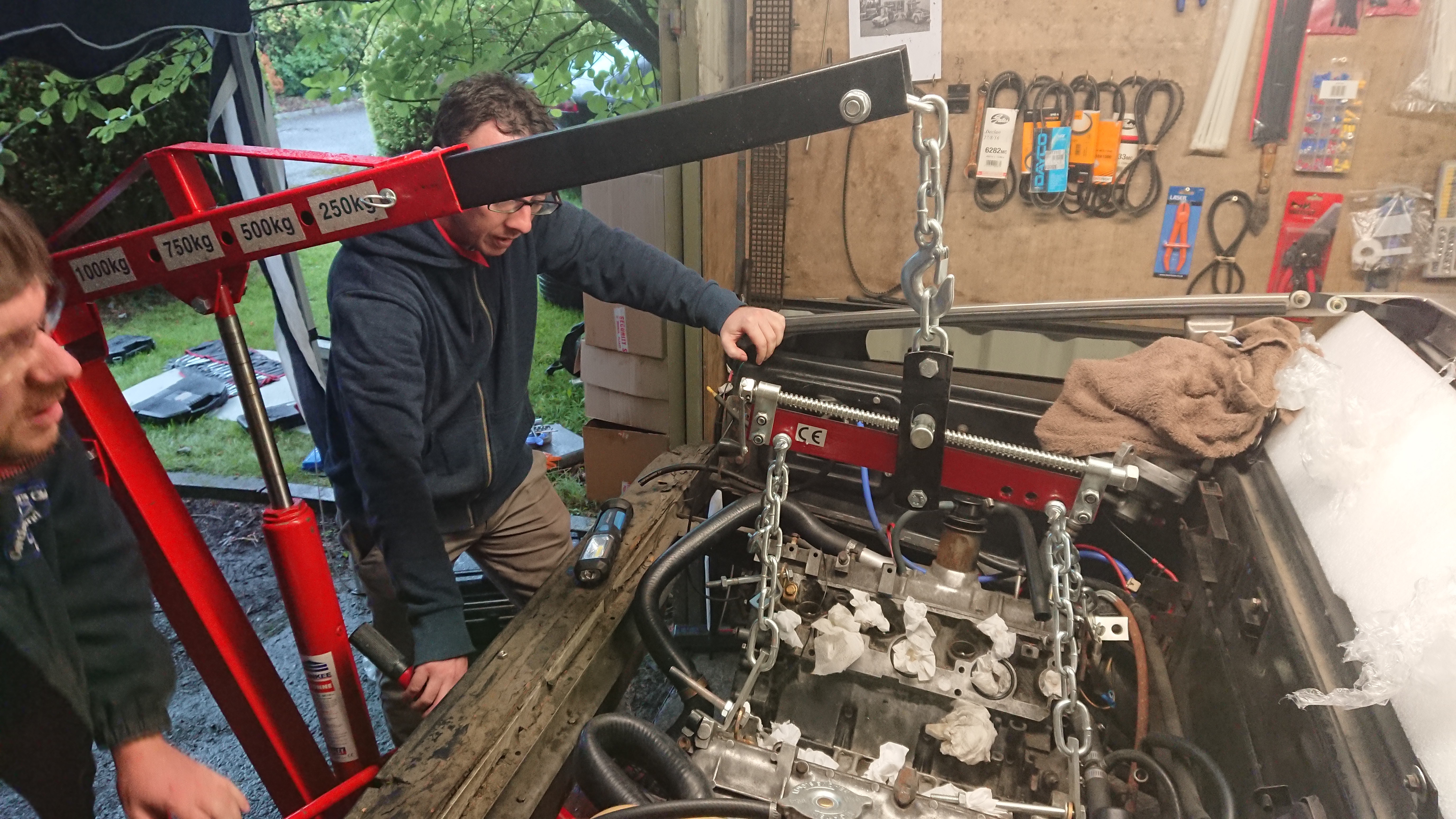

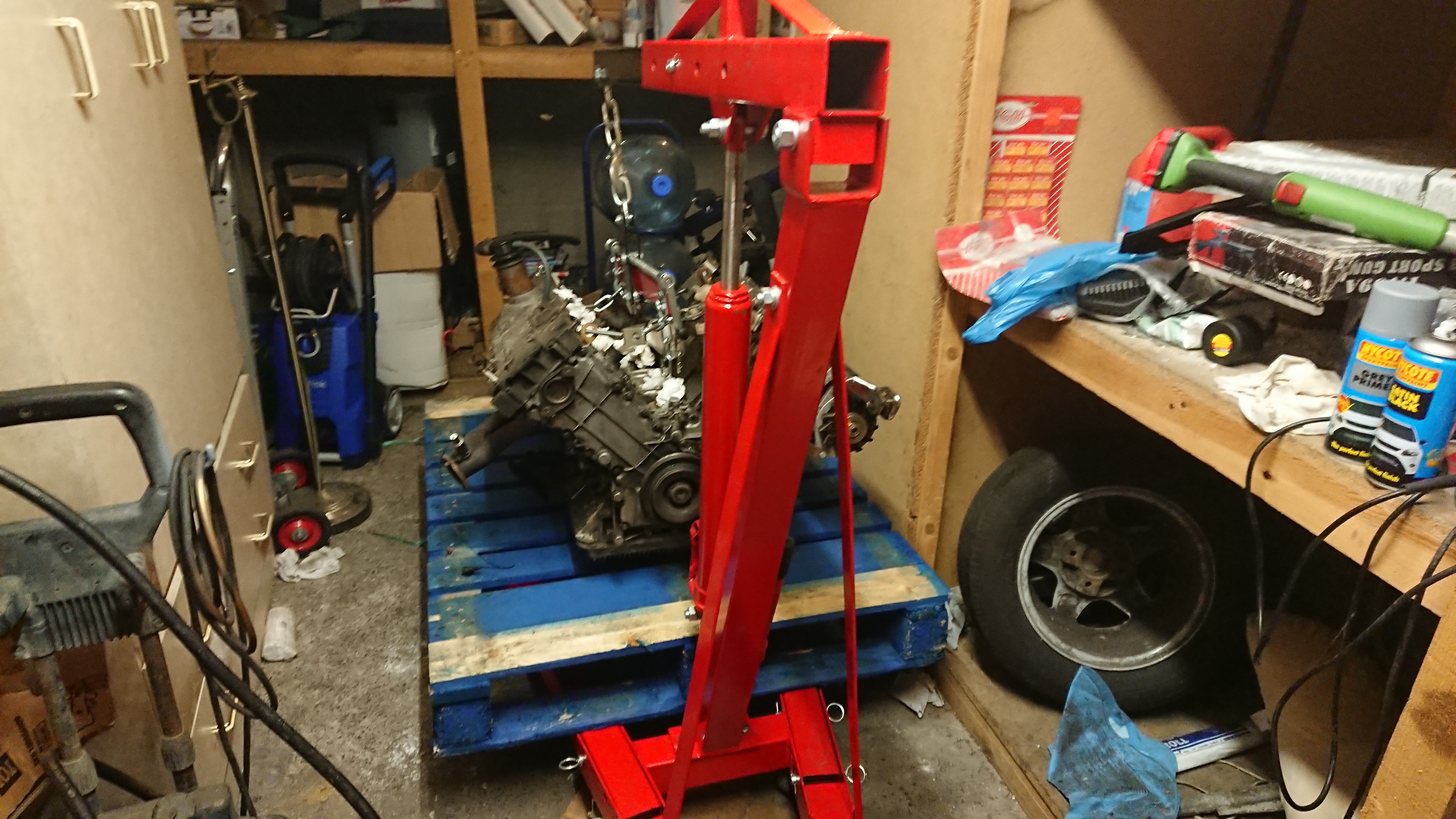

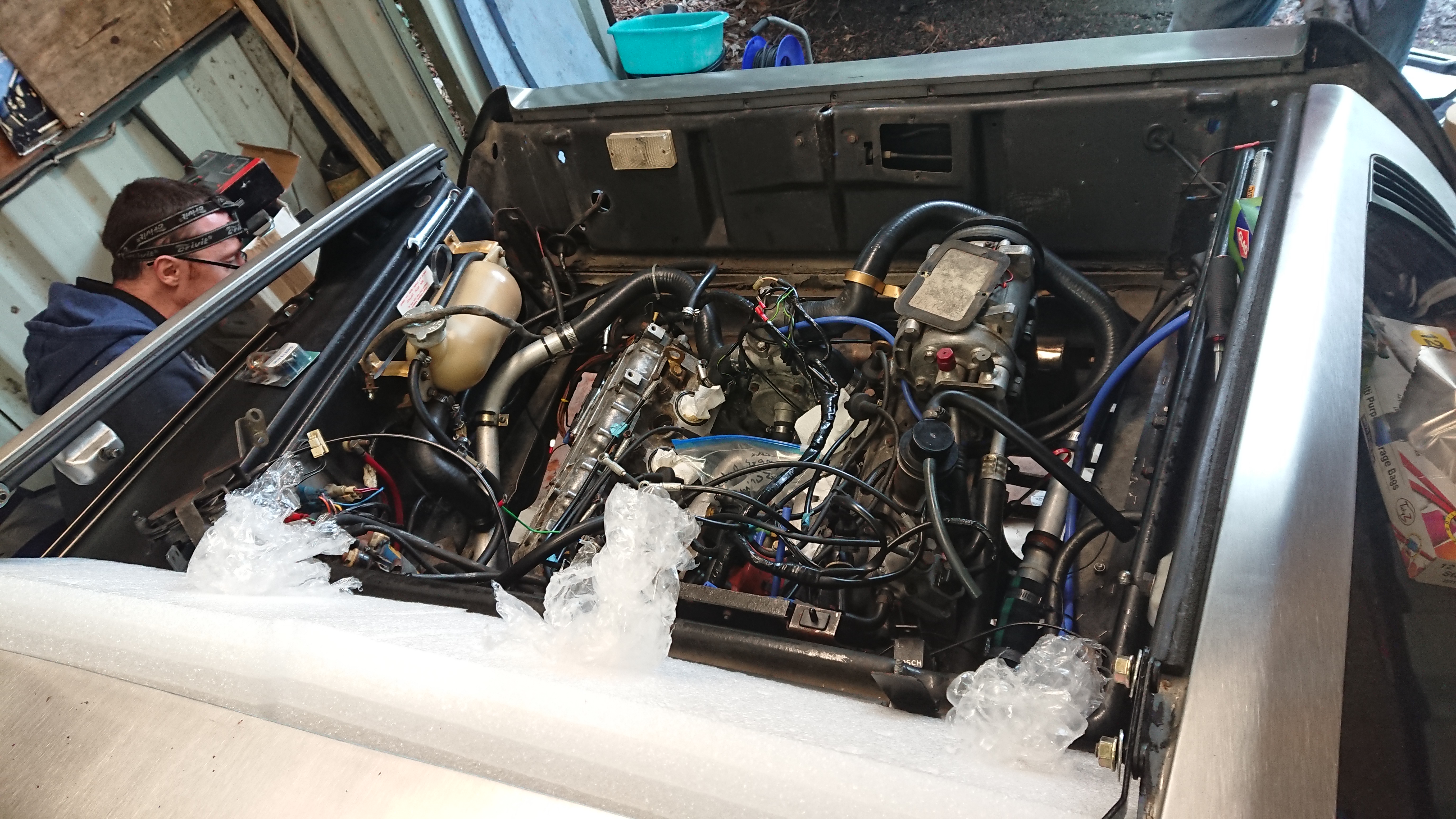

Postby cis6409 » Sun Sep 09, 2018 5:05 pm
Macgyver came to help lol !

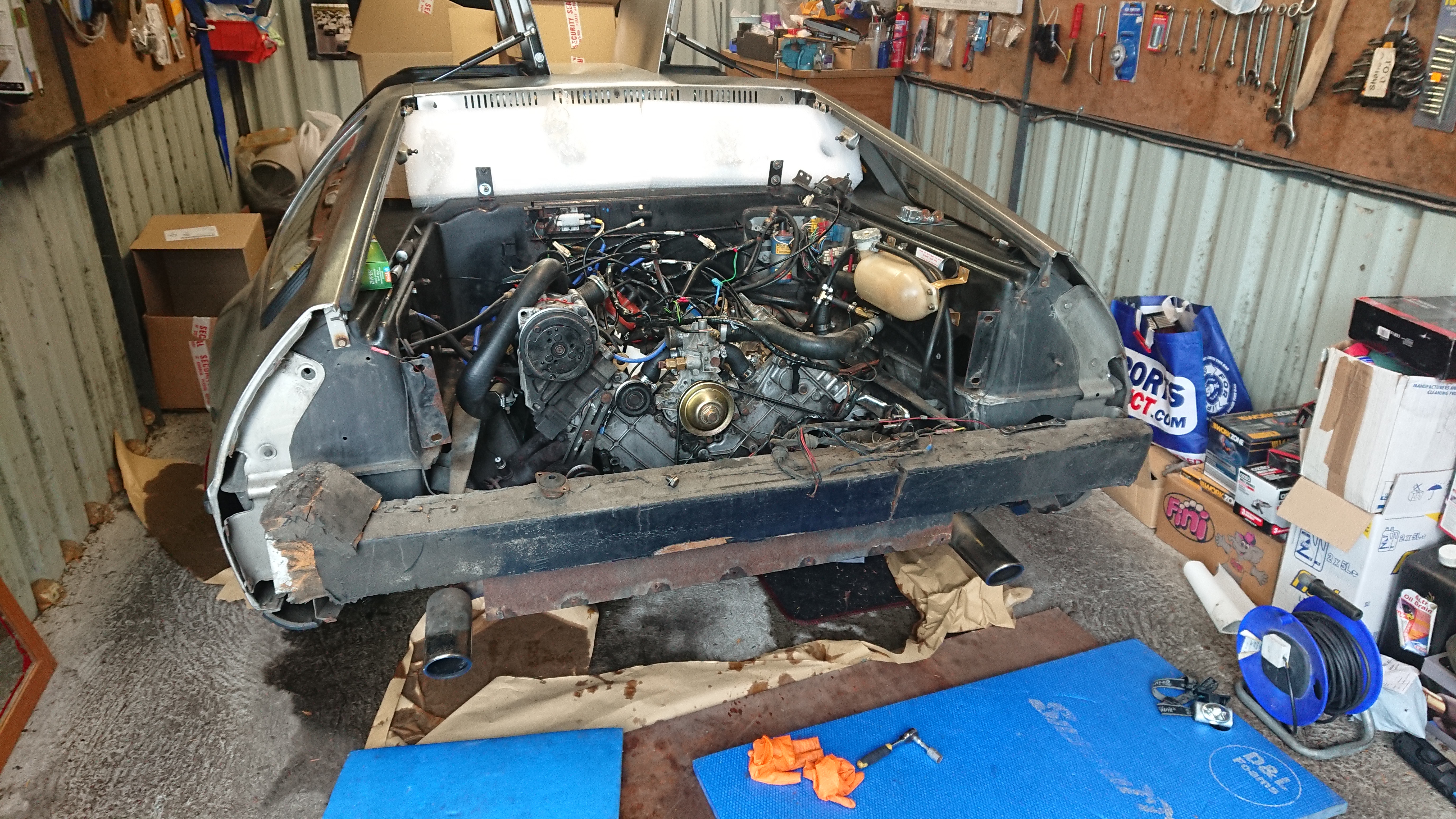

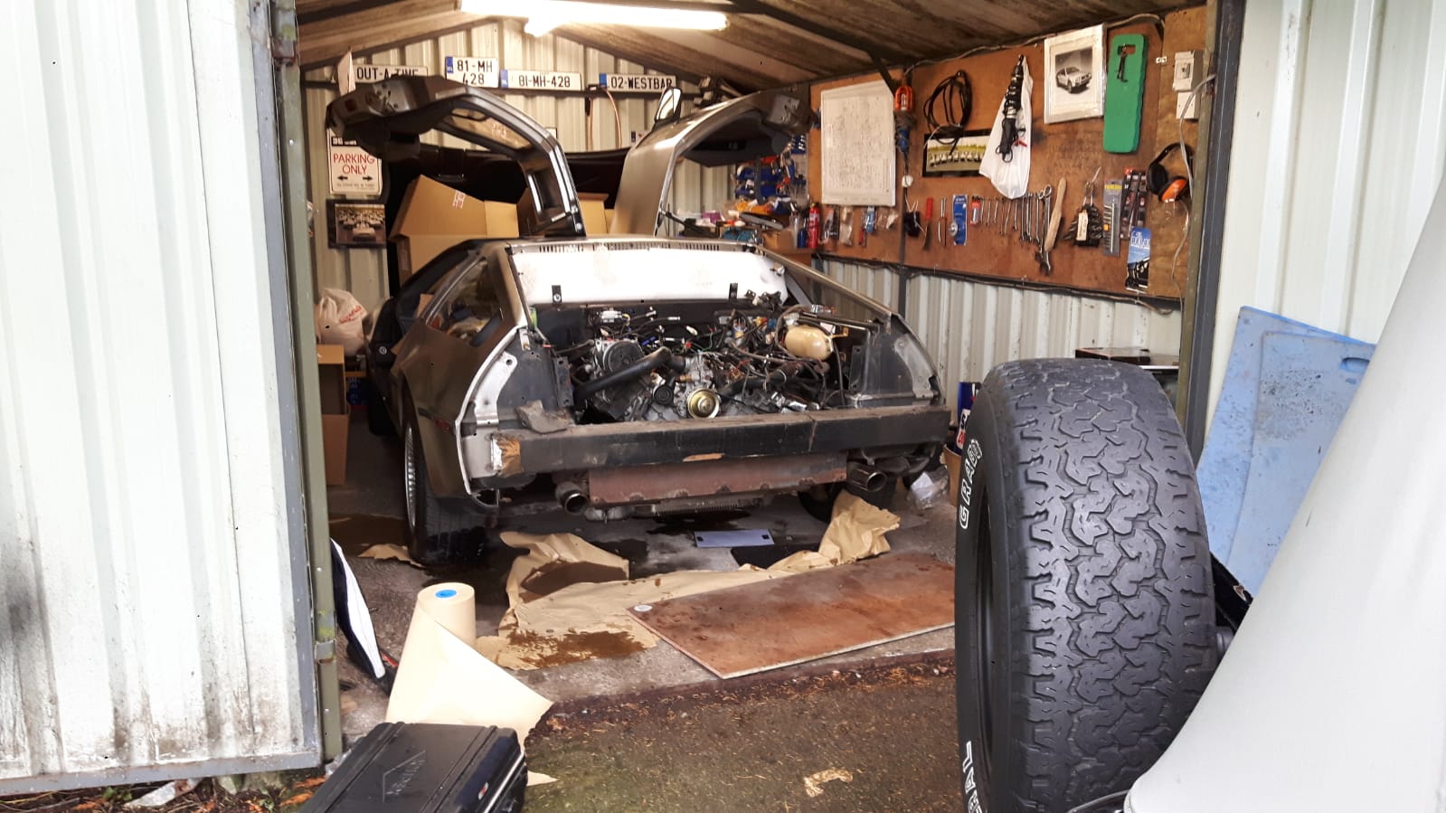

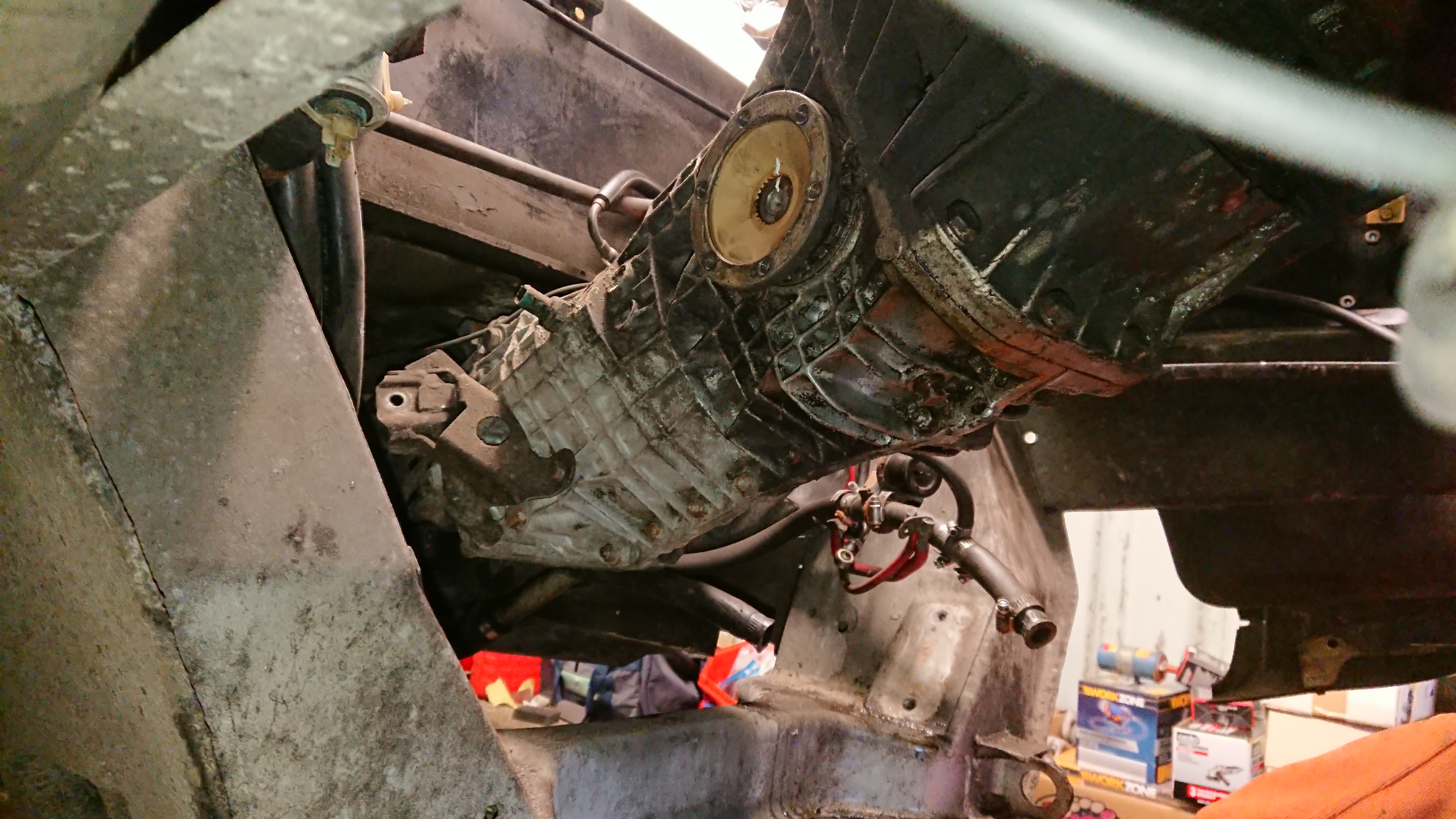

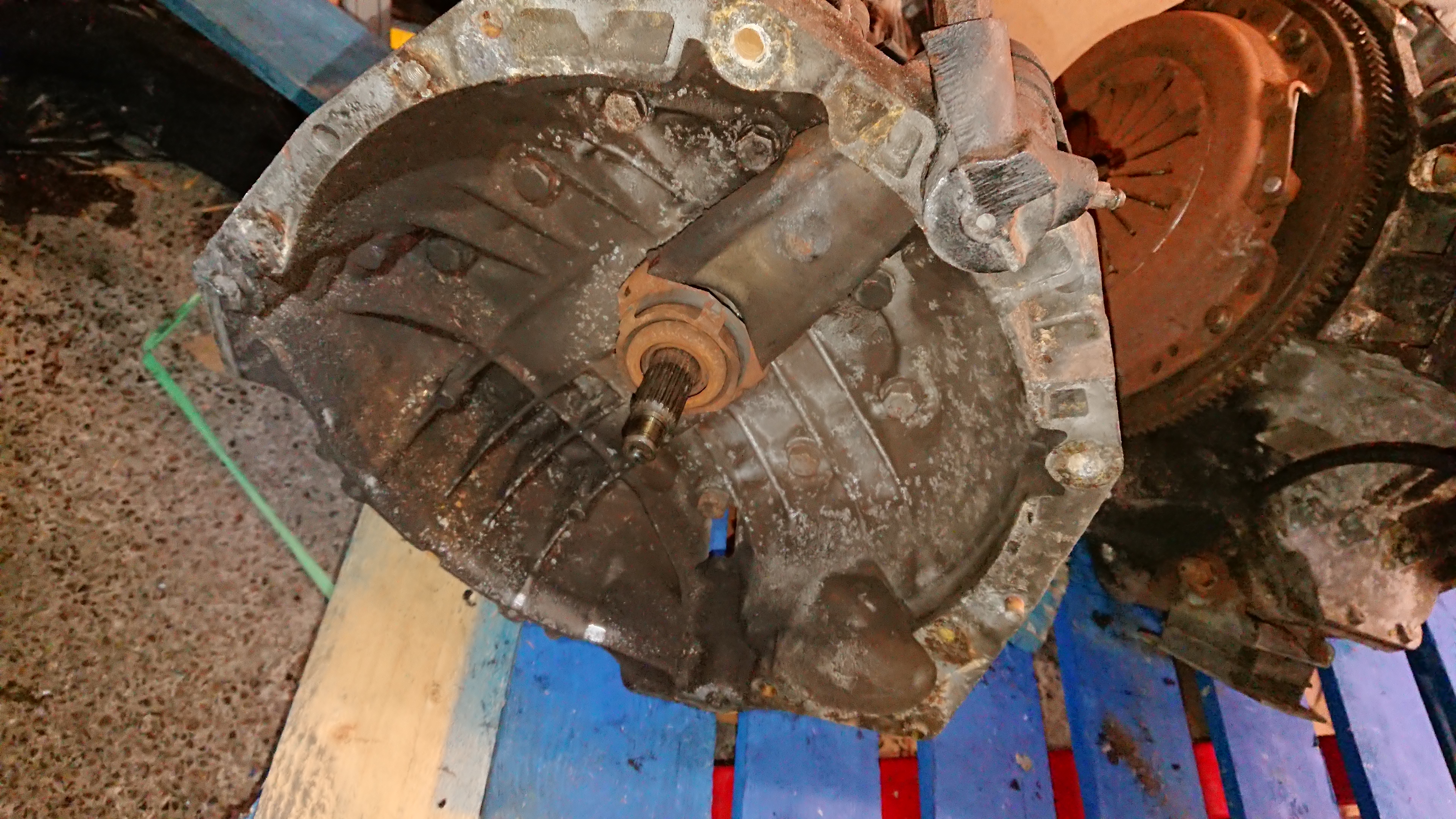

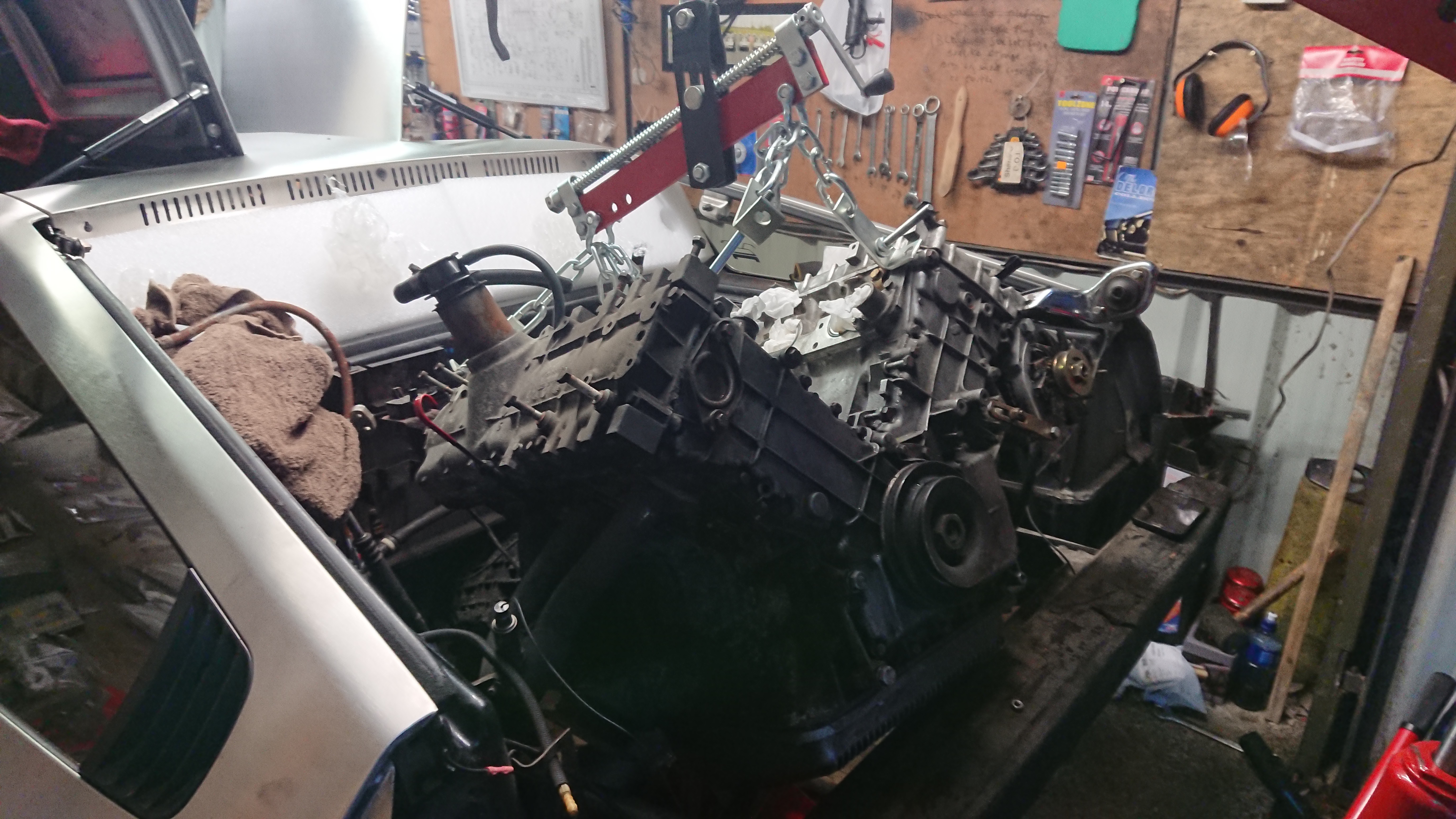

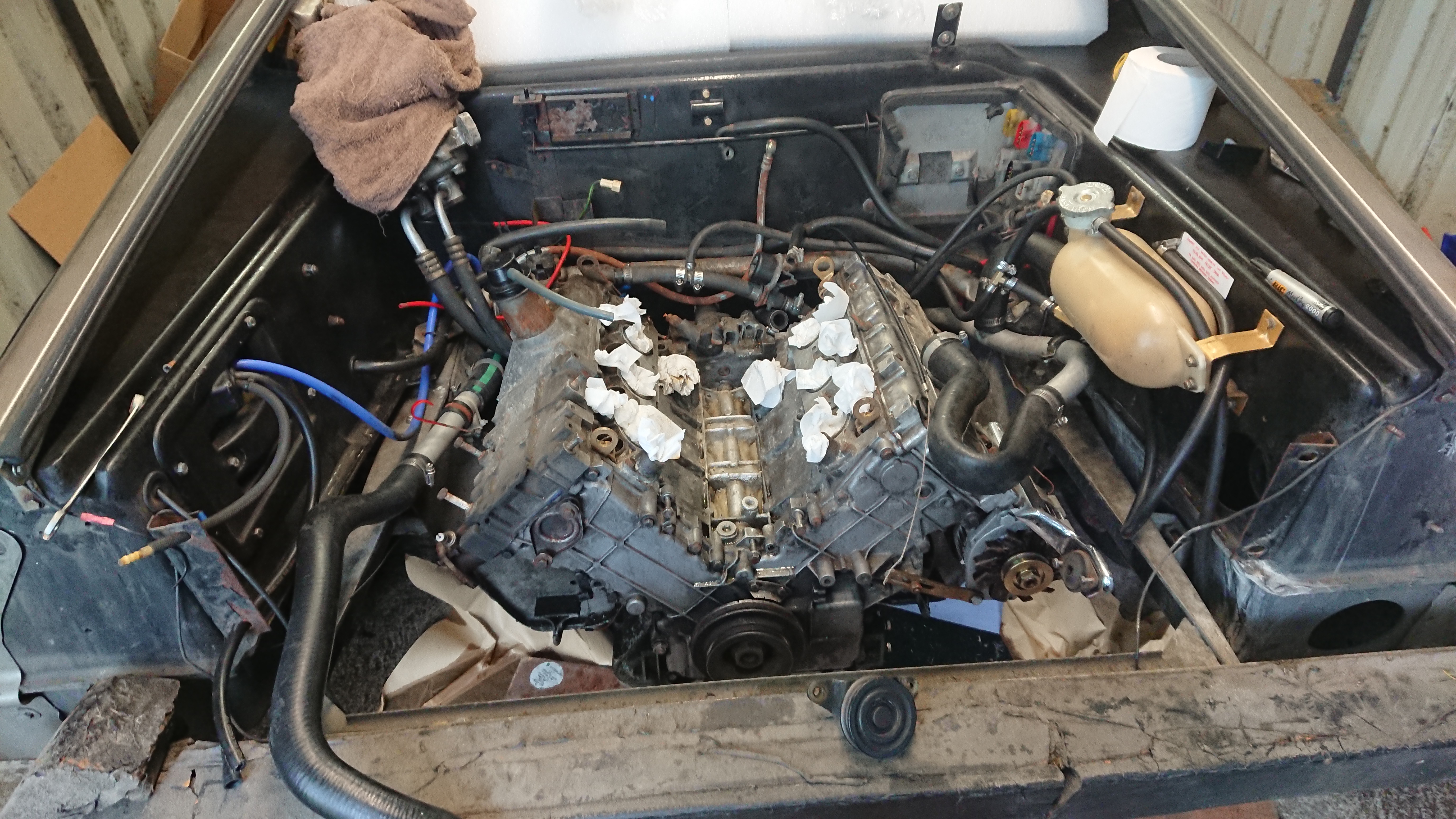

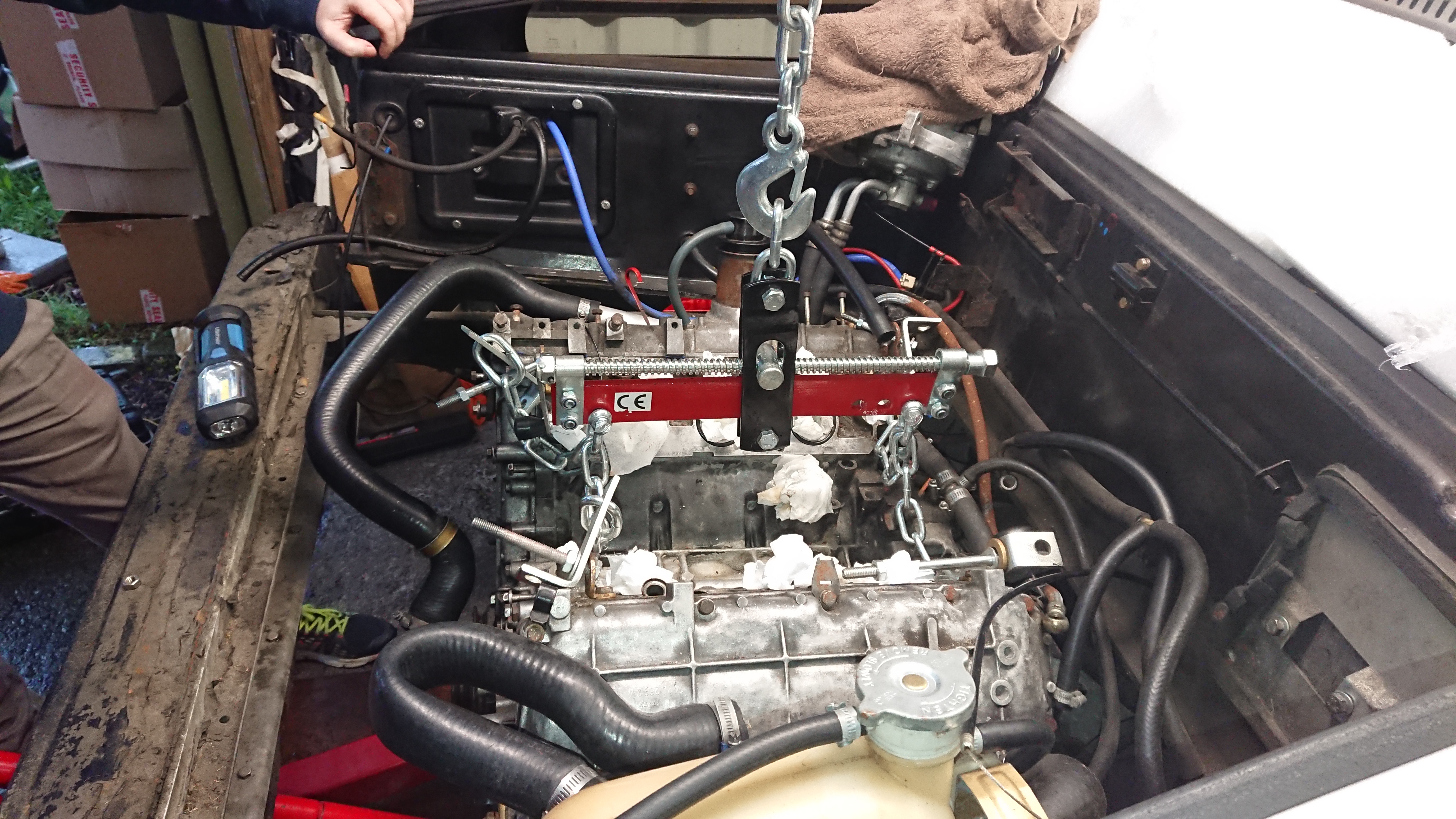

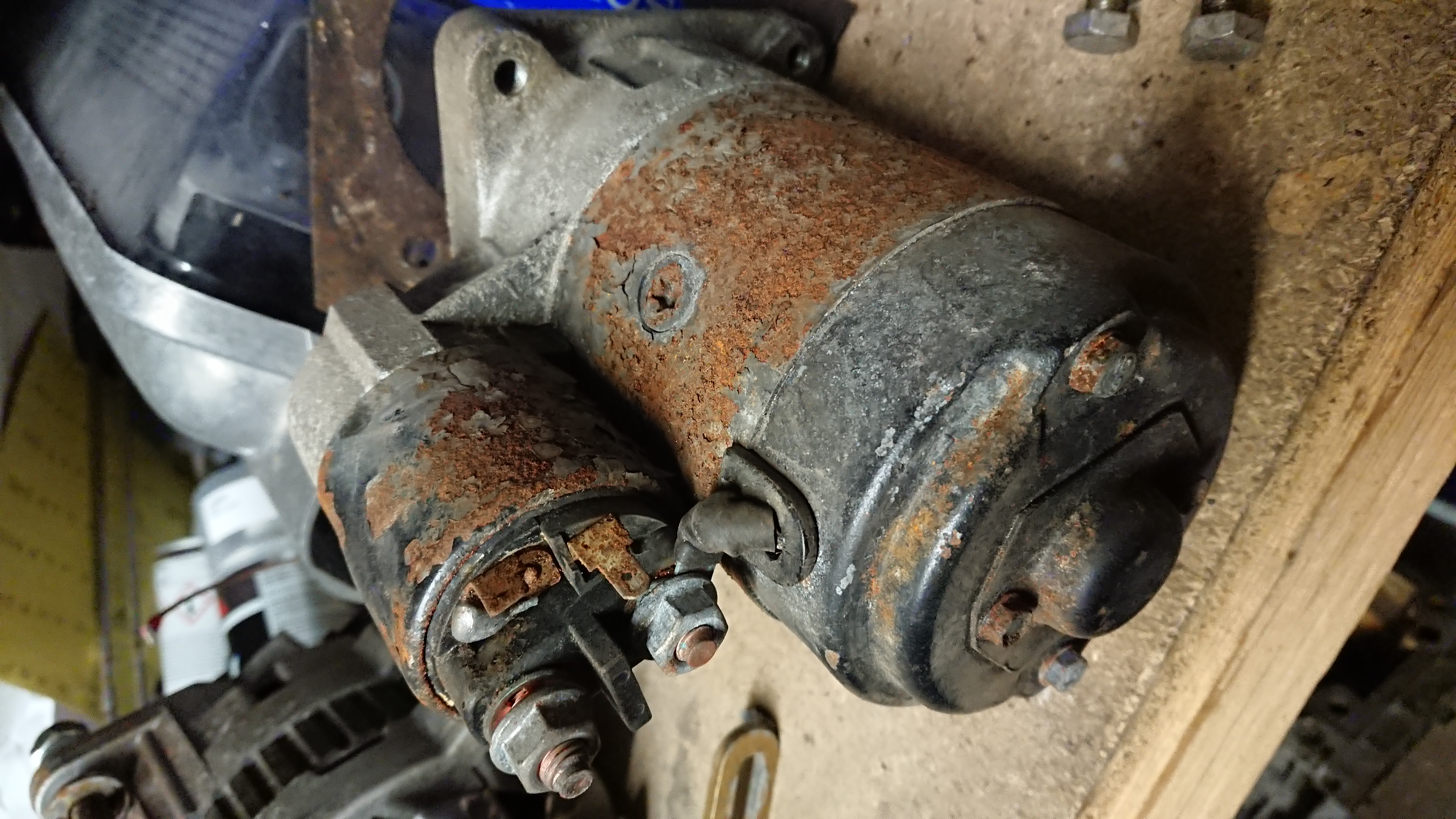

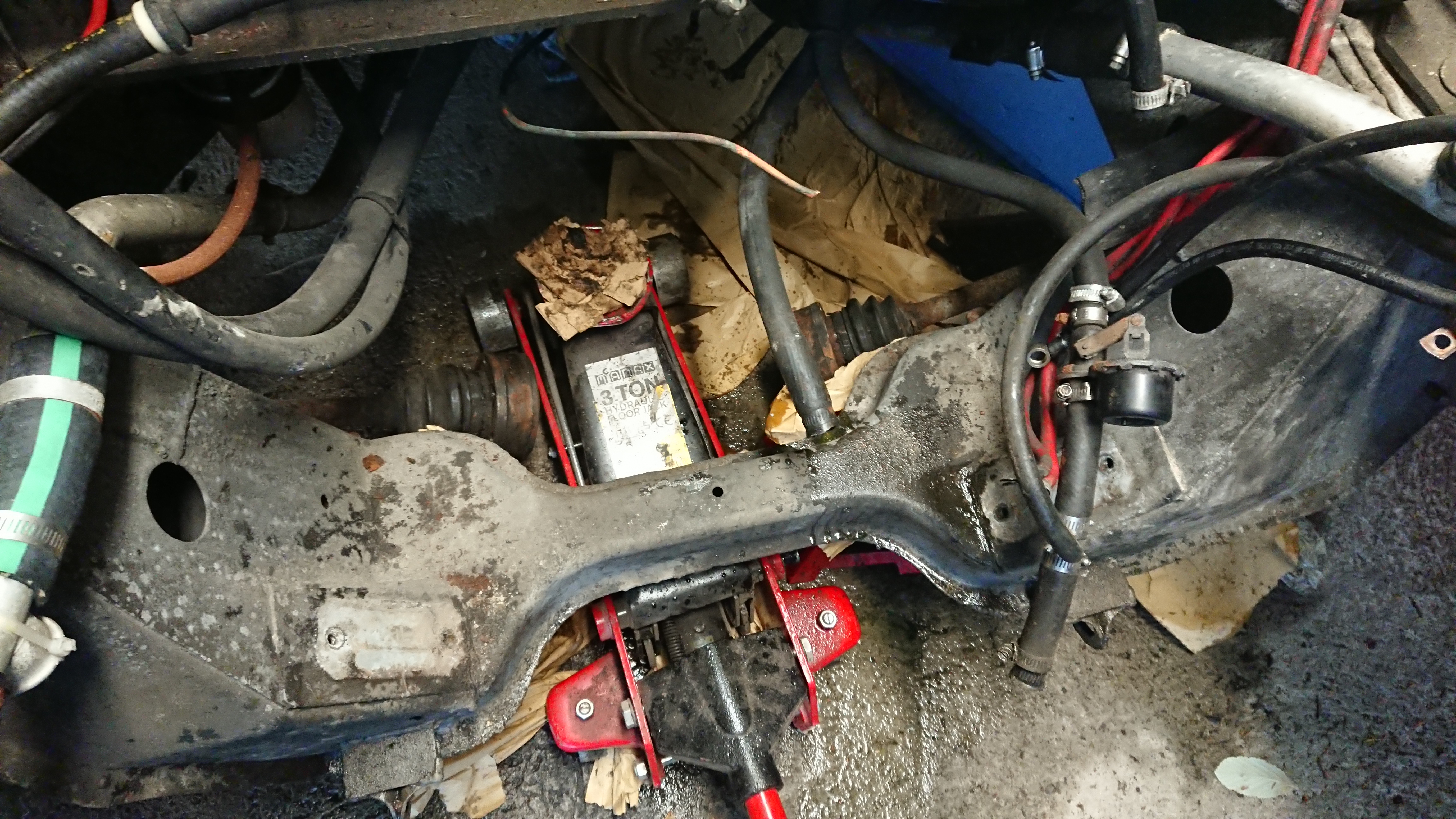

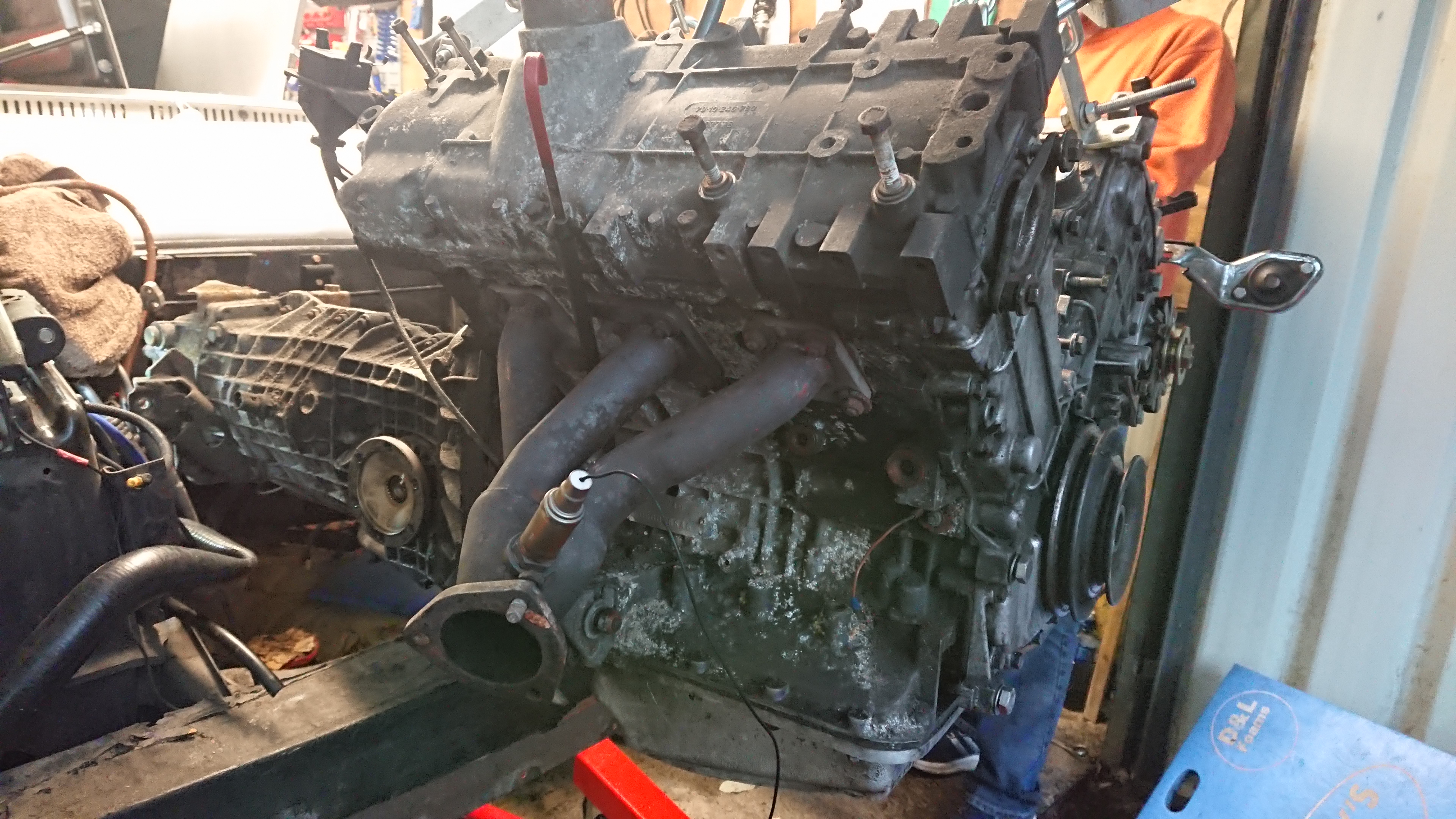

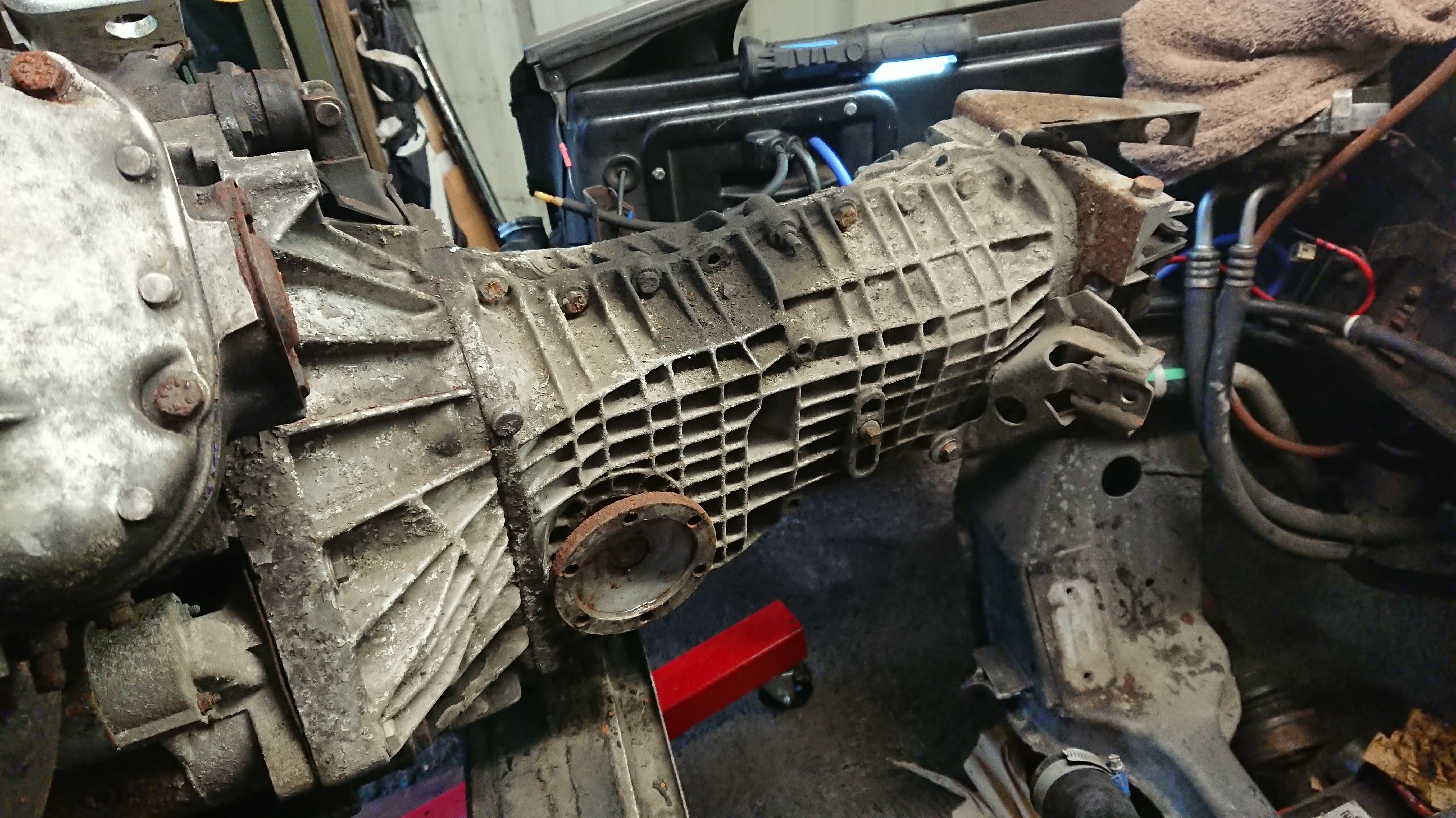

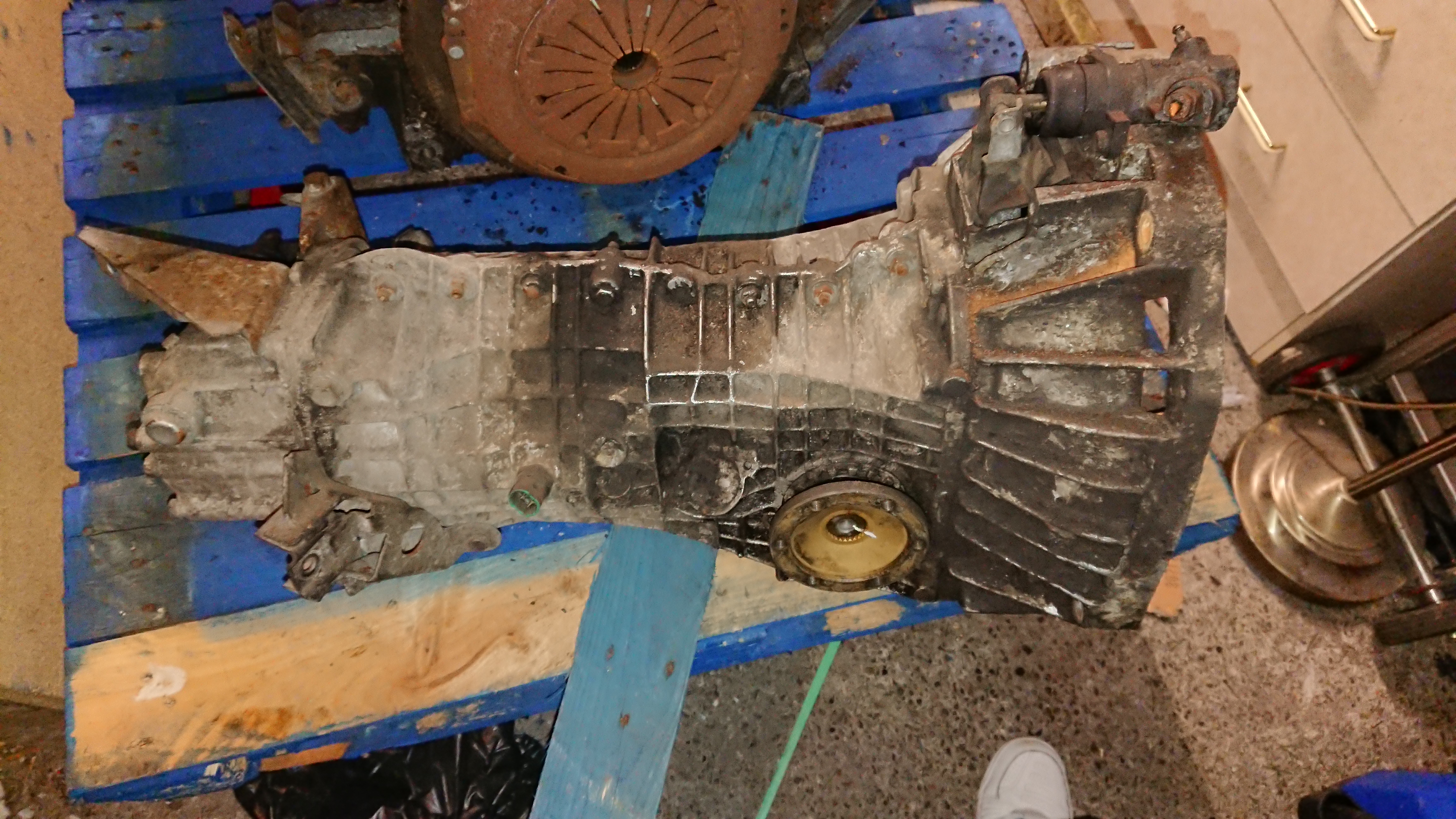

Postby cis6409 » Mon Sep 17, 2018 3:13 pm

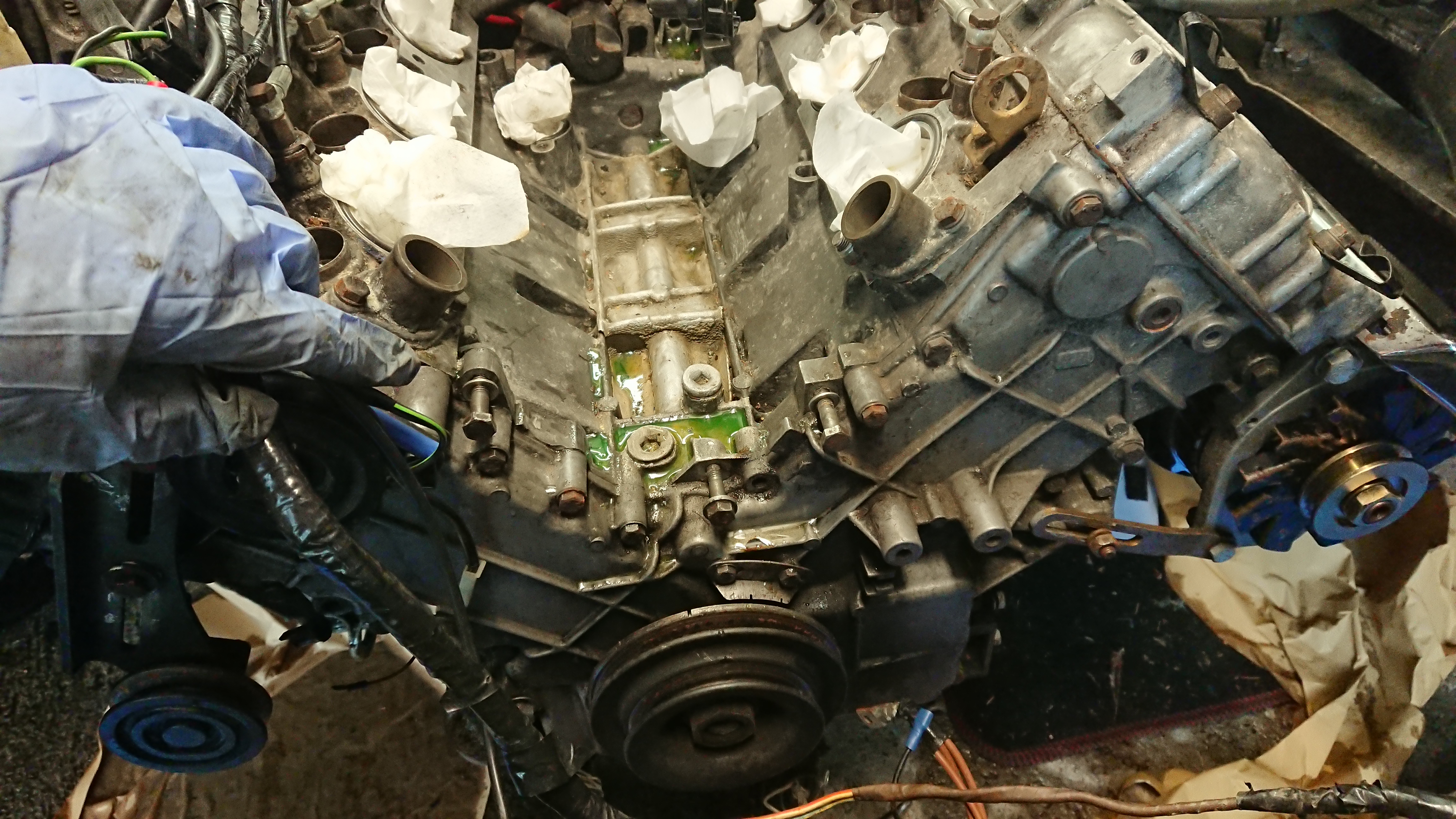

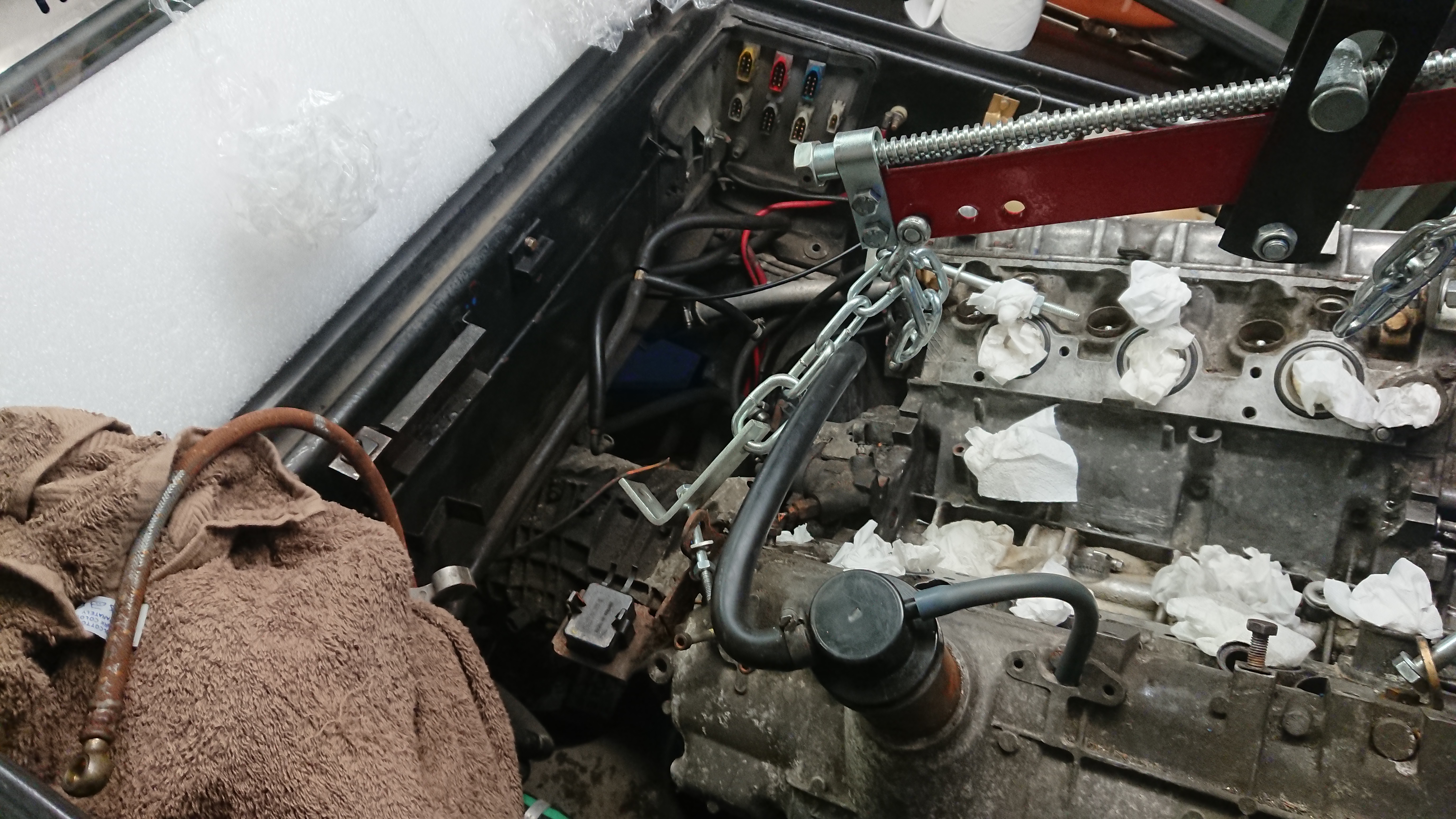

Got a small bit more done, further stripping of remaining ancillaries and disconnected the gearbox, Interestingly missing the third inspection plate for the bottom of bell housing to block..probably rusted away lol!

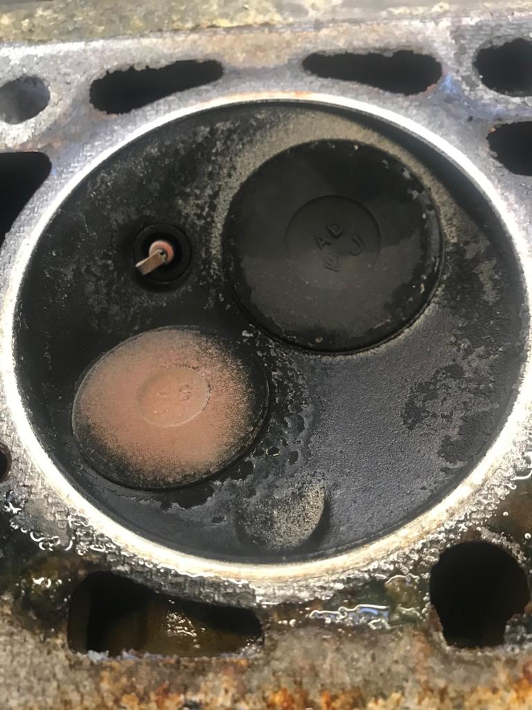

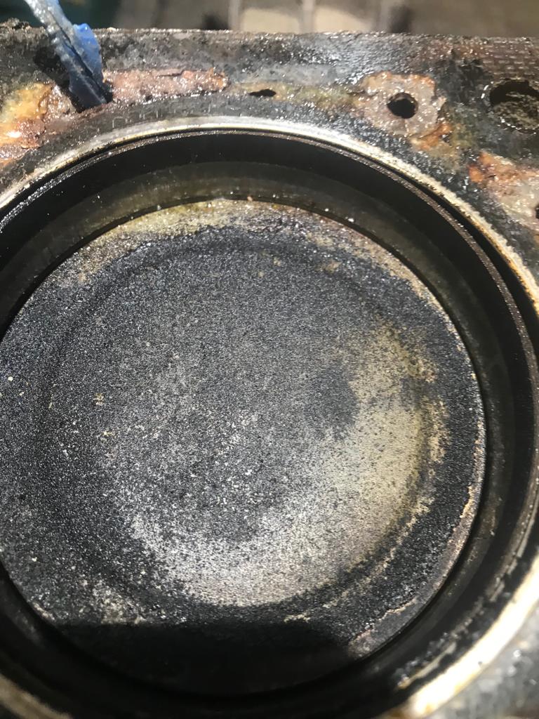

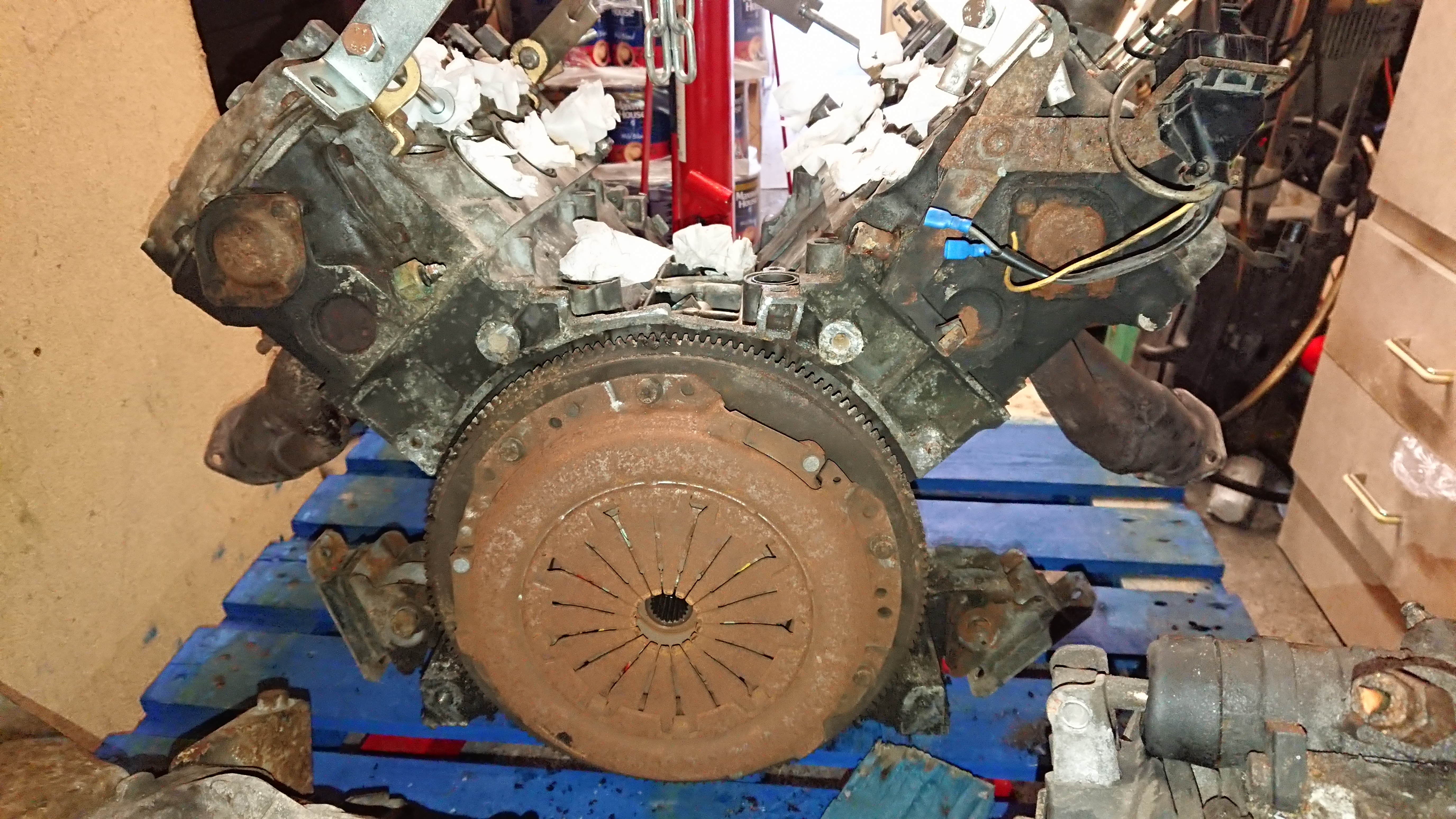

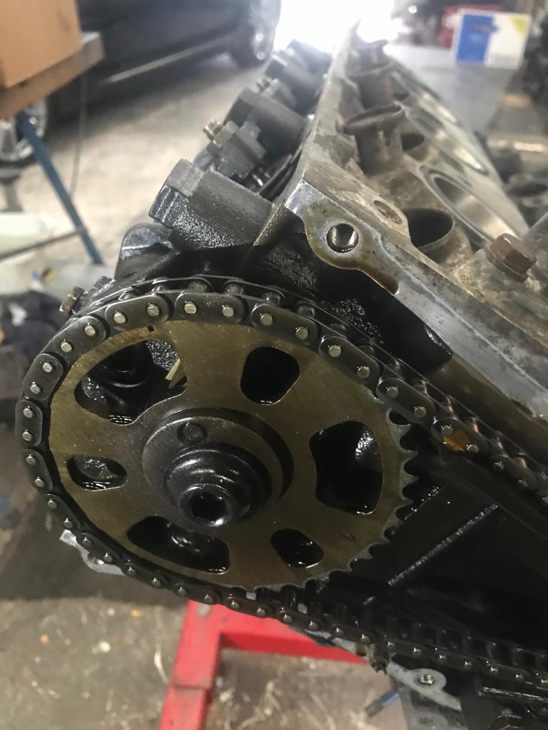

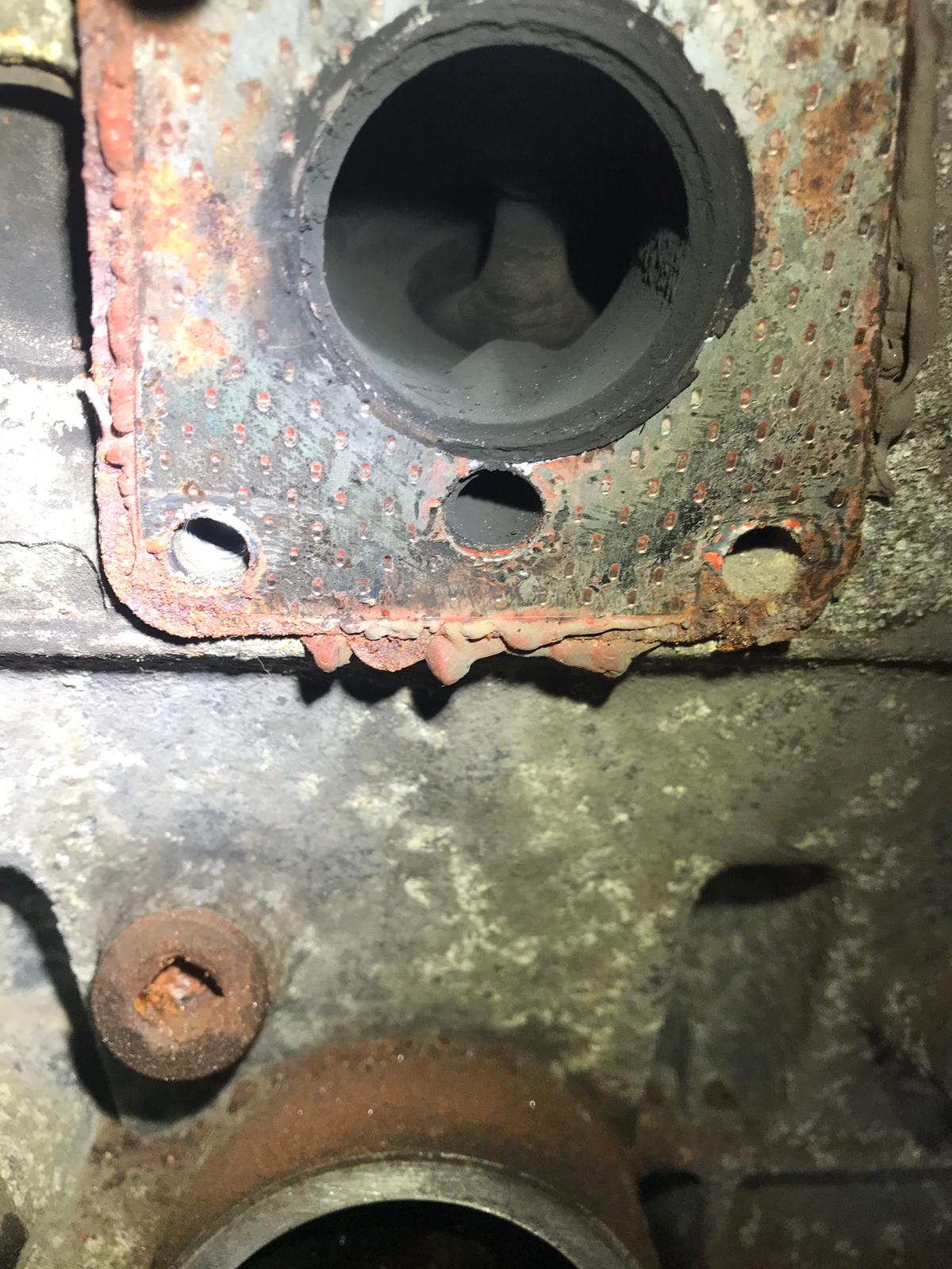

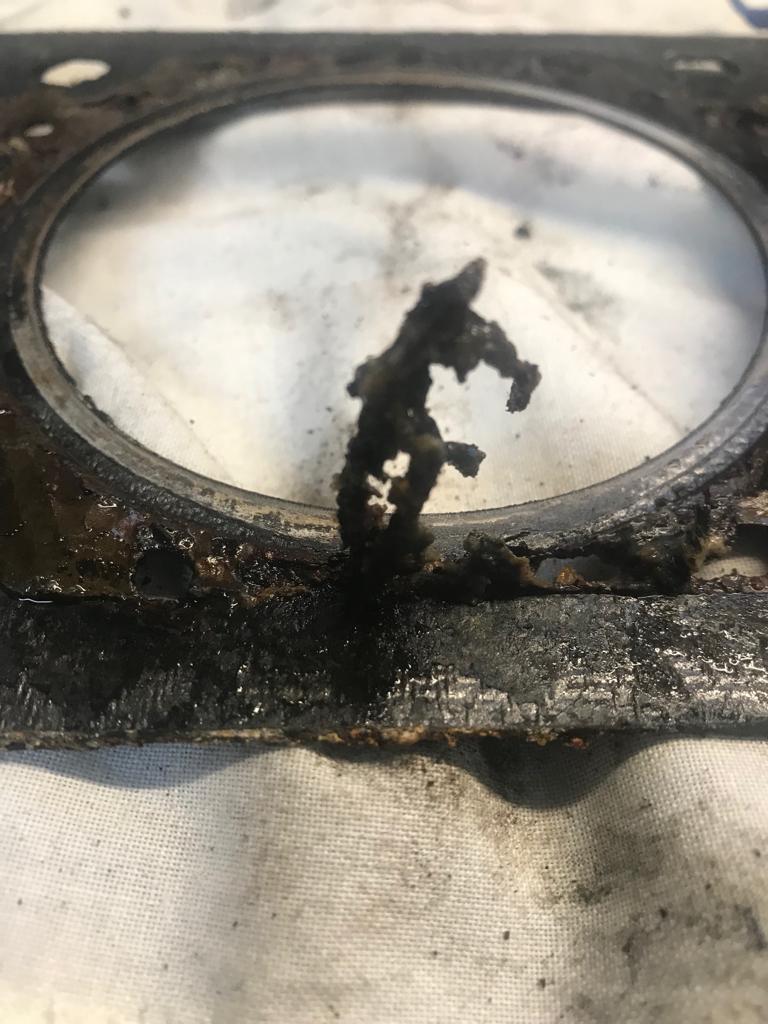

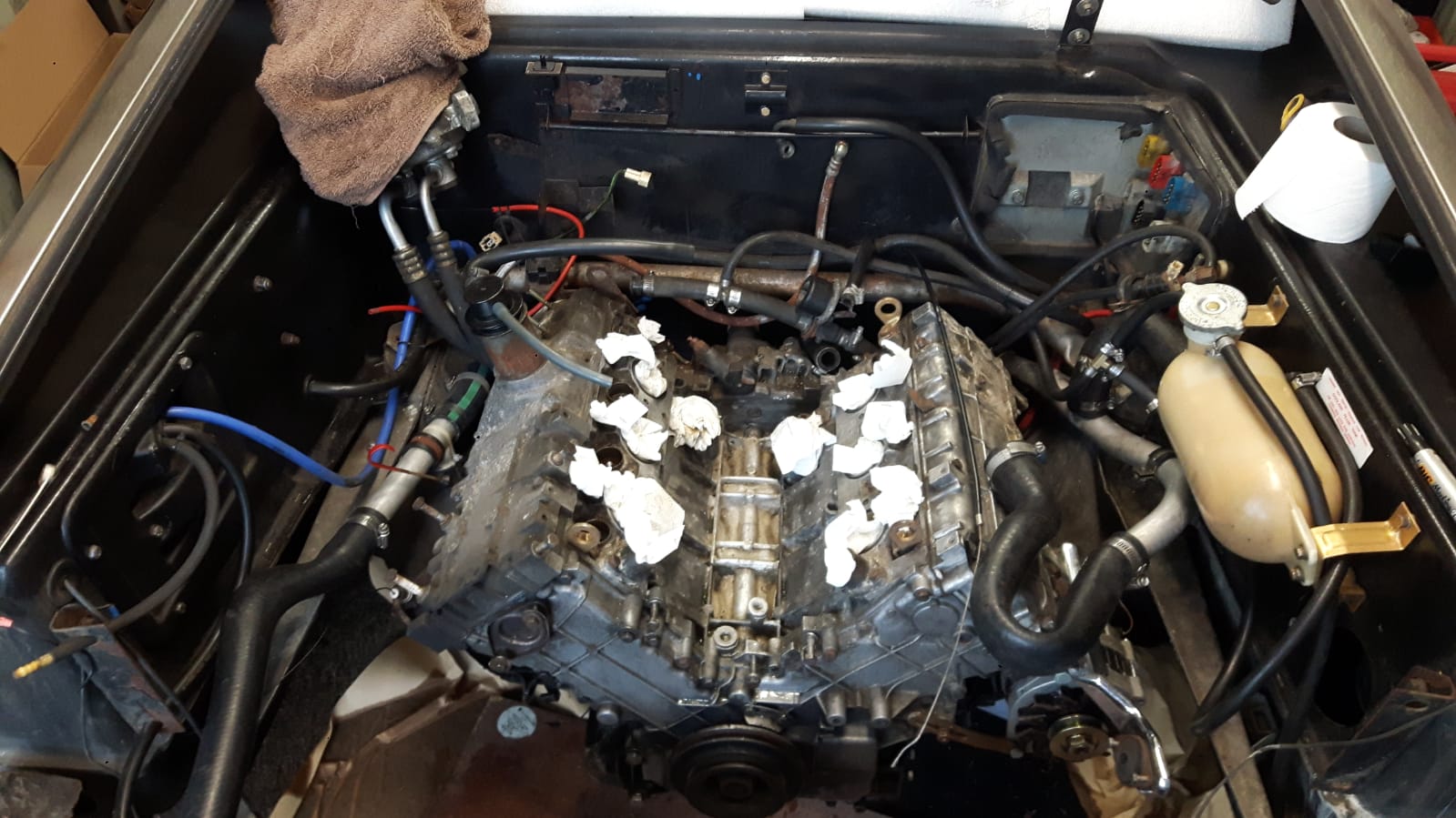

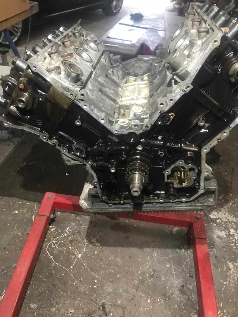

Postby cis6409 » Sat Nov 24, 2018 11:13 pm

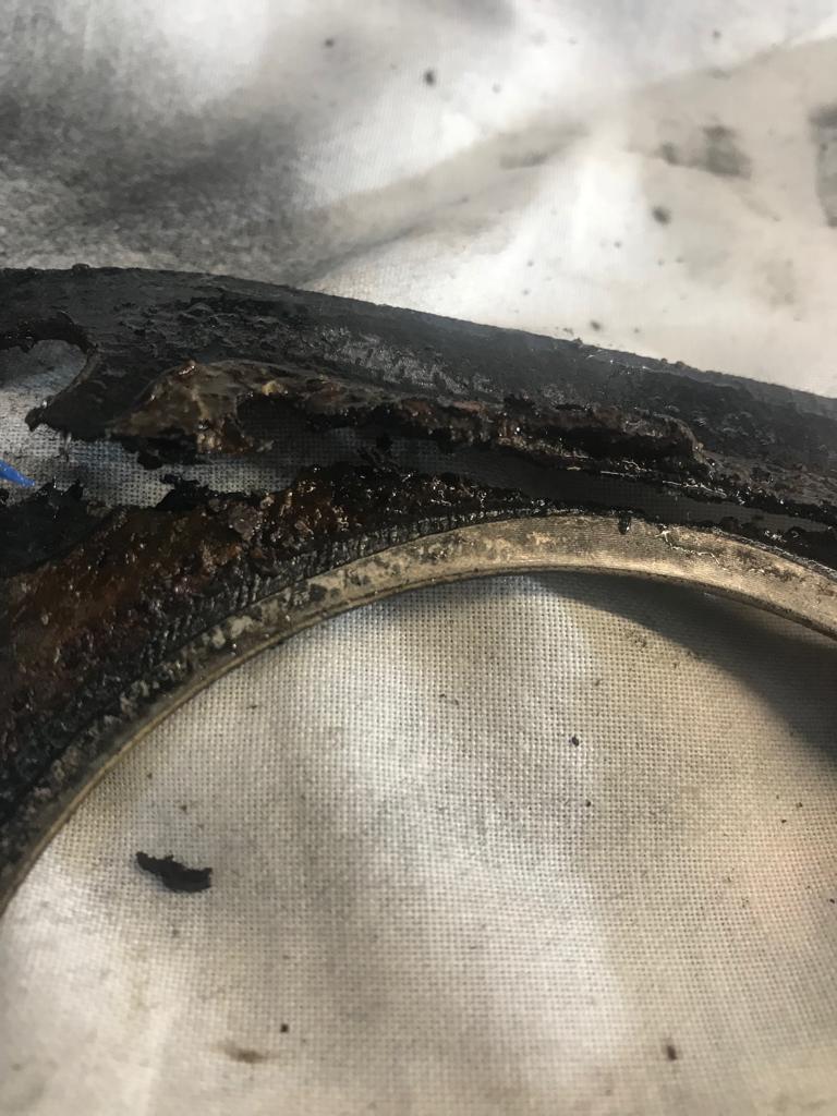

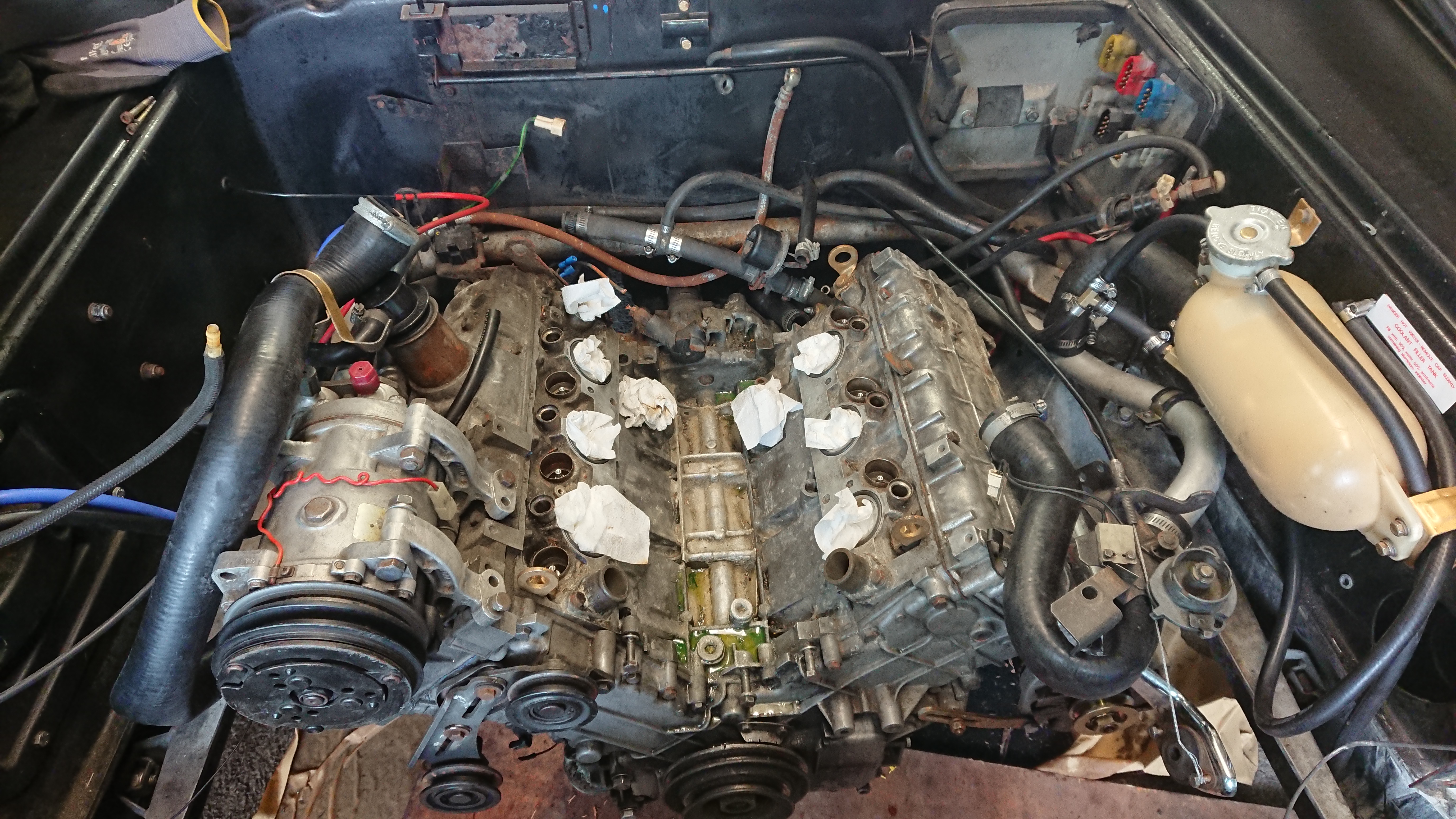

Some more progress.. Confirmed head gasket gone on cylinder 1. My thinking was confirmed the gasket being 37 years old or so had erroded away and given up /broken away enough to allow the coolant to seep into the combustion chamber and allow the combustion chamber gasses to go into the cooling system, not a big leak which is why I think it was so confusing as whether it was gone 100% or not..
learned alot more about the symptoms and methods of testing to confirm a head gasket which is a positive at least!
Posts: 747

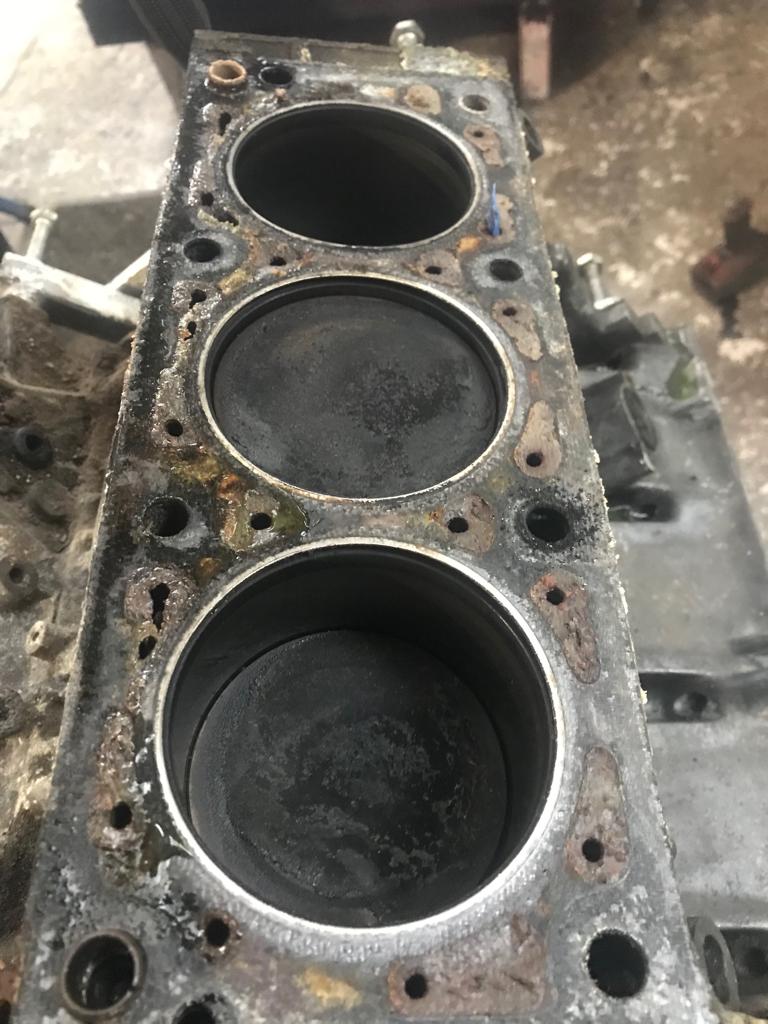

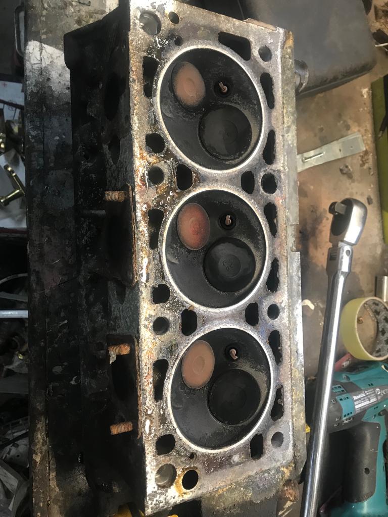

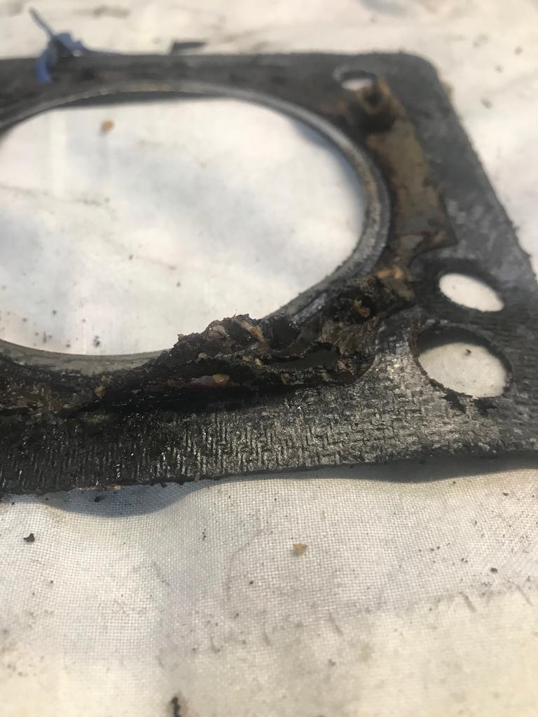

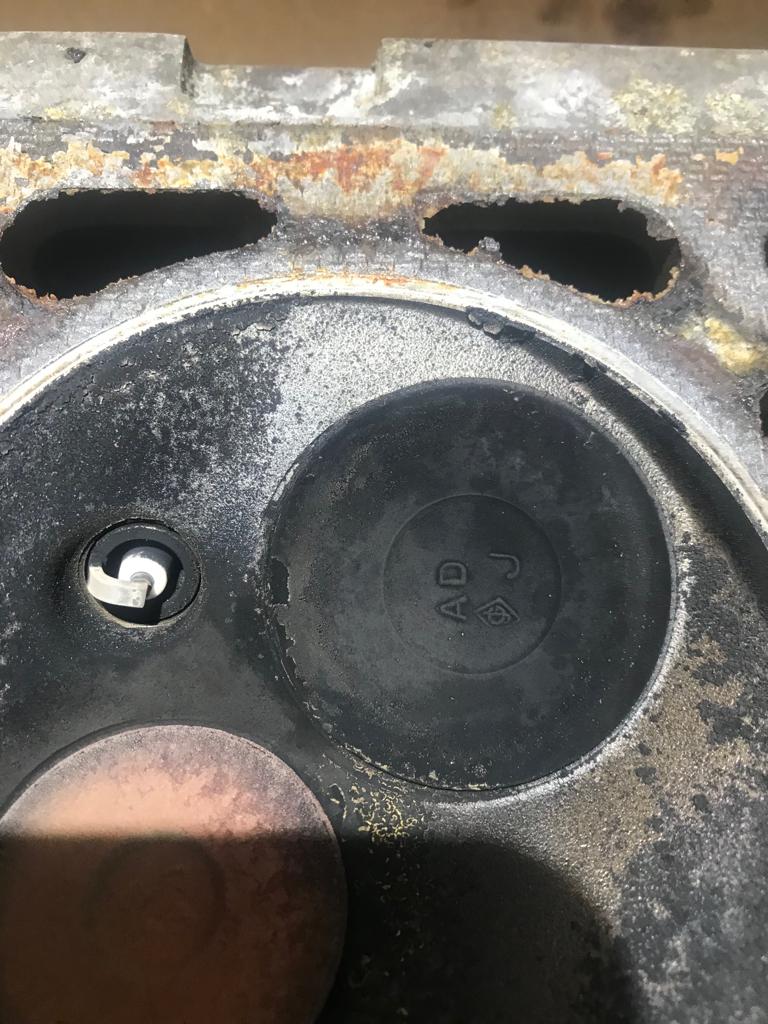

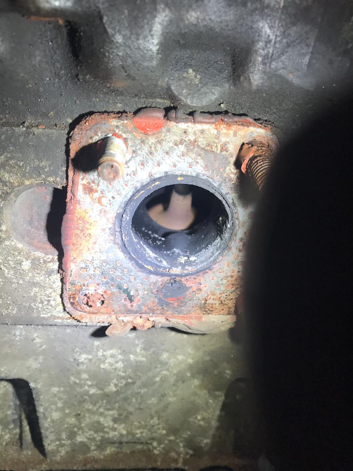

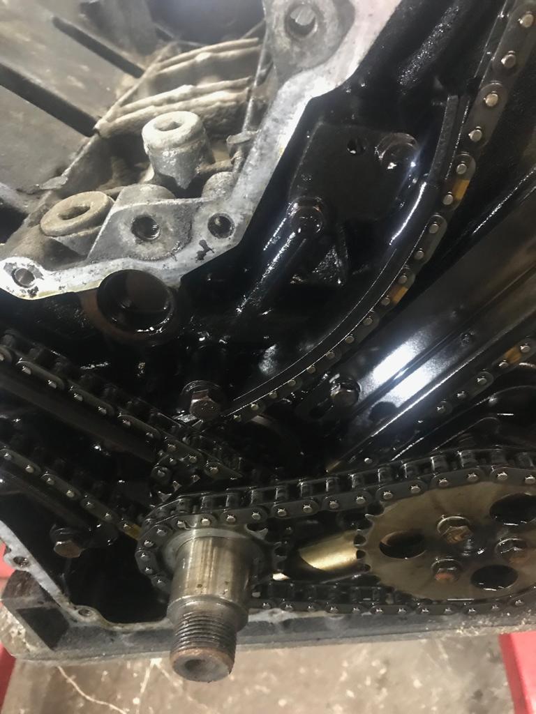

Postby cis6409 » Sat Nov 24, 2018 11:20 pm
Pics
You can see where the coolant has "cleaned" the valve and surrounding area all the rest of the 5 ports where like the 2nd pic

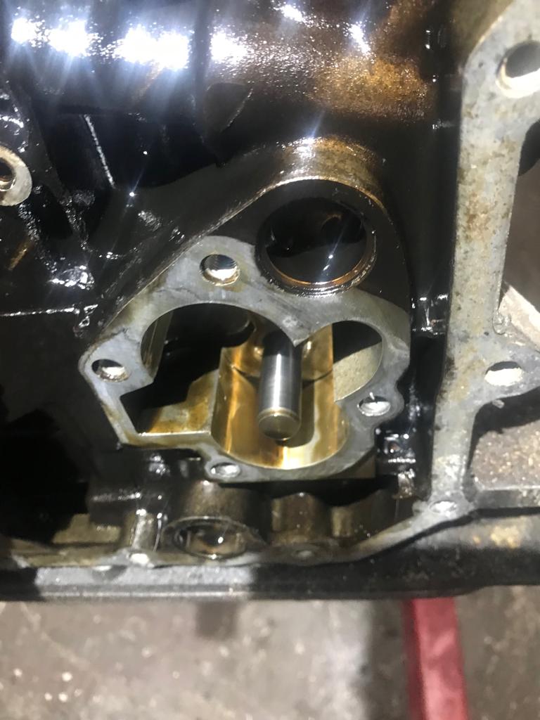

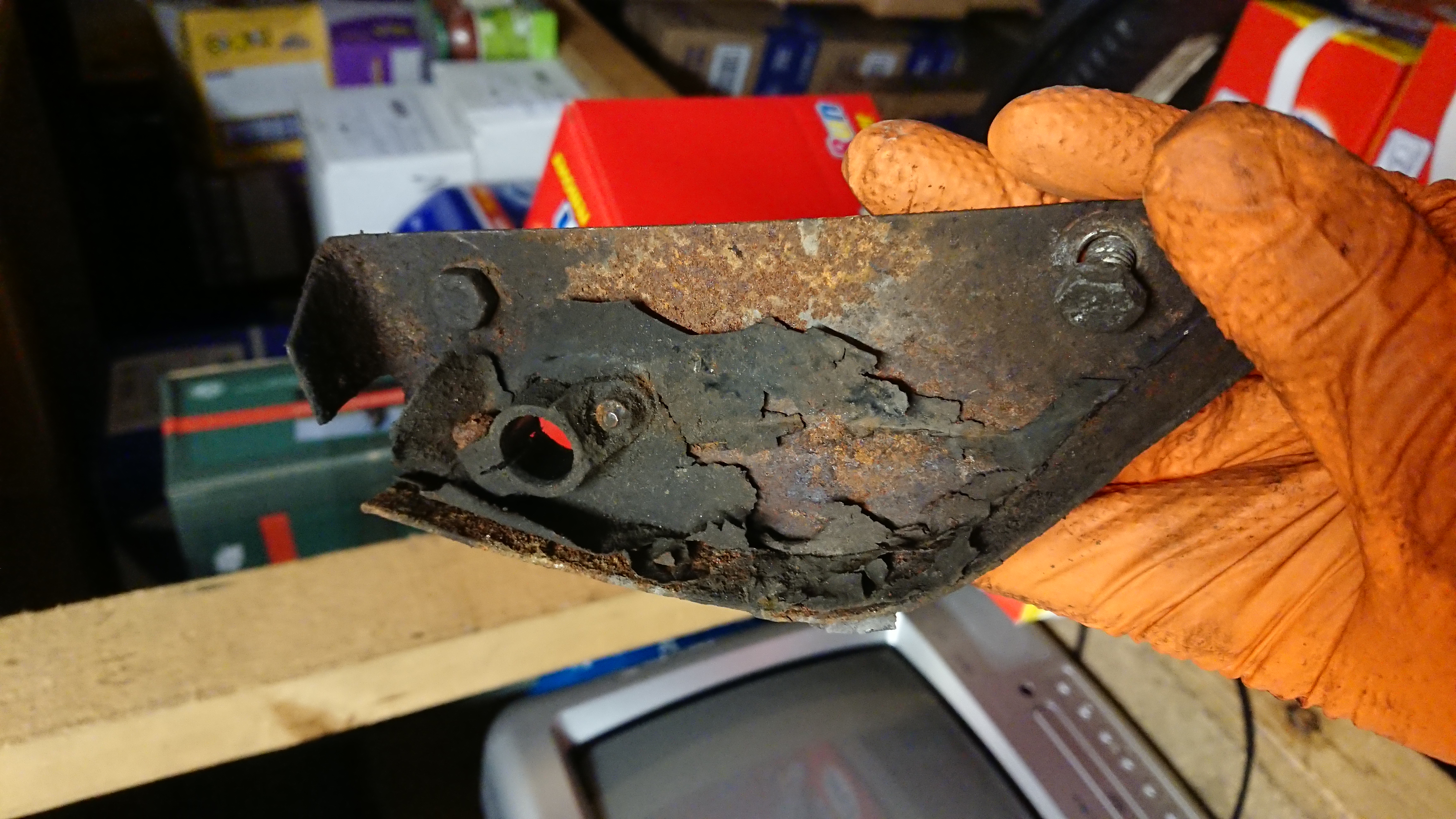

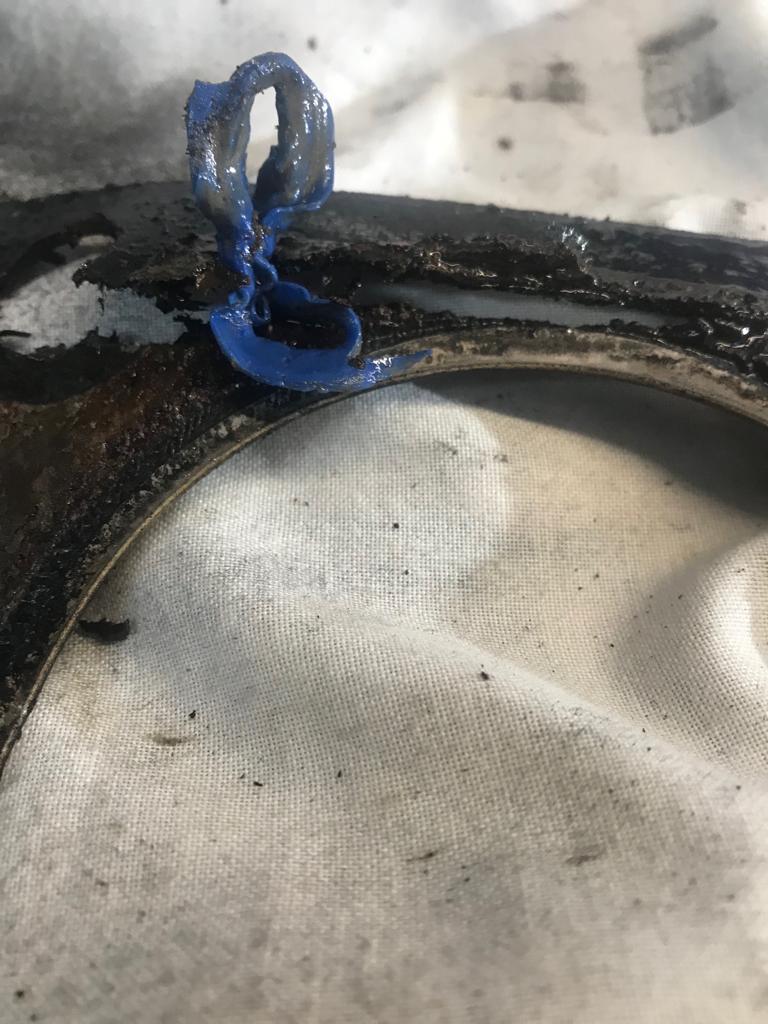

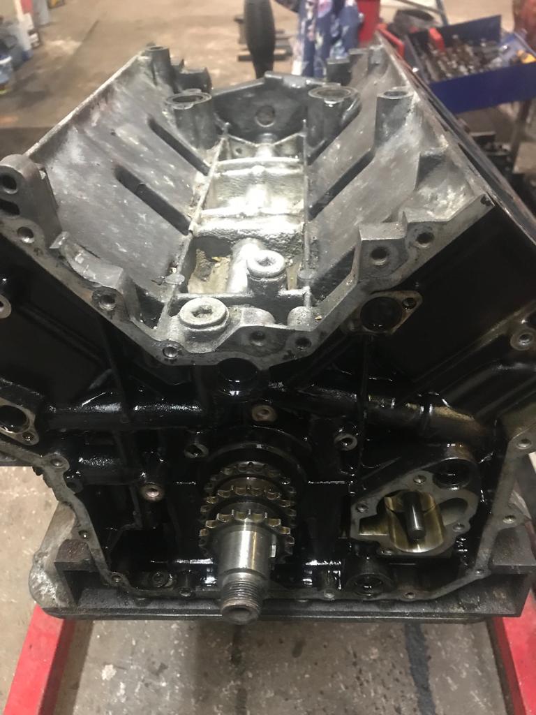

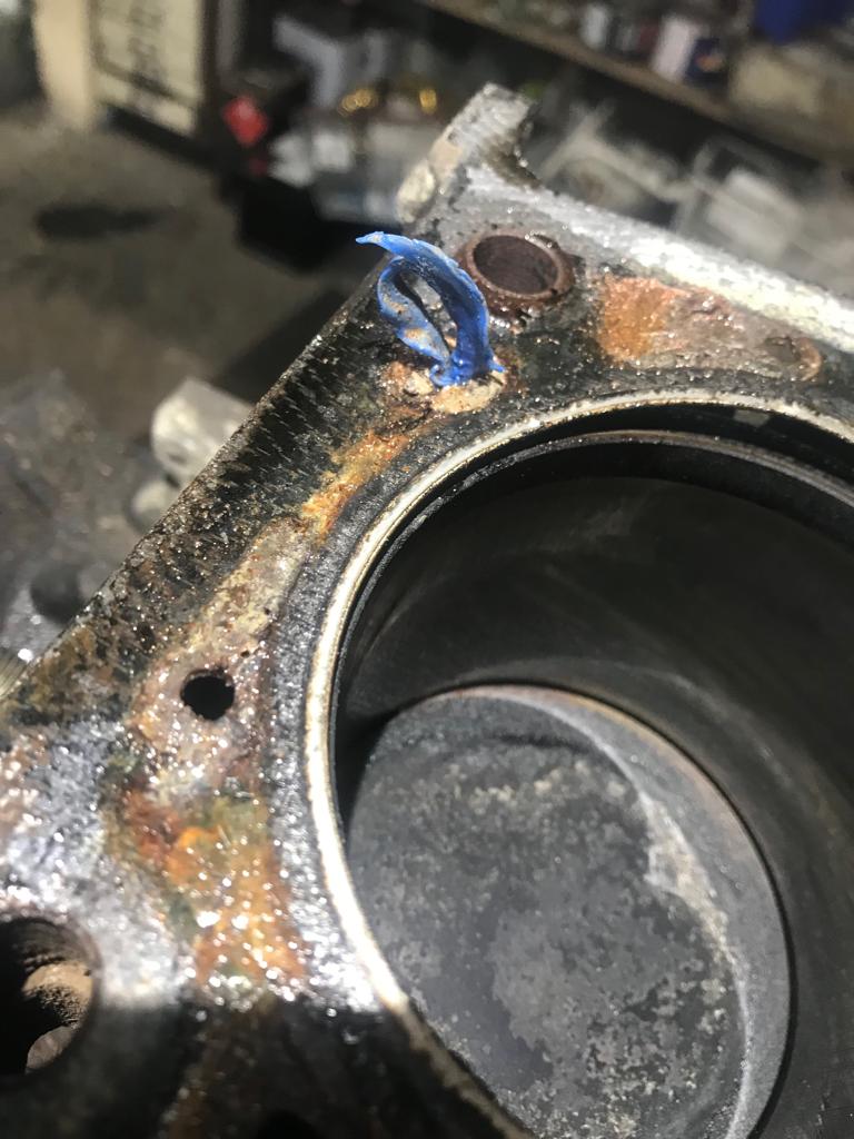

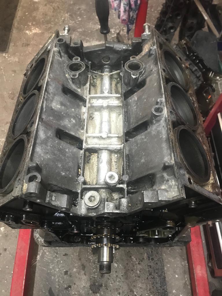

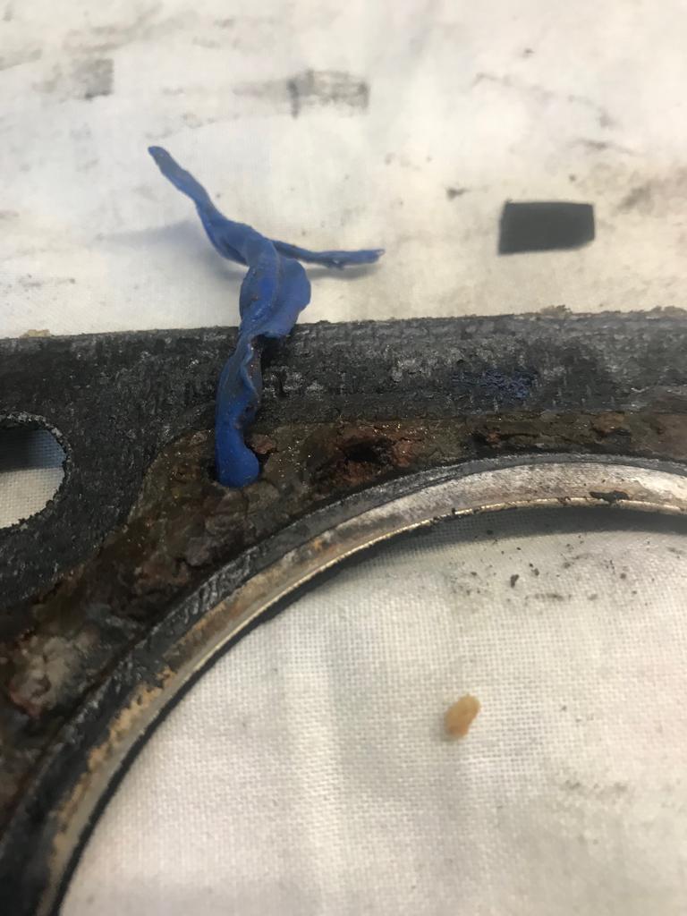

Postby cis6409 » Sat Nov 24, 2018 11:32 pm
Block tare down
Blue rtv that got in to the system and clogged an area, not 100% sure how that got in, but shows the danger of it if not used correctly!

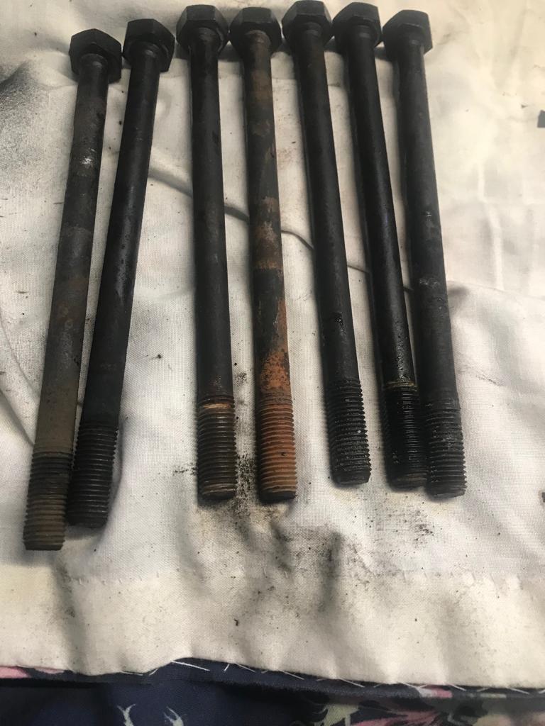

Postby cis6409 » Sat Nov 24, 2018 11:44 pm
Good points :
all head bolts came out, thankfully none broke in the block.
piston and liners all seem good to..
Bad points:
Crank pulley seized would not come off and play ball tried everything short of dynamite! so unfortunately had to be cut off, o well
In summary the head gasket looks to be original never been changed before, the head once free from all bolts still had to be coerced (nicely) off due to being together for so long.. The coolant passages around head and liners badly clogged so the system was under alot of stress as it was
Next is to get bottom end stripped and heads stripped to see if there s any warpage on the head surface or crank journals and then see how bad the block rot is and go from there.
Also have to somehow get the mutated seized engine mount studs out of the block!
Onwards and upwards as they say!
