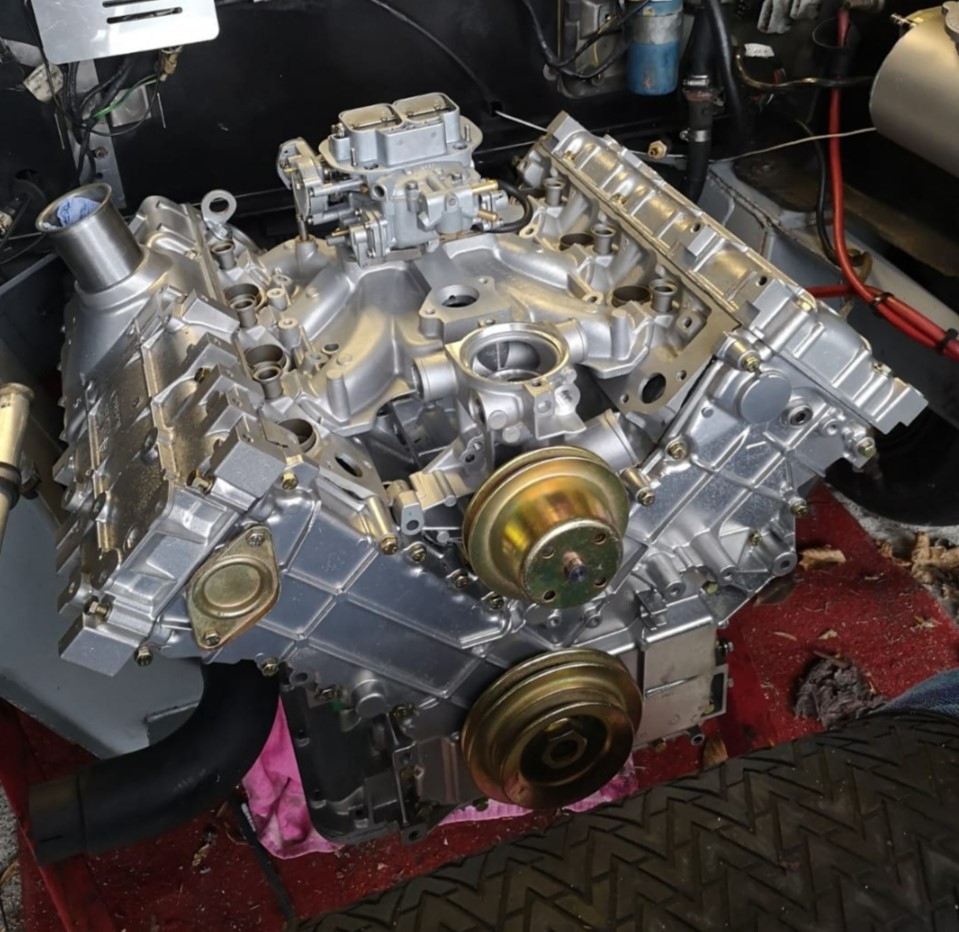

dmc4087 wrote:I ended up getting a block from Martin G, its out of a 1985 Renault Atmo. Z6W engine code. It has a different oil pump and uses a slightly different oil filter but that didn't bother me too much.
Bit manky, but solid. The delivery company dropped the parcel for good measure, breaking off a waterpump mounting attachment. 180 pounds later, that was welded back on with the face machined down...
Then had that blasted
have your engine parts been masked before vapour blasting? like oil galleries, bearing surfaces..
BABIS
Posts: 128
Re: Vin #4087 Engine rebuild
Postby dmc4087 » Tue Jan 28, 2020 4:19 pm
Vapour blasting is non-aggressive to the metal so the likes of bearing surfaces were not covered. It does leave behind a mess though. Every plug was removed from the block before being thoroughly washed several times.

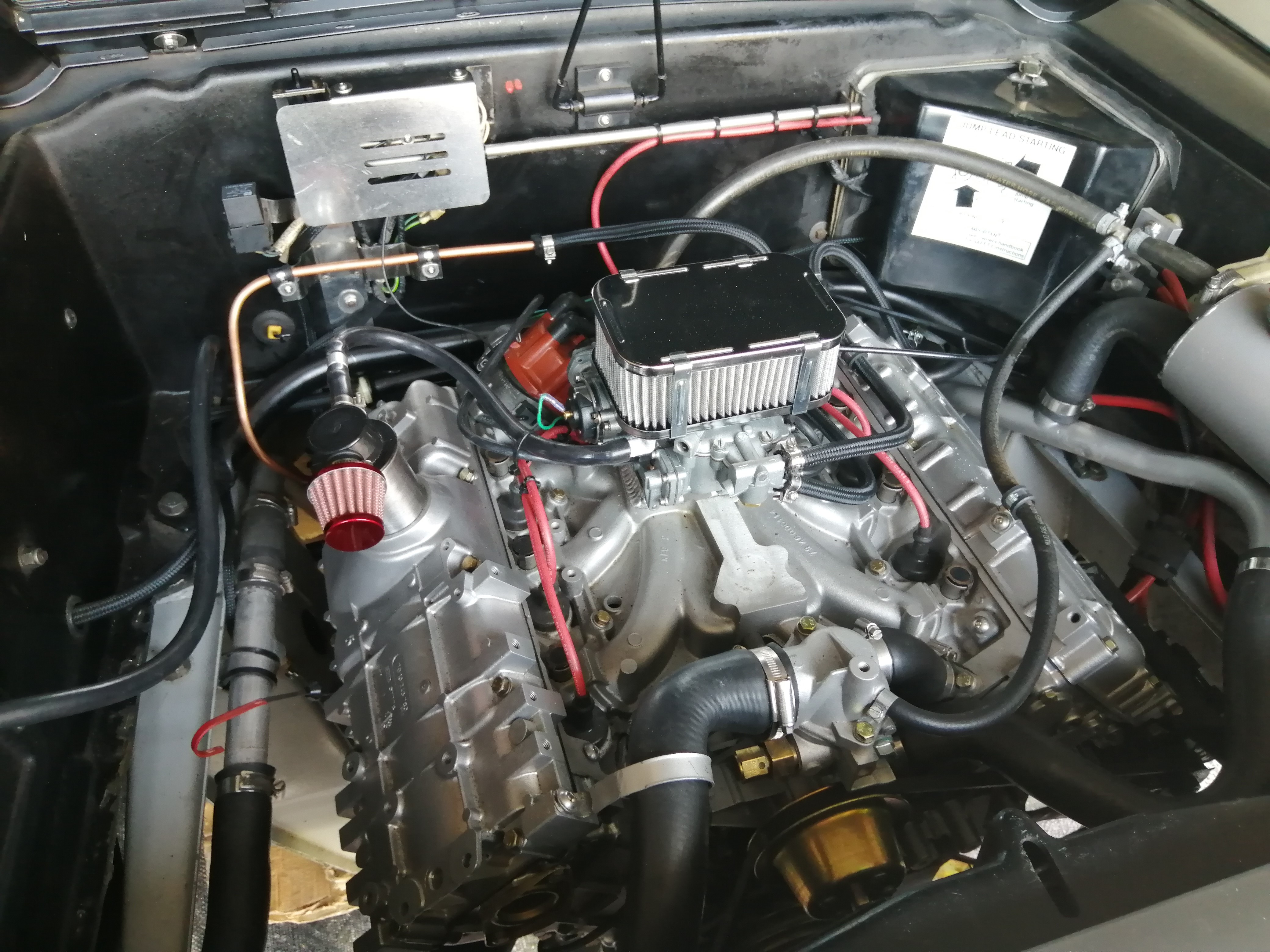

Just a wee update to this - engine has been refitted and I'm putting a few miles on it every so often to see what's going to break. Thankfully no fires yet but there have been a few headaches along the way - big one was the head gaskets - the cheap set on dgo leaked immediately, so pulled the heads off and fitted the quality ones they sell (the difference between the two is staggering)
Oh, also decided to try a Weber 38 after finding a carb manifold. Engine pulls very well and it makes a lovely induction noise. I now use a manual fuel pump bolted to the passenger cylinder head, and the engine wiring loom has been reduced drastically.
Drive seals are proving to be a pain to seal up on the gearbox, so have to look at that again but so far very happy with it - will keep putting on the miles. For the first time in nearly 20 years of dmc ownership, I don't have to top up the coolant every 3 minutes
