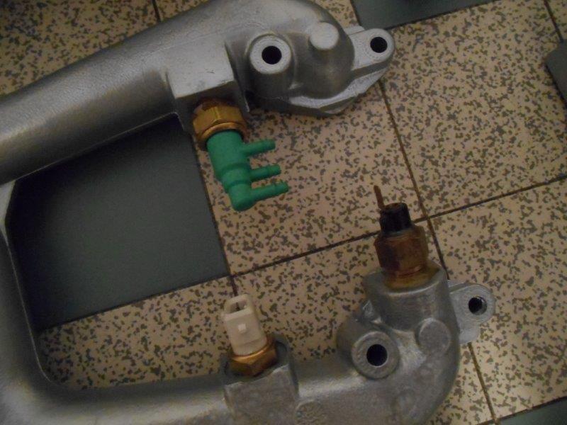

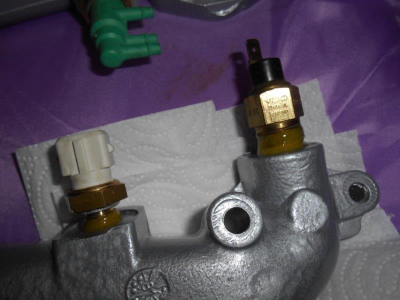

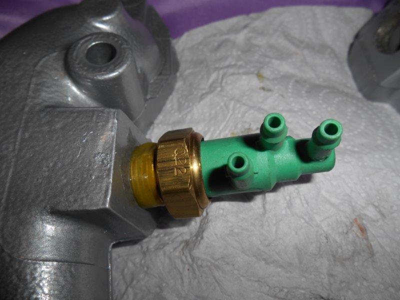

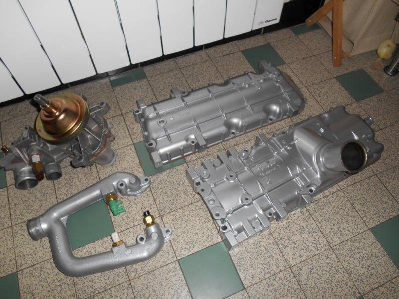

Looks like there is a water pump bleeder included in this kit?
Are the small bore hoses for that??
Good luck!
Postby Admin-bloke » Sun Nov 08, 2015 10:30 am
You could always ask Josh direct ;)
It looks like the "self bleeder" kit is included within this. Look at the brass made "T" piece and brass made "screw in barb" for the water pump at the top of the picture.
Enjoy :)
Btw, nice engine Pics, thanks for sharing ;)

Postby Domi » Sat Nov 14, 2015 6:19 pm

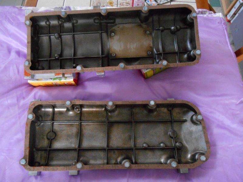

Not a lot of job today.

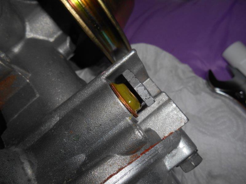

Put the valve cover gasket on both side
And adjust the sensor with Loctite 577 to avoid any leak in the future

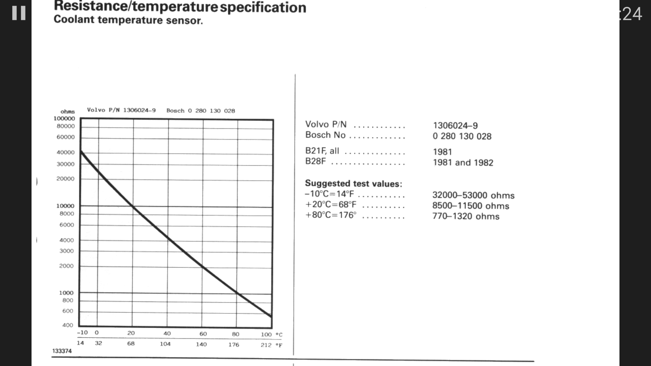

While your engine is apart, check that the thermister (engine idle ecu temperature sensor) is the correct type and varies with resistance.
There are two types that look the same but have different part numbers. The attached graph is the correct type and part number:
Correct Thermister temperature characteristics :)

Postby Admin-bloke » Sat Nov 14, 2015 6:51 pm
I advise you to check.
Just because it's a new from a supplier, doesn't mean that it's:
1) correct part number
2) it works within specification/ work's at all
