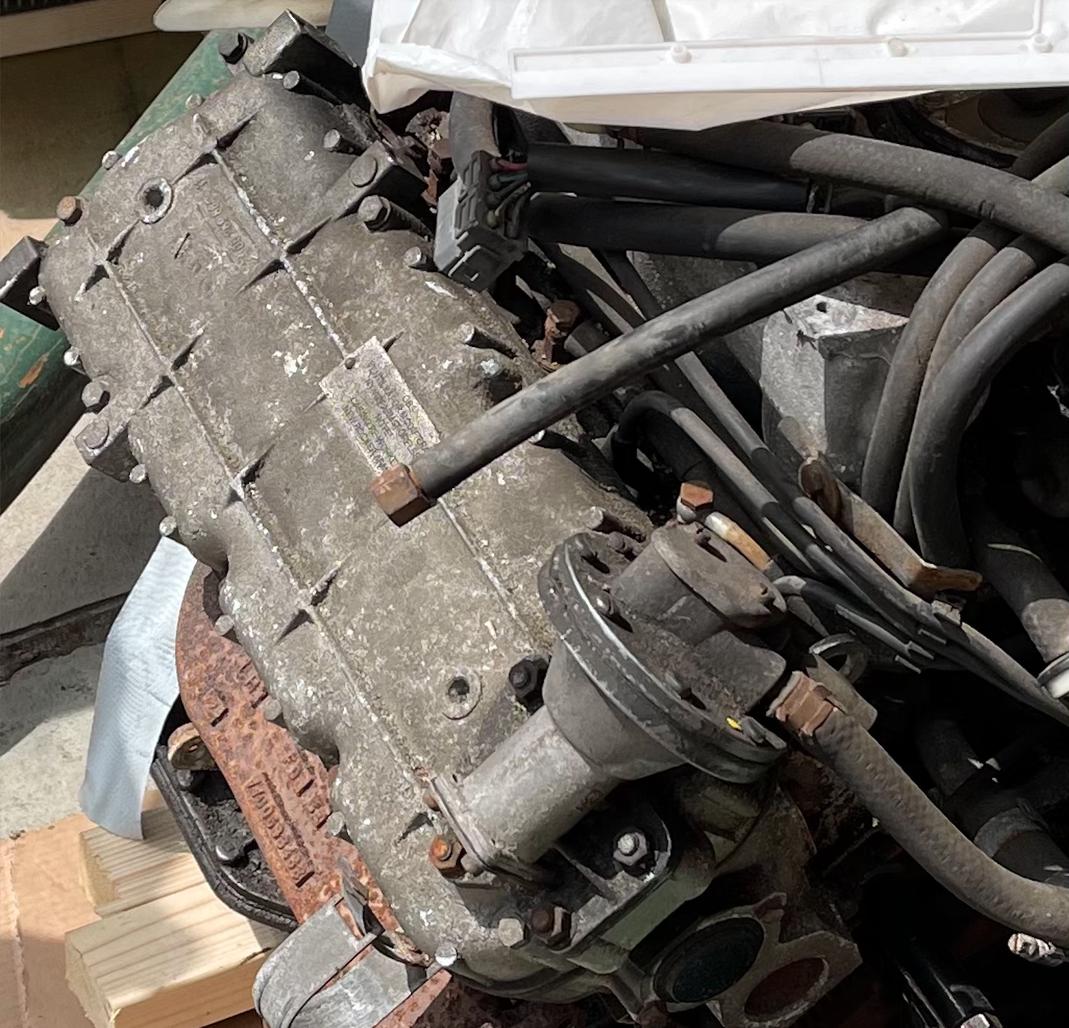

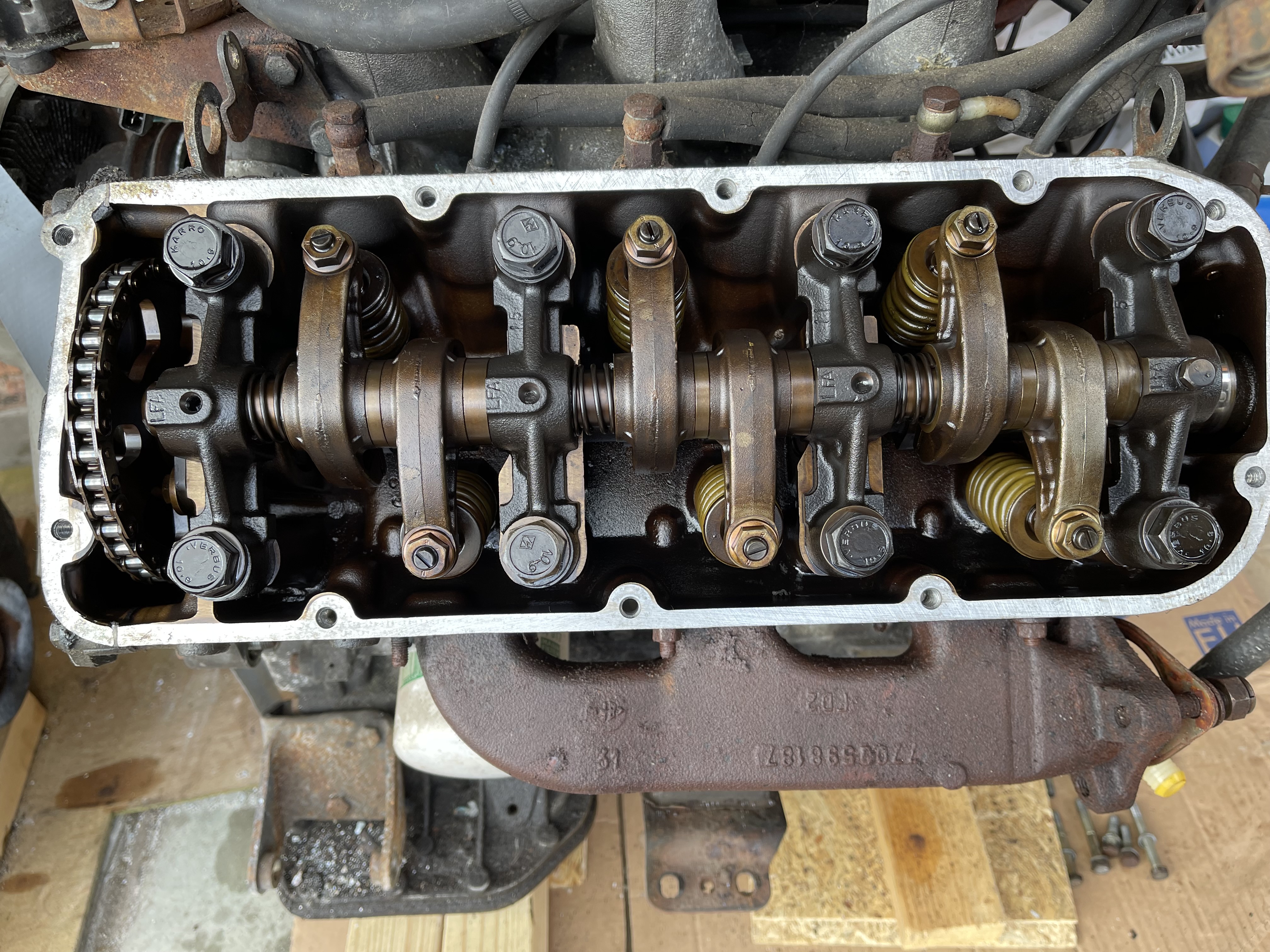

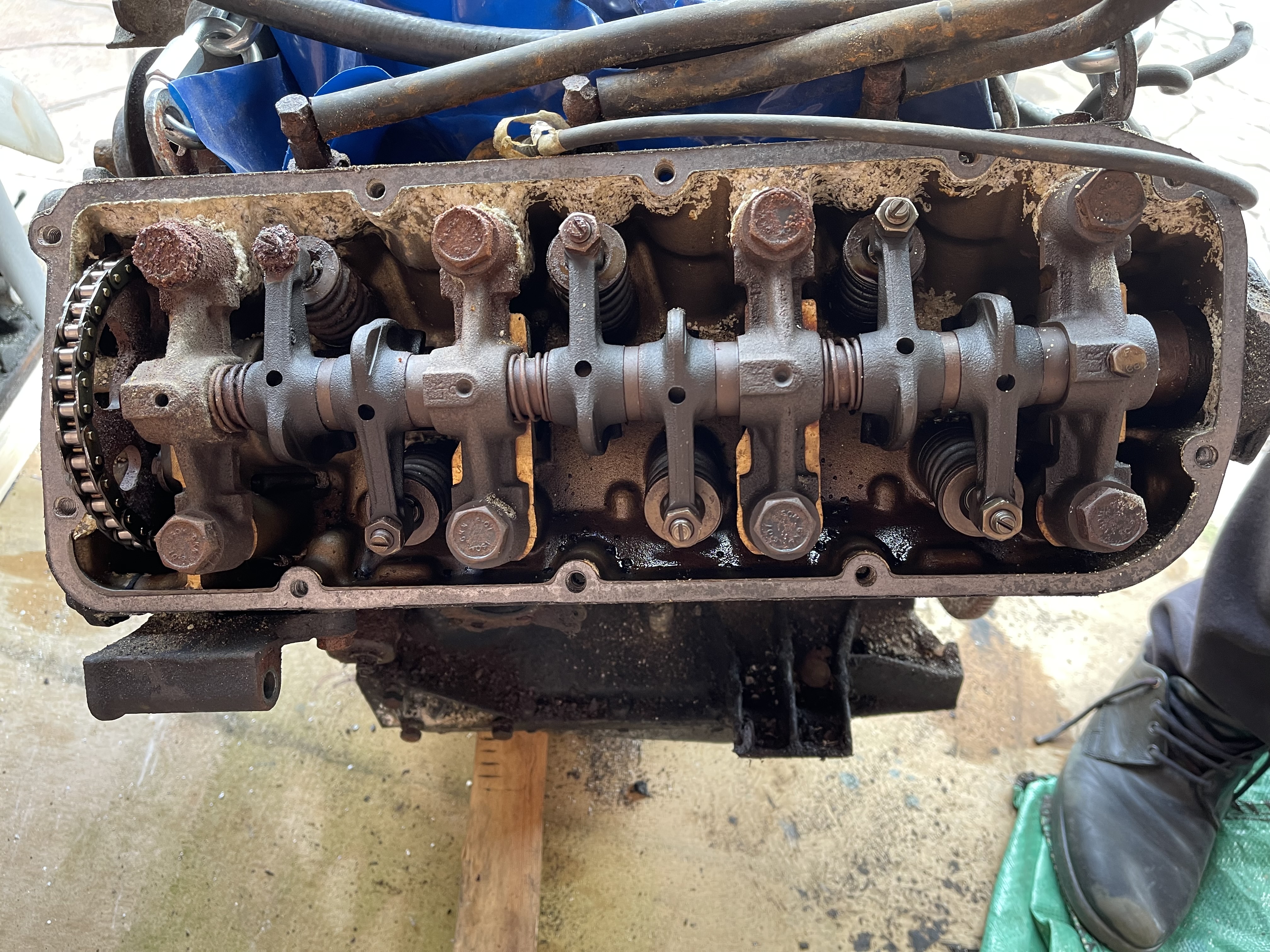

I pulled the rocker cover to swap them over to remove the Volvo pump. Interesting pictures below showing the internals of Delorean v the Volvo Rockers and Springs.
My issue is that the Delorean cover is not as deep and is fouling on the Rockers on the Volvo engine. I am sure i have heard of this some before.
I am thinking of making a cover plate for the removal of the pump instead of grinding it out and risking a foul. Anyone else had this issue?

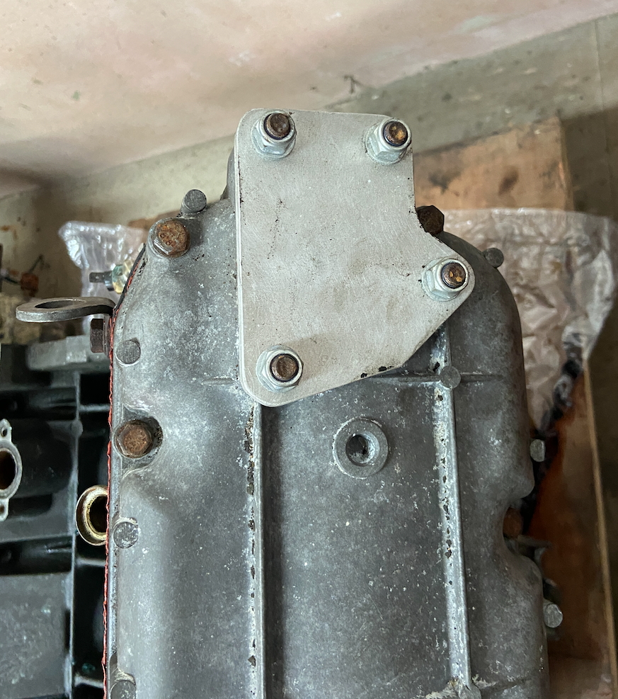

Thats a strange one. I have worked on quite a few Volvo versions of this engine and never seen one with those chunky rockers. What year is the car that came out of?
I have also ran one with a blanking plate over where the pump mounts as well. Just an ally plate cut to size and sealed on with high temp silicon.
Re: VIN #2307 Arriving soon from BHCC
Postby Darrenre » Mon Jul 05, 2021 2:30 pm
"Thats a strange one. I have worked on quite a few Volvo versions of this engine and never seen one with those chunky rockers. What year is the car that came out of?"
The Engine is from a 1987 Volvo 760. I will do the same with a blanking plate.

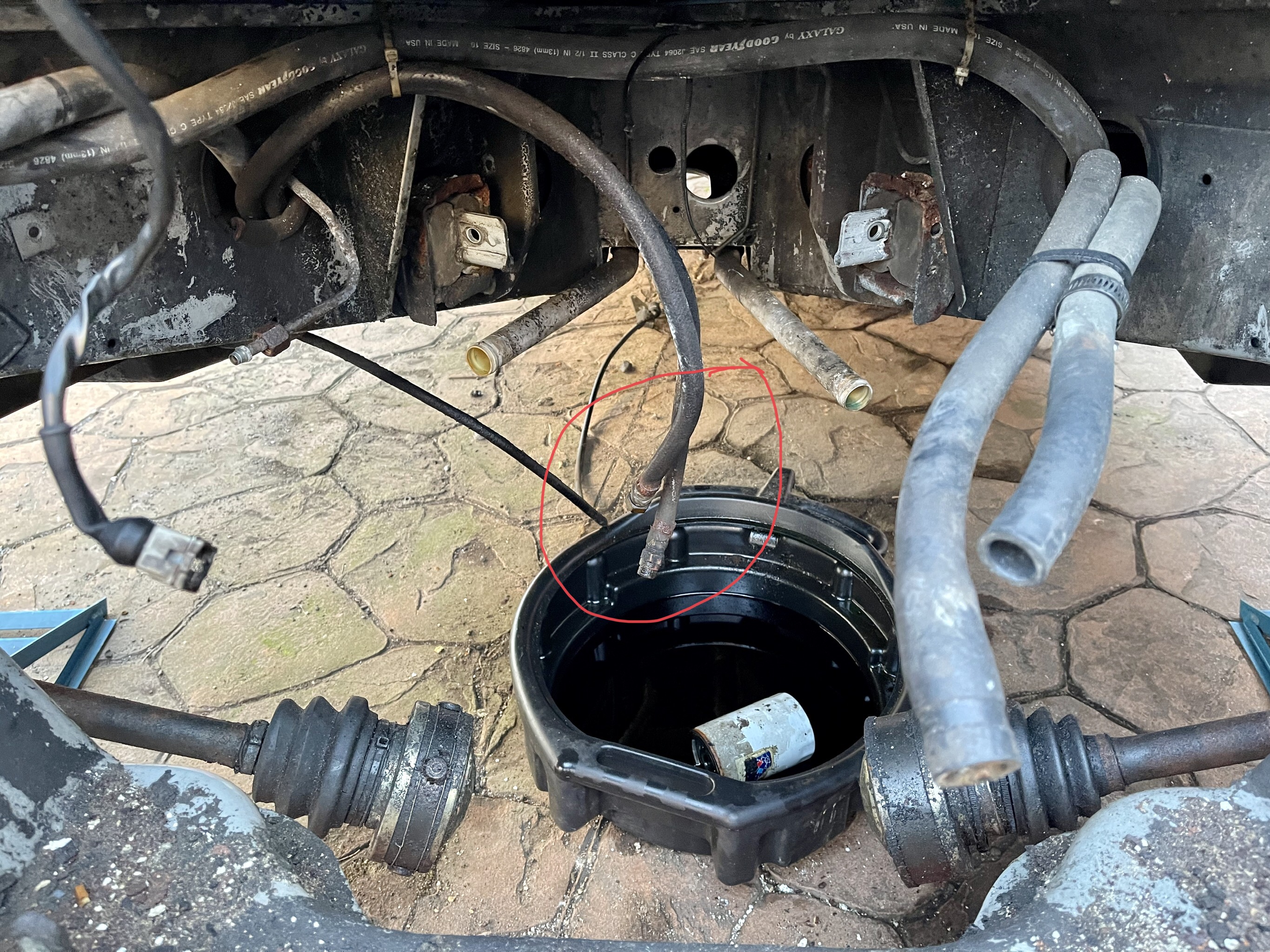

Am I going mad or do I have two extra hoses above where the auto gearbox sits in the car. I have not had chance to see where they go but they could have been in series with the normal trans cooler which I already removed with its hoses. Car was sold in LA originally?
I circled them in red on the picky below. Any thoughts? (The dark oil in the drain bowl is not related)
Extra hoses
Darrenre
Posts: 193
Postby eric » Mon Jul 19, 2021 9:40 am
You have indeed, I just went out to have a look at mine as I can see that area clearly and on the left of your picture the round hole through the chassis I only have the larger hose which is squirreling off to the left... The two coming down to your oil pan (nice posh one that btw), aren't there.
What did it connect to ?
Your left trans axle looks like Frankenstein's monster what's with the bolts/caps on the side ?
