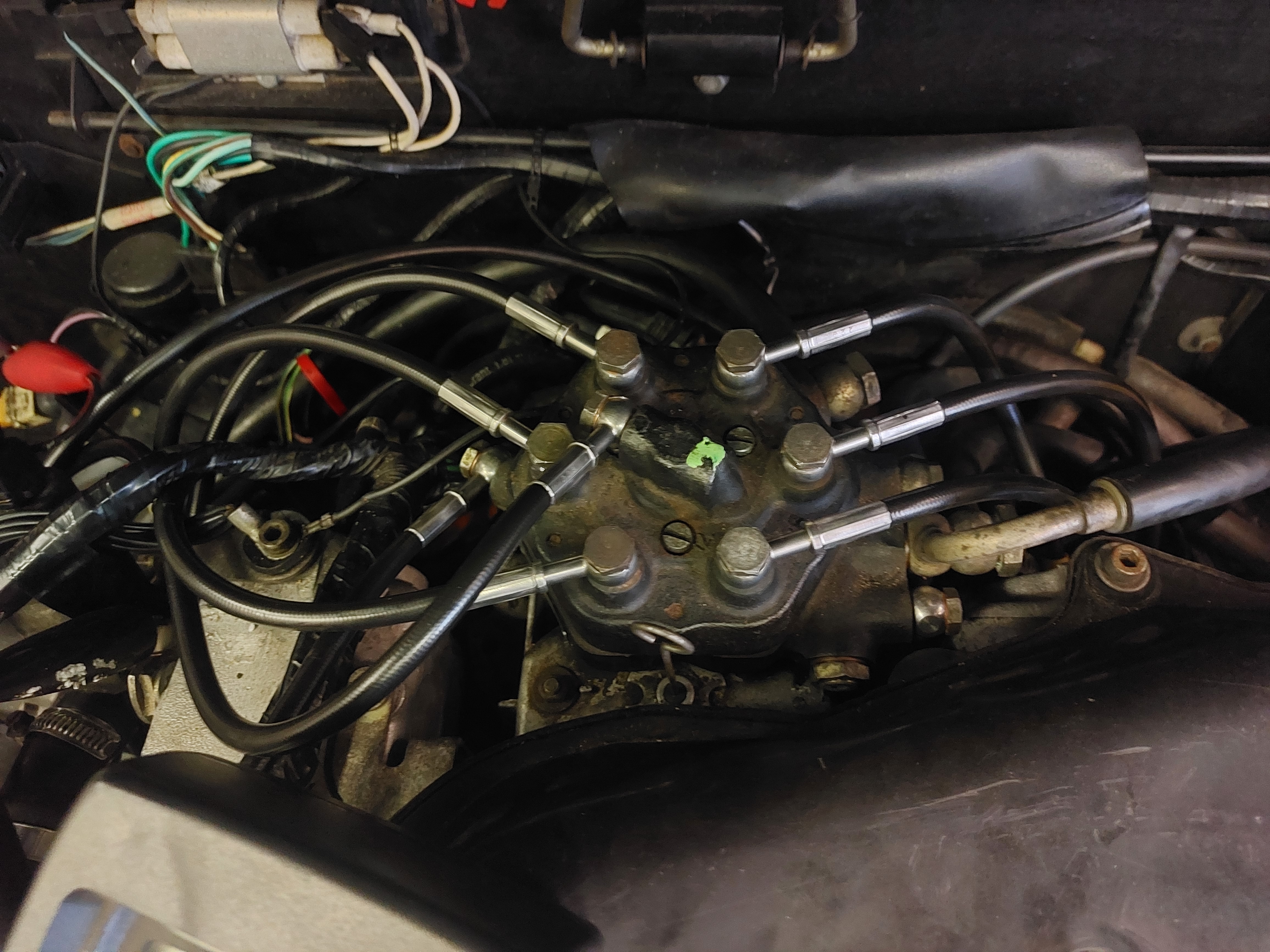

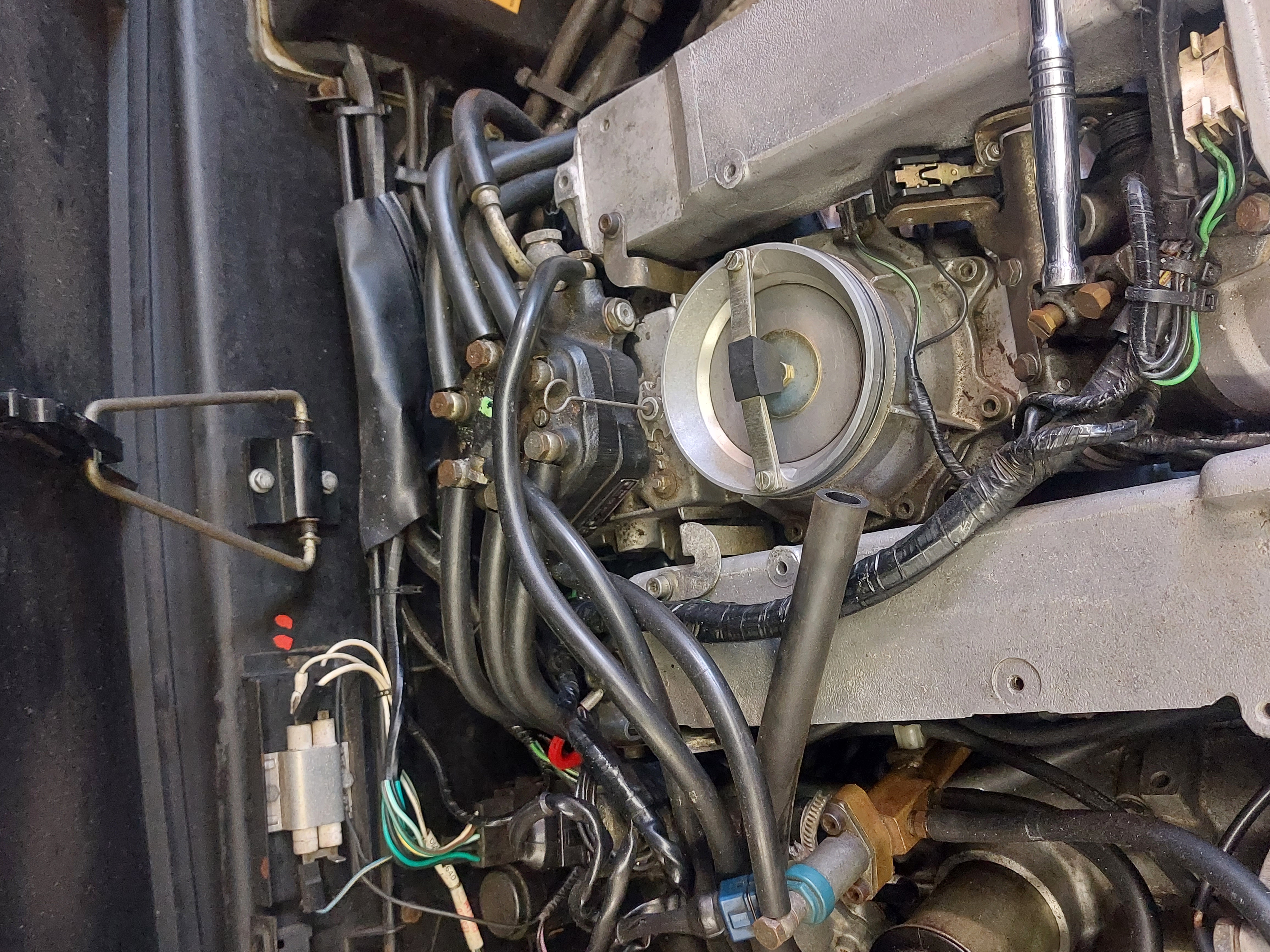

While the injectors were out, I have finally fitted the top quality fuel lines from DGo, the ones to the injectors and the control pressure regulator:
After, DGo fuel lines
Before, OEM
