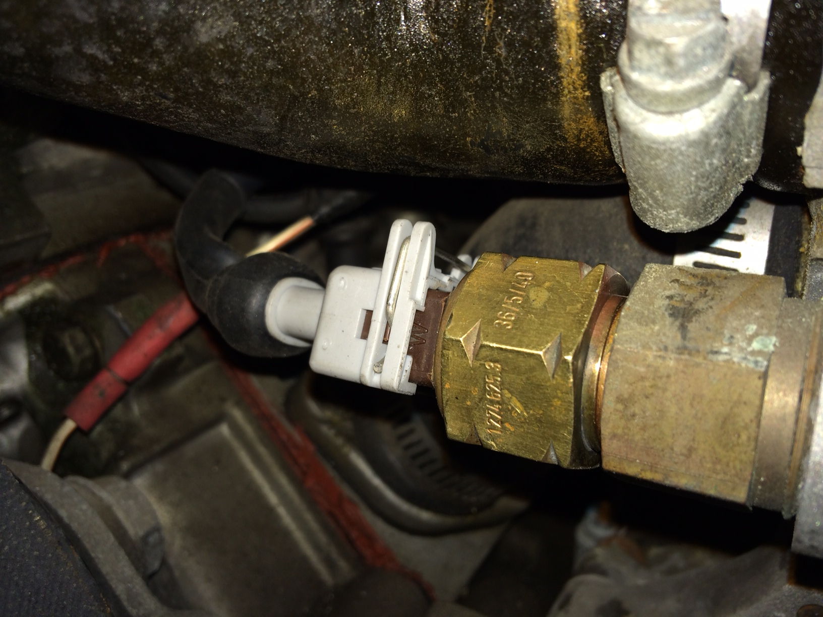

Today I fitted a new thermotime switch to fix the cold start problem. The new sensor had a different connector to the original, the same type as the CPR and cold start injector. So I crimped on a new bosch type connector and job done, all working properly now :)

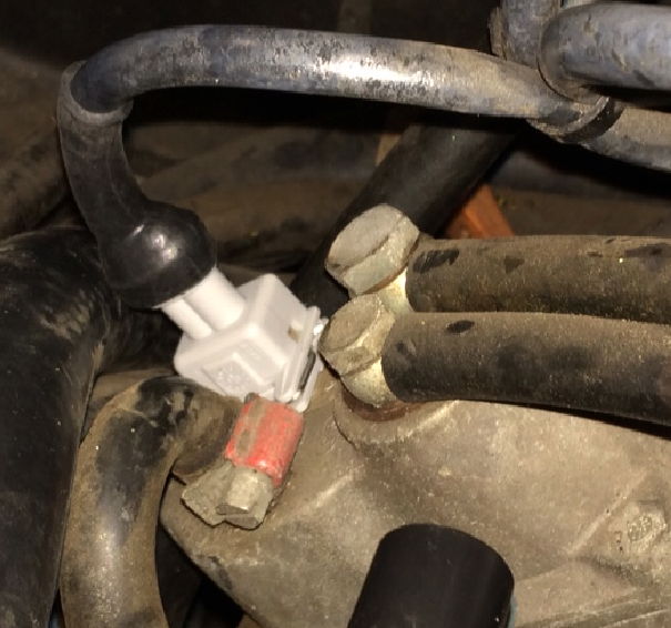

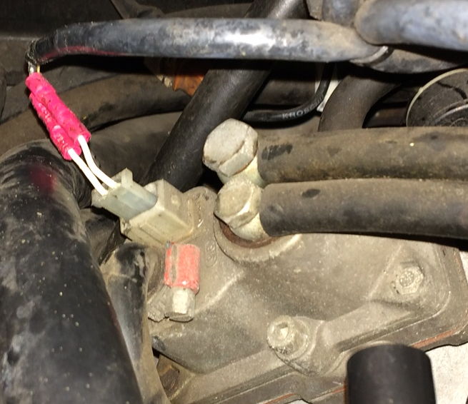

Postby Dan 6511 » Tue Oct 07, 2014 11:03 pm
Not much today, just fixed a bodge on the cpr wiring with a new bosch type connector:
Before:
After:

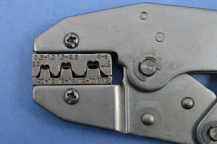

If you want to fit these types of connector properly you need a non insulated crimp tool like this:
