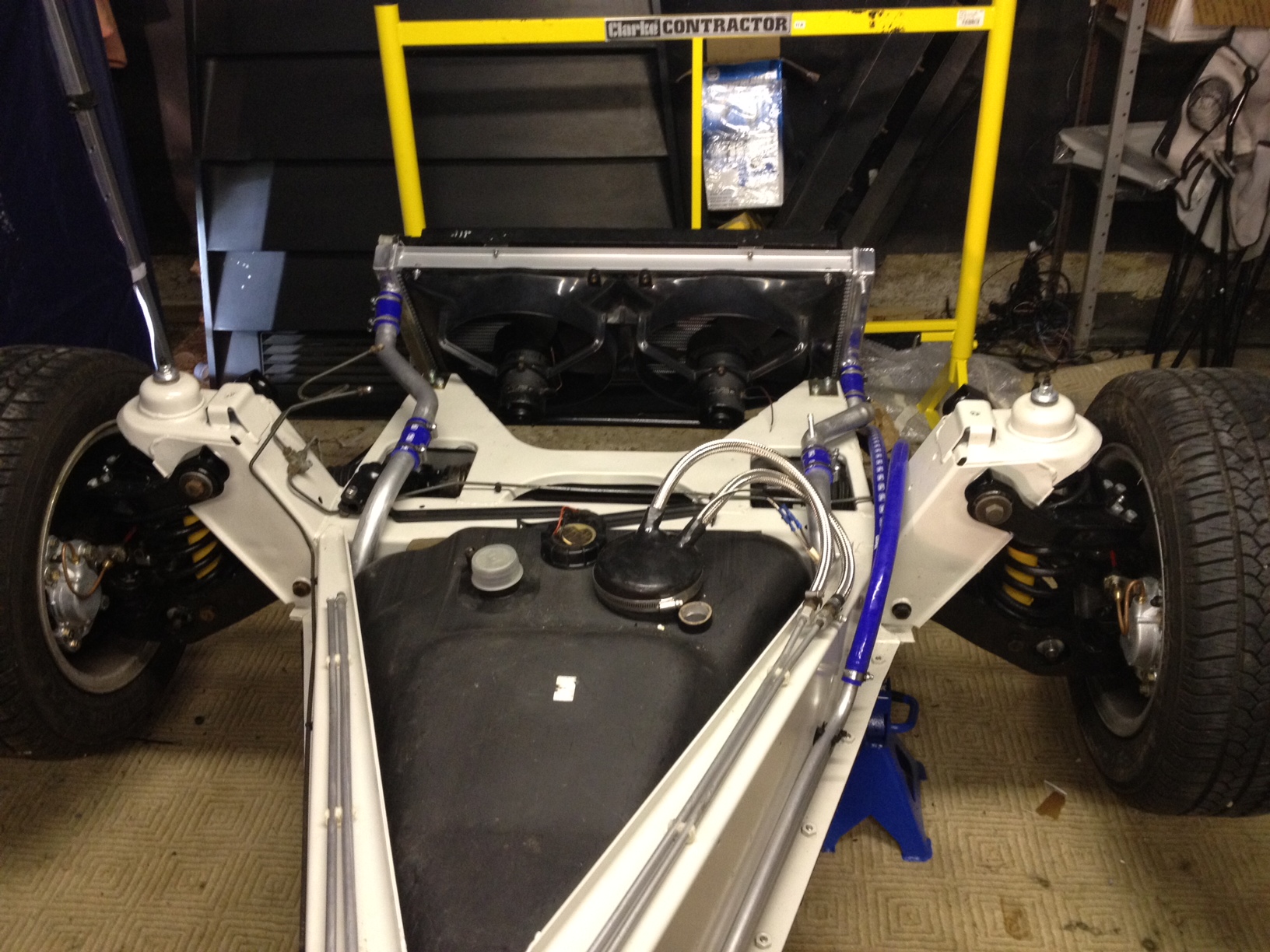

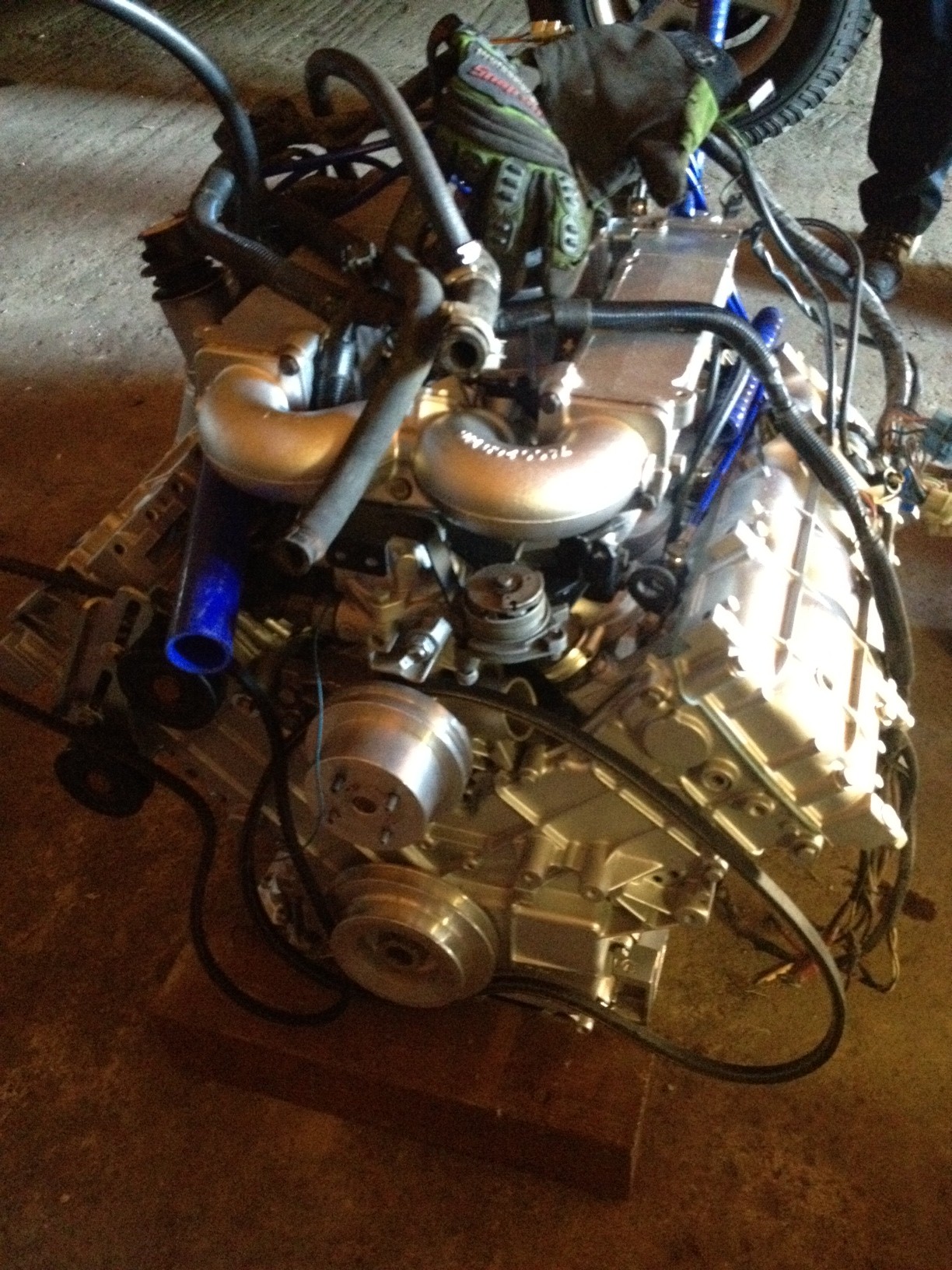

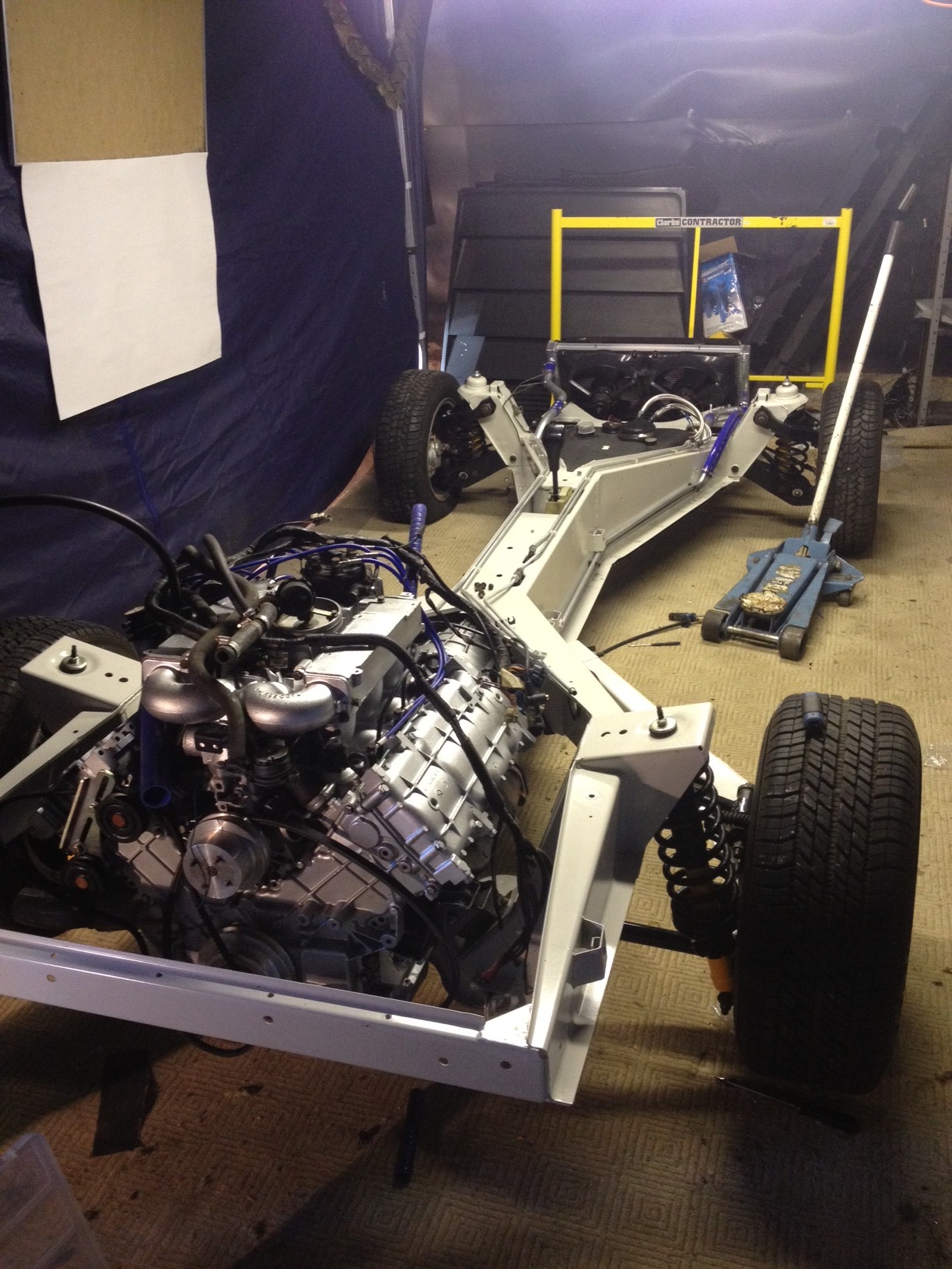

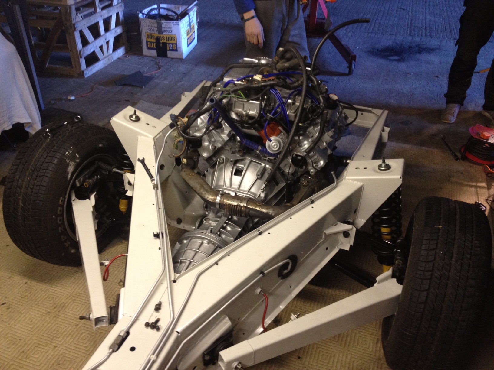

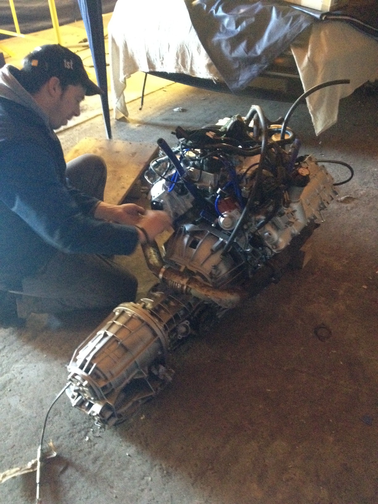

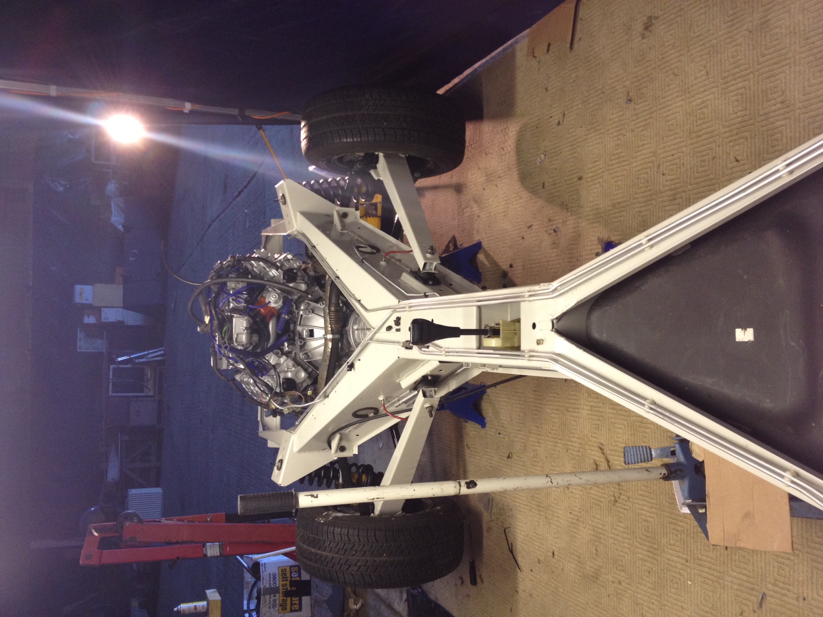

Hi all, My mate Will and I had a really good day working on the car yesterday. Will has done various bits an pieces to the engine and yesterday it finally went in! :D Also put the rear calipers on, hand brake cables, fans, air con condesner. So the car is getting there and I'm really pleased with how it's looking! So here is a few photos.

That looks really good, nice work. :D Don't tighten up your suspension arm bolts until the tub is back on and the car is settled down to the height it wants to sit at, otherwise you pre-load the rubber.
I'm not picking holes, just some advice.... on your fuel lines from the pump you've used jubilee clips. I would remove them and use proper fuel line clamps:
I did the same as you originally when I did my chassis. I even used brand new good quality stainless jubilees and they still leaked fuel! Swapped them for the proper clamps and never had a problem again. There's a hell of a lot of pressure there.
