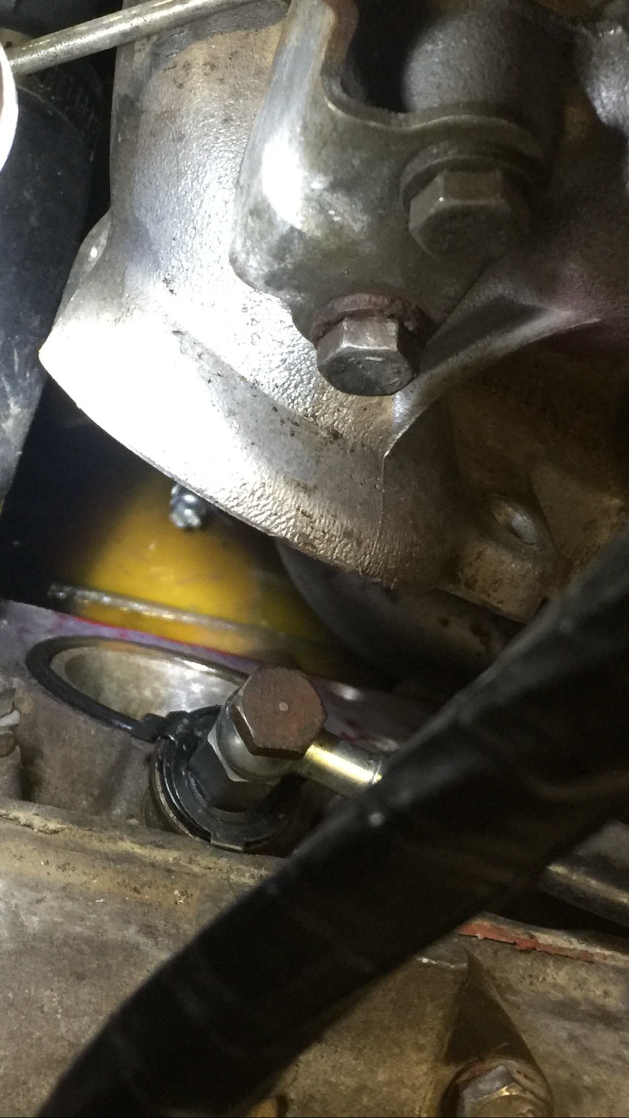

Postby gruffalo » Sat Feb 10, 2018 9:21 pm
I ran the engine a few minutes today. It does not idle but runs somewhat normally at higher rpm’s. I suspect a vacuum leak.
But after a few minutes I got a Bang!, and water pouring out from the engine.
I popped the intake to have a look, and The Valley was full of water.
I fear that the block cracked.

Re: Vin 5063
Postby A Van » Sun Feb 11, 2018 11:19 am
Shit...
Might be a loose connection on one of the o rings there, but unlikely
Usually you would get oil there if the block is porous in the valley
Can you see if any run marks down the sides ?

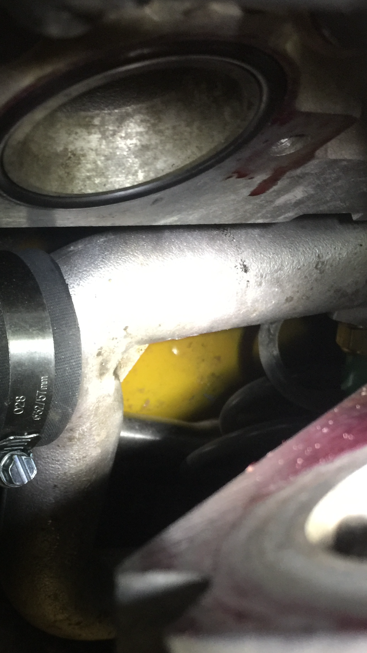

Postby gruffalo » Sun Feb 11, 2018 5:00 pm
I popped the intake today, and pressurized the cooling system using compressed air.
The leak revealed itself. It was the lower part of the Y-pipe that was leaking. It may be that I forgot to tighten the clamp, but upon tightening it started skipping the threads. So basically the hose clamps are crap.
The previous owner got a full hose/clamp kit from John Hervey, and I’ve used them all over the car. If it turns out that they are useless crap, well, I have a lot of work ahead of me. :(

Re: Vin 5063
Postby ROBLAMROCK » Sun Feb 11, 2018 6:47 pm
I replaced my radiator a while back along with silicon hoses. Most of the jubilee clips (hose clamps) that I got from various sources were pretty useless.
Might be considered overkill but the expensive ones that can be torqued are certainly reliable;

Re: Vin 5063
Postby Admin-bloke » Sun Feb 11, 2018 9:30 pm
gruffalo wrote:I popped the intake today, and pressurized the cooling system using compressed air.
It's a lot less work than sourcing and fitting a new engine!
You'll get it sorted pretty quick for sure I reckon.
