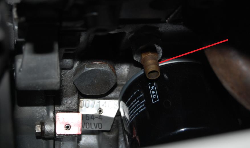

Pic 1: Exactly where do the three ends of this pipe connect up?

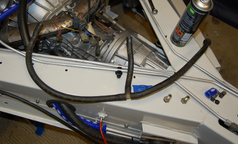

Does one go on the fuel injection? ie Pic2?

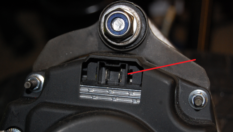

Pic 3: What connects on to here?

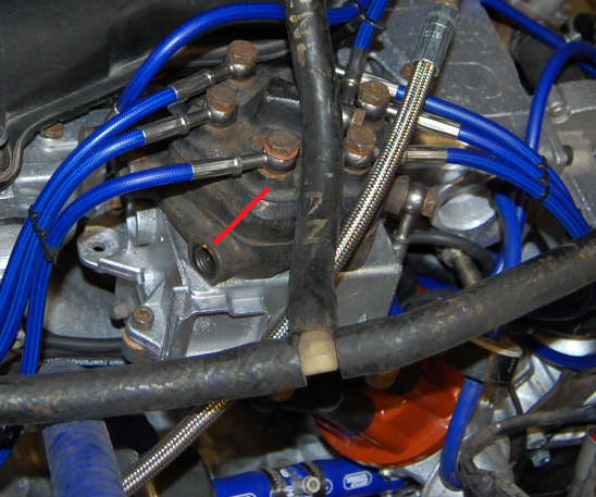

Pic 4: What connects on to this?

1 this is the pipe for the servo and connects to the inlet manifold that runs through the car to the servo unit
2 there are 2 x 17mm banjos one for fuel in other for return to tank , I think the nearest in the pic is the fuel in
3 not sure but it might be to do with the auto box

Pic 1 looks like some old vacuum hose that you may or may not need. I have a diagram somewhere showing how to connect up the vacuum system when running volvo setup. I'll try to dig it out tomorrow.
On the last picture the hose connections are drains to drain the block of coolant so nothing is connected to those.

Is the third pic down the back of the alternator?
On the 2nd pic, where did you get the fuel lines from? They should be solid plastic lines with rubber outer or braided lines. Standard rubber/ silicon non reinforced lines will cause pressure fluctuations on the k jet.

Thank you for the responses! Yeah third pic is the back of the alternator.
Dan 6457 wrote:Pic 1 looks like some old vacuum hose that you may or may not need. I have a diagram somewhere showing how to connect up the vacuum system when running volvo setup. I'll try to dig it out tomorrow.
