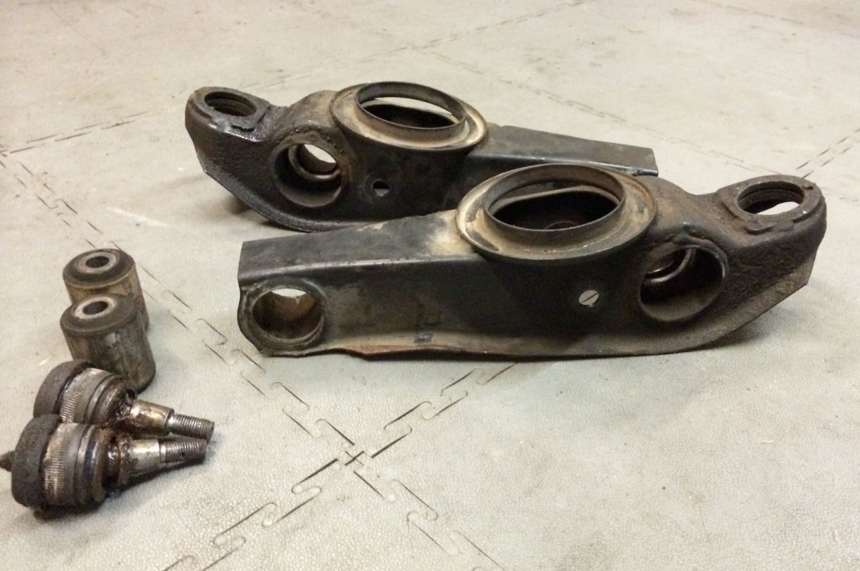

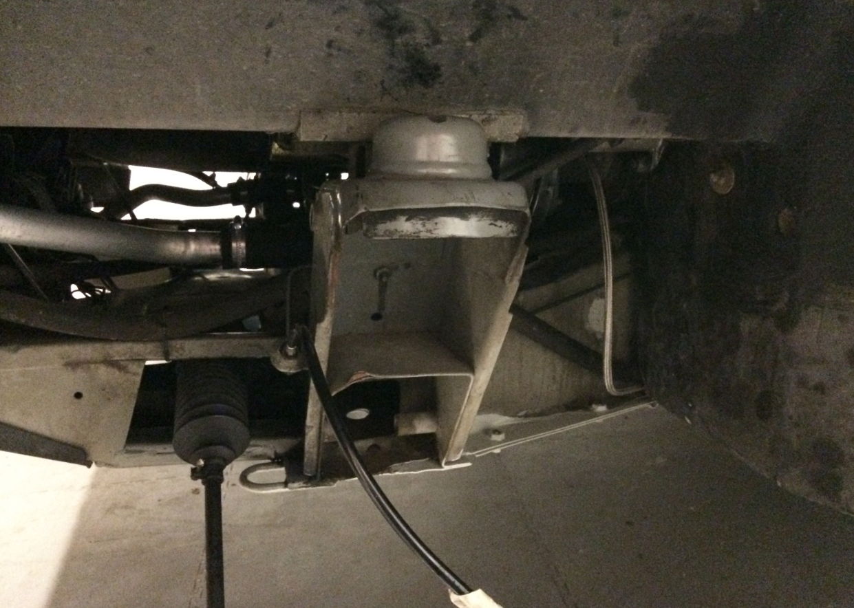

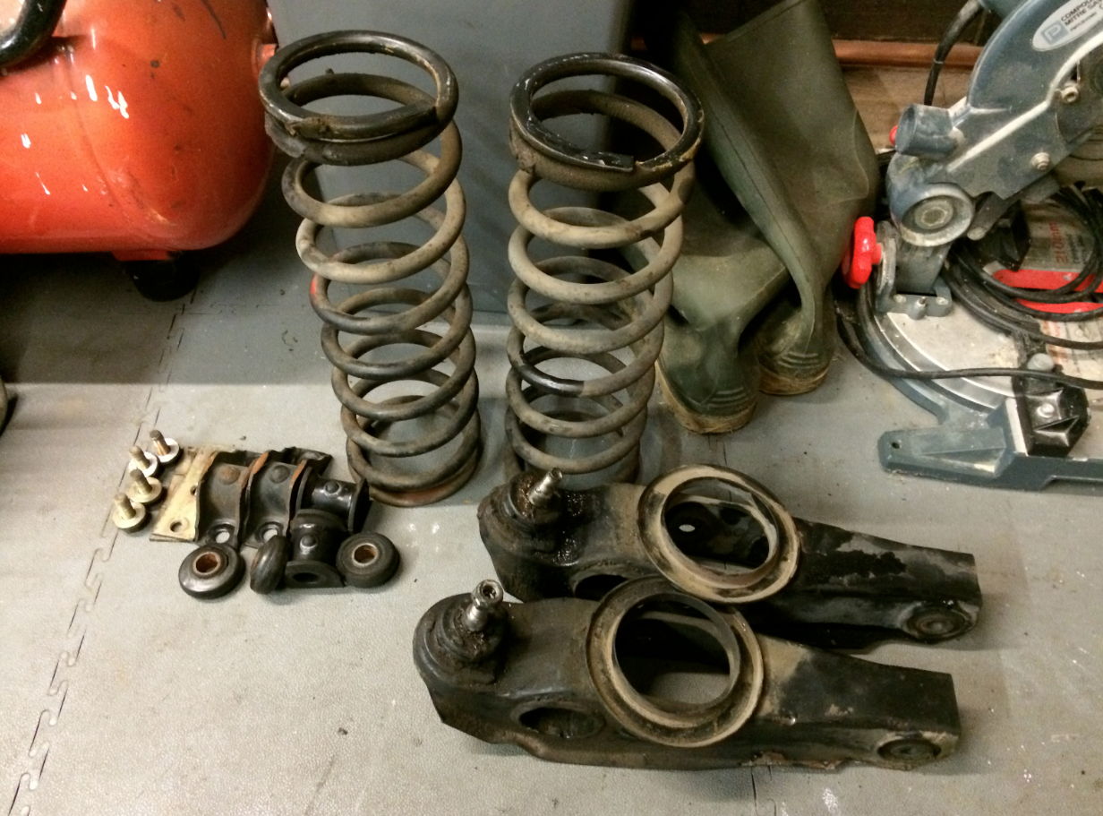

Done a bit of stripping down this weekend:
Next job is to get the arms stripped and weld on plates to re-enforce them but that can wait till next weekend now.

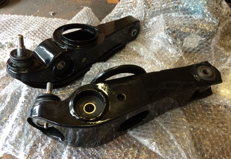

Postby Dan 6511 » Mon Apr 13, 2015 9:54 am
Time for a bit of an update as I've been doing some more work.
I decided not to bother modifying the suspension setup in the end because basically I couldn't be bothered and just want the car back on the road now.

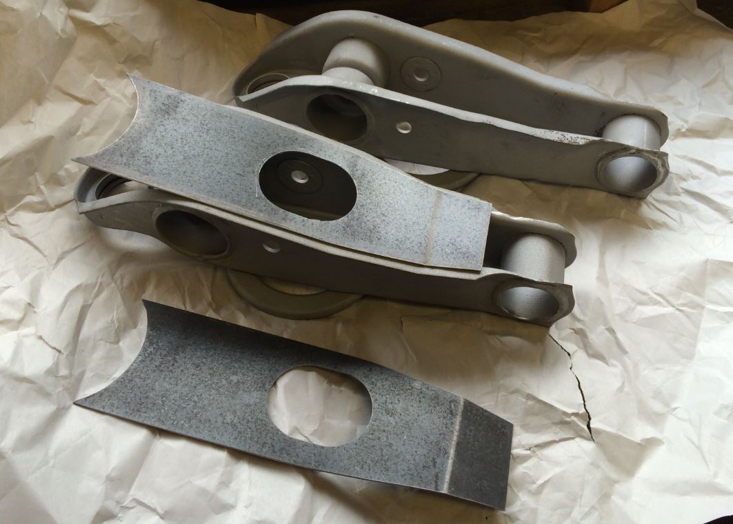

Arms shot-blasted and then cut out strengthening plates:

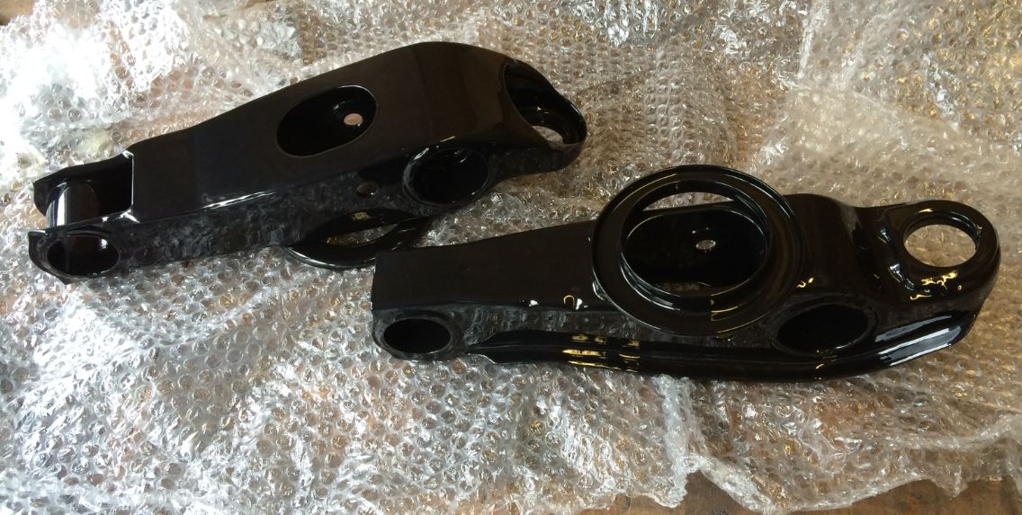

All welded up and powdercoated:

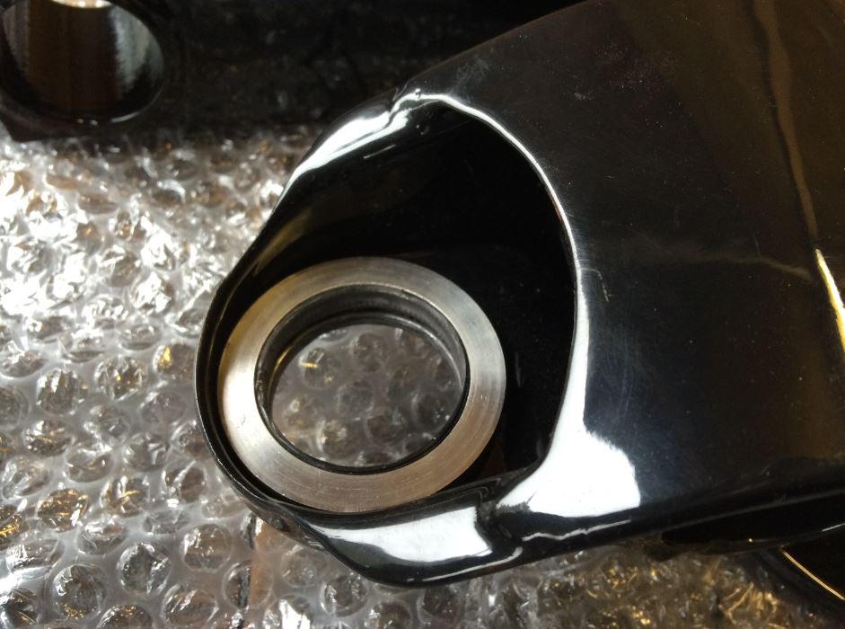

Retaining rings pressed into place:

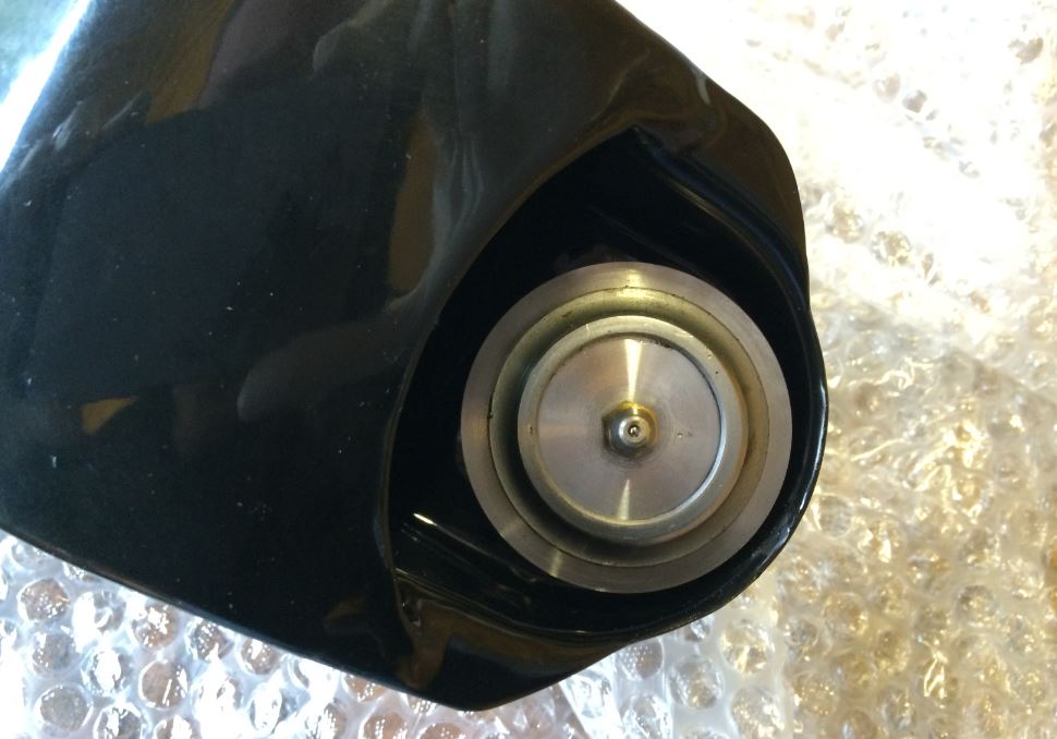

New Delorean Club balljoints pressed in:

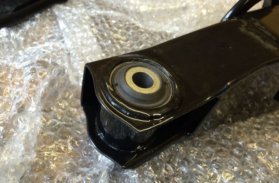

New bushes pressed in:

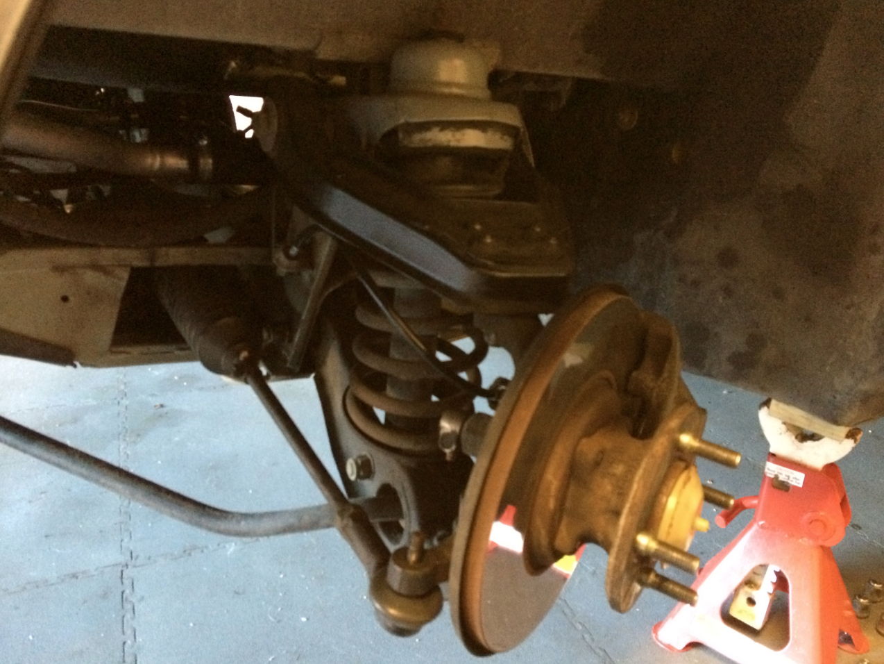

All assembled with DPNW sway bar bushes as well:

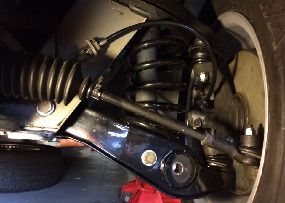

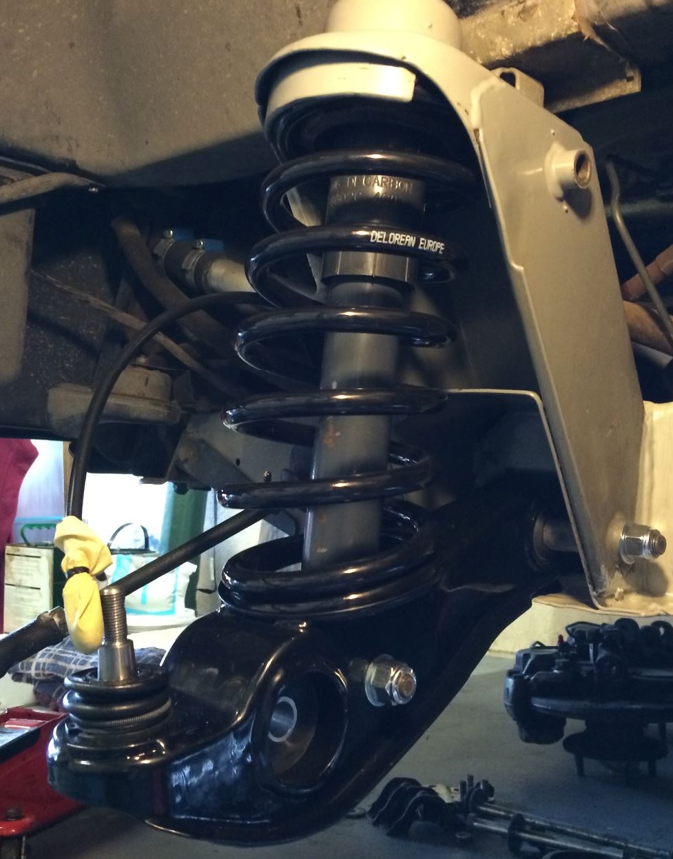

Back on the car with new Delorean Europe front springs:
