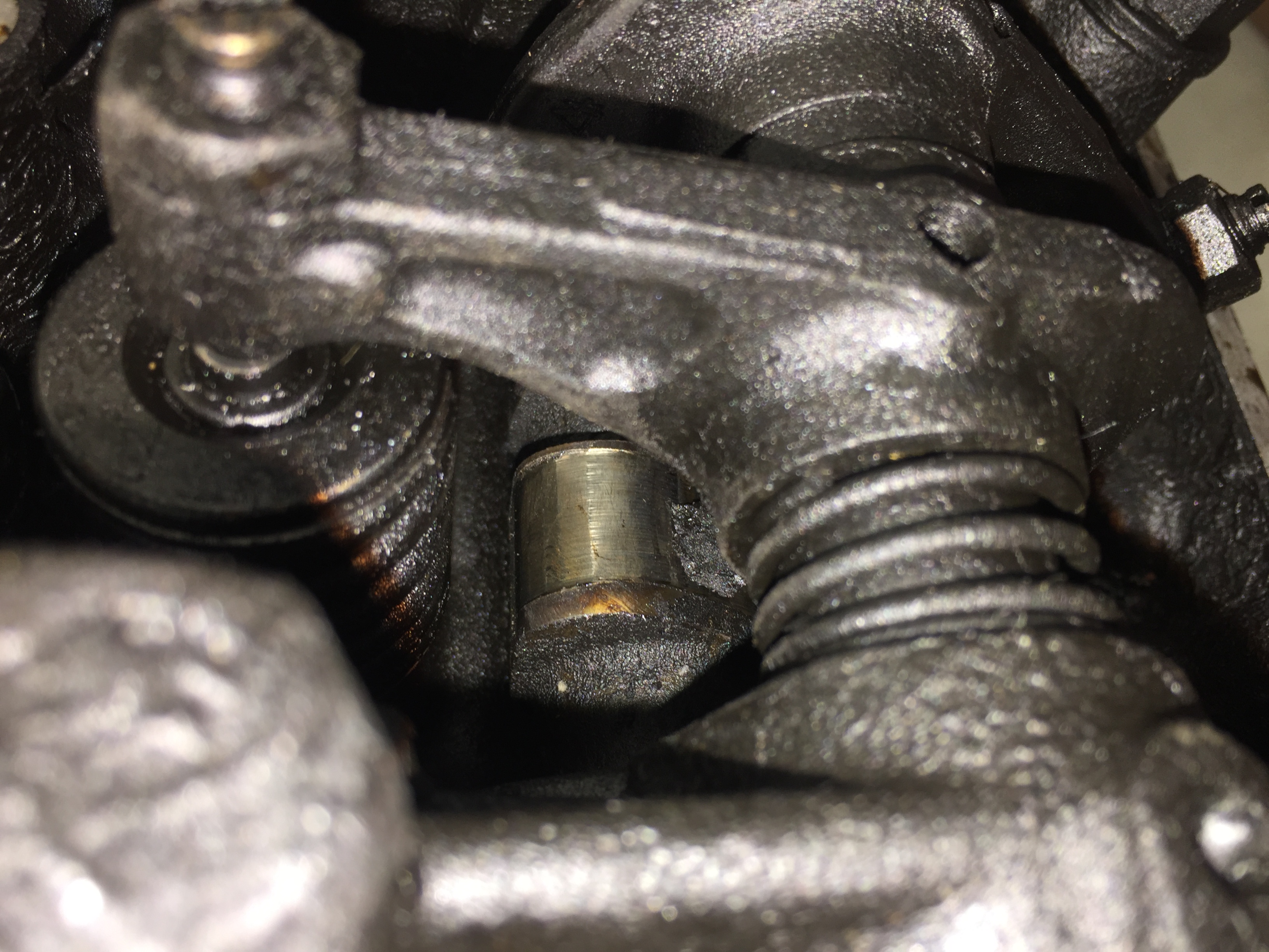

Magne
Worn cam

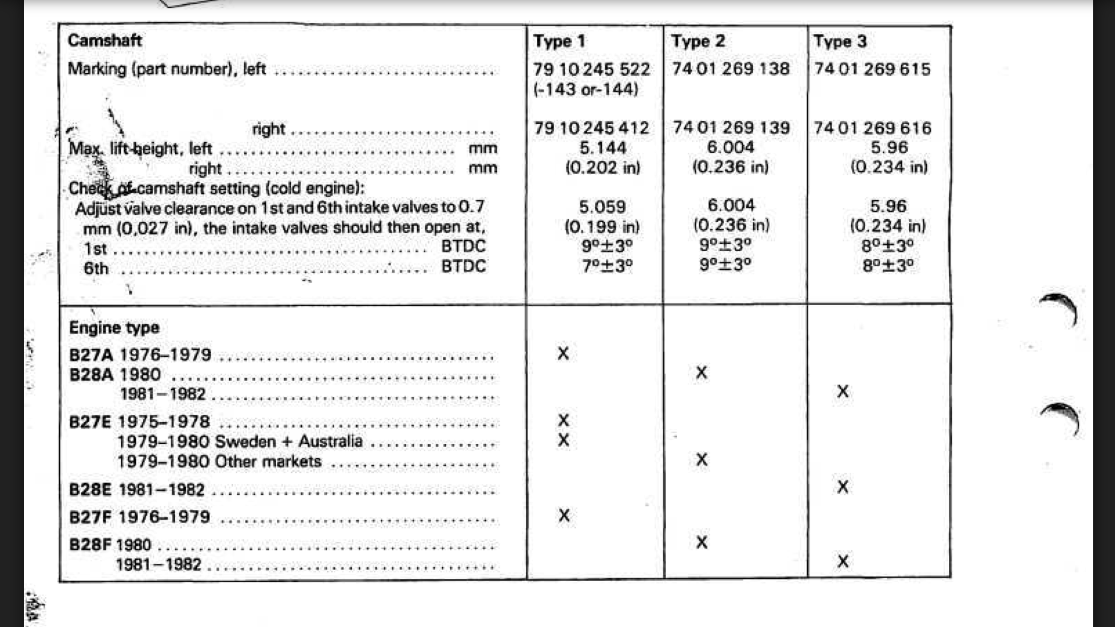

Postby gruffalo » Sat Feb 24, 2018 12:25 am
Lift seems to be similar at least

Re: Vin 5063
Postby arranj » Sat Feb 24, 2018 1:09 am
? They are the same on that chart.... (type 3)
As far as any Volvo dealer is concerned there is just one part number for all variants of the E and F. The new and used camshafts I have in stock are all "Volvo" ones, but they are the same as DeLorean ones as far as I'm aware.
The official Renault numbers for the camshafts they supplied for the DeLorean engine are 7910247110 and 7910247111 which are of course different to above. But that doesn't necessarily mean they are different, just different numbers.
