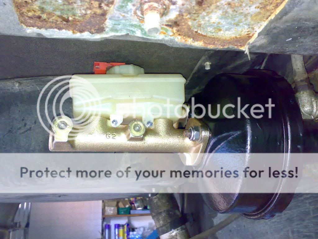

I just replaced the entire brake master cylinder plus reservoir. I didn't want to mess with the ability to stop after the car tried to kill me. Good luck i noticed on time.

Postby bandit » Tue Nov 26, 2013 8:33 pm
A quick tip for the reservoir bottle, stick it in the dishwasher, comes up like new !
Here's mine after cleaning
