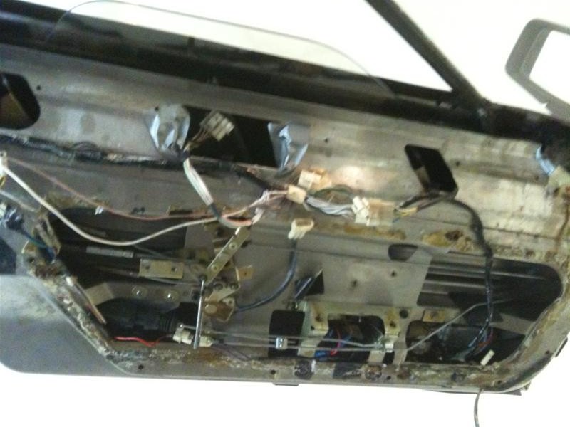

Since it is a long rainy weekend i decided to take on the restoration of the doors' intestants. After removal of all the trim backets and braces i found out some interesting stuff. Can you spot the differences?

Postby Admin-bloke » Fri Apr 30, 2010 2:21 pm
Looks like an aftermarket central locking solenoid has been put in.........

Postby Daniel Shane » Sat May 15, 2010 8:10 am
Admin-bloke wrote:Looks like an aftermarket central locking solenoid has been put in.........
That looks like Tobys door locking system. I had them fitted to my car and they worked great.
