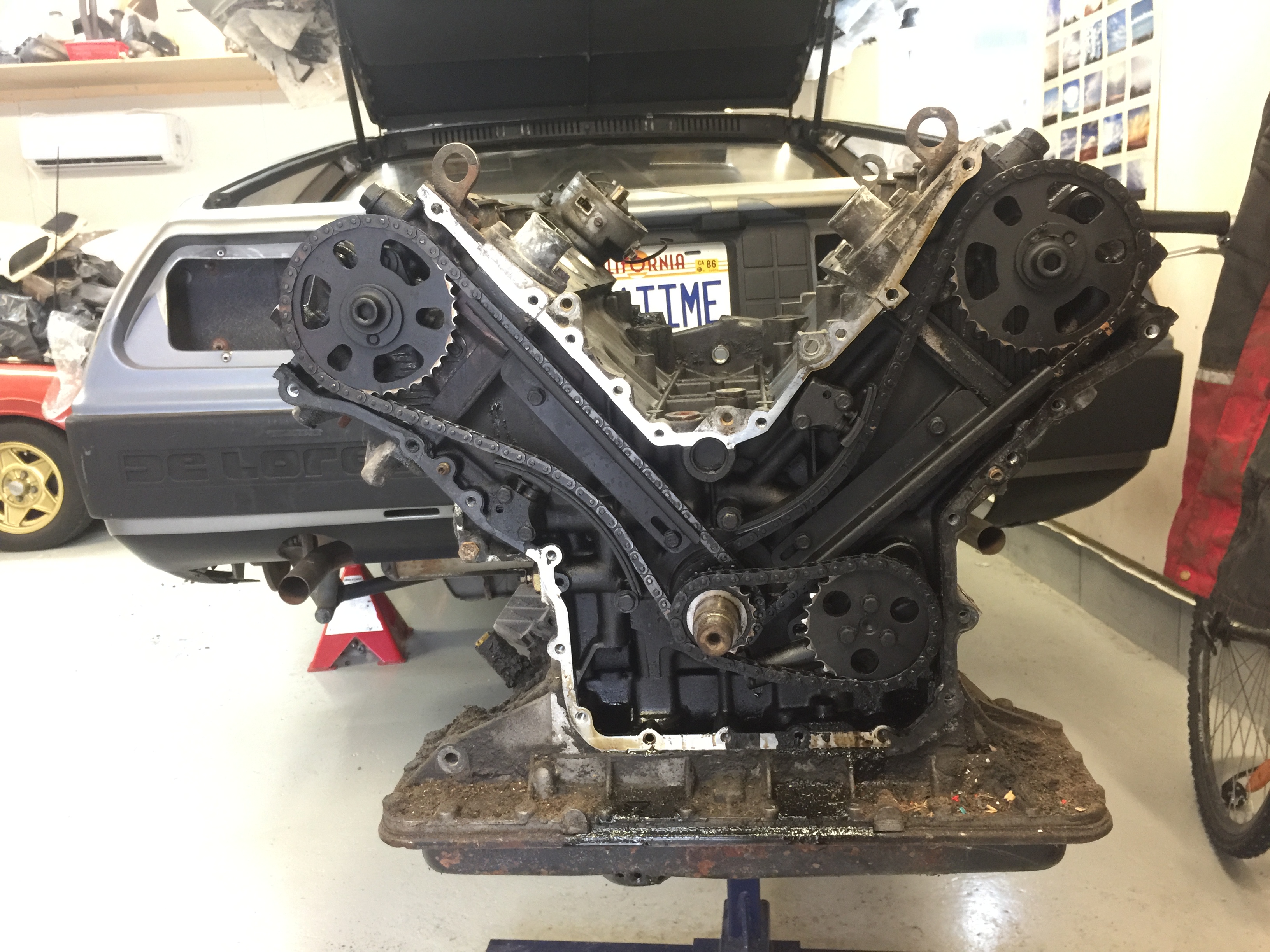

The timing cover is off the B28E, and one chain tensioner is loose. The oil pump chain is also very loose .
Practice session
Naked B28E

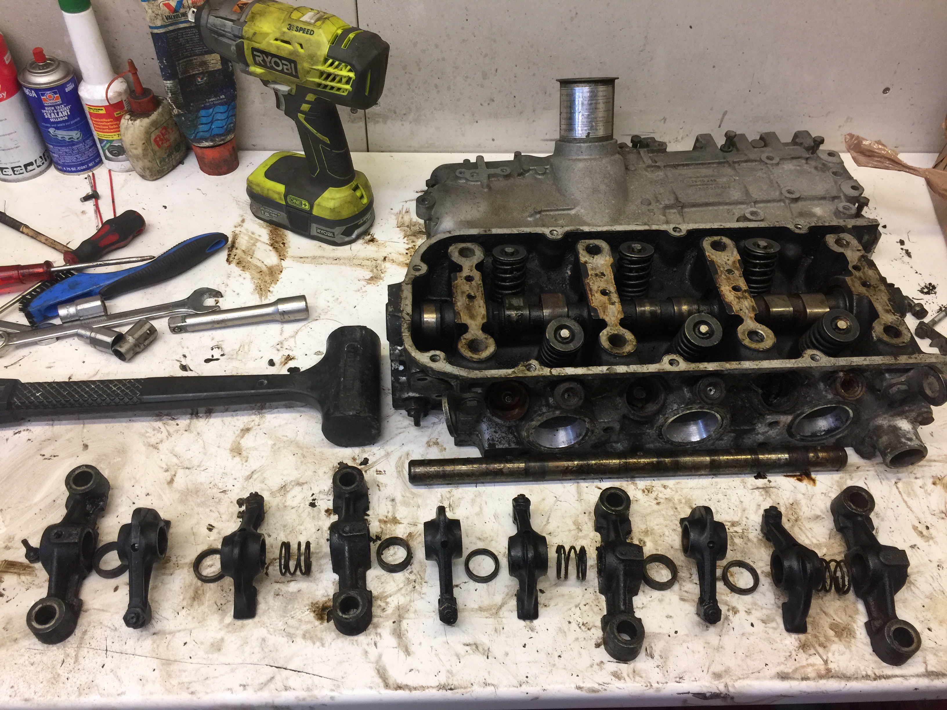

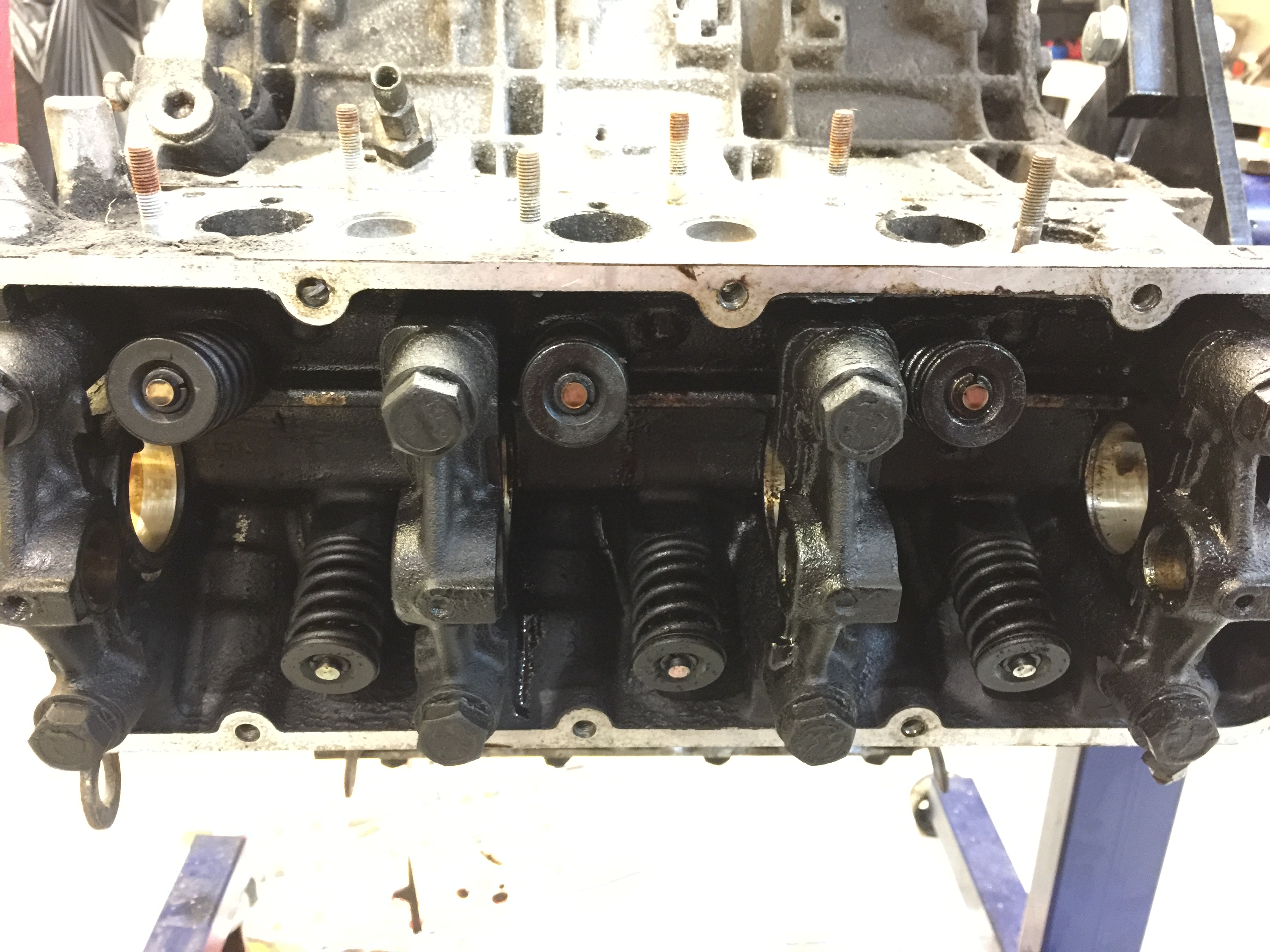

Today I had great fun and smooth progress :)
I removed the rocker shafts and the whole assembly along with the cams on my B28E. Everything went super smooth, much thanks to my training session on the spare engine.
The oil galleries on the rocker shaft were not clogged, so hopefully oil starvation isn’t a generic problem on this engine.

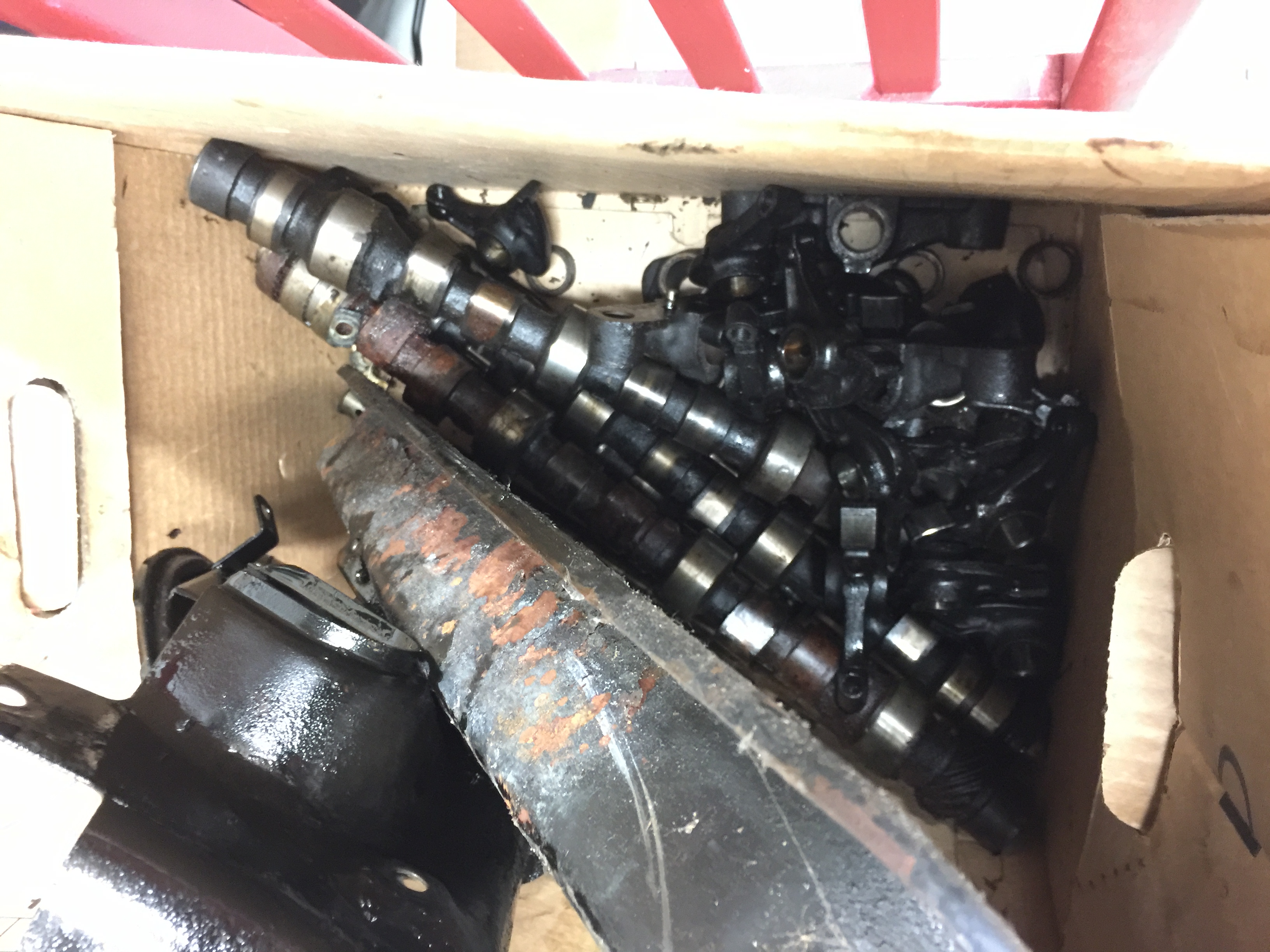

The low mileage dmc engine cams have no visible wear, so hopefully the two combined will make a great engine.

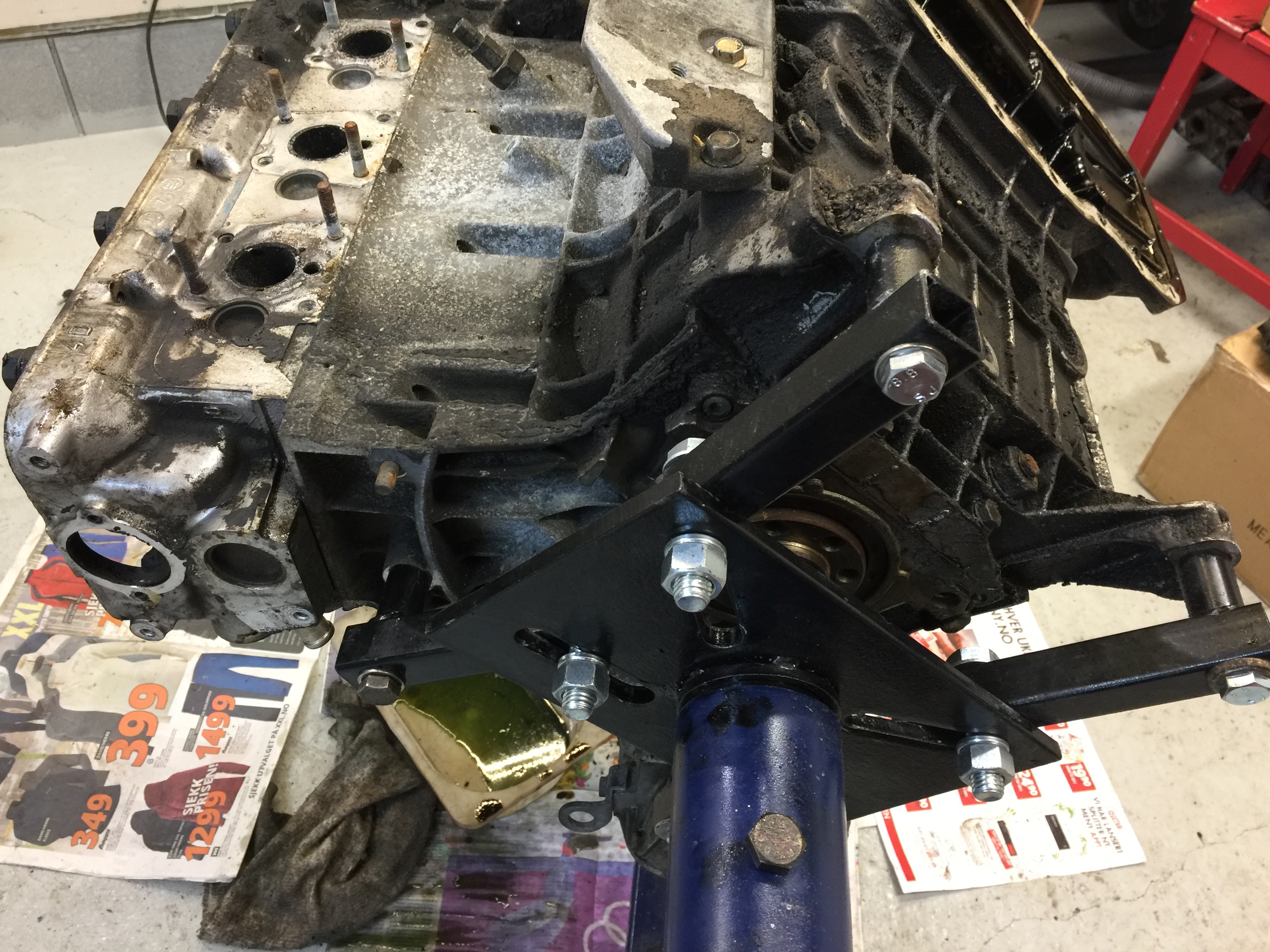

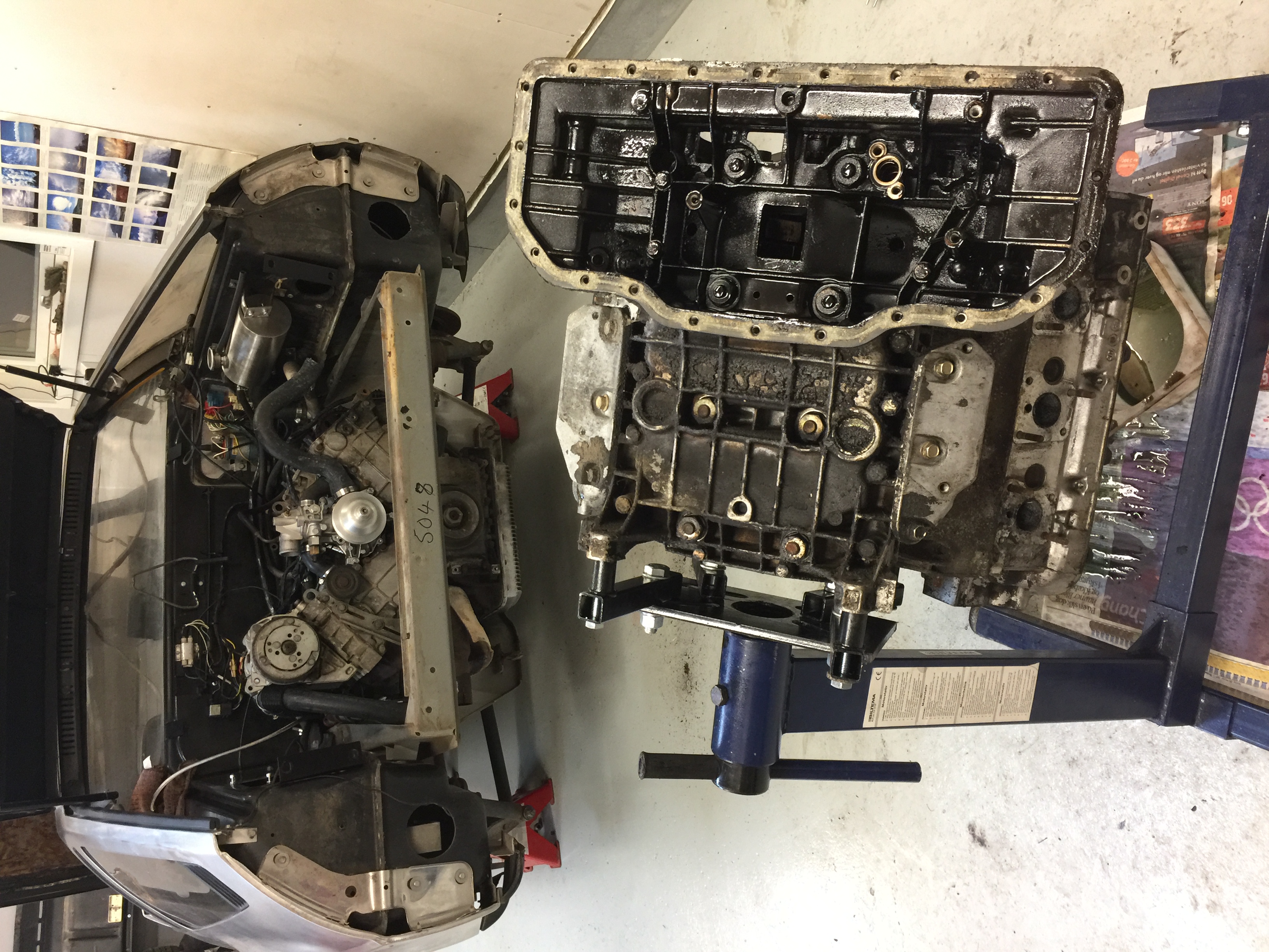

The only “problem “ I ran into was related to my engine stand. It is attached to the sandwich plate, thus no replacing that while the engine is on the stand.
I prefer working with the engine on the stand, so I’ll save the bottom end for last.

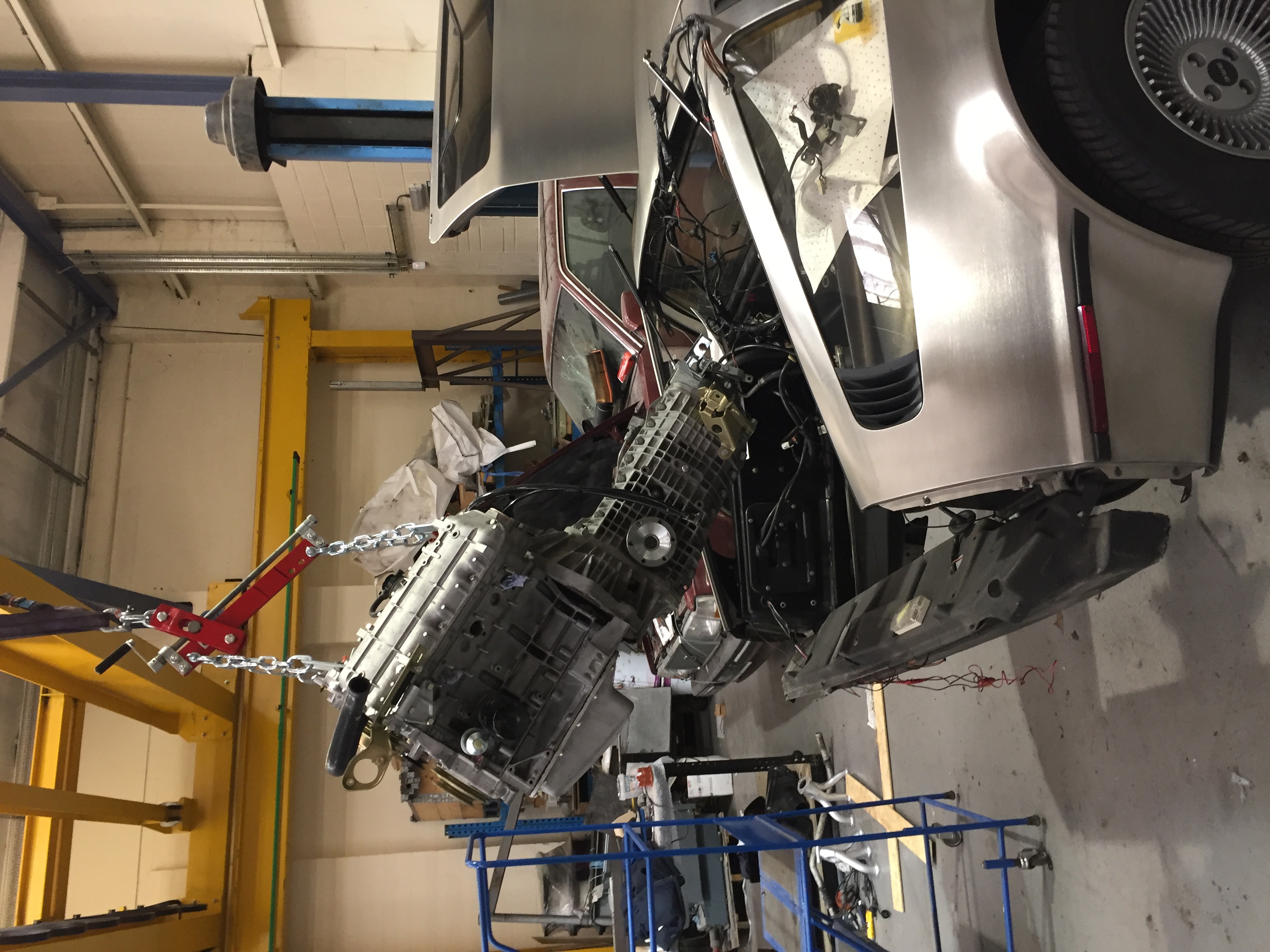

Next thing is pulling the old engine, and start moving good parts. Once the top end is done, I’ll flip it up side down, and swap the lower part over.
I do not want to install the intake with the engine out of the car, because that way I won’t get to the clutch slave. At least that’s my plan for now.
So I’ll drain the fluids, loosen the motor and transmission mounts, shift linkage, clutch slave, wiring harness, get a crane and pop the old bugger out!

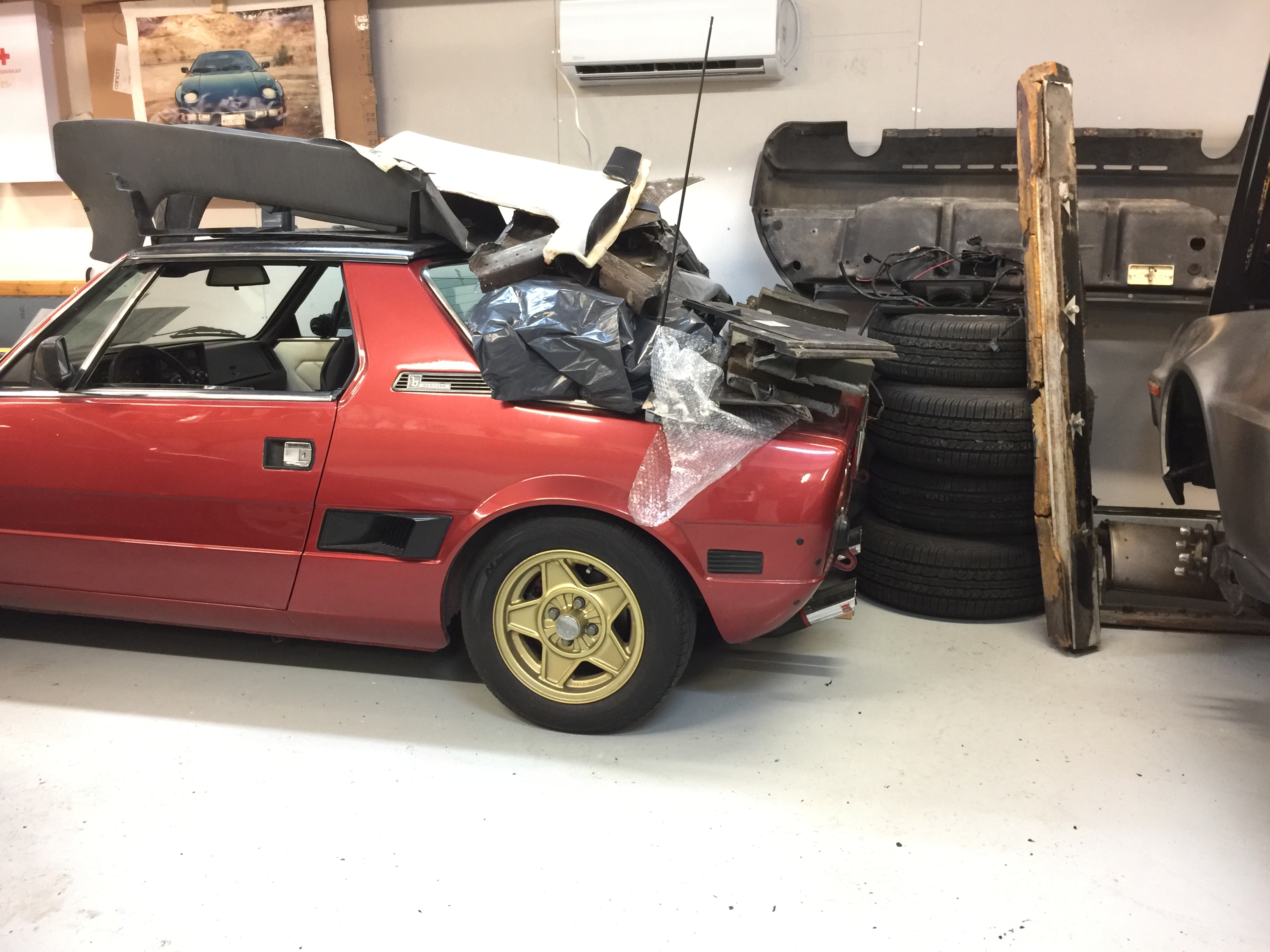

Fiat buried under parts
‘F vs ‘E
Parts to bin.
Frame # off by 5
Empty head
Stand issue
Parts to recycle

Don't throw parts away, someone may want them and you'll feel good about not wasting them :D they might be useful for core parts or for cam regrinds if someone wants a performance can doing etc
I recommend that the rockers follow the same cam as they will have worn together

Postby gruffalo » Sun Feb 25, 2018 8:19 pm
OK, I’ll put them in the “dungeon” for now.
You could try taking the engine and transmission out in one, that's how I did it

Postby gruffalo » Mon Feb 26, 2018 3:35 pm
DJK73 wrote:You could try taking the engine and transmission out in one, that's how I did it
I will. I just have to figure out the optimal way of detatching the shift linkage and transmission mounts from the transmission casing.

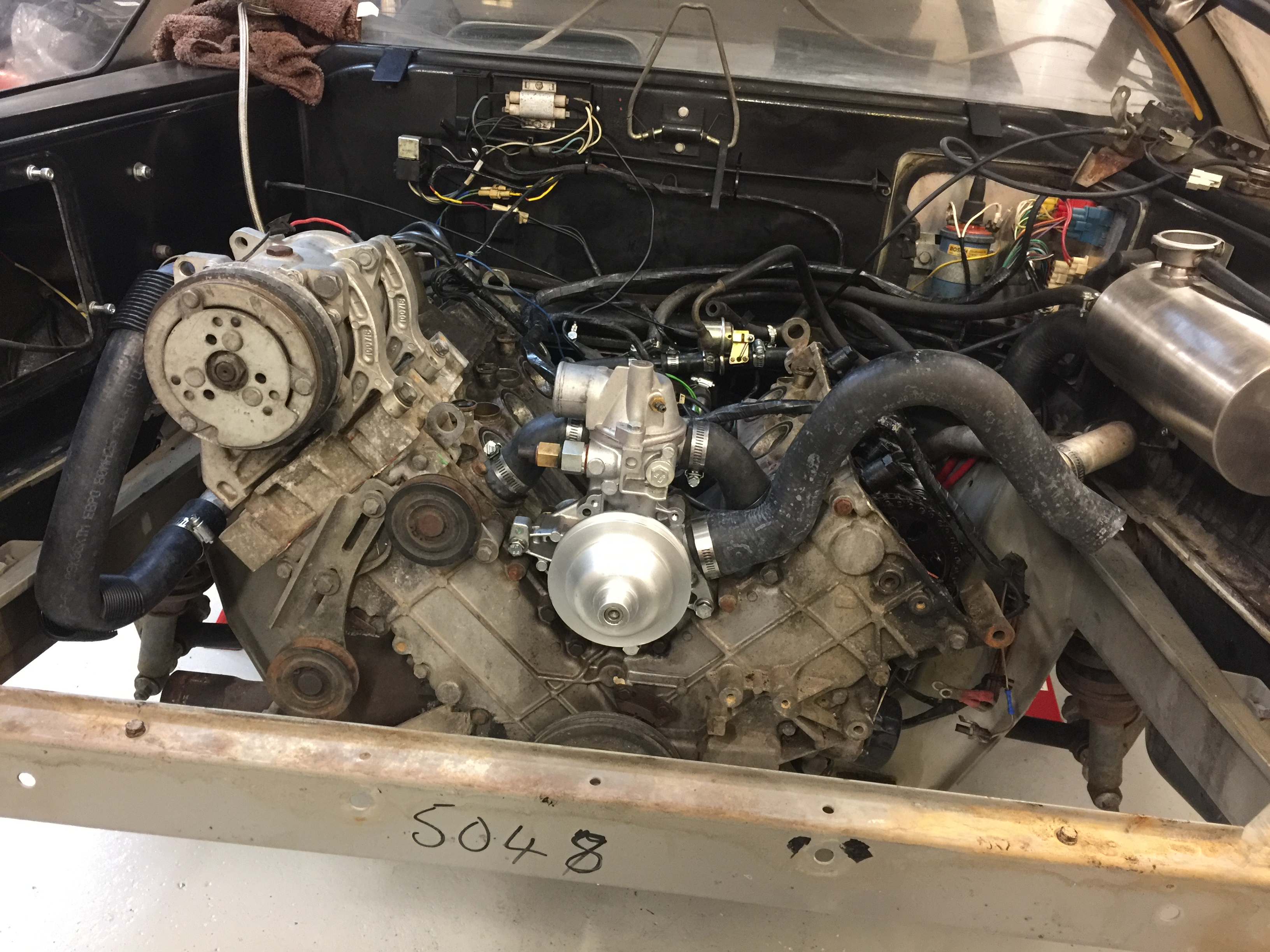

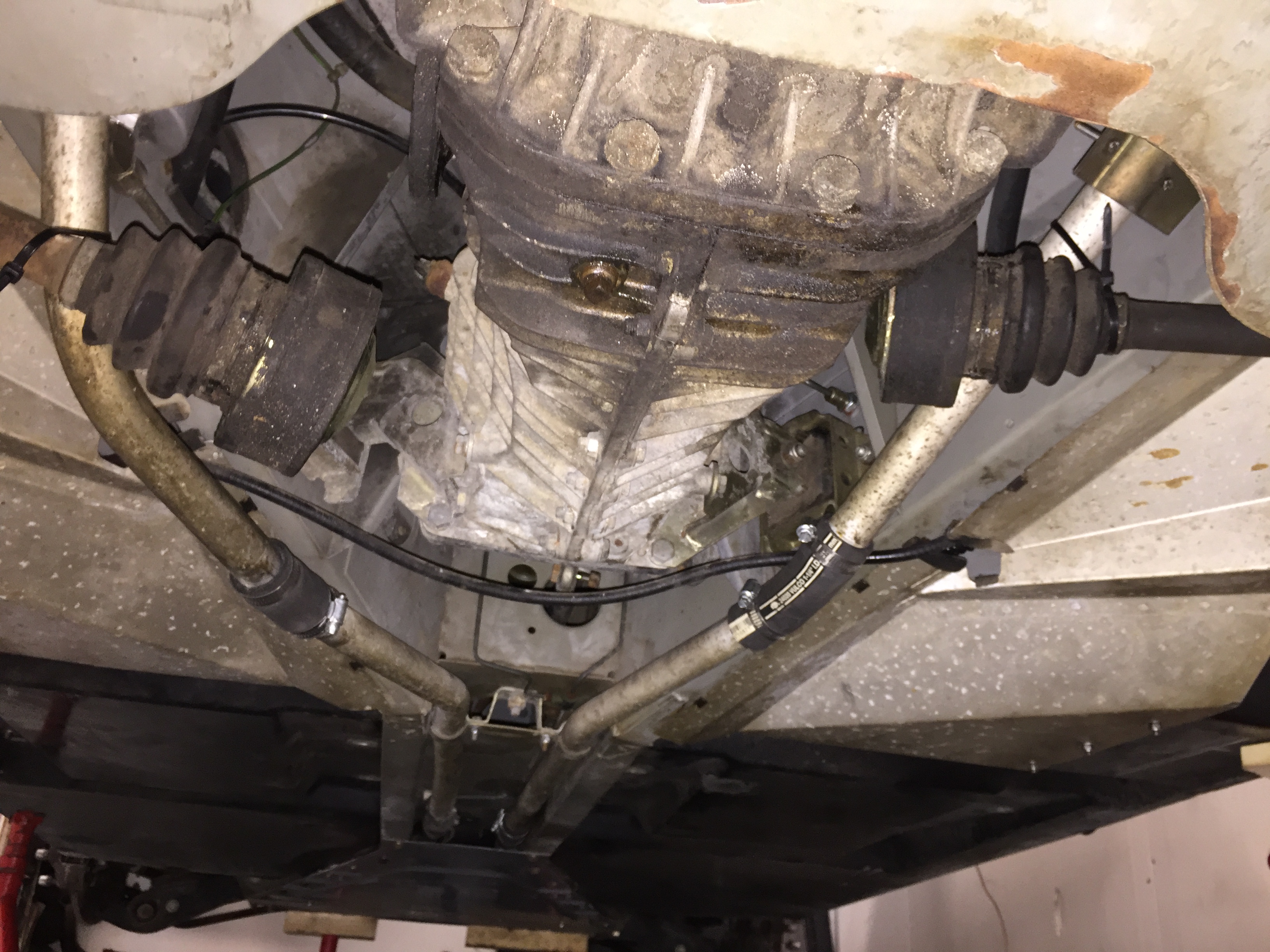

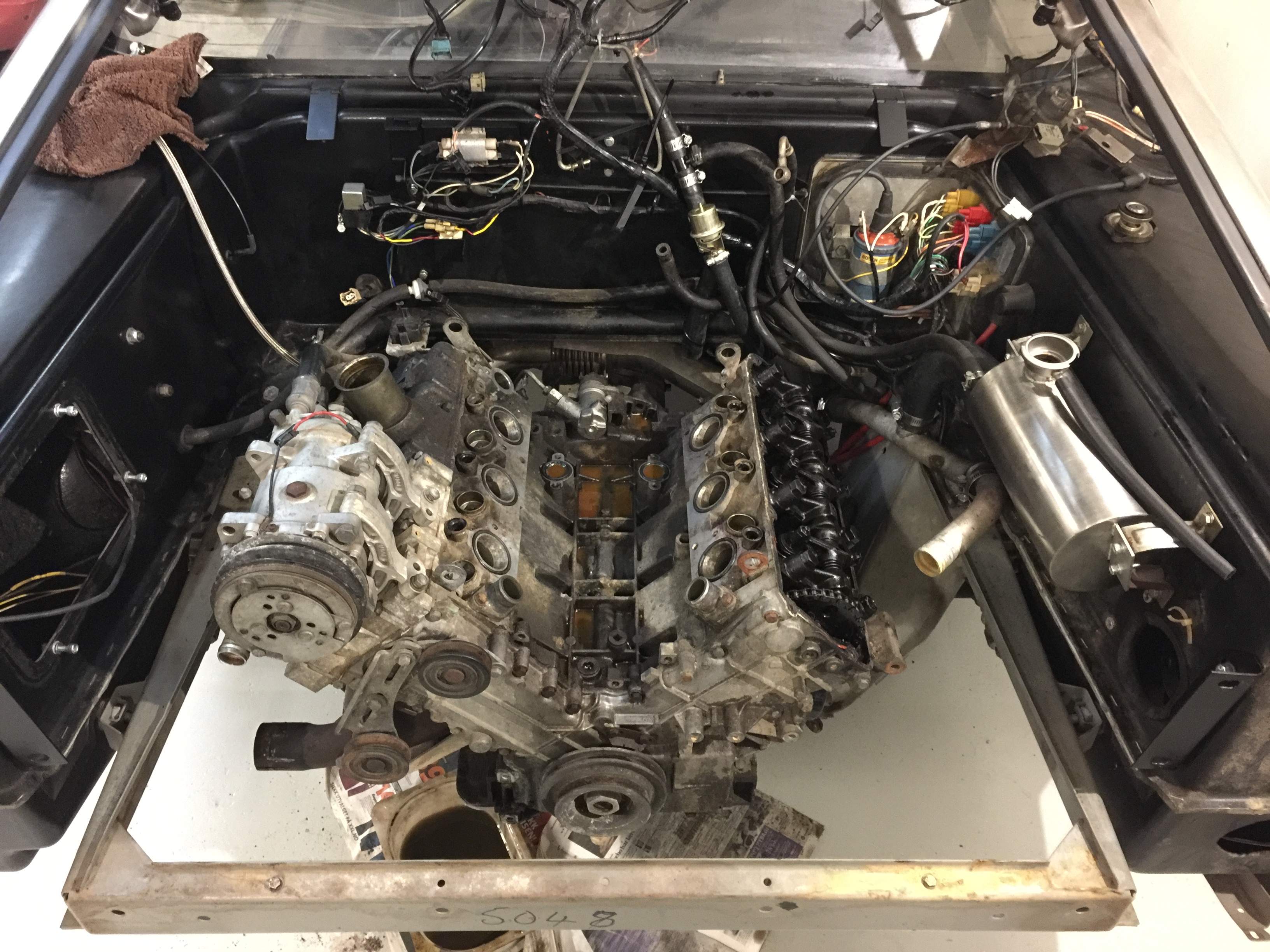

Tonight I cleared everything out of the way in the engine bay, and undid the driveshafts.
The shift mechanism and the transmission mount are the only things attached now.
I need to get a crane .

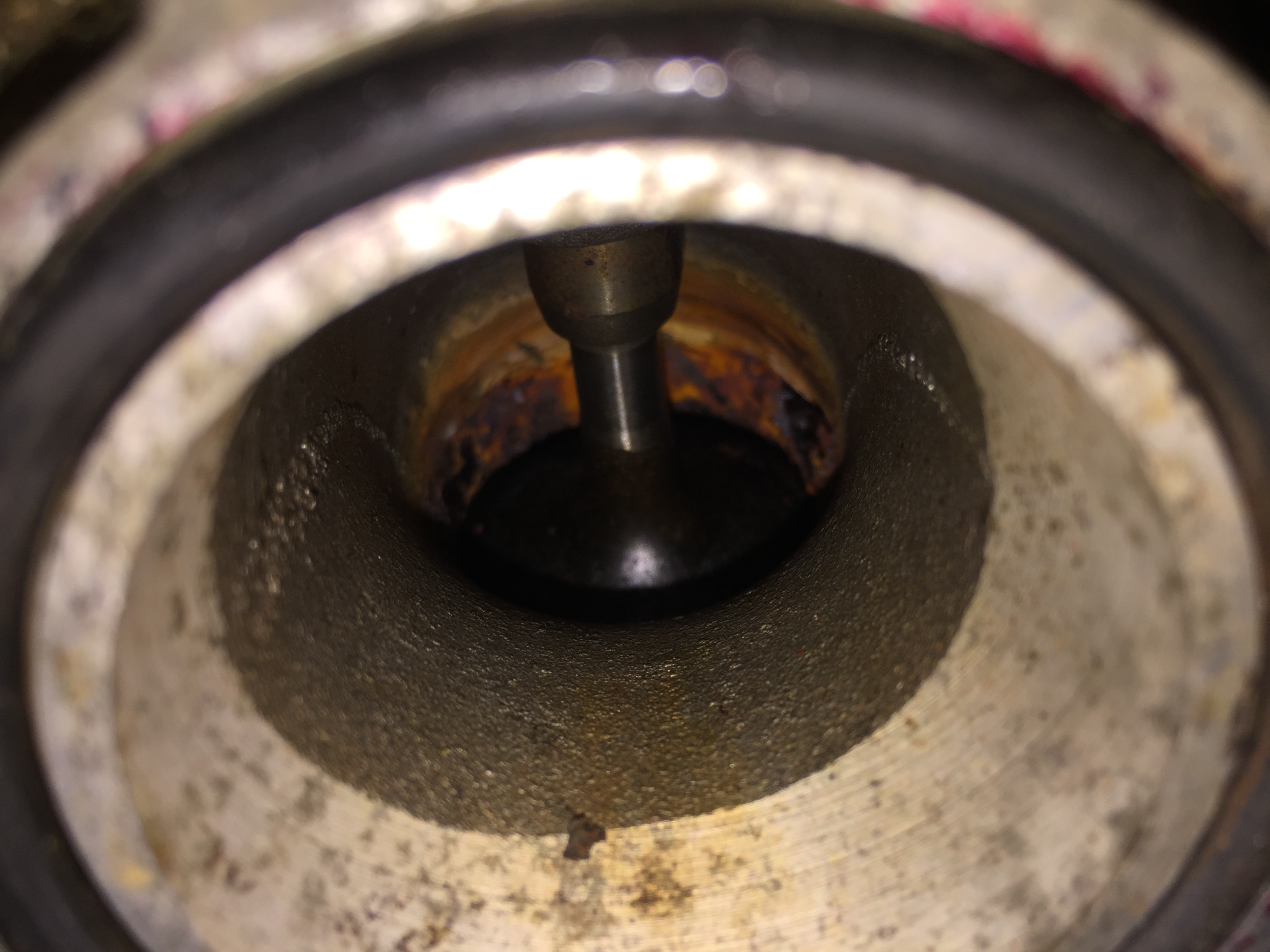

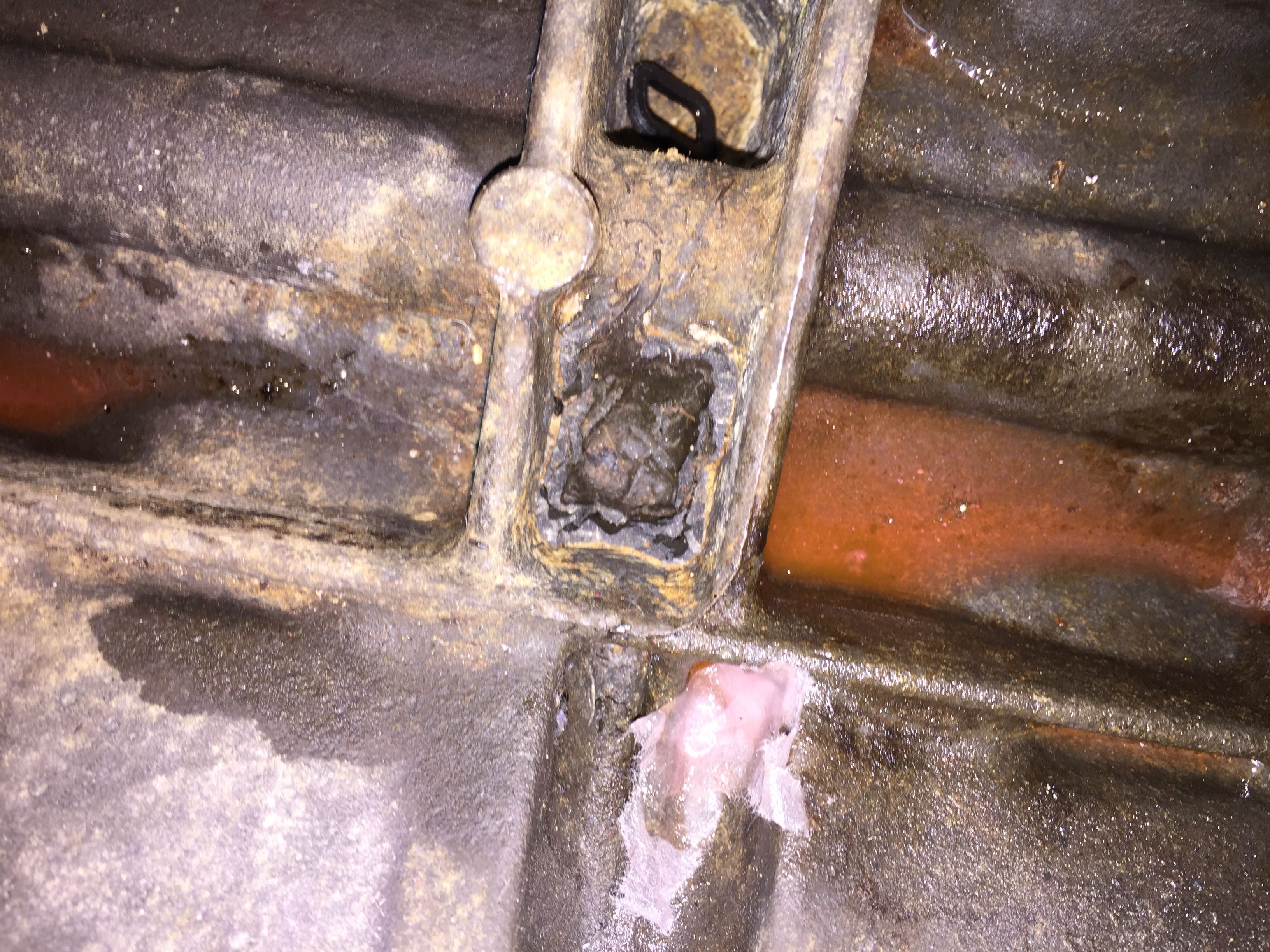

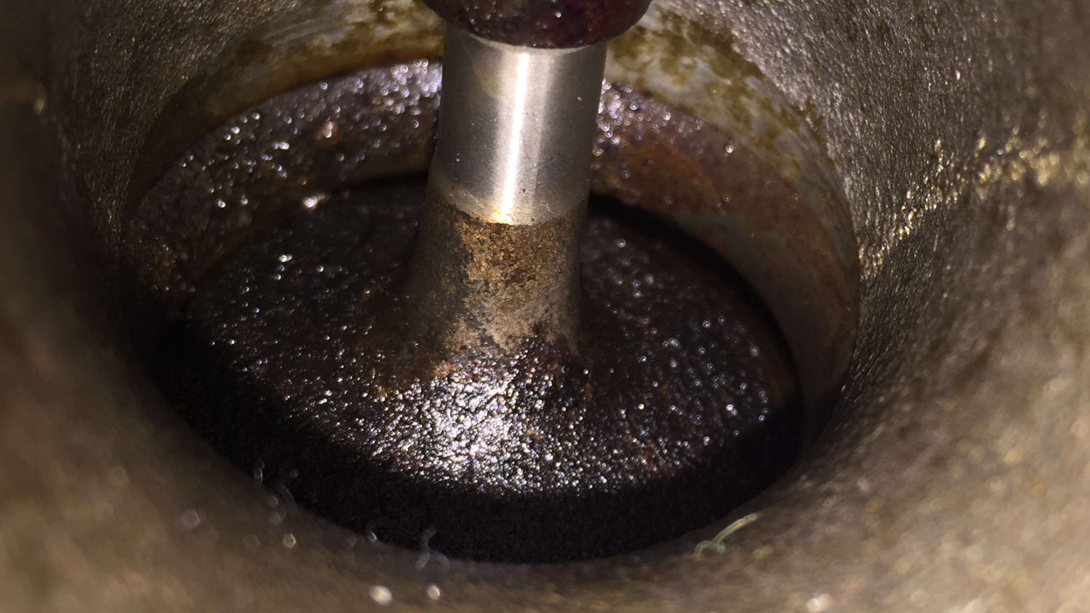

Some photos of the original engine that I finally gave up on.
Axels off
Everything detached, bar ac compressor
Block rot repair
Evidence of water
Bent valve
