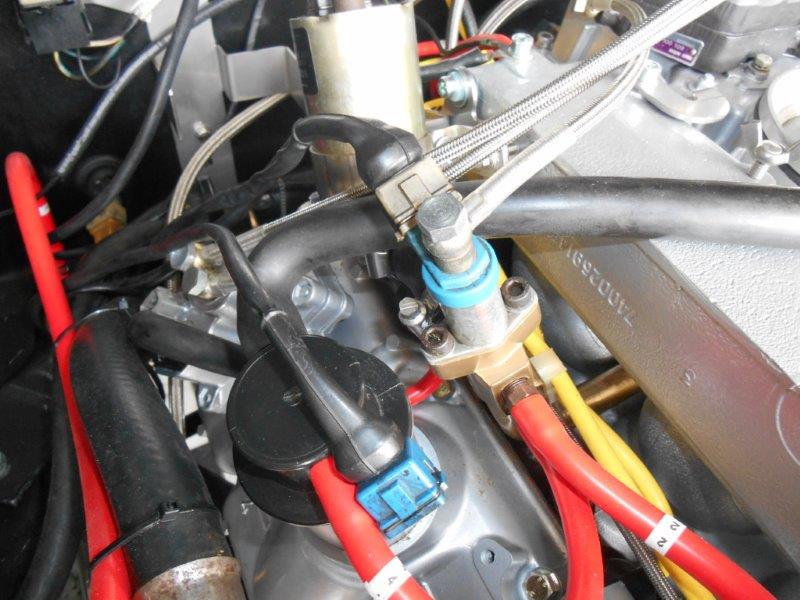

So, I have tried to invert the connector of the WUR and Cold Start Valve and everything is running fine.
Video below
https://youtu.be/B7VSPZzk9V0
Around 900rpm. Don’t worry about the smoke; it comes from the exhaust which still has some WD40
On the other hand, when I plug the connector where they should be, same problem, the car starts but stall after a second.
Do you have any idea what is happening now?
Thank you very much for you kind help.

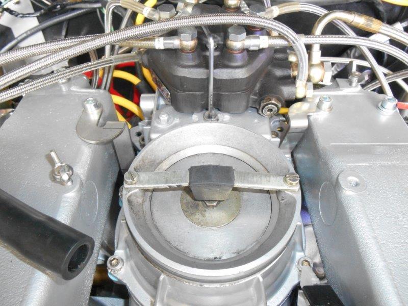

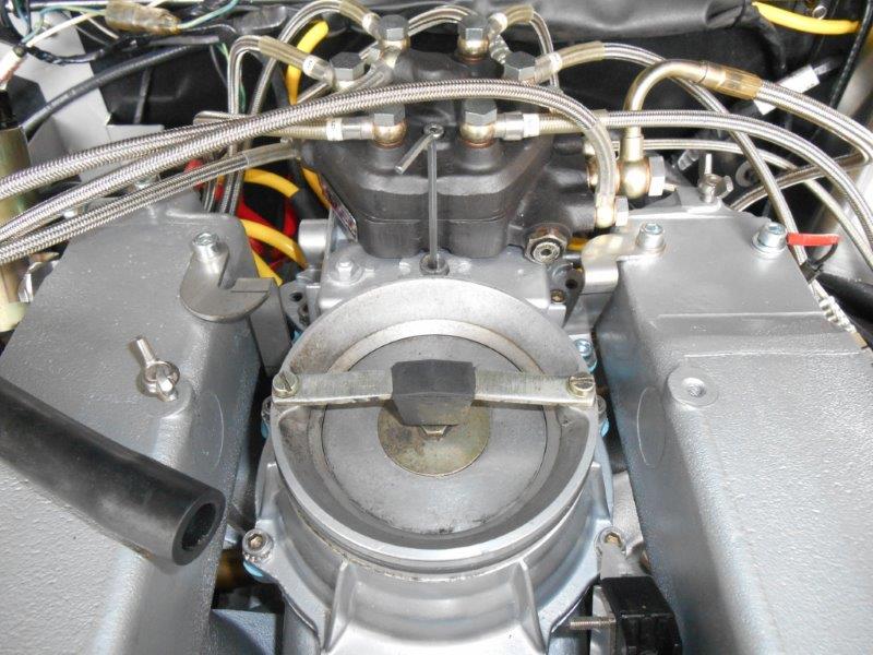

Postby Domi » Sun Jun 05, 2016 7:04 pm
Here is the initial position of the screw
Turn it of ¼
Then another turn
And the result on the video, the idle was up to 1300rpm then 900rpm it worked a few second then stalls. I will turn back the screw when the engine temperature will be fine.
