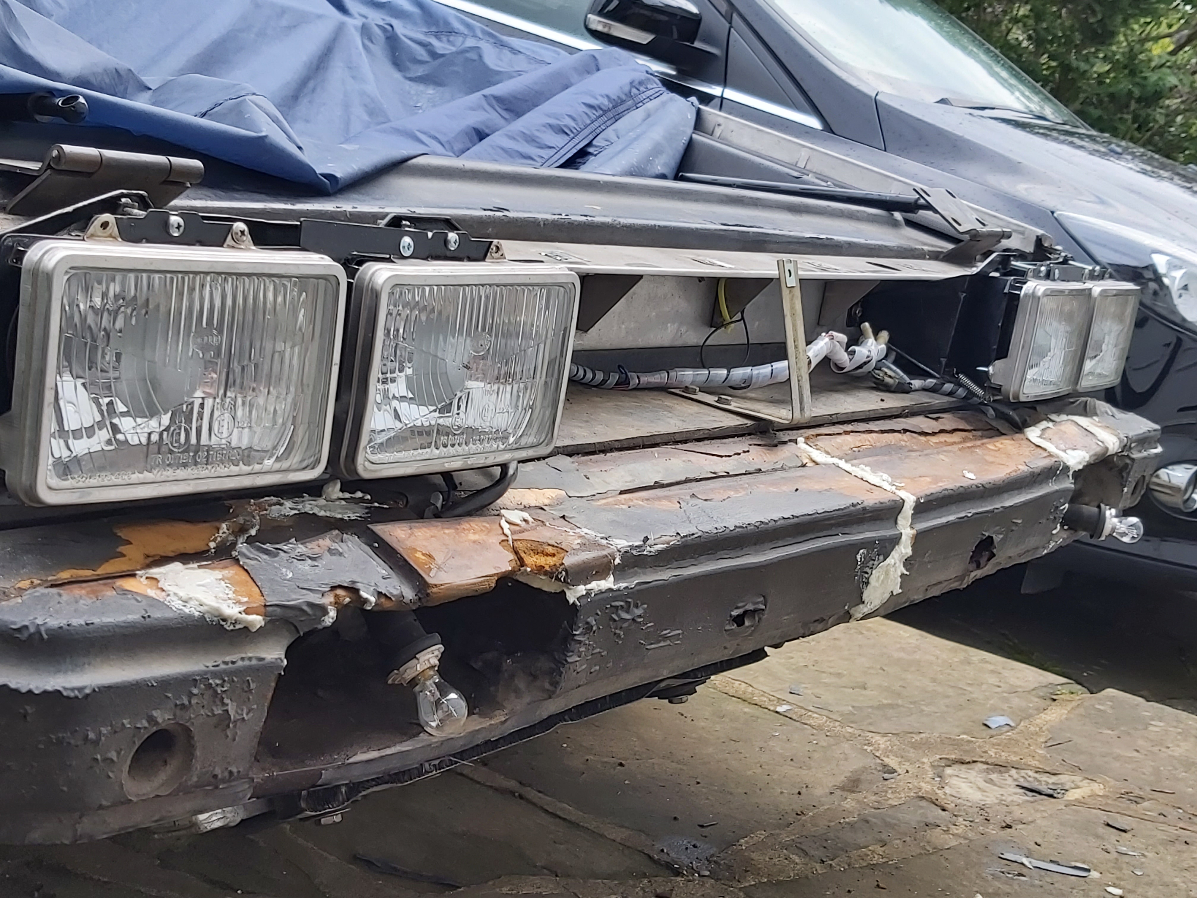

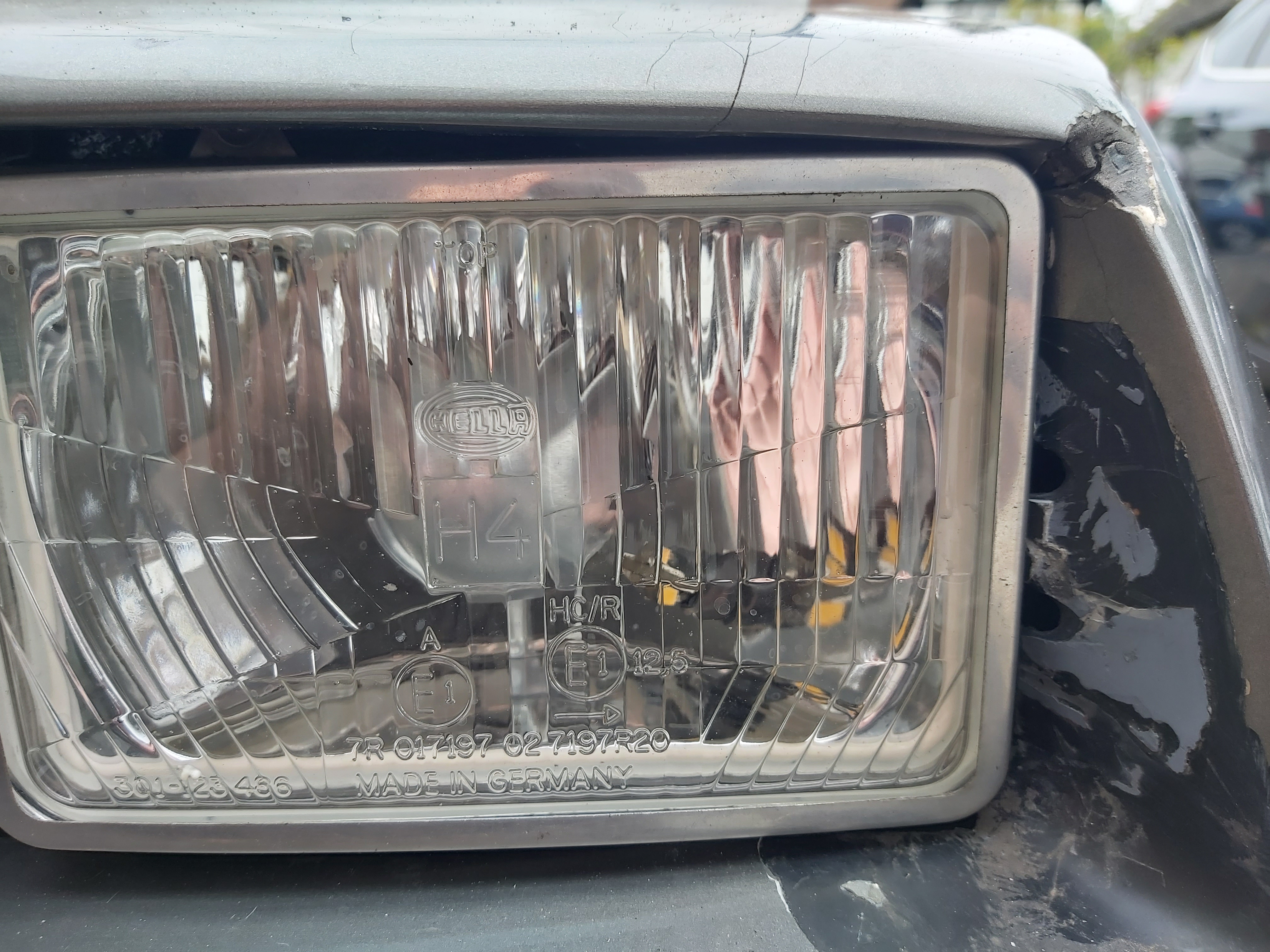

The headlamps are now all H4s, and the buckets and brackets painted. I changed the chewed adjustment screws, and used new stainless screws on the bezels Wiring had been previously remedied. I also fitted the headlamp finishers I bought in.... 2012..!!
I've had the front fascia on and off lots and lots, in an attempt the get a better fit. Not quite their yet, but its not as tight round the headlamp units following a bit of easing with the file.
I filed slots into the fascia to allow access to the retaining and adjusting screws.
These are not too noticeable when fitted

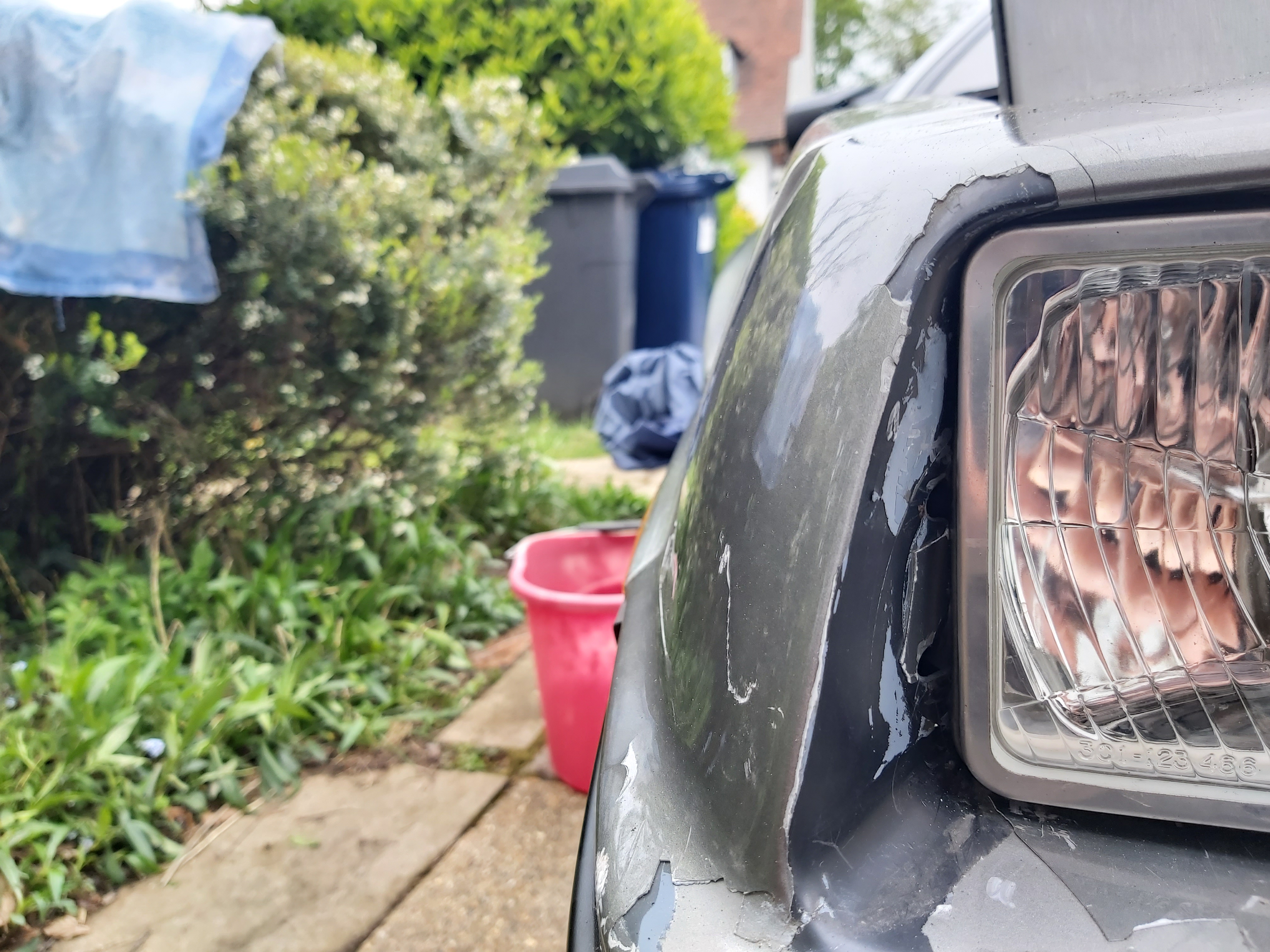

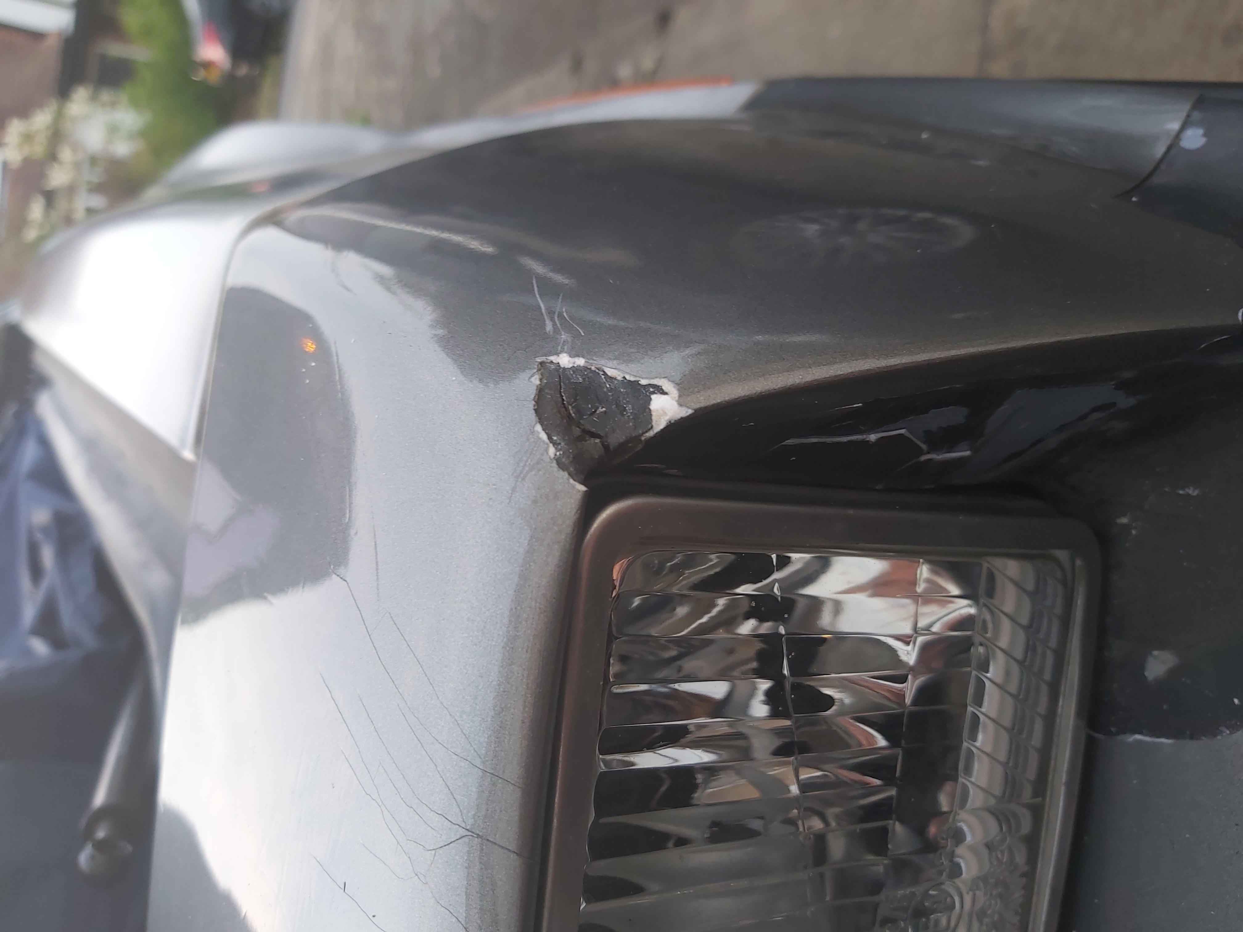

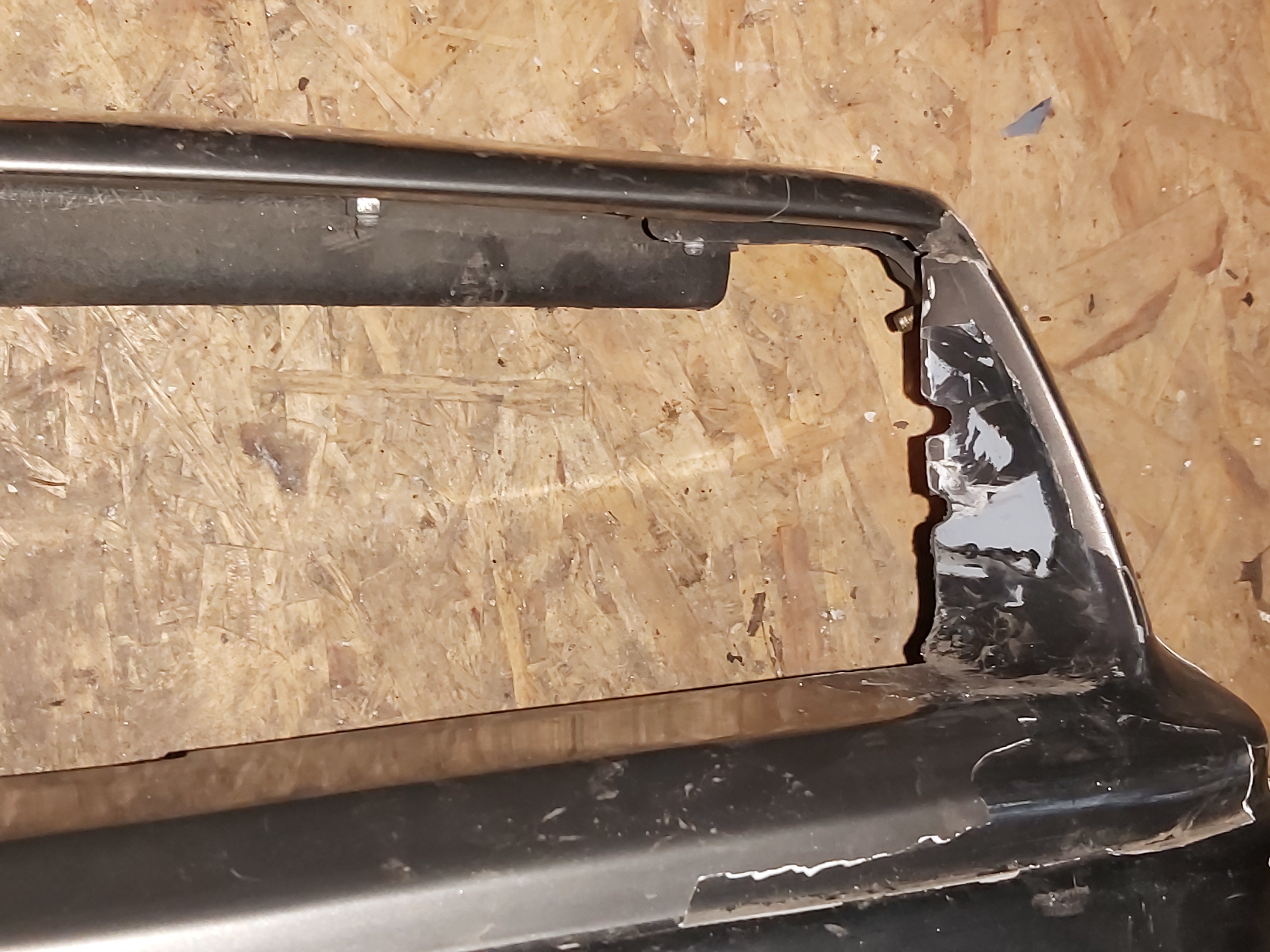

The major bit of damage in the top corner is unsightly and is going to need a careful repair.
I think this has in part been caused by the headlight "stretching" the shrunken fascia. Its been repaired before in the past, and was ok for the last 8 years so cant really complain too much. However, it will need remedy.
With the fascia off, I used some expanding foam filler to patch up the impact absorber. Its not pretty but I'm not going to waste time beautifying something not seen.

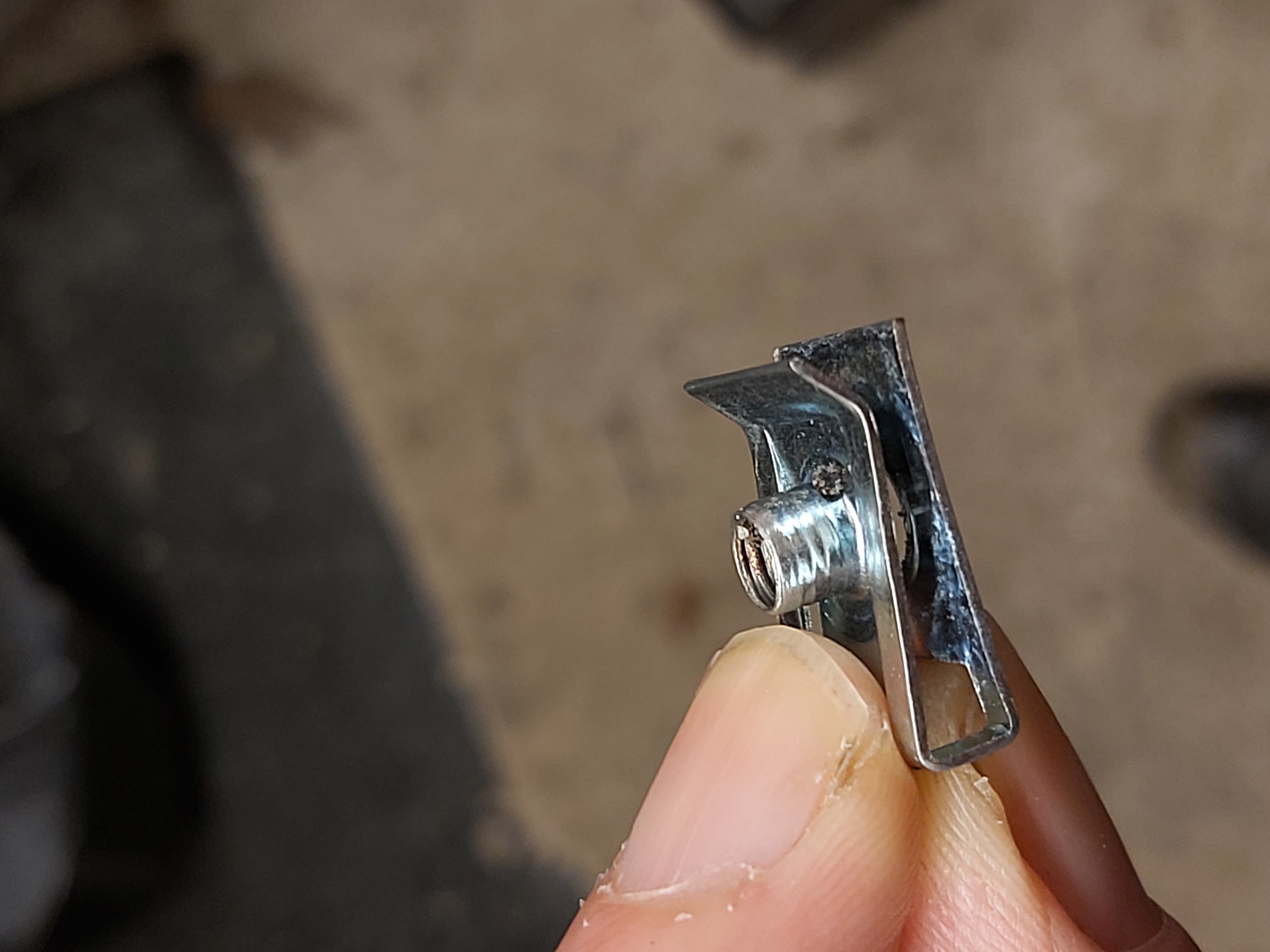

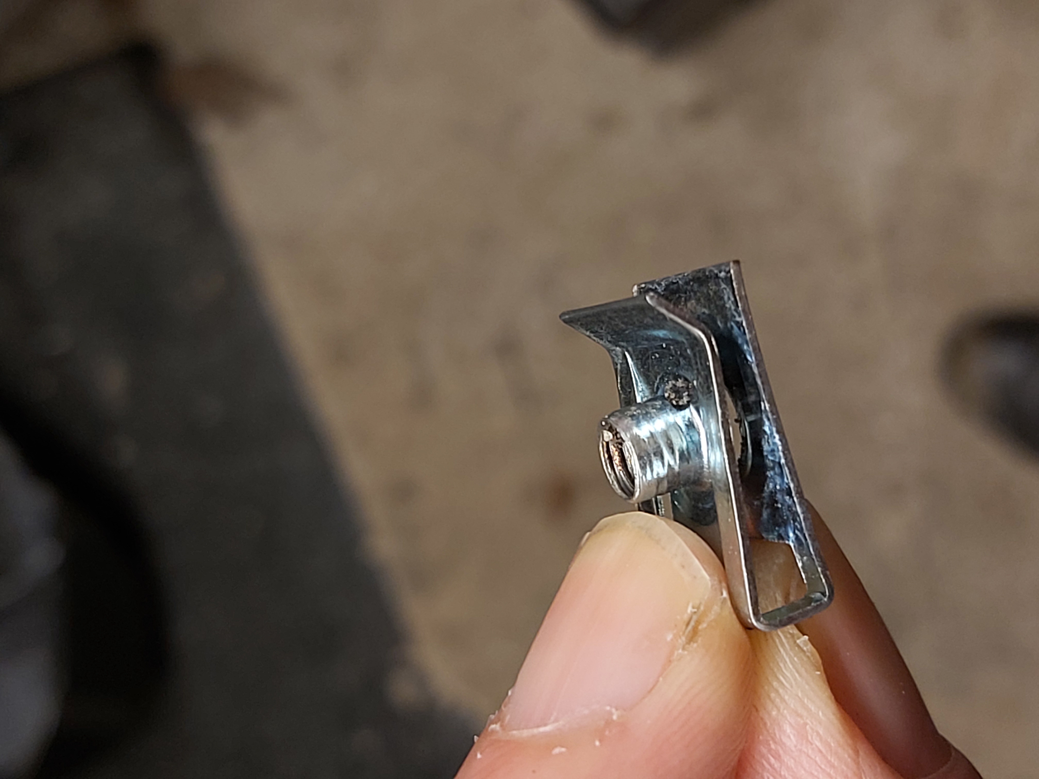

With all the gubbins off, I replaced the rusty self tappers and mild steel washers with captive M5 chimney nuts, stainless dome head allen screws and stainless washers.
Some of these washers have subsequently been chopped down to help fascia fitting.

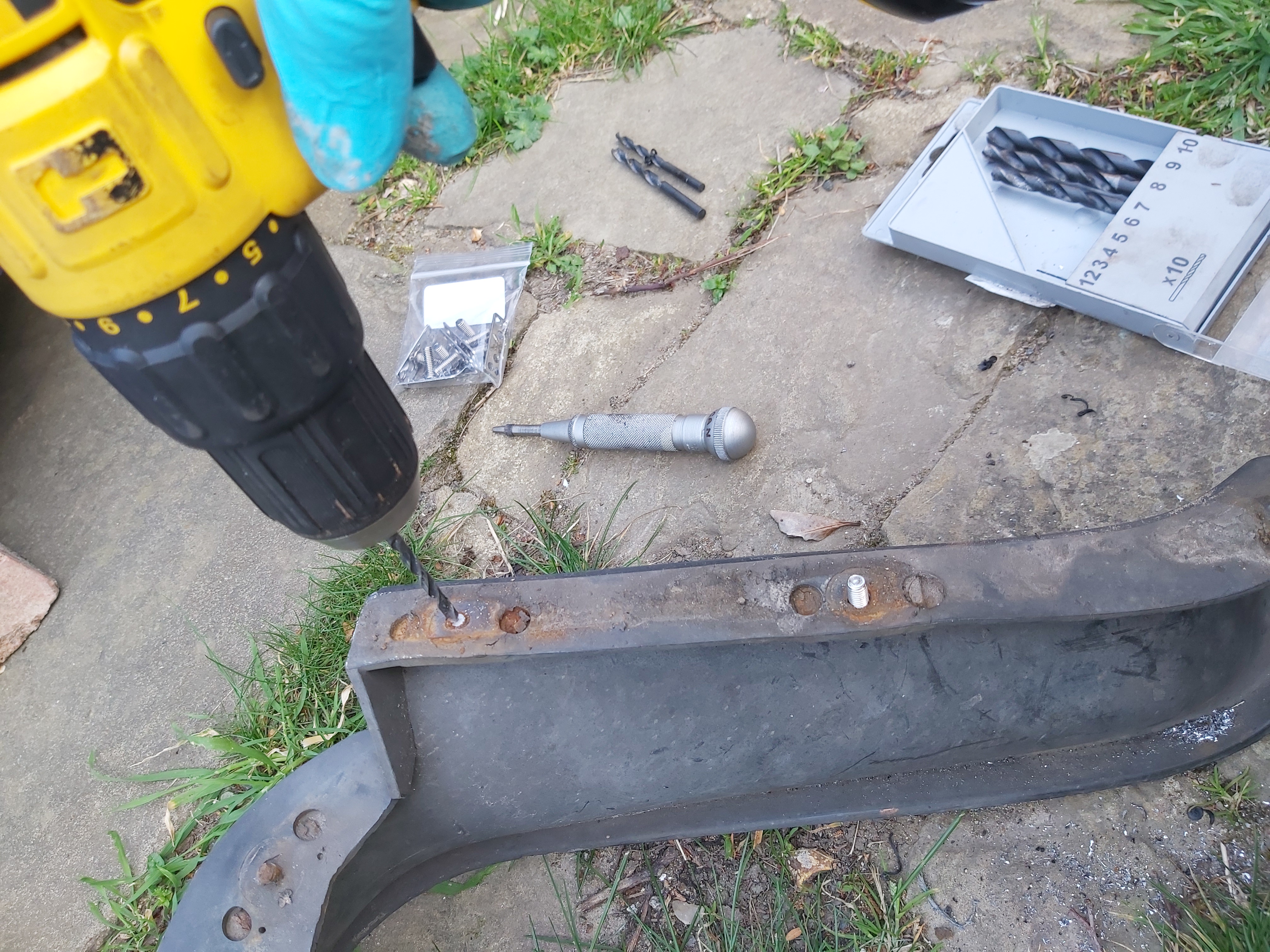

I have also been repairing the studs in the chin spoiler

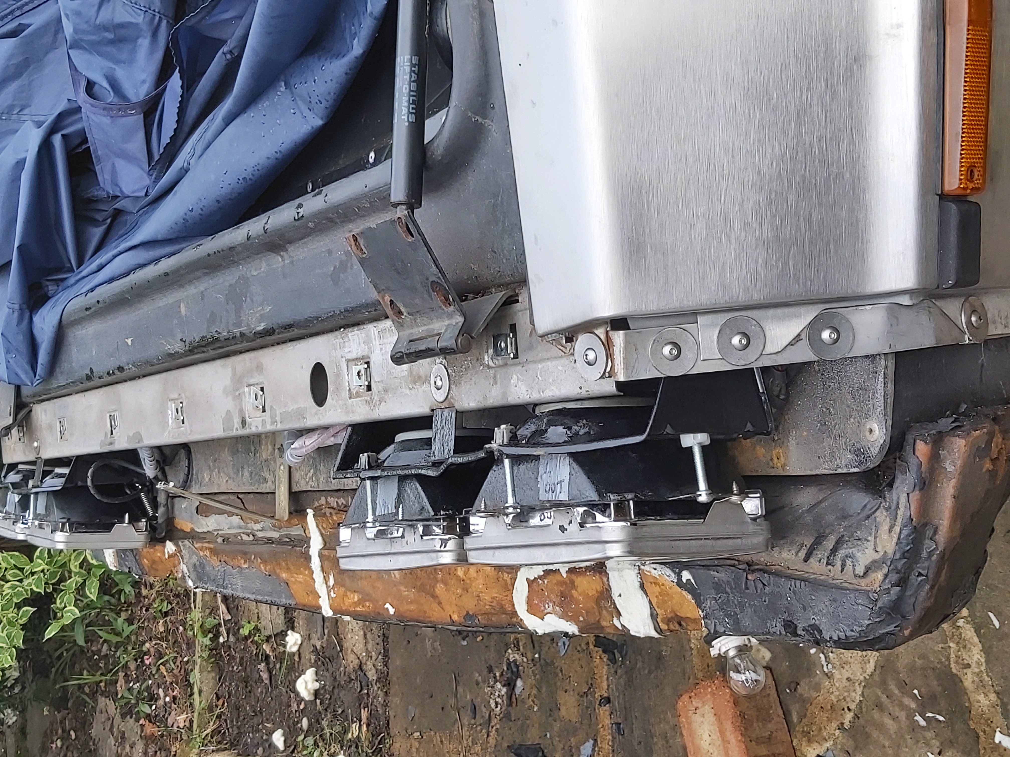

Thankfully the back is ok, and is probably about ready for paint. Lets see how all this pans out.
