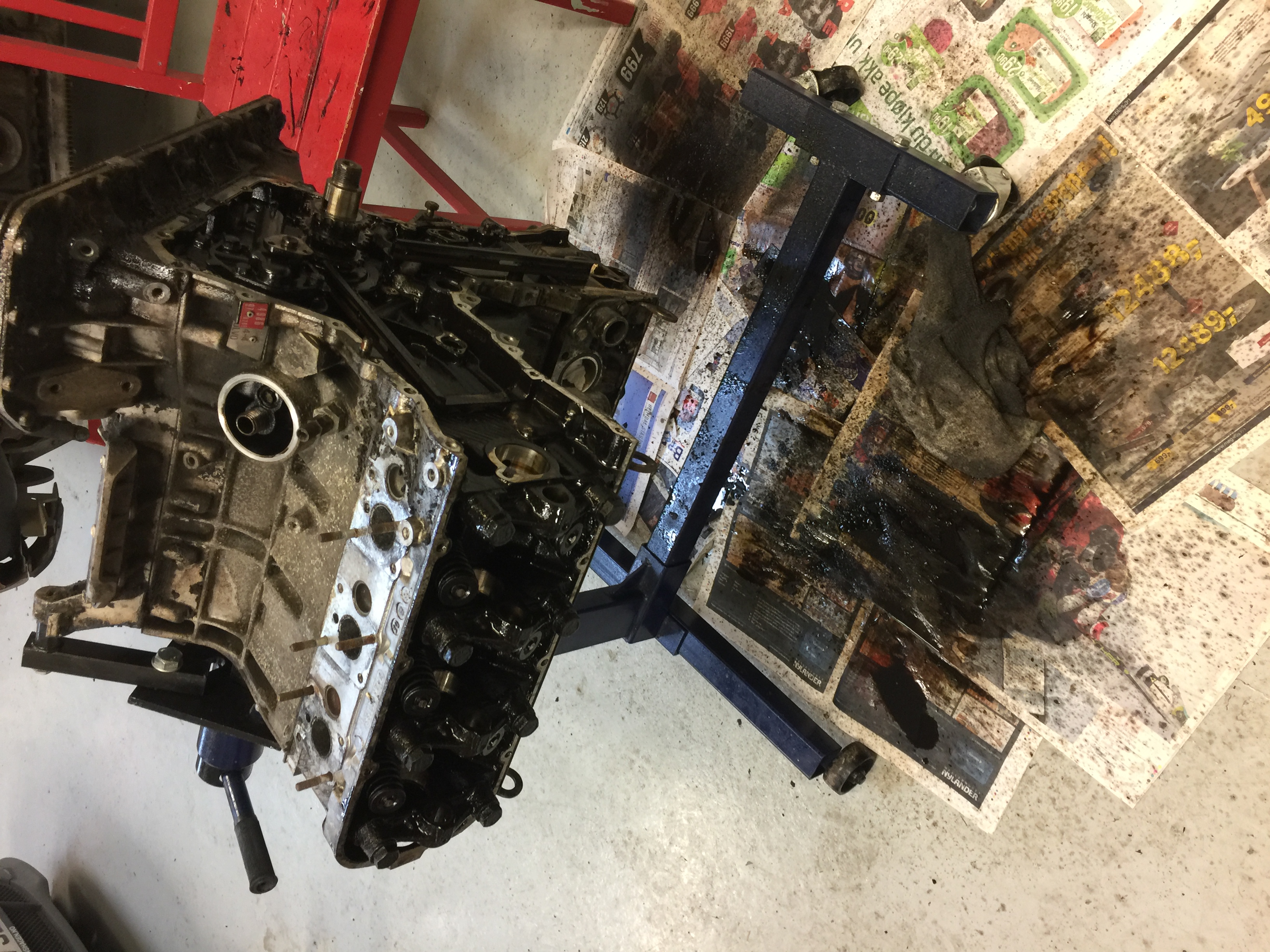

Postby gruffalo » Thu Mar 01, 2018 11:14 pm
I’m cleaning up as much as I can. Tedious work but it will pay off somehow I guess, hope.
Dirty work

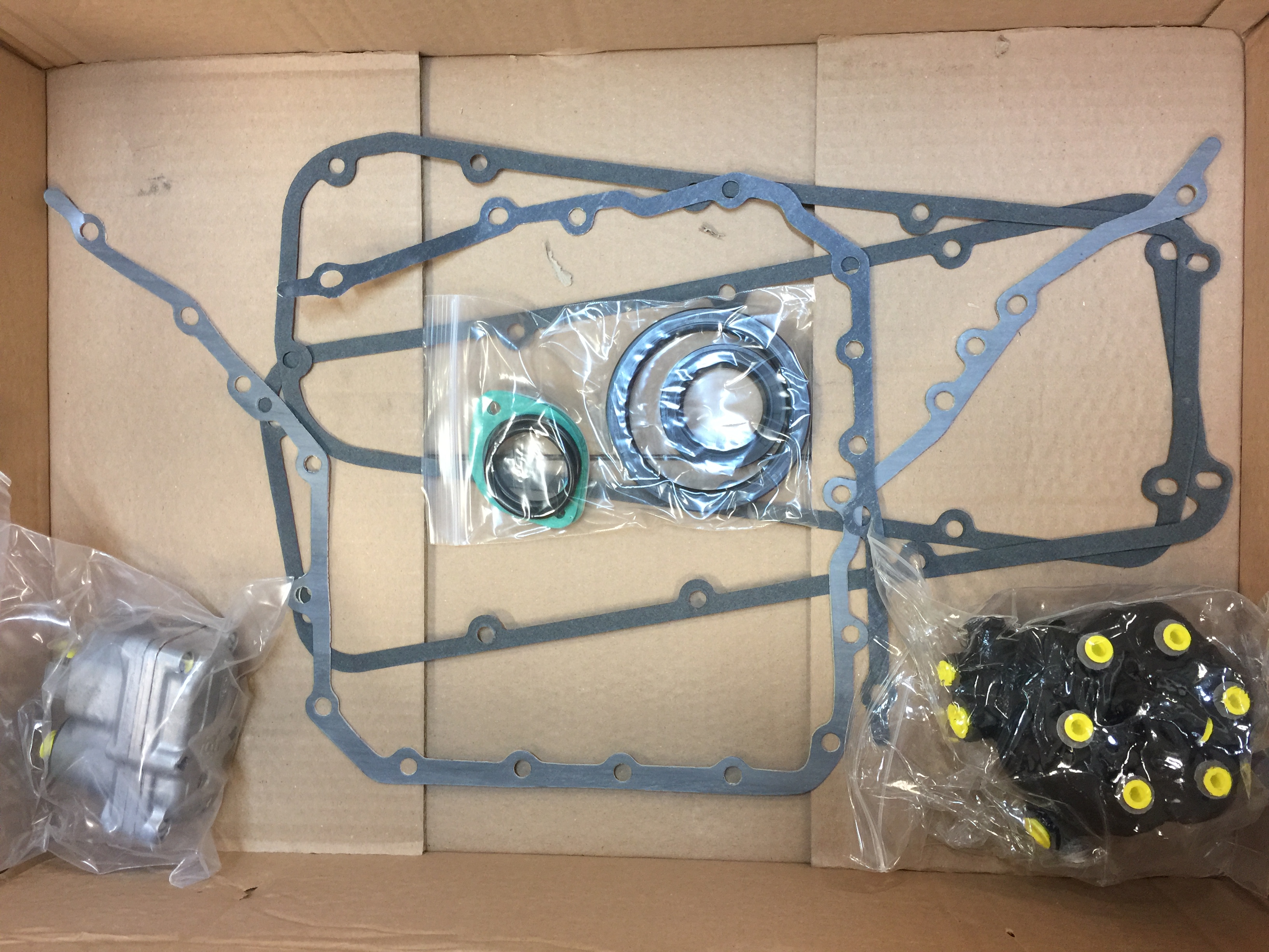

Postby gruffalo » Mon Mar 05, 2018 11:12 pm
Arran at Deloreango.com set me up with some great stuff for my Volvo B28E project. :)
Correct Volvo fueling parts

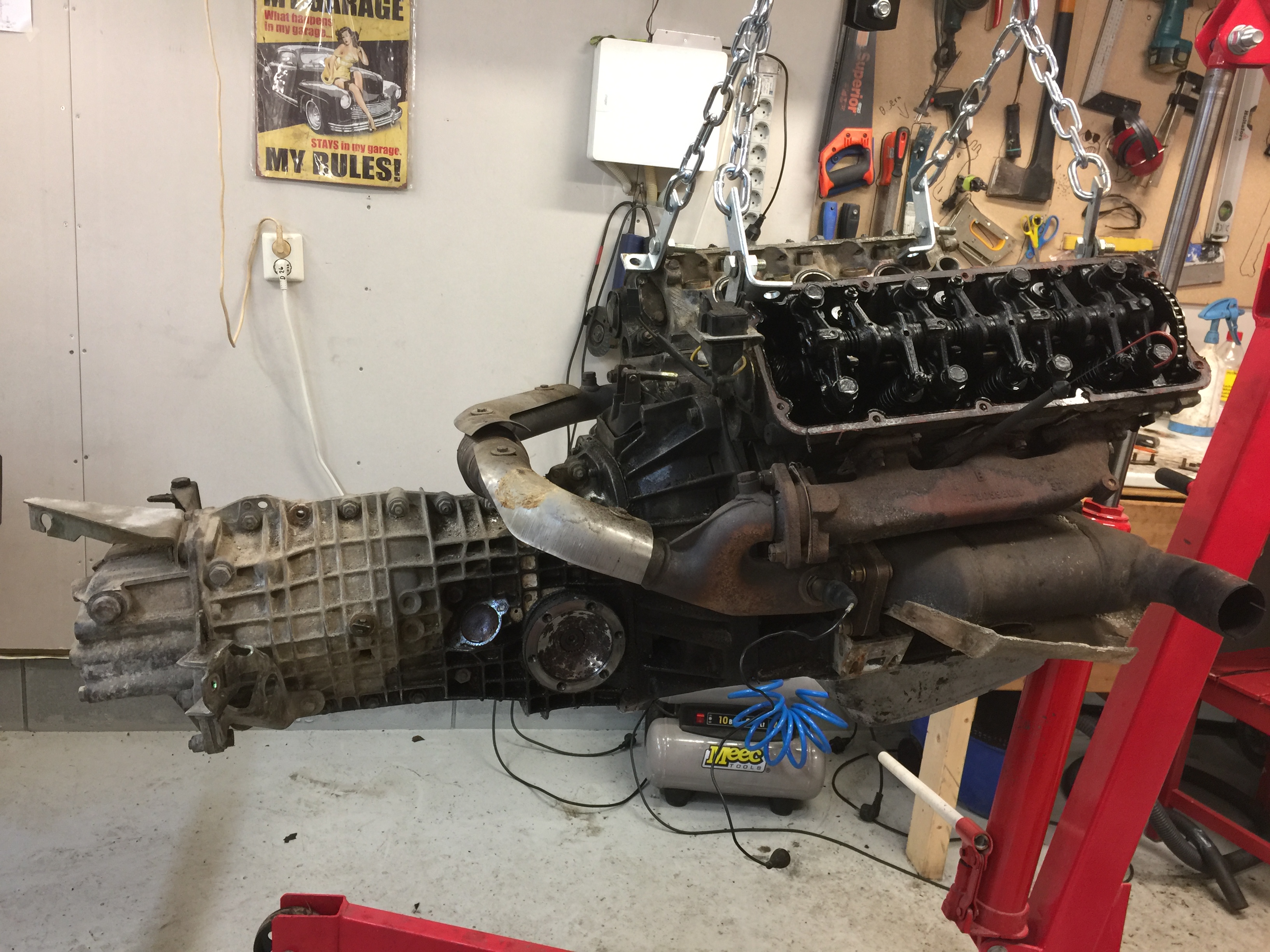

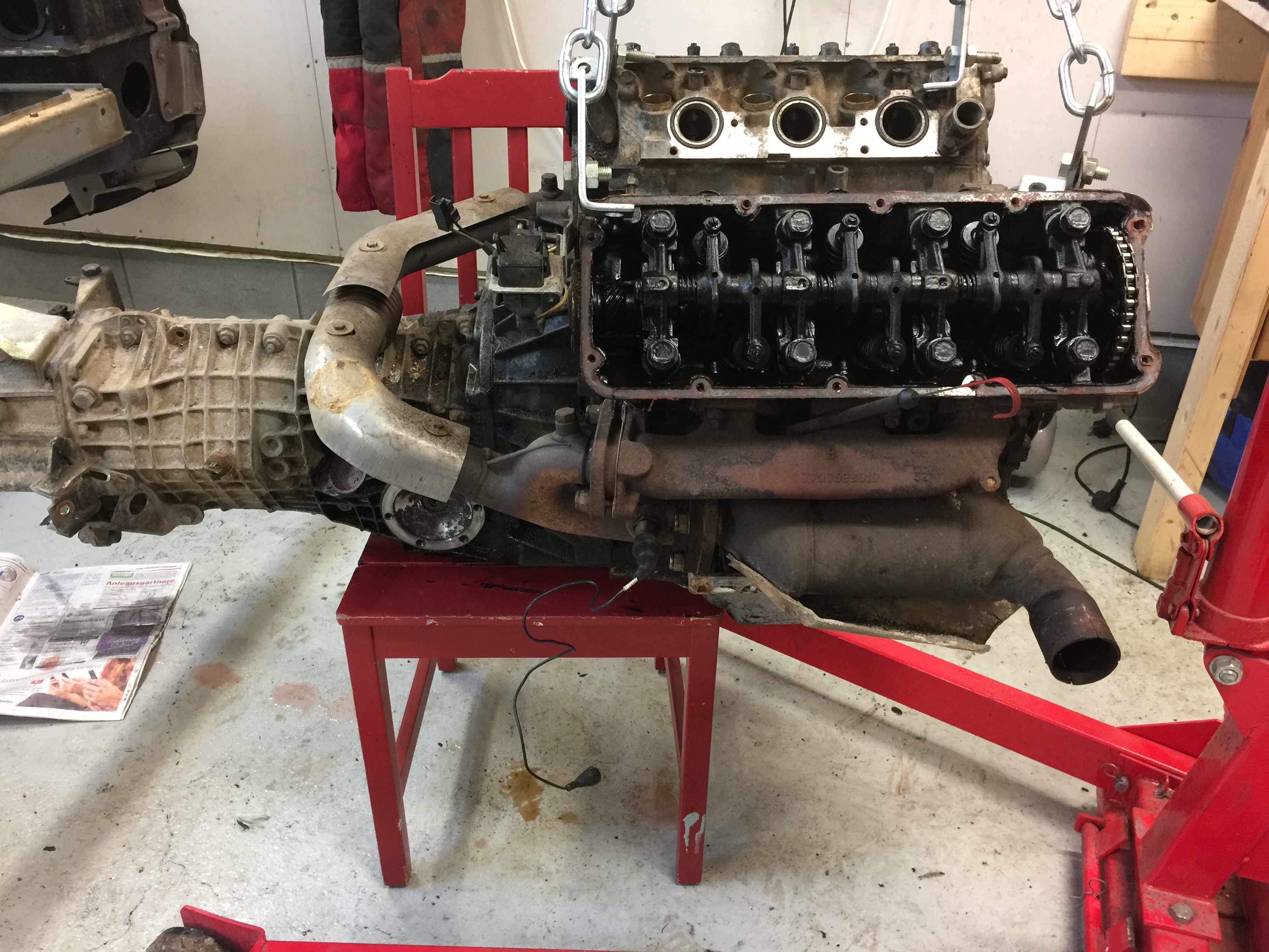

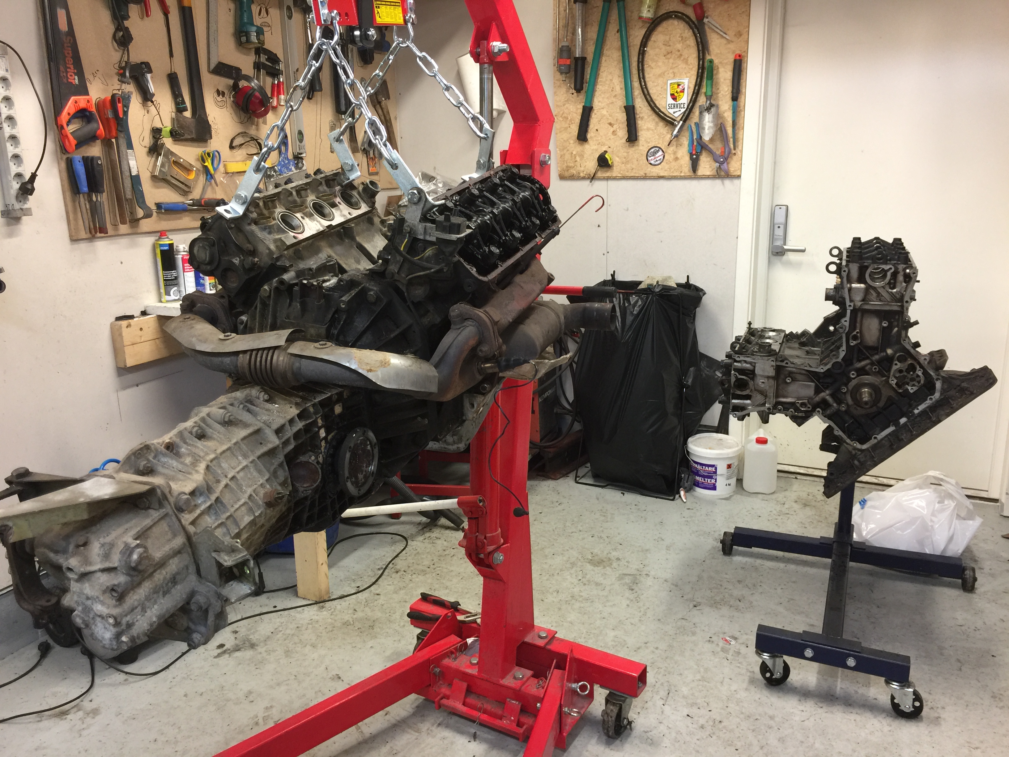

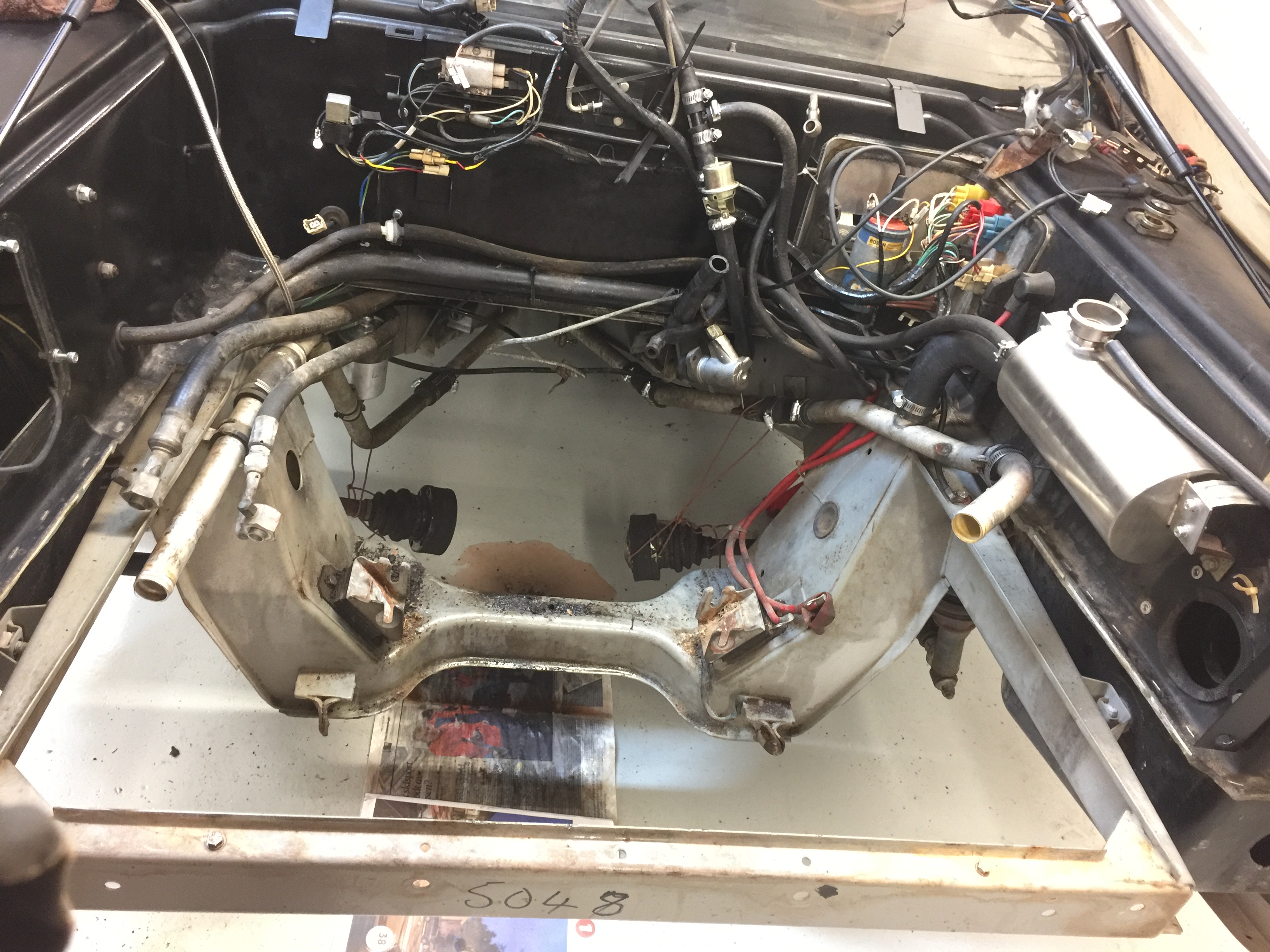

Postby gruffalo » Thu Mar 08, 2018 10:28 pm
It’s O-U-T !!!!
That went super smooth!!! Did it all by myself in no time. Had to undo the clutch line, and remove the engine cover. Otherwise smooth sailing. The rest is gonna be great fun :)
Void
Both lumps
Hovering
Resting on an ikea chair
