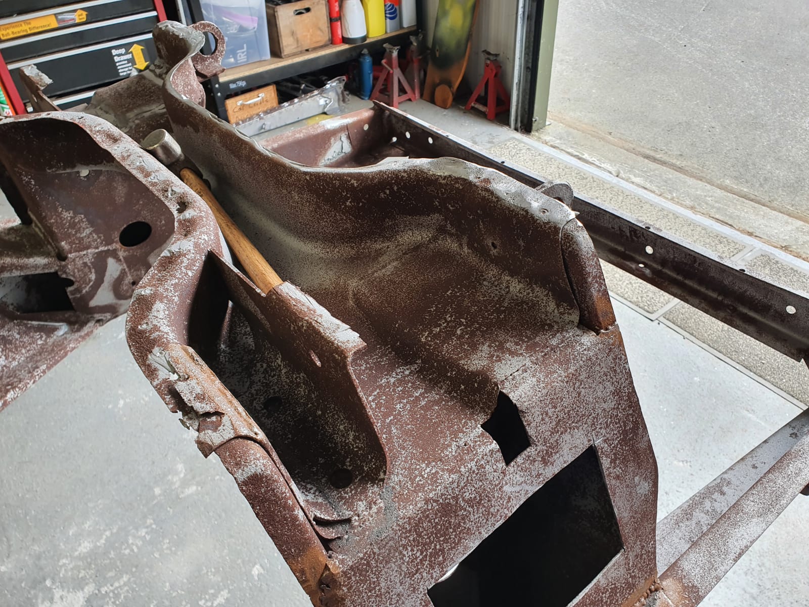

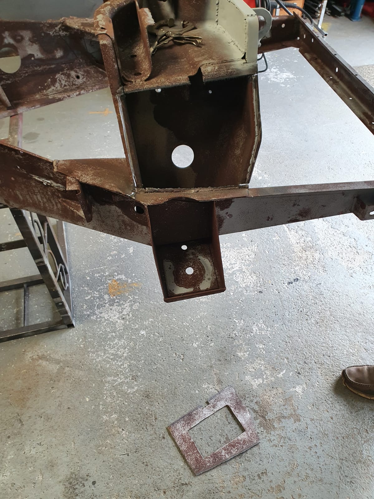

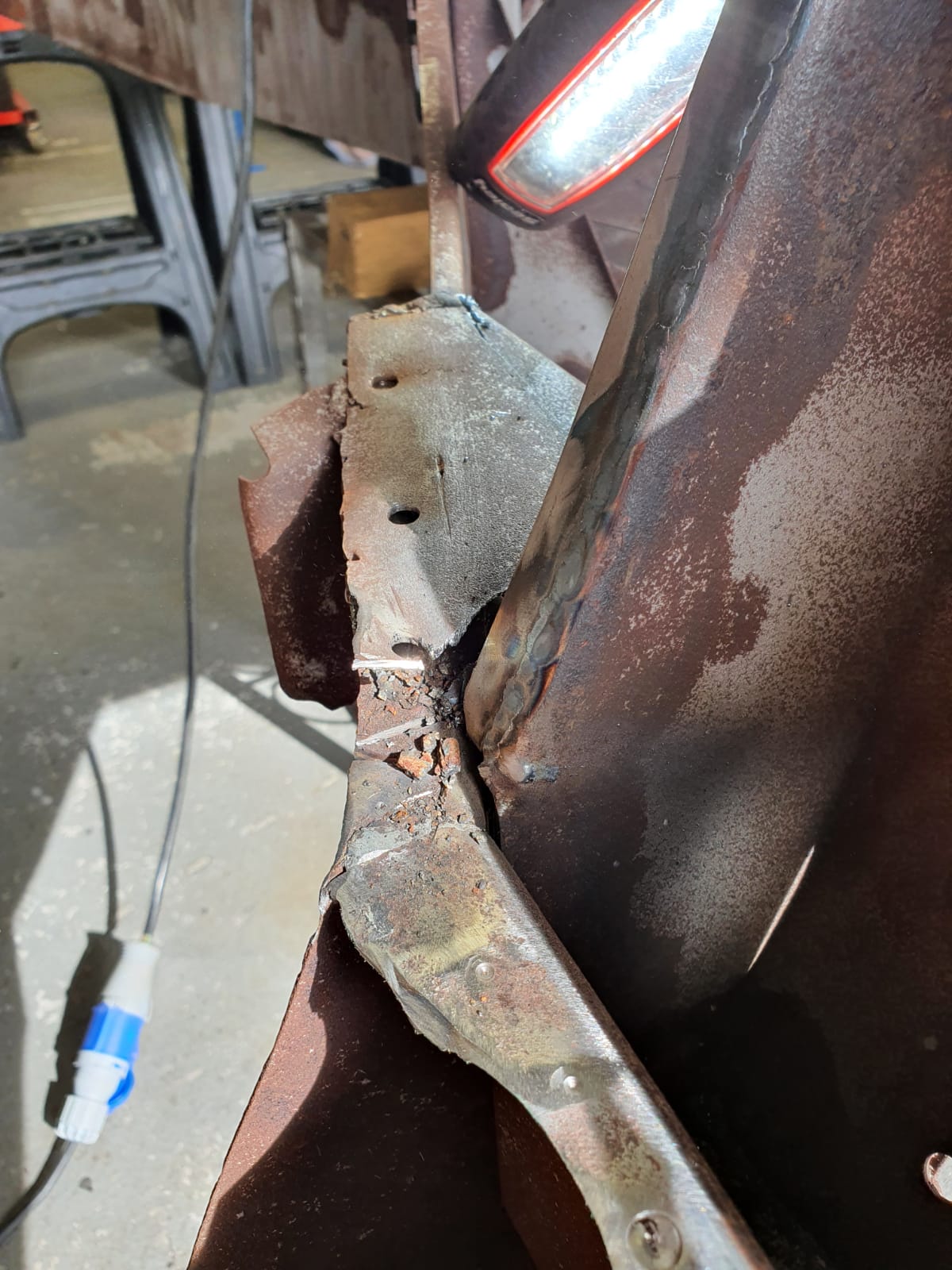

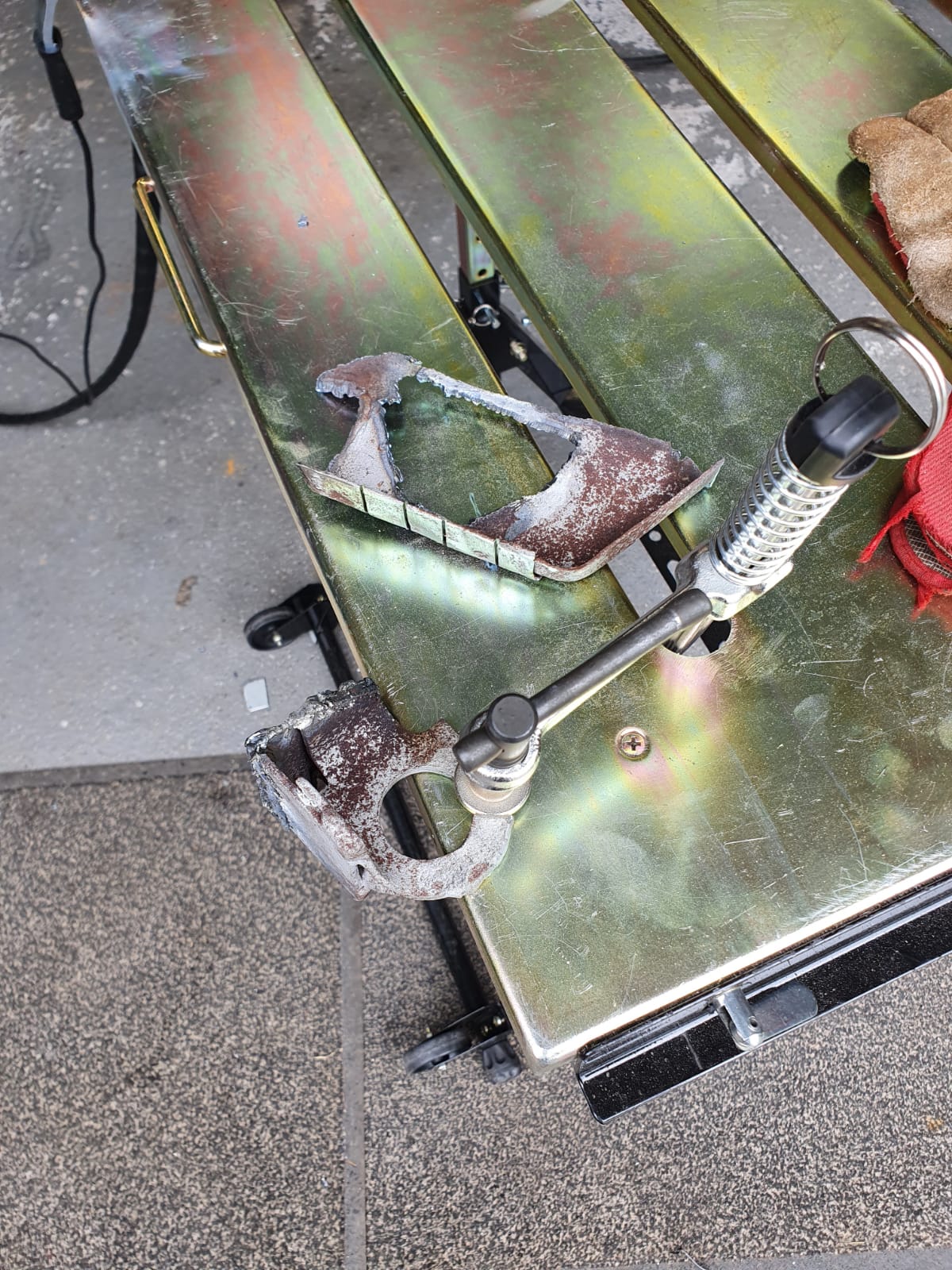

Postby cis6409 » Tue Dec 22, 2020 9:10 pm
The rear towing hooks were filled with rust sandwich, I think I'll be using that word alot now lol

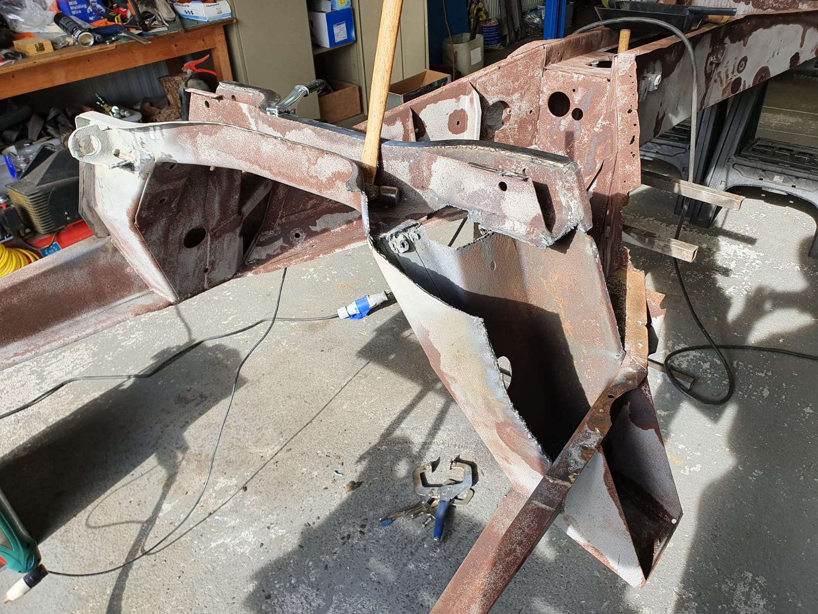

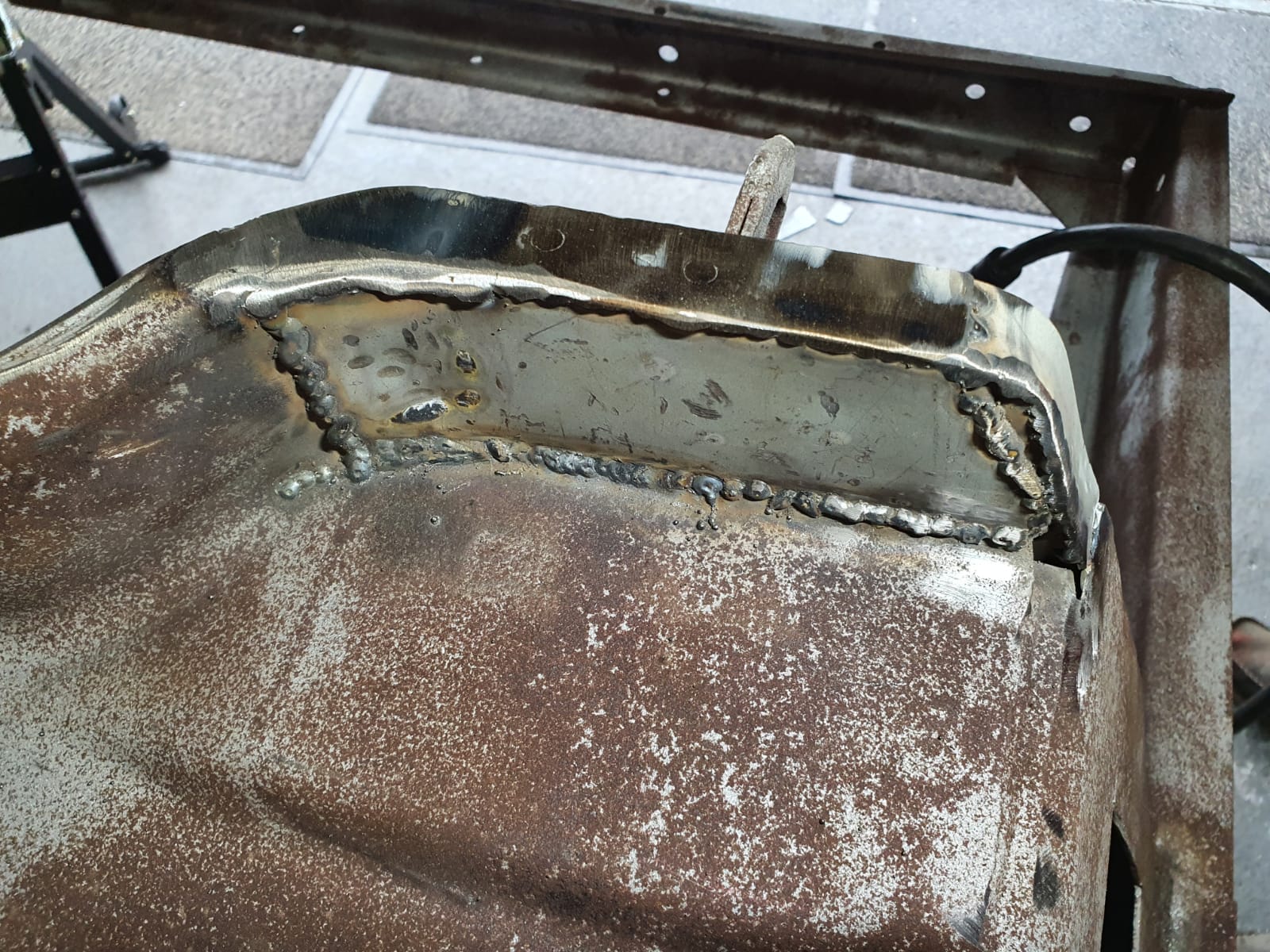

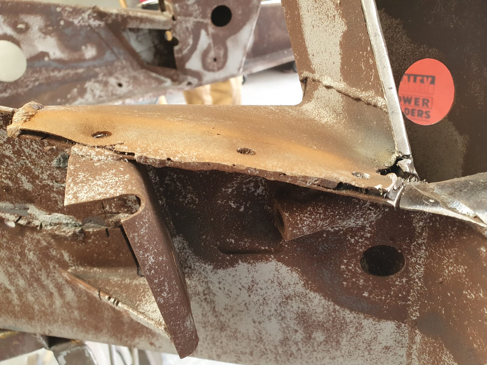

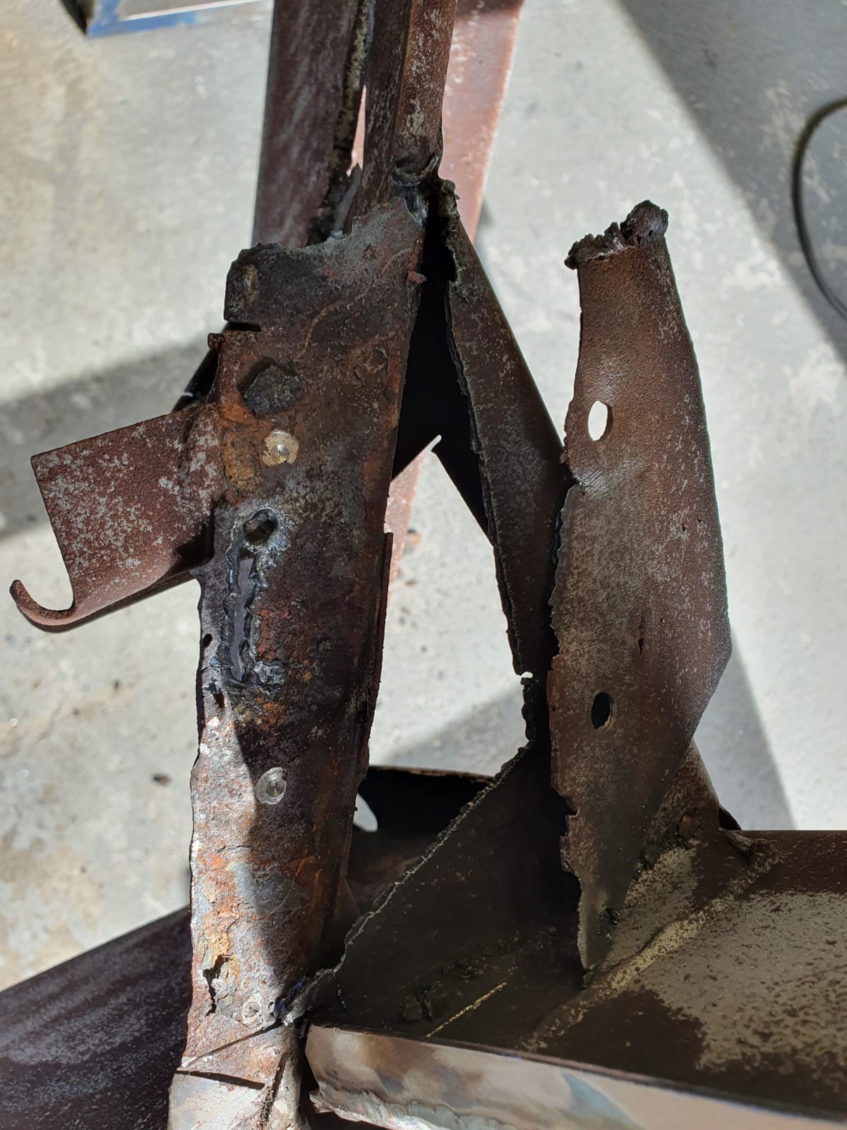

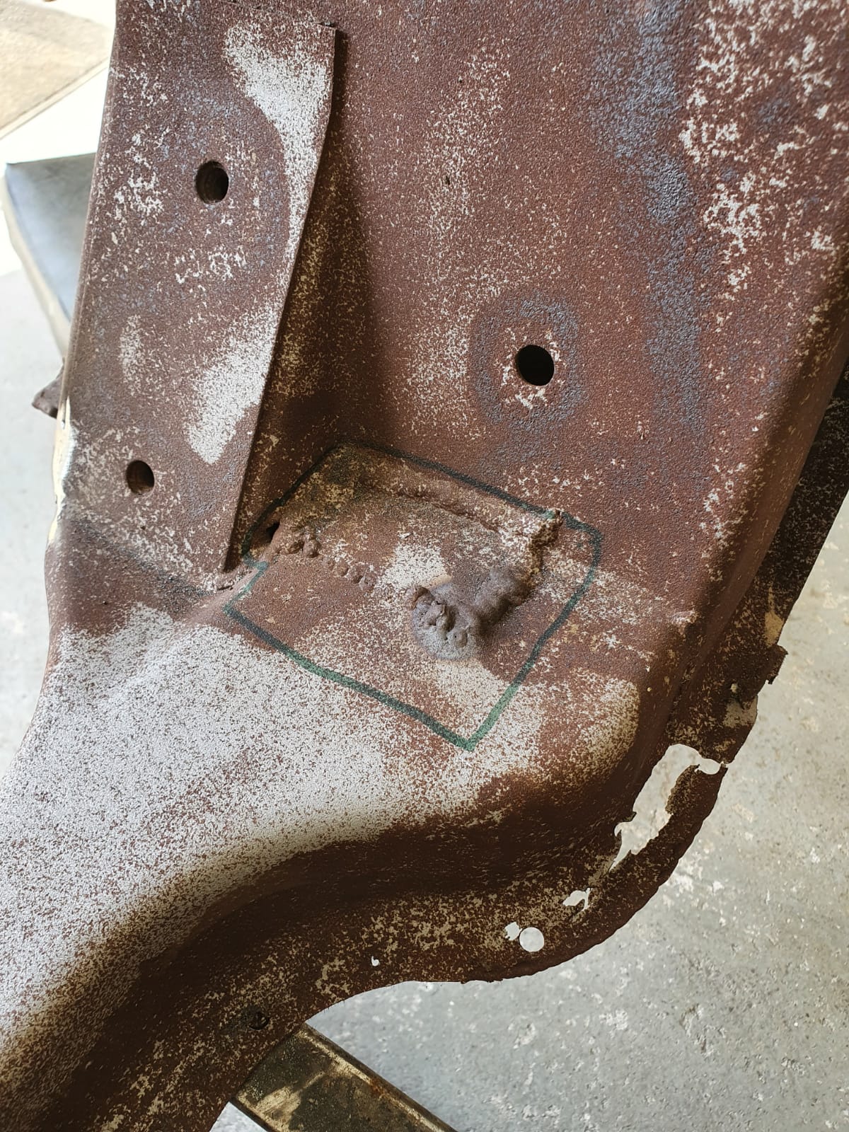

Postby cis6409 » Tue Dec 22, 2020 9:13 pm
Some more previous repair patches

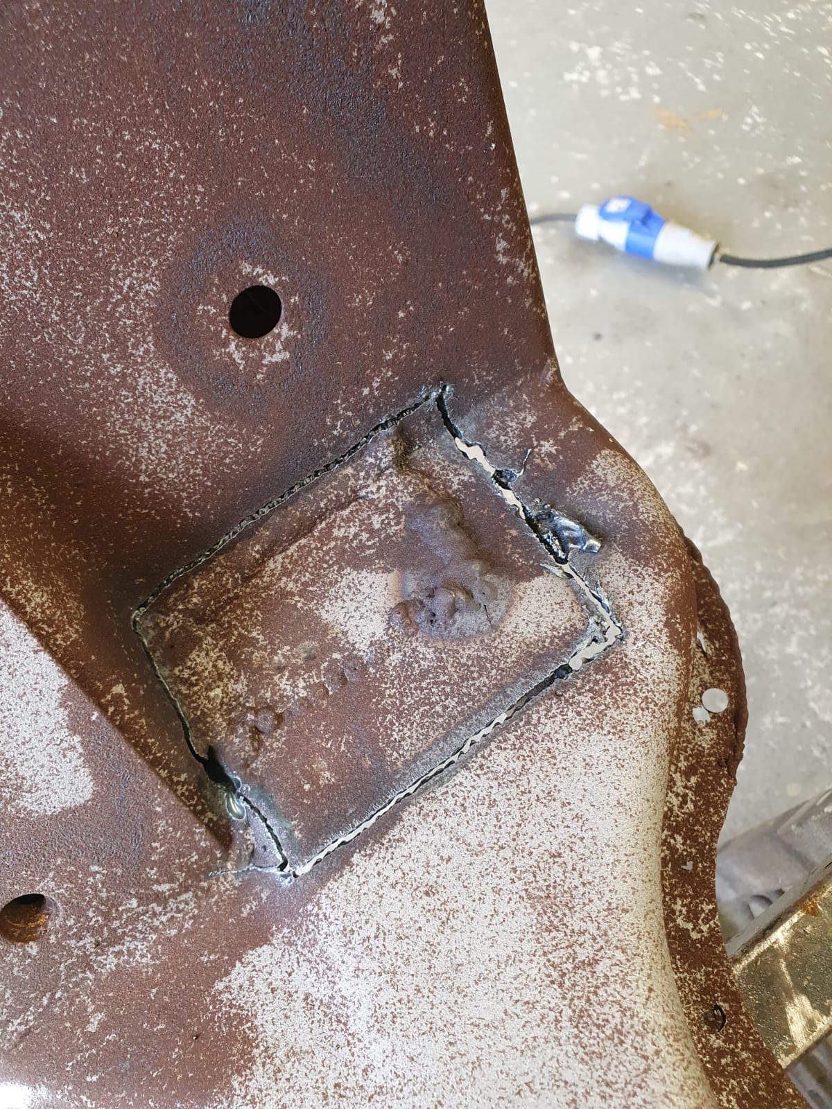

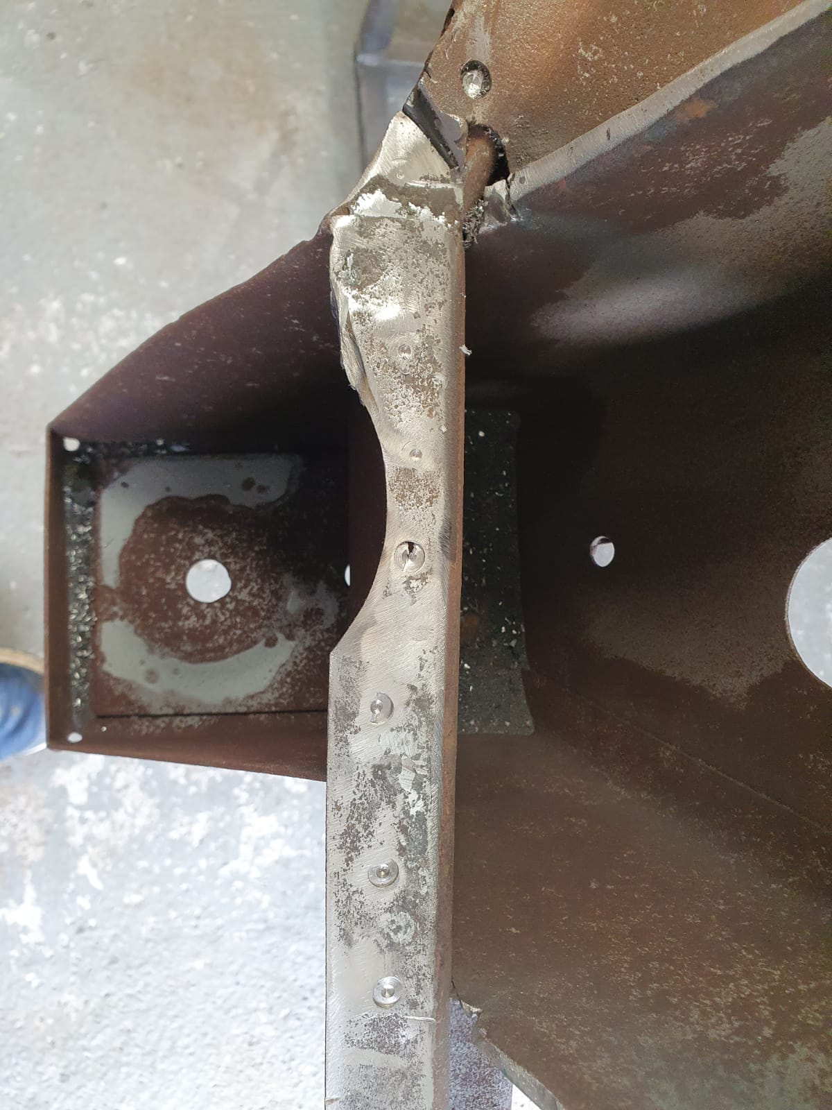

Postby cis6409 » Tue Dec 22, 2020 9:32 pm
More

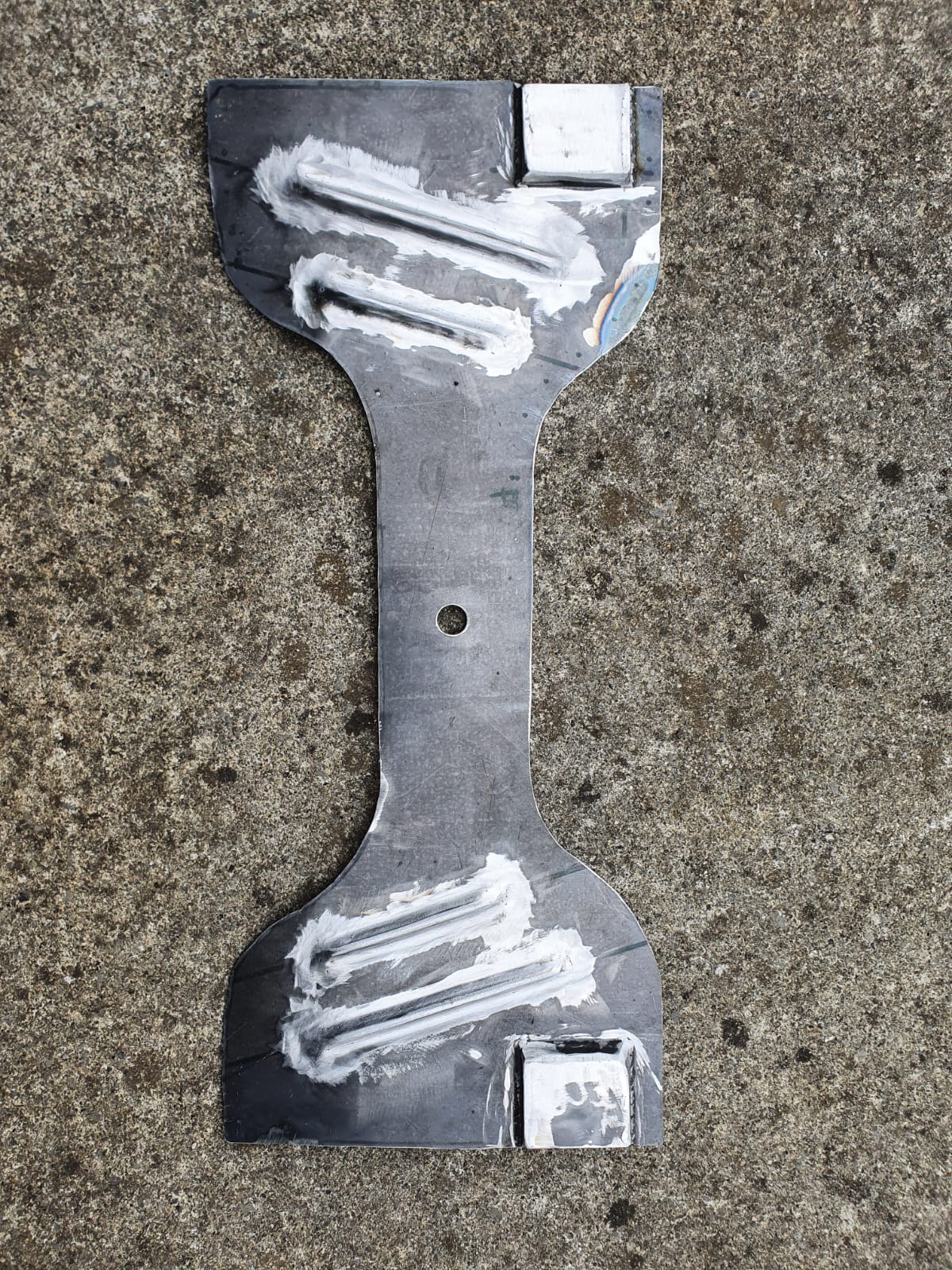

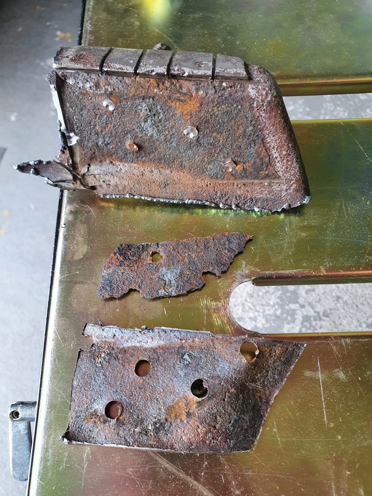

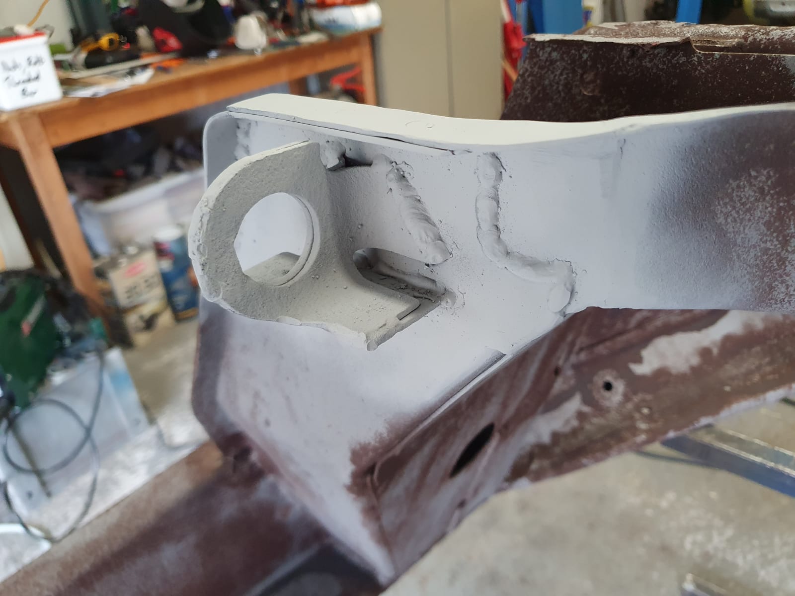

Postby cis6409 » Tue Dec 22, 2020 9:43 pm
Decided to remake the dog bone rather than repair the old one

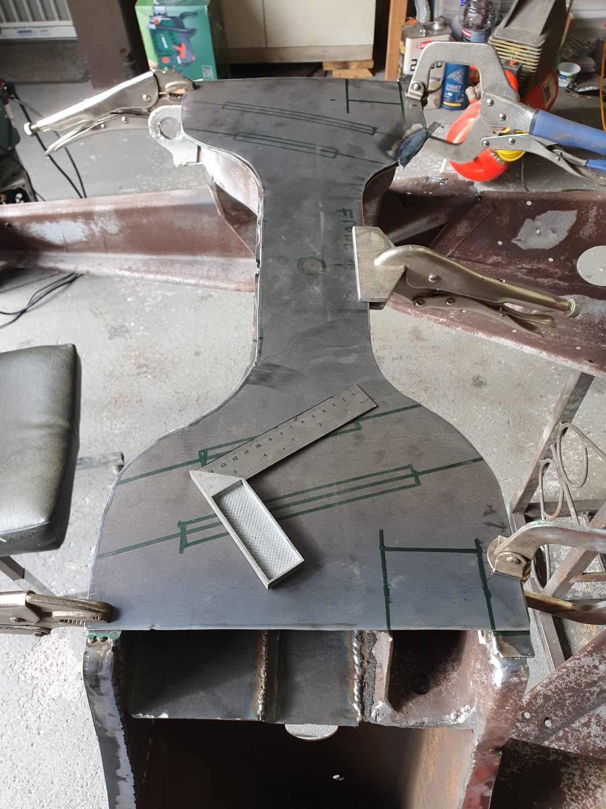

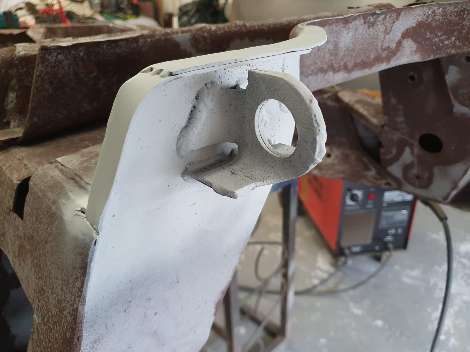

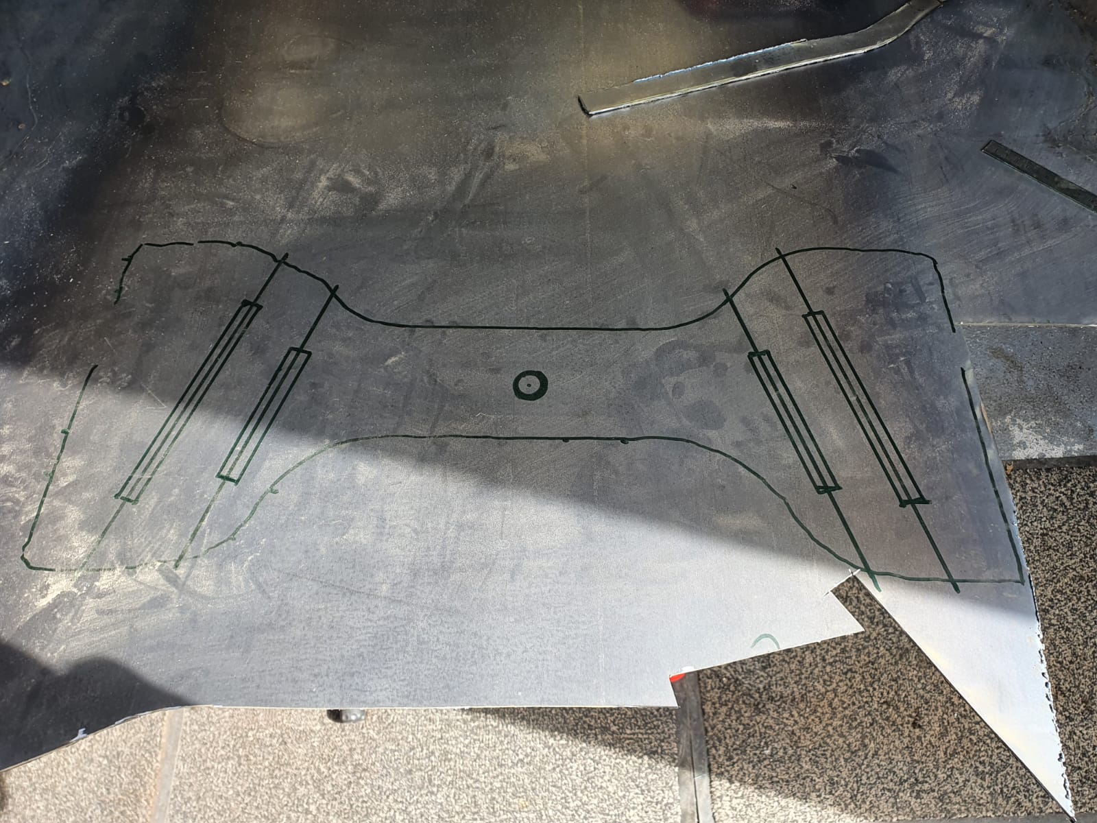

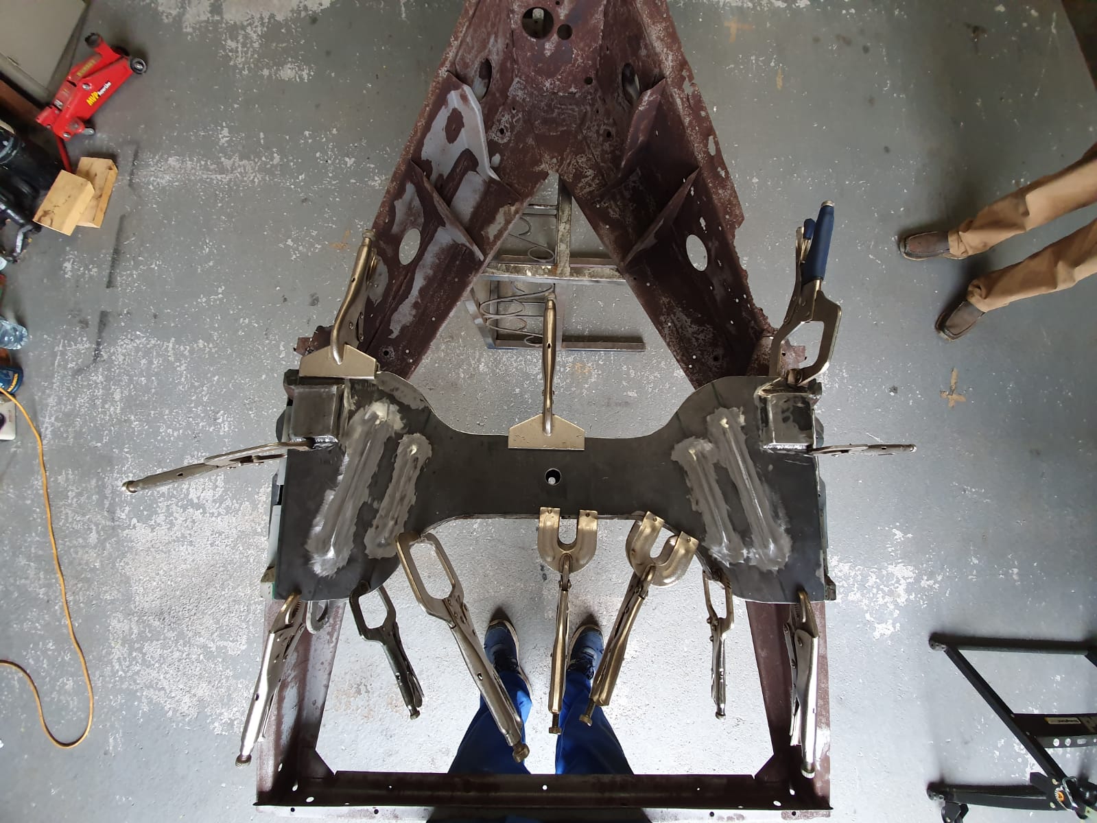

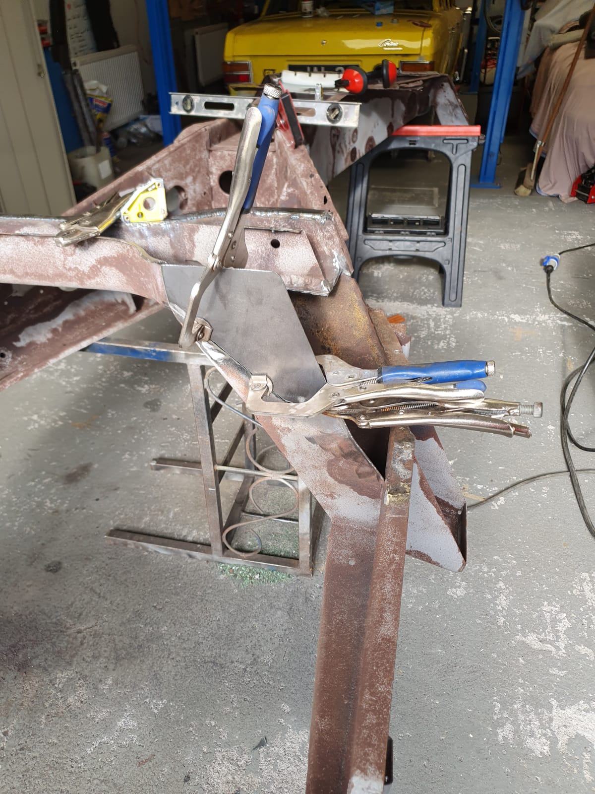

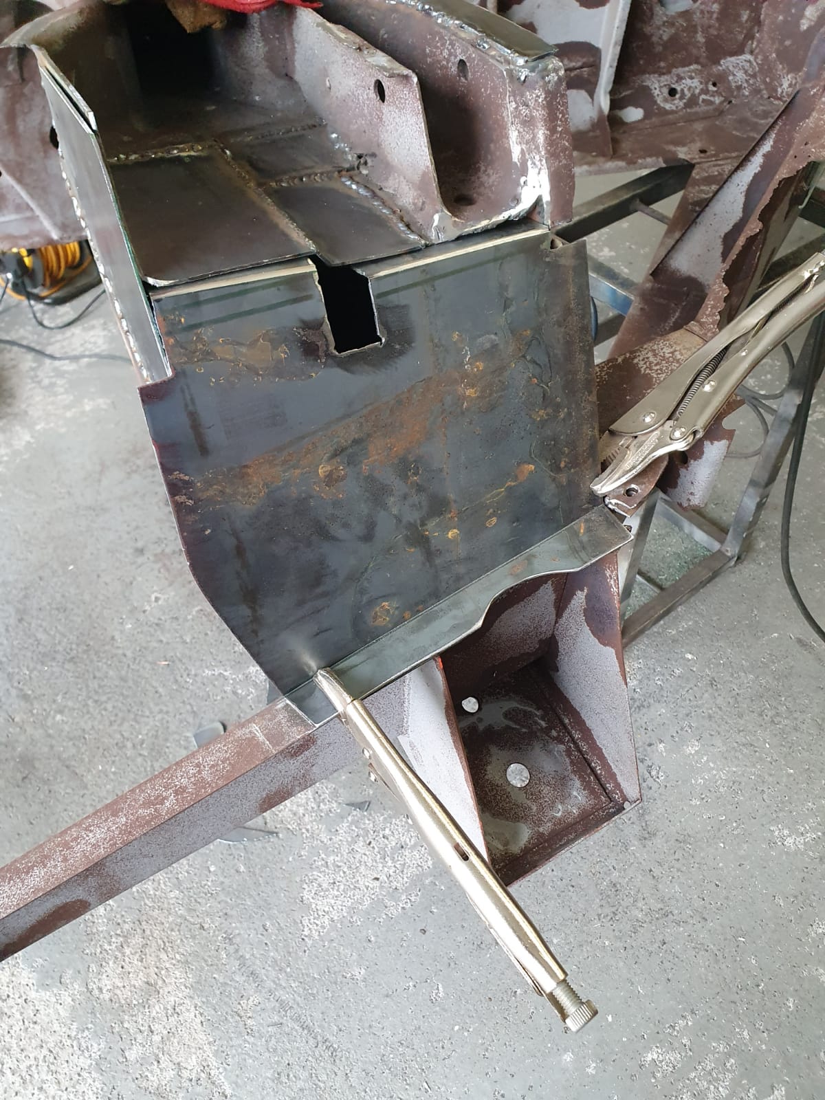

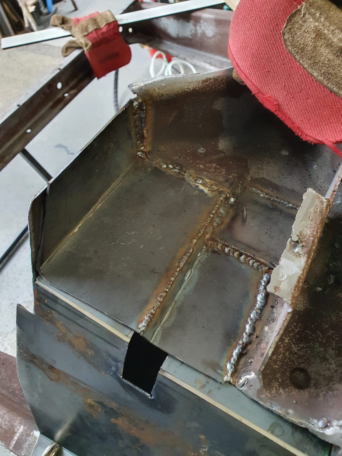

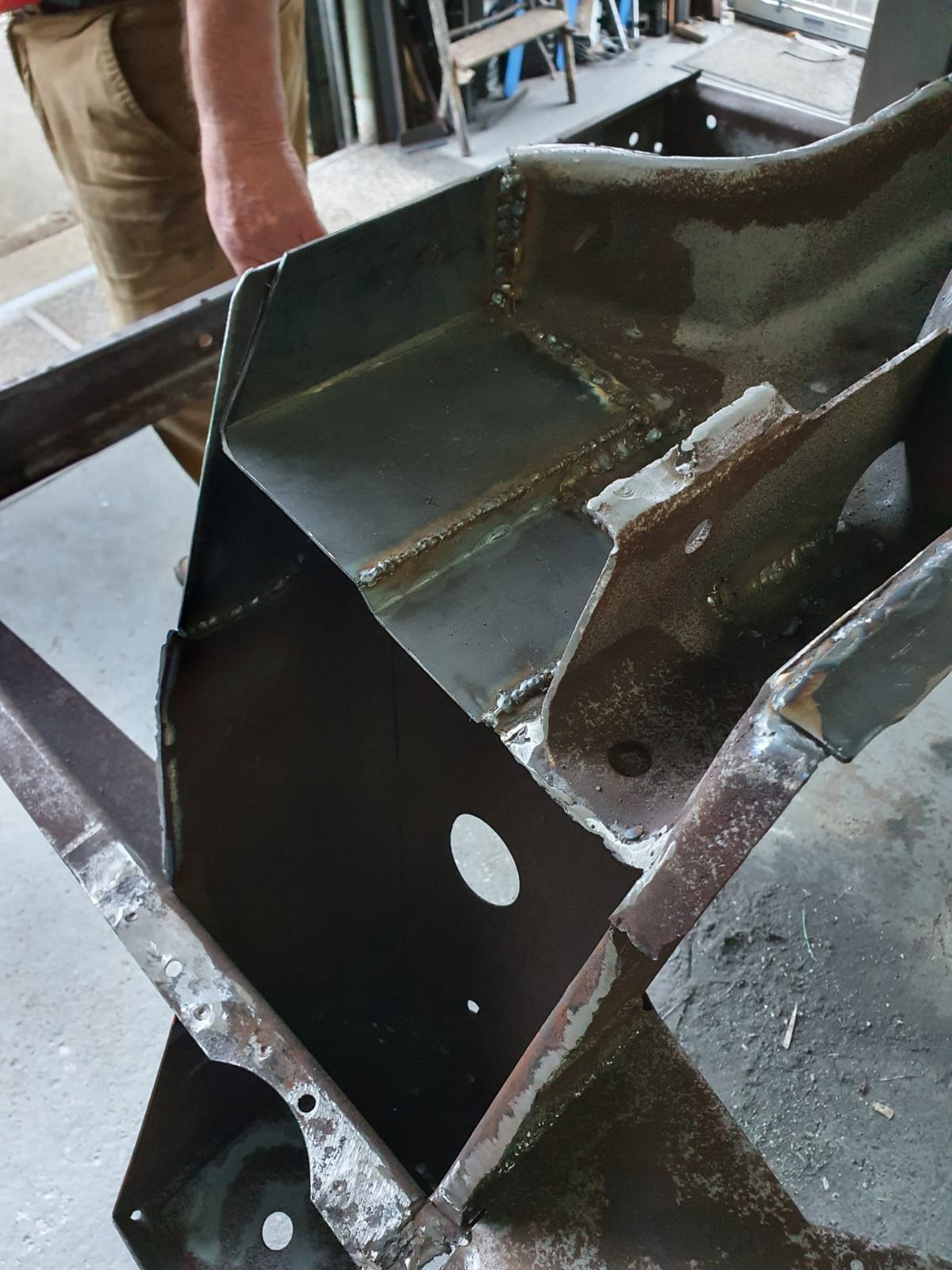

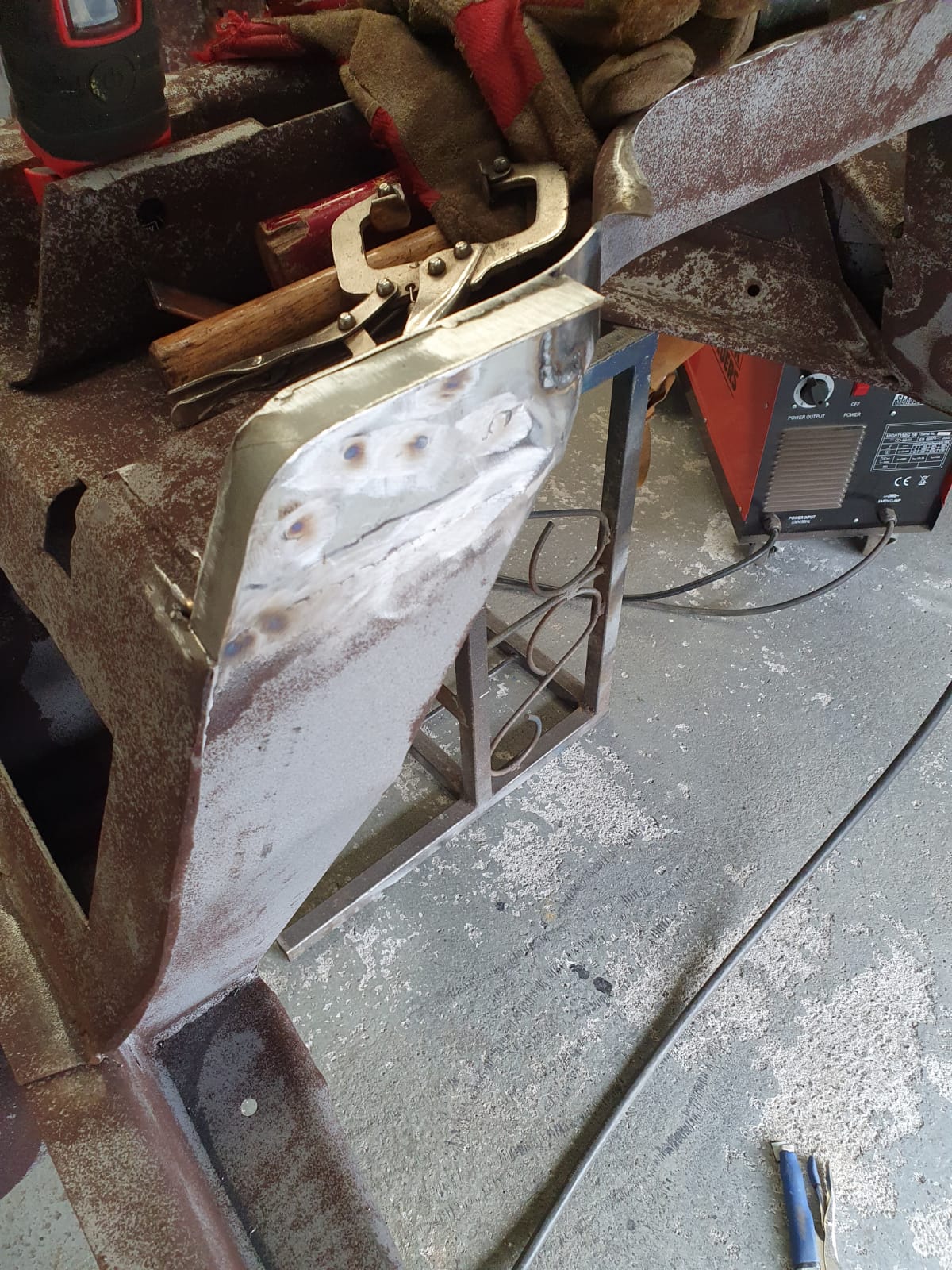

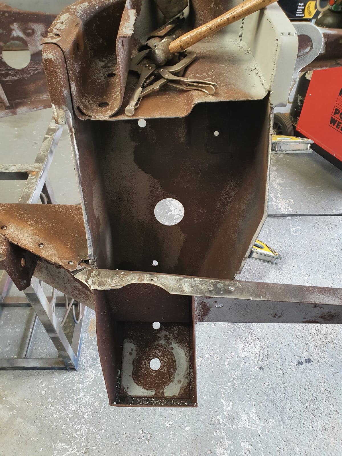

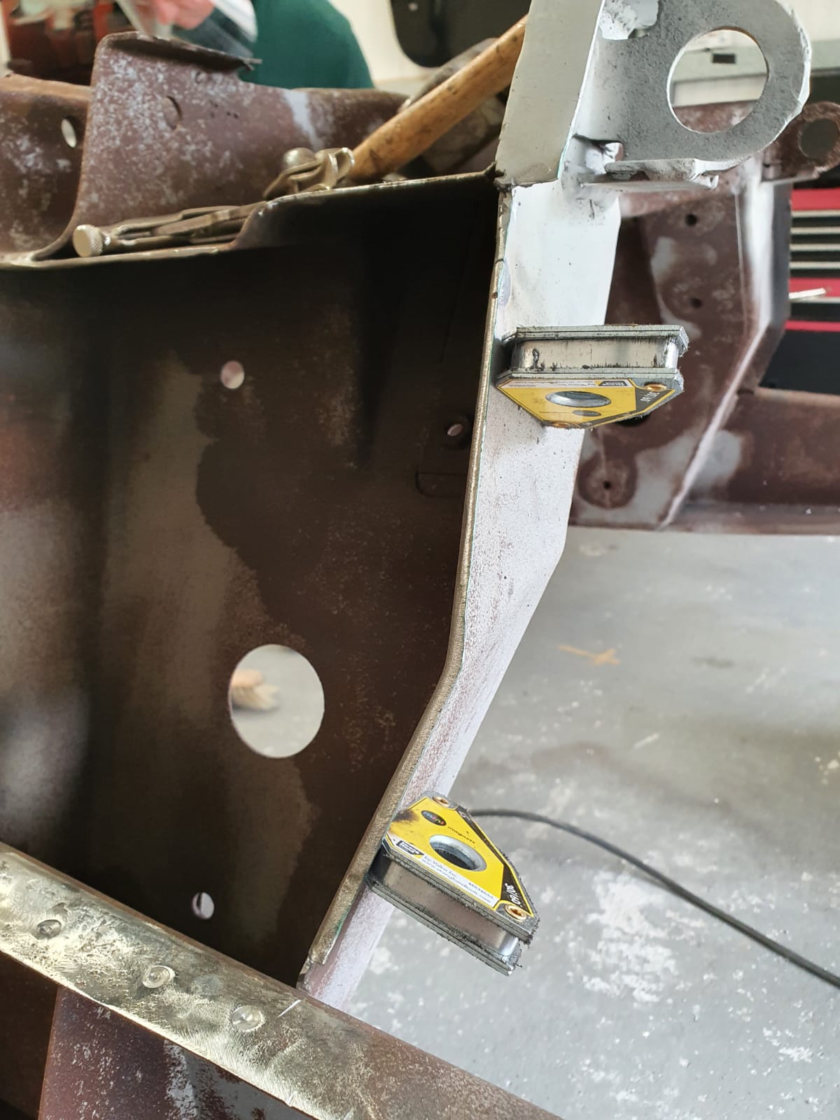

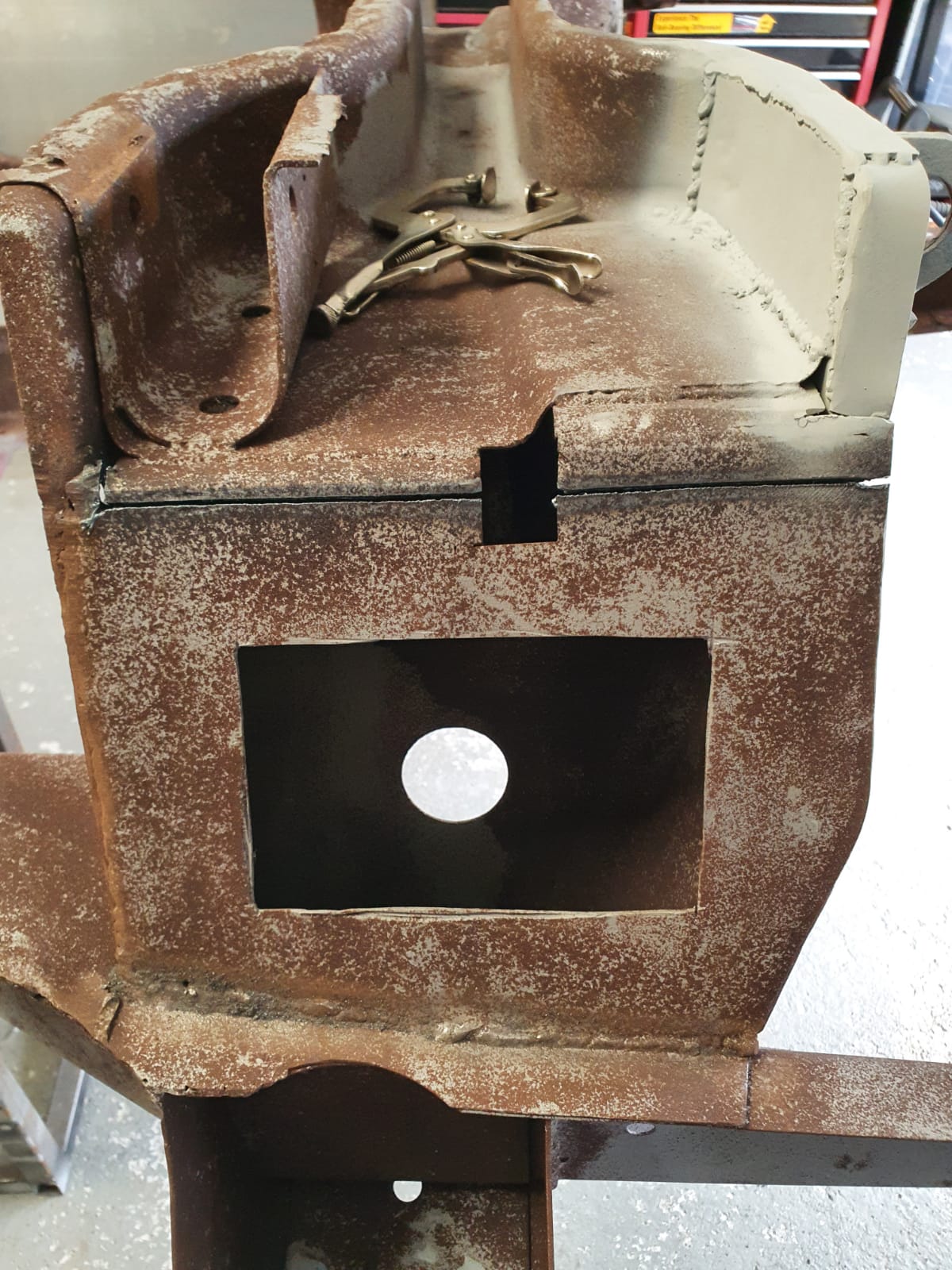

Postby cis6409 » Wed Dec 23, 2020 11:50 pm
Onto one of the biggest rust sections yet, the doubler plate on both sides of the rear ' y '. Thought the drivers side at first would only need to be replaced but on further inspection passenger side wasn't far behind. So both were re fabricated.
The sandwich filling had extended behind the trailing arm bracket mounts and the rear turrets for the gearbox mounts.
Starting to see progress turning a corner a wee bit and keep spirits up for Nicky ;)
Seeing the work skill and fabrication up close really makes it clear how hard it is and the time it takes :shock:
Hats off to Alex and anyone else that has/ done this type of work :jzd:
