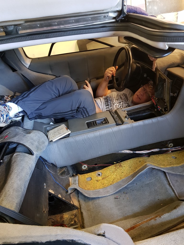

As for removal Rissy, there should be enough movement in the brake lines for you to be able to unbolt the master cylinder off the servo and then as you say you can unbolt the whole thing bracket included from inside the tub, this is made a little easier if the seat is taken out, you still have to lay upside down in the footwell to get it out though... like this ... lol

picture courtesy of gem ;) :dance:

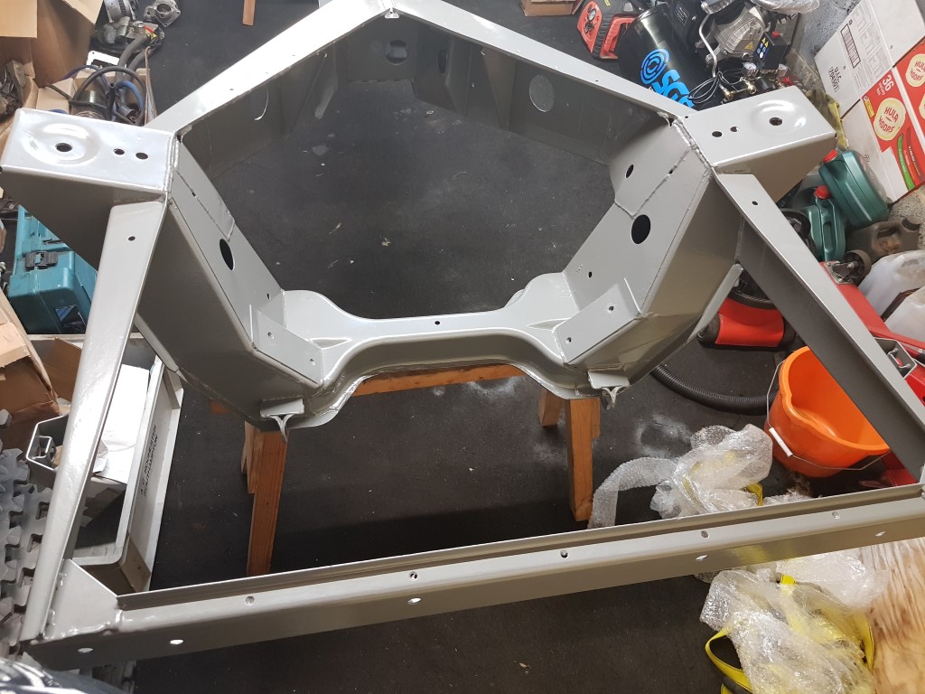

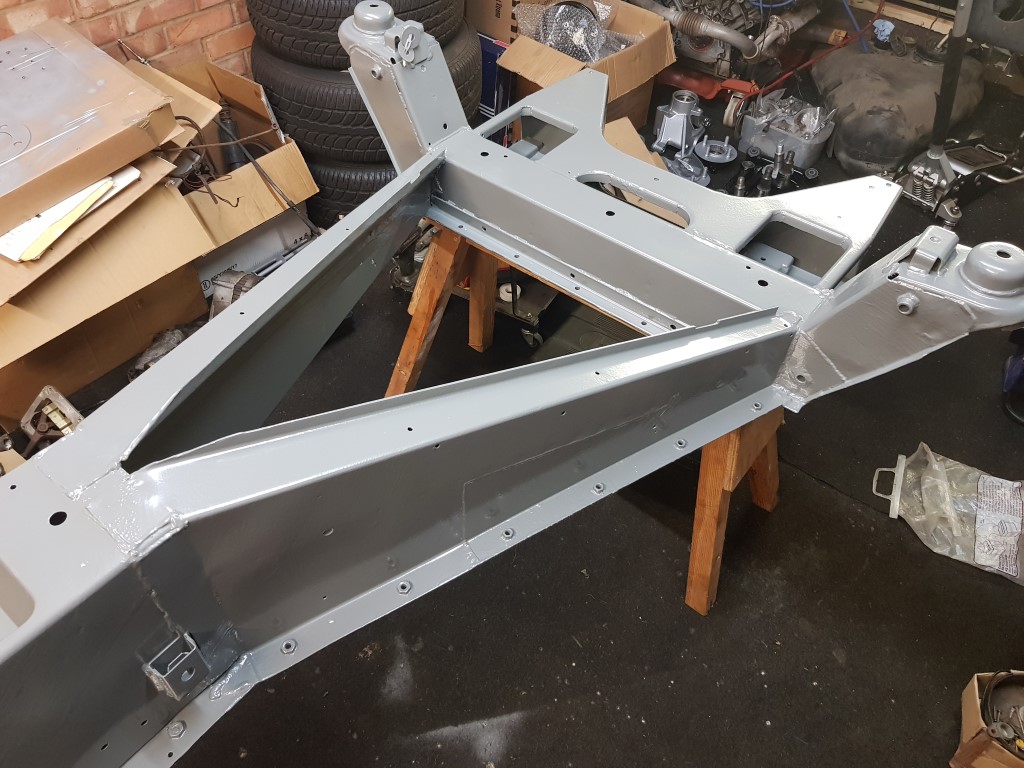

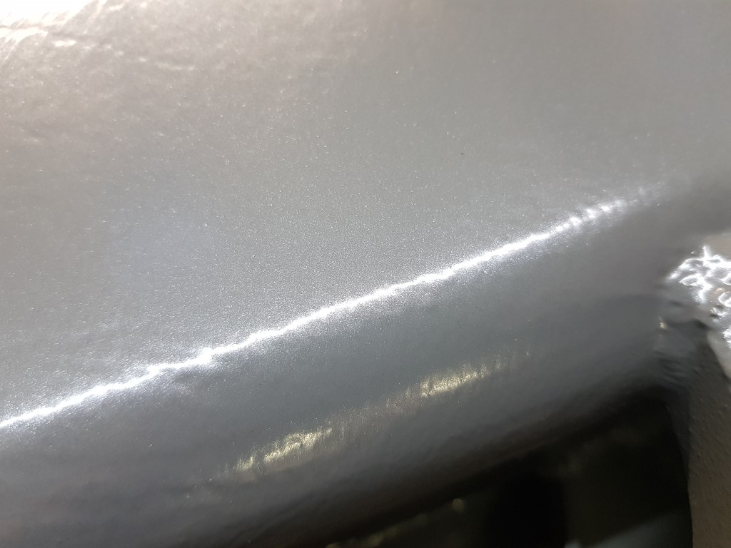

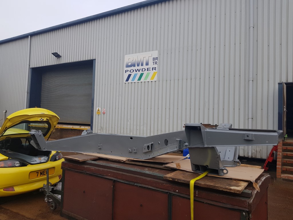

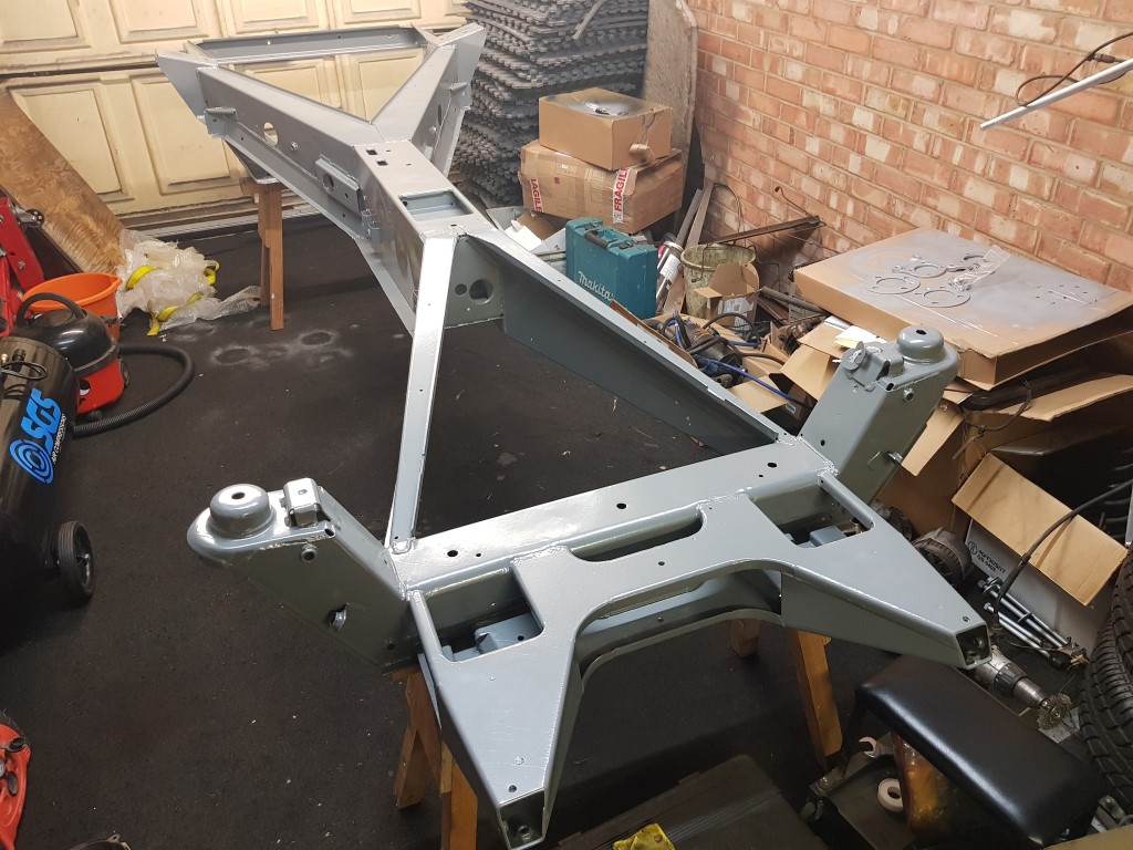

Hi All
Its that time again !

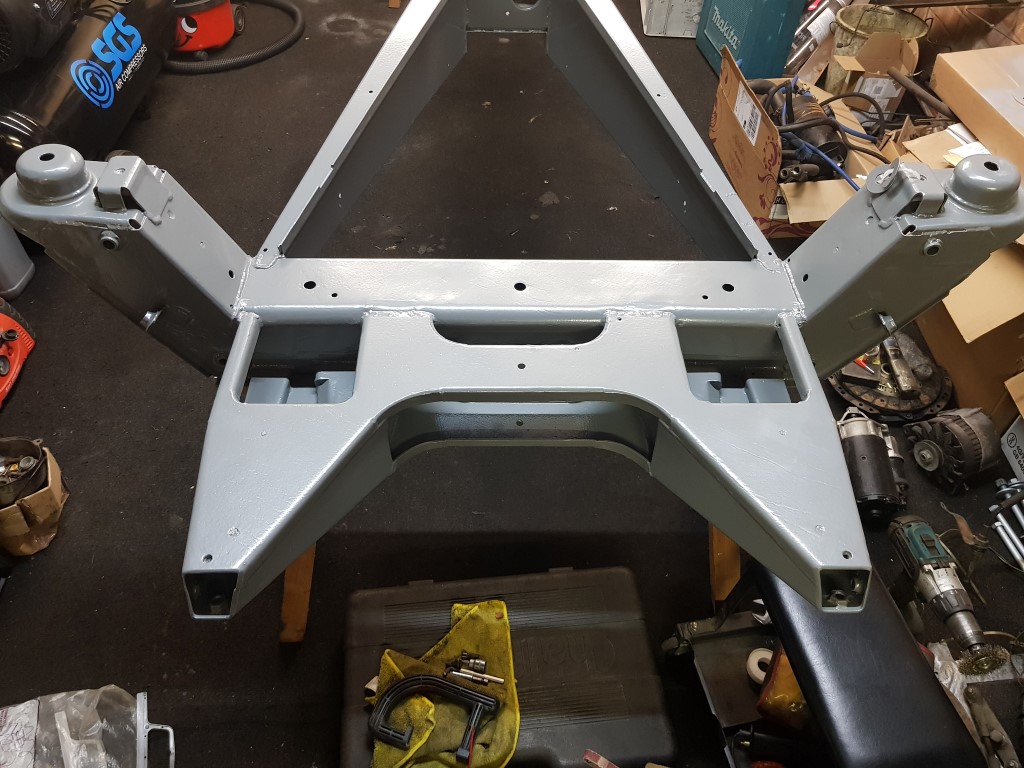

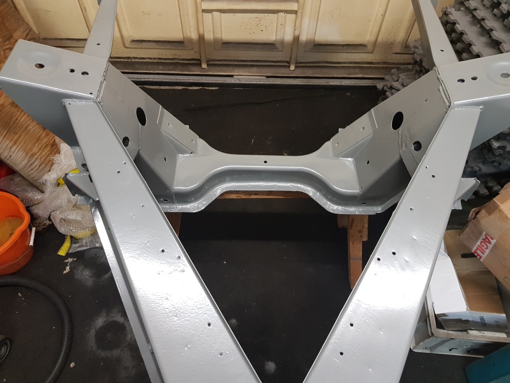

Today was a good day in the timeline of the restoration, the chassis has come home !! for good this time, I left around 7.30am this morning to pick it up from the Galvanizes/P-coaters...
20190118_102700 (Medium).jpg (211.11 KiB) Viewed 4067 times

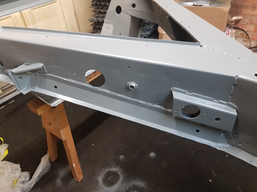

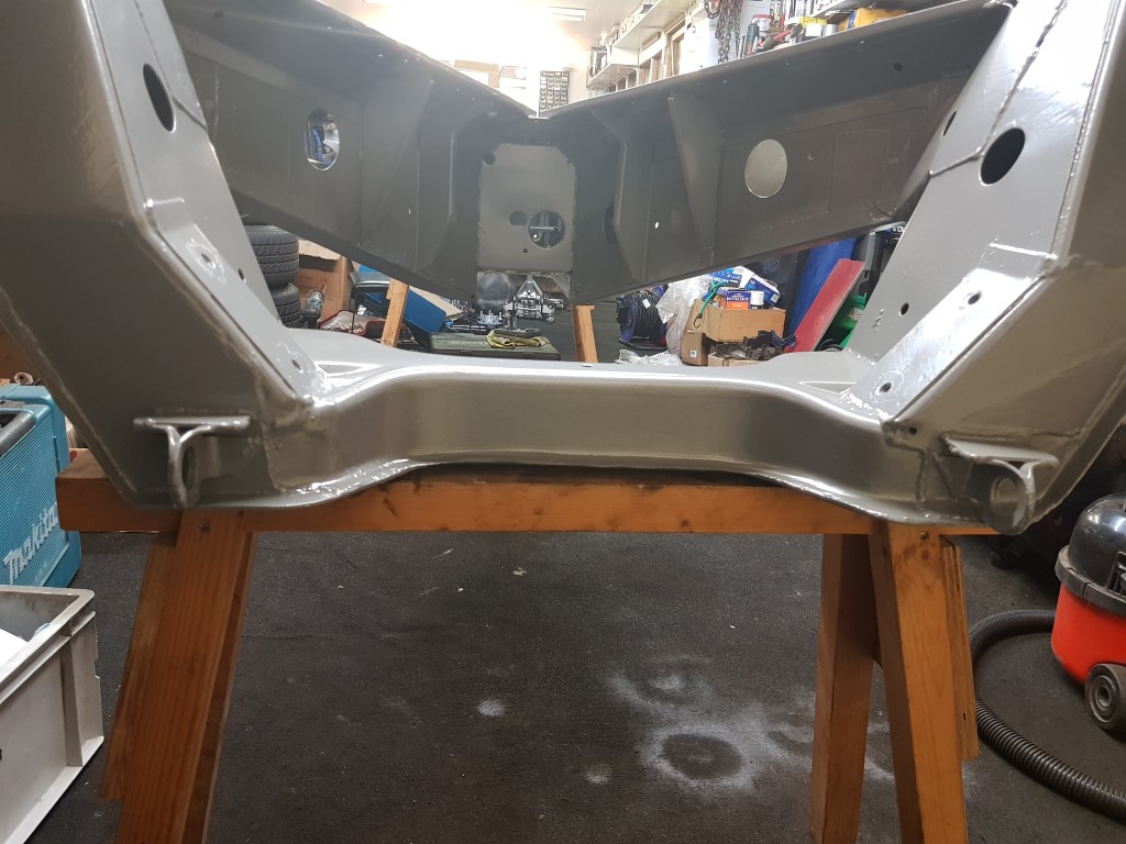

So I loaded it up, swung past Alex's to say hi on the way home and made the trip back, its now safe back in my garage, having looked at the pics tonight, i didn't realise how close the grey I have chosen was to the original colour, the only difference being its a very subtle metallic flick in it and is very slightly darker than original...
20190118_214635 (Medium).jpg (248.34 KiB) Viewed 4067 times
20190118_214647 (Medium).jpg (226.74 KiB) Viewed 4067 times
20190118_214700 (Medium).jpg (231.66 KiB) Viewed 4067 times
20190118_214707 (Medium).jpg (196.93 KiB) Viewed 4067 times
20190118_214713 (Medium).jpg (167.17 KiB) Viewed 4067 times
20190118_214729 (Medium).jpg (231.04 KiB) Viewed 4067 times
20190118_214737 (Medium).jpg (199.93 KiB) Viewed 4067 times
20190118_214842 (Medium).jpg (152.51 KiB) Viewed 4067 times

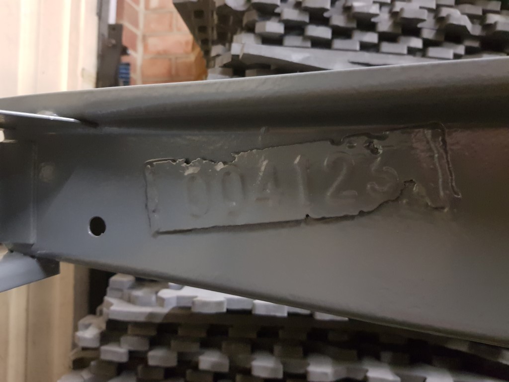

One of the best things i like is that the original moth eaten chassis number plate has survived the process and should now last forever ...
20190118_223007 (Medium).jpg (130.47 KiB) Viewed 4067 times
So who says you cant polish a turd !!! ;) :dance:

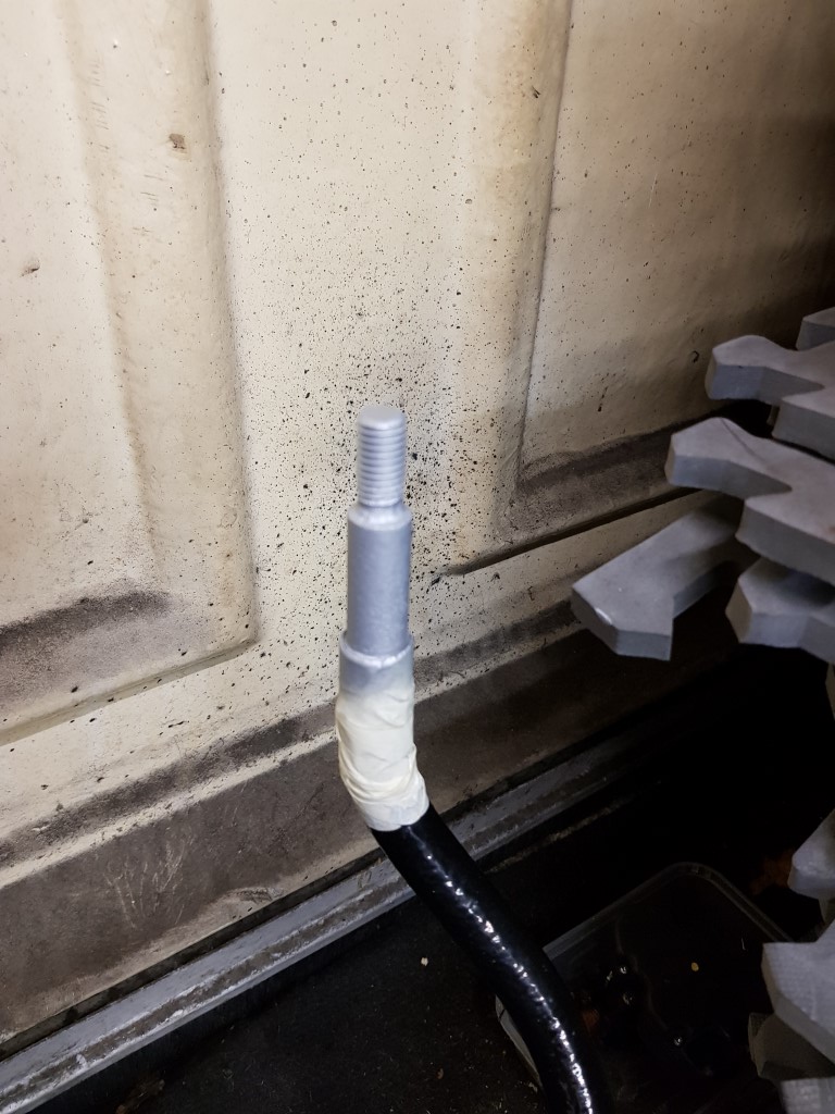

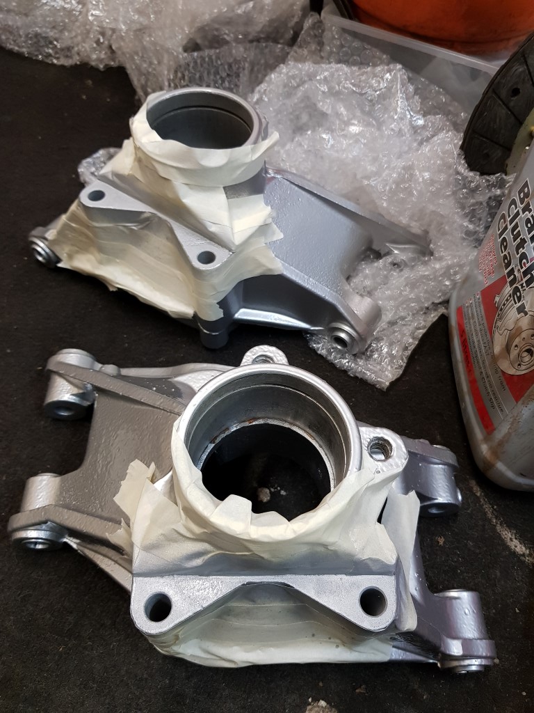

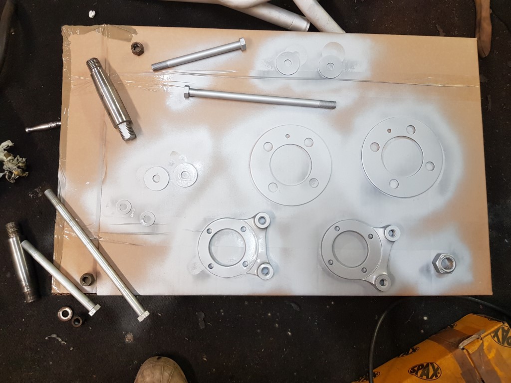

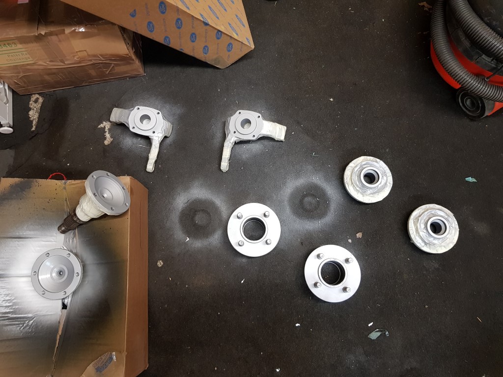

In the mean time since my last post before today i have done a few other jobs too, all of the powder coated parts that i pictured before has mating surfaces which cant be p coated, so i masked all these up and painted them with cold zinc galvanize spray...
20190104_231122 (Medium).jpg (238.91 KiB) Viewed 4067 times
20190104_232547 (Medium).jpg (257.83 KiB) Viewed 4067 times
20190104_232604 (Medium).jpg (229.35 KiB) Viewed 4067 times
I've also refurbed some other small parts, which will no doubt continue as i start putting things back together..

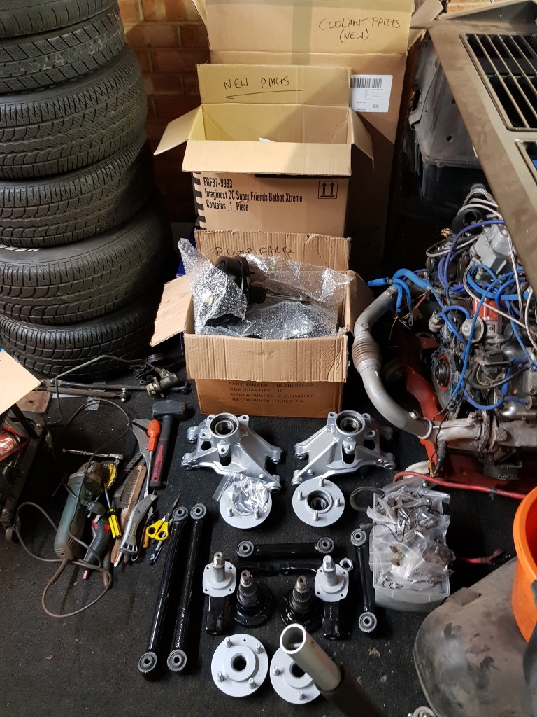

And I've had a rather large box of new stuff arrive :D (thanks Arran ;) )
20190108_144109 (Medium).jpg (237.87 KiB) Viewed 4067 times
and I've had a clear up and arrangement of new and p-coated parts to try and get things going, I have already pressed new bushes in the rear arms and new wheel bearings are already pressed in too..
