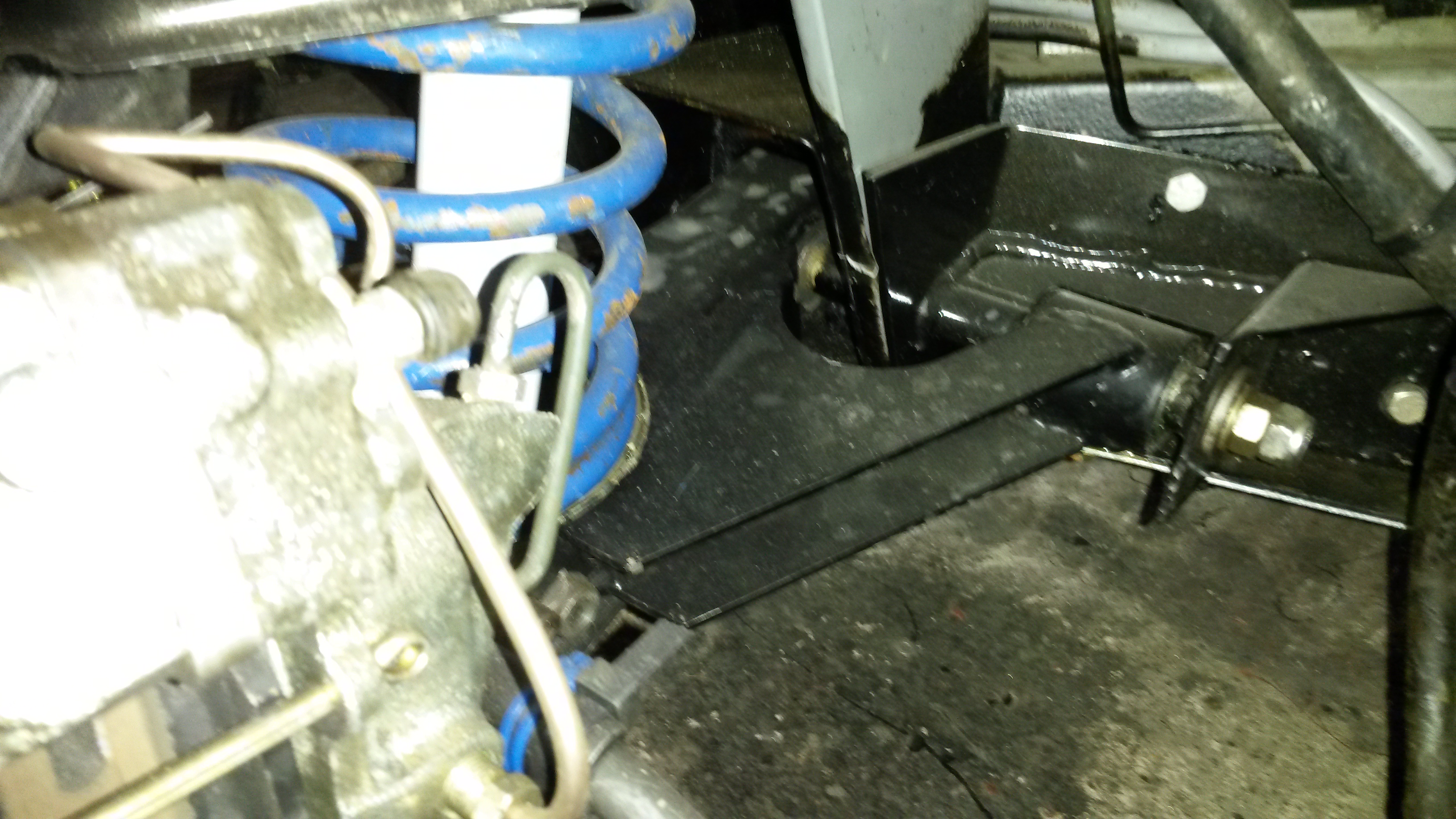

Postby delorean12uk » Mon Apr 27, 2015 6:34 pm
Dan 6511 wrote:I am thinking about modifying the front arms the same way that Jason Monk has done to his,
Got another picture for you Daniel
lower track control arm.jpg (1.7 MiB) Viewed 5342 times
I put a threaded plate on the inside of the chassis where the tank is to spread the load rather than nut and bolt it. All welding and fabrication done by me. Dan you said you changed back to OEM bushes on the front because you said the ride was less harsh??? I think mines improved with the poly bushes.
Postby Admin-bloke » Mon Apr 27, 2015 6:49 pm
That looks like a brilliant solution there Jay
