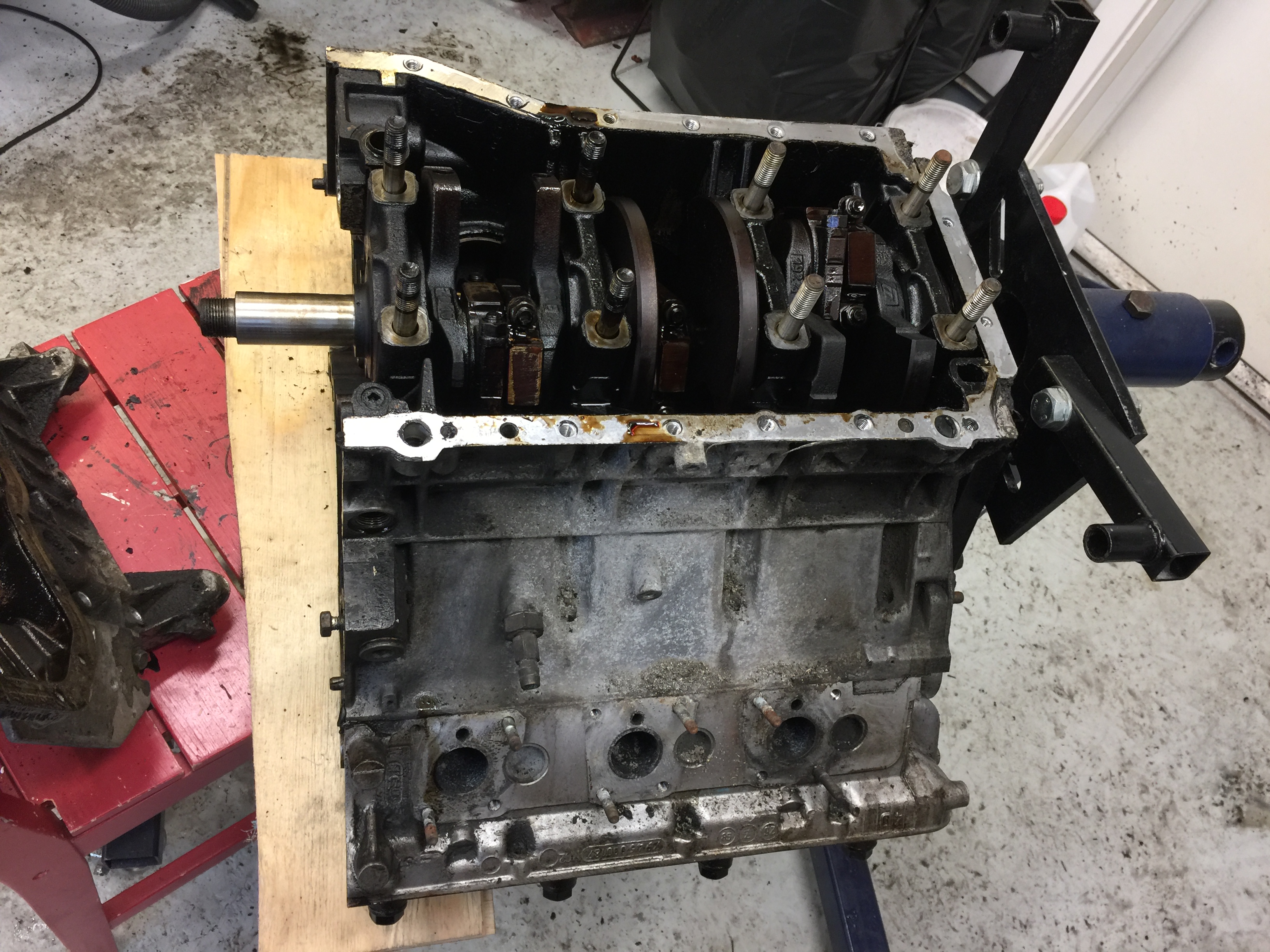

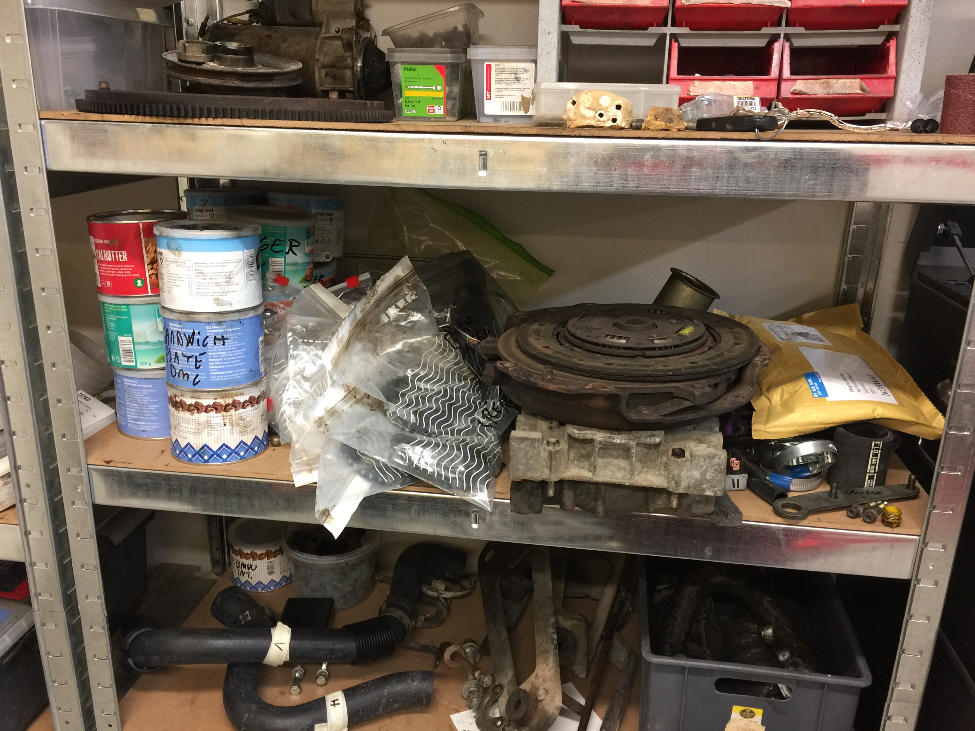

Postby gruffalo » Sat Mar 10, 2018 4:45 pm

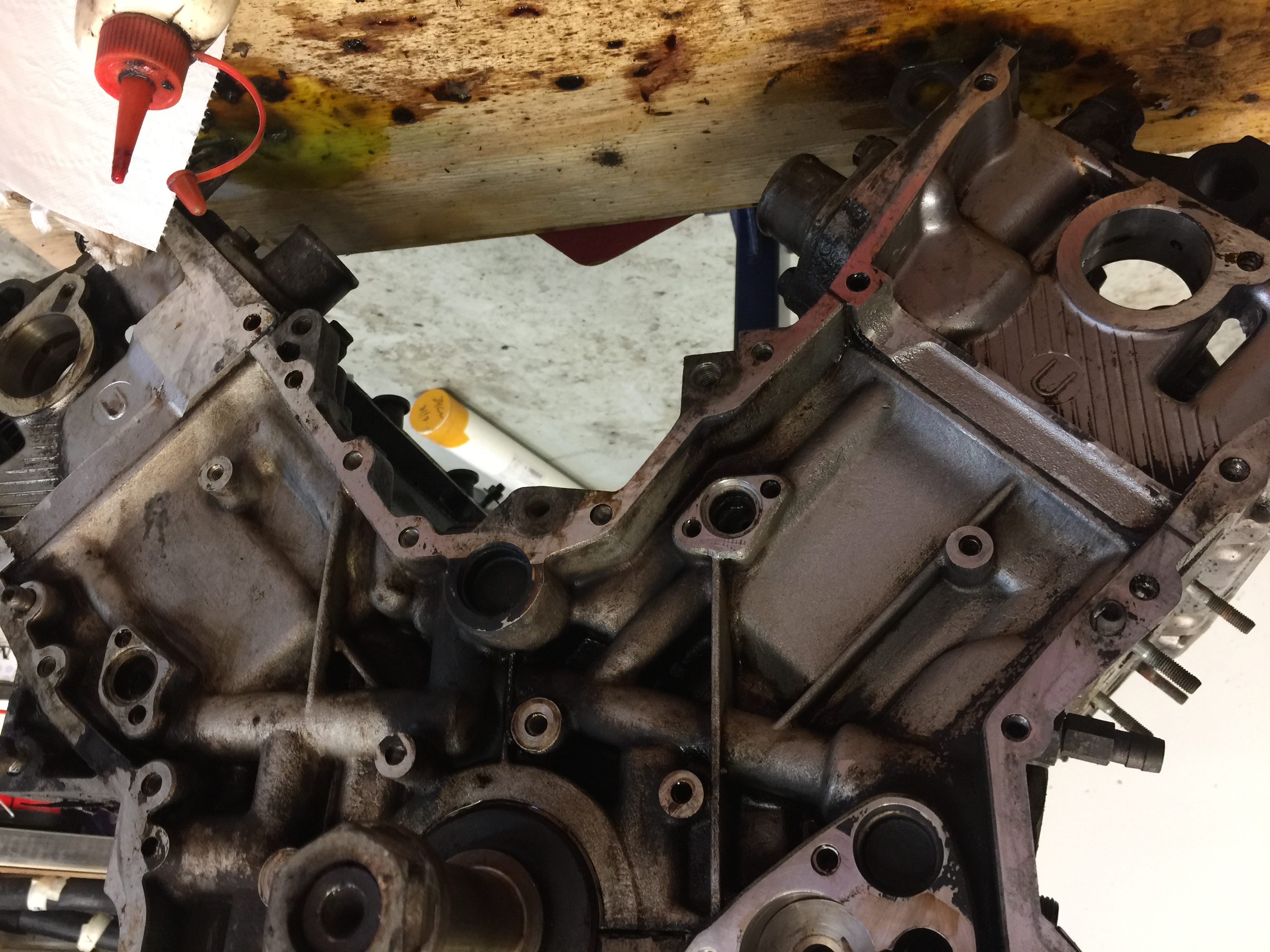

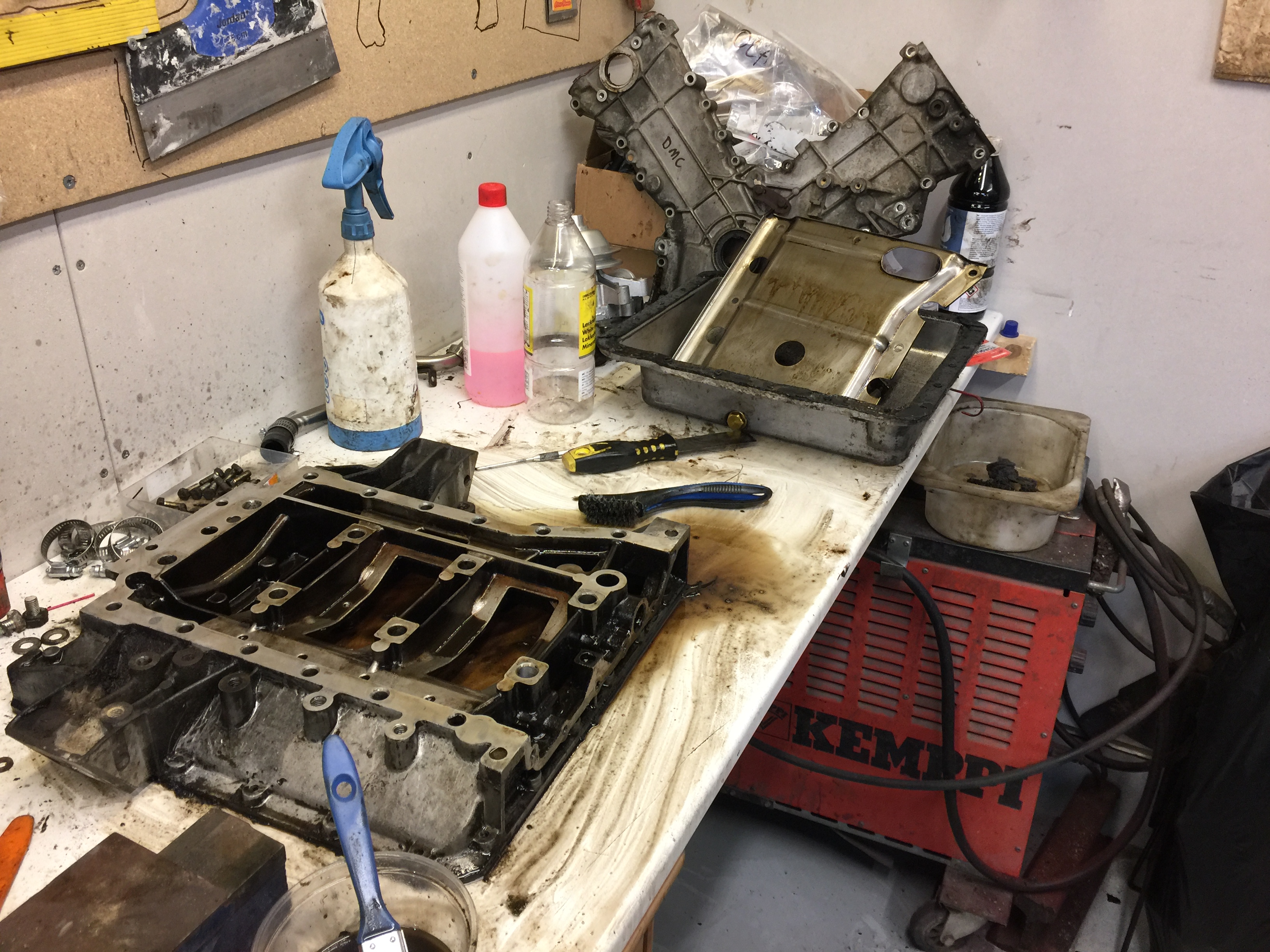

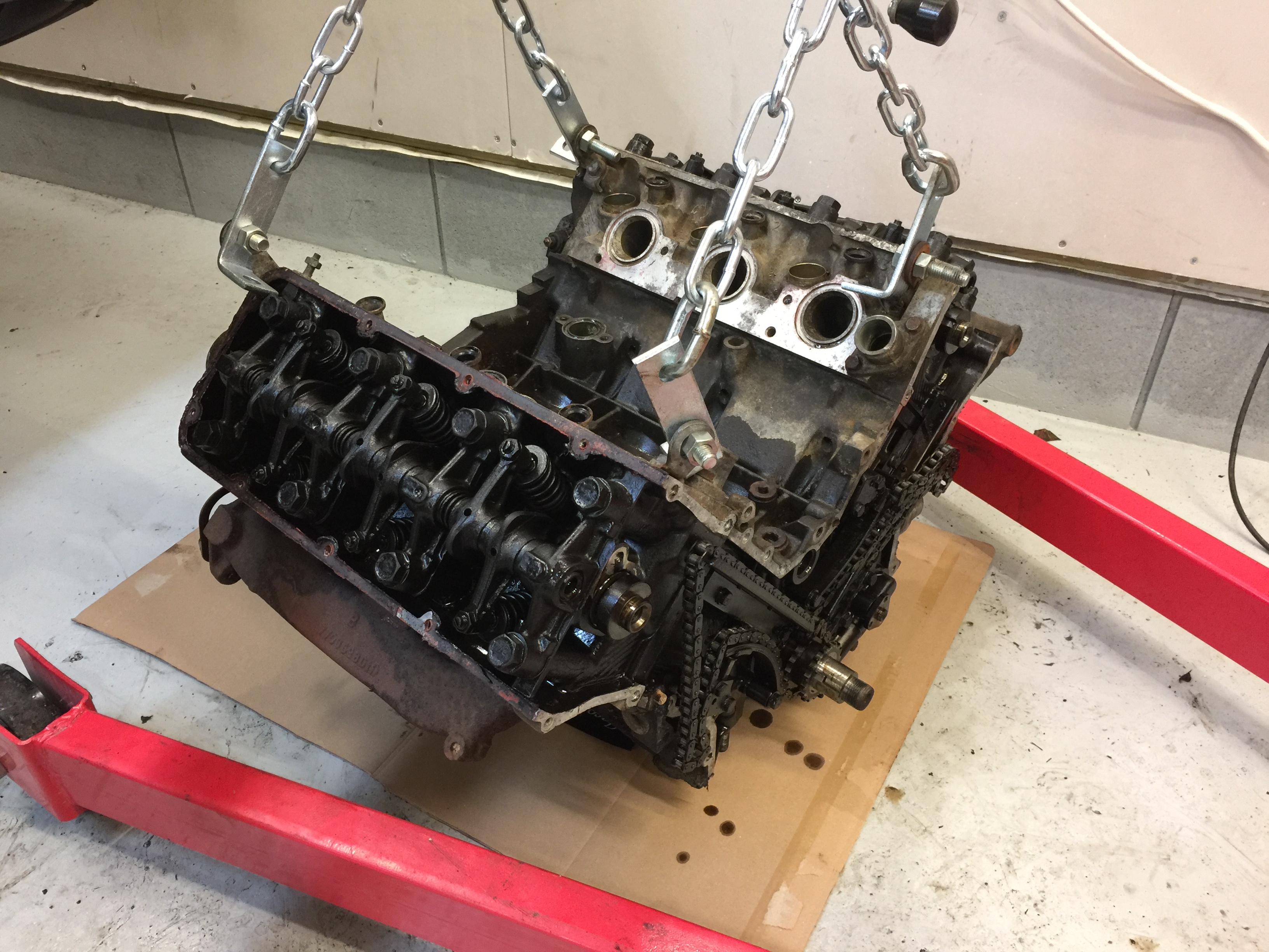

Working on swapping over the engine bottom now. Lots of cleaning to do. Hopefully getting that done today, and the cams and rockers tomorrow.
Dmc engine robbed of parts
Volvo engine ready to receive dmc bottom end
Cleaning parts to swap over
Parts are piling up

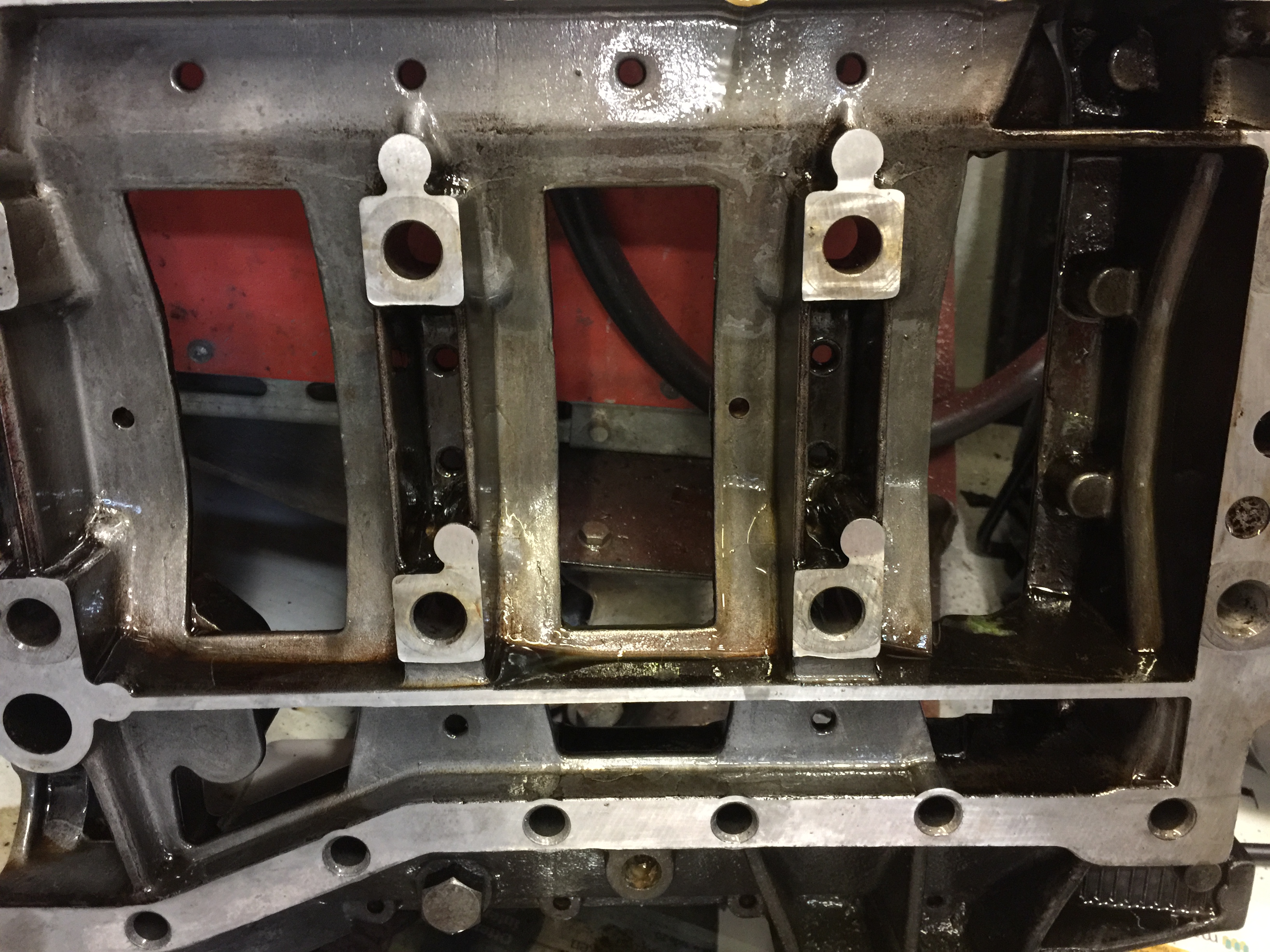

Today was spent mostly cleaning parts. I had some success using oven cleaner, but the majority of the work was done using kerosene and a small paint brush.

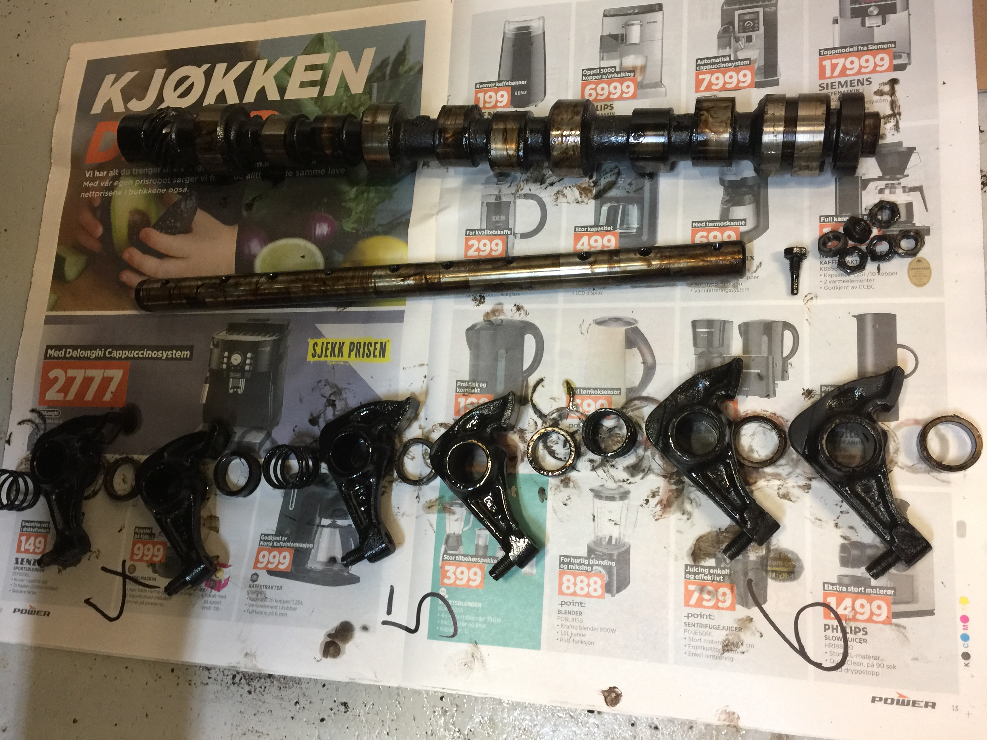

I also disassembled one rocker shaft and cam. Luckily very little wear to be found.

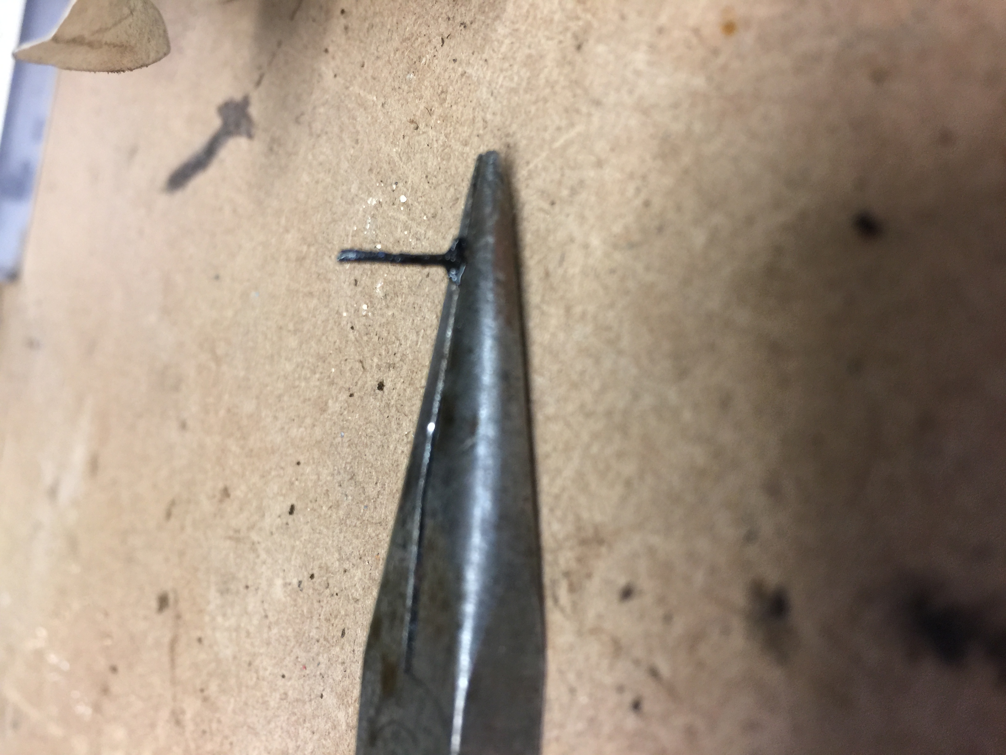

On the other hand on 4 out of 6 rockers the lubrication hole was completely clogged. One was so bad that I struggled for a long time getting it open with a needle. There’s no way that one would have come open by itself! On a different one I managed to pull the clog out with pliers. (See photo).
Clog pulled from oiling spray hole!!!
5-6 cam and rocker assembly
Sandwich plate getting better
Finally showing bare metal
