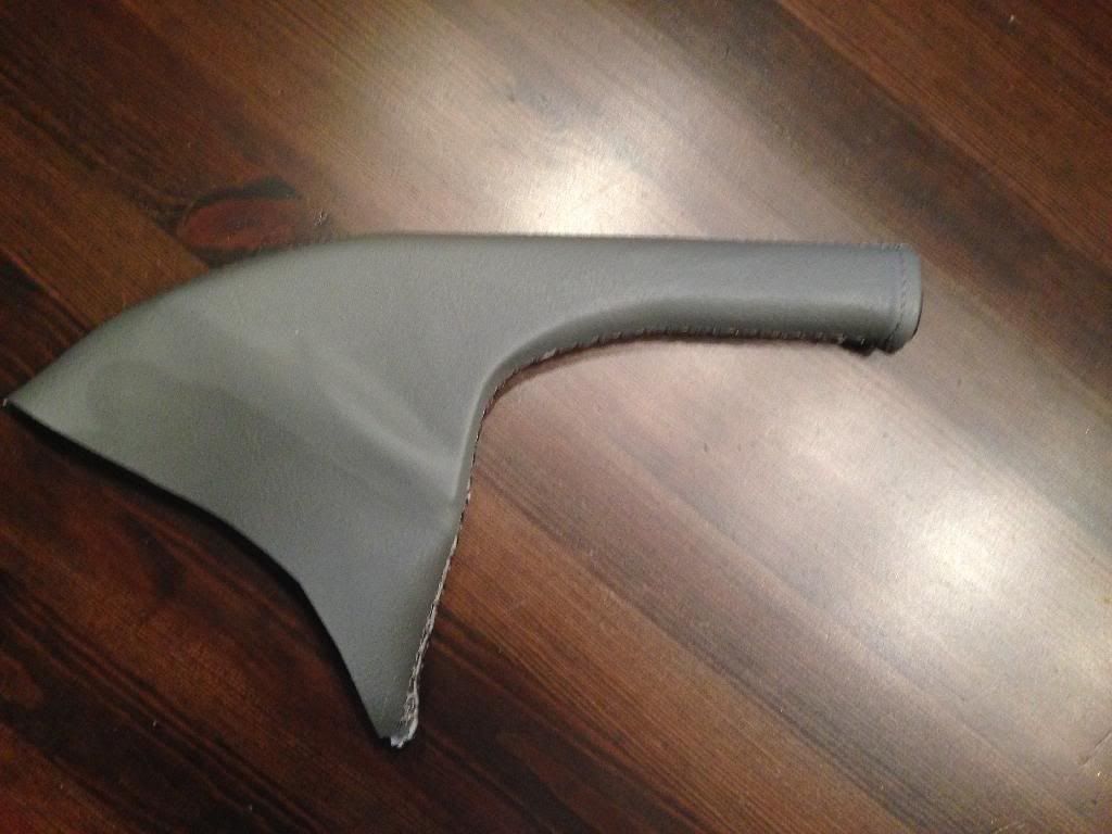

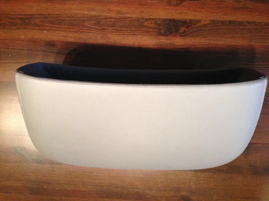

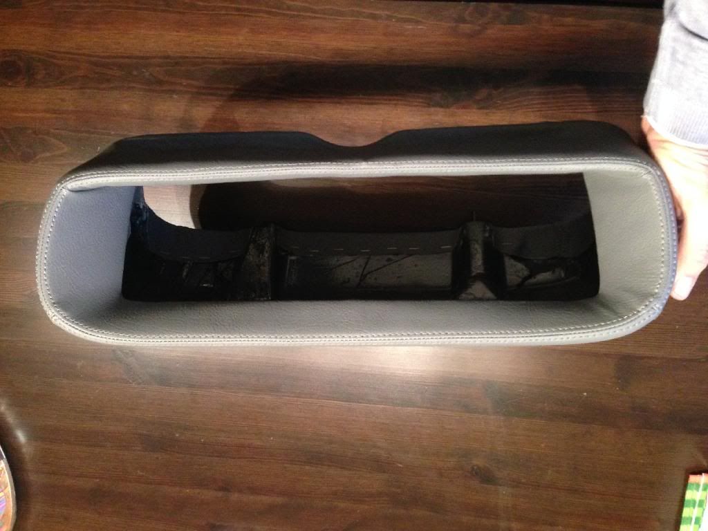

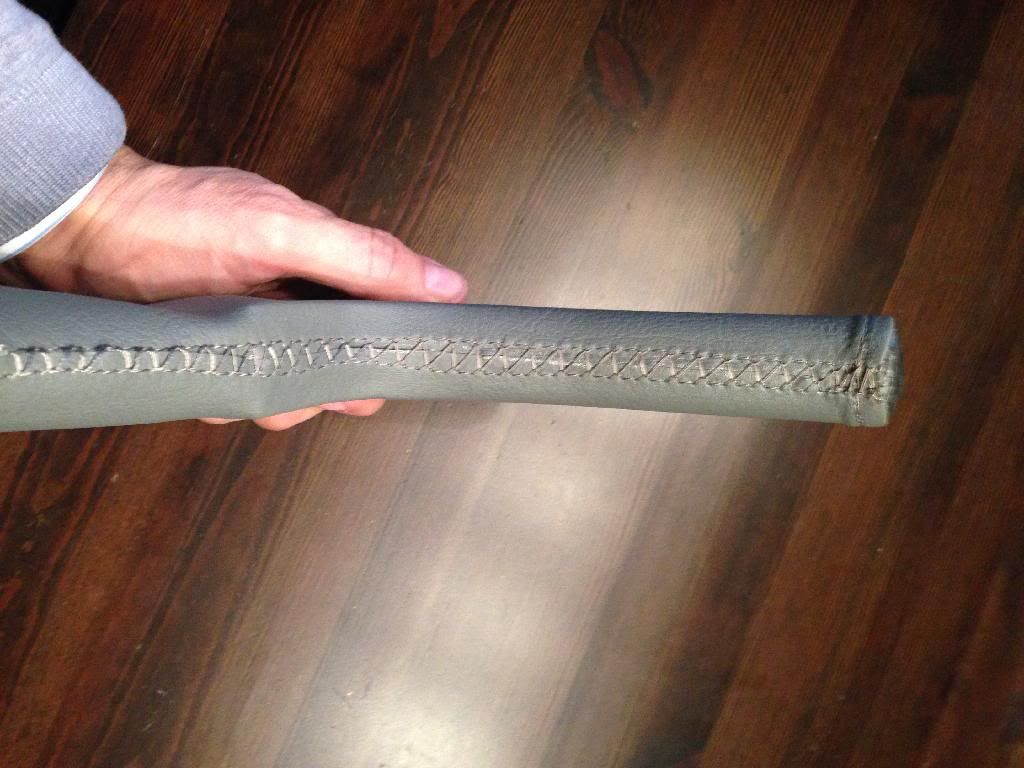

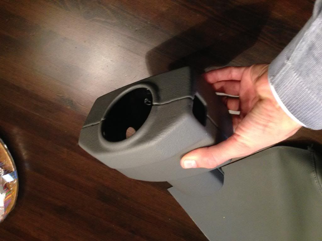

Had my binnacle, handbrake and steering canopy dressed up with a gray leather to match the rest of the interior.
Binnacle was improved with a thin sponge under the leather, to cover the cracks and give it a soft feel!
Hand brake or emergency brake for some...
Canopy

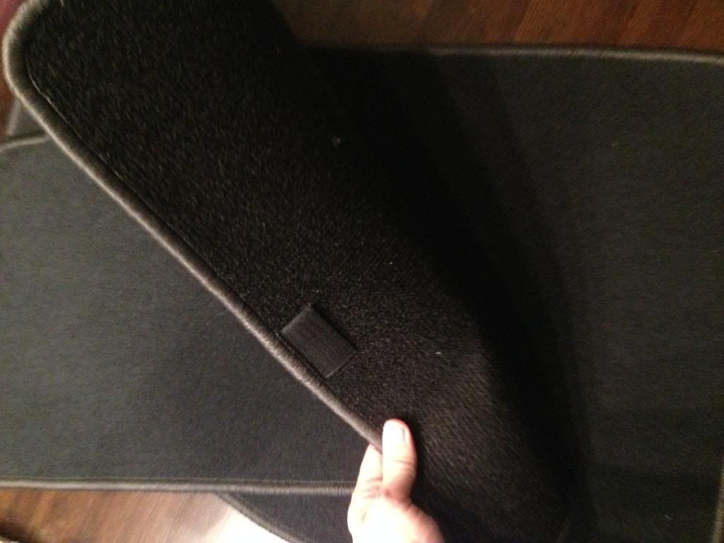

and had floor mats replicas made on which I will add the DMC emblem additionally. Cool that hey added some Velcro underneath to keep em from sliding!
All in all 120 USD.

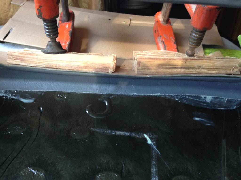

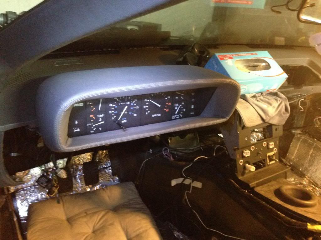

To straighten out the top binnacle lip from the sun warping and ho have it look aligned with the speedo later on, I have put some pressure on it.
Can't use the heat gun cause it would most probably burn the leather cover.
Postby ALEXAKOS » Fri Dec 27, 2013 5:59 pm
Refurbished binnacle and full led speedo is back where it belongs...
Reassembly era has begun a few days short to the new year.

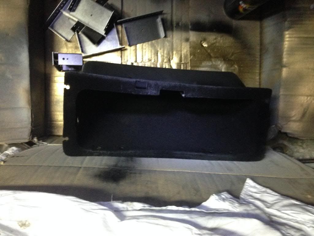

Refurbishing the used glove box and placed that back in its position as well.

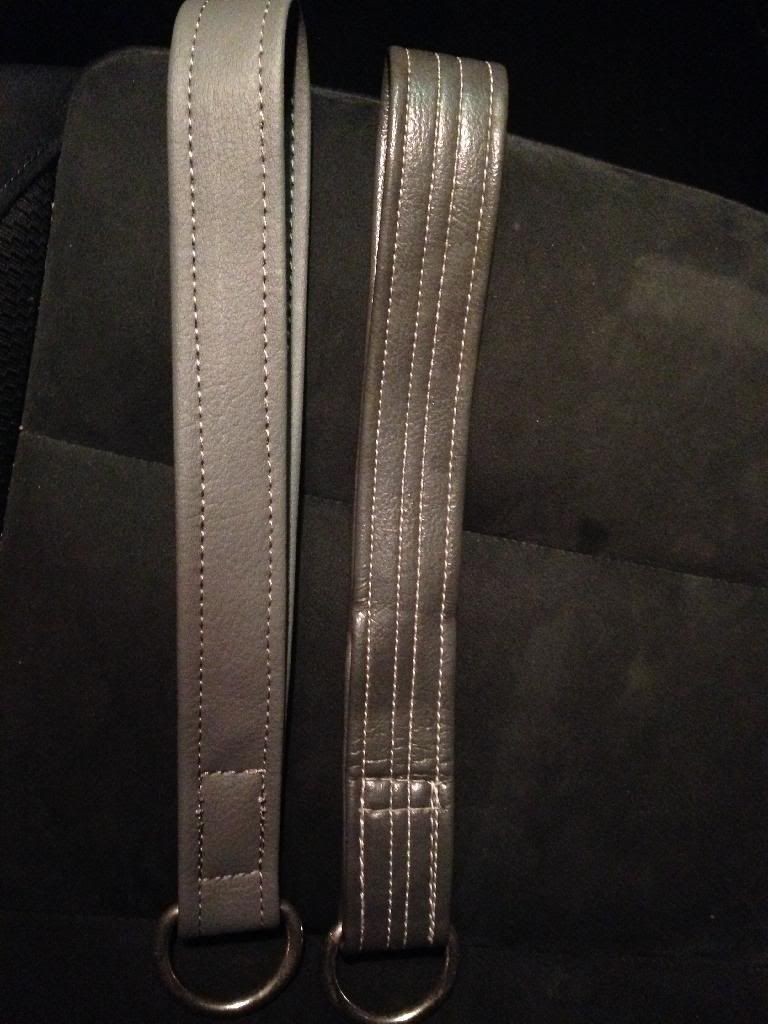

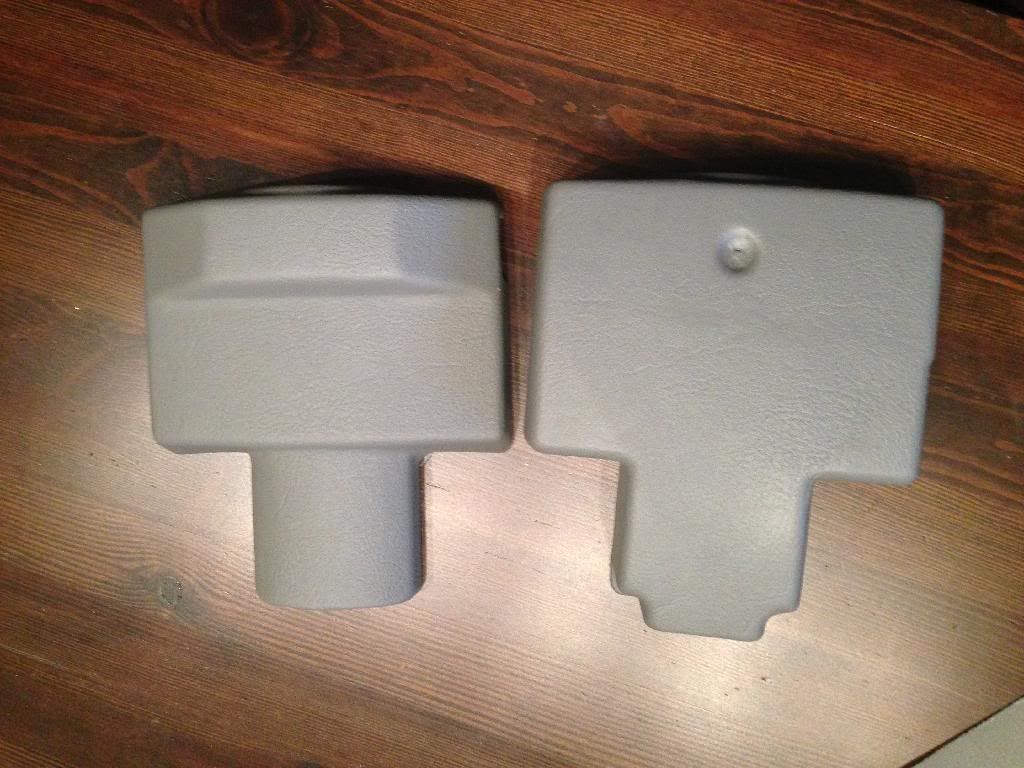

and had he door straps redone by enforcing them internally. Added a strap to avoid those cracks and rips when pulling on that plain fake leather....
Left is the new, right is the DMC stock.

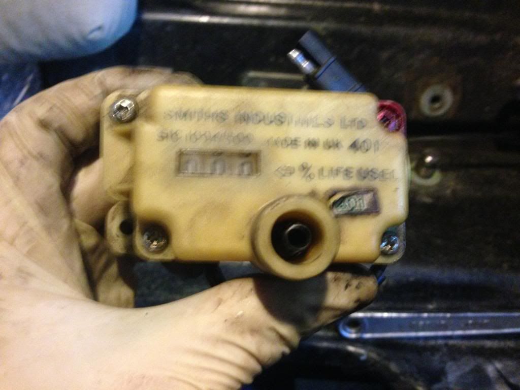

Then I removed the lambda counter and reset it.
That two holed cylinder is where you get it done.
All you need is a tool to grab it with and start turning it until in goes back to zero. Works just like the speedo's resetting knob works.
voila
