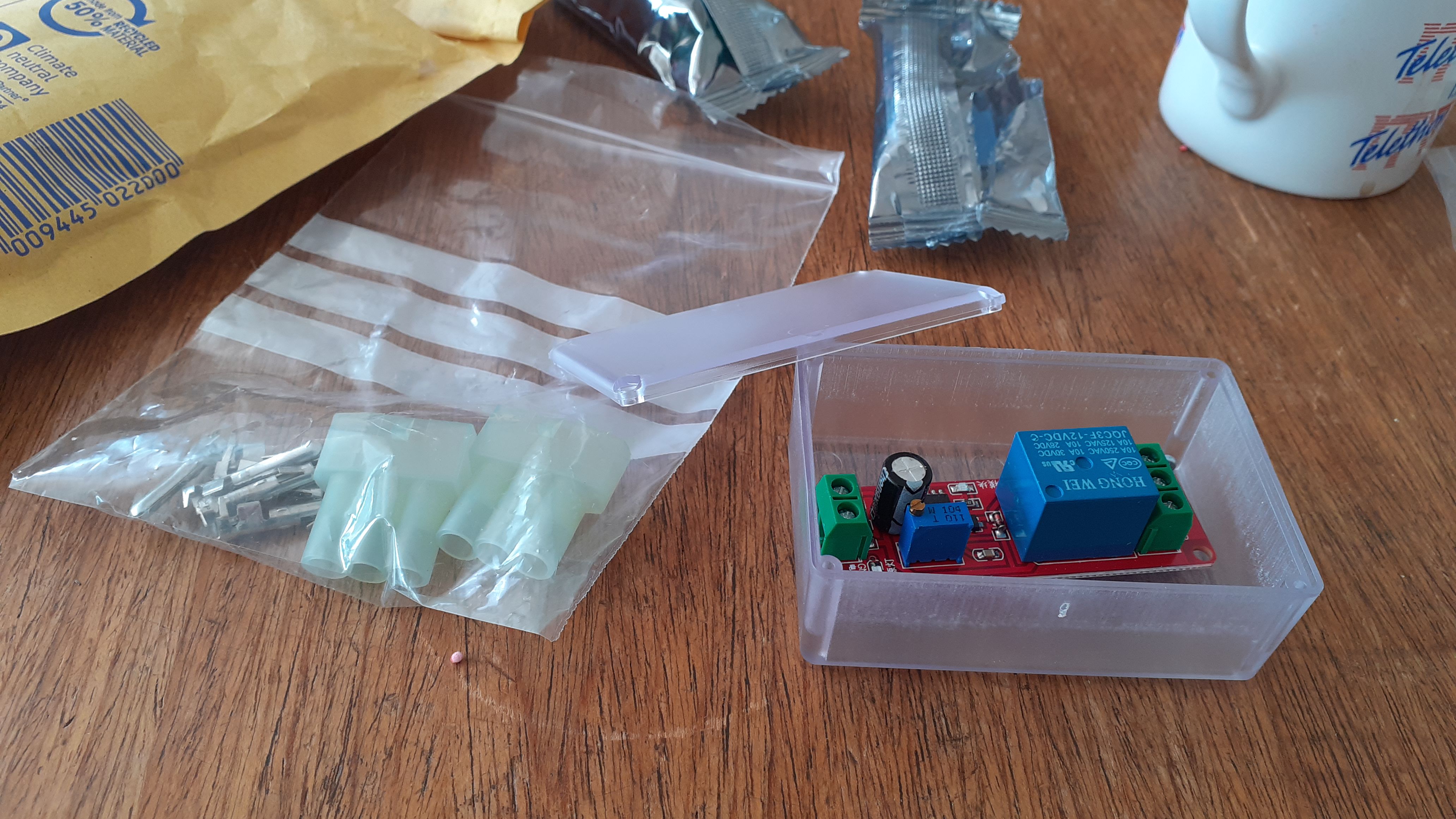

So I got these:
A box (in a fact I went through a few, for stupid trial and error reasons)
Connectors to go "in line" where the 3-wire front indicator loom plugs in. So a female and male needed
The timer module (something like
https://www.ebay.co.uk/itm/Adjustable-T ... SwjFleC0GM ).

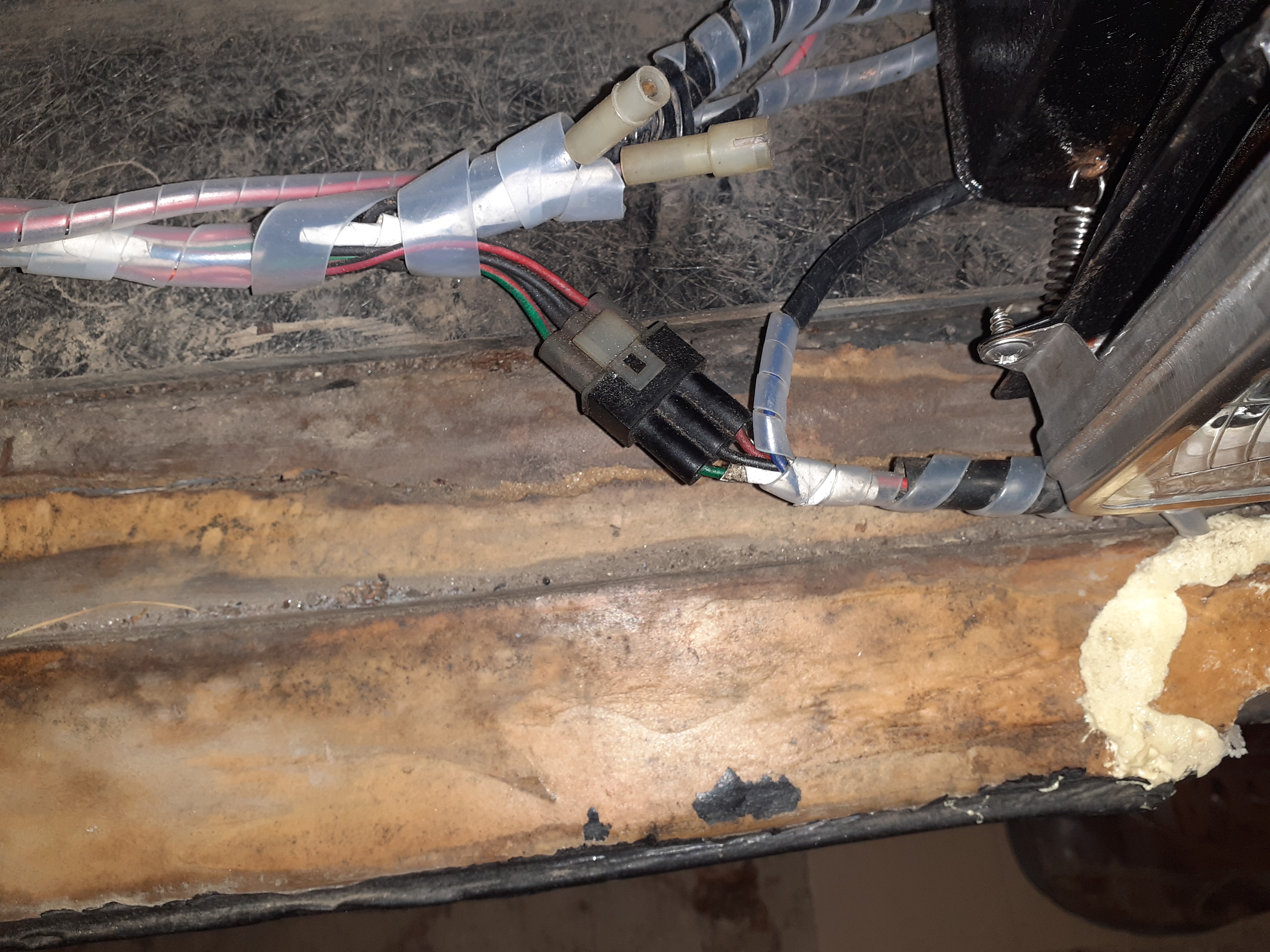

And wired it so that it goes in between these two familiar connectors behind the front grille

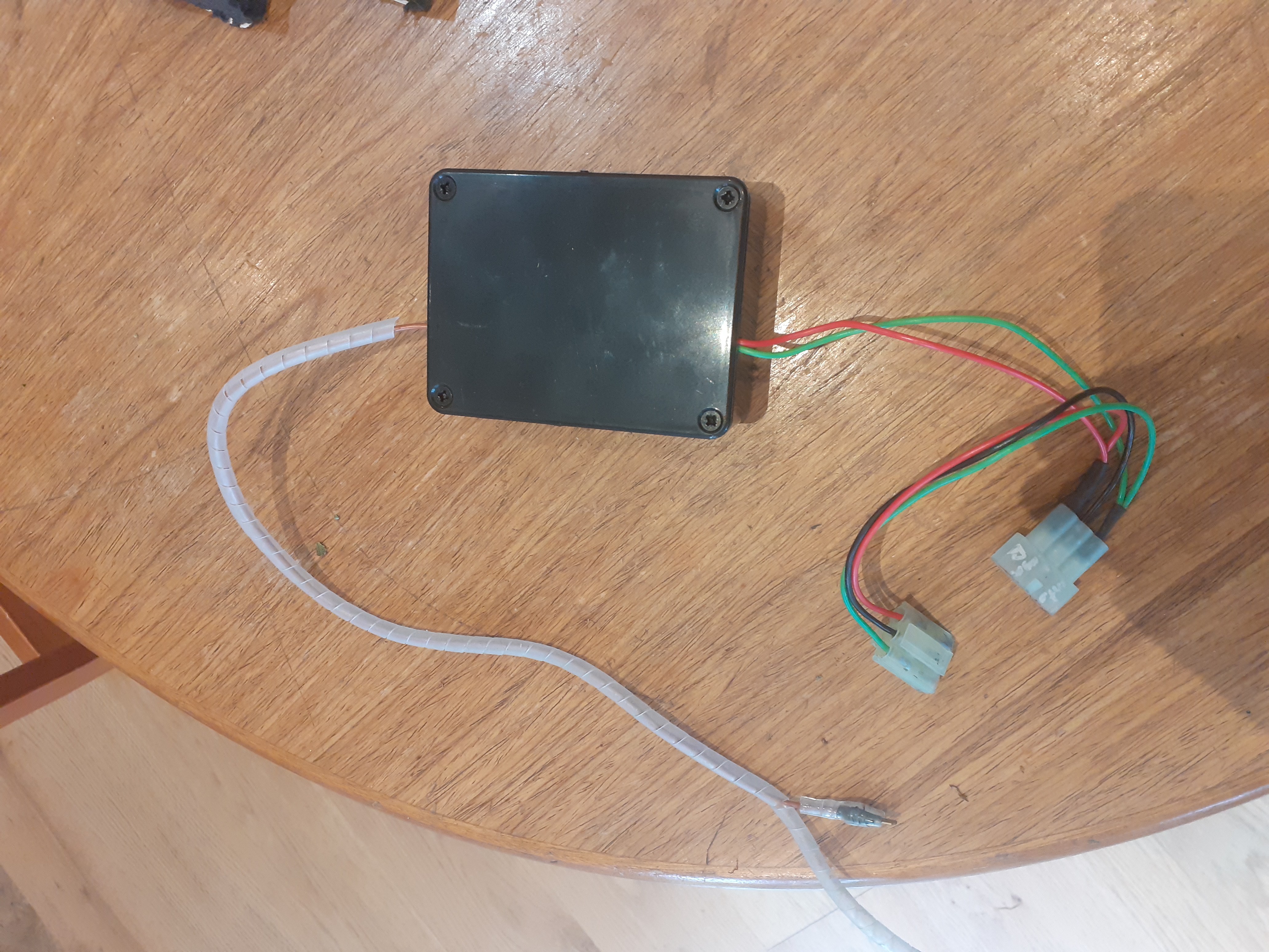

It looks then like this:

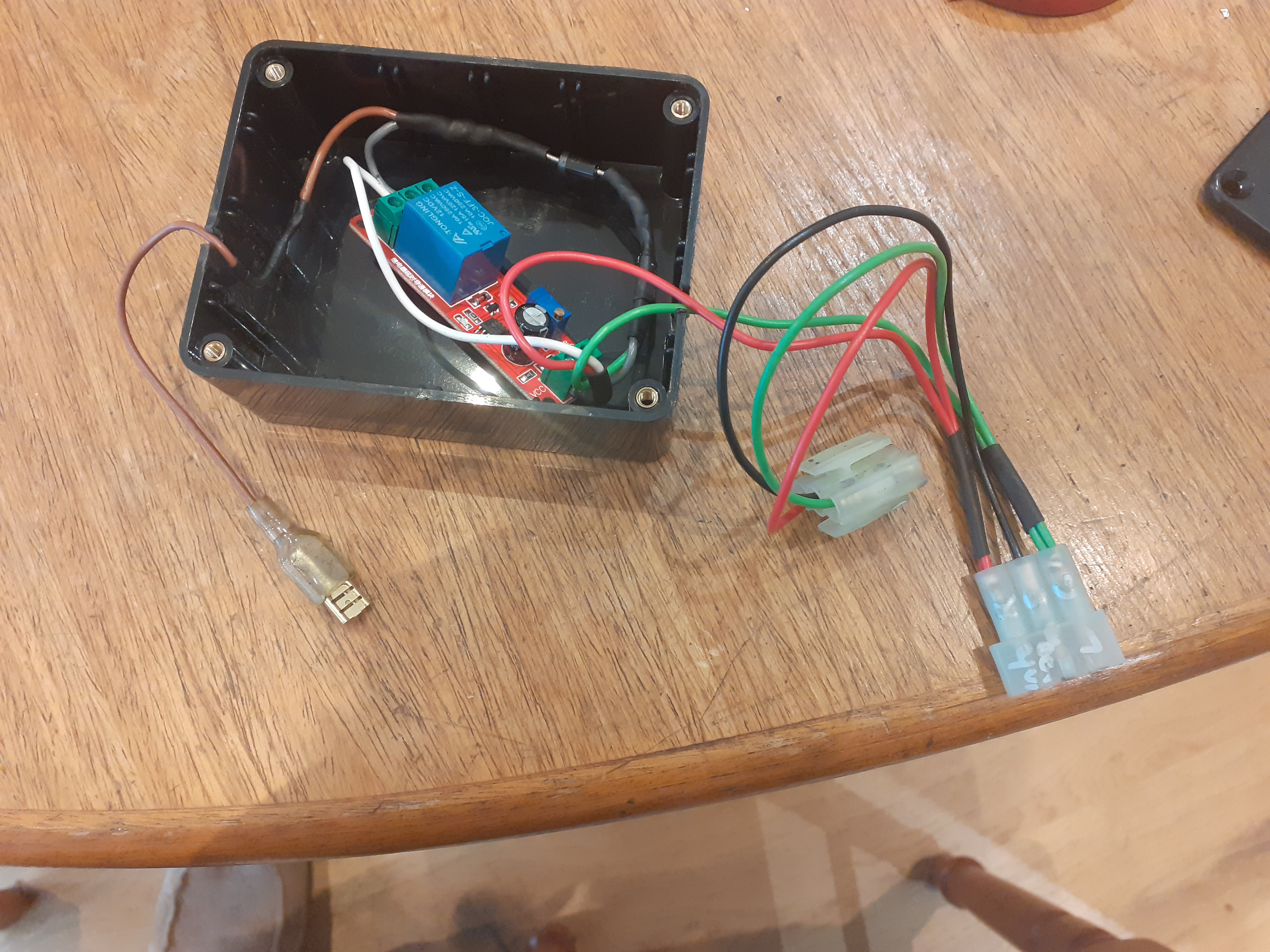

And finally, like this.
So you can see where this plugs in-line. And the single lead on a spade connector then goes to feed the side marker (minimal butchery- not quite none! But mine had been hacked about anyway, so Mike W cant shout at me)
