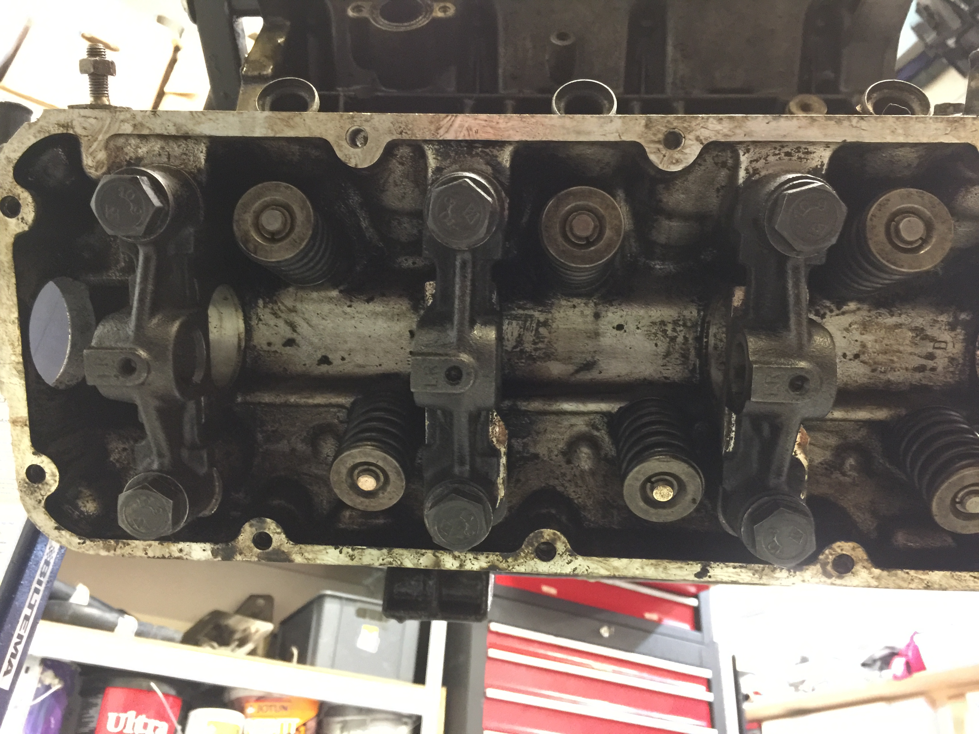

Today’s assembly work done
Did I do them all ? :|

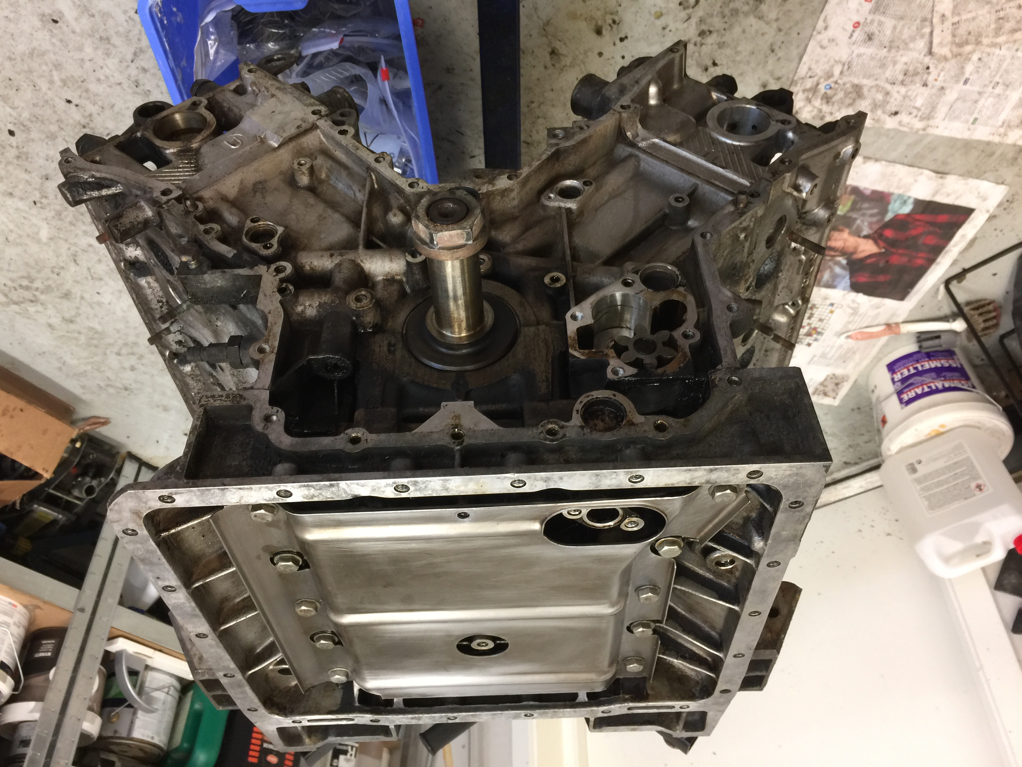

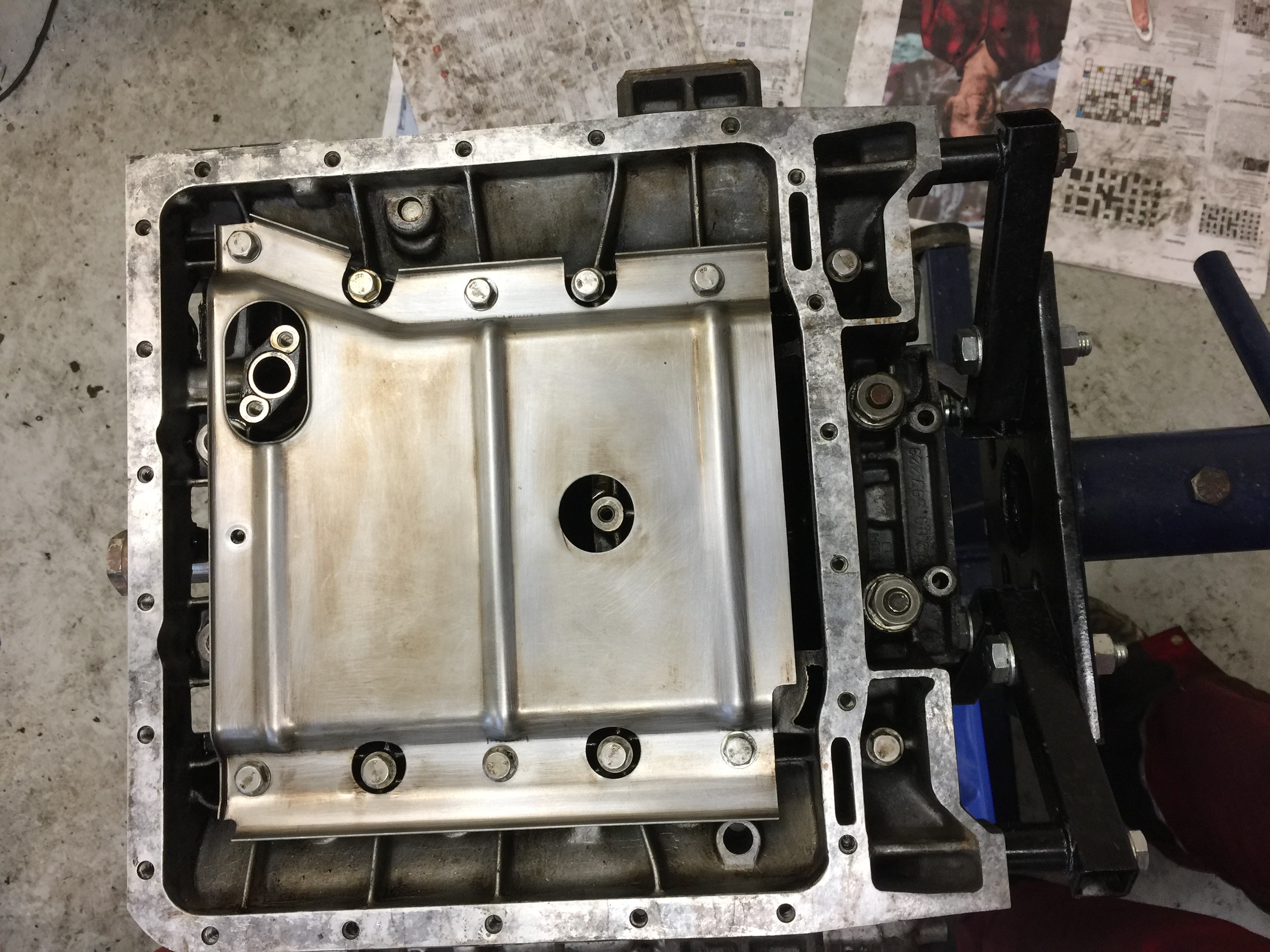

Bottom end swap done, bar pan
Pass side slowly getting there

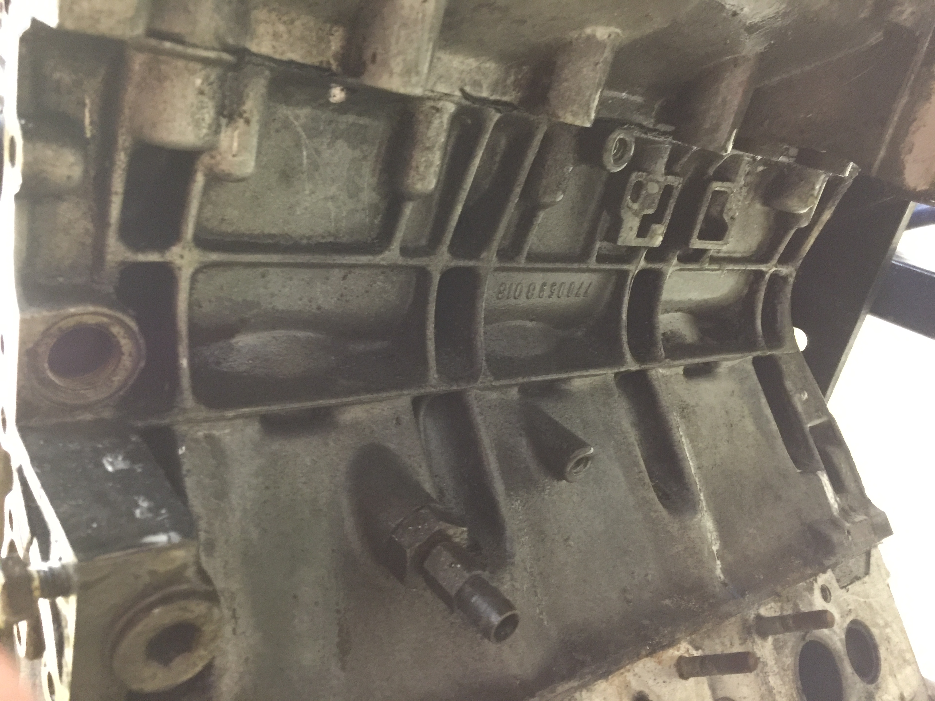

This side somewhat cleaner
Drivers side yet to be cleaned of dried oil sludge

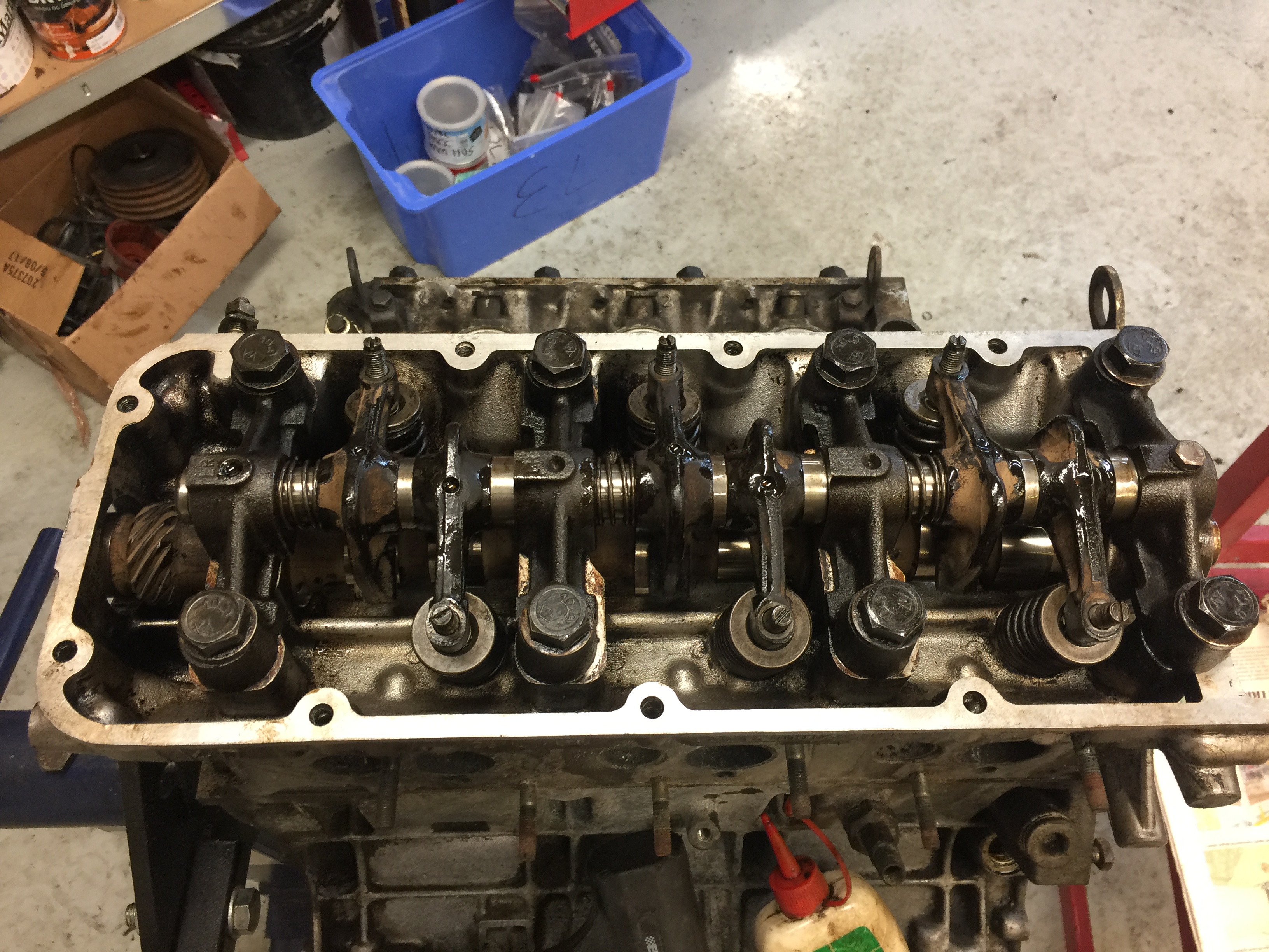

Enough with the cleaning for now, I decided this one was ready for assembly.
4-6 complete

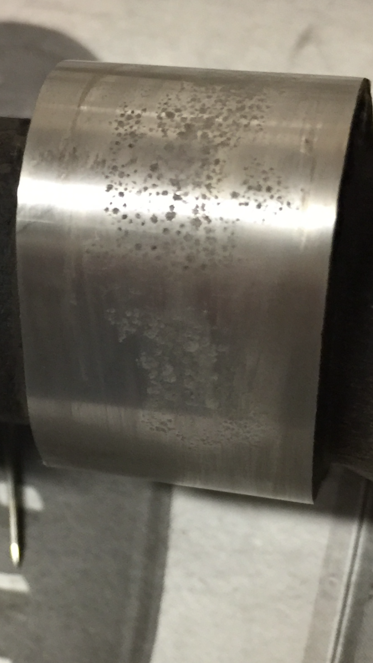

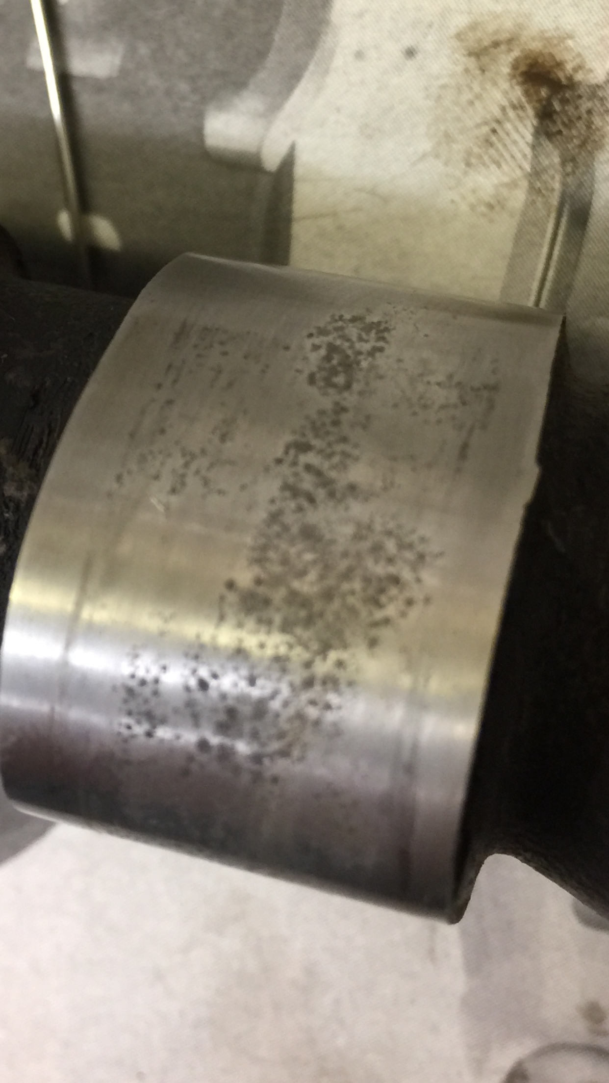

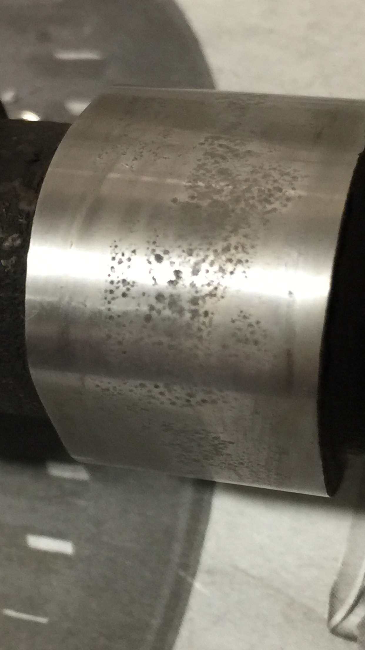

I thought my miseries were over, but now this. All cam lobes seem fine, with very little wear, ant literally the last one looks like this.
What do you guys think?
Pitting
gruffalo
Posts: 256
Location: Norway
VIN #: 5063
Re: Vin 5063
Postby Admin-bloke » Mon Mar 19, 2018 12:19 am
I wouldn't use it personally. See if the (correct) cam from your other engine is ok and if so consider using that instead.
If not put a post up seeing if anyone has a spare cam they're willing to sell or see if that cam can be reground back to oem profile.
It'll be easier to sort now rather then pull the engine out again
Re: Vin 5063
Postby gruffalo » Mon Mar 19, 2018 7:57 am
I have two spare engines, but all cams are ruined. (No wonder since half of the lifters have clogged oil supply)
I have a cam sent to me from a local dmc owner, but that too might be slightly worn. We’ll see.

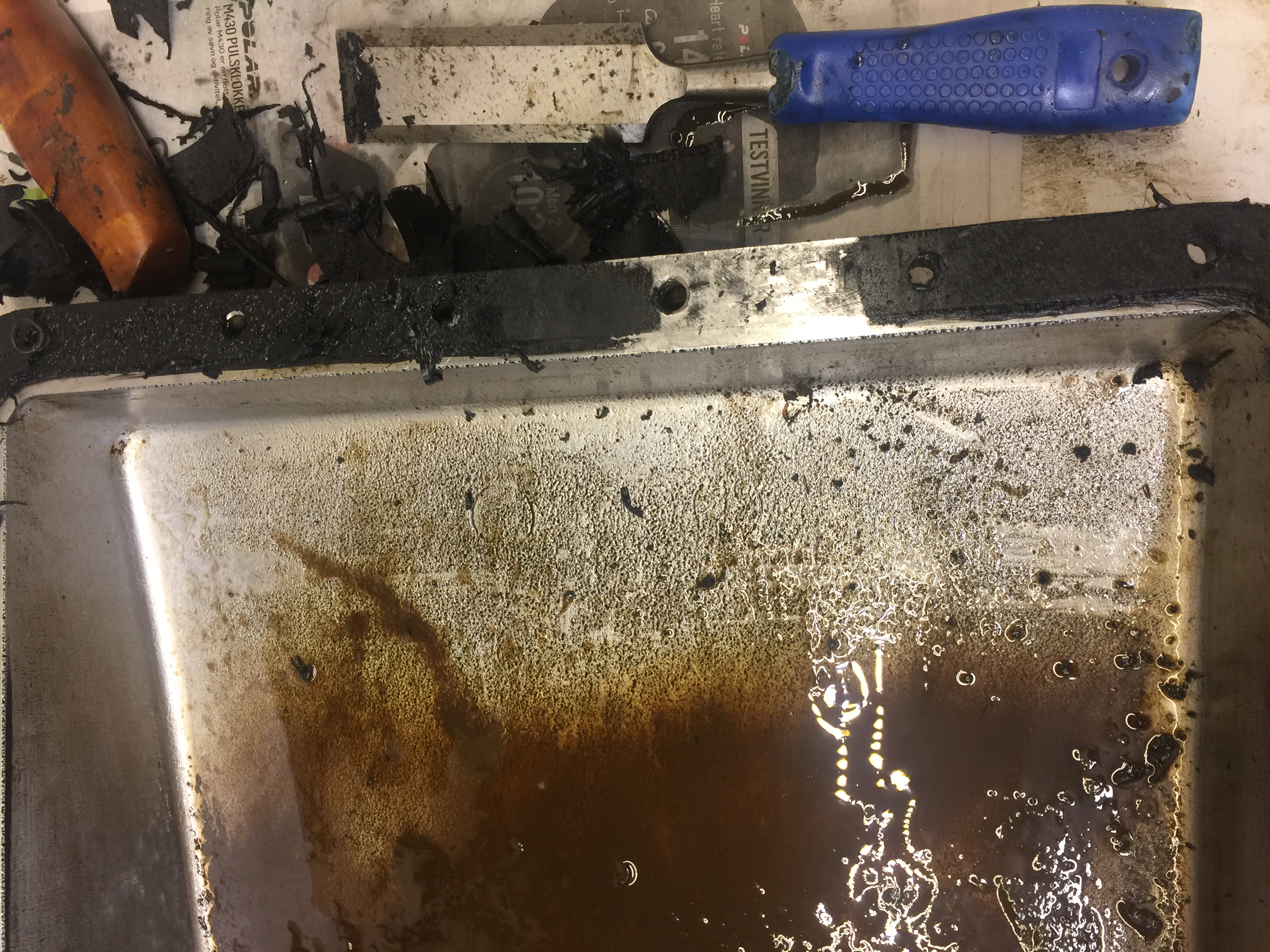

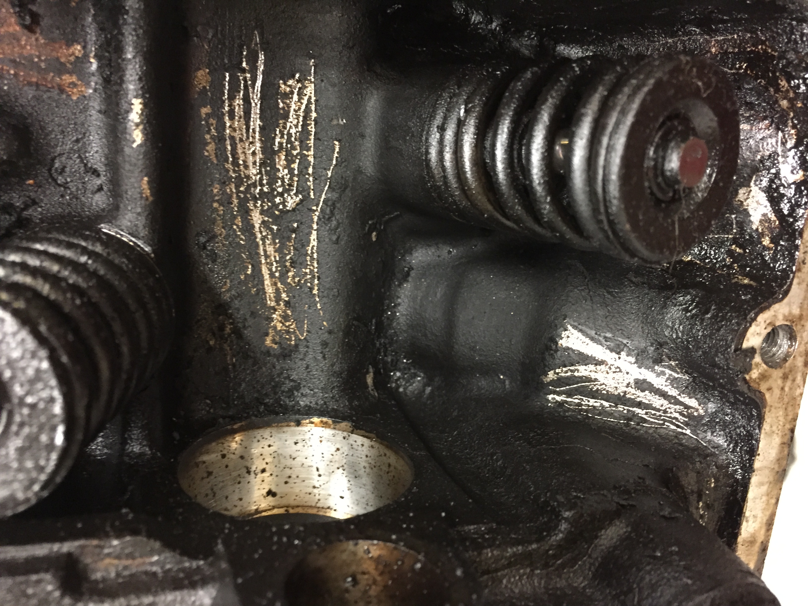

While waiting for my replacement cam to arrive, I decided to have a go at removing the pan gasket. I fitted this in December, and spent forever removing the old gasket material, before fitting a new one.
Well here we go again :)
I also inspected my collection of valve rockers, looking for good ones. There’s no point installing them in the original position once I fit a different cam.
I wonder what is acceptable wear?
Déjà vu
