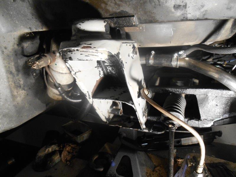

Postby Domi » Tue Nov 01, 2016 7:28 pm

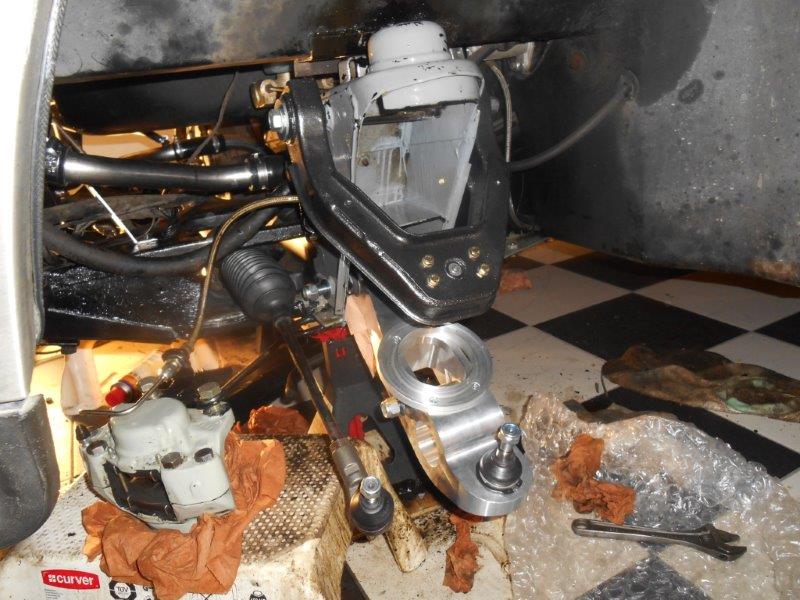

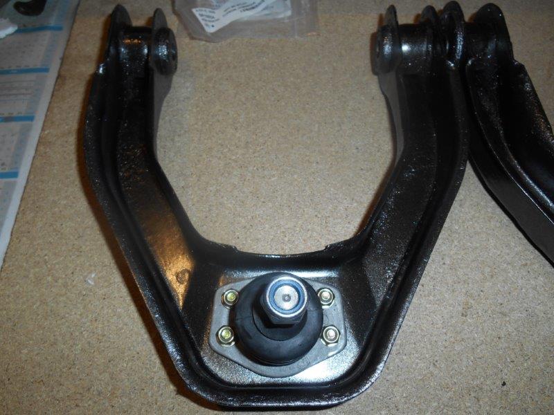

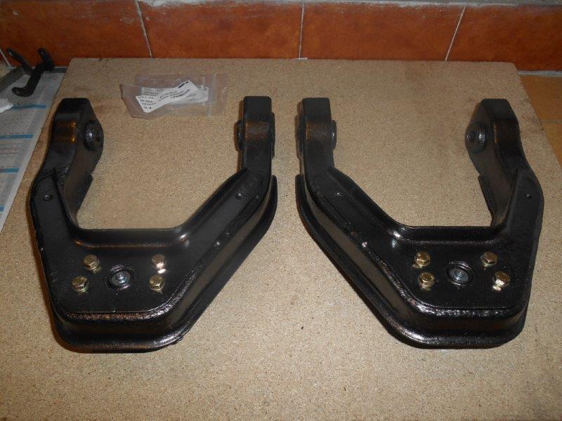

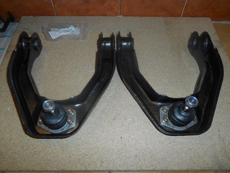

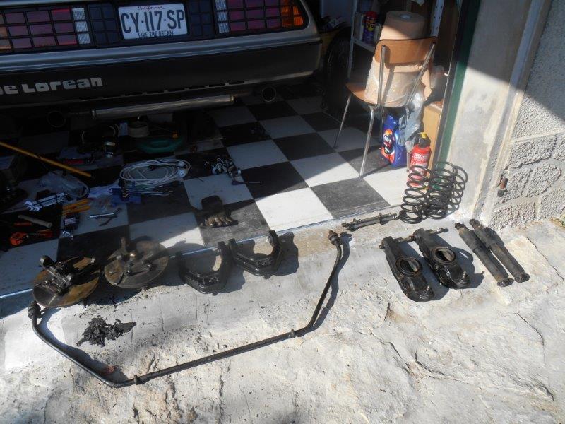

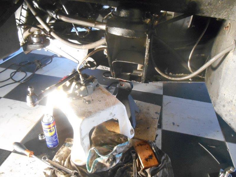

I worked on the other side this afternoon.

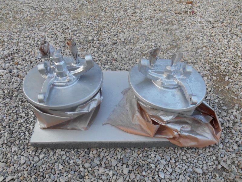

Did a lot of cleaning because of the black layer on the arm...
Then, applied some paint to refresh them.

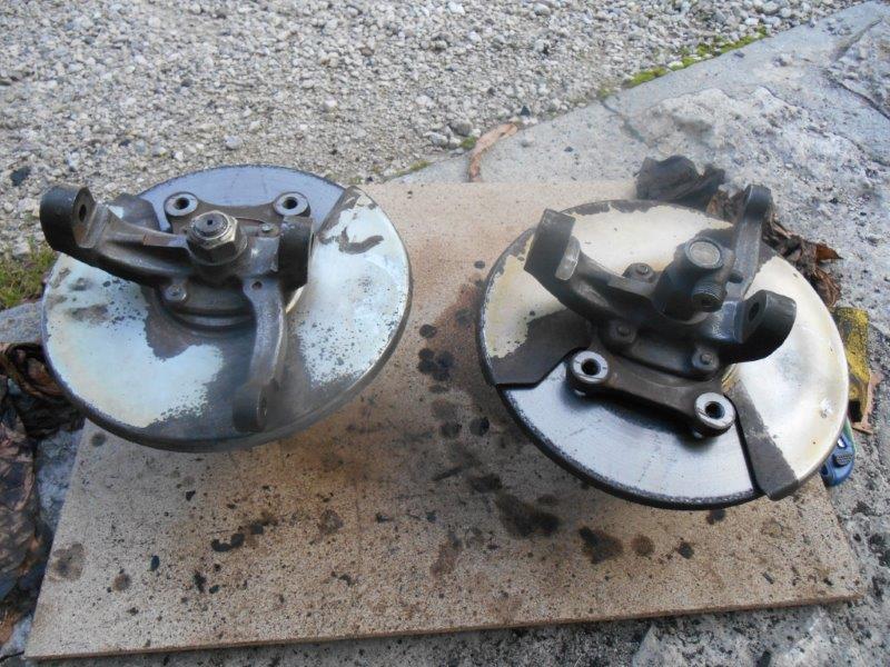

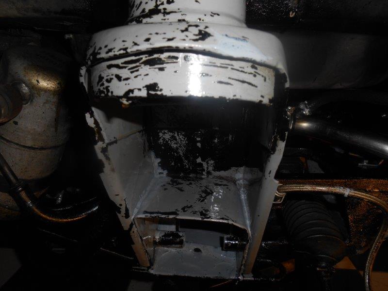

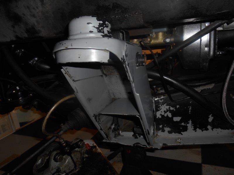

Postby Domi » Fri Nov 11, 2016 6:53 pm

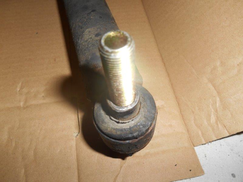

Cleaning today, nothing really interesting
Not really satisfied with the result, and found some rust point I have to repair before re-assembly all the parts…

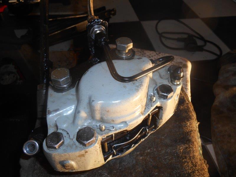

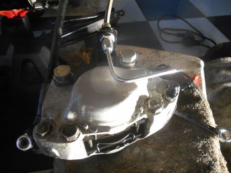

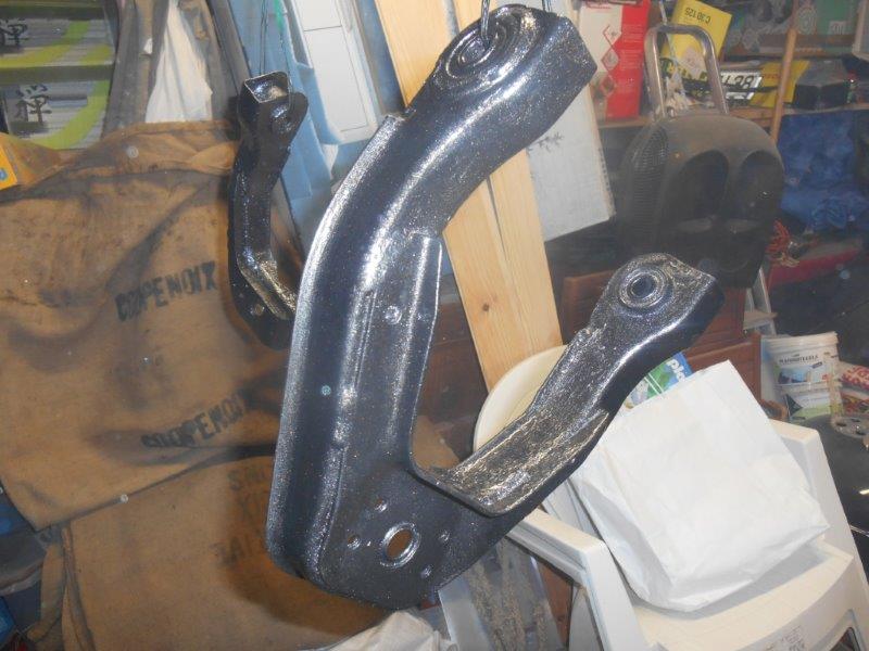

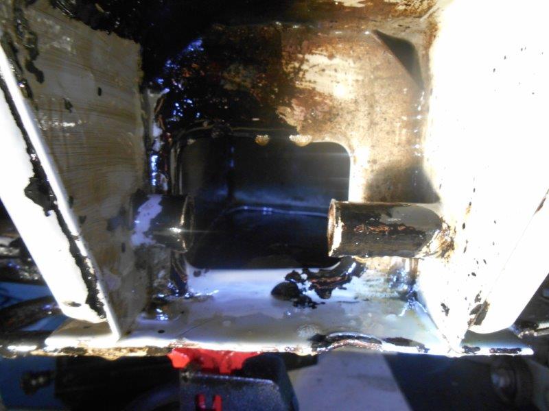

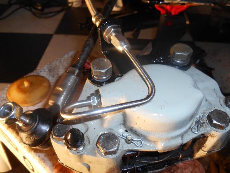

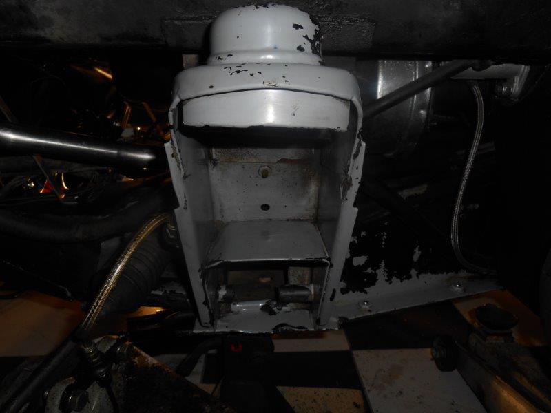

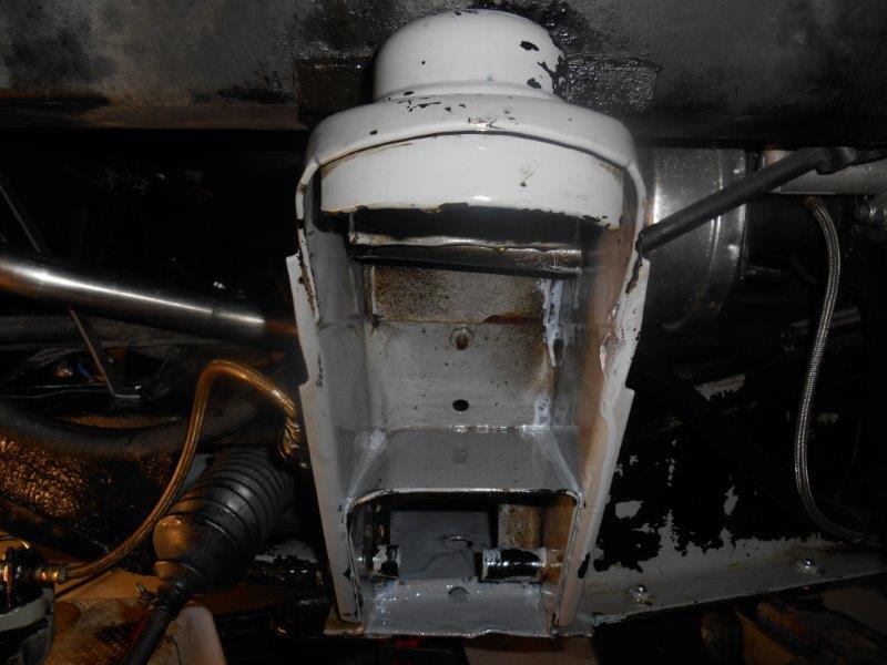

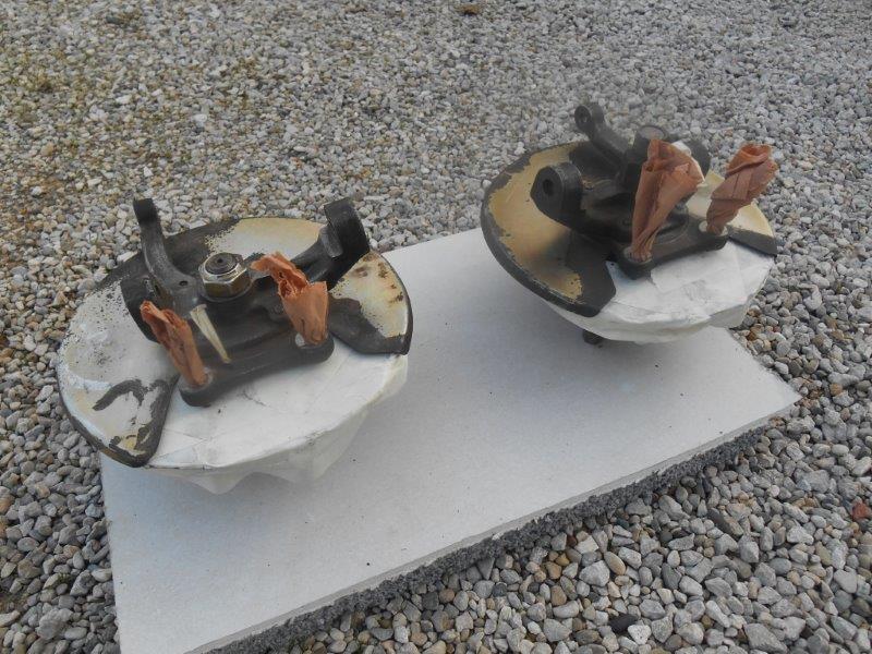

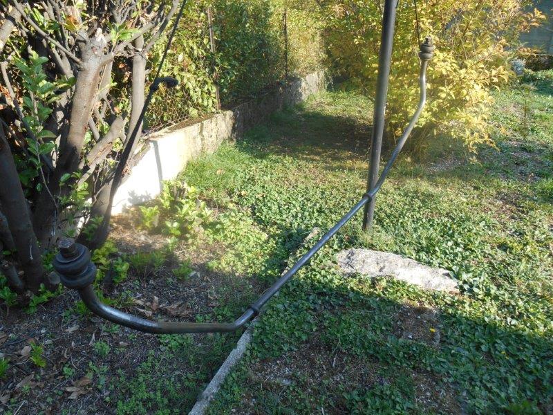

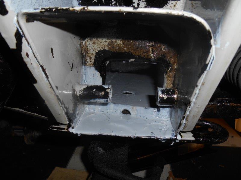

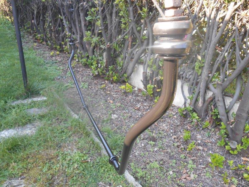

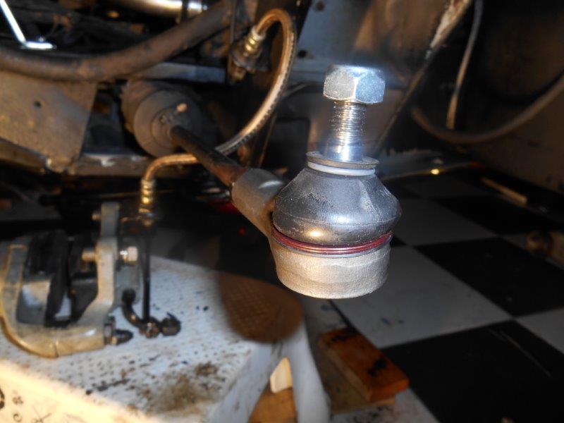

Postby Domi » Sat Nov 12, 2016 6:27 pm
Removed old paint and then applied some rustol before POR15
Then, replaced old pipes to new stainless ones from Josh

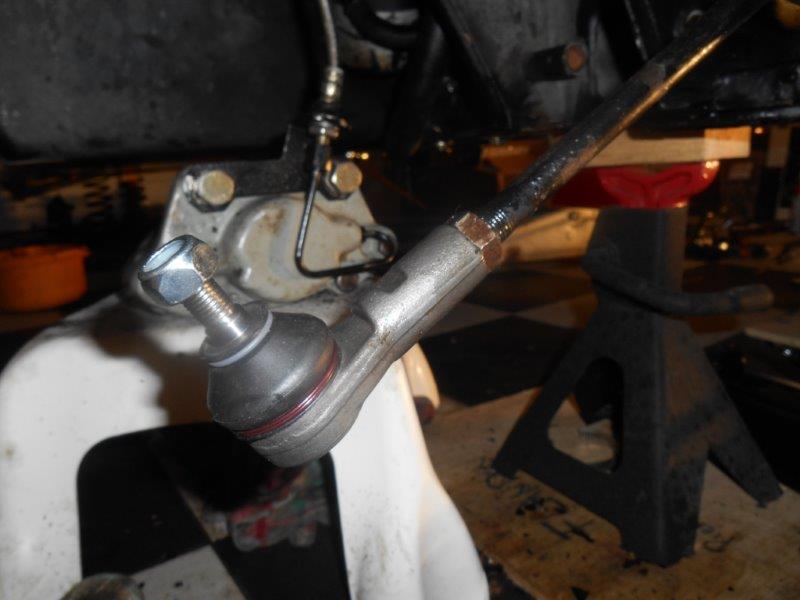

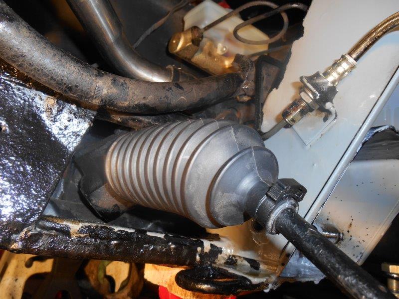

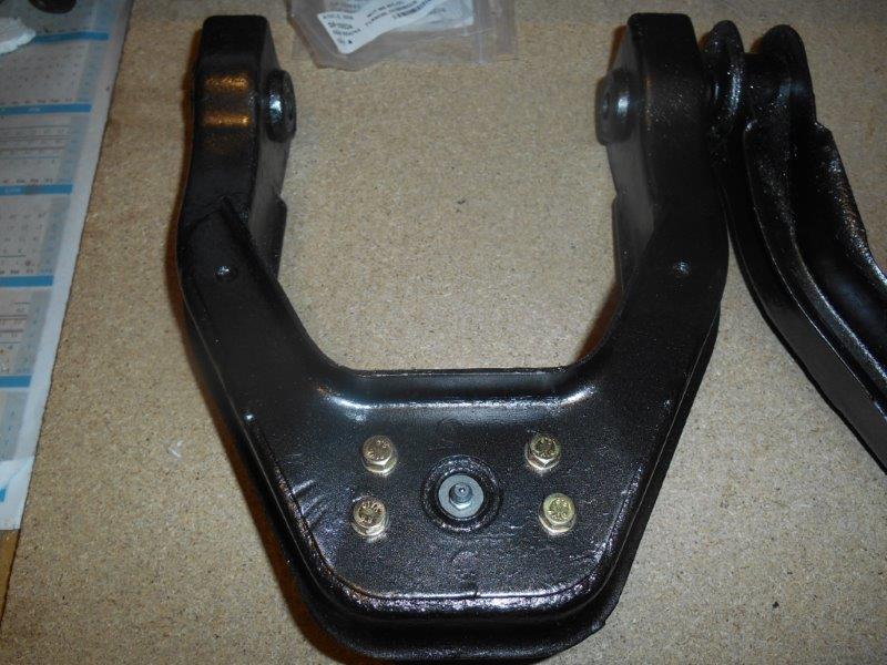

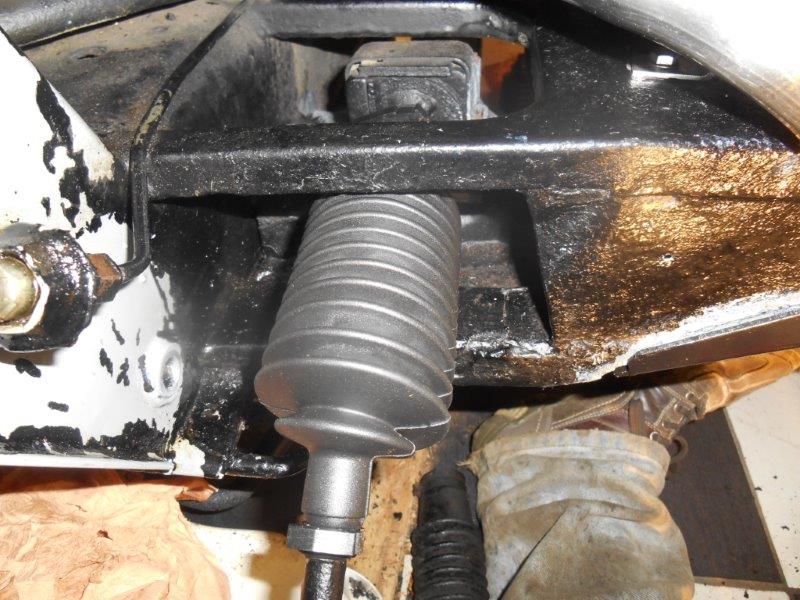

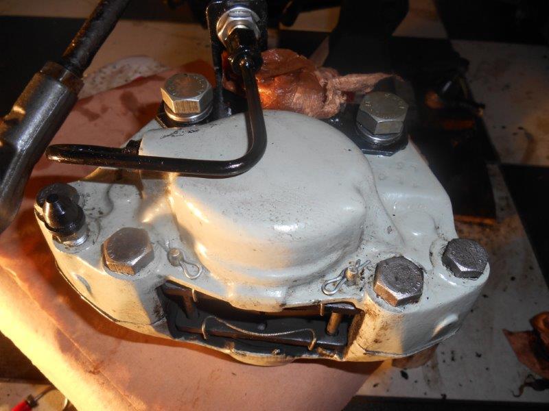

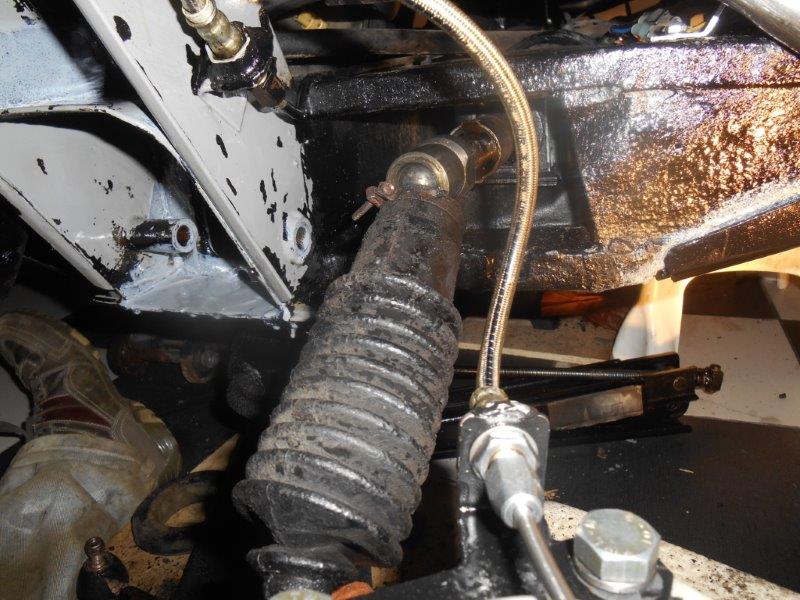

Postby Domi » Sat Nov 19, 2016 6:57 pm
POR15
Installed new boot
Posts: 1004

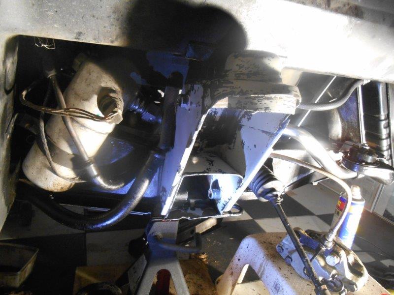

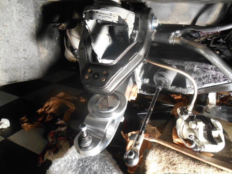

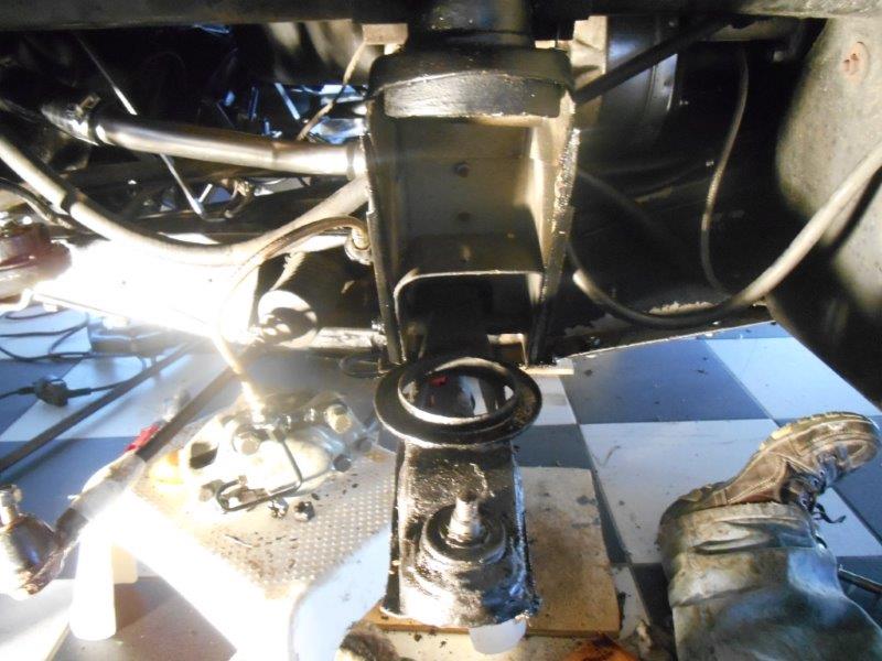

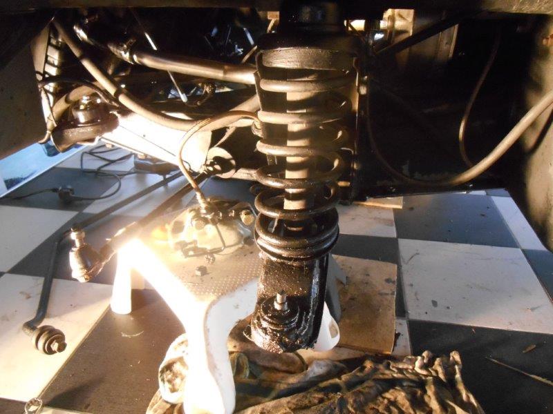

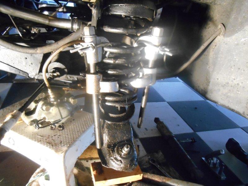

Postby Domi » Wed Nov 23, 2016 10:07 pm
Lower and upper arm on the frame
Posts: 1004

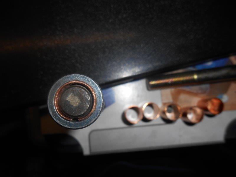

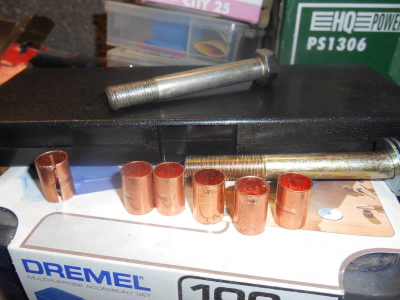

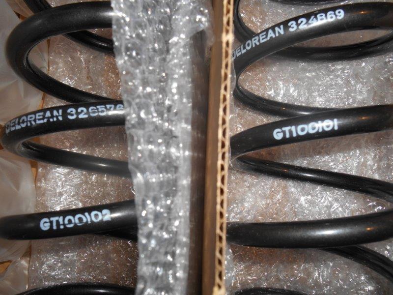

Postby Domi » Fri Nov 25, 2016 8:41 pm

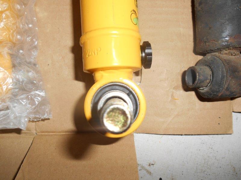

I bought the Spax a long time ago and I'm ready to install them.
One question on the front, please.
Is it important that there is a gap between the screw?
Please the pic of the old and new to compare

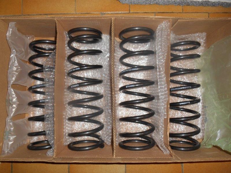

For those who bought the Eibach spring, can you please confirm the smaller one are for the front?
Many thanks ;)

Postby Domi » Sat Nov 26, 2016 6:13 pm
Find a way to fix the gap with cooper
Posts: 1004
Postby andyd » Sat Nov 26, 2016 9:15 pm
Hi Domi,
I had the opposite problem- half inch bolts (? Right?) With 12mm bushes in the shocks. Early Spax i think...? I had the undersize bushes reamed to fit. I presume your bushes are 13mm? With 12.7mm bolts.
Copper may be too soft for this application long term? Anyone got a more learned engineering opinion?
Postby Domi » Sat Nov 26, 2016 9:34 pm
andyd wrote:I had the opposite problem- half inch bolts (? Right?) With 12mm bushes in the shocks. Early Spax i think...? I had the undersize bushes reamed to fit. I presume your bushes are 13mm? With 12.7mm bolts.
Absolutely.
