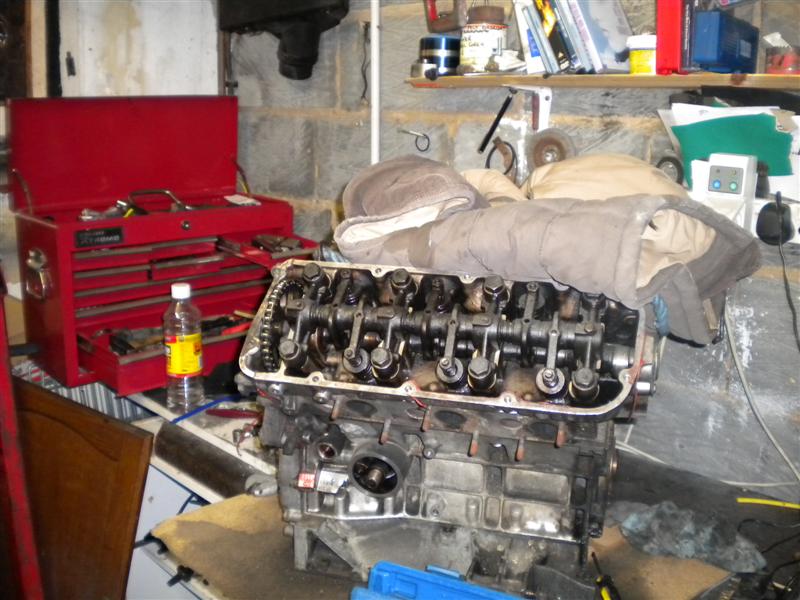

nice you could use it rob, a nice tidy garage as well :D unlike mine
4 002 (Medium).jpg (85.52 KiB) Viewed 3220 times
