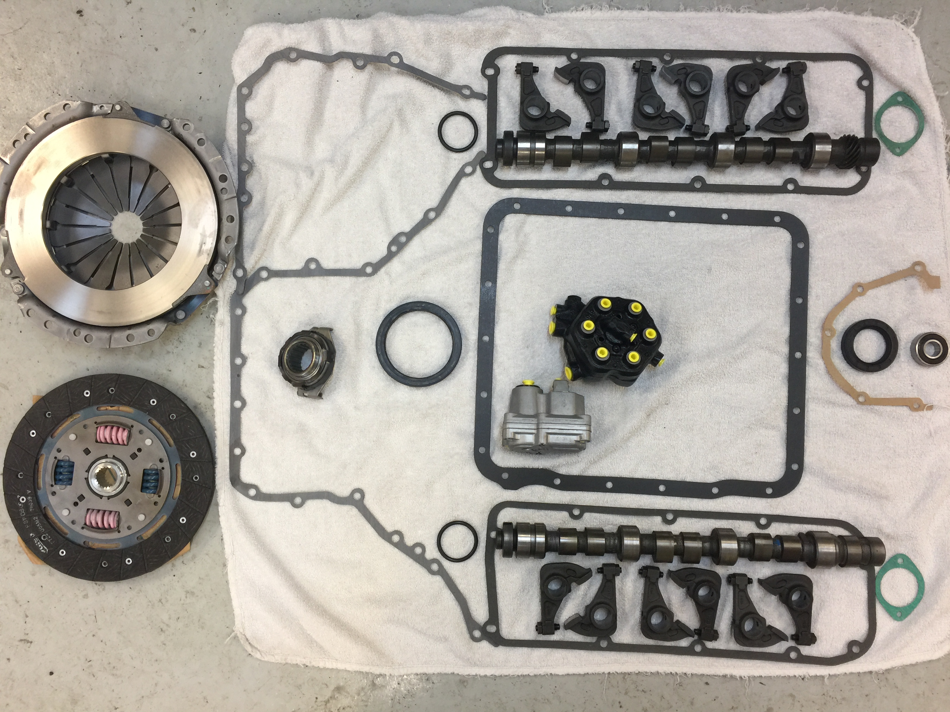

Postby gruffalo » Fri Mar 23, 2018 8:39 pm
More parts arriving, but it’s gonna be about a week and a half until assembly of the engine can commence since I decided to replace the valve train. And parts are on their way.

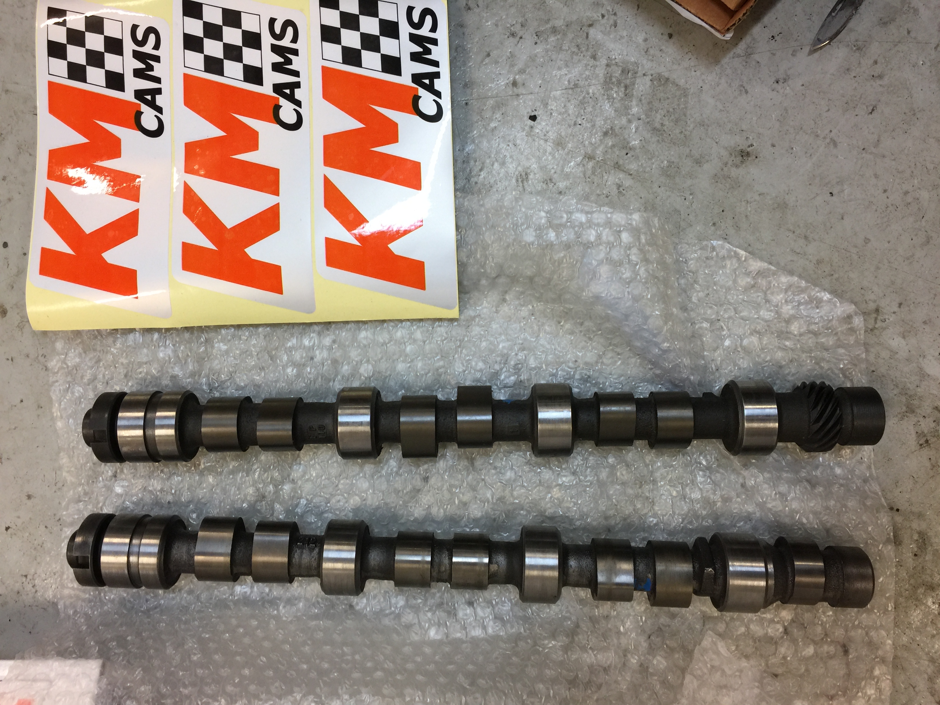

Postby gruffalo » Sat Mar 31, 2018 8:04 pm
Unboxing some goodies, just waiting for the lifters now.

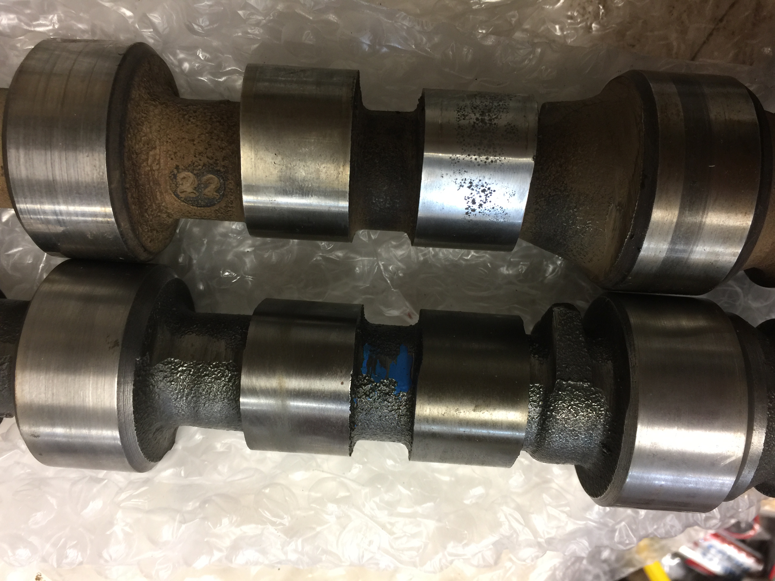

New cams!
New vs old

Postby jerzybondov » Mon Apr 02, 2018 5:51 pm
Nice new cams! Did you get them reprofiled to a different lift profile or are they kept stock? Whatever you do, make sure you run them in properly or you'll be taking out the engine again a few thousand miles later :o :shock:

Postby gruffalo » Mon Apr 02, 2018 10:55 pm
I’ll do my best to run them in as well as possible, but I’m not sure if the engine is going to start immediately, or run for that matter. That’s an x-factor. I’m also debating whether I should put some special break in substance on them, or just soak them in engine oil. I spoke to a professional mechanic who said it was more critical in americano v8 with splash lubrication only.
The profile is stock, at least no obvious difference to the naked eyes.

Postby bandit » Tue Apr 03, 2018 8:37 am
Don’t put any ‘run in’ crap anywhere, just use engine oil on all the moving parts when building, then once done & fitted, spin it over on the starter for a while until you get oil pressure, before firing it up.

Postby gruffalo » Tue Apr 03, 2018 11:52 am
I spoke to KM Cams who sold me the cam shafts, and they recommended me to the following:
-soak everything in normal engine oil
-avoid idle, keep the rpms up to ensure adequate oil pressure (for "a while")
-leave the grey coating on the cams on, it's there for lubrication
