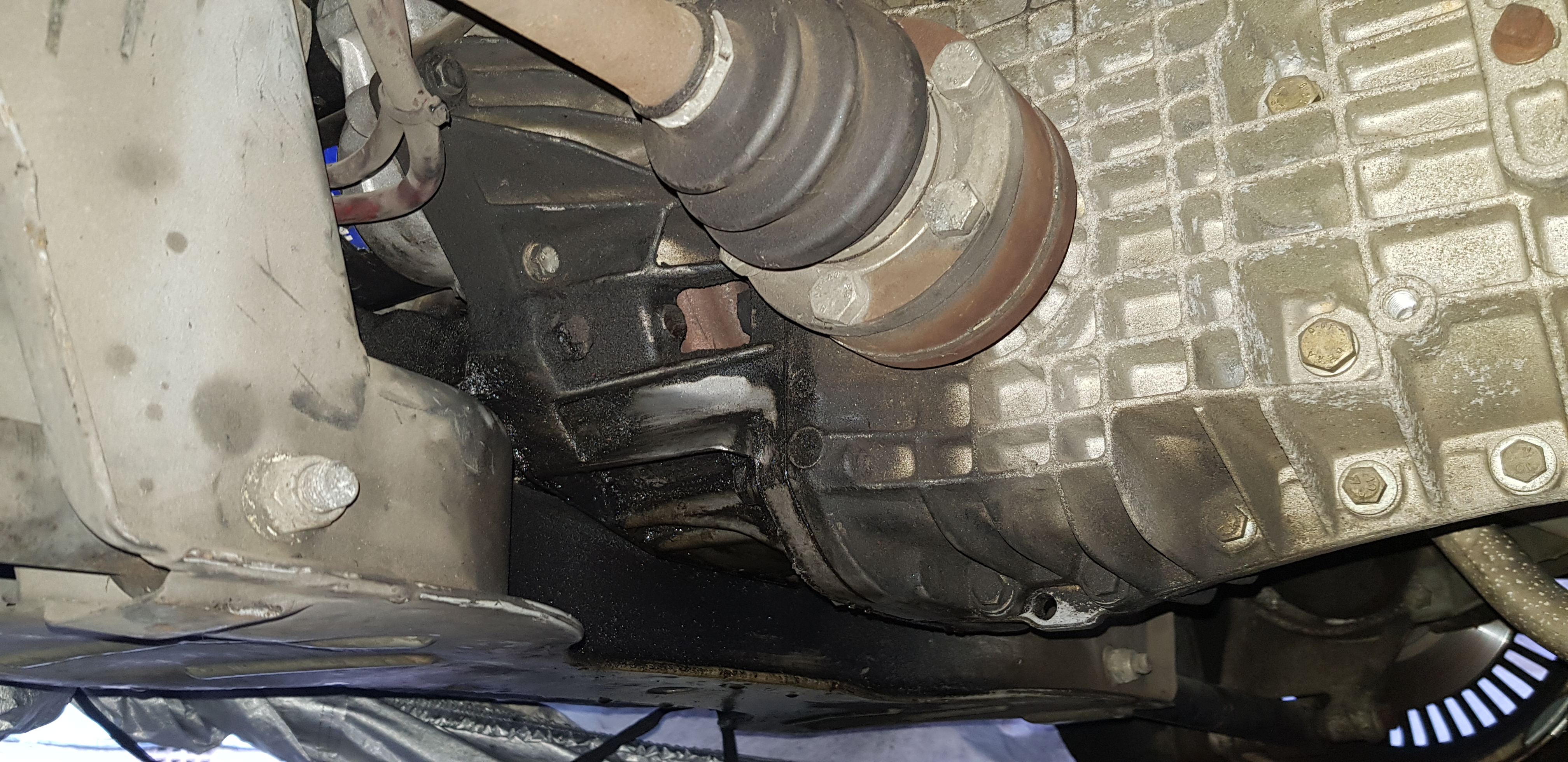

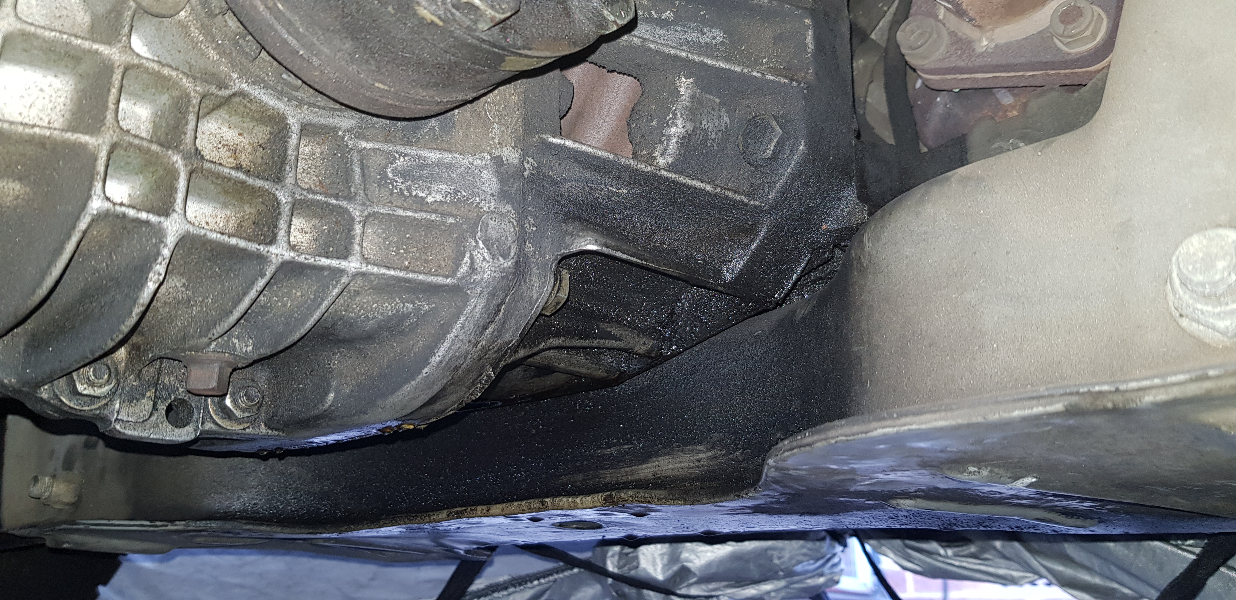

Postby DMC1983 » Thu Sep 26, 2019 5:20 pm
What my gearbox looks like currently
Re: VIN 5219
Postby Dan 6511 » Thu Sep 26, 2019 9:13 pm
I looked at mine this evening after it had a 100+ mile run at the weekend. Exactly the same, oil on the chassis cross member and running down the bell housing to the lowest point on gearbox. I just wiped it off and will live with it for now. The level on the dipstick hasn't dropped that much at all in over 2k miles.
Re: VIN 5219
Postby bandit » Thu Sep 26, 2019 9:19 pm
Yeh it’s like spilling a glass of milk. Half a pint, but it looks like a gallon. Mines leaked from the crank seal for yrs, but it’s fuck all really. Stops rust on the cross member :thumbsup:
Re: VIN 5219
Postby DMC1983 » Fri Sep 27, 2019 7:45 am
Ok. It will be a job to do eventually then. Im still planning on bringing my car to the meetup. See you all there
Re: VIN 5219
Postby A Van » Fri Sep 27, 2019 12:30 pm
I wouldn’t worry at all about changing that seal until your clutch goes
Then it’s an excuse to take it out and do both jobs
