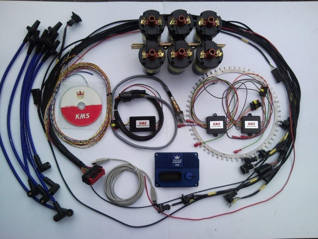

Posted on behalf of Nico , who will have some current video and photos from his dyno test runs soon :)
This is the management set without al the sensors.
The triggerwheel is mounted on the flywheel
this is for the ignition and the injection
Nico
kms set.jpg (115.19 KiB) Viewed 6123 times

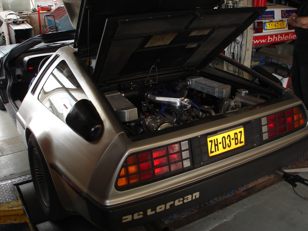

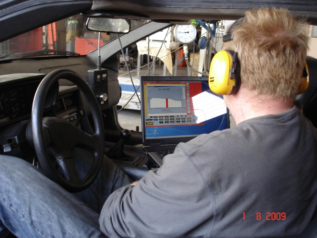

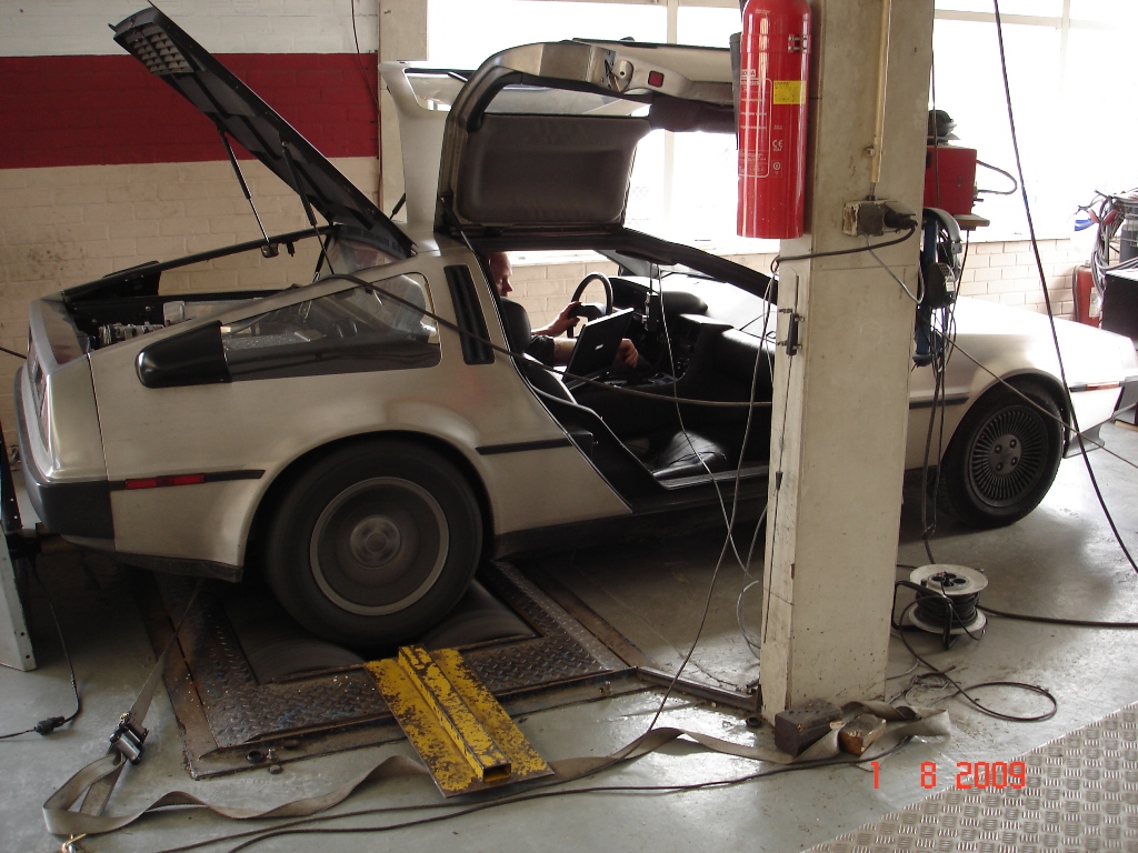

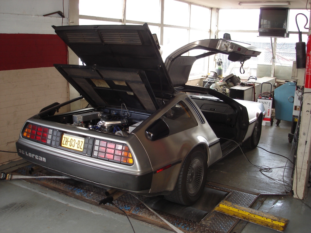

hi arran
here some pics of yesterday and hope you can open the video,
we had 214 BHP at the wheels
regards
nico

Re: VIN# 3662 Twin Turbo Black Manual Holland
Postby arranj » Sun Sep 06, 2009 6:19 pm
My crude maths puts that at around 255 BHP at the flywheel.... (give or take 10BHP either way)
