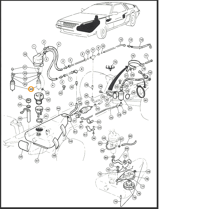

I tinkered about with the car this evening starting with the fuel tank. The old fuel pump boot had disintegrated into the fuel tank and its contents lay stuck to the bottom so I had to remove it...
The item below was floating about the tank...its a filter of some sort however there were the remains of gauze so its knackered whatever it is...can this be replaced ? If so where does it go?

Postby andyd » Thu Jan 23, 2014 6:10 pm
Its the pick up filter. Item 76 on this page. Part No 101643. 20 Euro from DMC Europe. Add it to your shopping list! I think you'll probably want to replace most rubber parts on that page?
