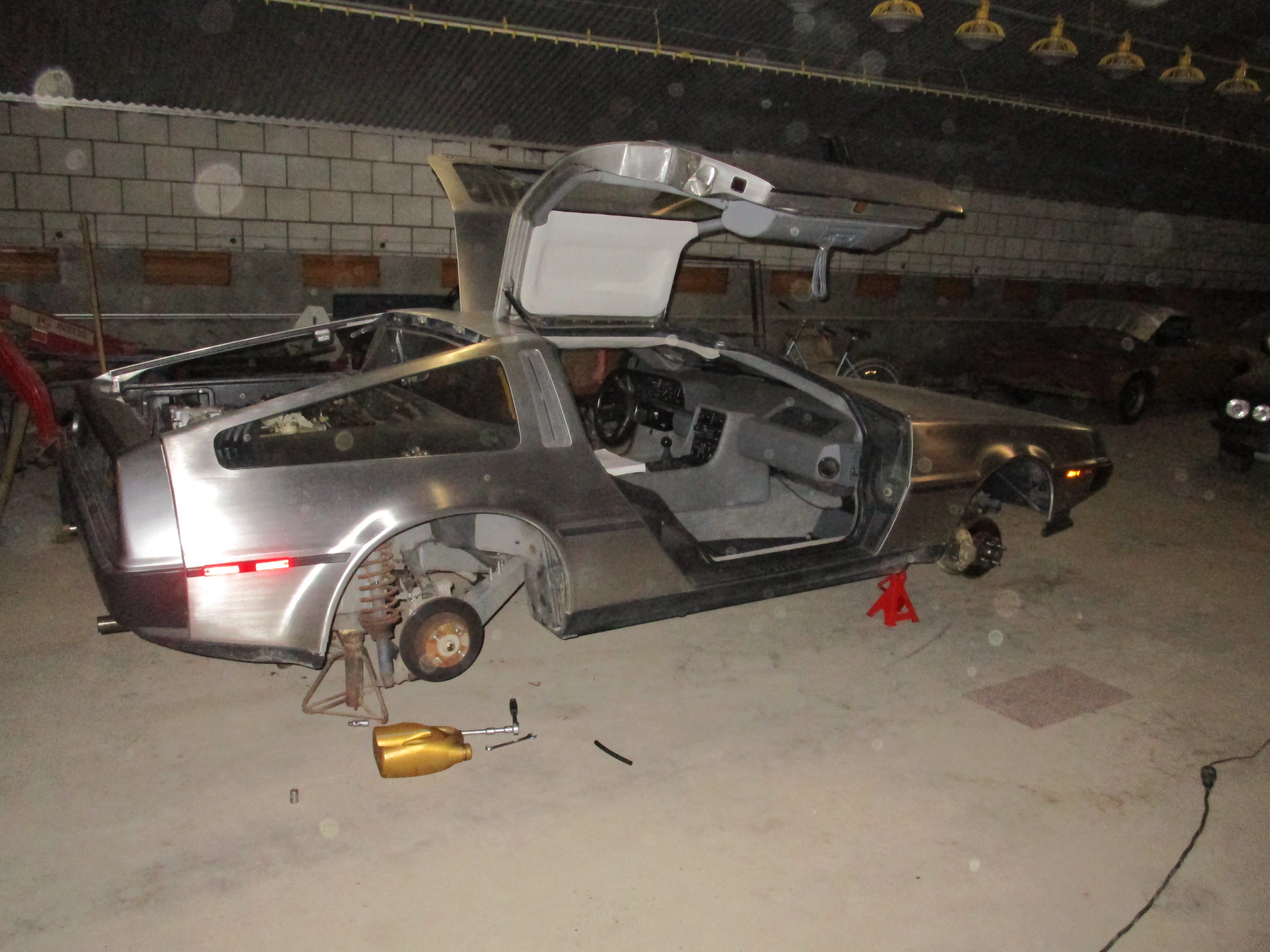

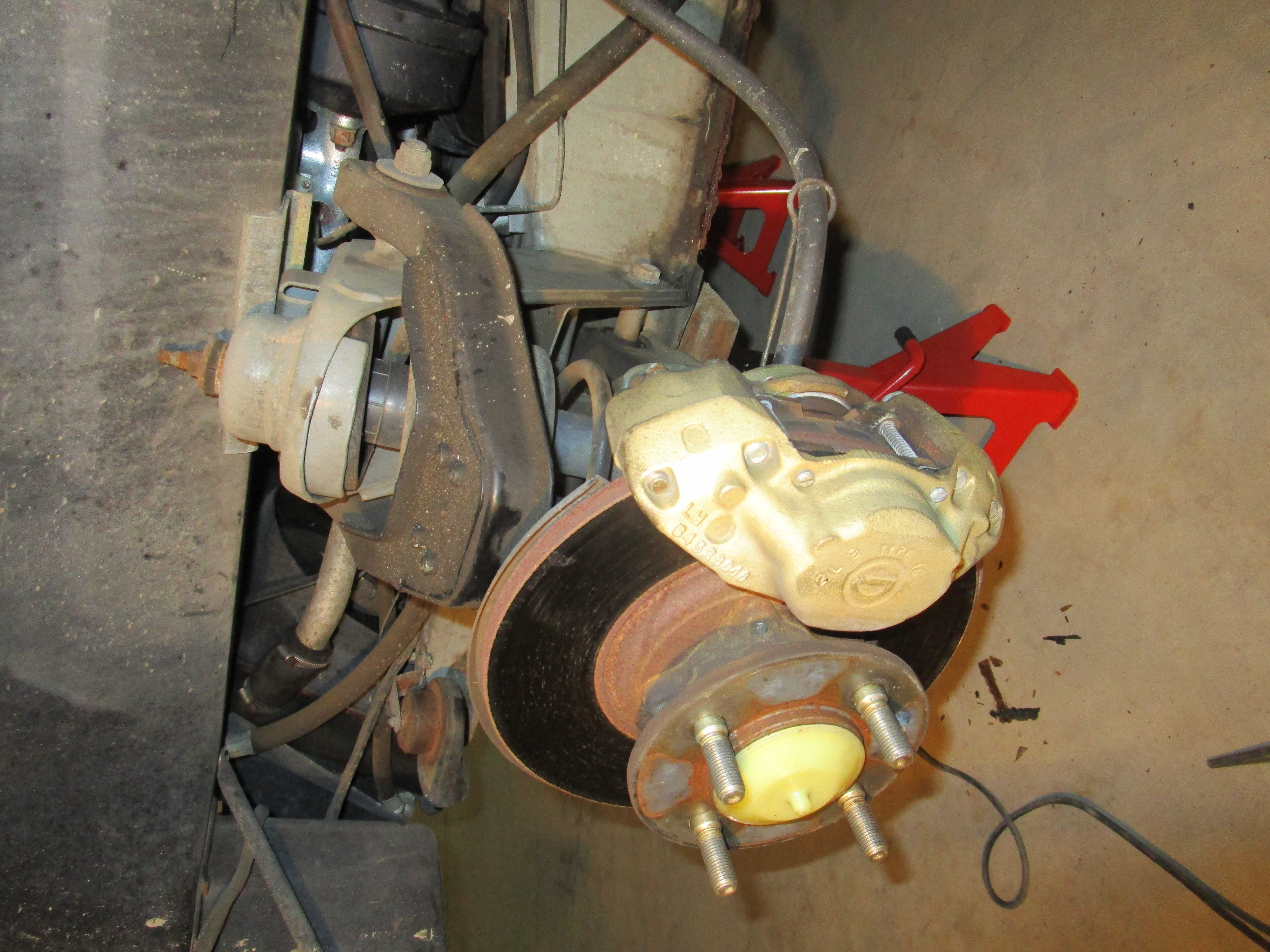

Today I took the rear calipers apart and cleaned them. Going to need new brake pads. On the hand brake one of the blocks came loose frome the metal plate it is glued to. So need a set of hand brake blocks. Then I removed the front tyres and had a nice suprise: almost new calipers an brake pads! Do need to replace the tie rod end rubber parts, they are torn. Looks like they are not that old, there is no paint on the metal. Also the rubber boot/ dust cover on the steering rack needs to be replaced both sides. The Lca's and sway bar could use some paint, but that has to wait, to cold for paint and the main goal is to get it MOT ready first. Need new brake hoses on the front and yesterday I removed the leaking clutch master cylinder. Time to order some parts now and move on with headlights modifications tomorow and remove the headliner.

While the wheels are off, check your LCA s very carefully!
viewtopic.php?f=13&t=5029

Yes I checked them for any signs of cracks after reading some horror story about them breaking.
Planning on boxing and powdercoating later.
