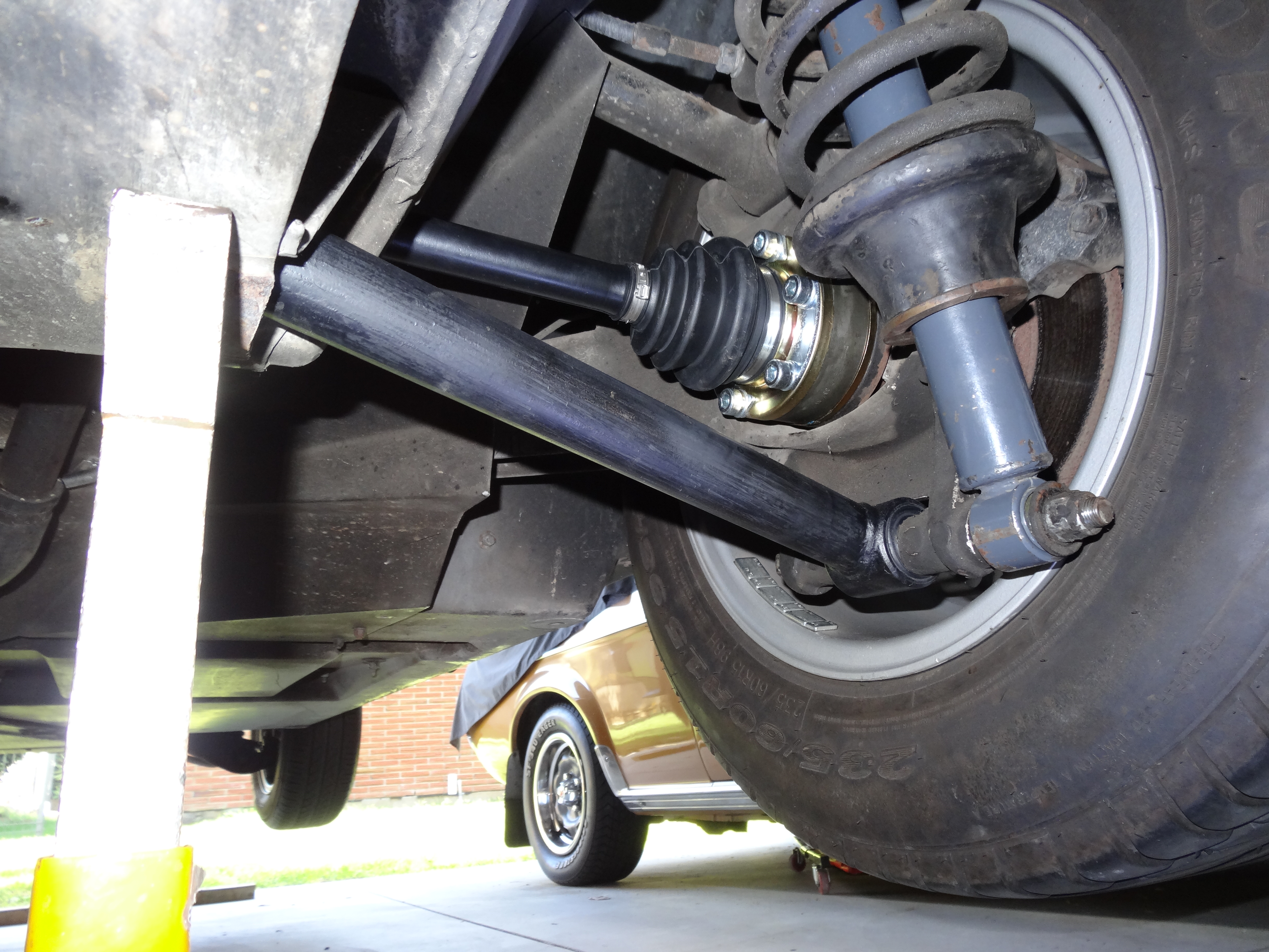

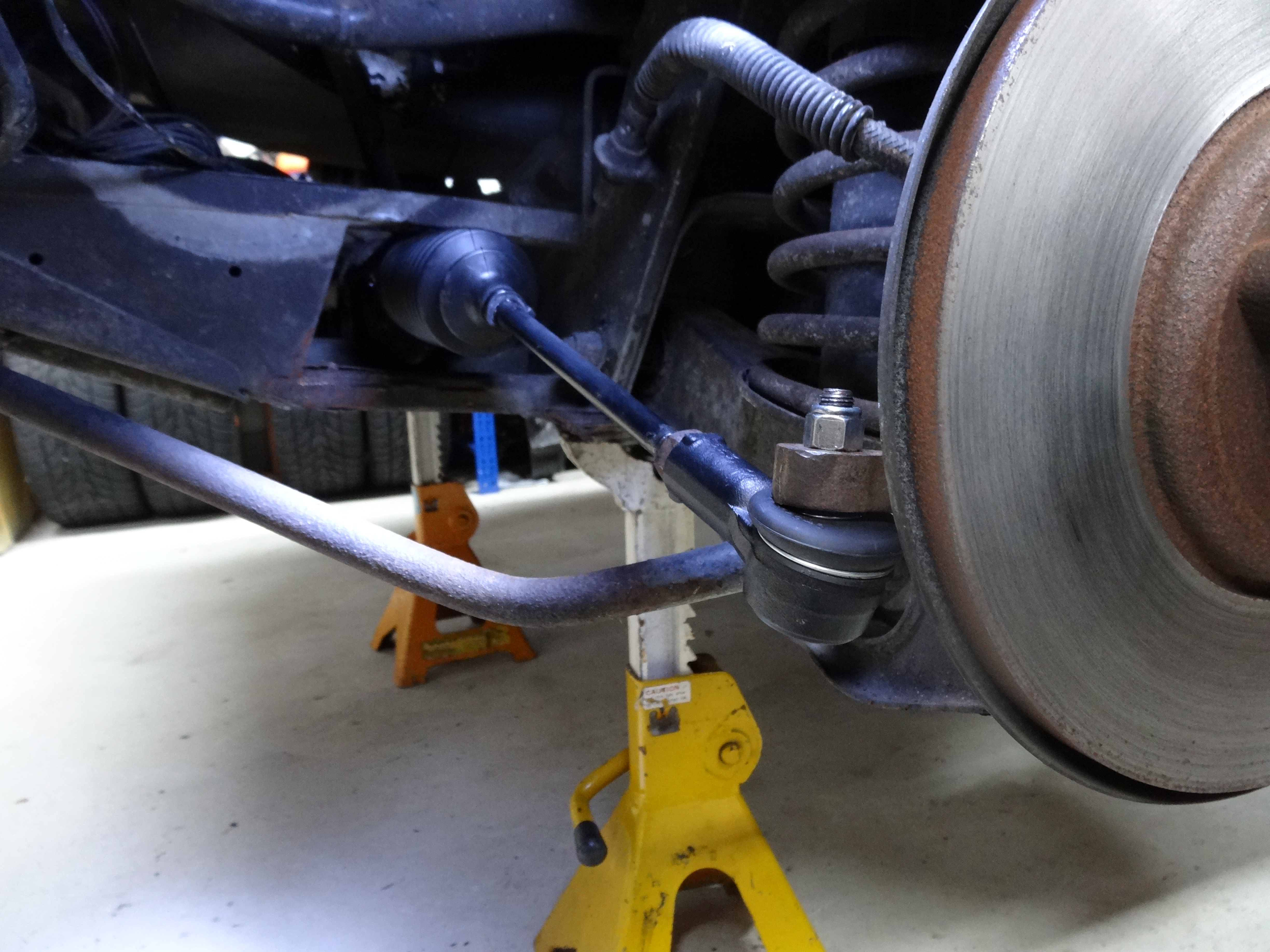

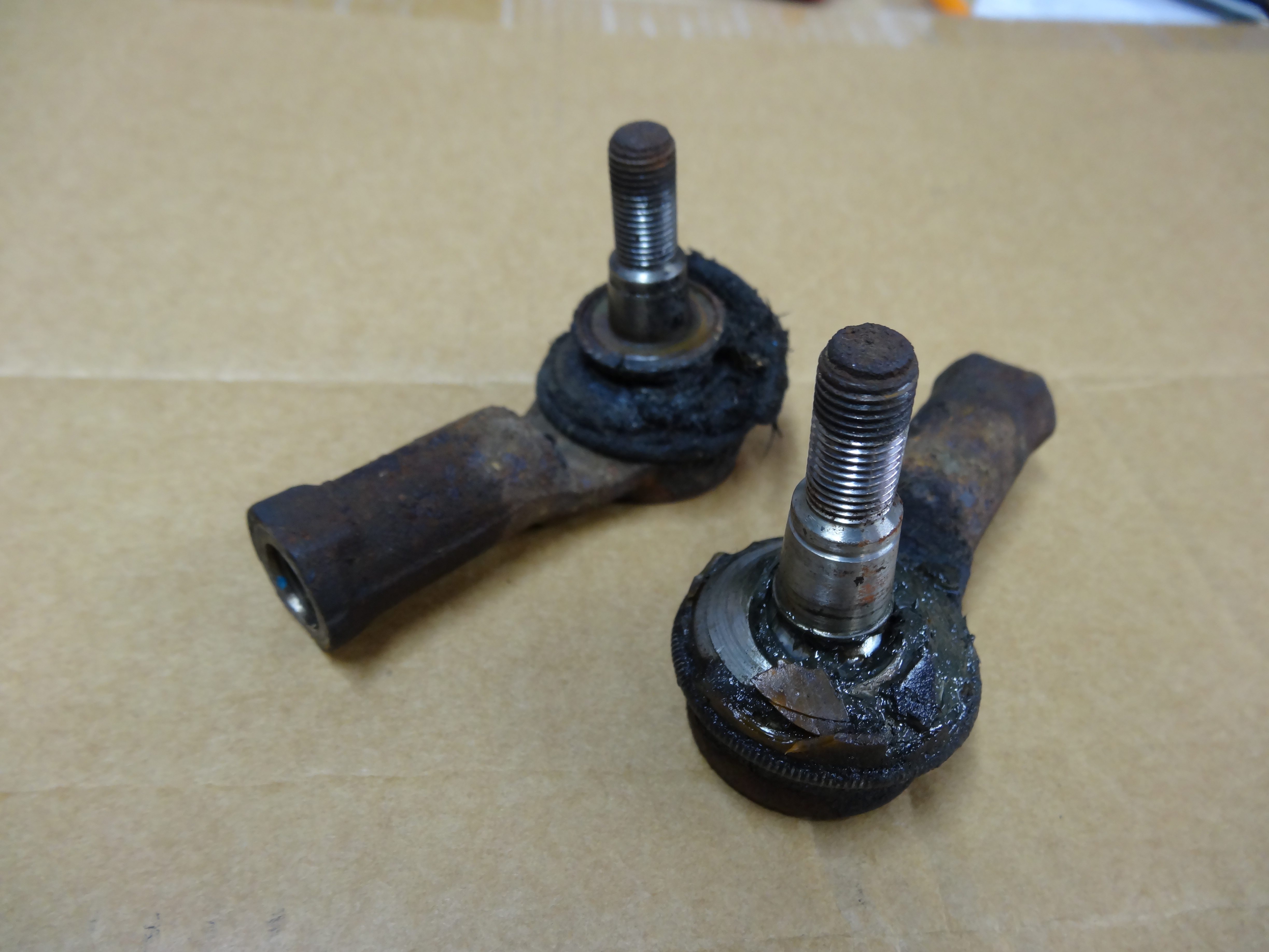

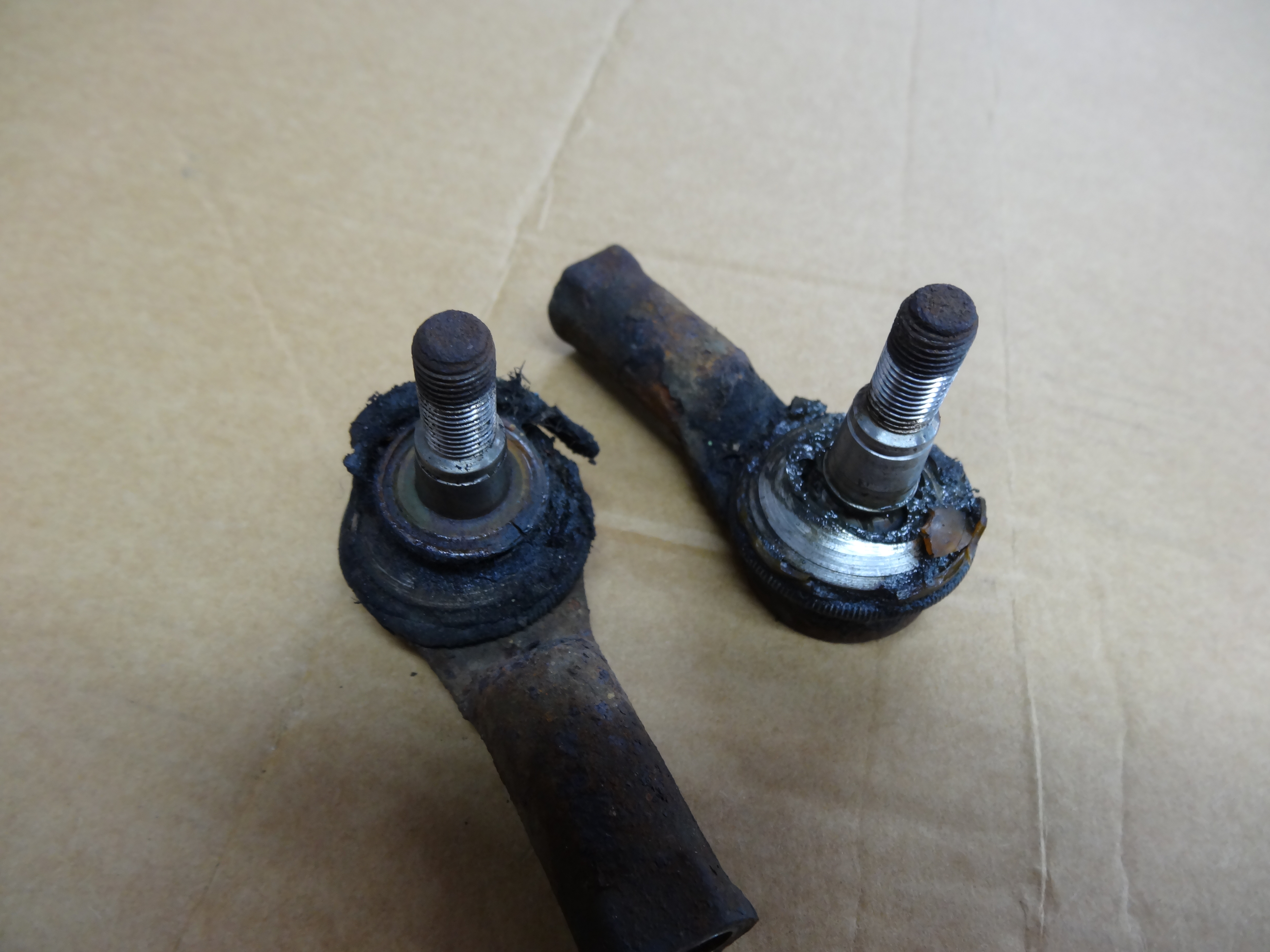

So next is to do a bit on the front end, i really want to get some lower springs in there but for now i needed to replace the tie rod ends as the boots had turned to dust but the joint itself is still in great condition, i think after 33 years they could do with a holiday, and while i'm there i replaced the steering boots as well, the originals were not broken just a little perished hence why the rack is in excellent condition but i changed them anyway
it was a little scary to drive this car as the brakes are atrocious, the front disc's were quite warped and the car had a terrible shake when the brakes did eventuality work, combined with the 16 year old Goodyear NCT's on the front made for an exciting ride, so i machined the front disc's and binned the tyres, the rest of the front looks in bad shape but the ball joints are good and everything else works as it should

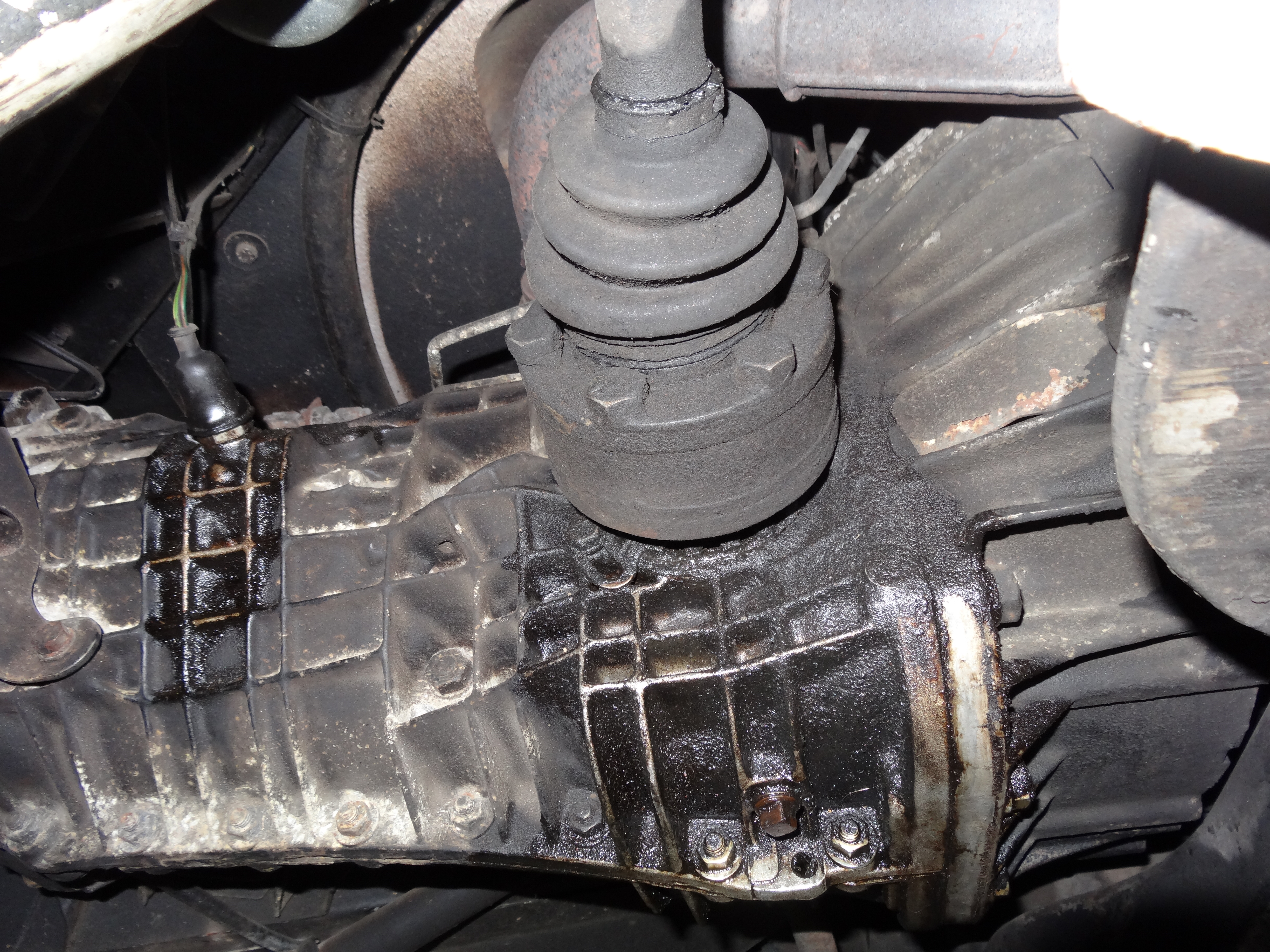

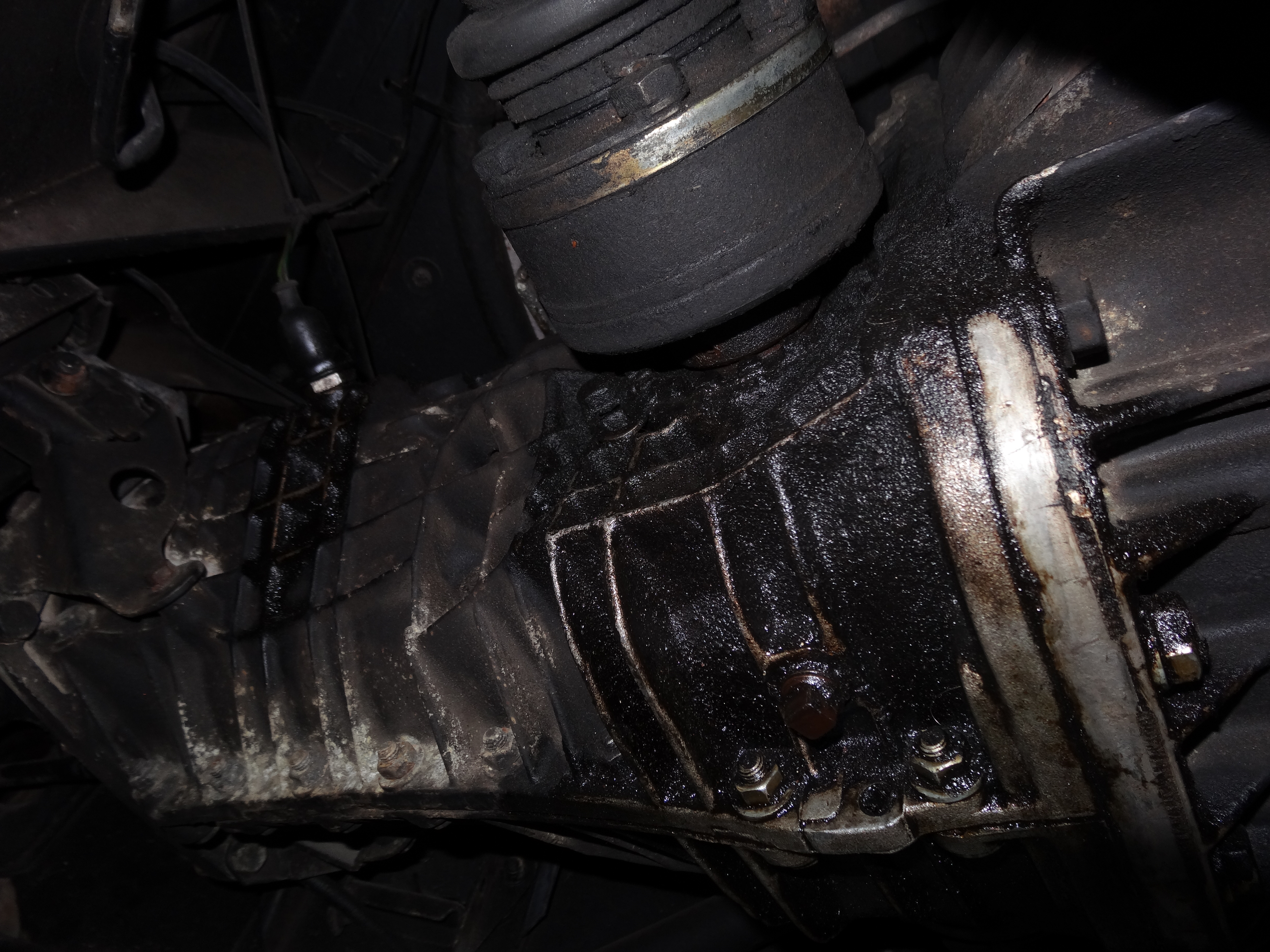

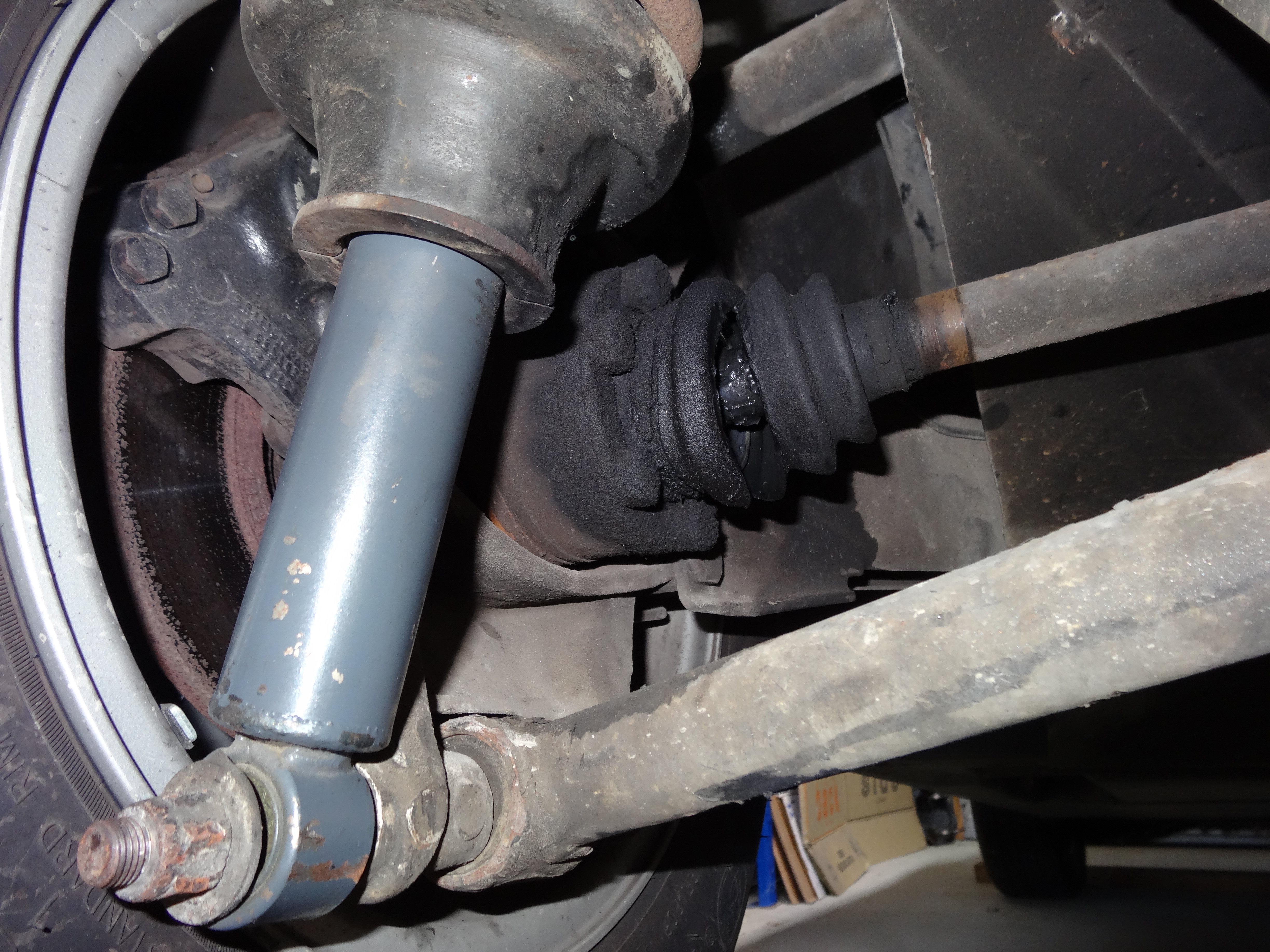

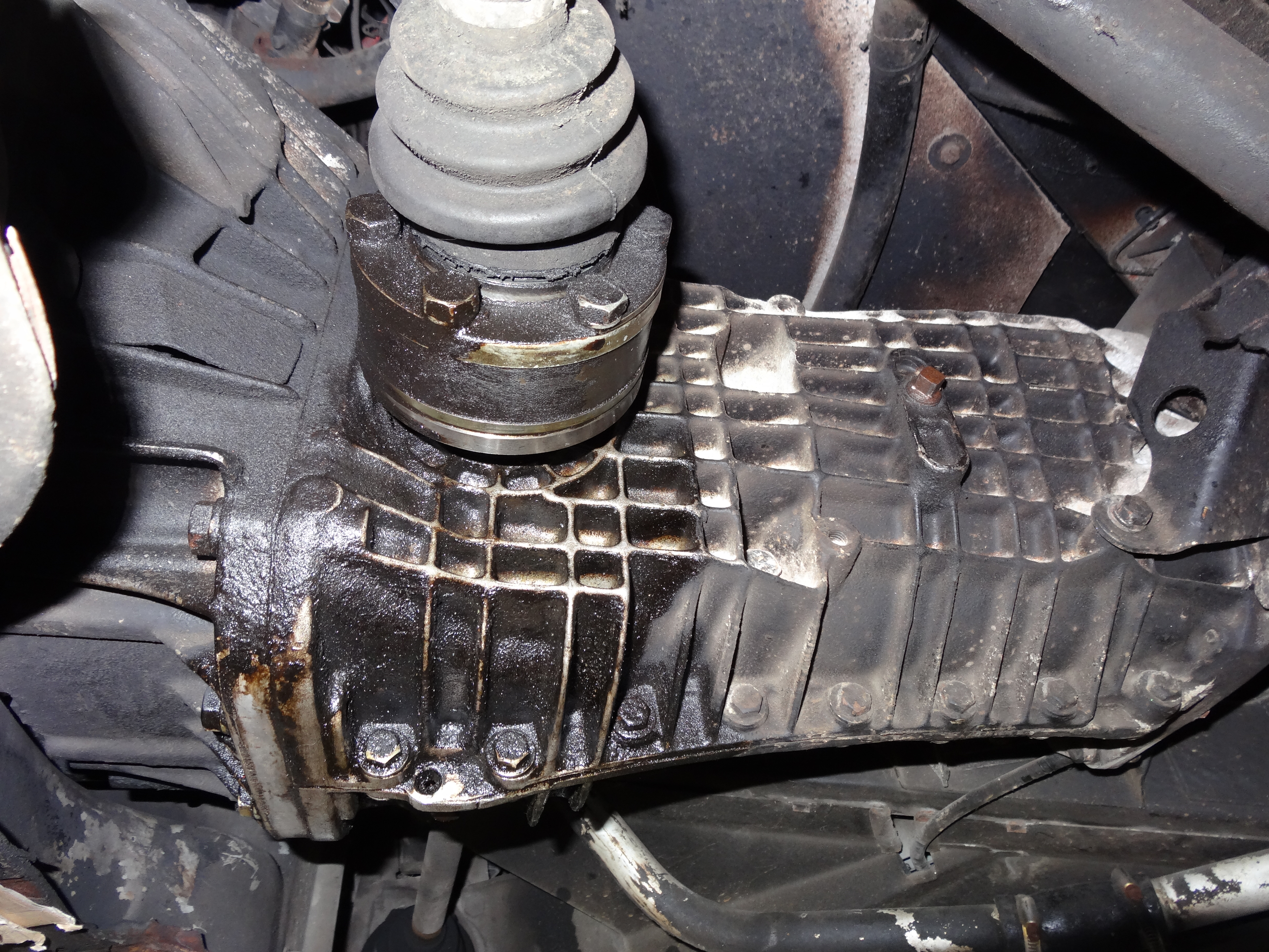

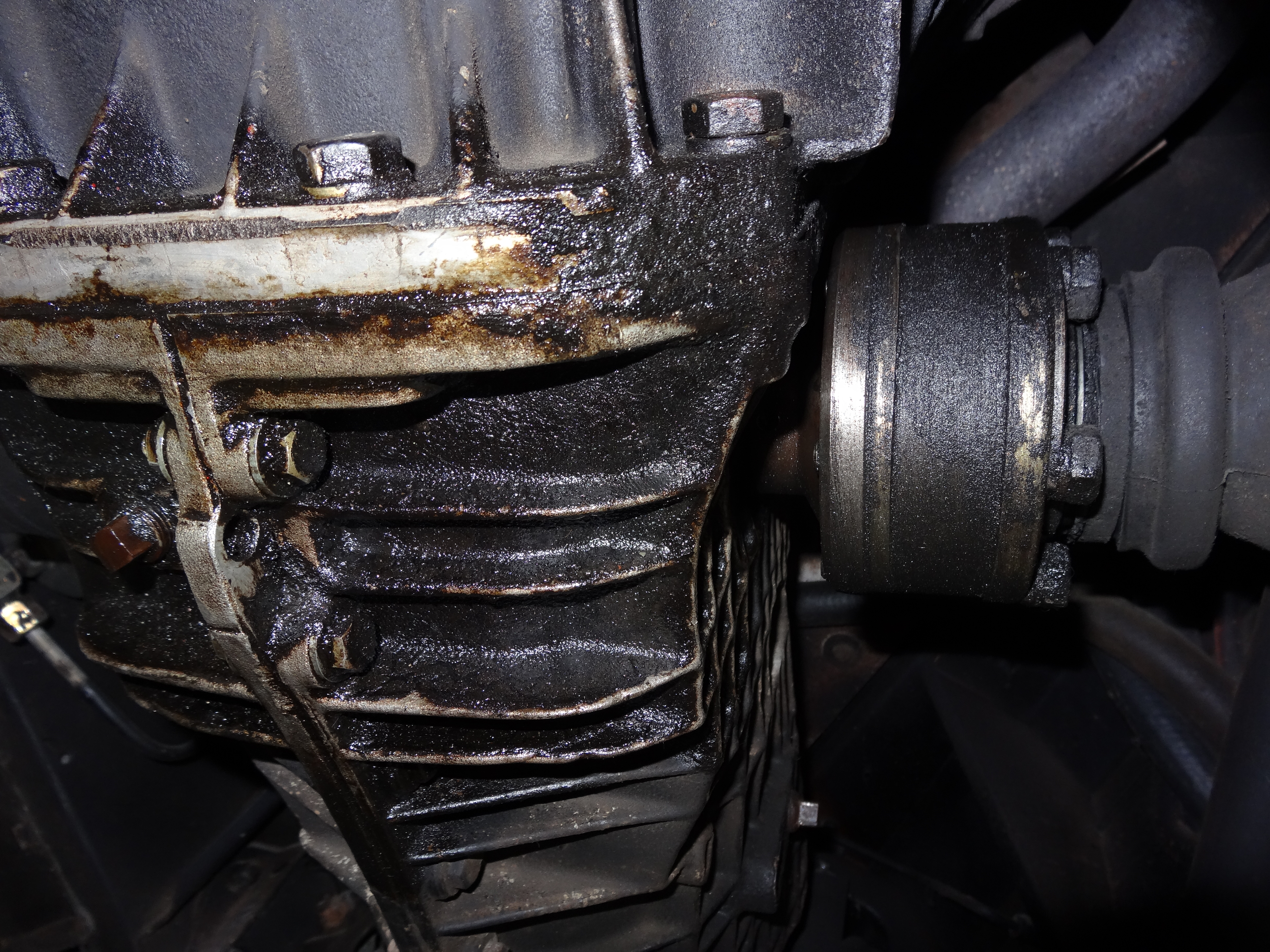

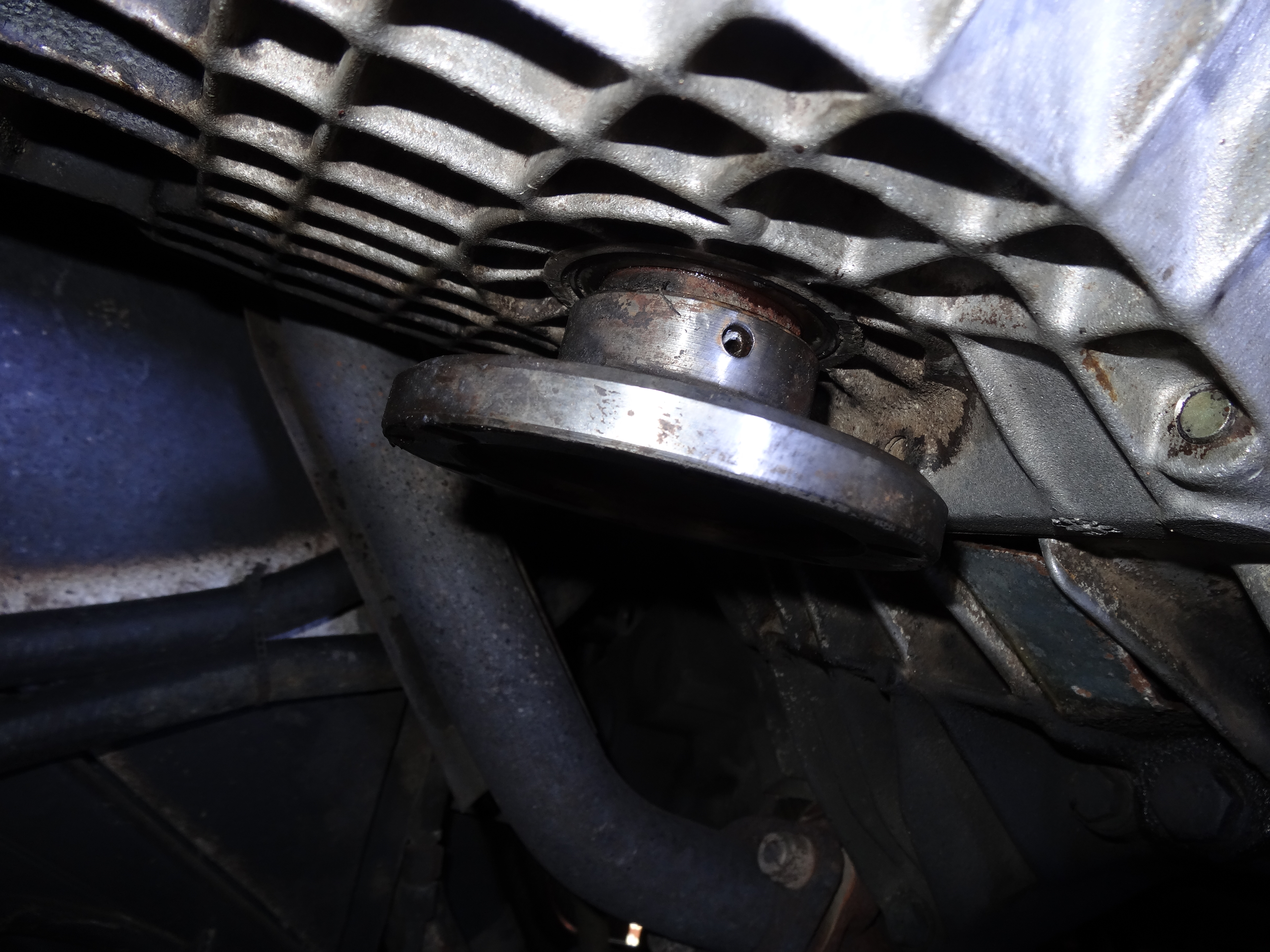

So i've now moved on to the back end and this is what it use to look like

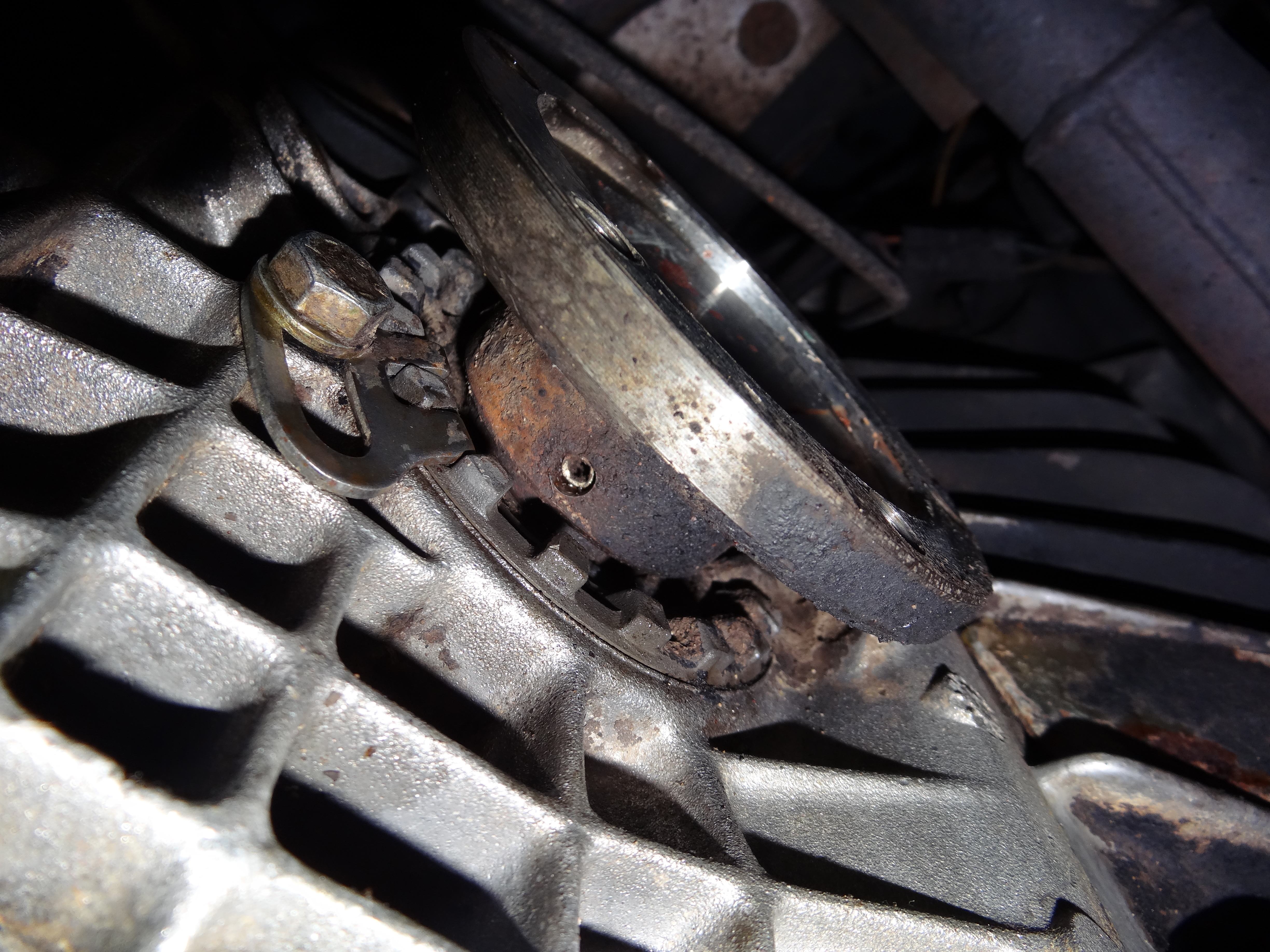

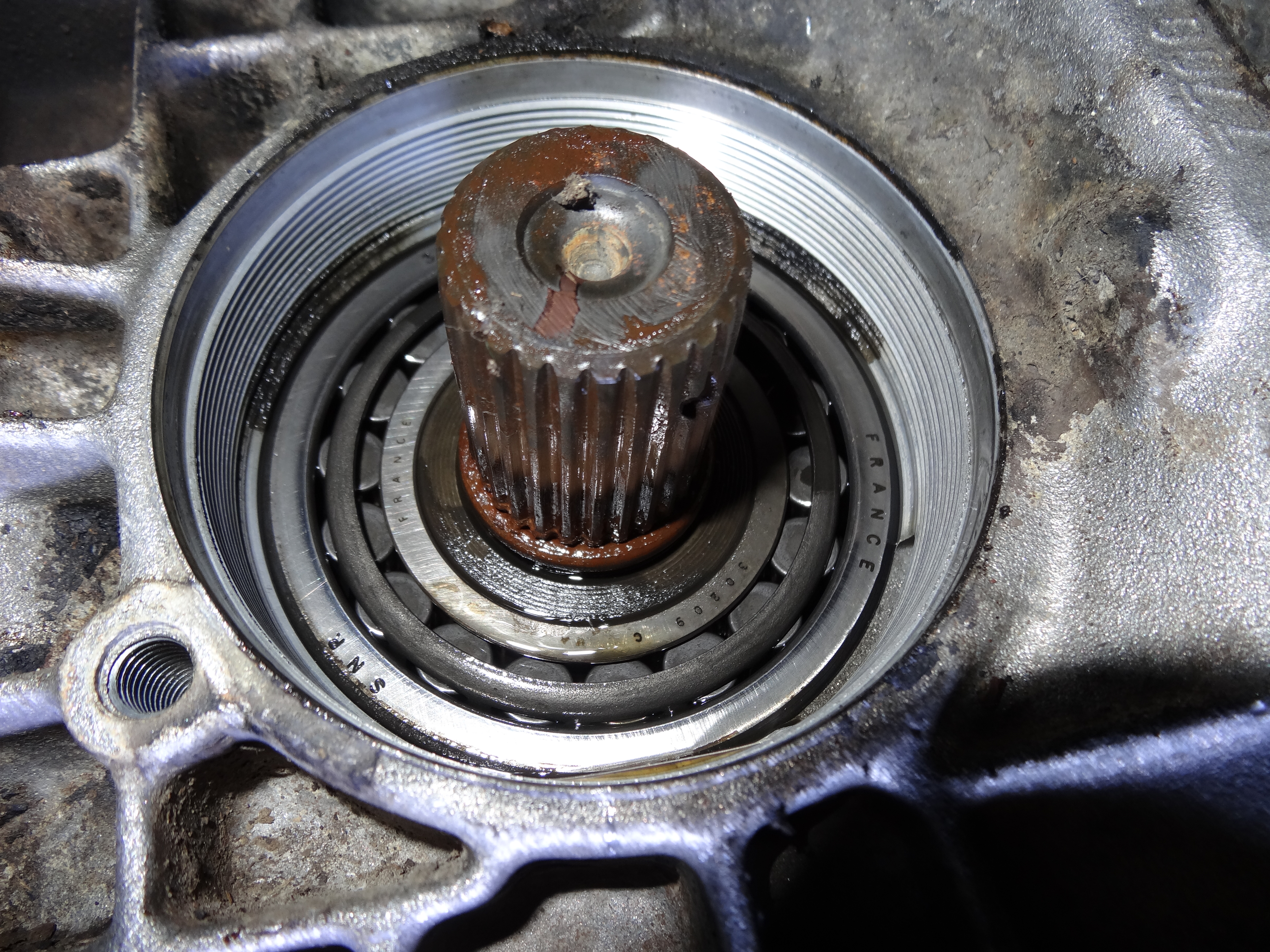

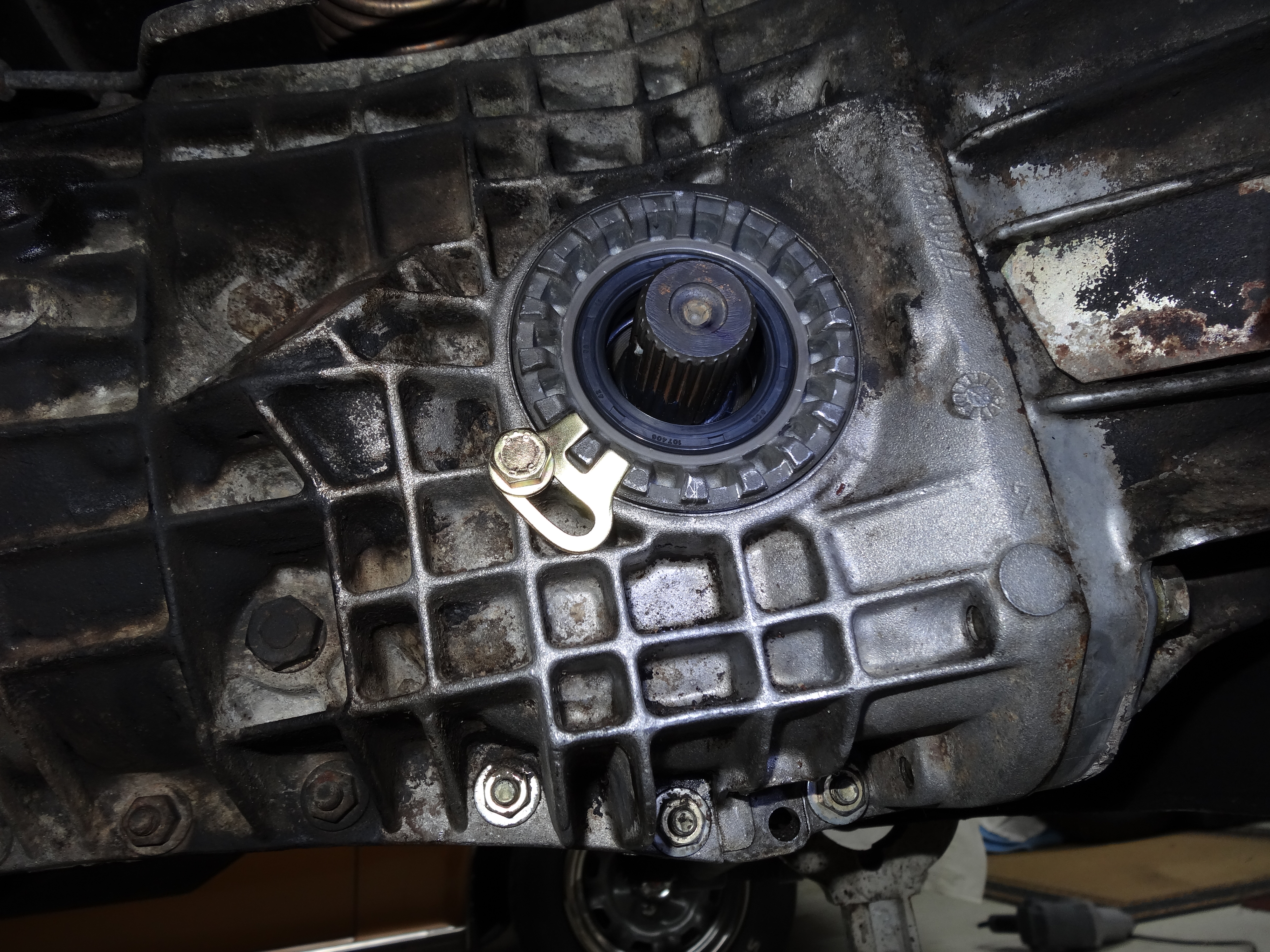

first job is to have a look at the weeping reverse light sender, very easy fix with a new dowty seal and reinstall without cross threading it,

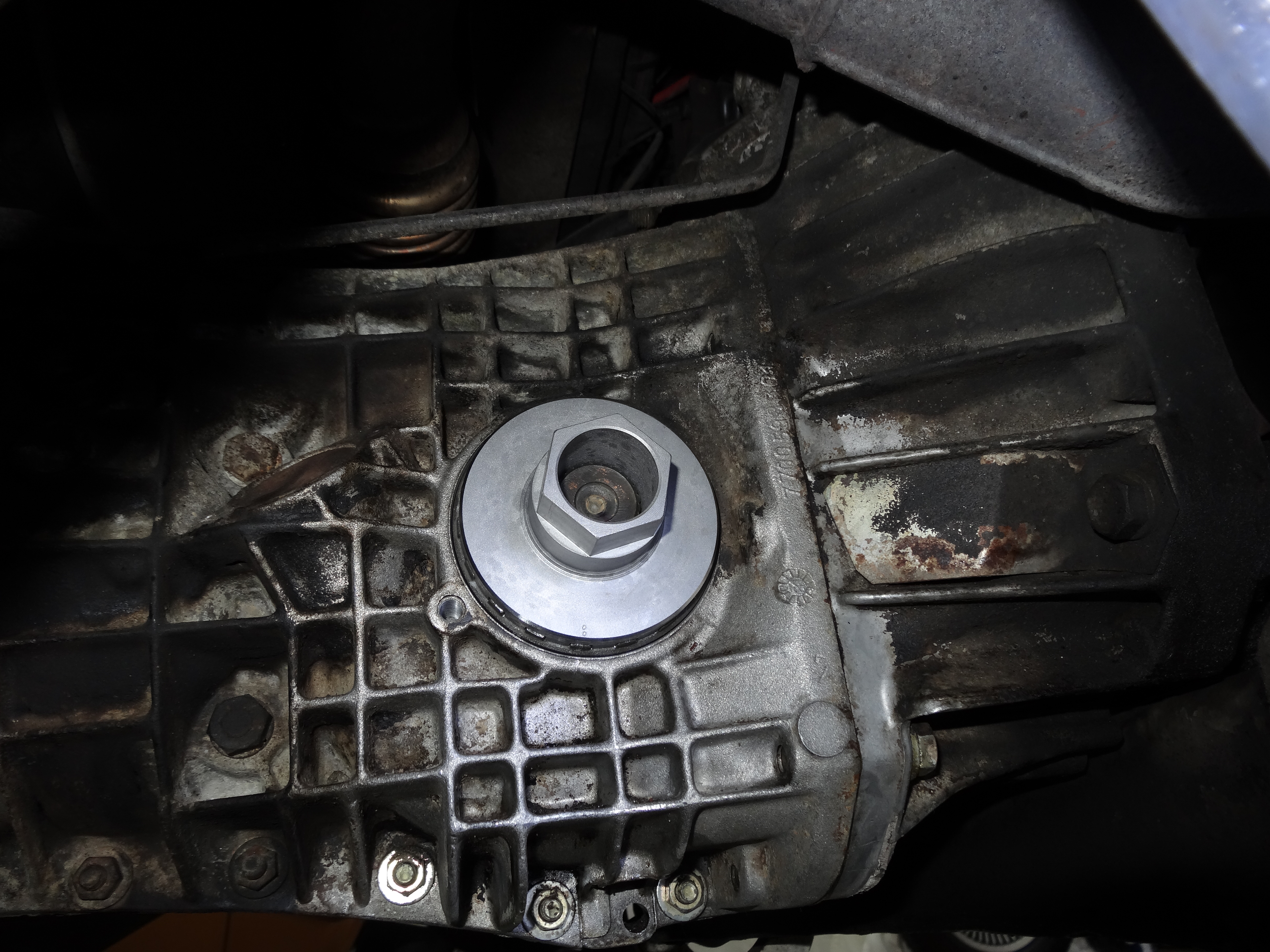

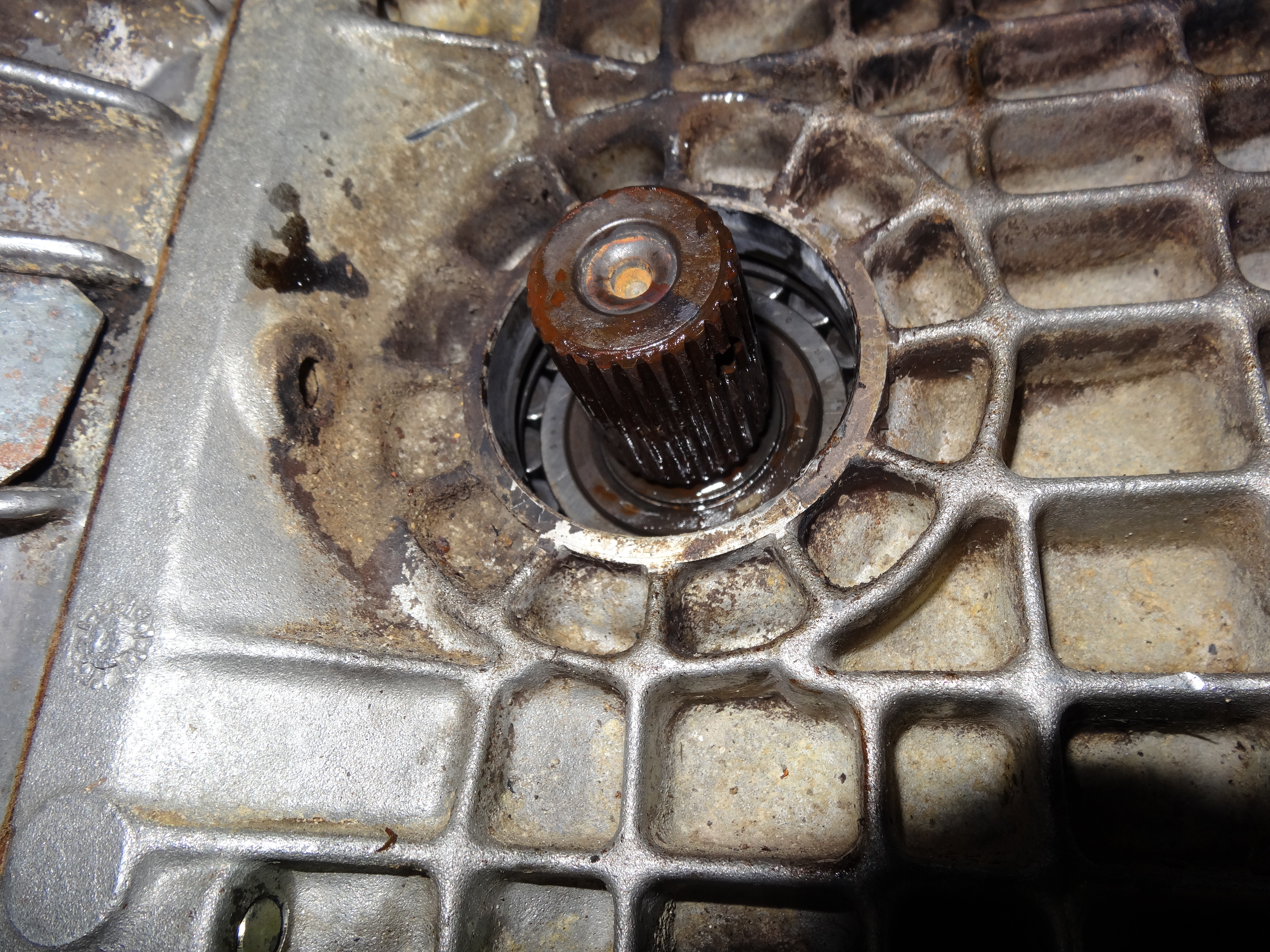

one of those area's that has a very high chance of "while your there" jobs, knocked the pin out to pull the flanges and adjusting nut
if your needing to do this as well there are 5 seals you need, one of them is here (and the other side) thats the rusty ring at the bearing end of the shaft, another on the adjusting nut and an oil seal on each side

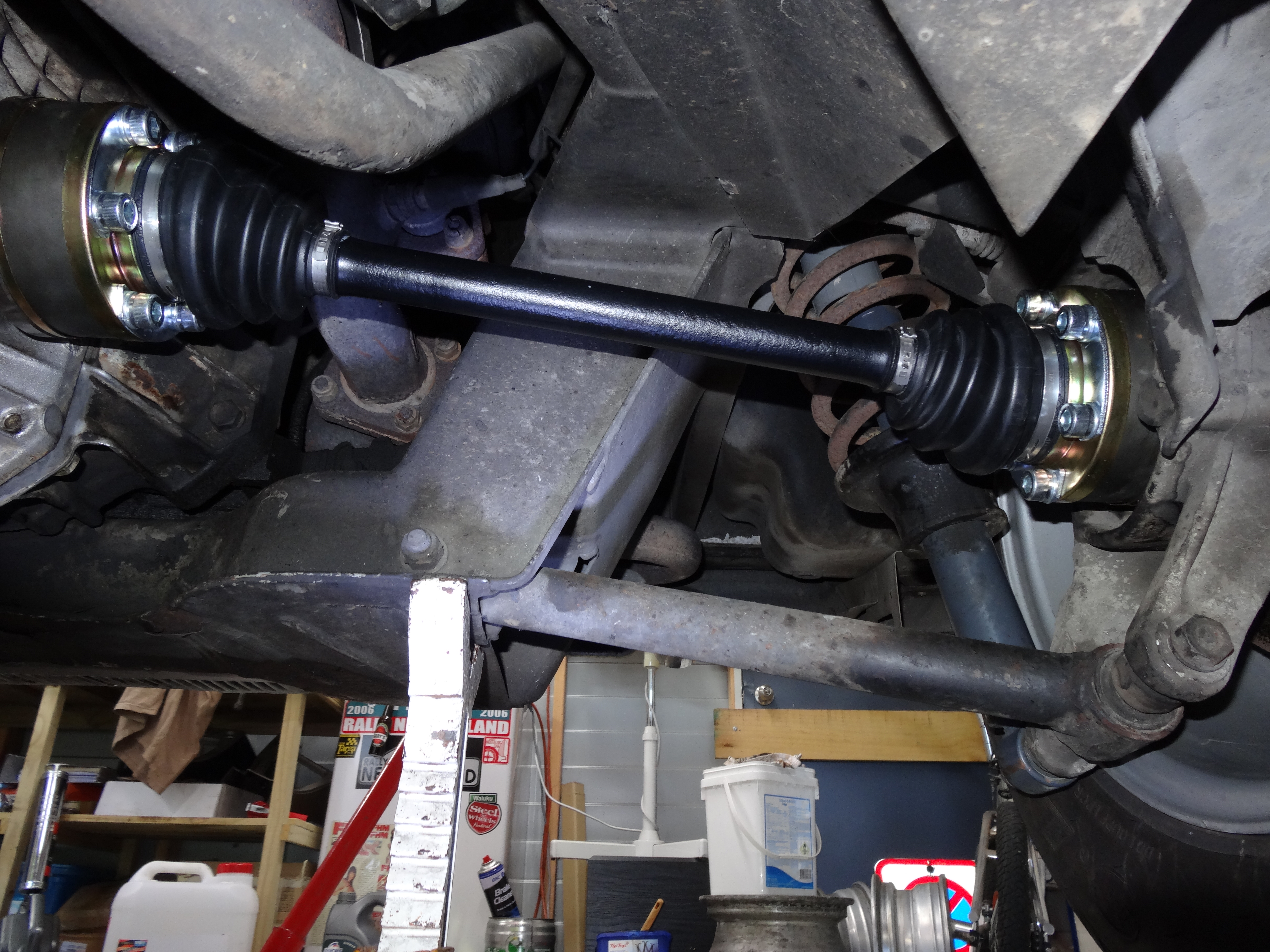

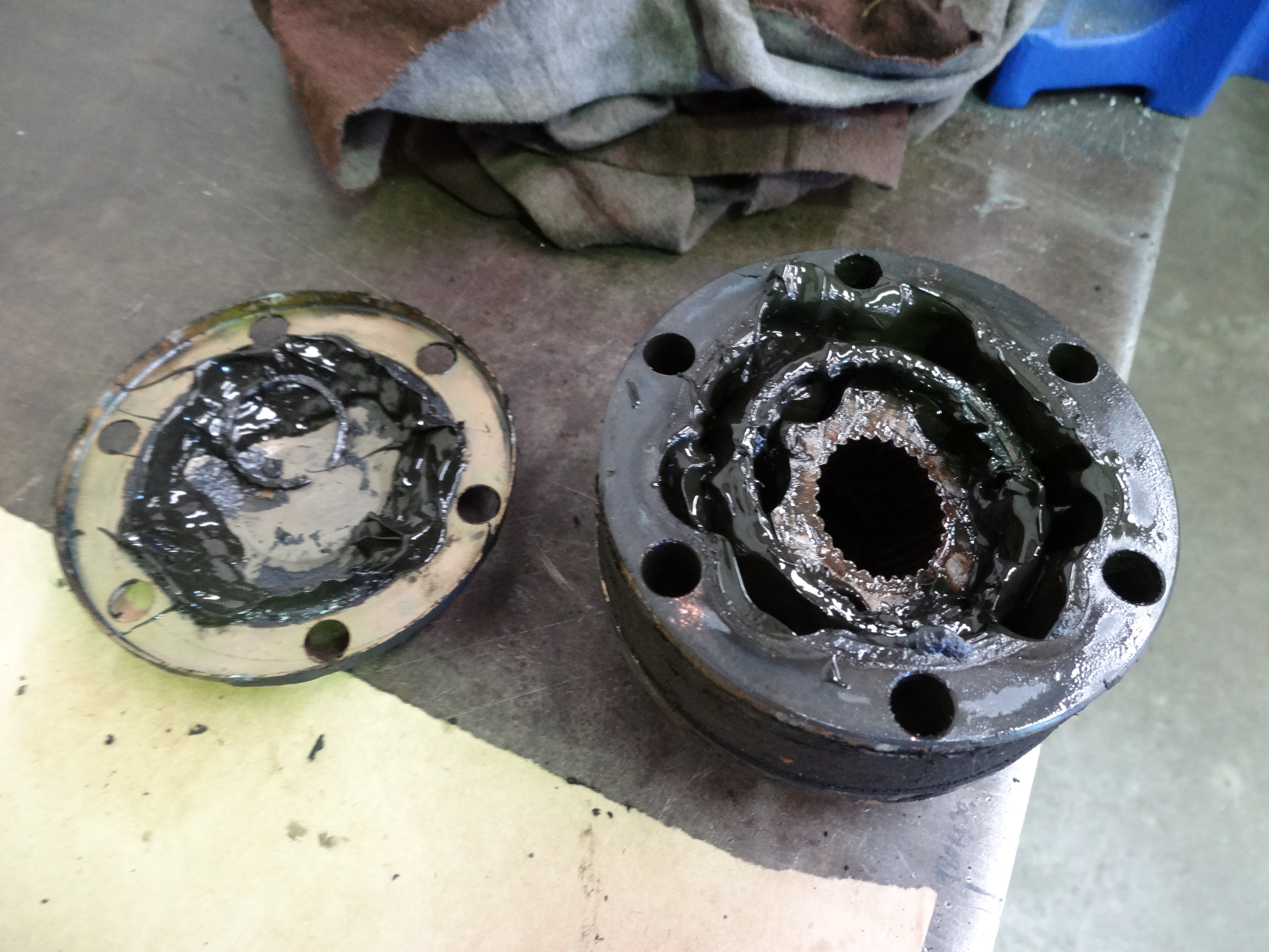

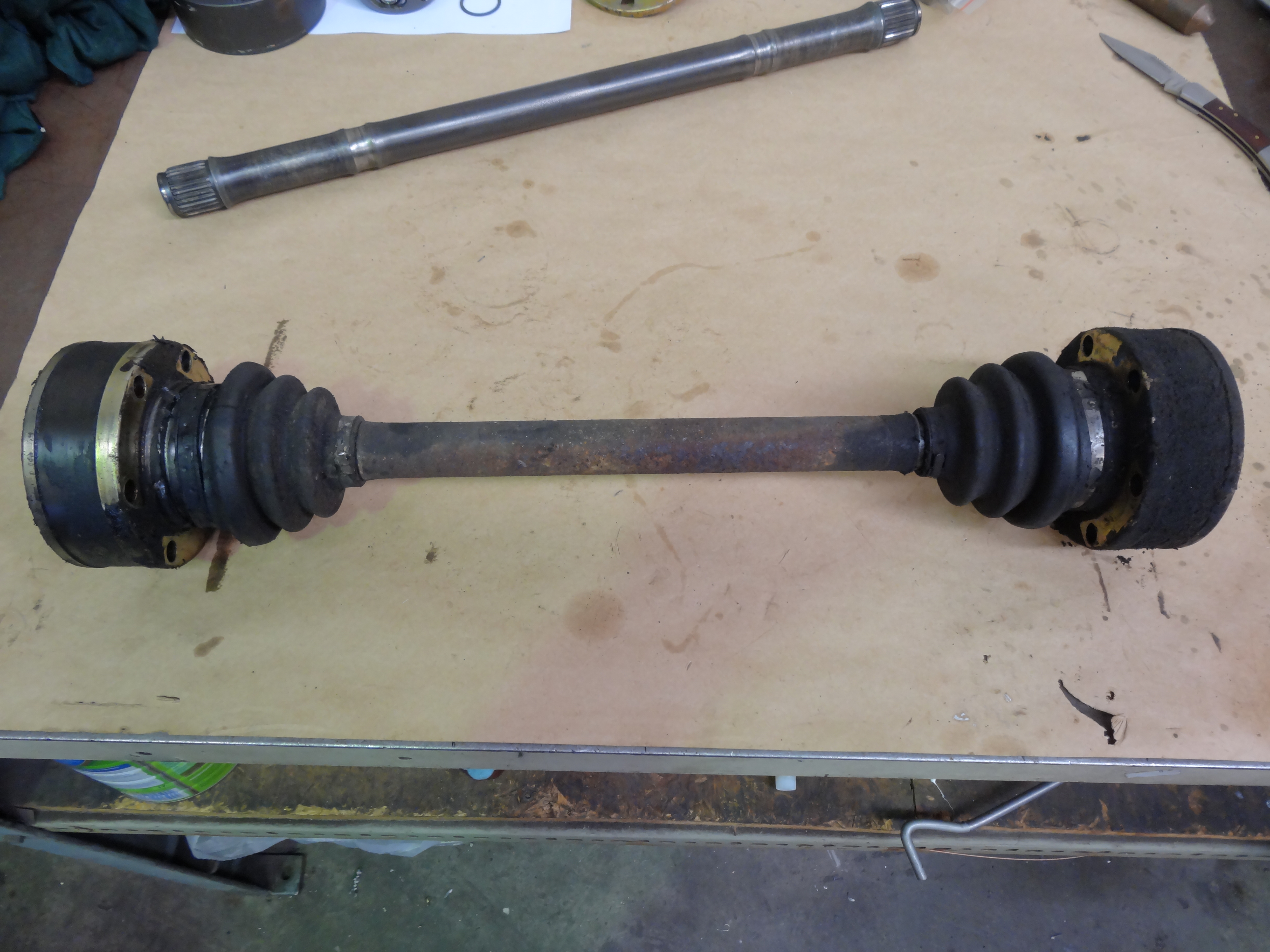

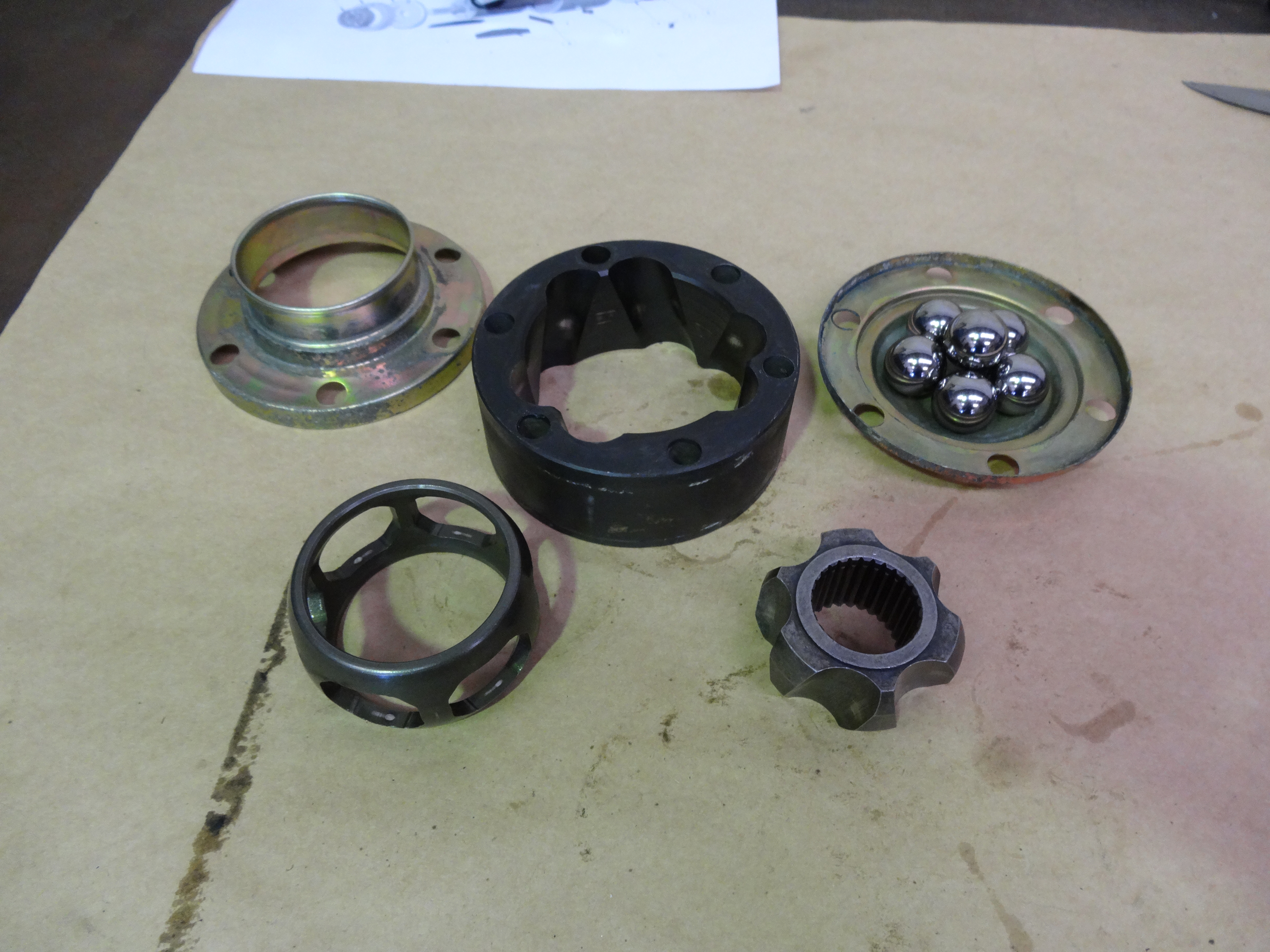

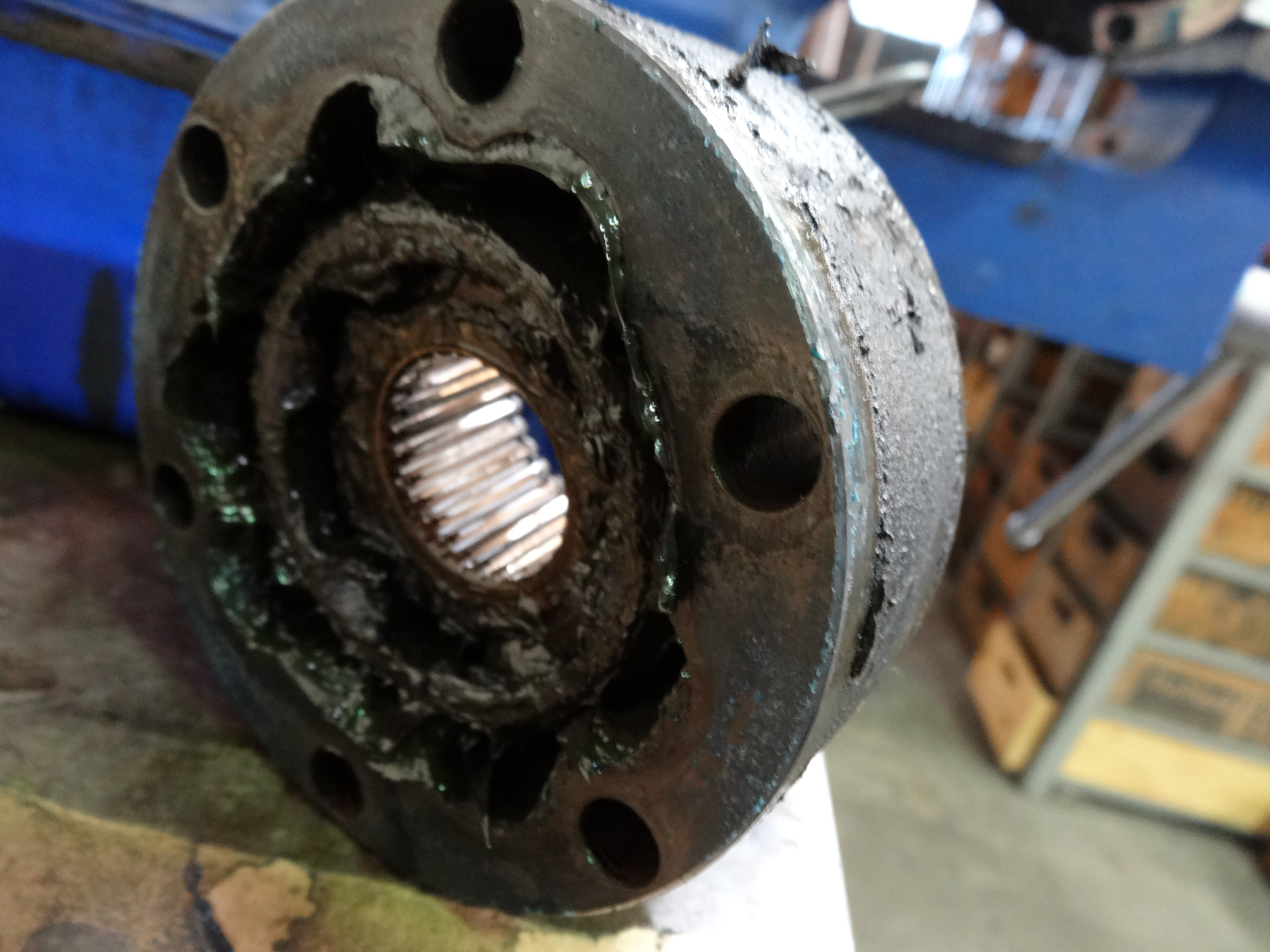

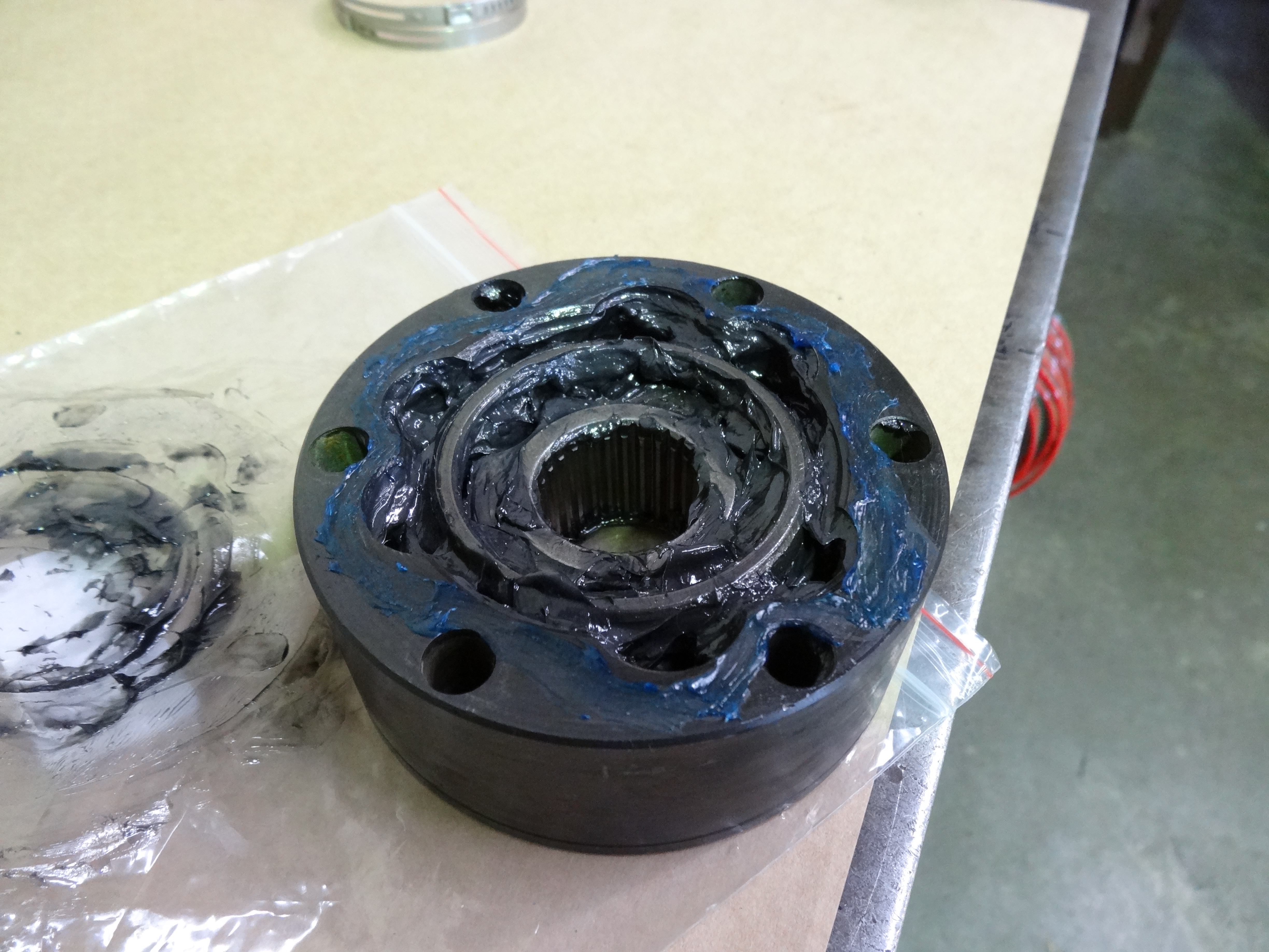

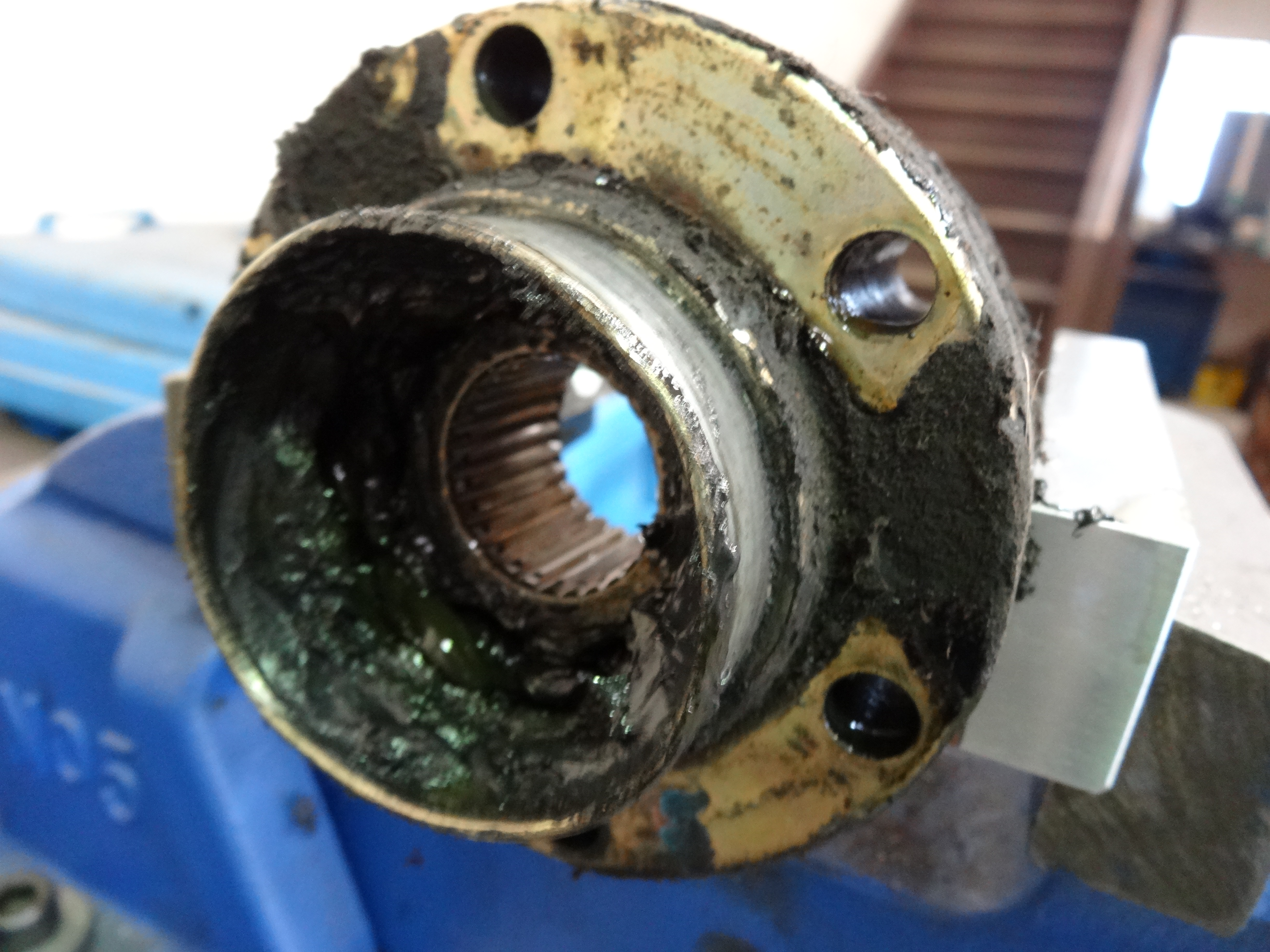

Postby gary290 » Mon May 09, 2016 2:43 am

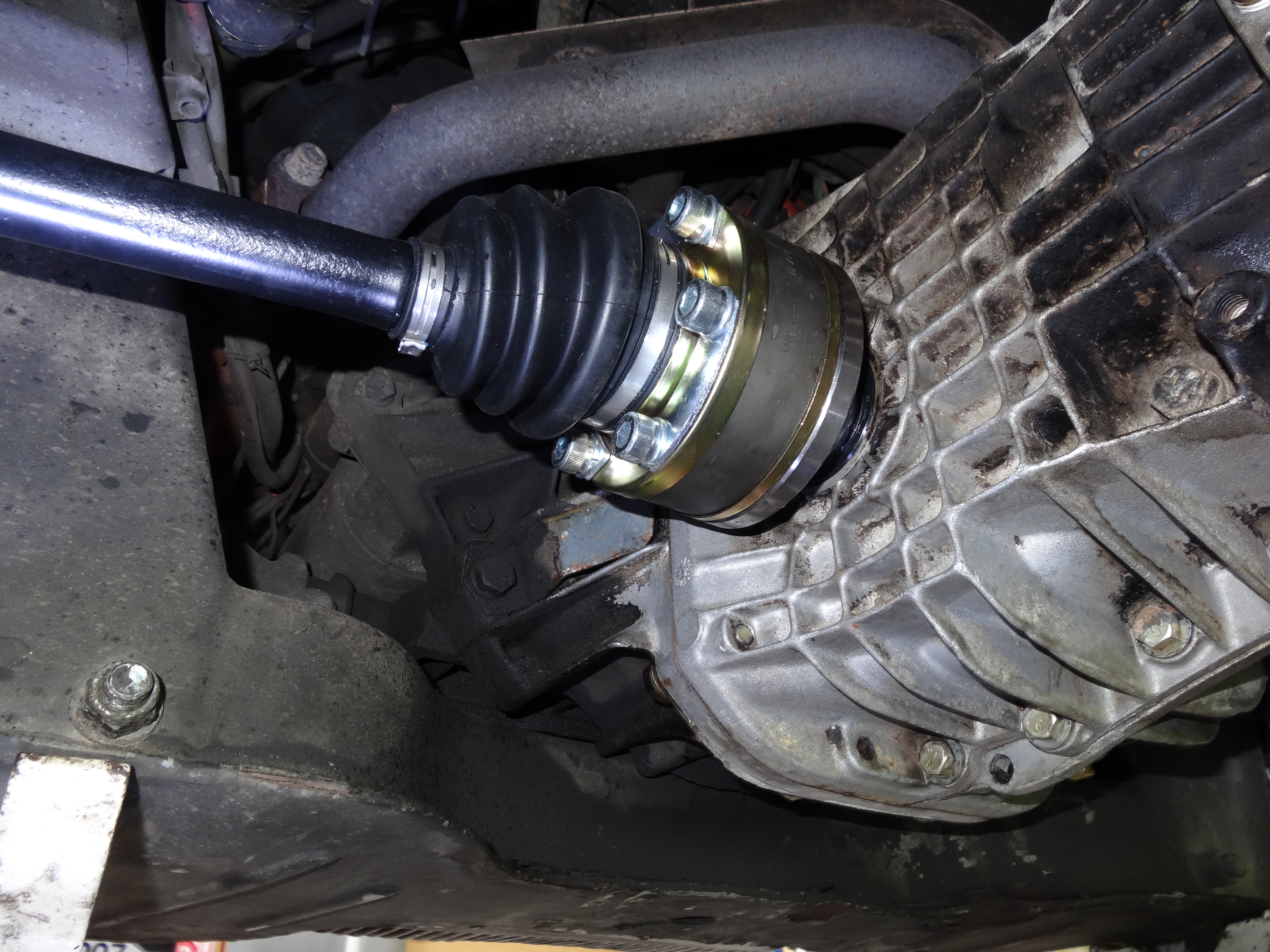

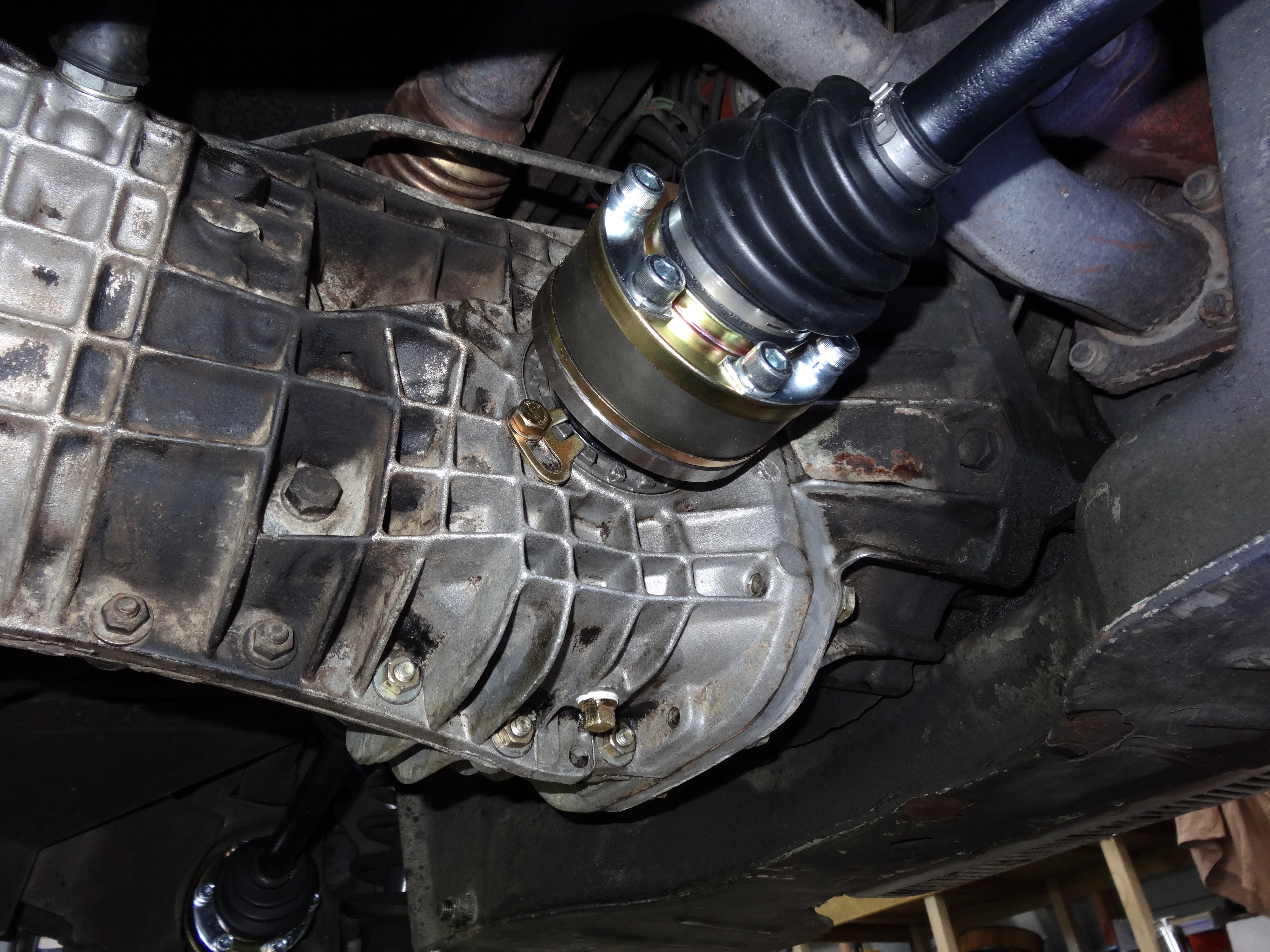

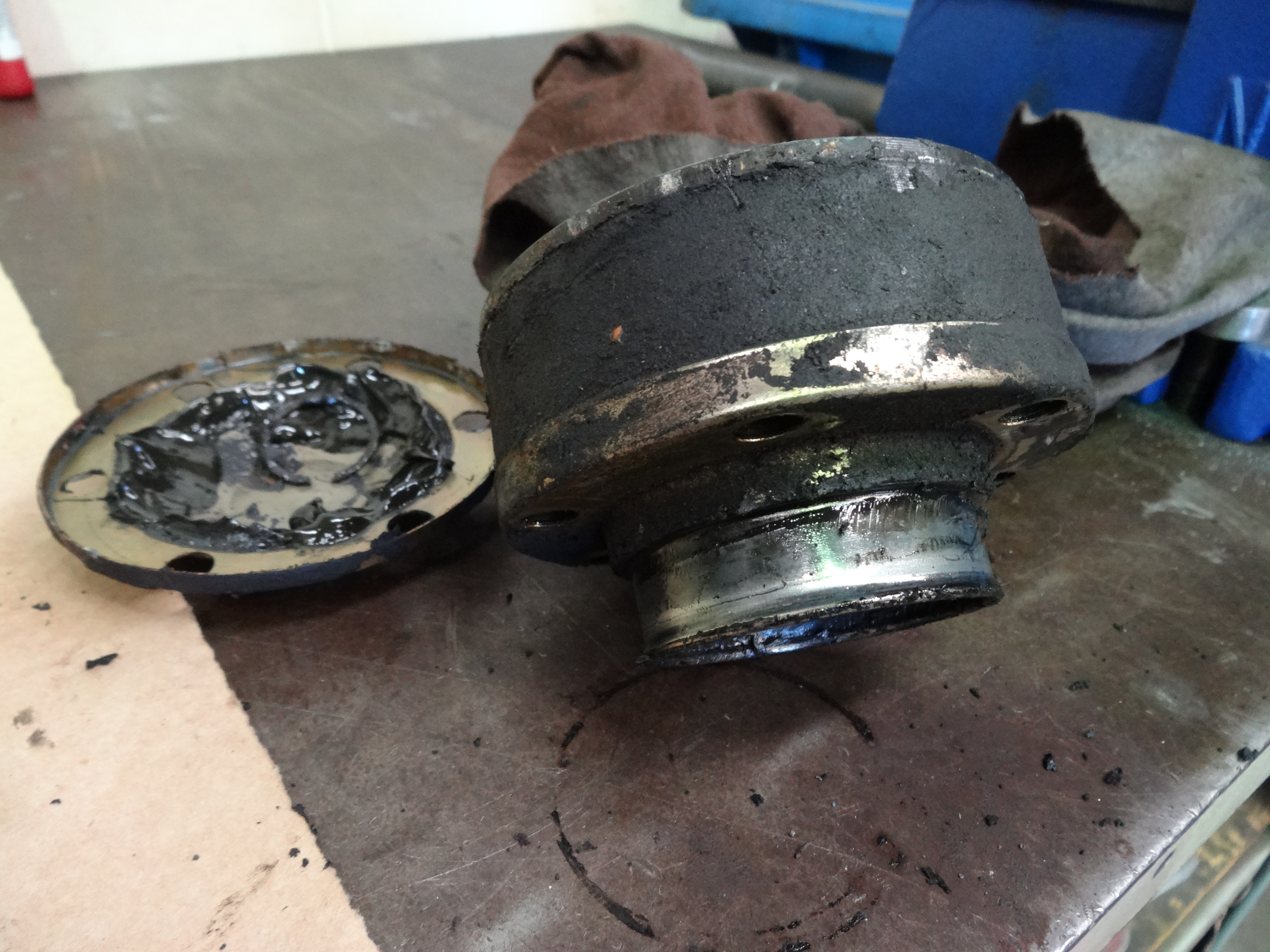

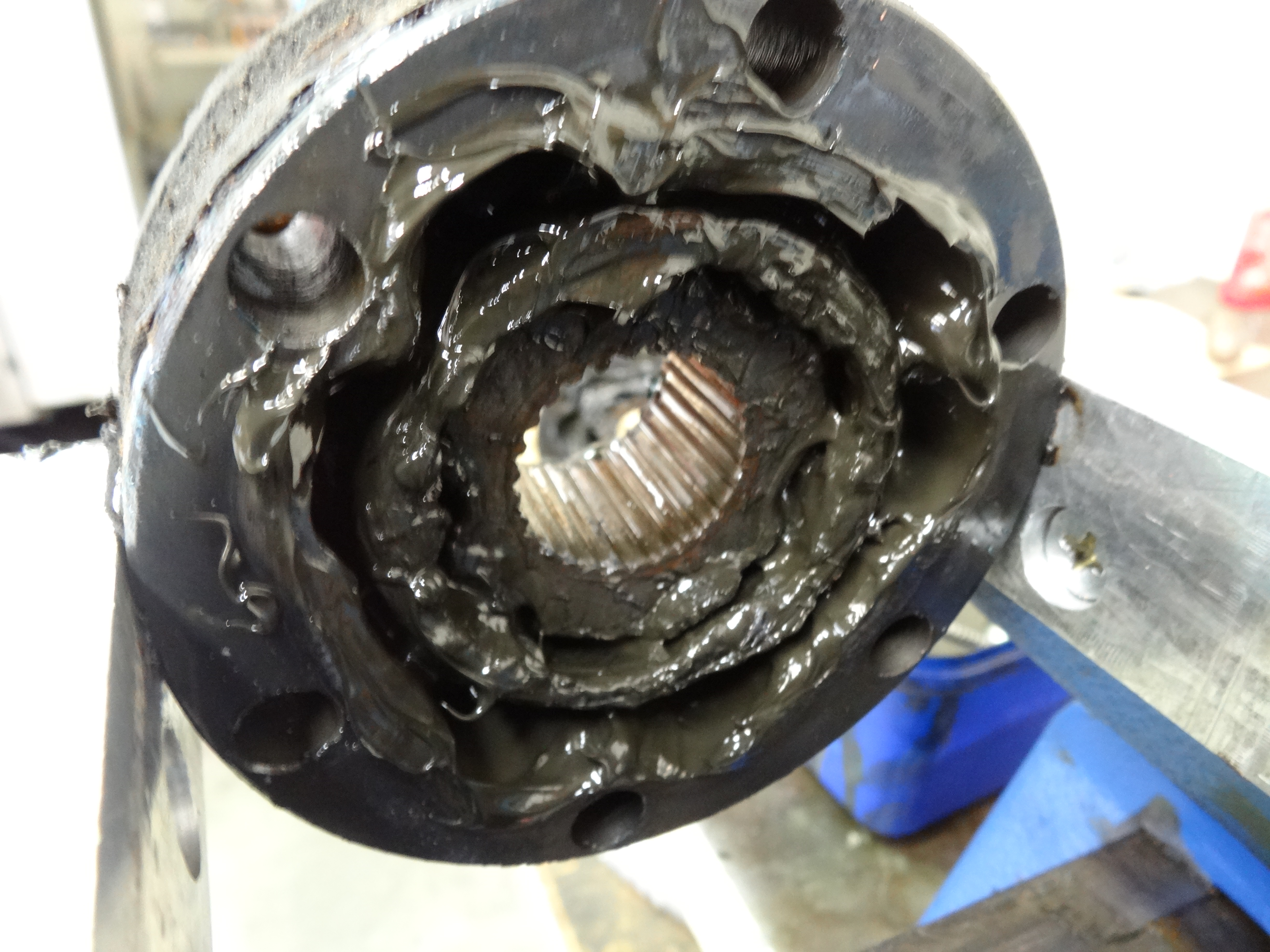

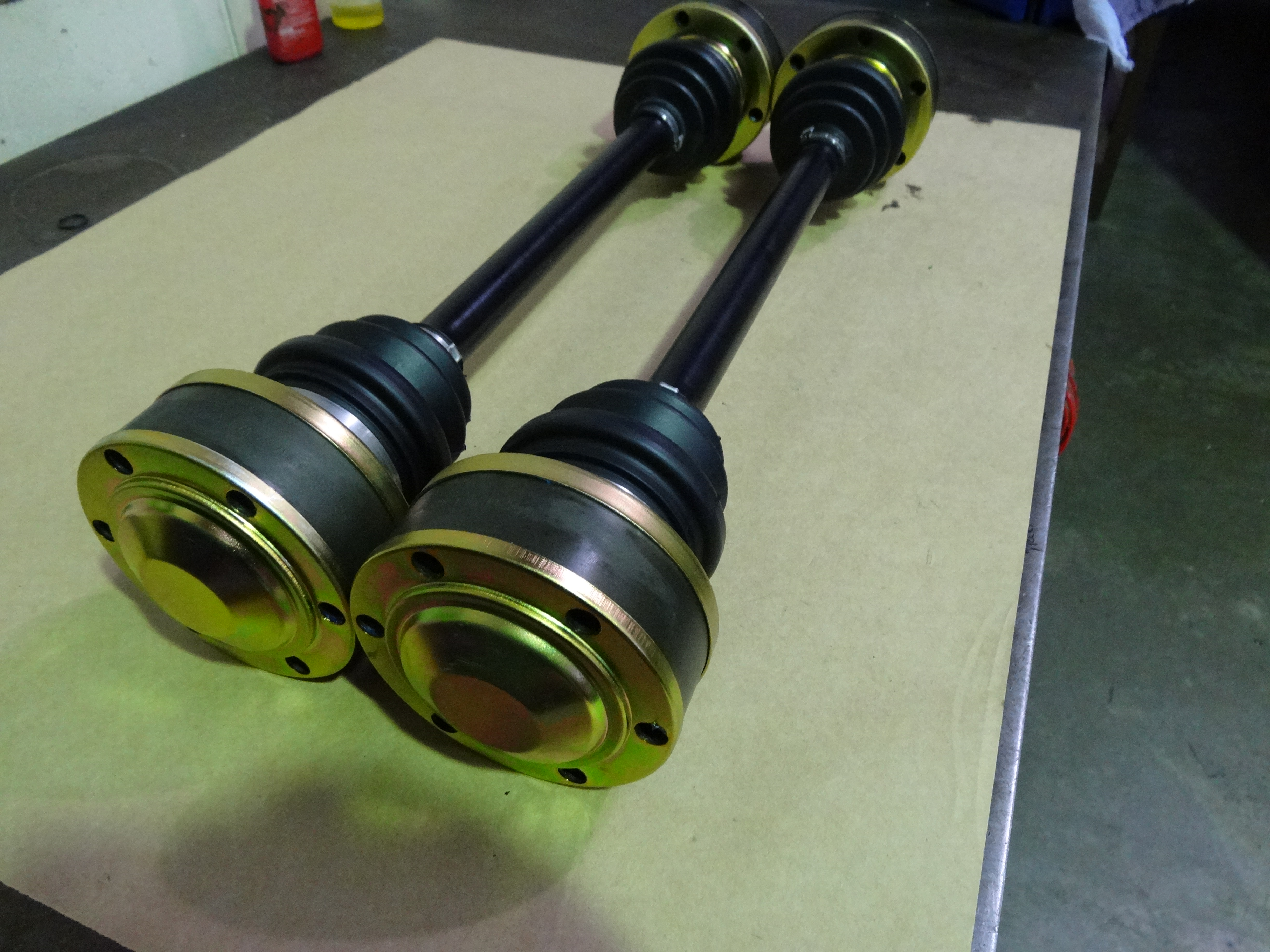

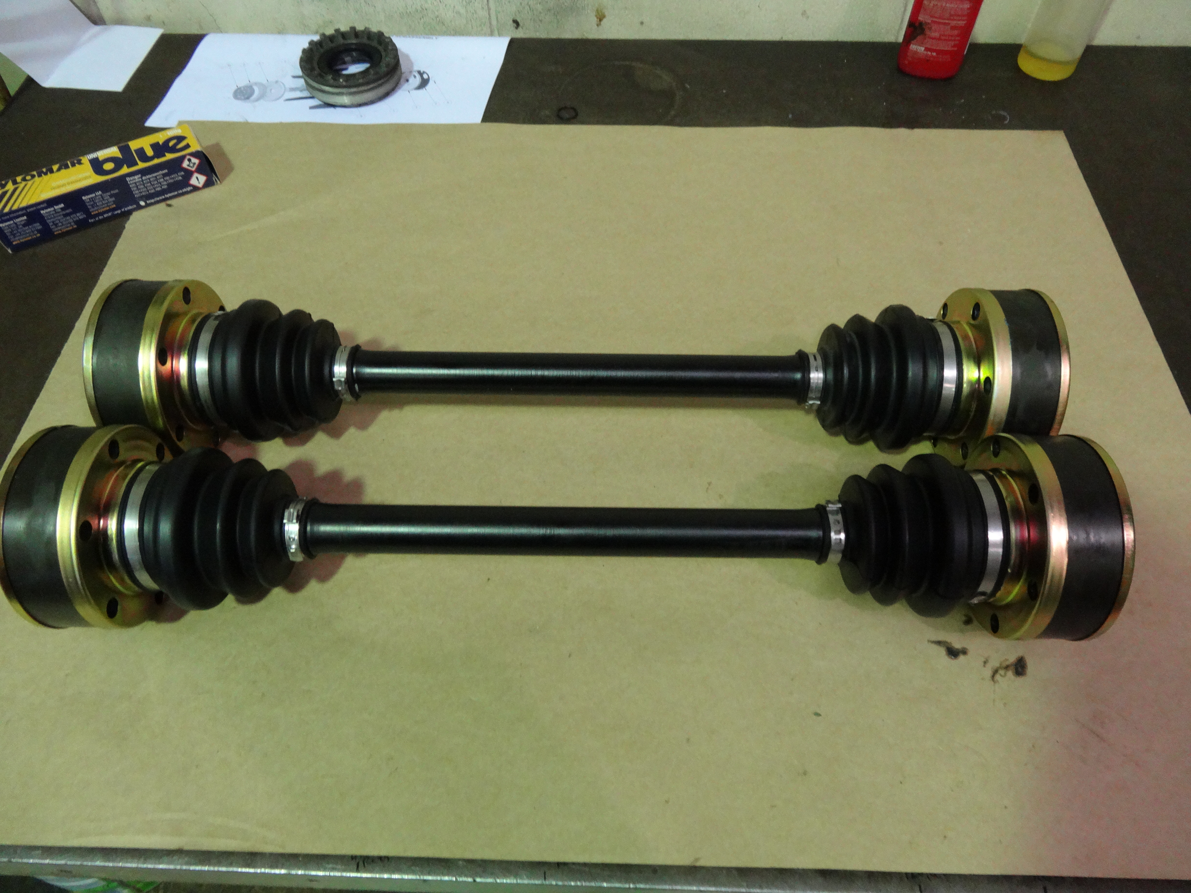

First job is a lot of cleaning
all the joints are in excellent condition, so i cleaned them up, re-greased, re-plated the end caps and of coarse new boots
also applied some fresh Hylomar to seal each end

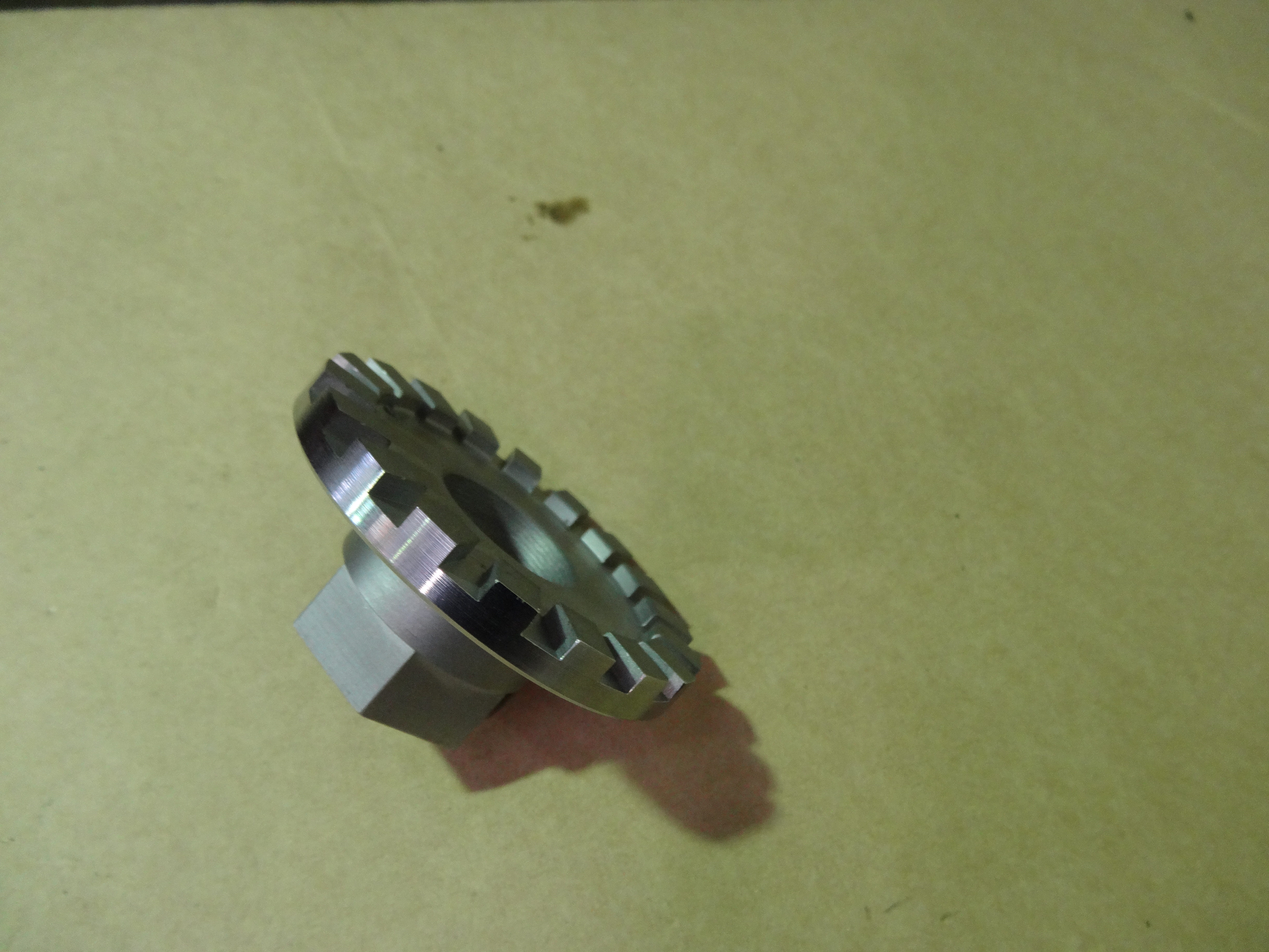

and made this doofer to install the adjusting nut
after reading the story's of other peoples gearbox's leaking i thought it might be difficult but it's not a hard job to do your self just very messy
gary290
