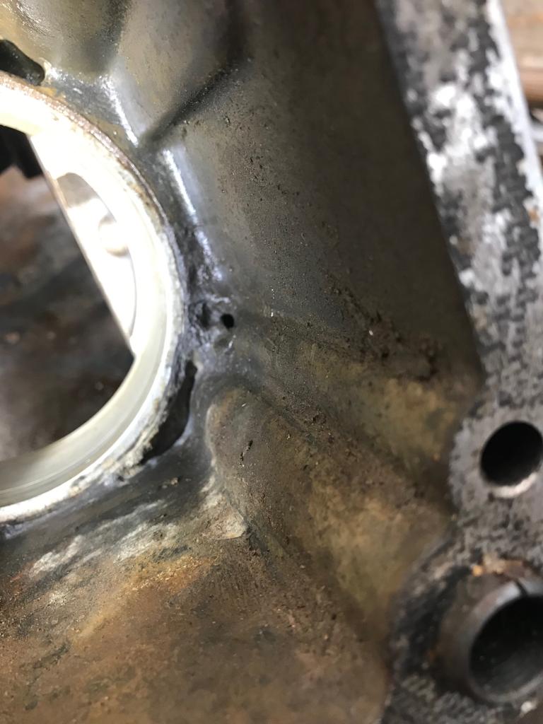

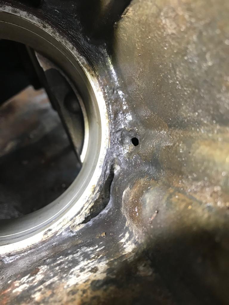

This all looks too familiar! What have you filled up the deep holes in the valley with?

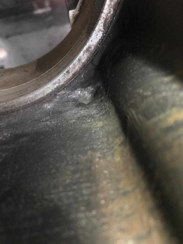

Dan 6511 wrote:This all looks too familiar! What have you filled up the deep holes in the valley with?
Hi Dan
The valley trenches was filled with a method called cold welding, its molten aluminium sprayed thru a welding gun so it grafts itself to the good metal that's left and fill up the holes (with the surface prepped first with an etch).. I'm happy enough with it but theres bits of it that are coming away a wee bit that didn't take so will be getting that cleaned up again

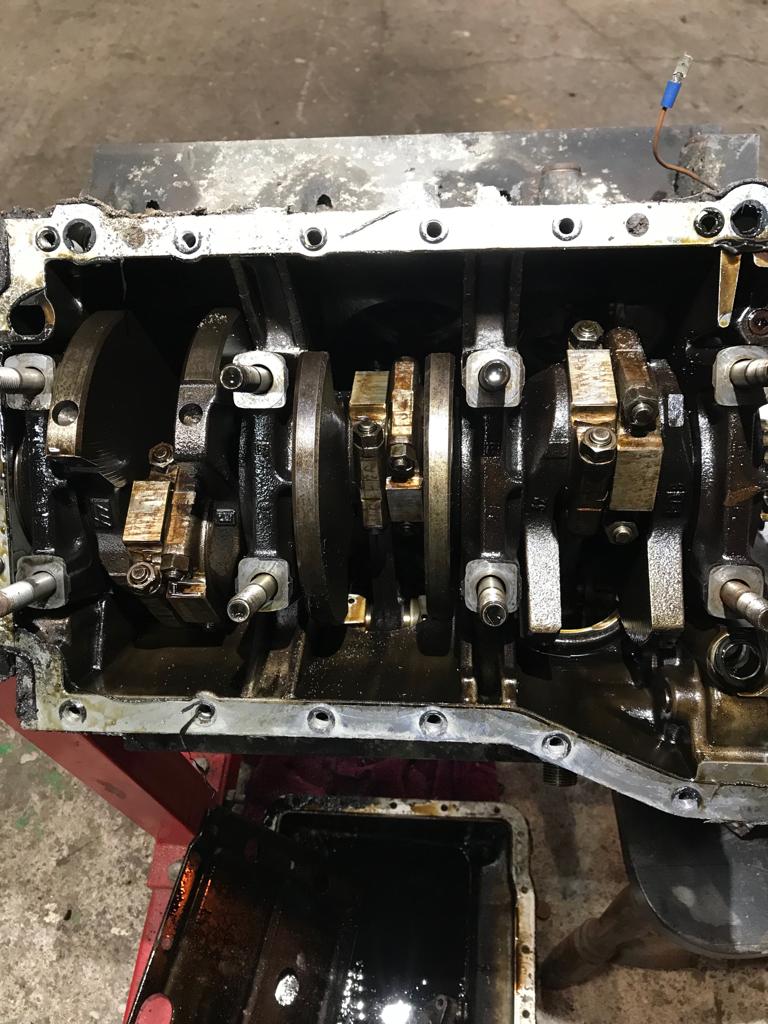

Postby cis6409 » Sun Dec 09, 2018 9:53 pm

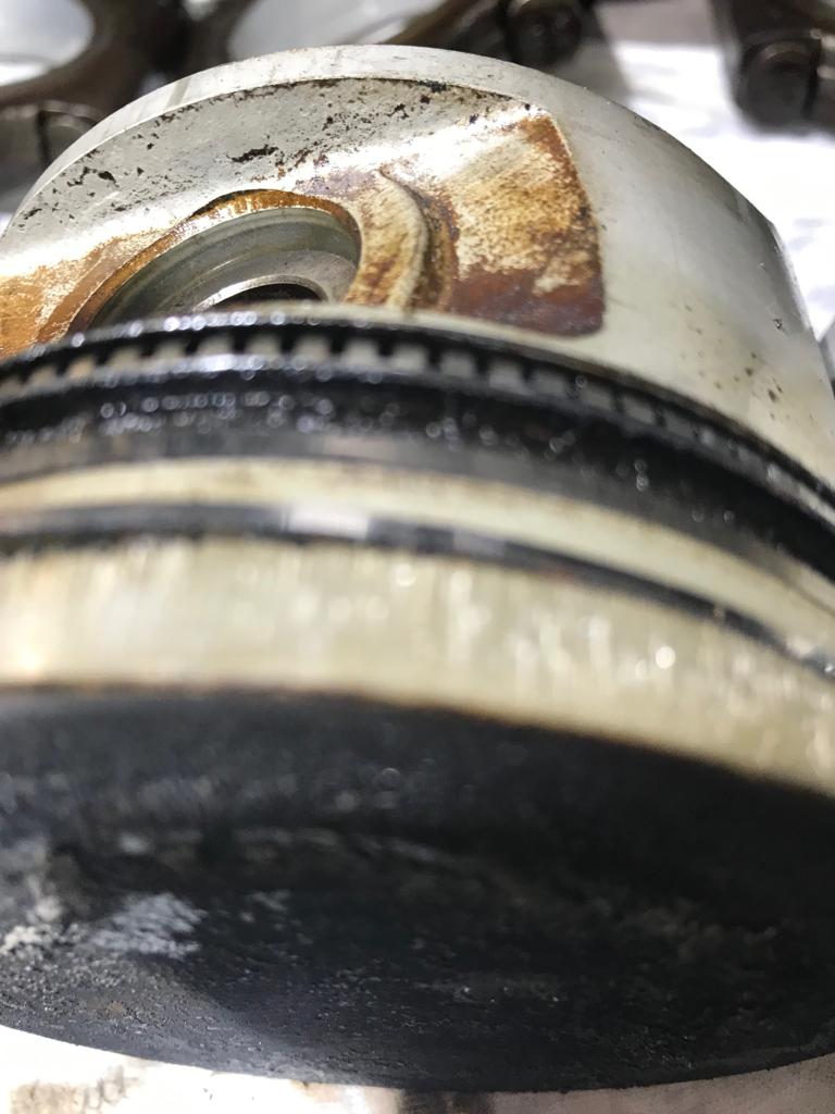

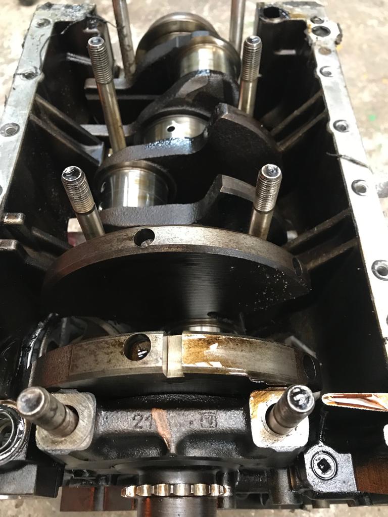

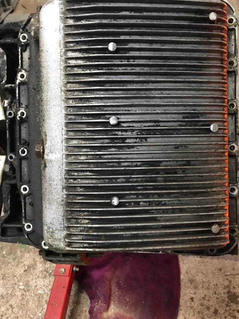

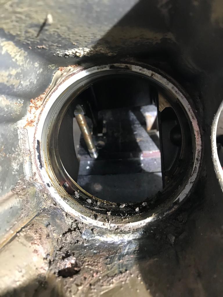

More progress of the engine tare down

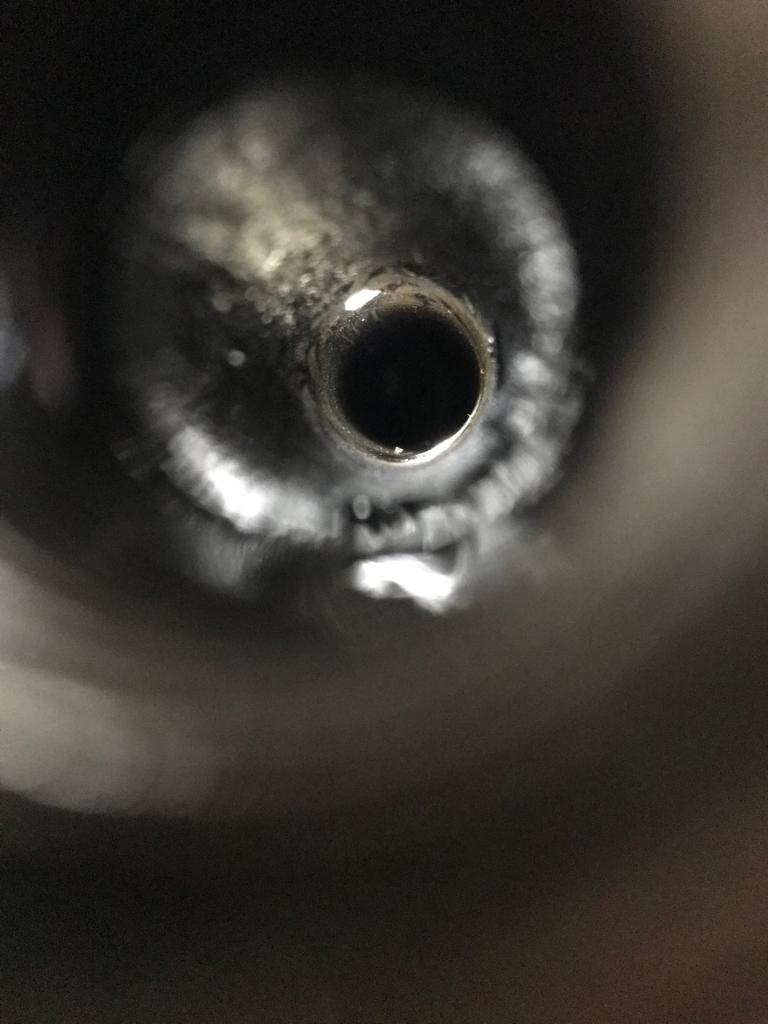

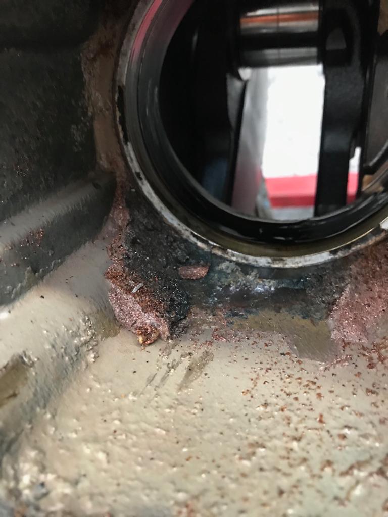

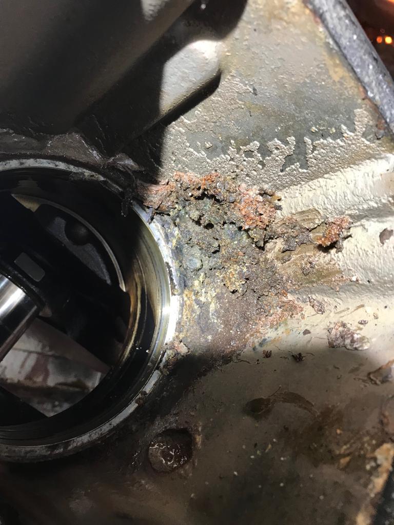

Re: Vin6409 engine rebuild

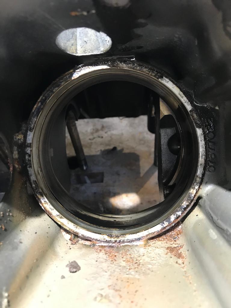

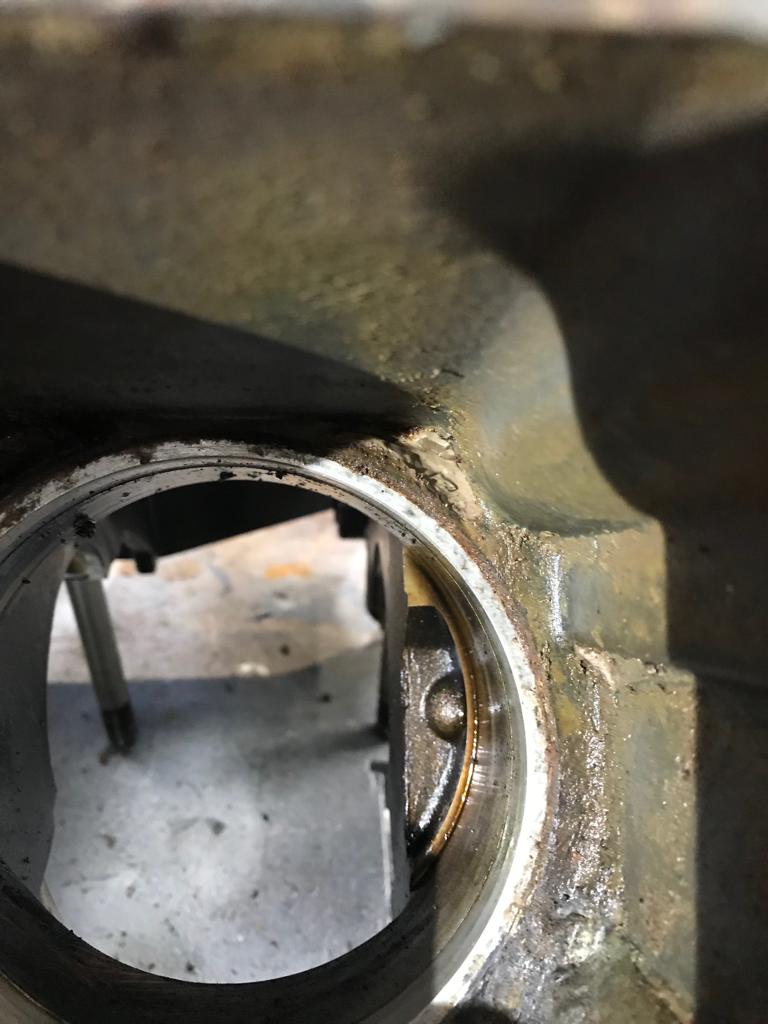

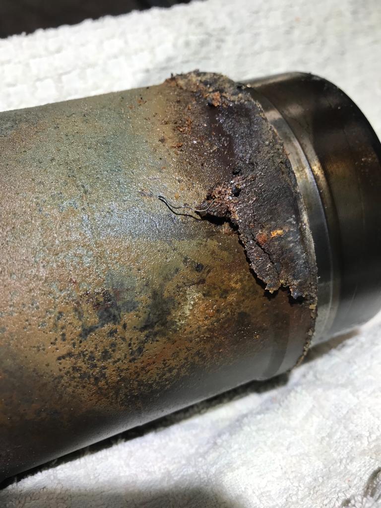

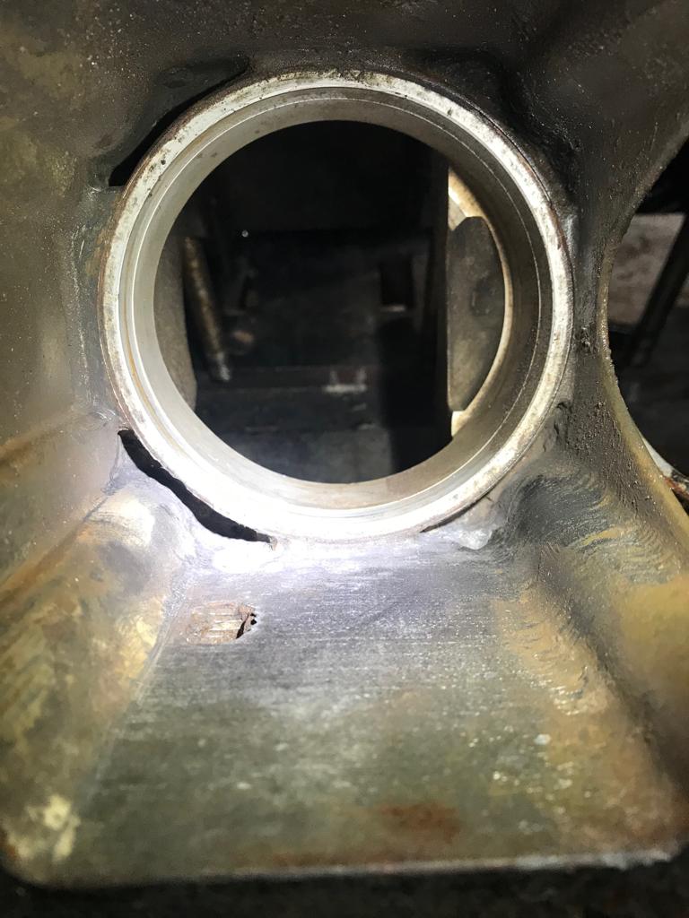

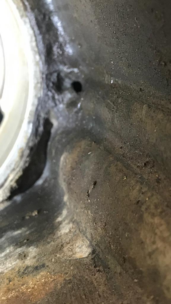

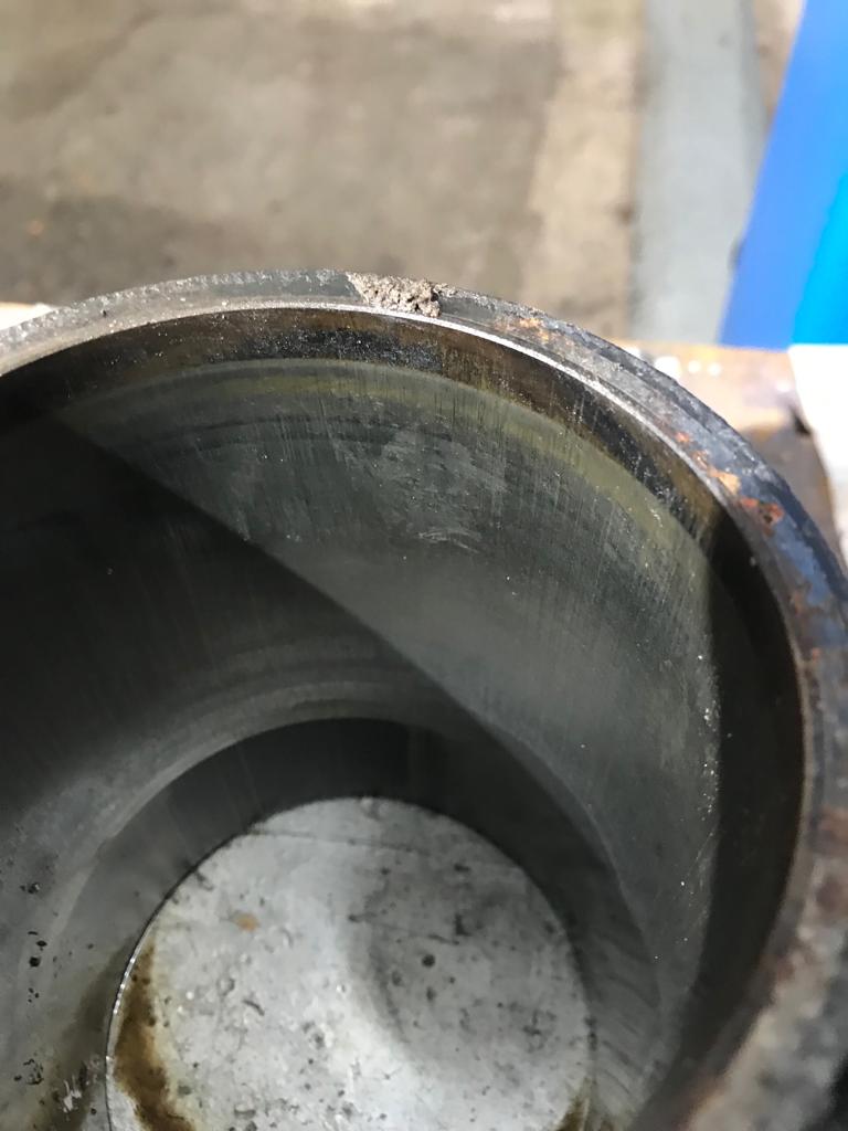

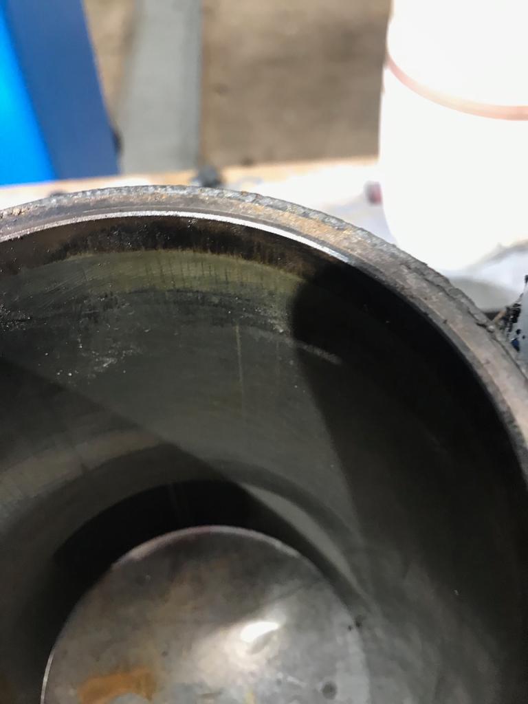

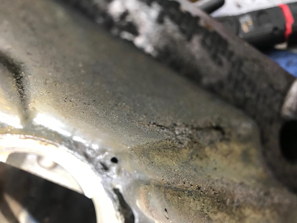

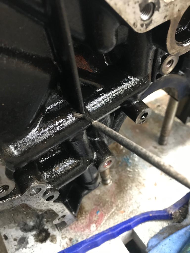

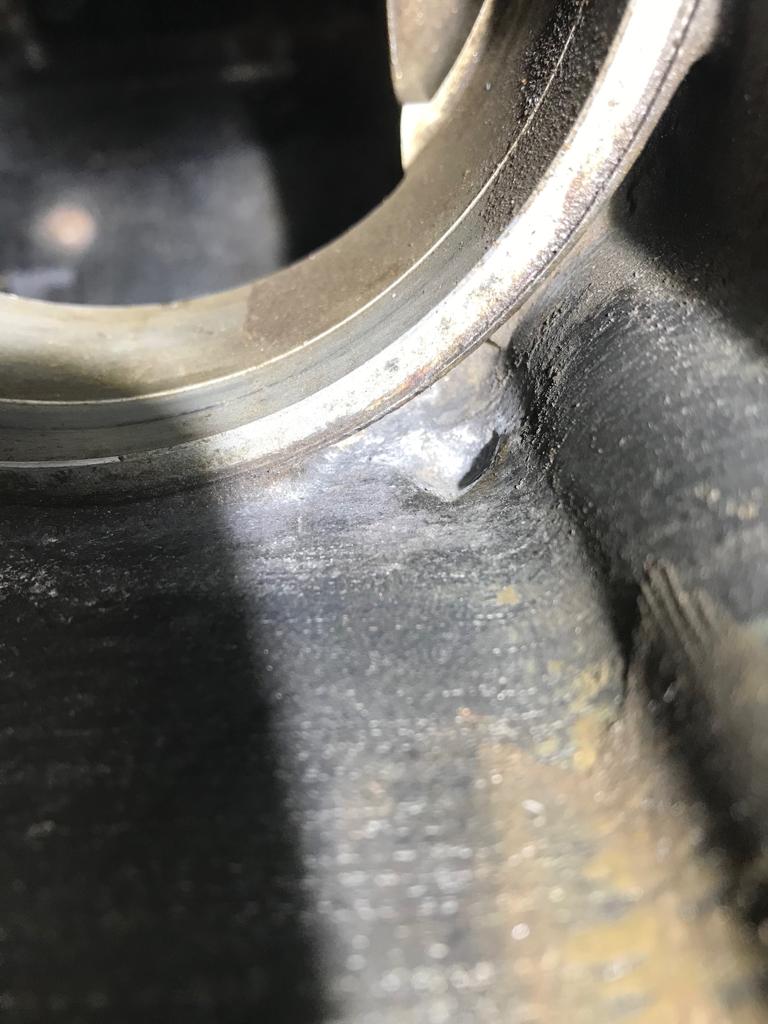

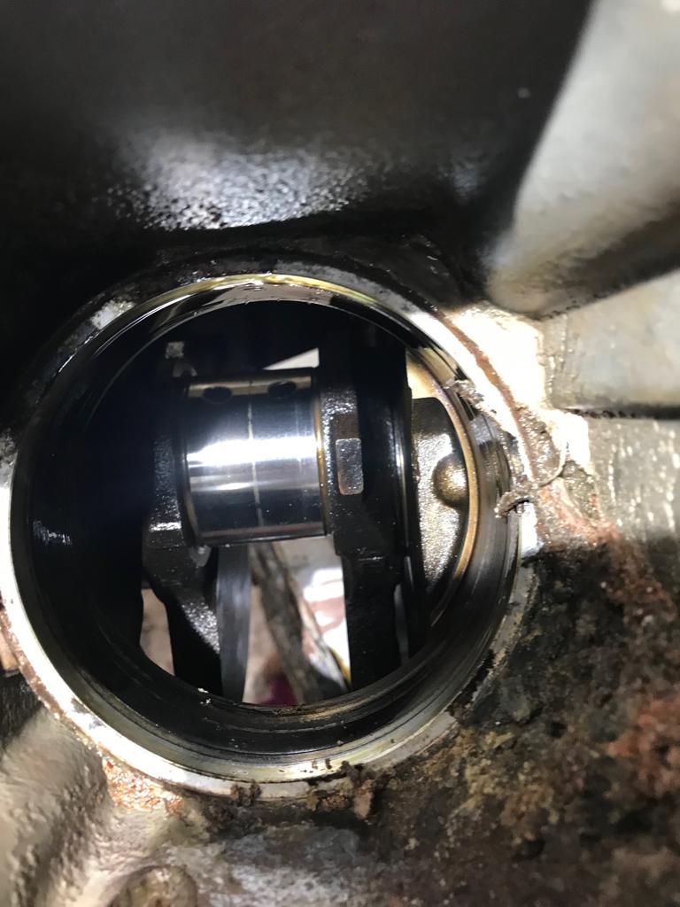

Postby cis6409 » Sun Dec 09, 2018 10:05 pm

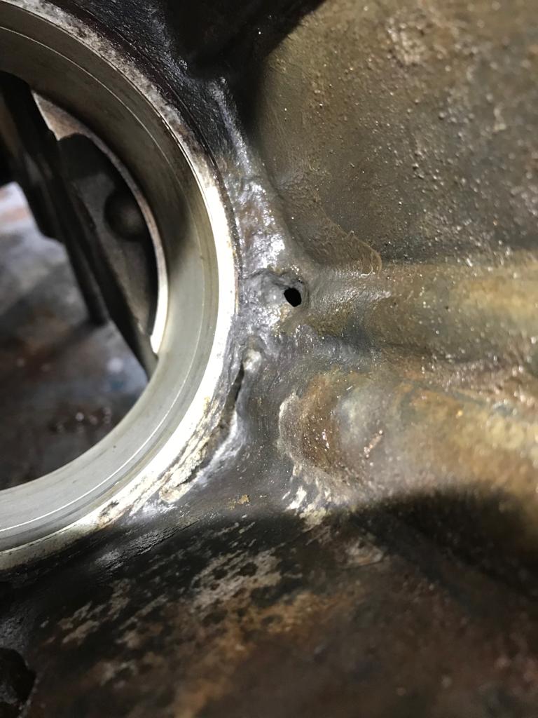

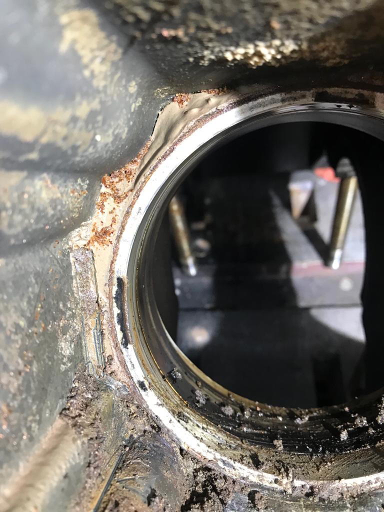

Block is not as good as we were hoping, the rot is pretty bad at cylinder 3 and cylinder 6.. more evidence as to why it's crucial to do a proper drain and a flush of the block when doing a coolant change every couple of years, instead of just the lower rad hose which only empties the pipe system.
The rot is right were the block drain plugs are. The water/coolant pools there, rots and spreads.
unfortunately on mine it has also spread to the oil galley behind the oil pump feed.. Not good.
This, we "think" is where the oil was getting into the inlet manifold system, it was leaking into the combustion chamber and some leftover oil that wasn't burned off was escaping "up" when the inlet valve was opening and spreading into the manifold..
The engine as a result was starting to burn a little oil to.. So overall better than other blocks that we've seen but a real let down that the rot comprised the oil galleys as well..

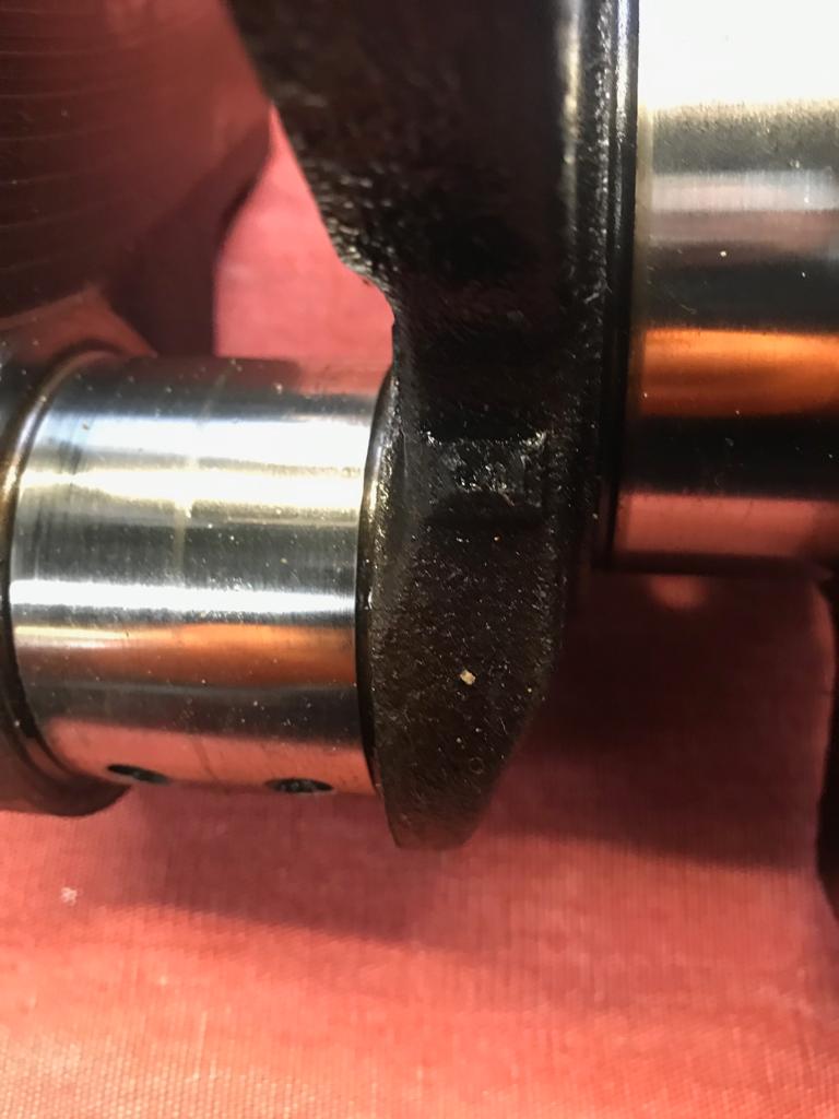

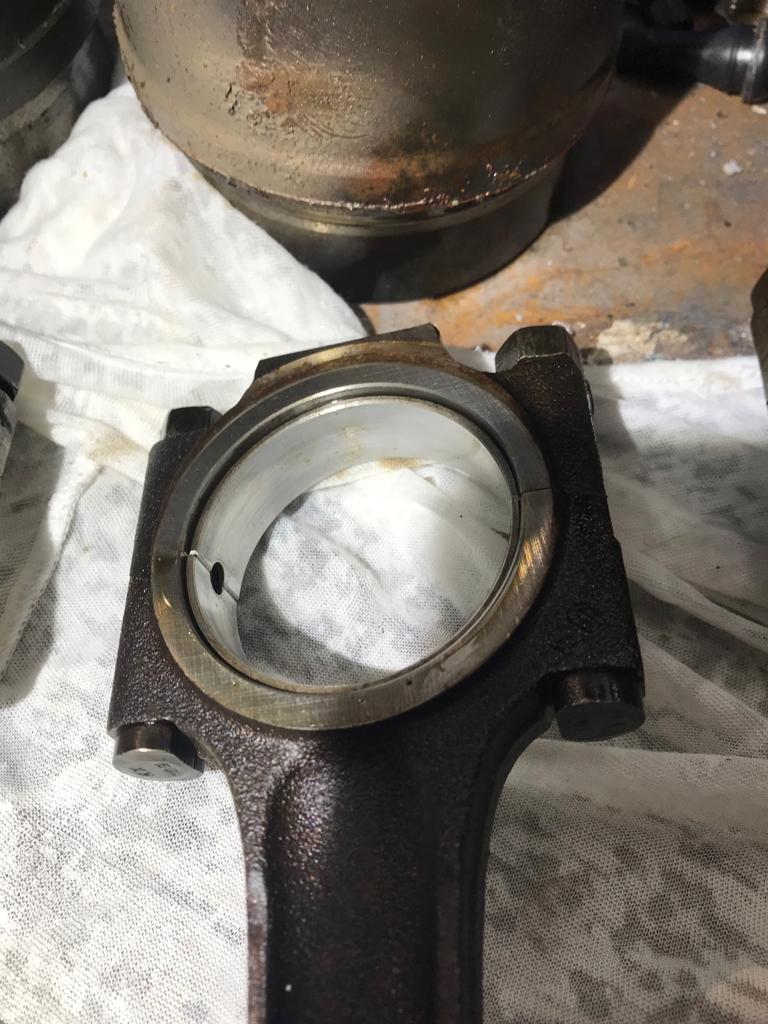

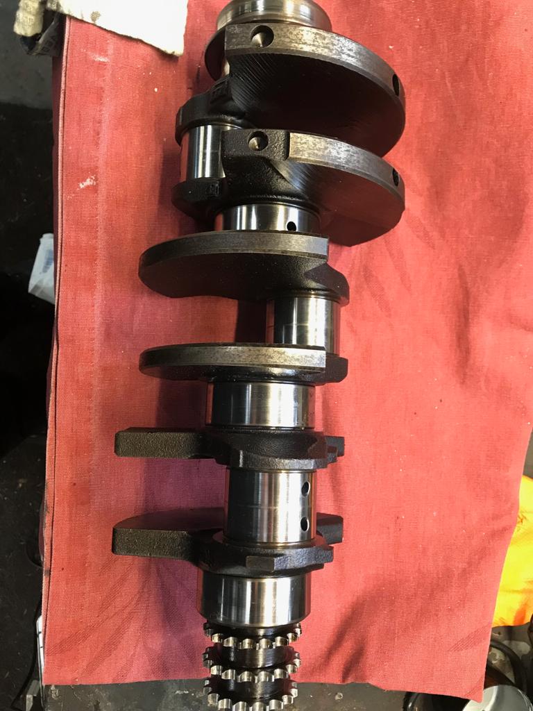

A Couple of the con rod bearings where wearing out to, thankfully the con rods themselves are fine.. All the bottom end bearing and shells will be replaced as a matter of course anyways..
Next step is to thoroughly clean down the block and get rid of the sludge and silt and then blast it to see what's left.. This will 100% verify if the block is toast or not
Fun times! :doh:
Shane
