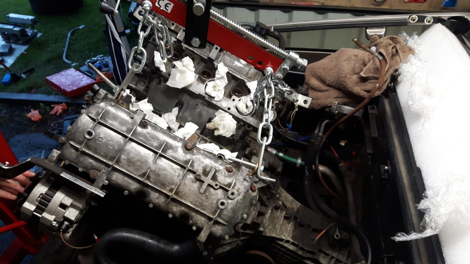

I lifted my engine and gearbox out in one lump, easier in the long run, as it can be a real pain trying to line up the bell housing to the engine when reinstalling. Easier to mate them back together outside first.
With the chassis away from the body it should be much more straight forward with that extra space but I definitely found the lift leveller to be extra helpful, very handy. In my opinion anyways :thumbsup:

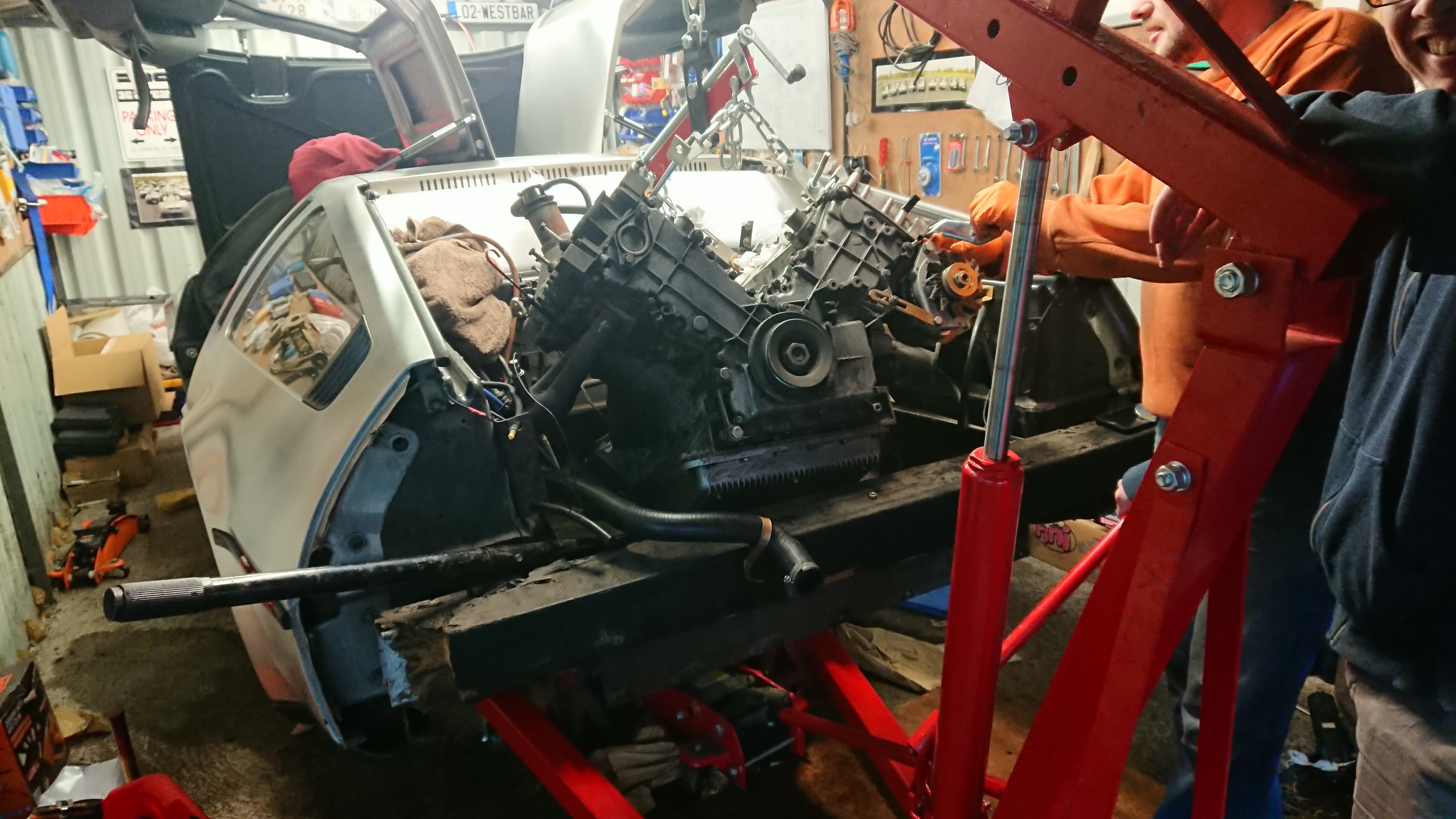

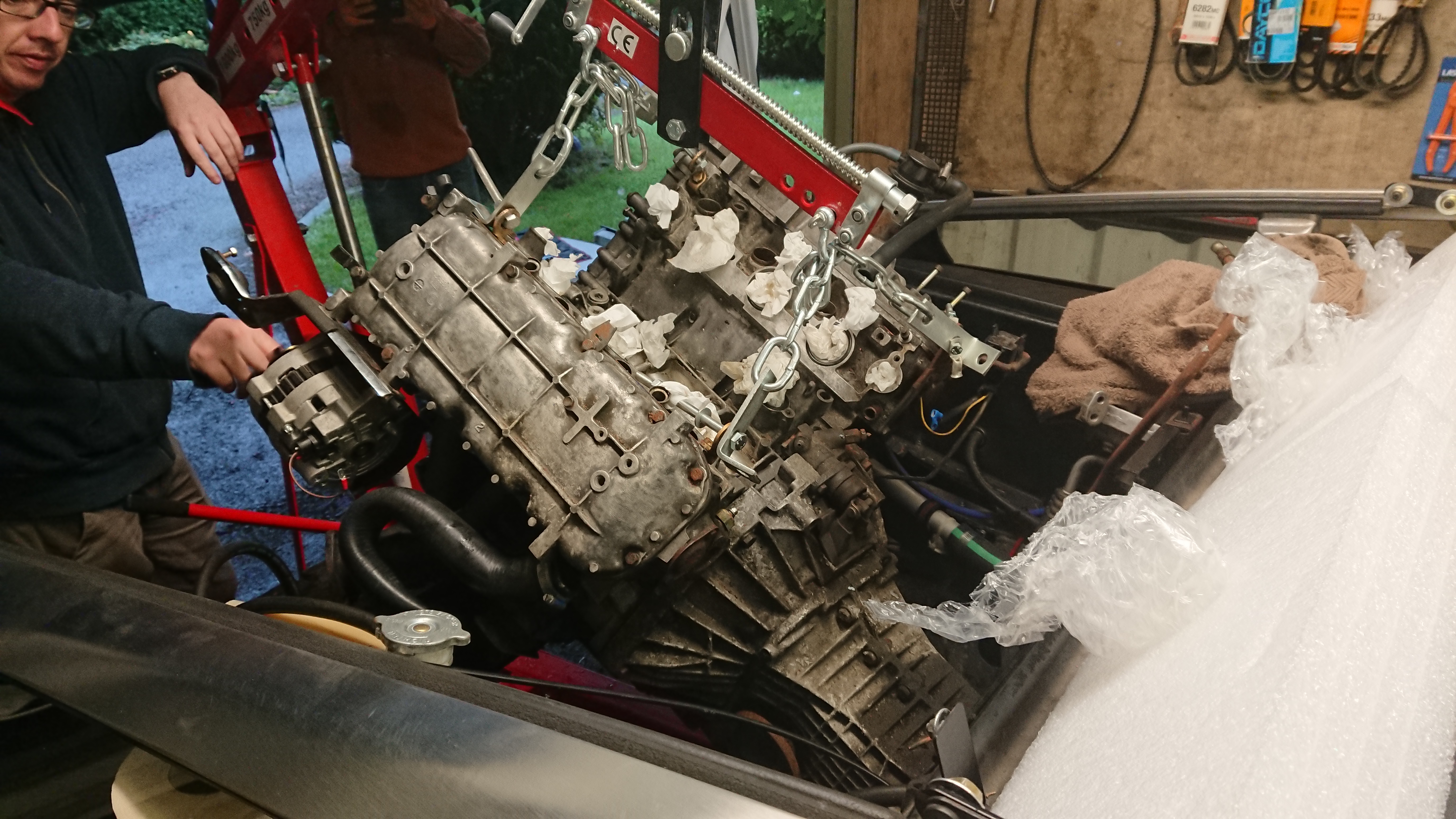

You need to lift the engine and box at a steep angle to make it clear the rear cross member.
These are mine for reference if it helps..

Yes we used to term it as the ‘dive bomb’ technique
