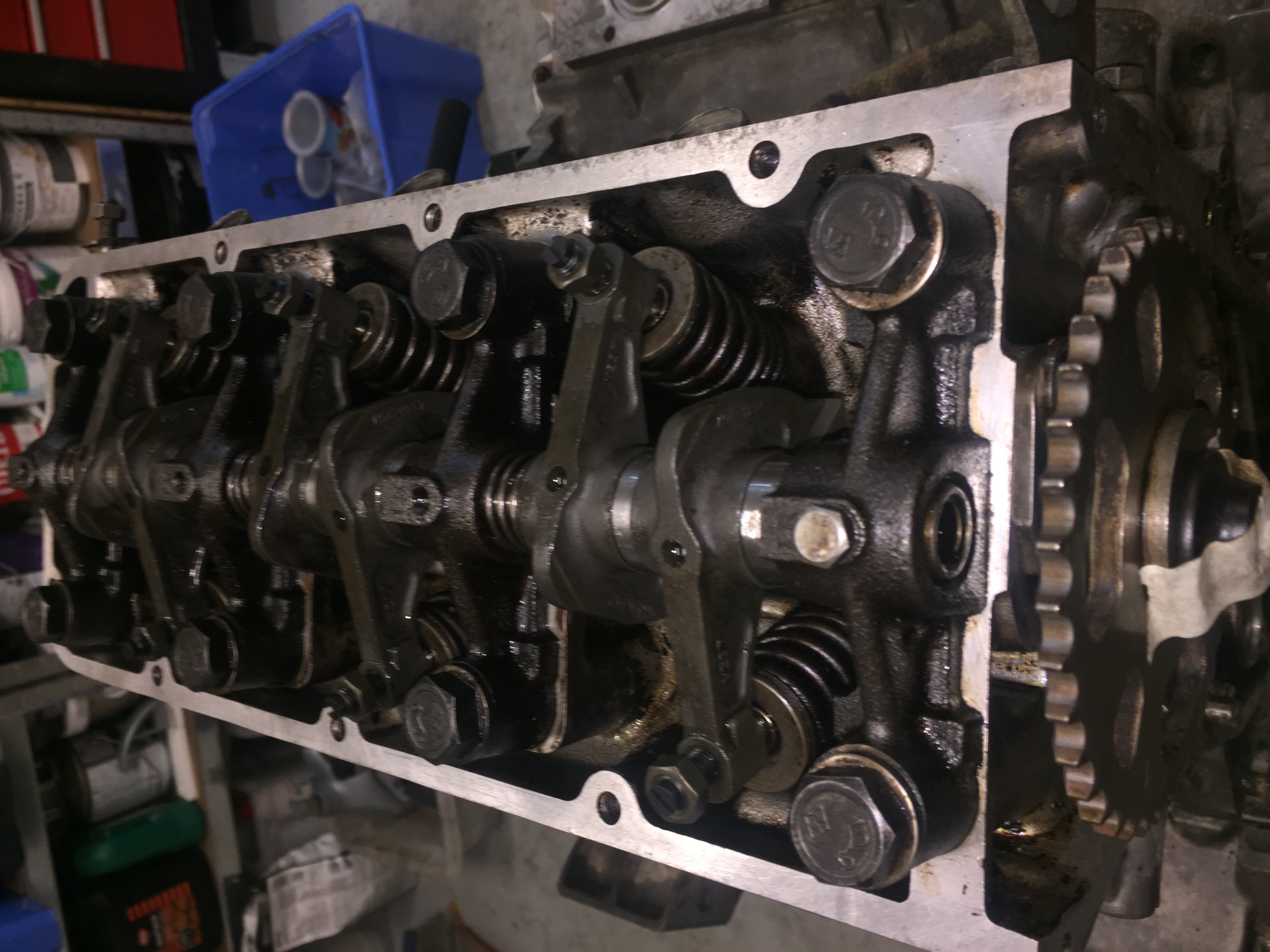

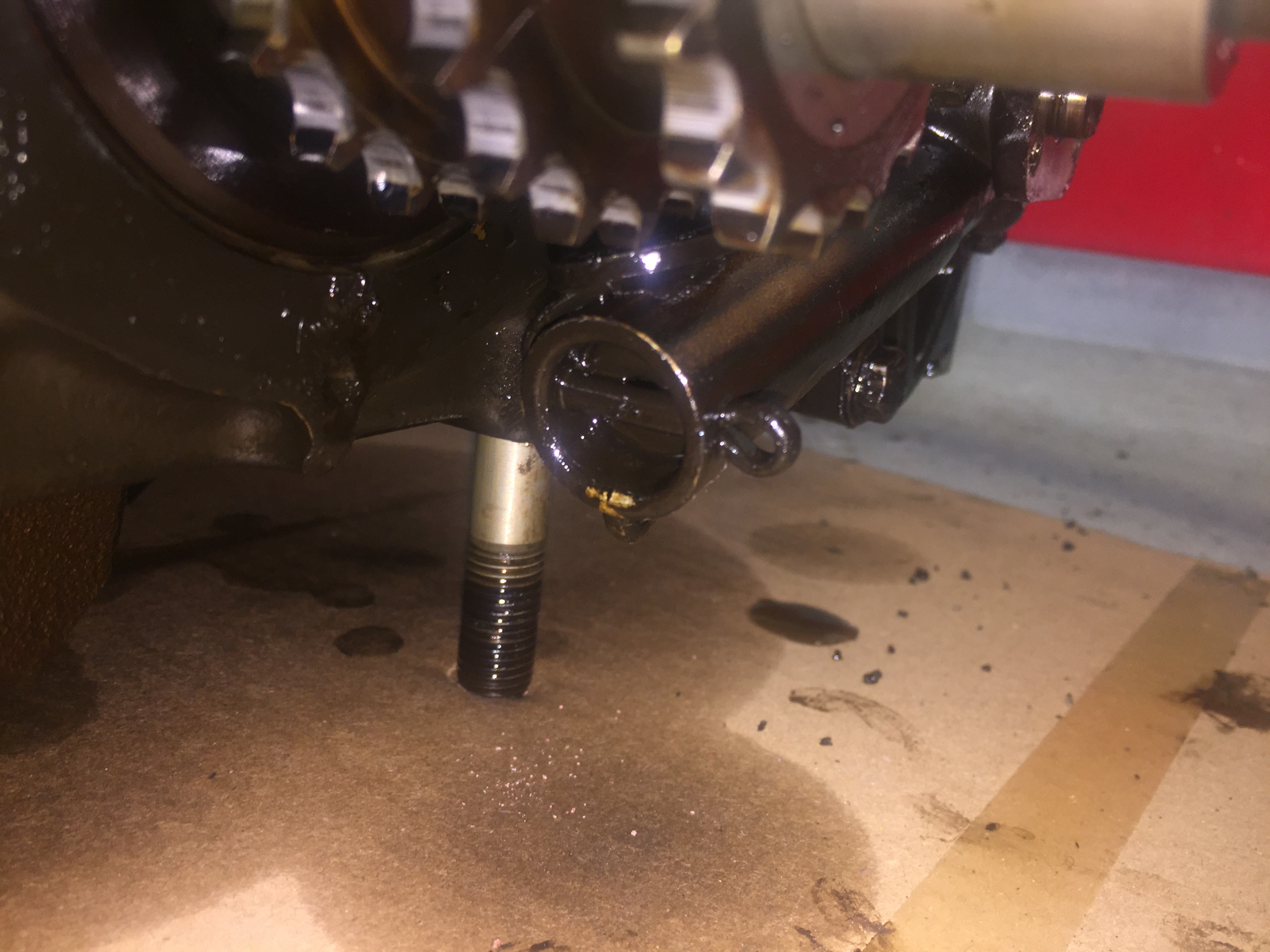

Tiny progress. What’s the proper torque for the cam gears? Thread locker?
What’s the piston behind the lock pin on the oil pump for?
Oil pump thingy
The other
One

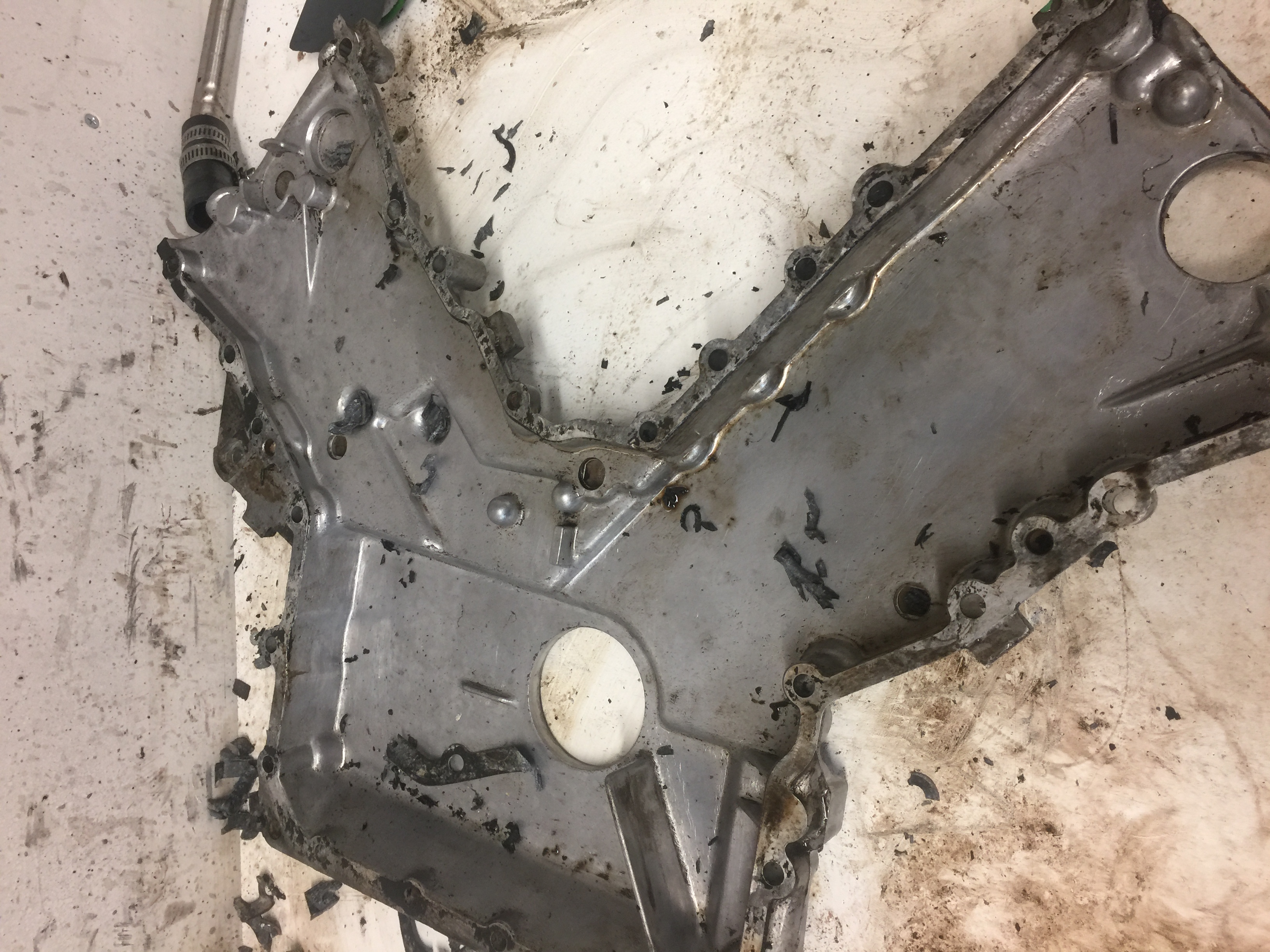

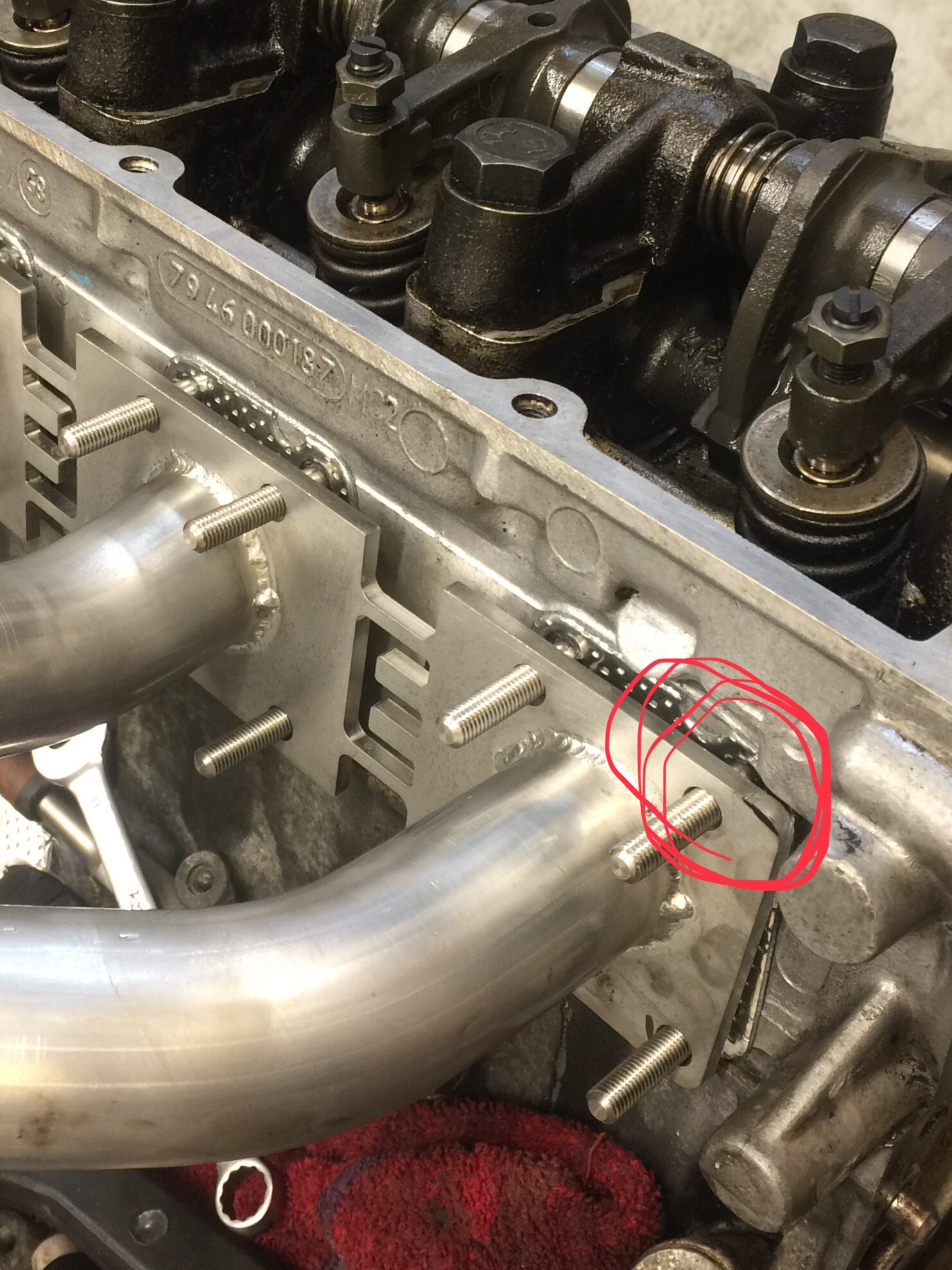

I’ve been fiddling with some small stuff, loathing removal of old gasket material from the timing cover.

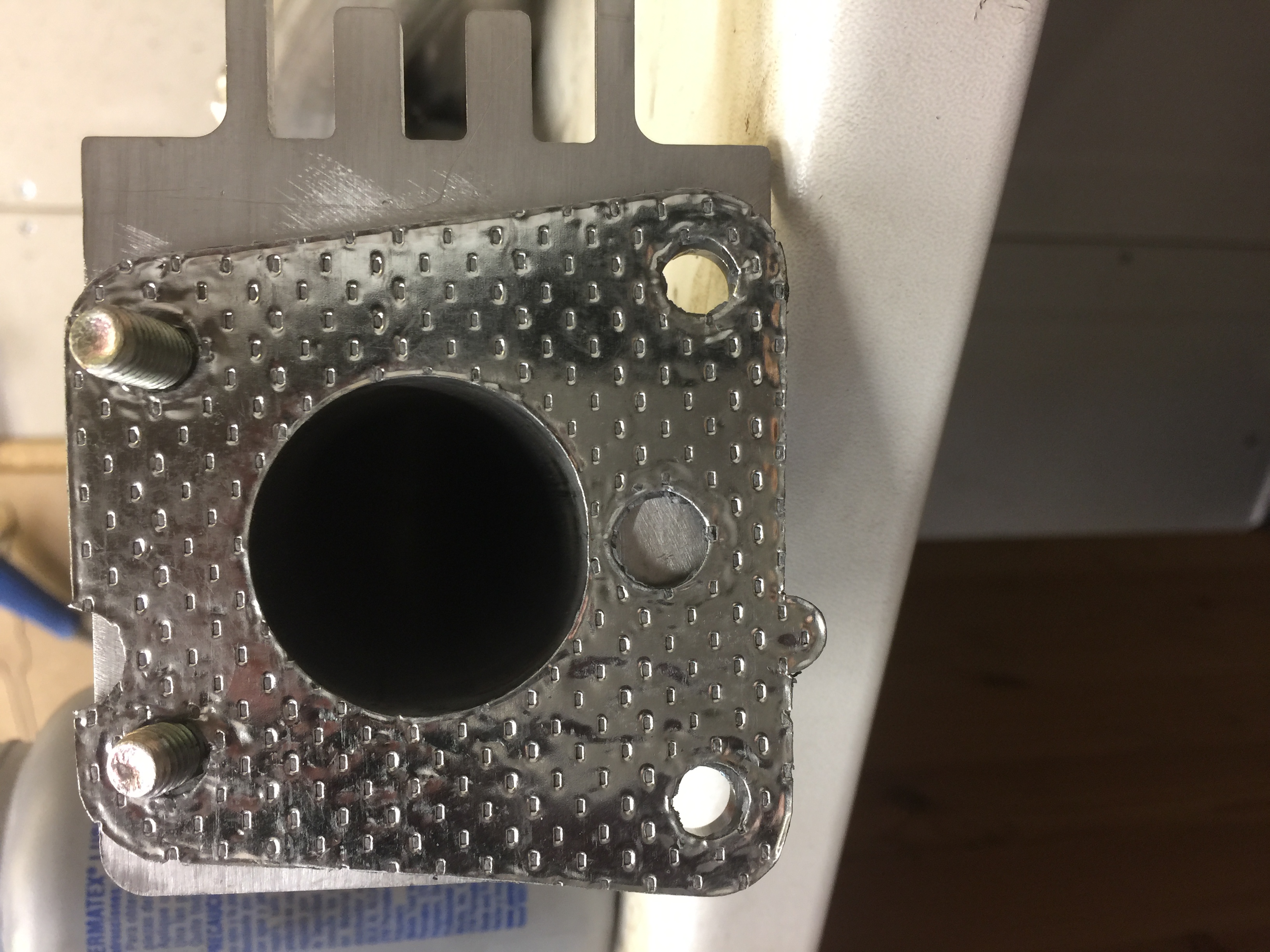

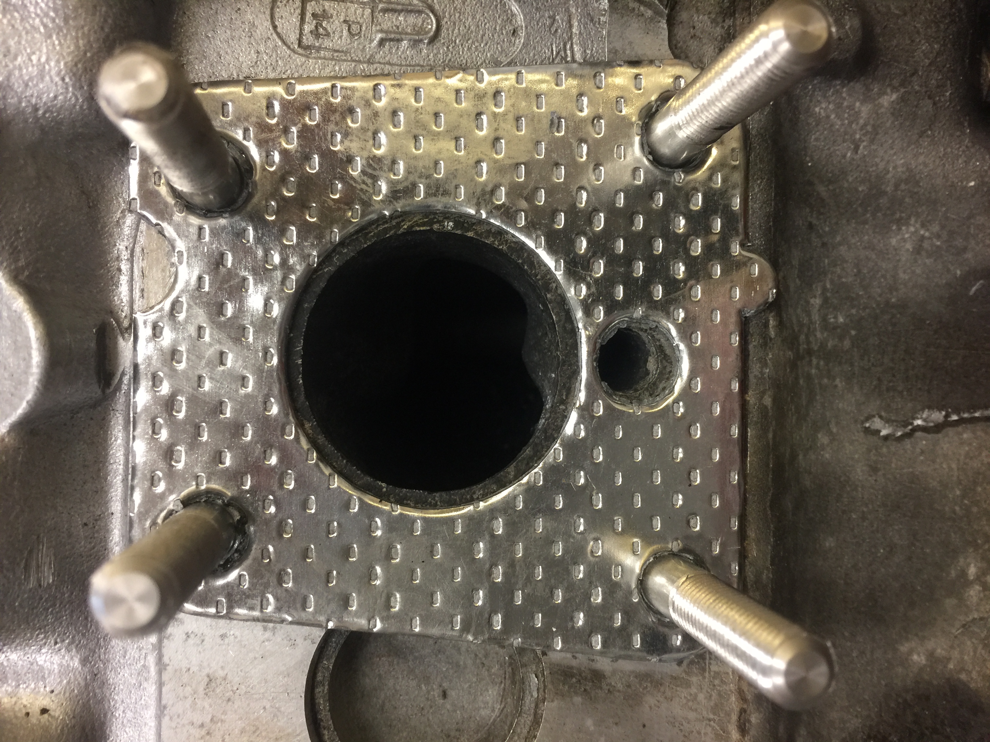

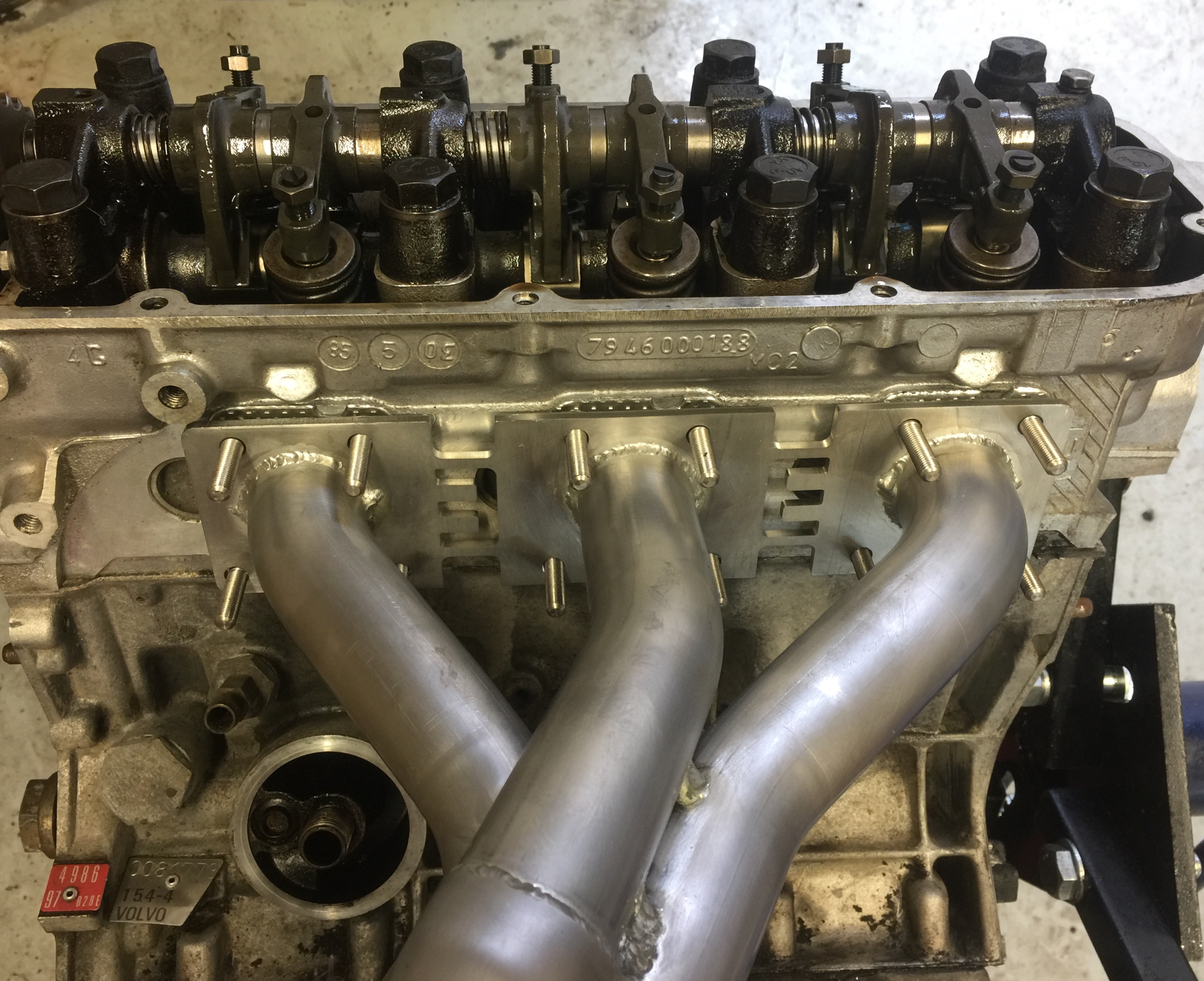

I wonder if I should port the exhaust ports in the heads? They are smaller than the gasket and headers. In addition the heads have provision for air injection. I could grind some of that down.
Any thoughts?
Gasket matches headers
Clearly visible smaller ID
Looks good here
Need to grind down some here

Postby Admin-bloke » Sat Apr 07, 2018 9:10 pm
I wouldn't bother with 'porting' the exhaust port to size match the hope in the exhaust, I'd leave it alone as the size difference of the will act as an anti-reversal step that will prevent backflow into the head.
Re: Vin 5063
Postby gruffalo » Sat Apr 07, 2018 9:13 pm
Very convenient too ;)

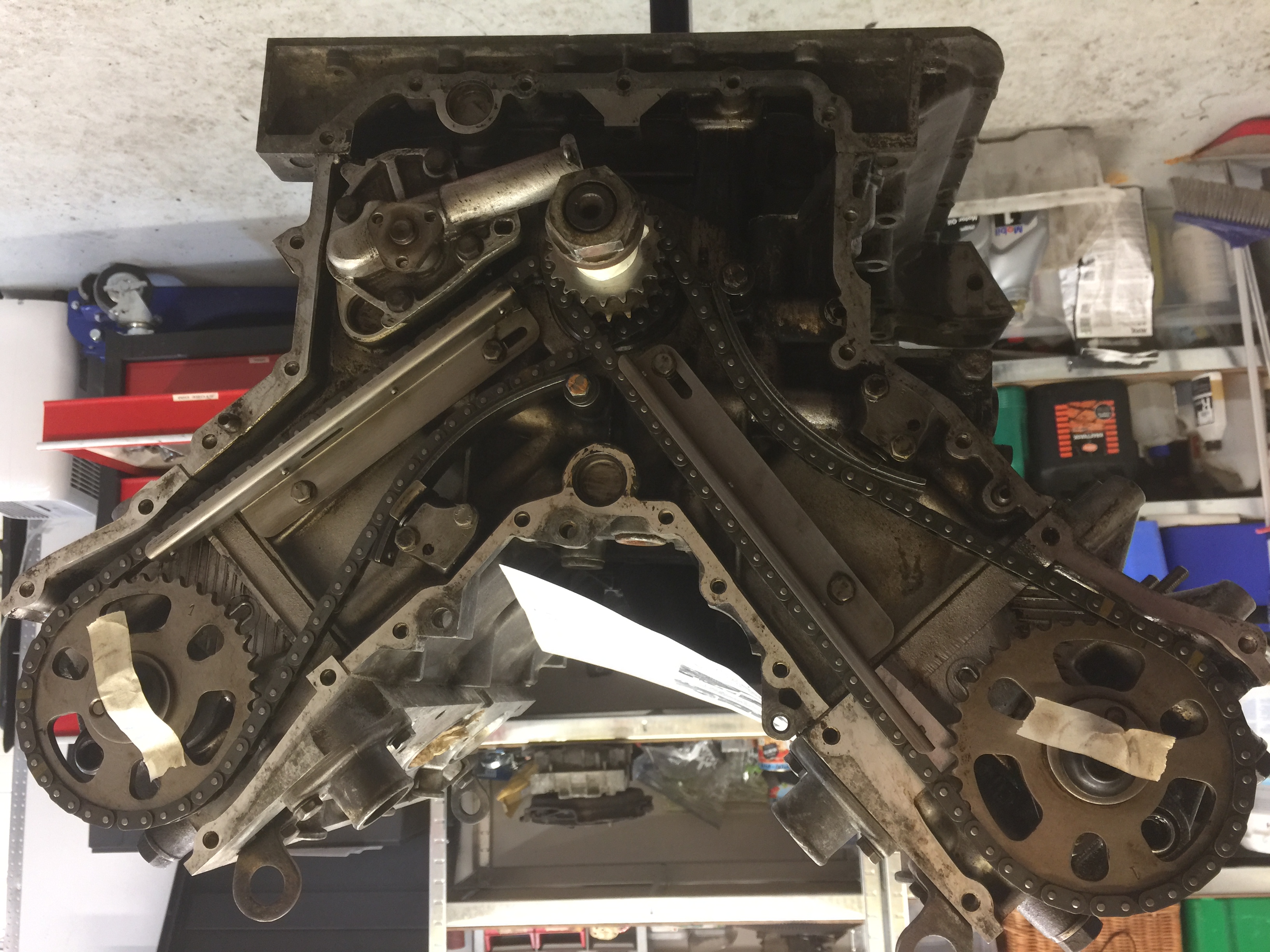

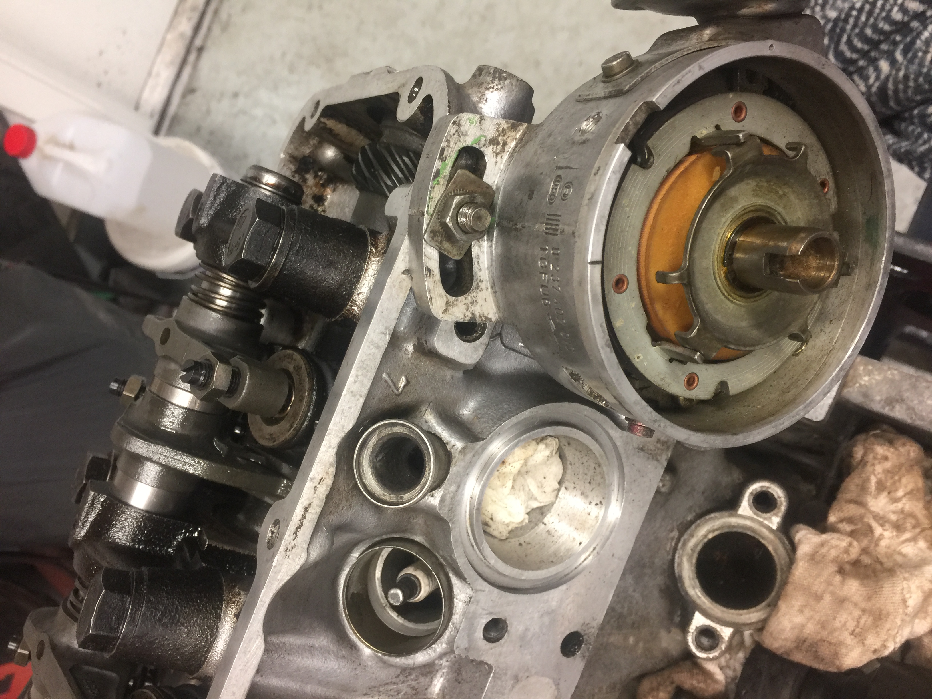

Another day of micro progress. Got the ignition distributor installed, and the cam gears torqued down.
I wasted a lot of time trying to figure out the timing procedure involving the hole in The Valley. I never got it to match the other timing indicators (visual on piston and mark on timing cover). Whatever .
On the other hand I made great progress removing old gasket material from the timing cover.
Unfortunately I discovered the dizzy cap was missing one of the hooks to clamp it down. I’d be happy if someone could donate one...
Properly timed (?)
Getting there, albeit slowly

Postby Spudmurphy » Wed Apr 11, 2018 7:51 am
The timing notch on the dizzy looks fine to me.

Postby Admin-bloke » Wed Apr 11, 2018 8:48 am
You open the access hope from the V section of the engine then put in a drill bit of equal hole size and move the crank until this locks the crank in the top dead centre. You then adjust the timing mark that is exterior to the engine as this is bolted on and slightly adjustable. You then set the timing of the distributor to number 1 and once done remove the drill bit etc
Re: Vin 5063
Postby gruffalo » Wed Apr 11, 2018 9:26 am
Admin-bloke wrote:You open the access hope from the V section of the engine then put in a drill bit of equal hole size and move the crank until this locks the crank in the top dead centre. You then adjust the timing mark that is exterior to the engine as this is bolted on and slightly adjustable. You then set the timing of the distributor to number 1 and once done remove the do bit etc
My engine is a B28E. There are multiple positions where the drill bit drops down, and none of them appear to be at TDC. What am I doing wrong?
