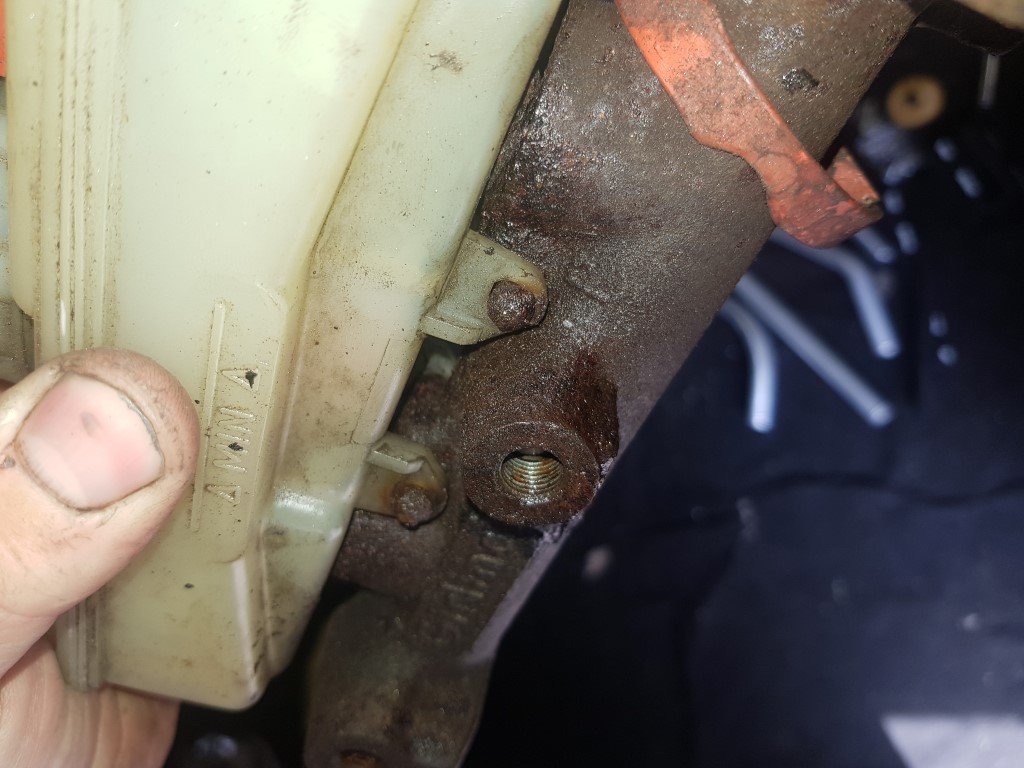

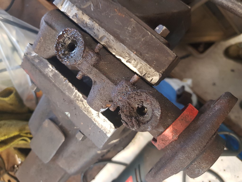

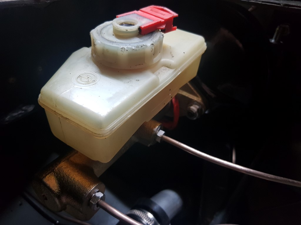

1st was the master cylinder, the pins we seized in so new ones required ...
20190522_121751 (Medium).jpg (184.36 KiB) Viewed 5681 times
the old one looked to have been leaking for a while which can be seen once the reservoir was removed
20190527_150142 (Medium).jpg (211.75 KiB) Viewed 5681 times

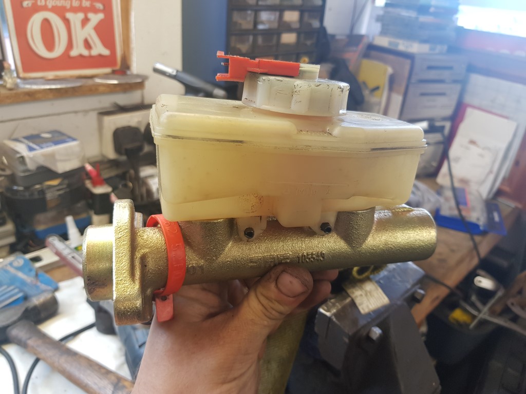

new one assembled with the original reservoir

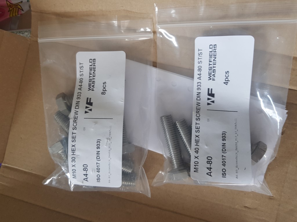

Stainless A4 80 grade bolts ordered for the body to be bolted down with, the tensile strength of these are almost the same as steel so should be more than strong enough

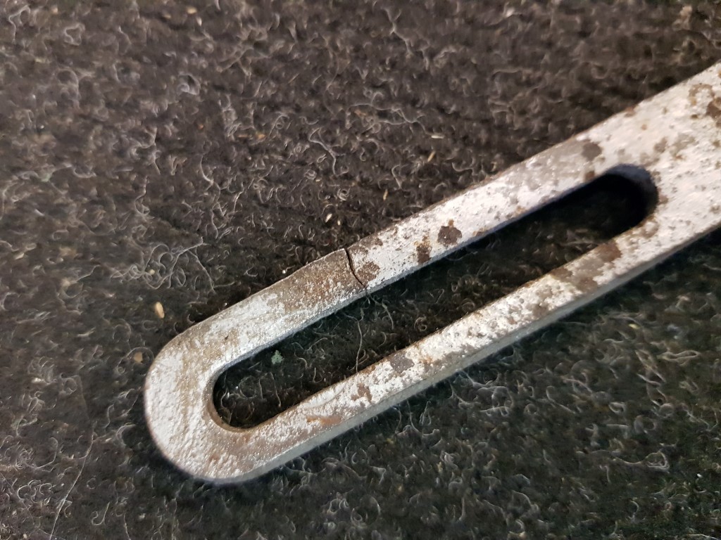

The alternator bracket was cracked so I welded this up for extra strength, didnt get a pic of it done but this was before...

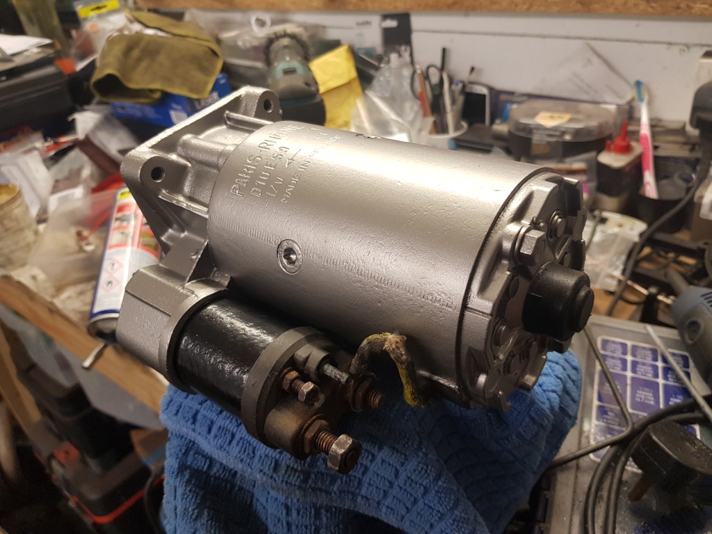

I also took the starter motor and solenoid apart and repainted them..
20190602_214630 (Medium).jpg (228.45 KiB) Viewed 5681 times
MMM a few wiring guesses required and some remote phone support from Mr T sorted that :geek: :thumbsup:

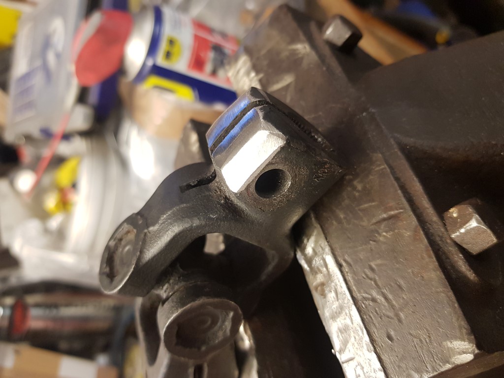

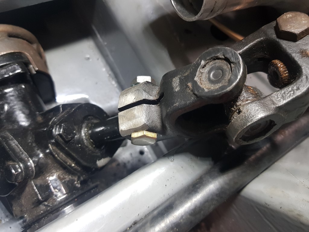

I then turned my attention to the steering, connected the wheels to the column, i 1st removed the column and fitted a new column bush, then started connecting the other end up with the cv joints, the clearance between the lower knuckle and the frame was very very tight so i decided a little modification was required...
20190604_211910 (Medium).jpg (179.04 KiB) Viewed 5681 times
I also used a half nut and modded the end of the bolt for a bit more clearance

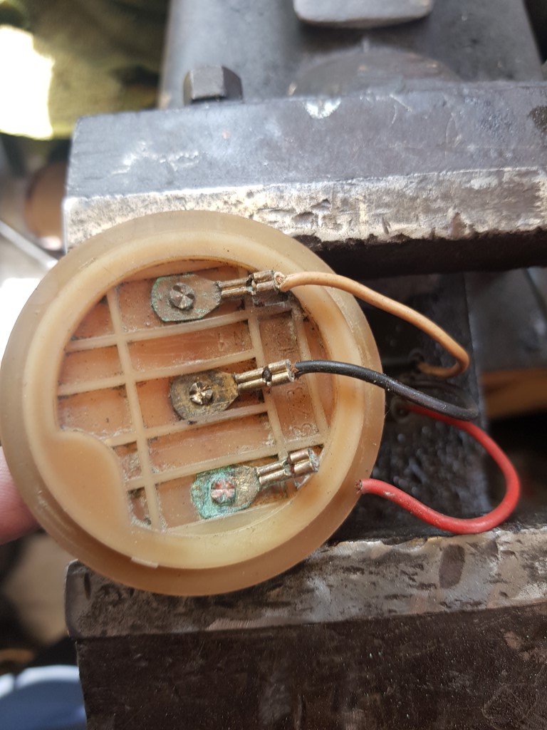

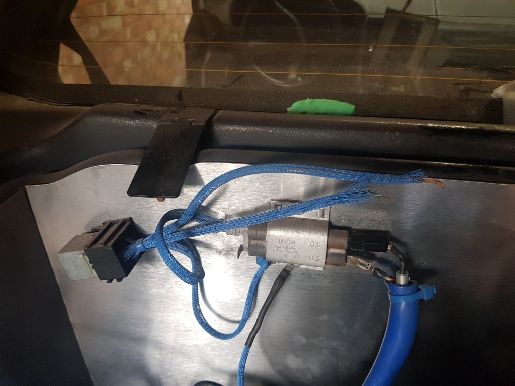

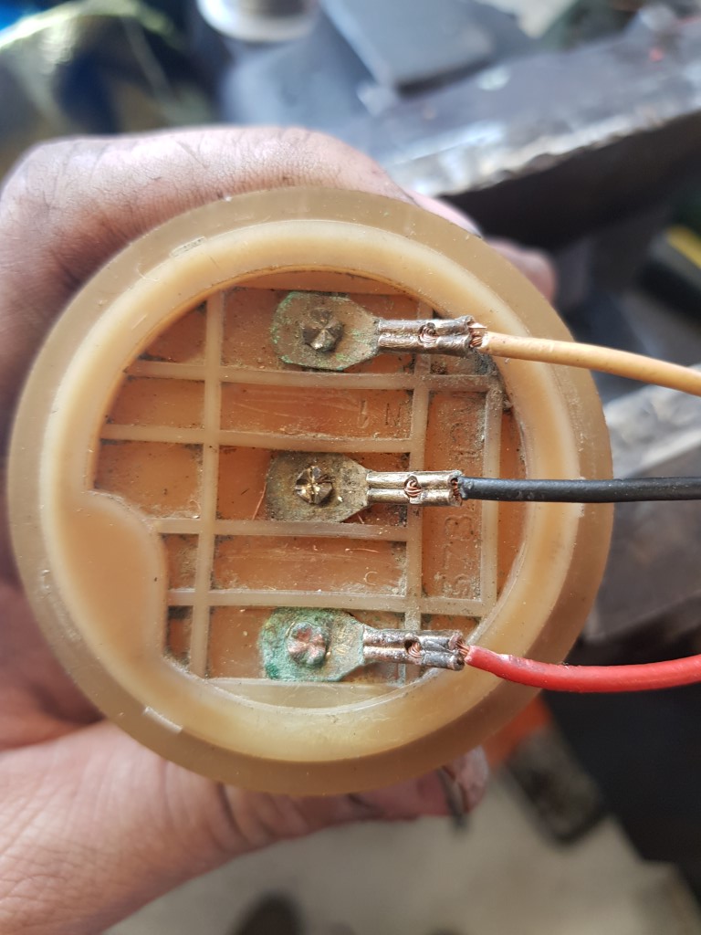

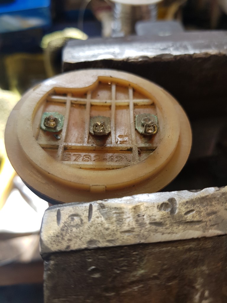

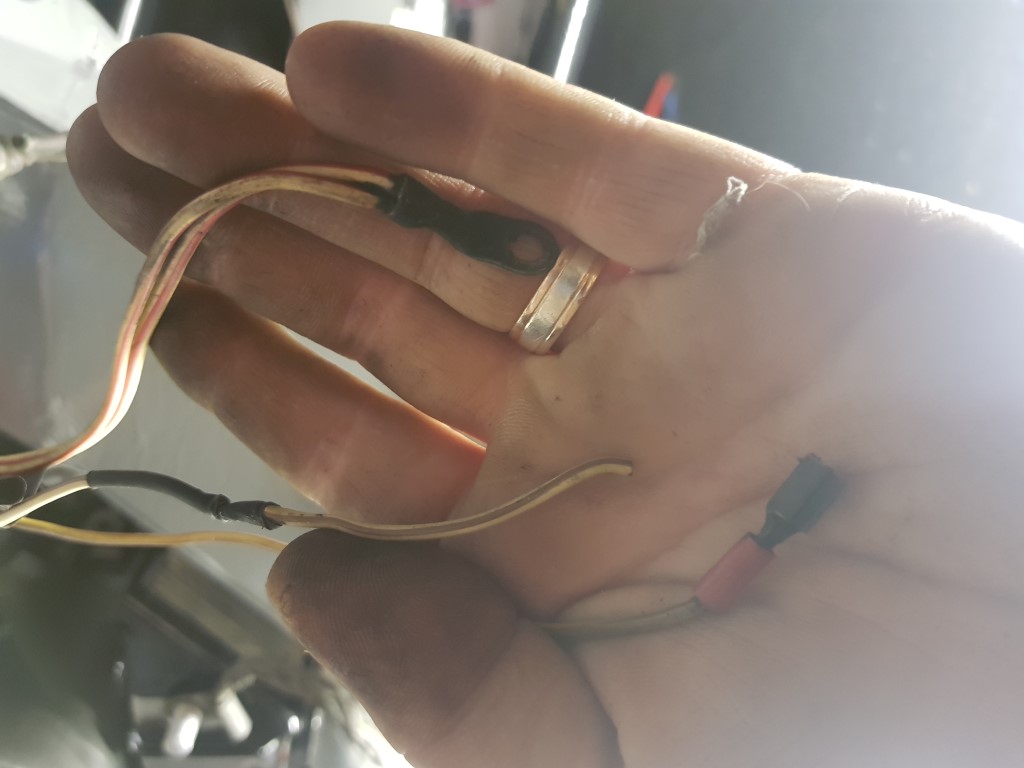

Fuel sender was next, one of the wires had snapped completely and the middle one was hanging by a thread so i cut these off flush and managed to drill out what was left of the wire and re crimp it
20190605_101041 (Medium).jpg (224.48 KiB) Viewed 5681 times
20190605_101958 (Medium).jpg (196.22 KiB) Viewed 5681 times
20190605_102947 (Medium).jpg (187.06 KiB) Viewed 5681 times
Unfortunately after doing all this the sender still doesn't work so a new one is now required :roll:

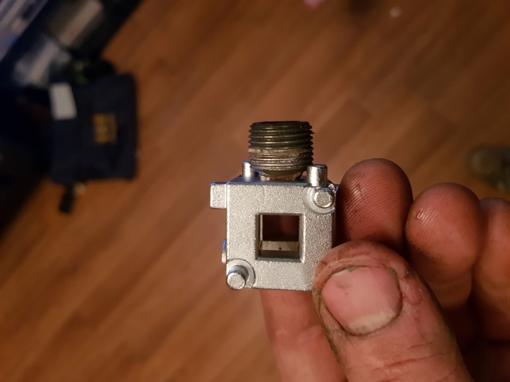

had a small issue doing the gearbox as i didn't have the right square socket to fit si i went to the local motor factor and improvised with a brake caliper wind back tool which has the right size square in the centre

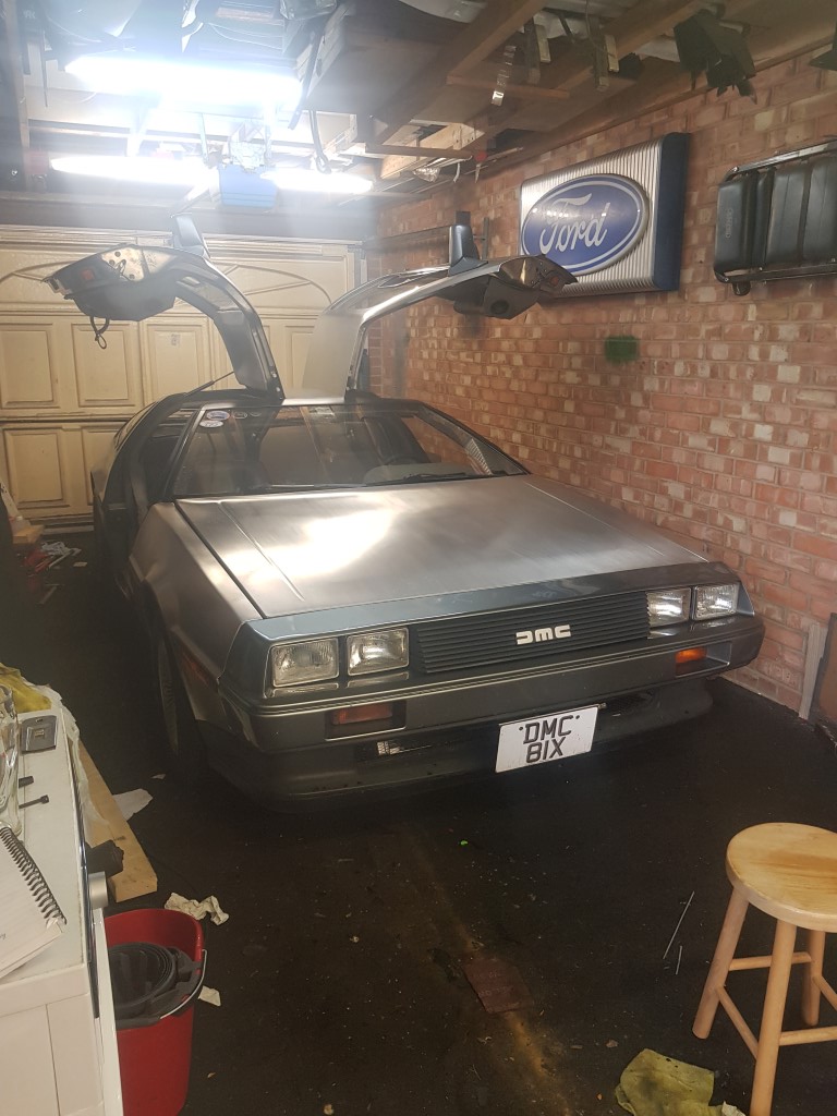

well after spending 9 days solid in the garage, most days were 14 hour days, i was down to the wire, however at 9pm on Friday 7th June....
20190607_211410 (Medium).jpg (337.6 KiB) Viewed 5681 times
YES I MADE IT !!!!!!!!! :D :D :D :dmcdoors: :dmcdoors: :dmcdoors: :dance: :dance: :dance:
The welcome i had from everyone was quite overwhelming !! It was Epic !!
To say that i was shocked and stunned was the understatement of the year !! the car ran perfectly, we found a small fuel leak on Saturday which just required 2 new copper washers (thanks Mr T) and i developed a random squeak on the way home from the suspension but other than that all good !

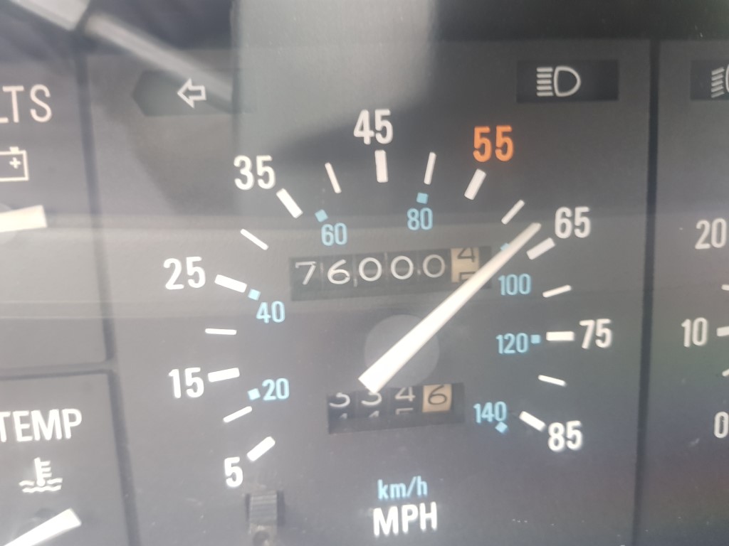

I got an action shot on the way home of the mileage ticking over to 76k
