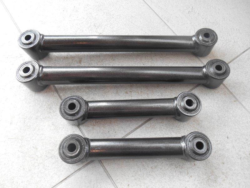

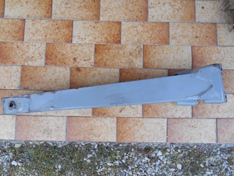

Postby Domi » Sat Jan 14, 2017 5:55 pm

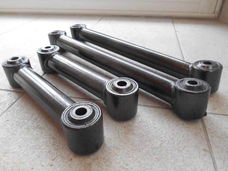

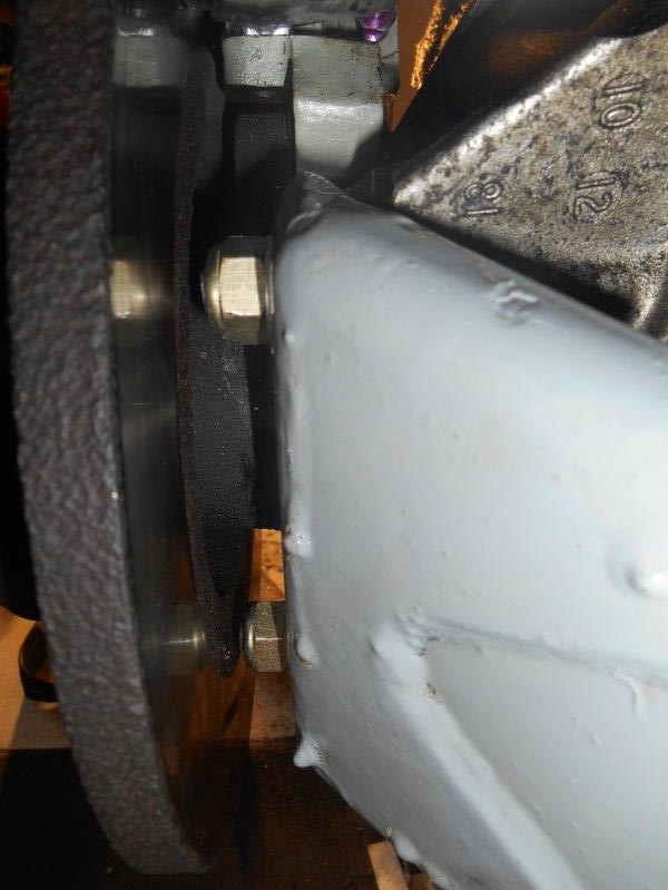

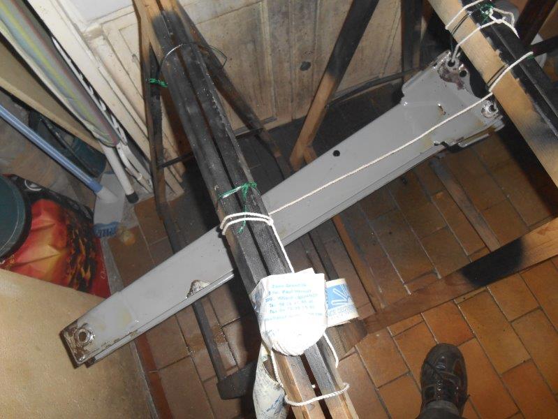

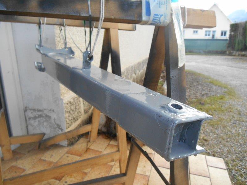

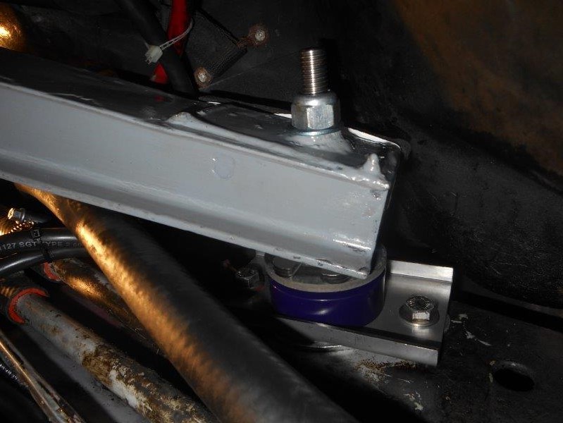

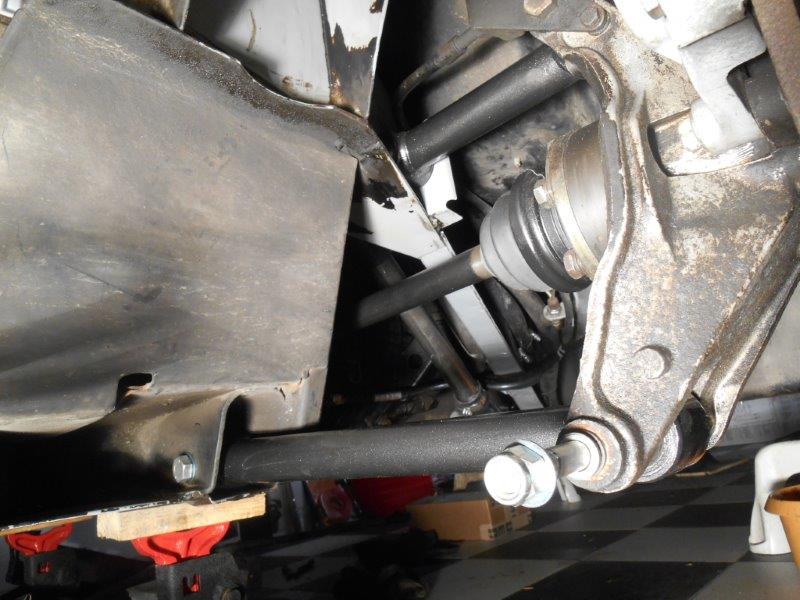

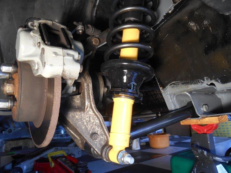

All arms are painted and I think they look good
Assembly of the arms

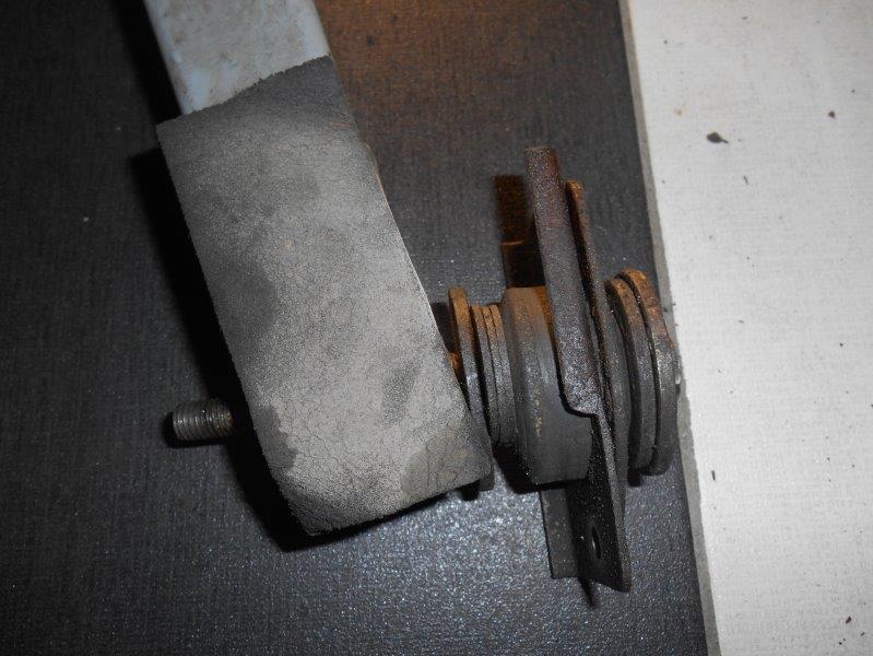

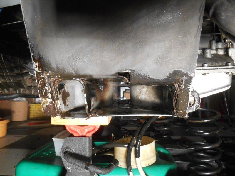

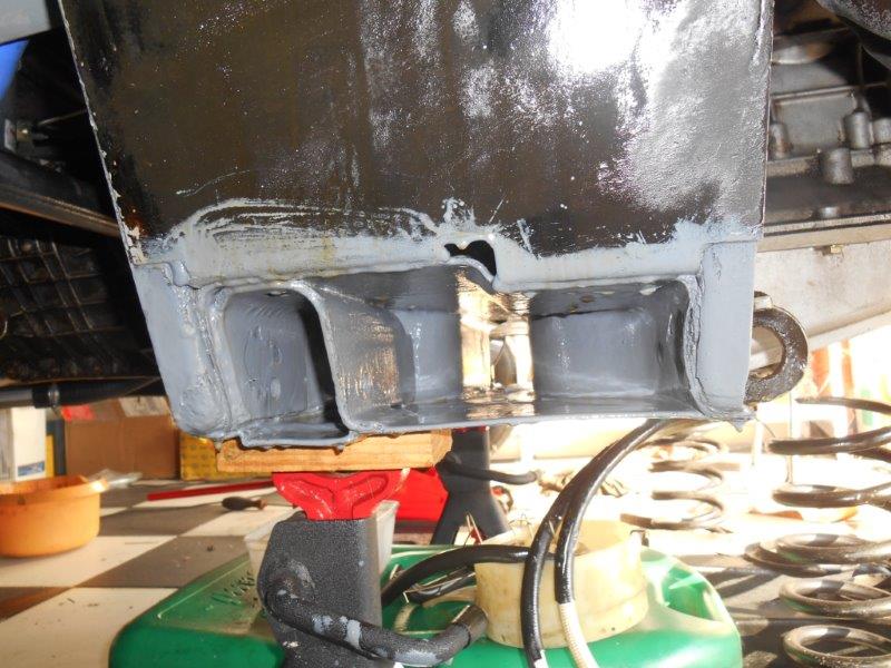

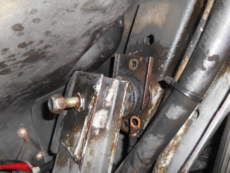

The other side is bit rusty and need some Rustol & POR15 before I mount the arms

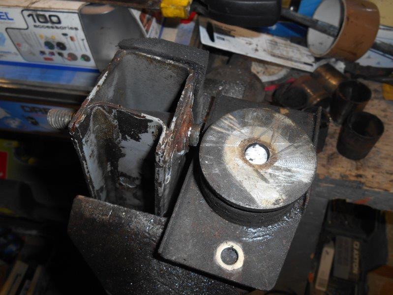

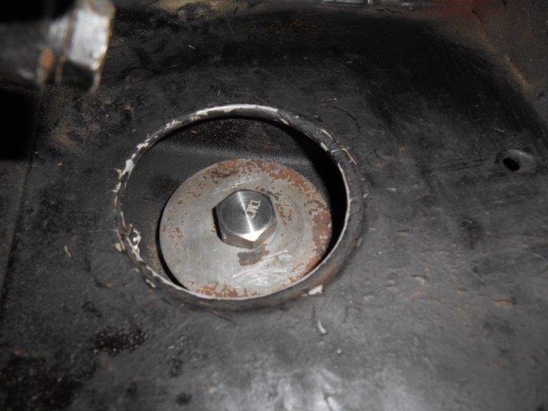

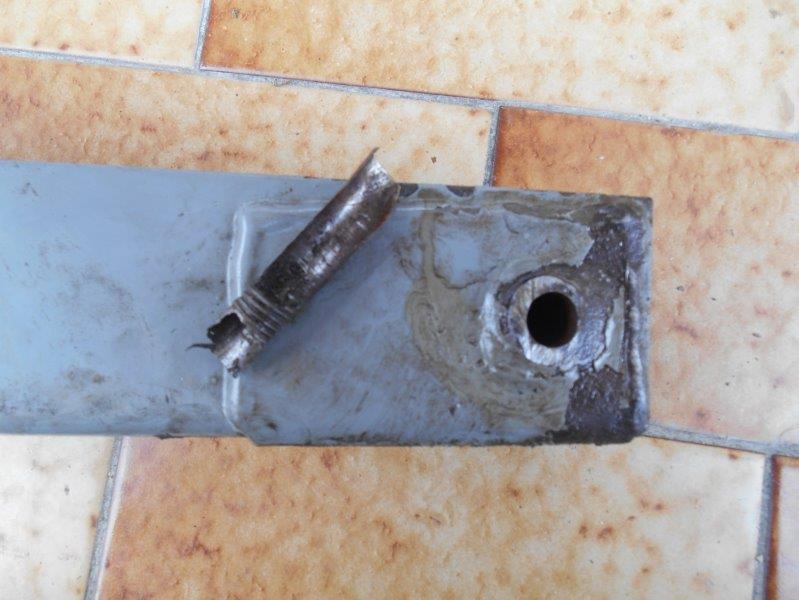

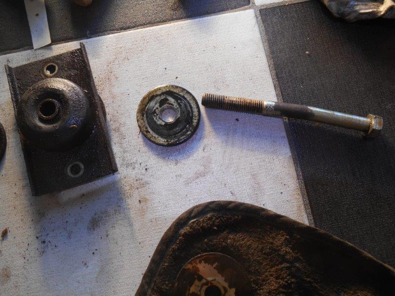

So far, impossible to remove the last tab. Just put some WD40 and hope it will work.

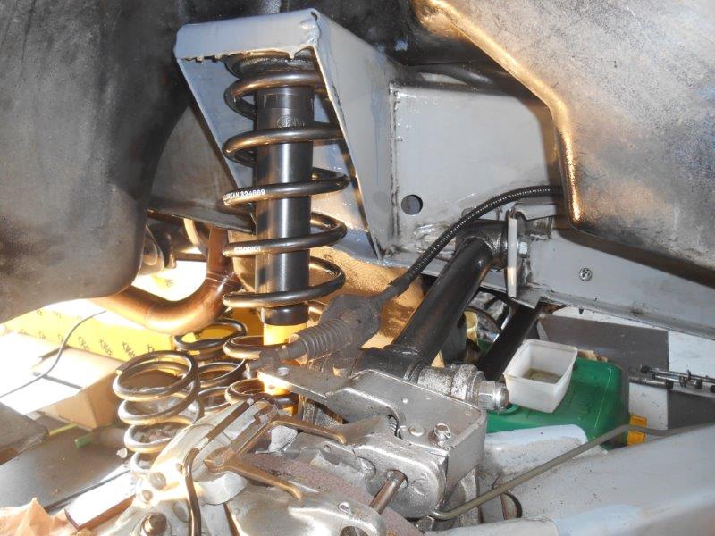

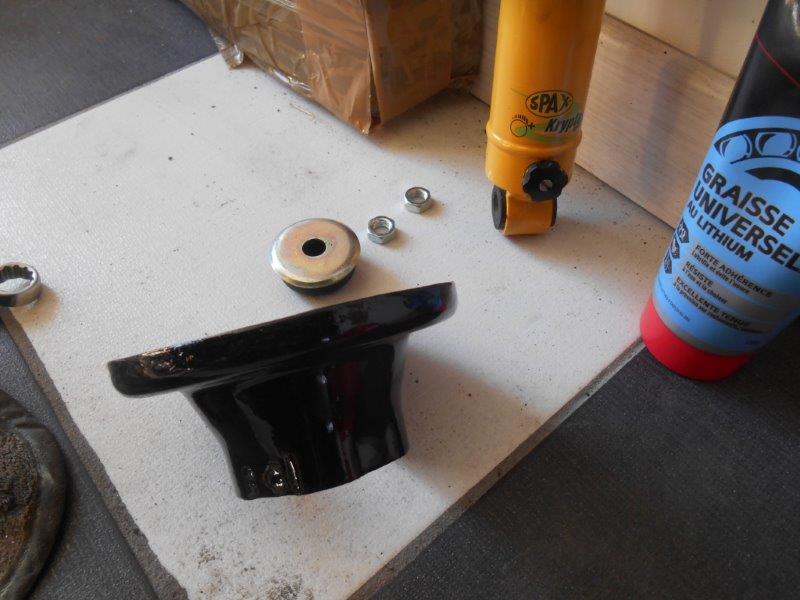

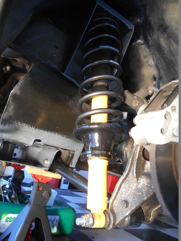

For those who mount the Eibach spring with the Spax shock, what is the height of the screw from bottom to top please?
Postby andyd » Sat Jan 21, 2017 11:32 pm
For my stuck tab, I had to hacksaw the bolt (hacksaw blade held in a rag) and cut it. Into 3 :twisted: :twisted:
An option if you can't hit it out with a hammer!
Good luck!

I spy DMC Midwest Inconel TABs, wise choice sir.

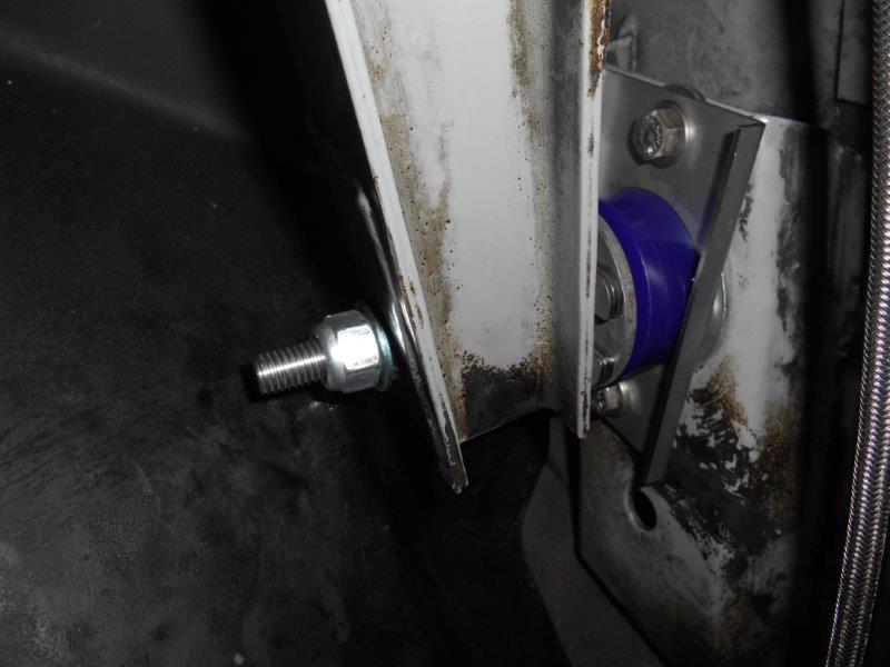

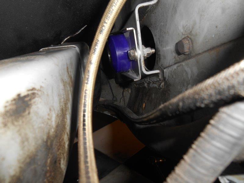

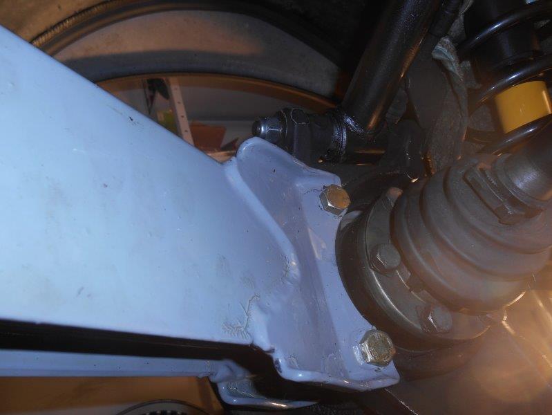

Postby Domi » Sun Jan 22, 2017 6:40 pm

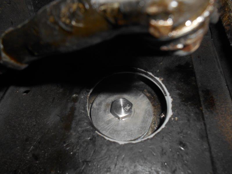

Thanks for the advice guys :)

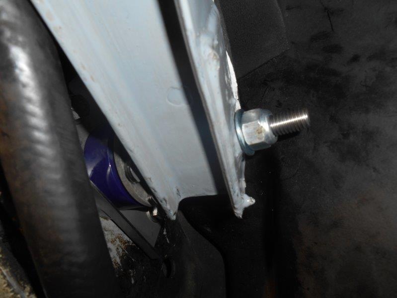

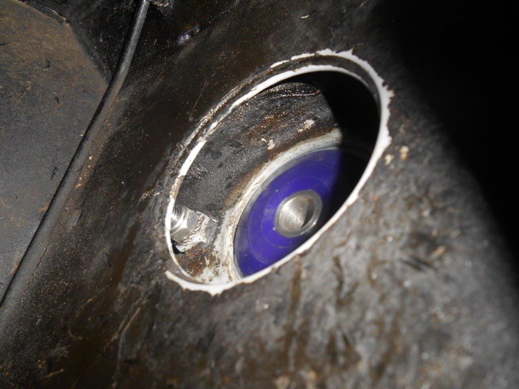

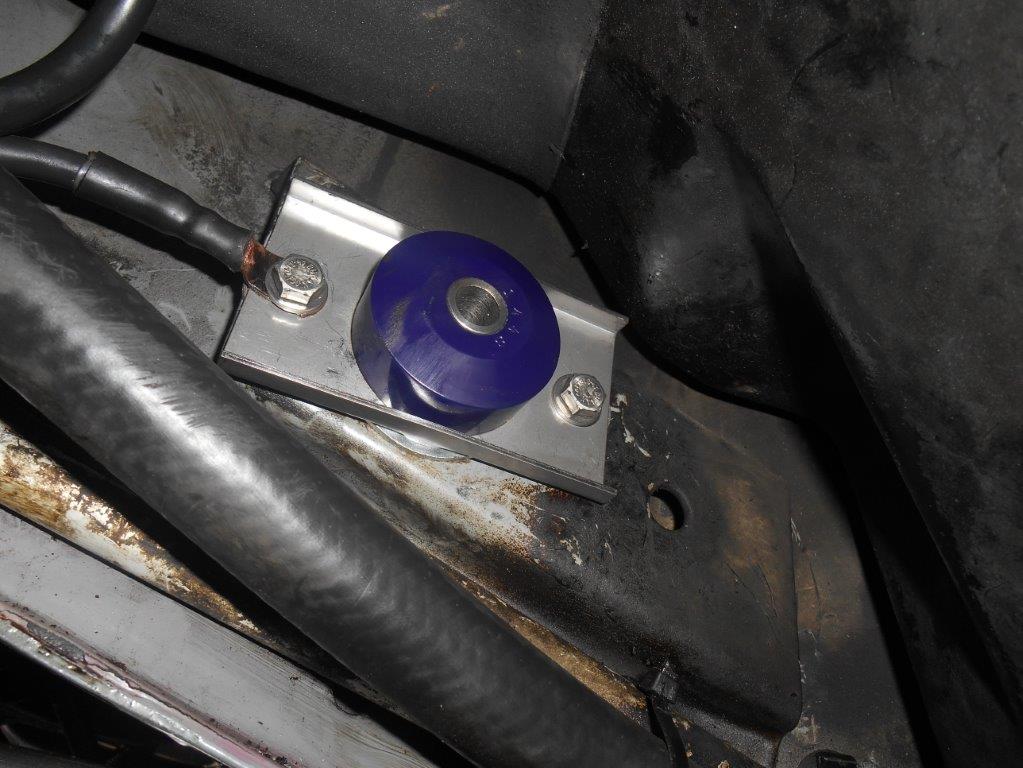

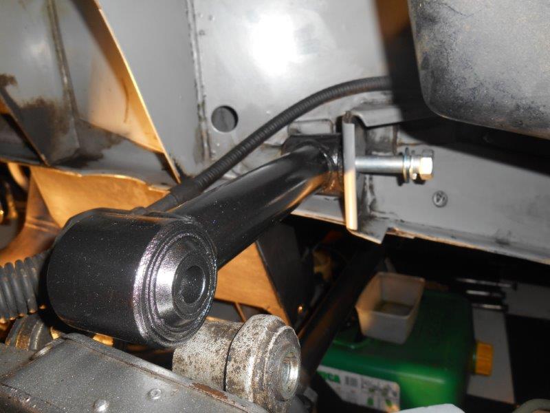

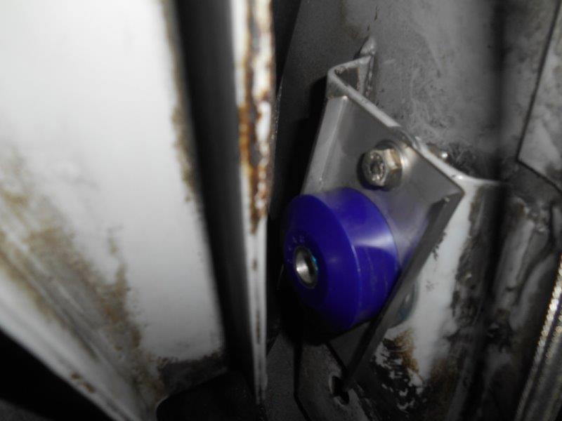

Replaced the two rusty bold for safety
New poly and stainless plate and bolt and new tab
Now the other side, once I will succeed to remove the old tab

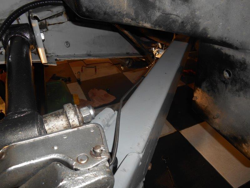

Postby Domi » Sat Jan 28, 2017 8:51 pm

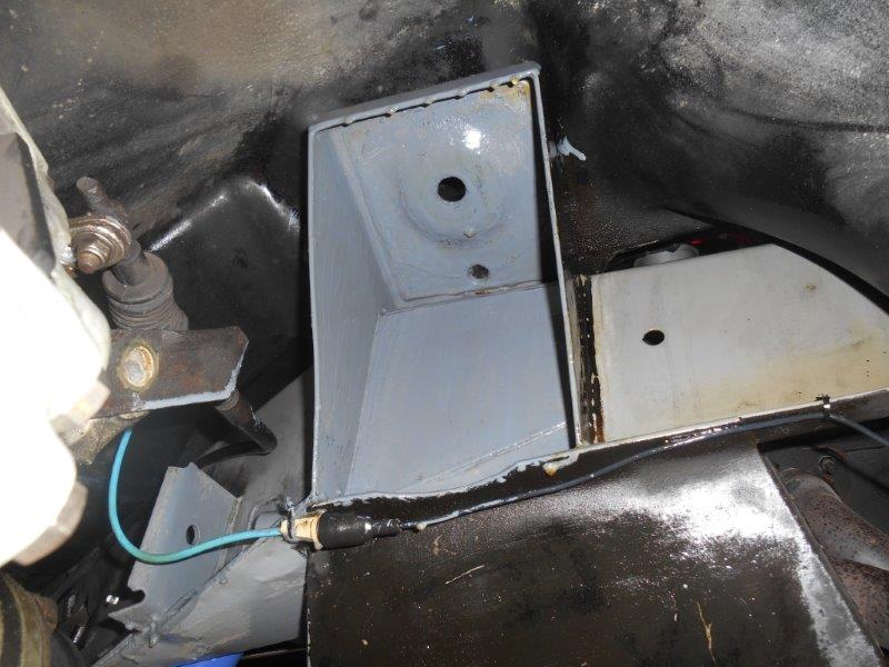

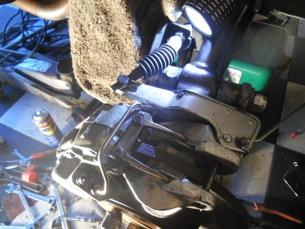

So far, the arm is on the floor.
I still have to remove the bolt. I cut it and drill it, but still not good.
I have to drill bigger but just can't do it now.
Postby Domi » Sun Jan 29, 2017 6:43 pm

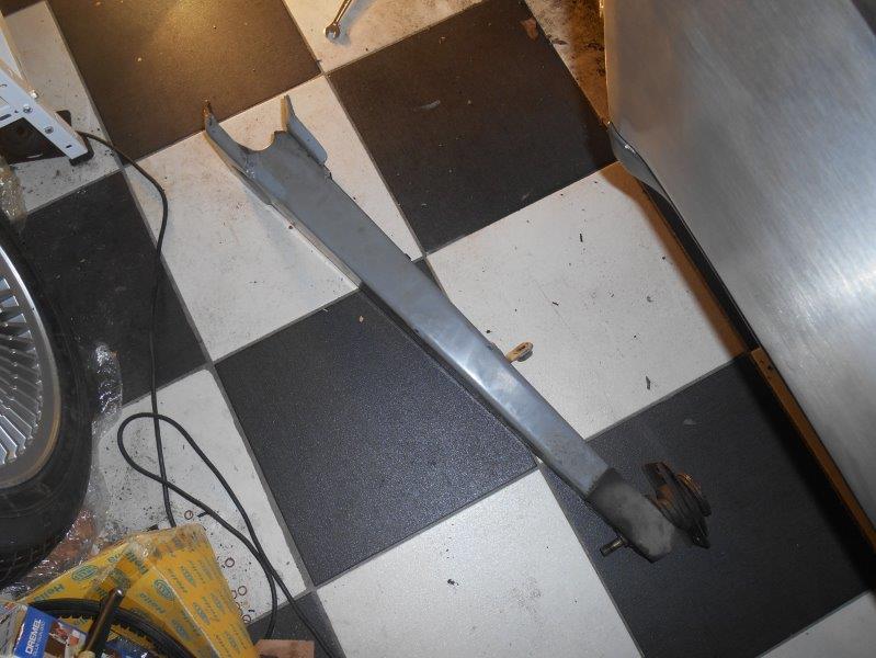

At last, removed this damn TAB
Cleaning the rust point (weird the one on the other side didn’t have a spot of rust…=
Applied some Rustol and the nit will be POR15

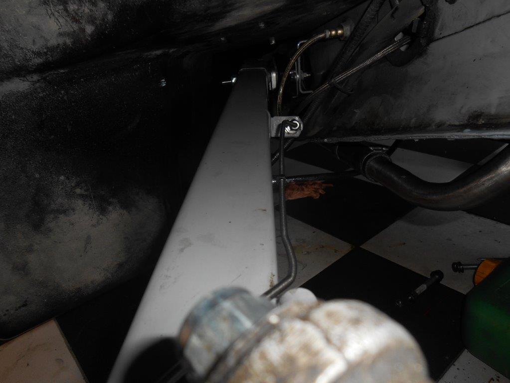

Postby Domi » Sat Feb 04, 2017 6:29 pm

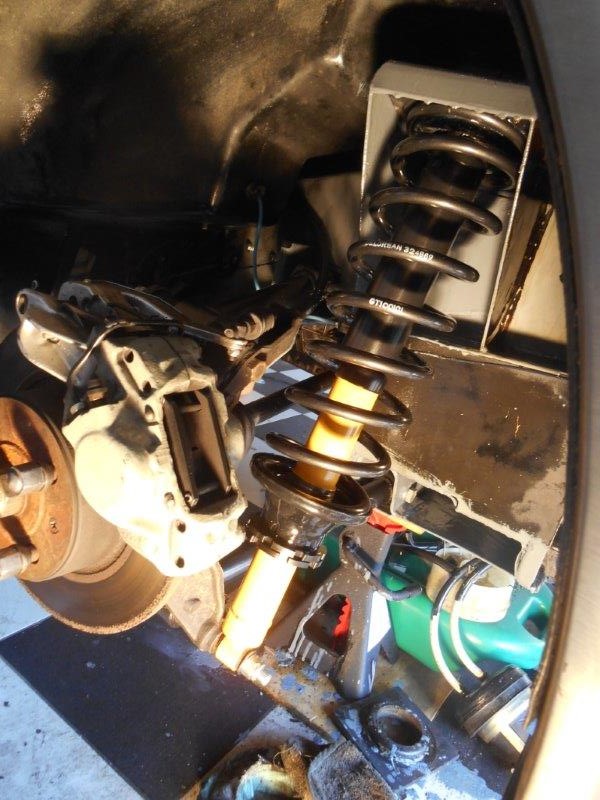

Removed the old 21 years old tires this morning, it’s time to change for something new for safety

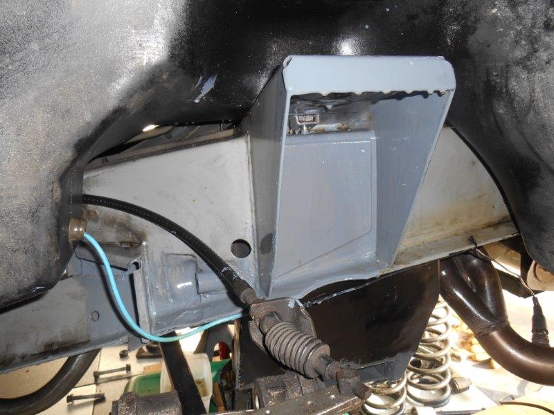

Last layer of Rustol to protect the arm against the rust
Poly on the passage side

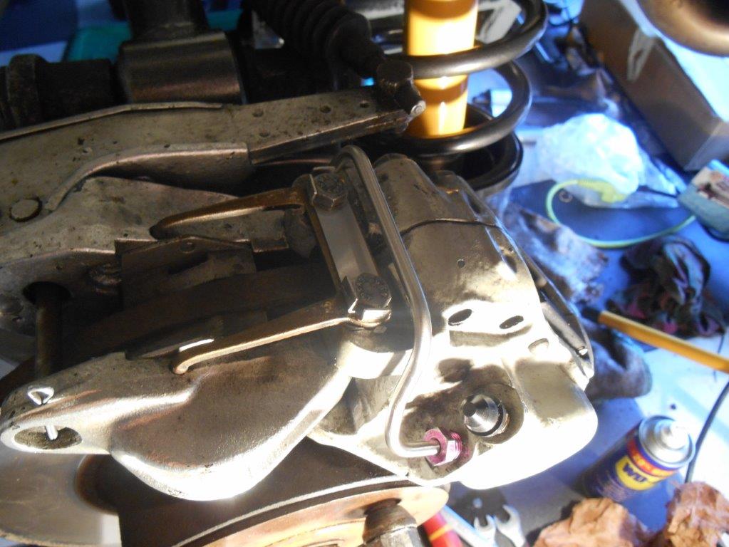

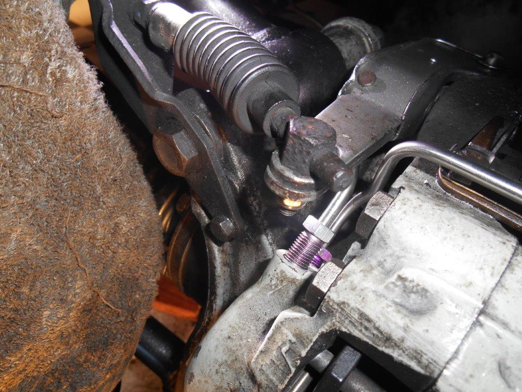

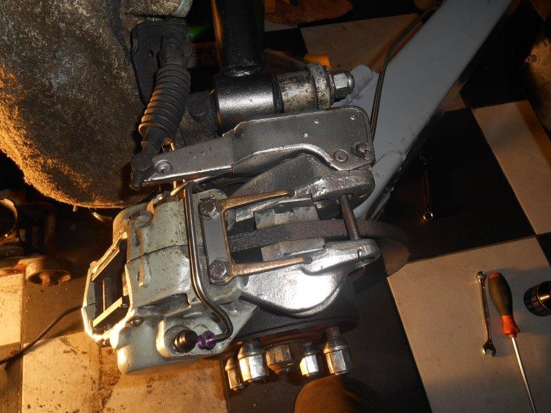

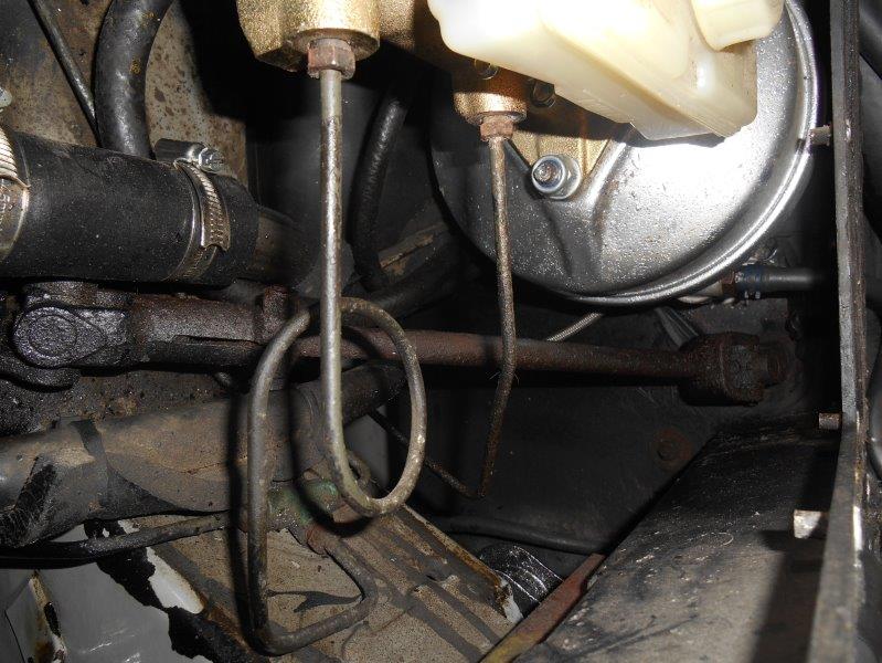

Stainless steel brake line
I’m unable to screw it for now, time to get some rest

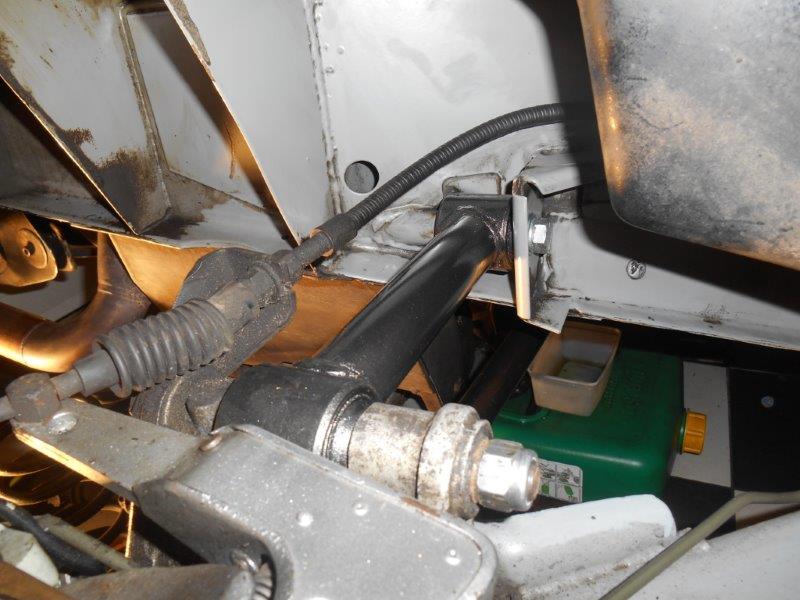

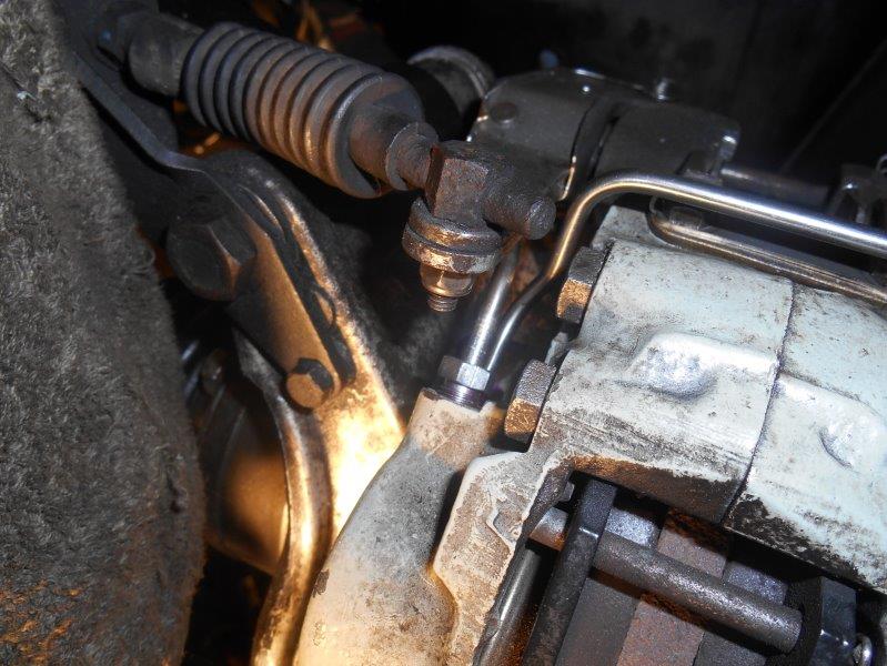

Postby Domi » Sun Feb 05, 2017 6:36 pm

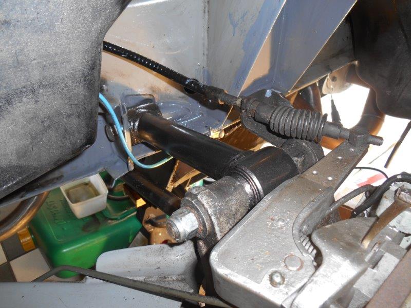

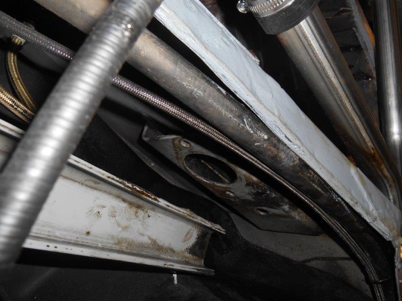

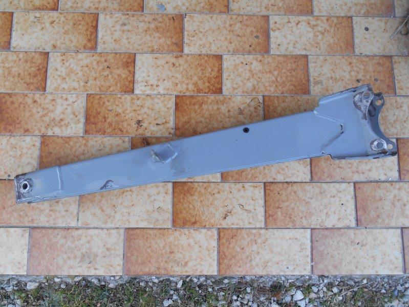

The arm is back with new tab and screws
New stainless brake line, not so easy because it wasn’t exactly the same pattern

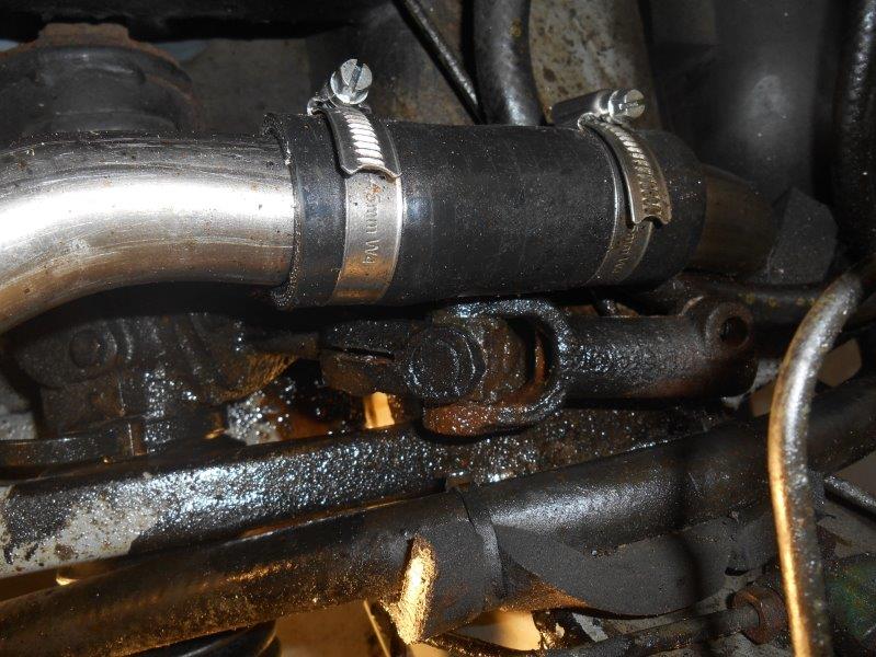

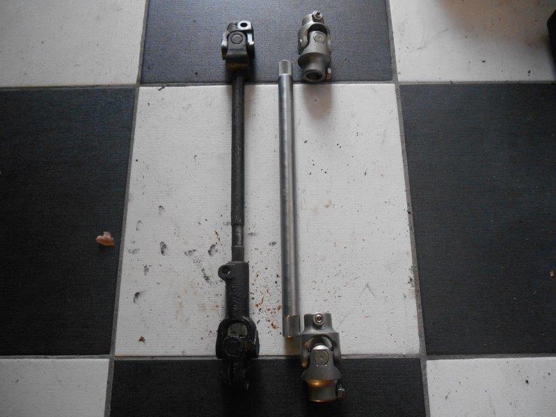

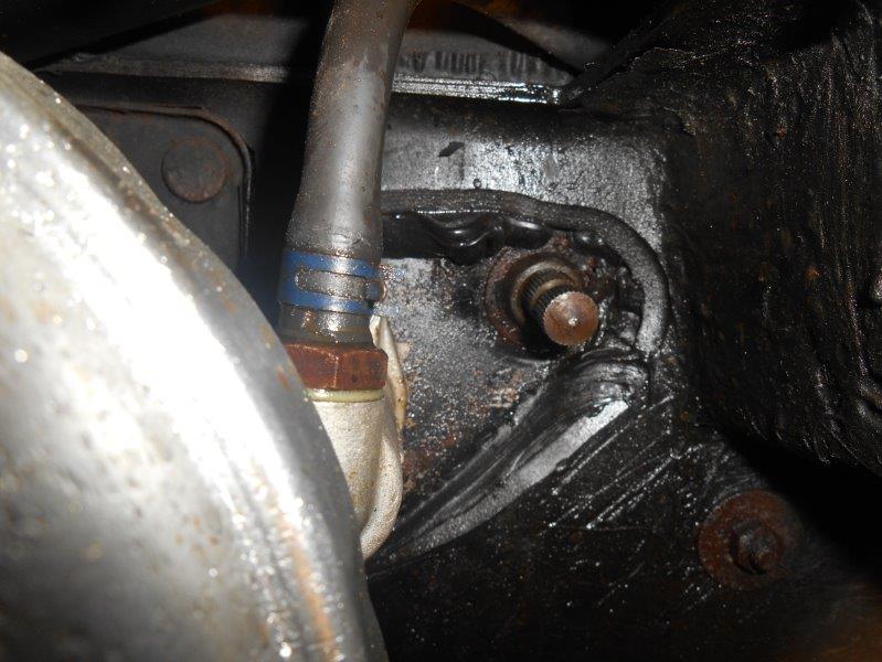

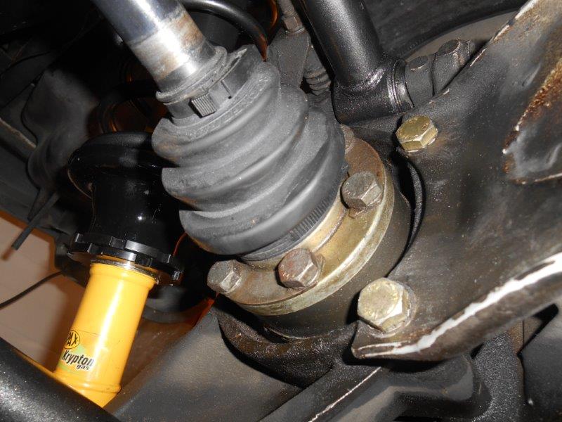

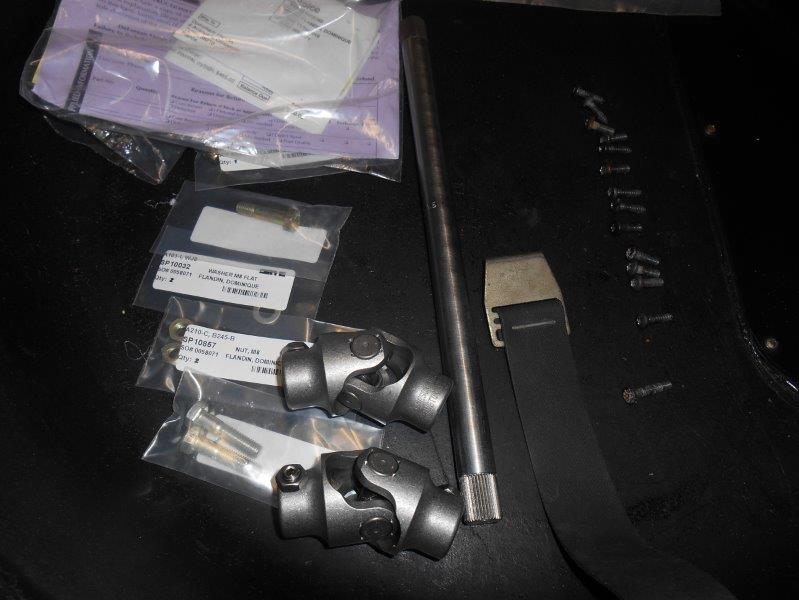

Old steering will be replaced by a stainless one, as soon as I will succeed to remove it

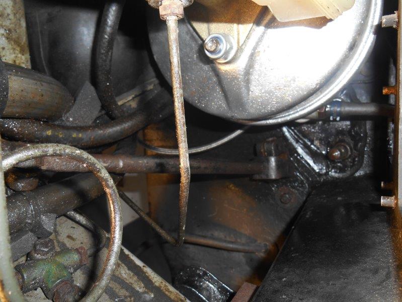

Postby Domi » Sun Feb 12, 2017 6:13 pm

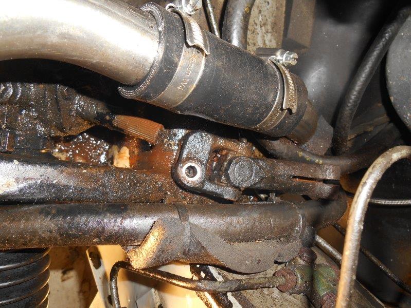

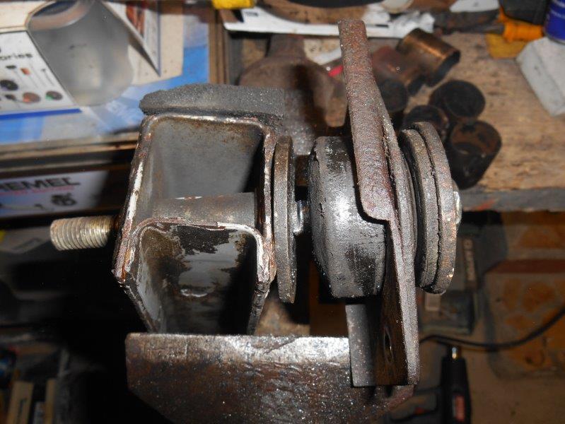

Removing the old steering, it was a little bit rusty
I’d like to change the bushing, but I’m afraid I need to remove the steering wheel from inside?

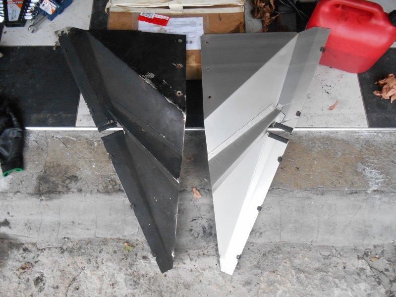

Old VS new one
Before and after cleaning
