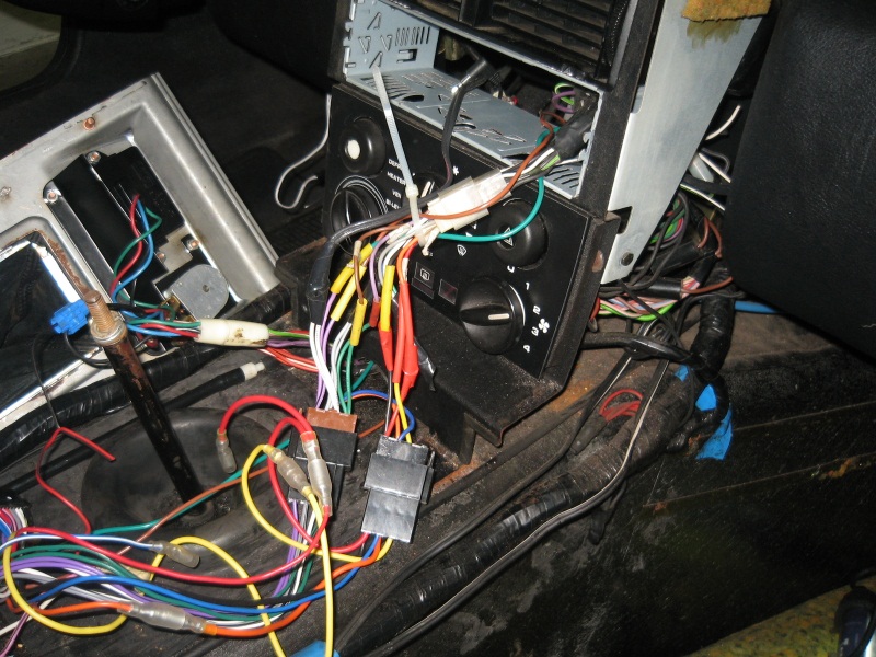

Postby RobvdVeer » Thu Oct 07, 2010 7:13 pm
First job: clean up
IMG_1293 (2).jpg (209.2 KiB) Viewed 3476 times
Postby Admin-bloke » Thu Oct 07, 2010 7:33 pm
I can see a scotchlock ! AAAAAAAAAAAAAAAAAAAAAAAAAAAAAGH
Postby RobvdVeer » Thu Oct 07, 2010 7:35 pm
Admin-bloke wrote:I can see a scotchlock ! AAAAAAAAAAAAAAAAAAAAAAAAAAAAAGH
AAAAAAAAAAAAAAAAAAAAAAAGH :shock: was my first reaction too :lol: :lol:
Postby arranj » Thu Oct 07, 2010 9:48 pm
You know they're all over his engine bay as well?! :shock:
