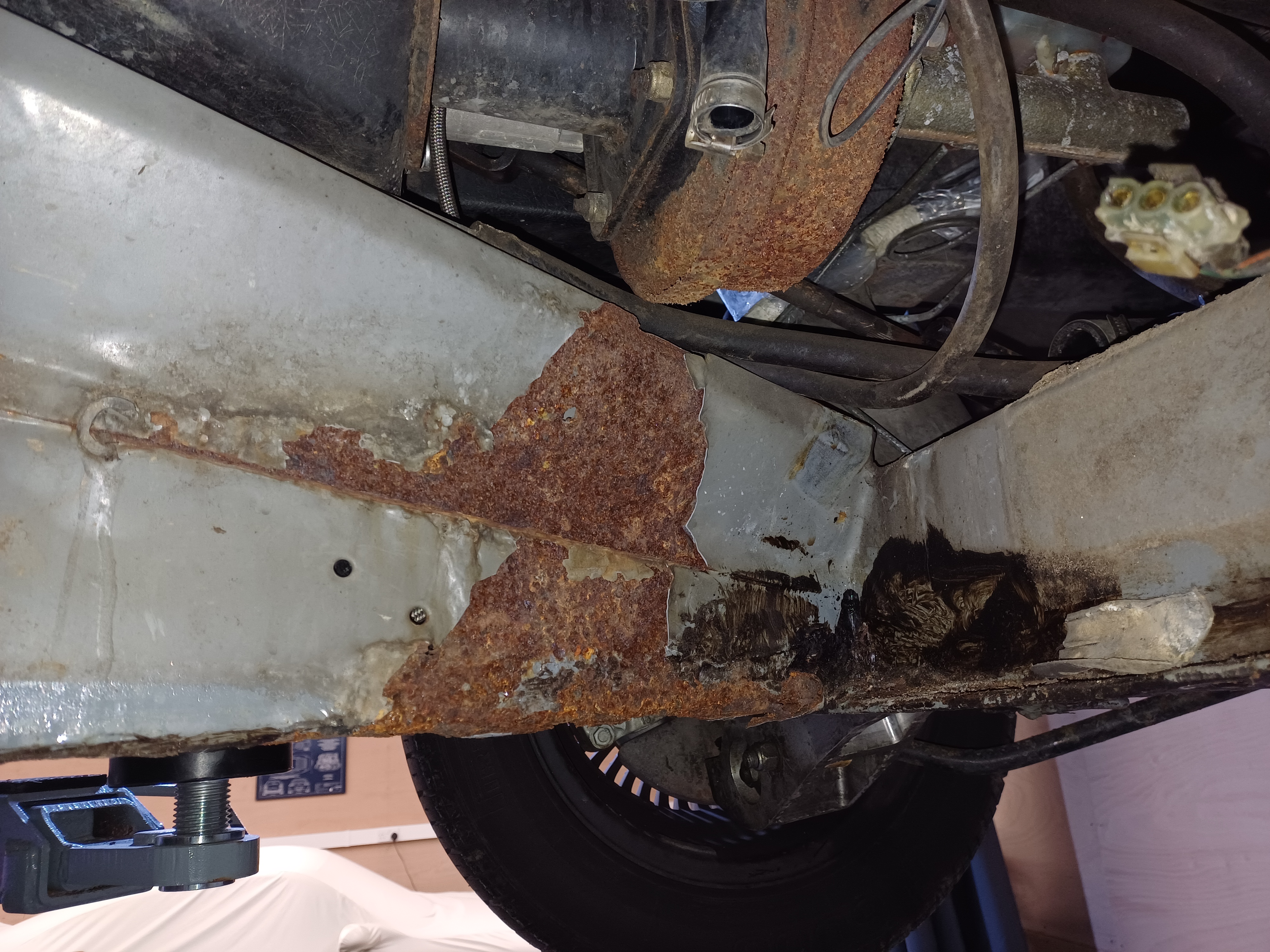

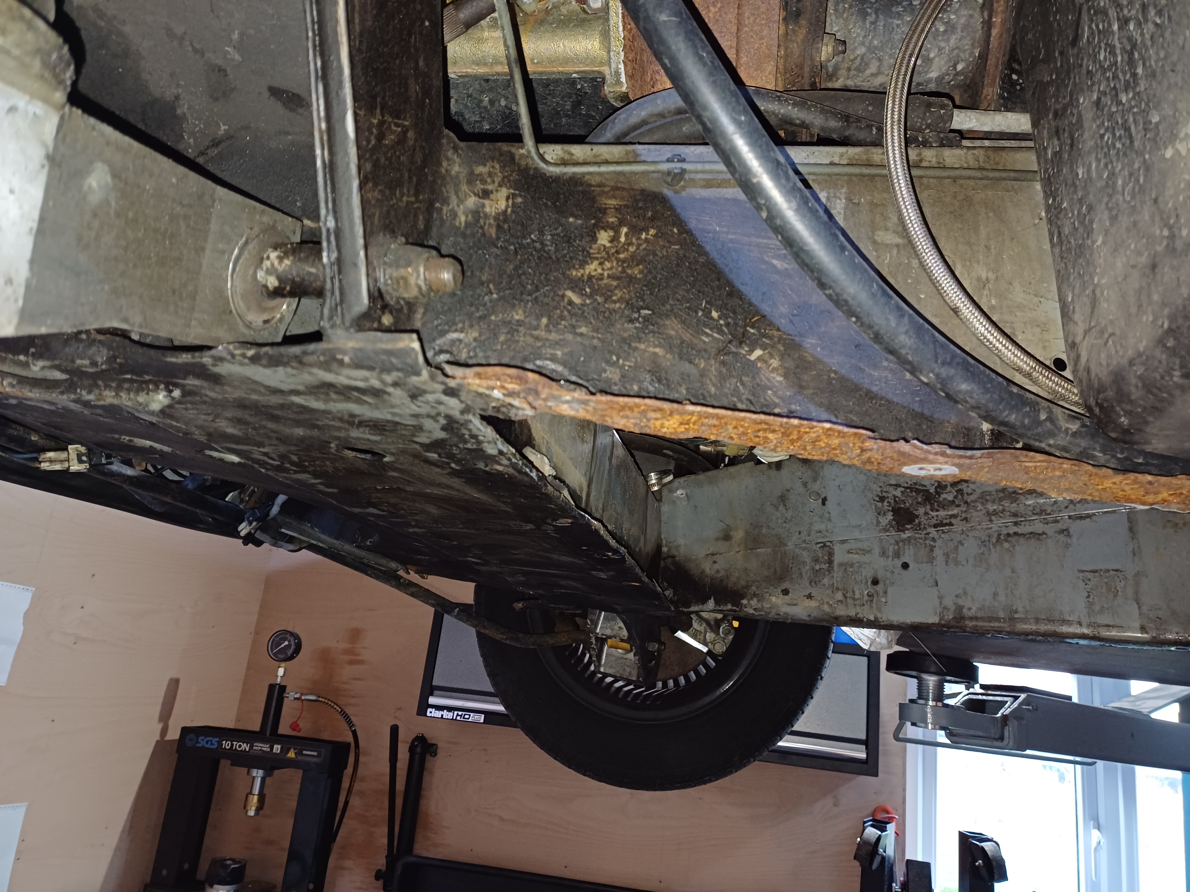

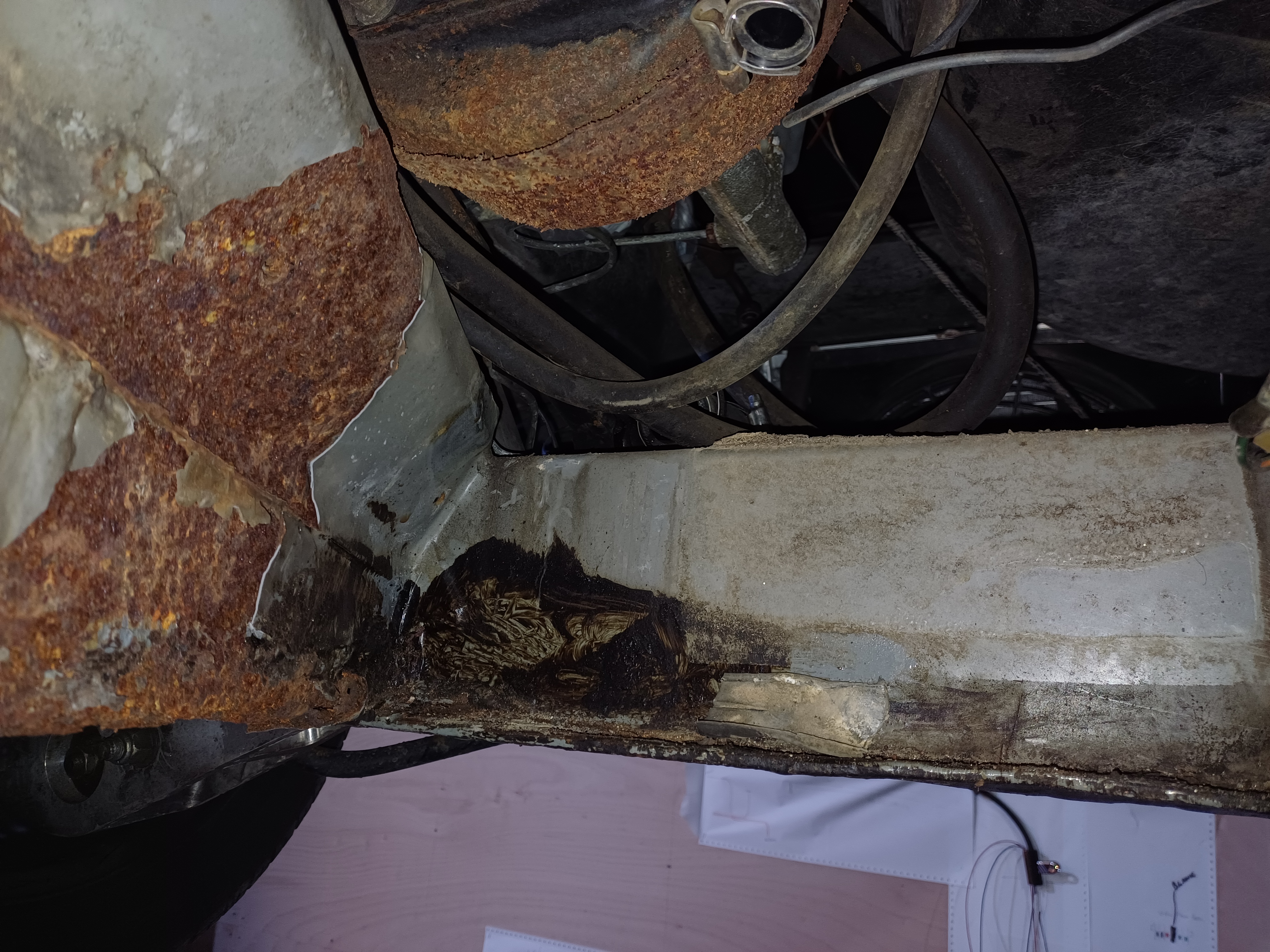

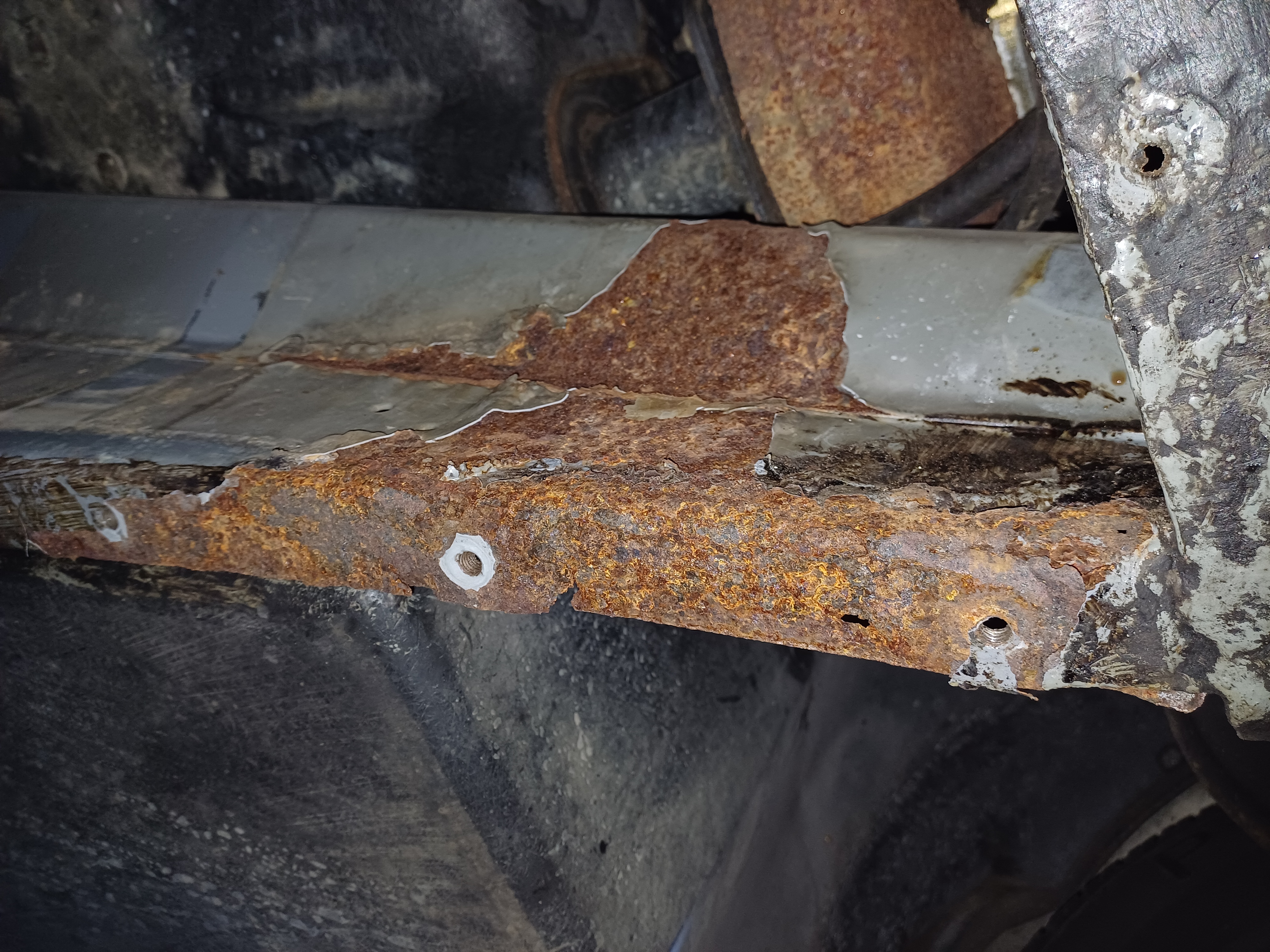

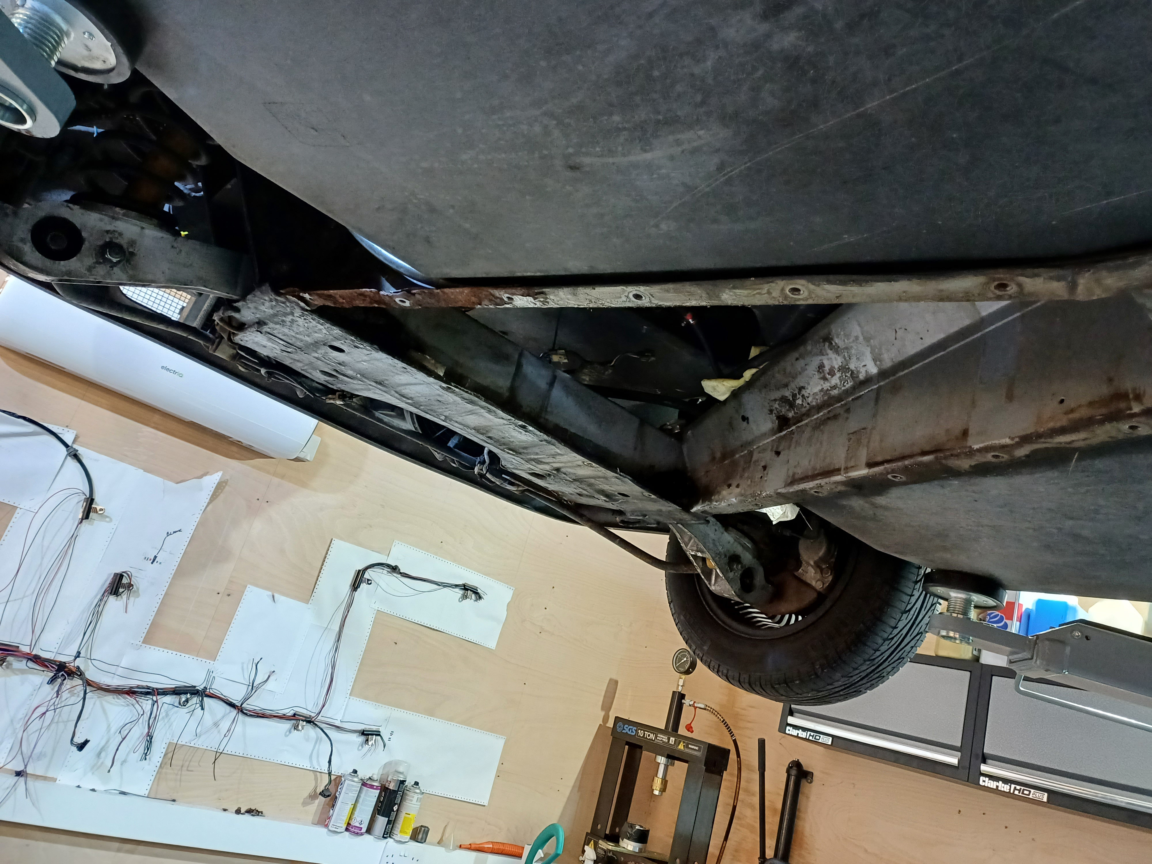

So after this, 1300 miles round Scotland in April/ May, I didnt touch it until I did another 900 miles to the Motherland and back in September. I knew there was likely a bit of welding needing done so I went to see a very special man who helped me out.
When I bought the car 2011 the epoxy was soft following a clutch master leak. I removed the tank closing plate, washed it down and got the PoR-15 on. It was ok for 12 years or so...
On the lift we dropped the fuel tank and got a look around. It wasn't entirely pretty, but wasn't awful either.
So definately a bit of cutting and gluing to be done, hopefully in the New Year. Welder man can take it, drive in-drive out, and I said I wanted it for March. Here's hoping

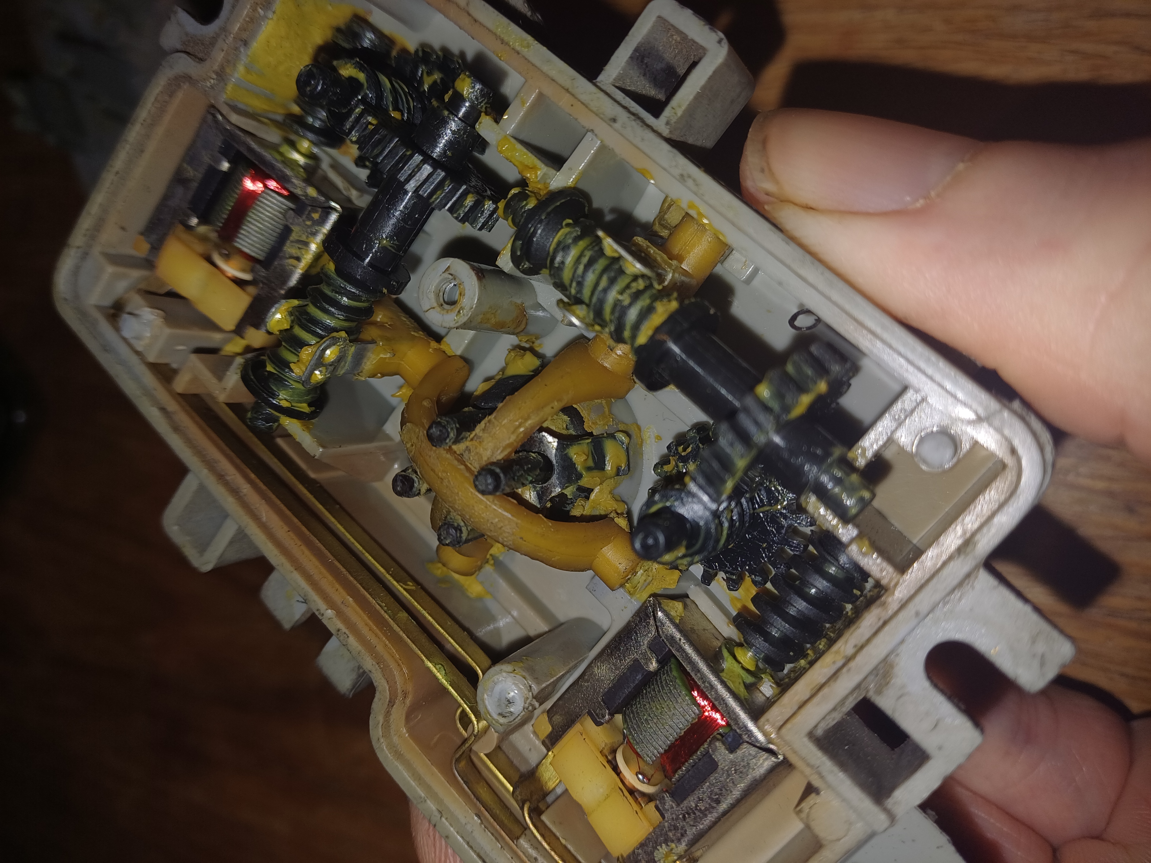

Finally, I battered the wingmirror off a tree stupidly.
The mirror glass was ok, but out of position, and no amount of fucking about would get it to move. In the absence of anything else I made the mistake of stripping out the mirror motor mechanism. Jesus Christ, its like lego technics, but with the complexity of the large hadron collider in there!
It didnt like getting a knock, and the mechanism behind the glass had come out of position. After a significant amount of pissing about (the Delorean factor), I got it back together. Hours I wont get back, but I think its ok, and seems functional. I am going to set the mirror and leave it, and pretend I cant hear the little rattle inside the motor box....
Small victory, for now anyway.

Postby Dan 6511 » Mon Dec 18, 2023 10:25 pm
That wiring loom on the wall looks interesting

Postby Spudmurphy » Wed Jan 31, 2024 2:56 pm
Interesting photo of the mirror mechanism. There doesn't seem much info on these, well, not that I can see.

Re: vin 814
Postby andyd » Fri Feb 02, 2024 8:46 am
Hi Spud,
Agreed, not a lot out there, but if you are careful they can be put back together... not fun tho, and requires a lot of care to keep everything in position.

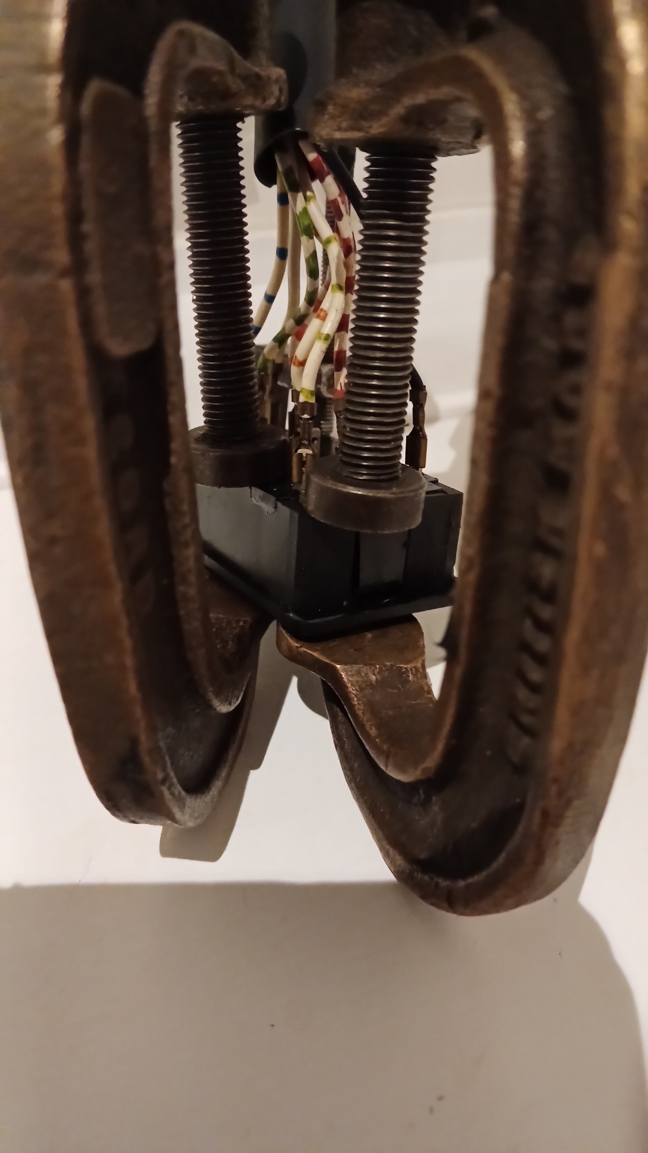

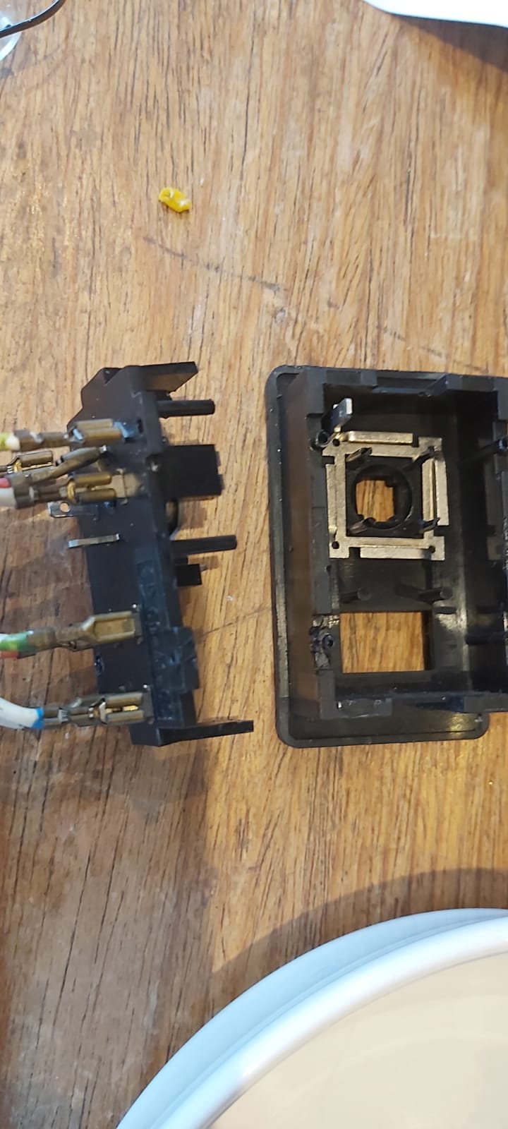

And I also recently had to so same to the mirror switch?! In a remarkable twist of fate!
The drivers door stopped opening from the in inside, traced to a broken rod clip.
When I had the door cards off, I checked and lubed the mechanisms, and took the opportunity to re-foam the cards. Ended up (of course, with the D-factor) being a bigger job than anticipated, requiring getting the needle and thread out (learning how to "back stitch "- who fucking knew?!) before fucking about with fibreglass resin before the glue. Cunts.

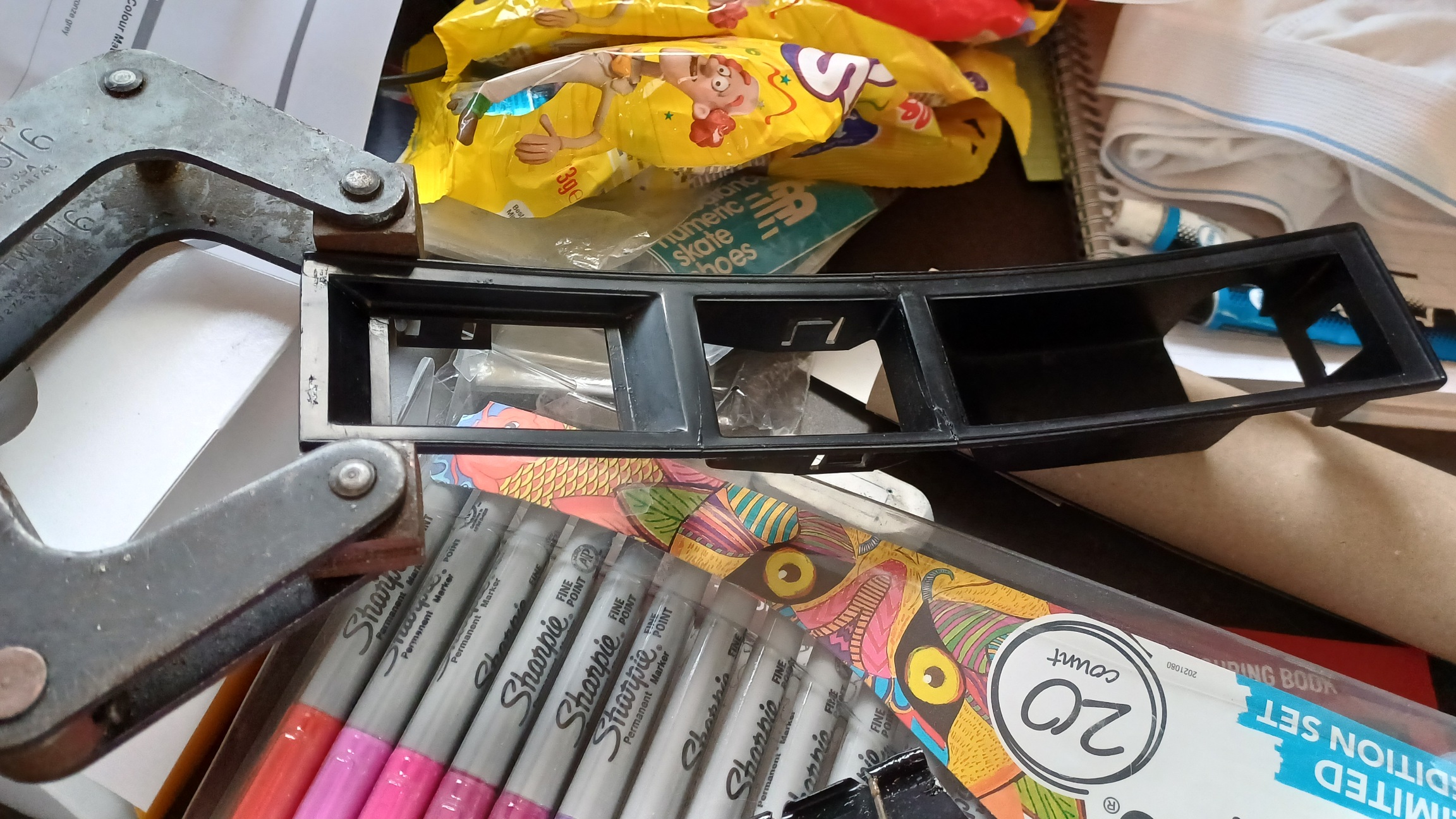

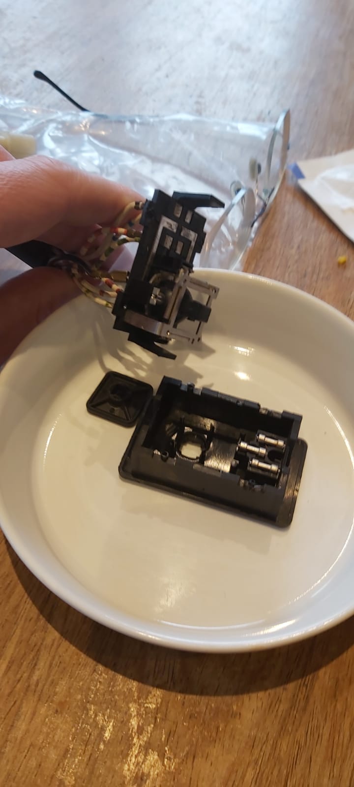

Anyway, removing the mirror switch separated the casing... balls and springs.... yep.
So I found the springs, and got 1/8" stsinless ball bearings from ebay.
I fired a good number of balls across the kitchen before getting it back together. Then a little araldite and some G clamps for overkill to let it set
Re: vin 814
Postby andyd » Fri Feb 02, 2024 8:53 am
Then, of course, one turns the attention to the brittle and previously repaired escutcheons.
More overkill
But, remarkably the switch works. And the mirror works.
