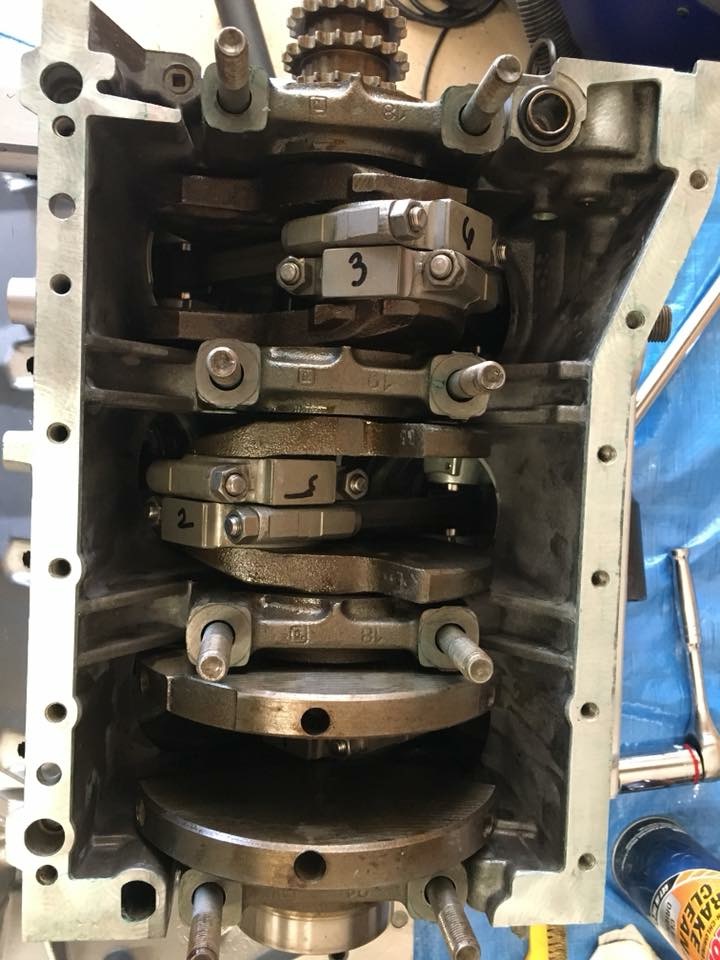

Postby gruffalo » Thu Apr 12, 2018 11:44 am
Any of these holes?
gruffalo
Posts: 256
Location: Norway
VIN #: 5063
Re: Vin 5063
Postby Admin-bloke » Thu Apr 12, 2018 12:08 pm
Follow the engine part in the manual if you've got a copy. The hole is in the crank that would be underneath the access hole that is within the V part of the engine underneath the water pump

Postby gruffalo » Thu Apr 12, 2018 10:02 pm
That’s the hole I’m using. There’s a round, drilled hole in the crank counterweight similar to the ones visible in my last photo. When this hole appears when peeping through the hole, the number one piston is past tdc.
I swear. I have double and triple checked.
