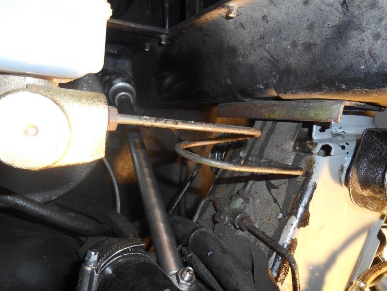

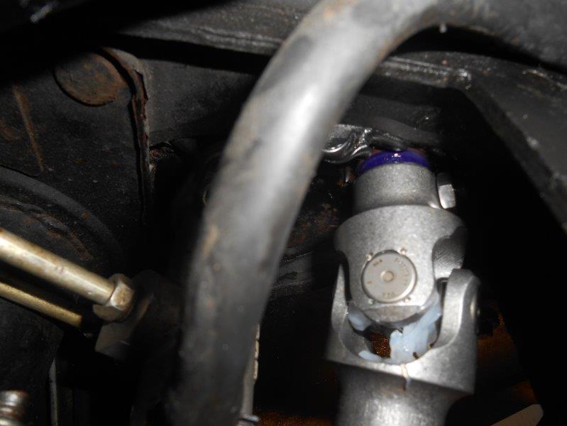

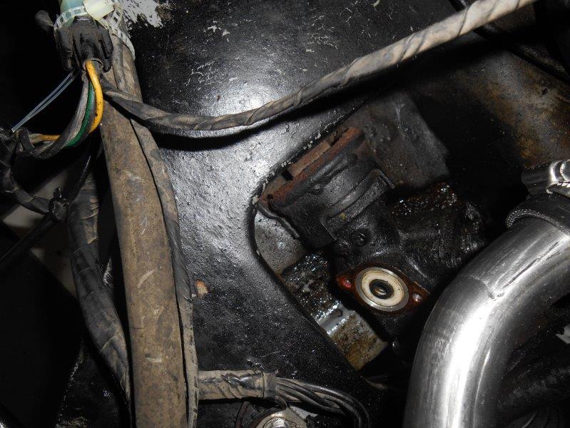

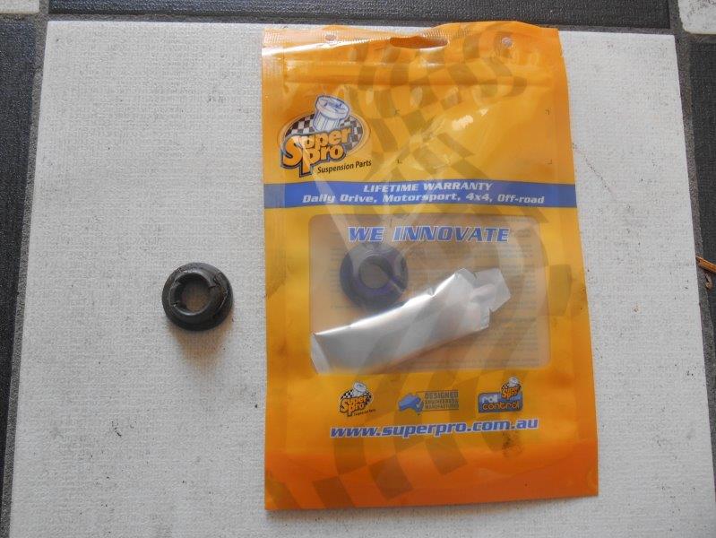

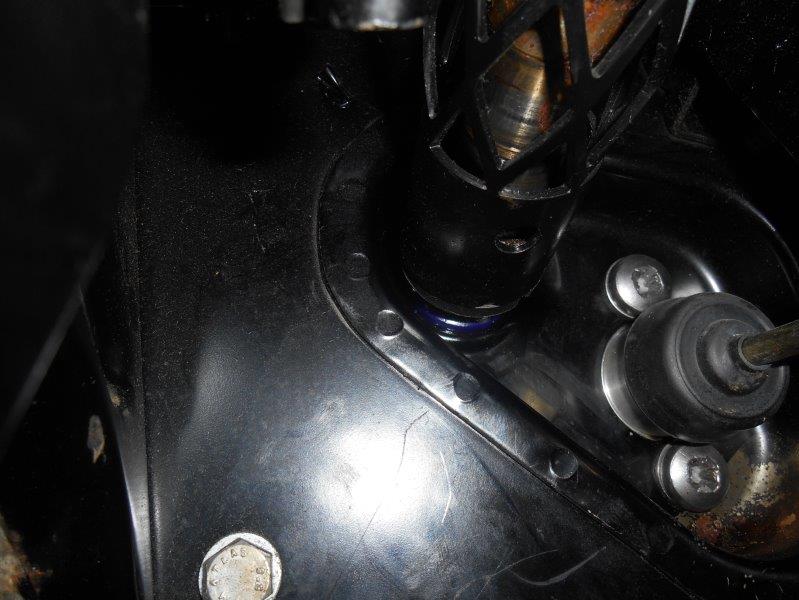

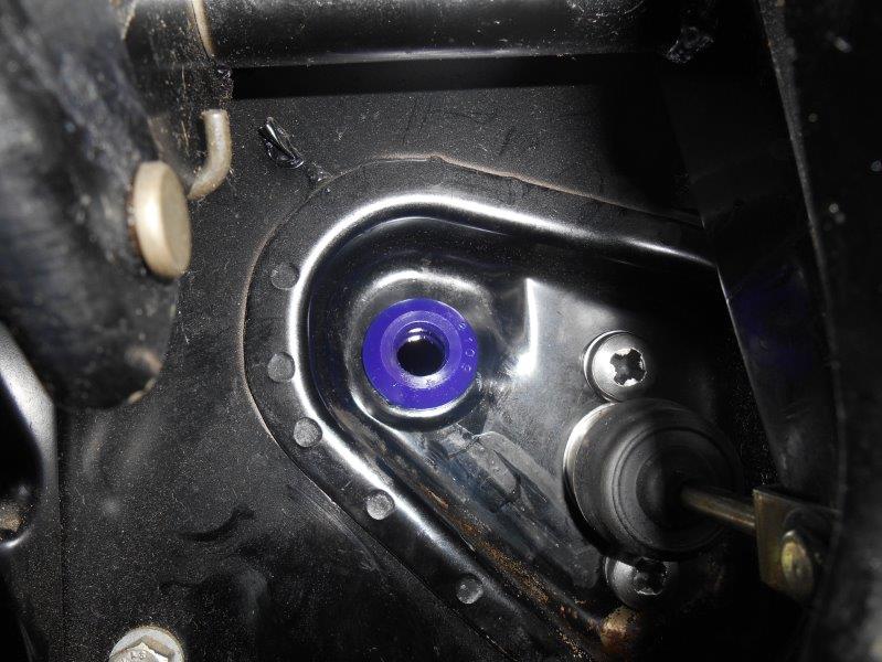

Domi, no need to remove steering wheel, undo the steering adjustment (up/down, in out).
And then push the shaft from the trunk area inside the firewall (towards rear of the car). When it goes true the wall, you can push the collum up or down, this gives you room to replace the bushing. Don't cut the bushing, no need for it.
Then slide the shaft back true the new bushing. Make sure the shaft slides easy in and out of the collum, lubricate well, also lube the new bushing. I used the bushing from the club, the blue one. Drop it in hot water before instalation.
Good luck.

Postby Domi » Sun Feb 12, 2017 8:07 pm
Thanks for the good advice :)
I also have the blue poly from the club ;)

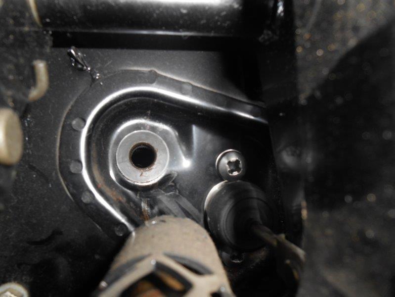

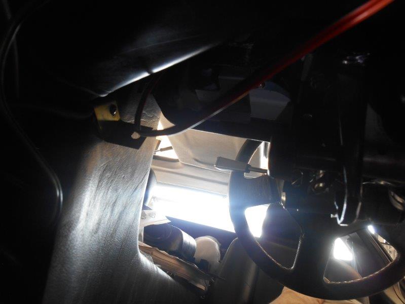

Postby Domi » Sat Feb 18, 2017 6:28 pm
New bushing and steering today

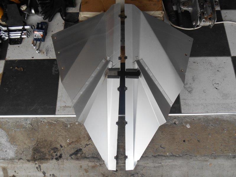

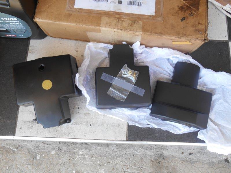

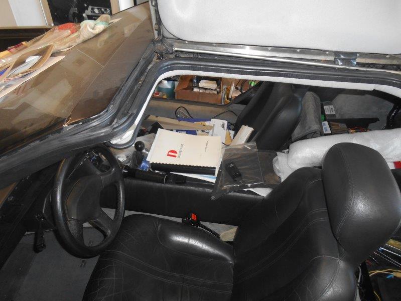

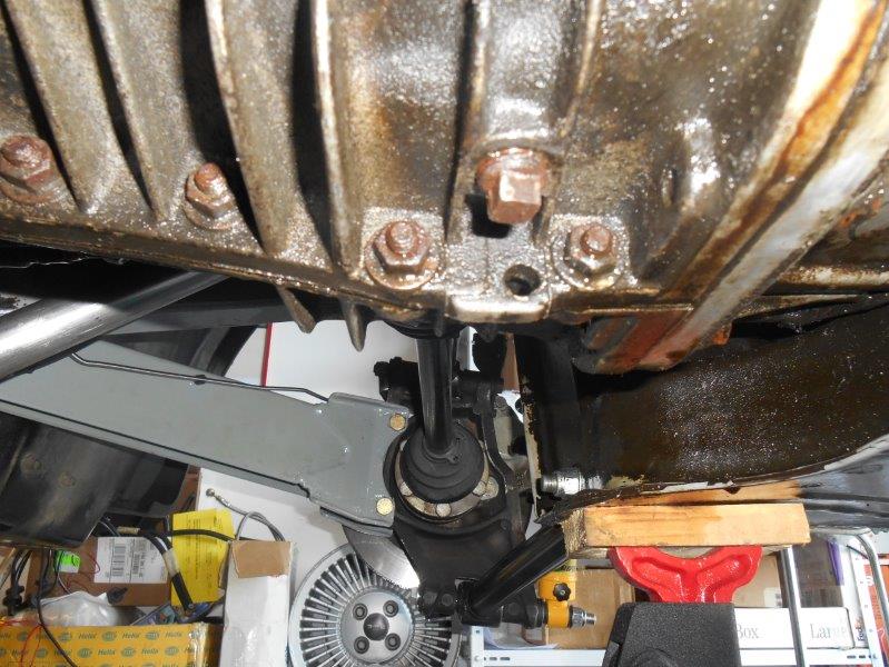

Postby Domi » Sun Feb 19, 2017 5:58 pm
New canopy
New oil
Can’t remove this bold for now…
Both plate are cleaned up
Postby A Van » Mon Feb 20, 2017 12:17 am
Where did you find the canopy
Postby CDNeal » Mon Feb 20, 2017 8:01 am
Can have your old one. Please
CDNeal
Posts: 4
Joined: Mon Dec 12, 2016 9:45 am
VIN #: 5550
Postby Domi » Mon Feb 20, 2017 7:20 pm
A Van wrote:Where did you find the canopy
I bought it on the "delorean car show" web site, back in... 2009
CDNeal wrote:Can have your old one. Please
The old one is a little bit broken and have holes for a remote control.
I'm sorry but I prefer to keep it, just in case.
Postby CDNeal » Tue Feb 21, 2017 7:58 am
The lower half of mine is missing, so if any one has a lower half in any condition can you let me know. But I do under stand if you prefer to keep your old one, you never know if you will need it.

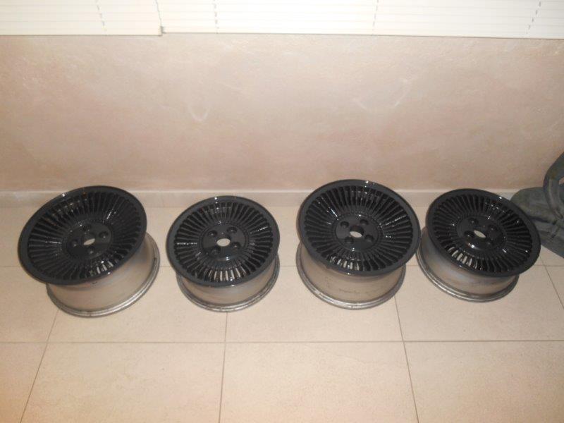

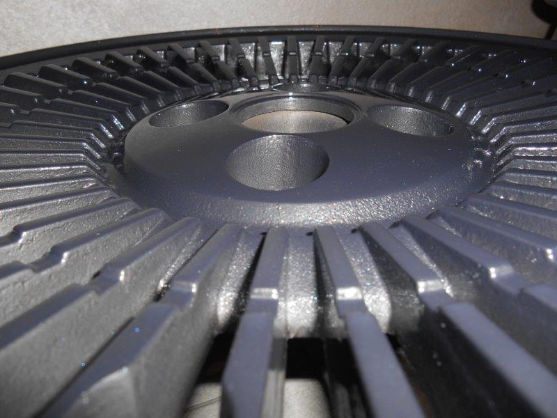

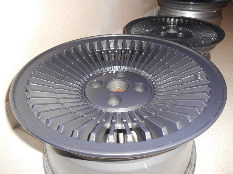

Postby Domi » Fri Mar 03, 2017 9:53 pm
My wheels are back from the guy whom restored them.
I'm very happy with the color, unfortunately, it's only the front of the wheel.
He didn't painted the interior and exterior of the wheels.
Here are a few pic, I will take another shot in the daylight, because it look different.
Postby MikeWard » Sat Mar 04, 2017 12:27 pm
:shock: what did he paint them with, rattle cans?
