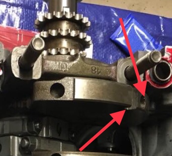

The notch (bottom arrow) or the round hole (top arrow)?
8mm bolt dropping into where?

And is the woodruff key somehow aligned with the #1 crank?

Postby gruffalo » Mon Apr 16, 2018 9:20 pm
Bottom arrow, I finally figured it out :)

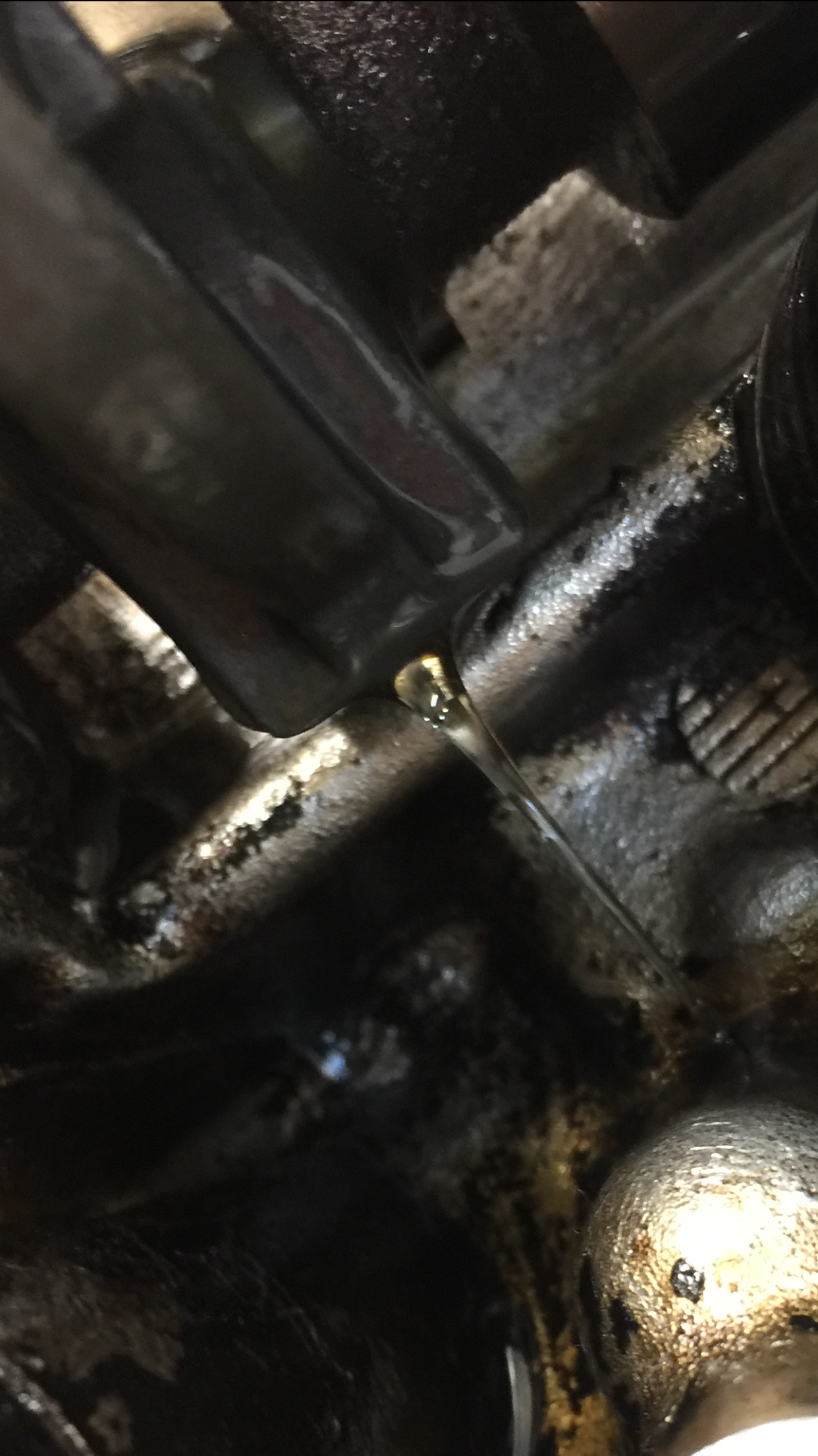

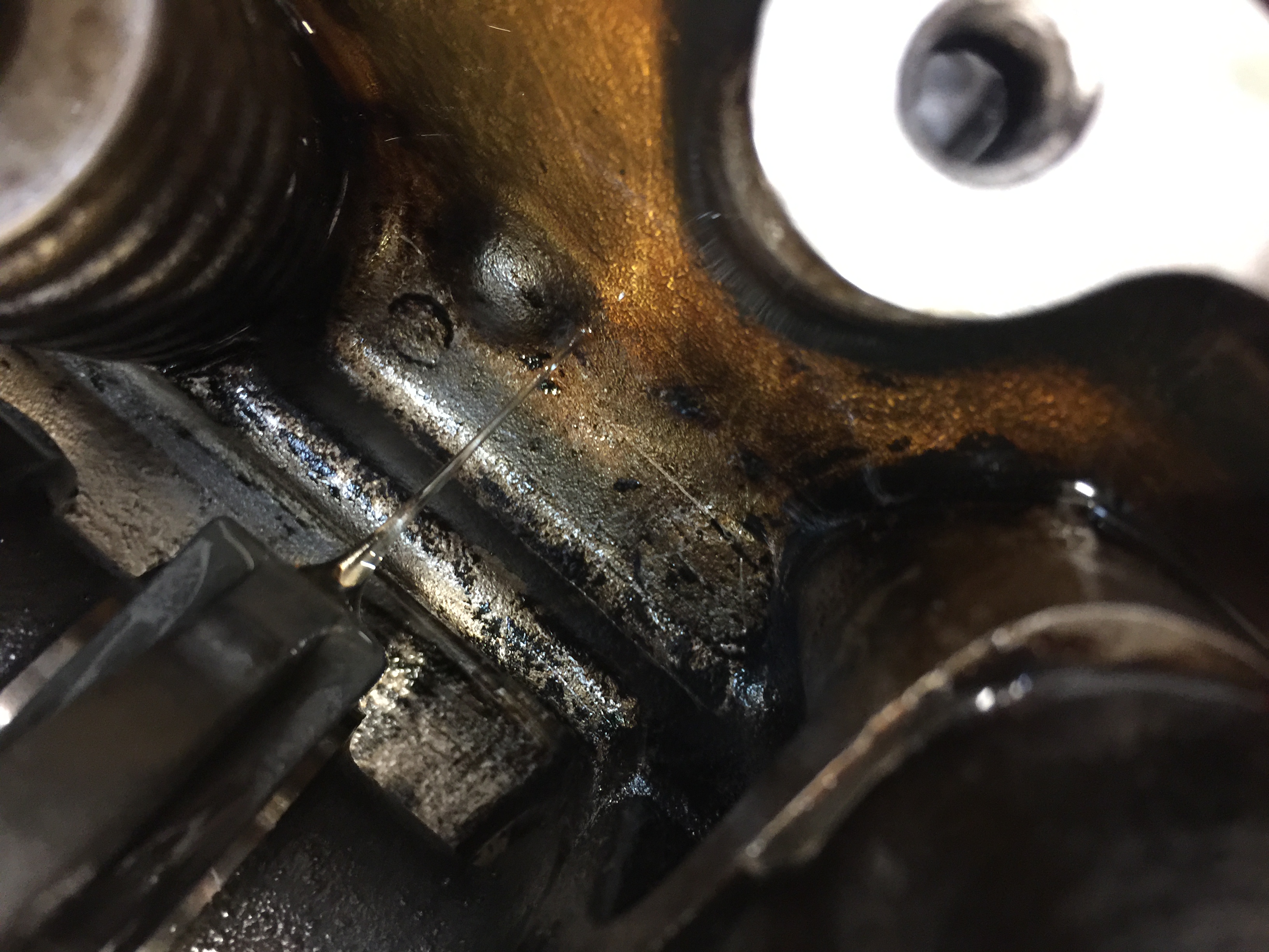

Today I did something interesting! I’ve been sorta paranoid about the oiling system not working properly. Seeing the cam wear, reading horror stories and listening to people talking down the prv got to me. So I decided I wanted to verify the function of the oiling system.
So I installed the oil pan, filter, pressure sensors and filled the sump with 4 liters of oil.
Then I started to crank the oil pump by hand. (Chain not fitted) This was very interesting and exciting!
After about 15 sec oil reached the pump, and it got a lot heavier. Next oil started pouring over the chains. A lot. At first it seemed excessive. But I kept it up, and it got even heavier at it reached the rocker shafts (which are pipes, really). And in the end I could see oil seeping out of each rocker . Hooray!!!!!
Now I can close the timing cover with peace of mind.
