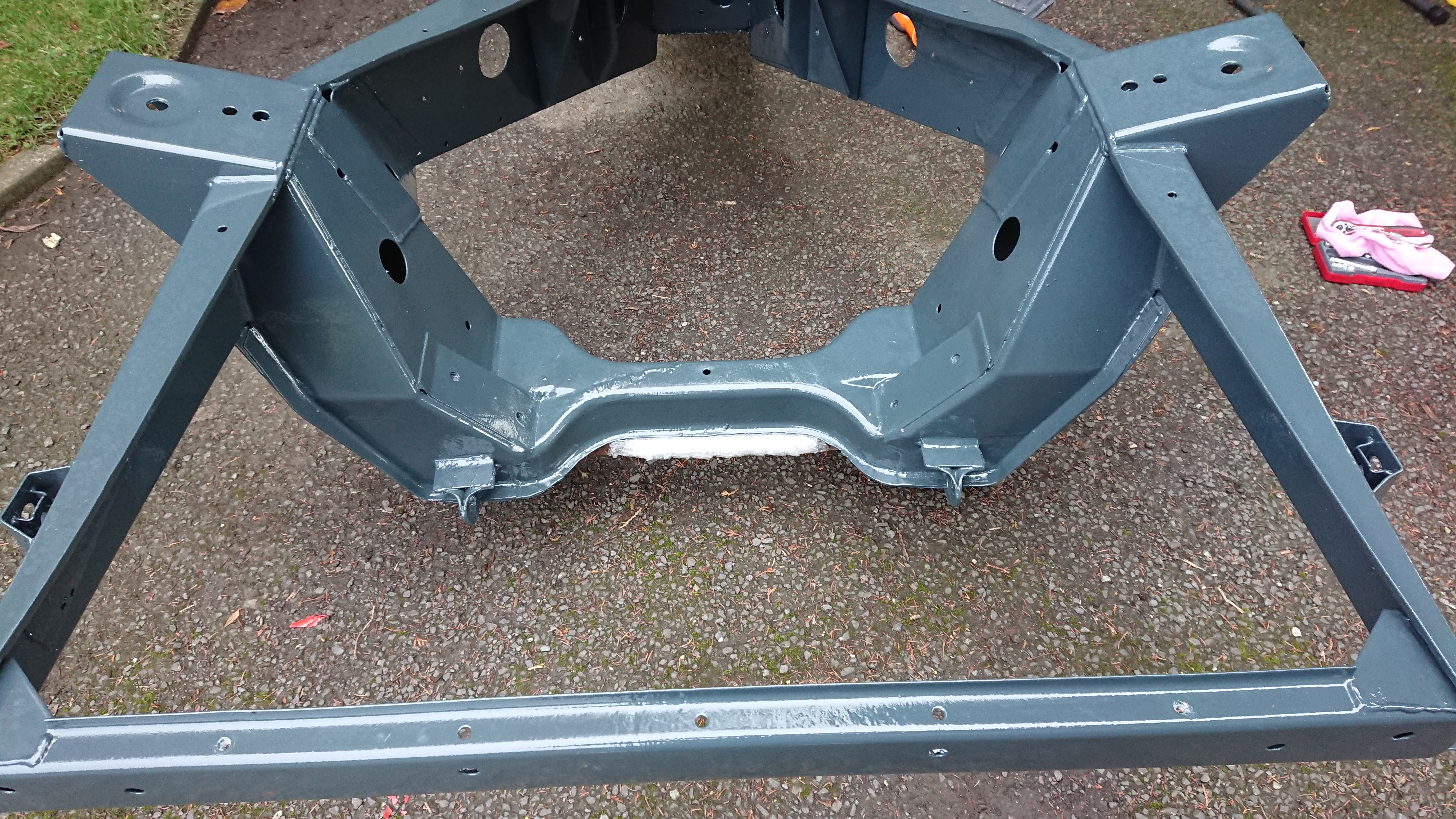

Postby cis6409 » Thu Dec 02, 2021 9:16 pm

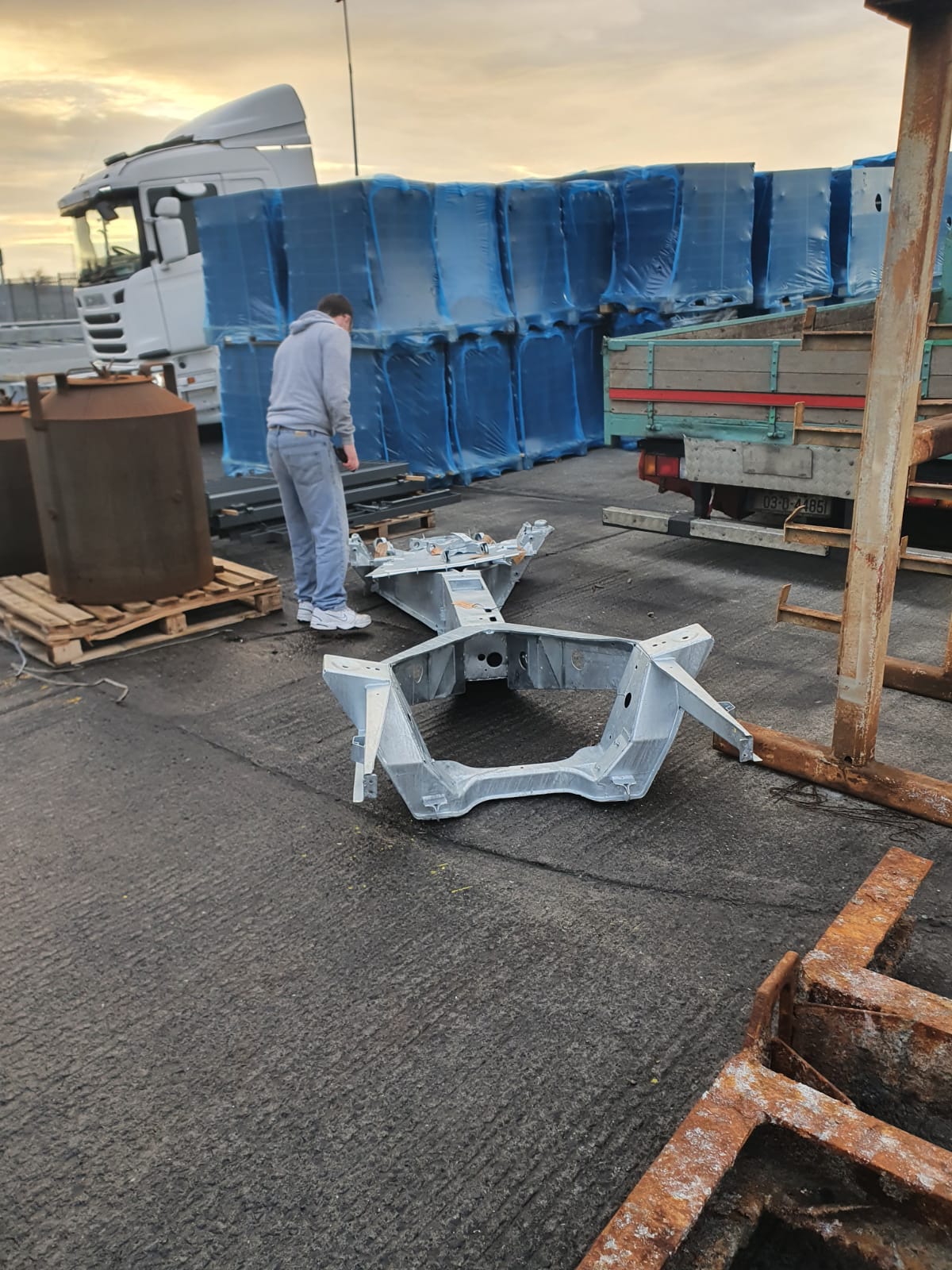

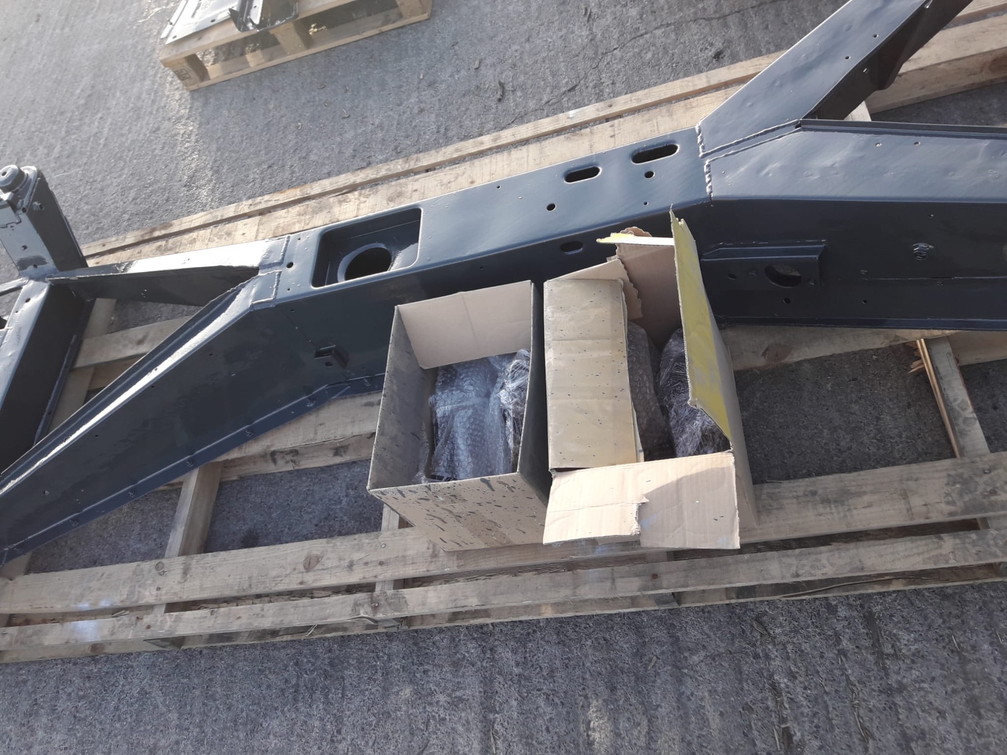

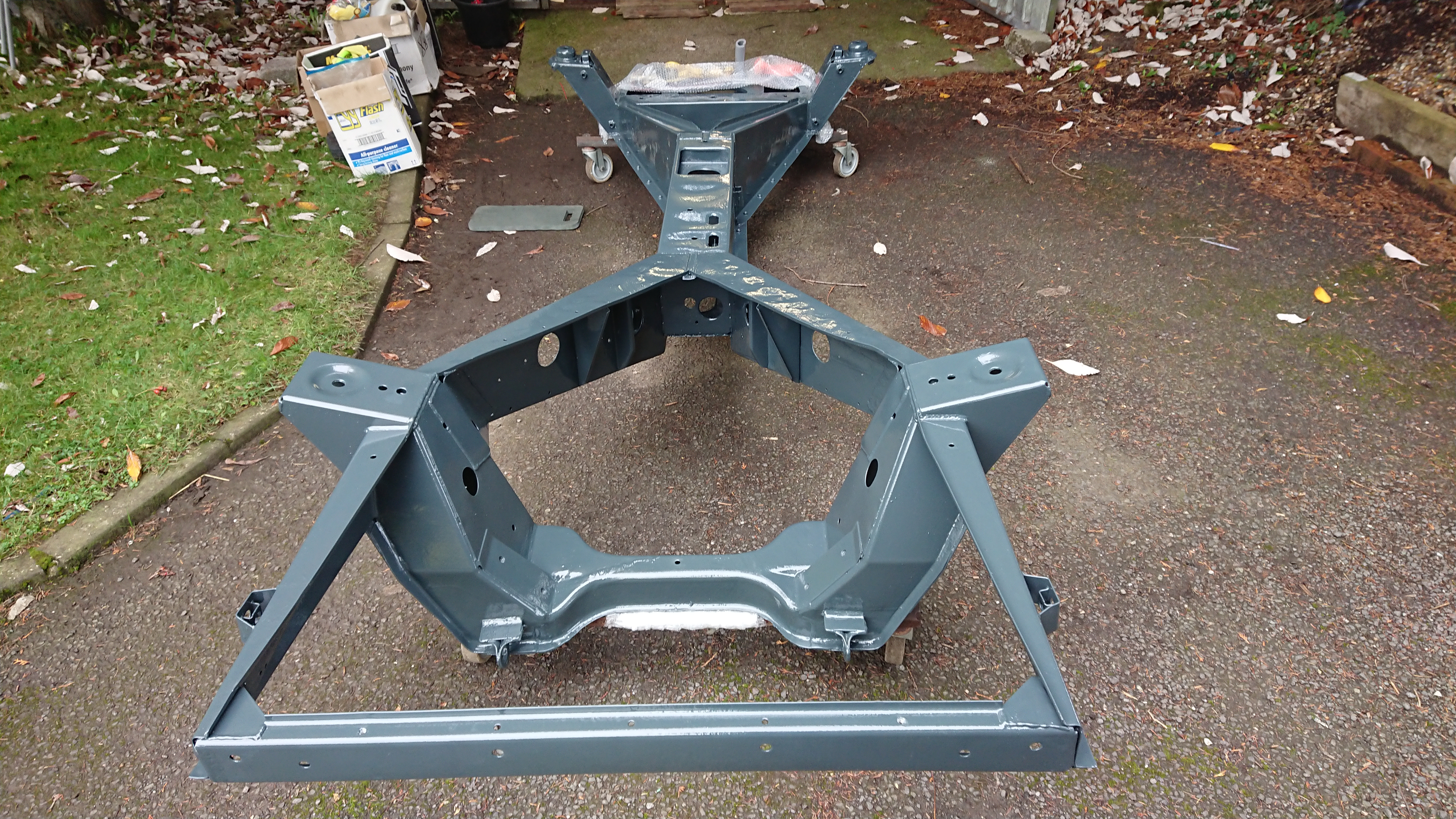

The chassis was finally ready to go to paint.
I used sacrifical bolts to plug the threads and gave it a clean and degrease to make sure the residue from the re tapping etc was removed.

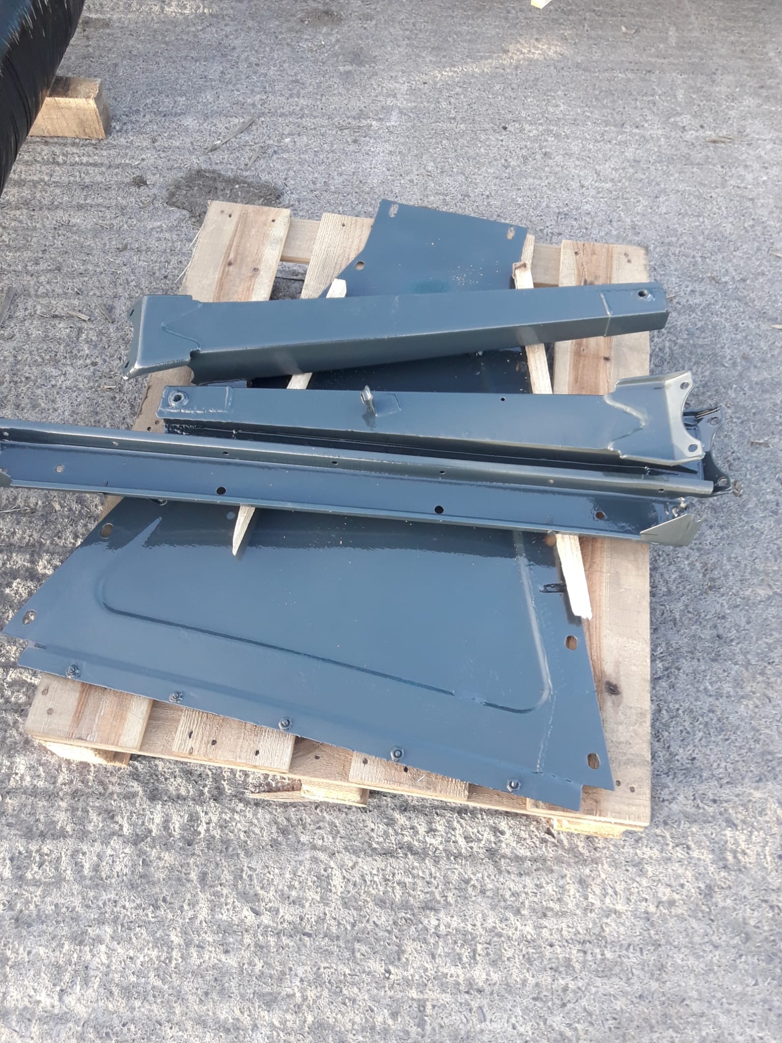

Re: Vin6409 engine rebuild

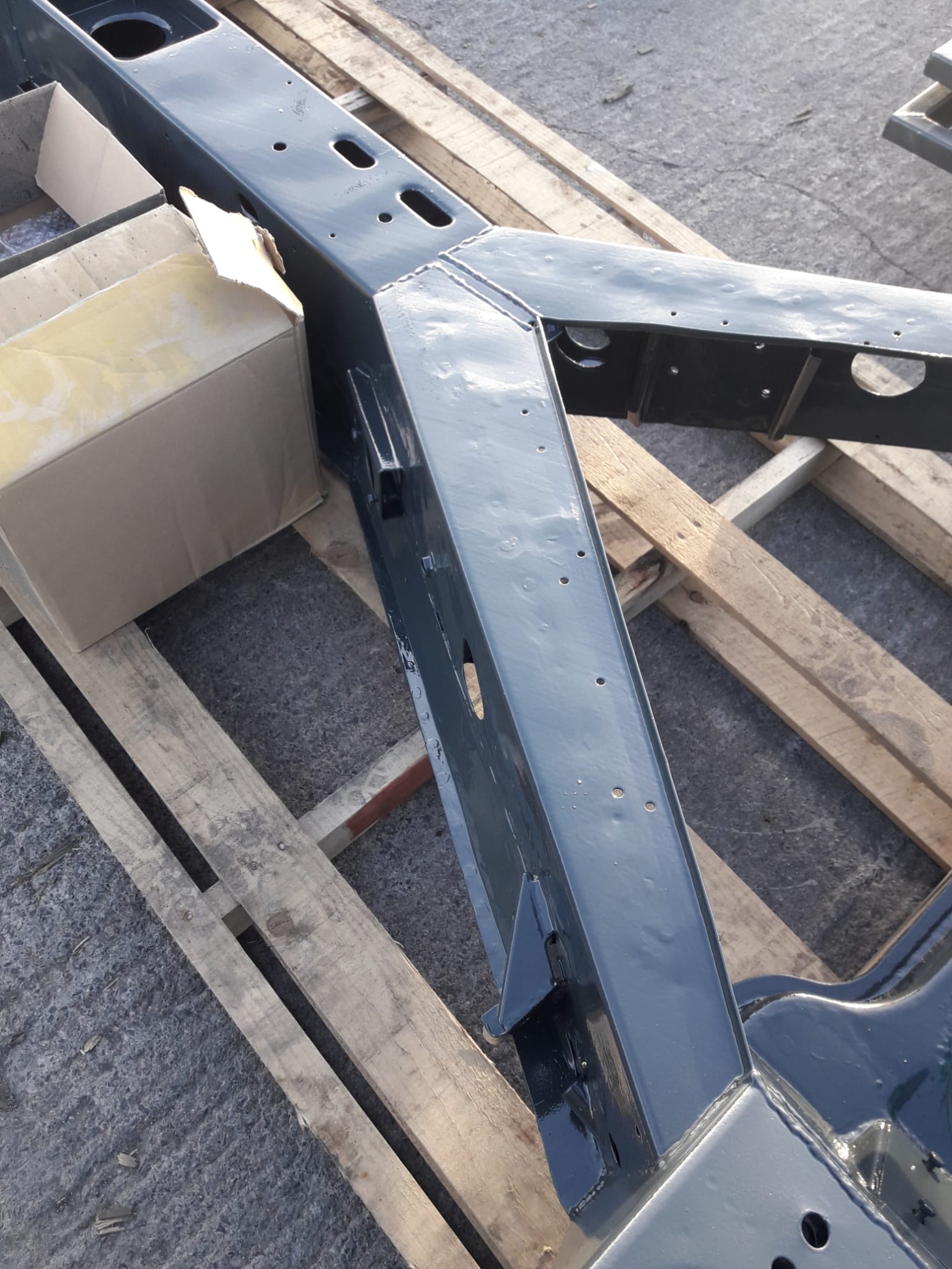

Postby cis6409 » Thu Dec 02, 2021 9:25 pm

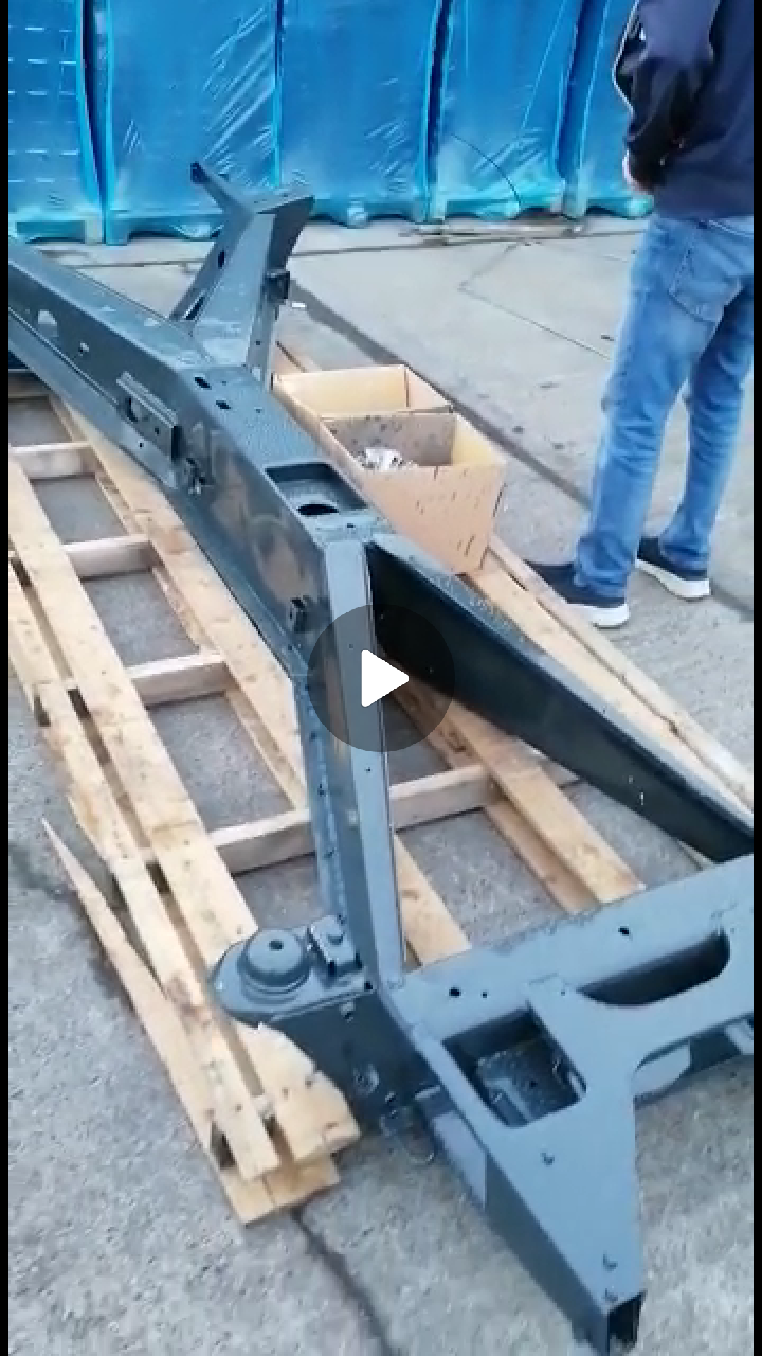

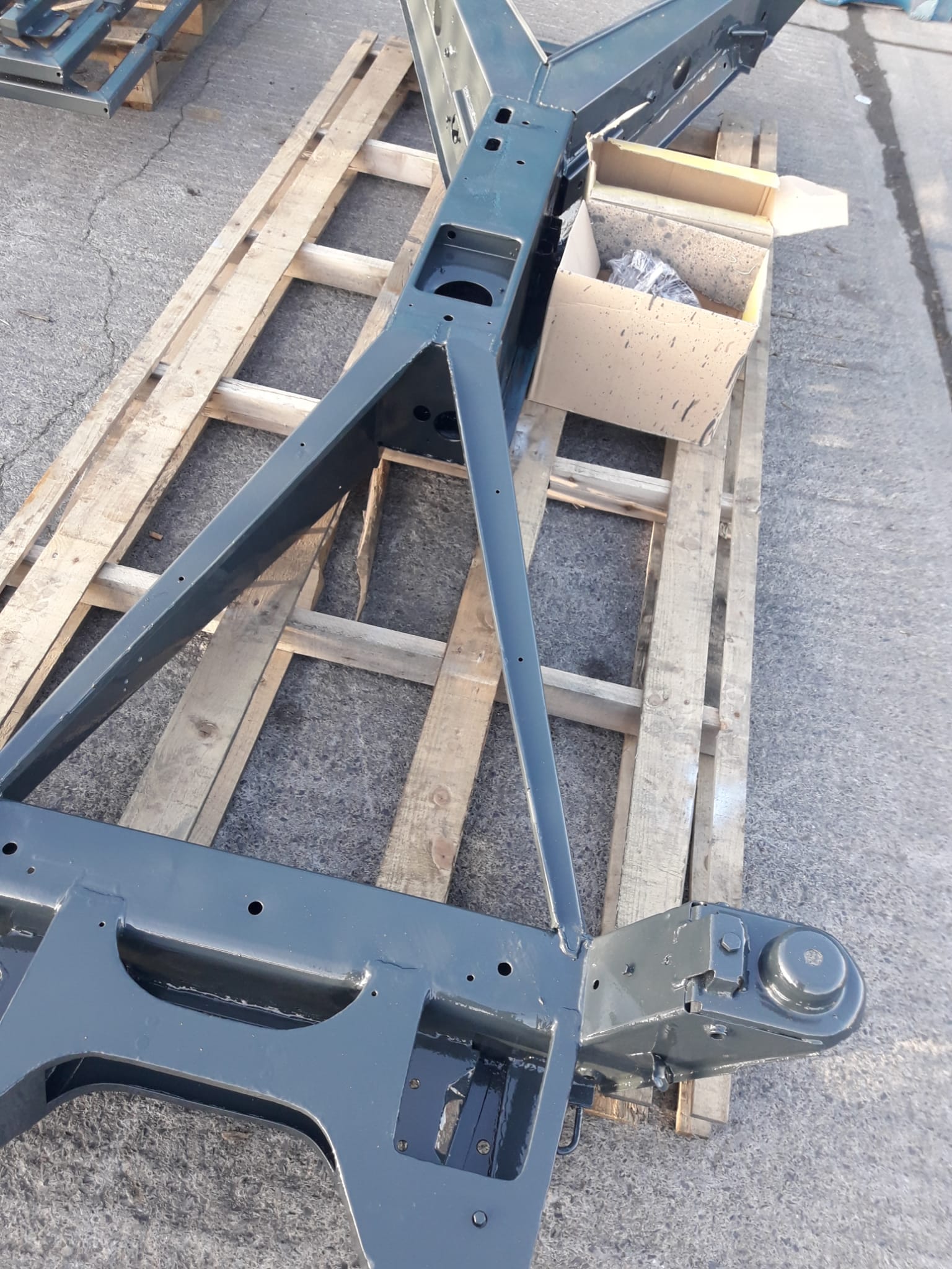

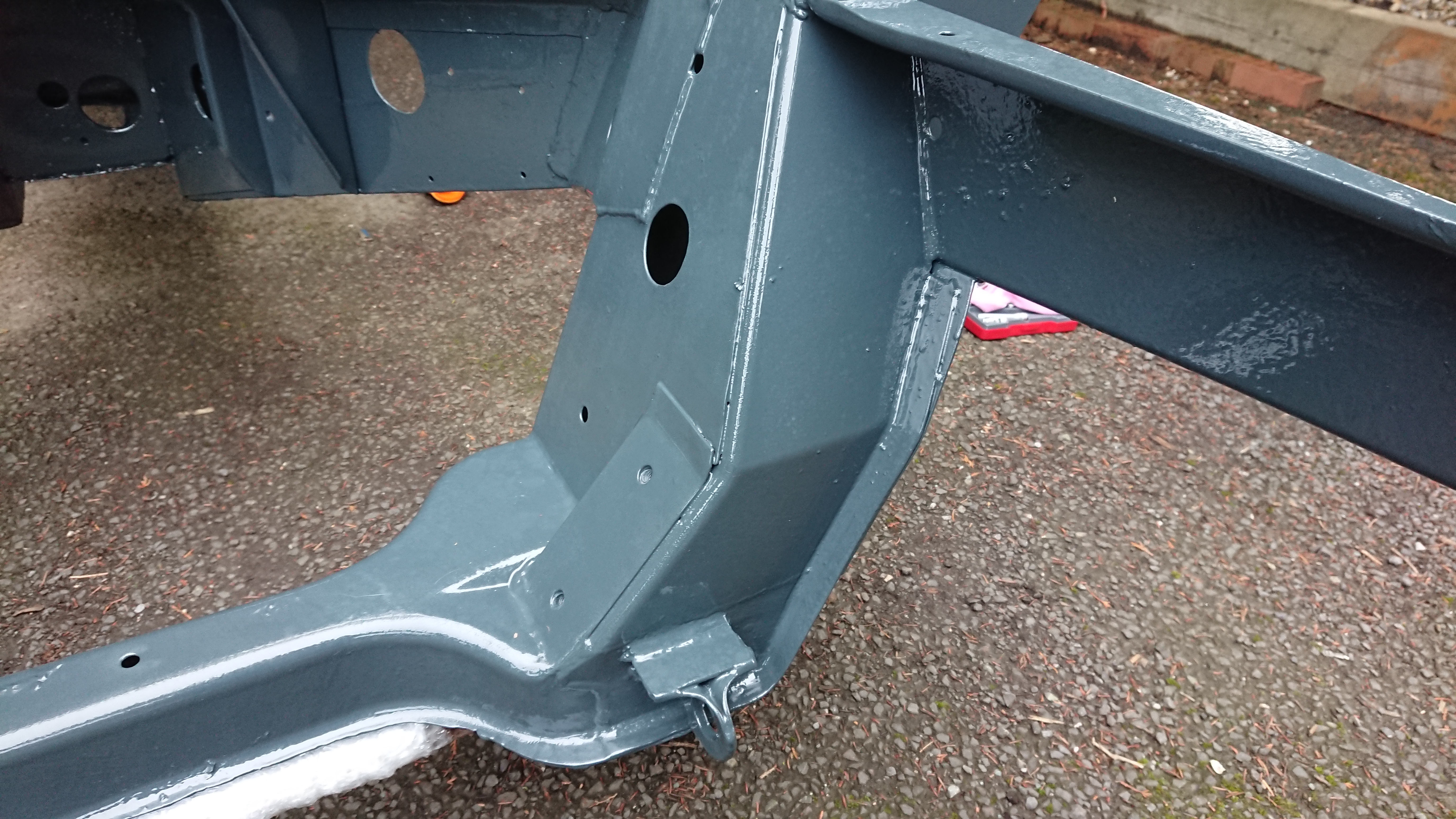

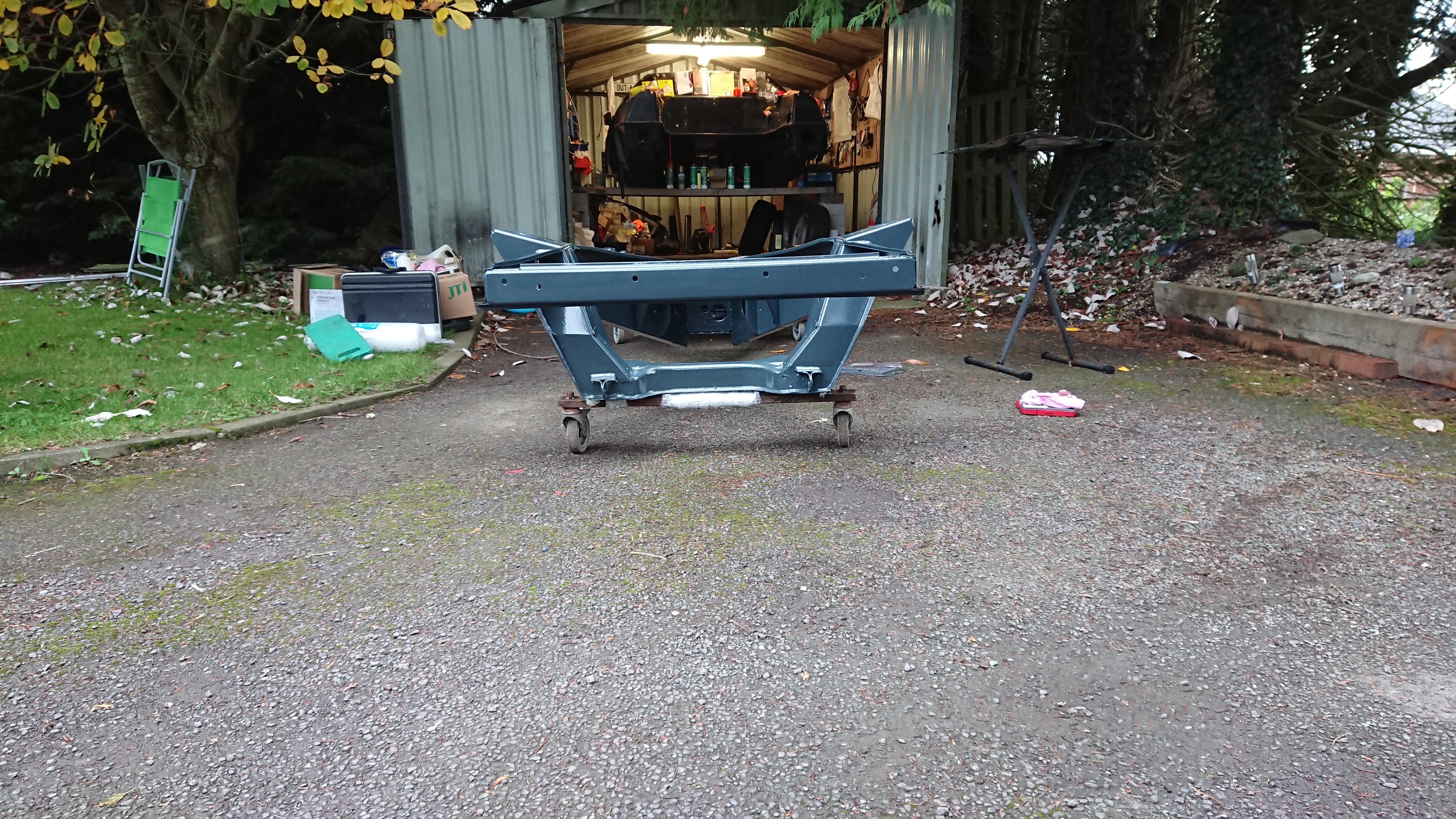

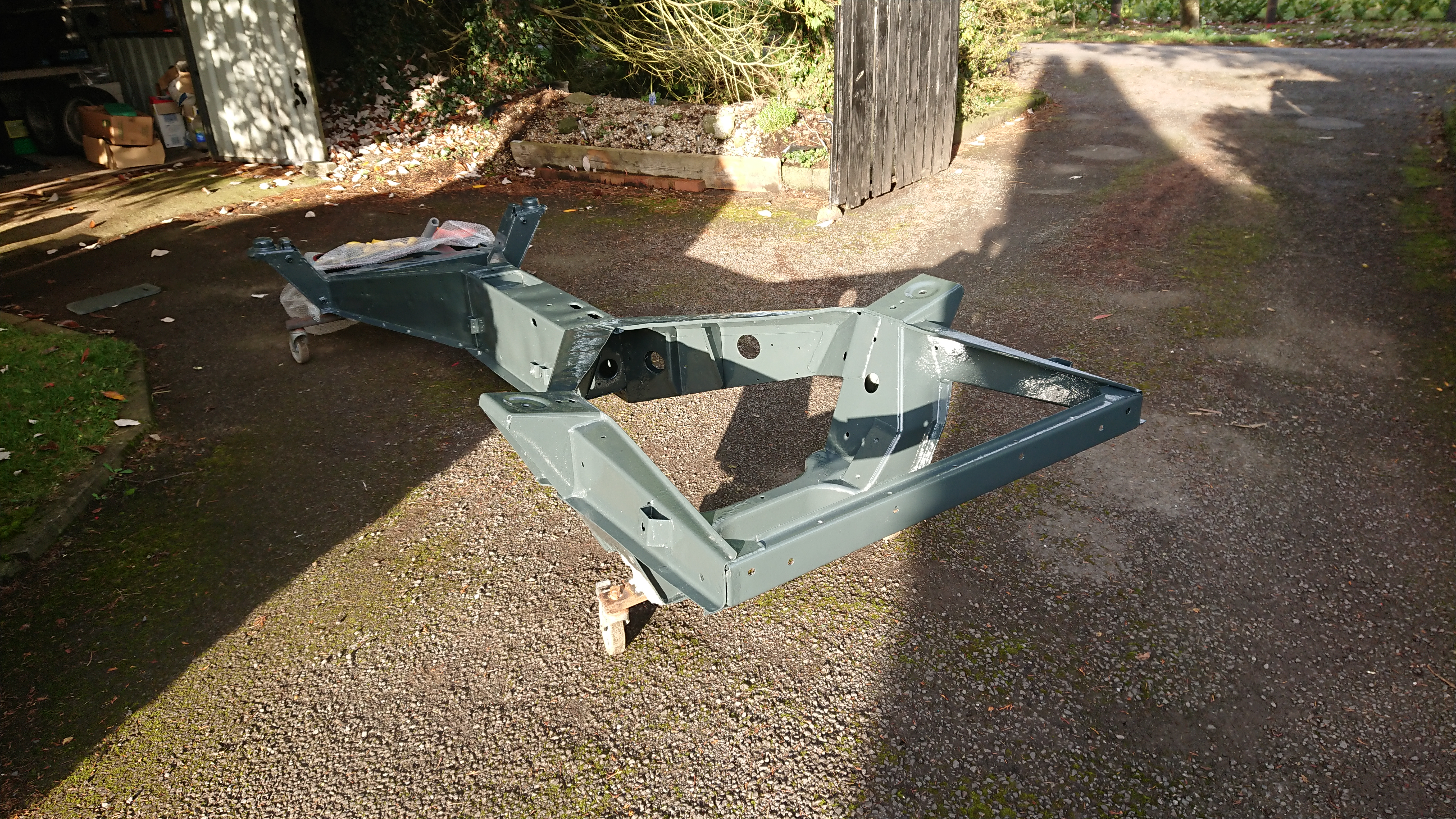

I got the call totell me the painting was done and it ws ready to collect.
Exciting and nervous times to say the least wondering how it would turn out with the colour we chose but have to say myself and Ian are very happy with it over all. :)
First pics of it when collecting it

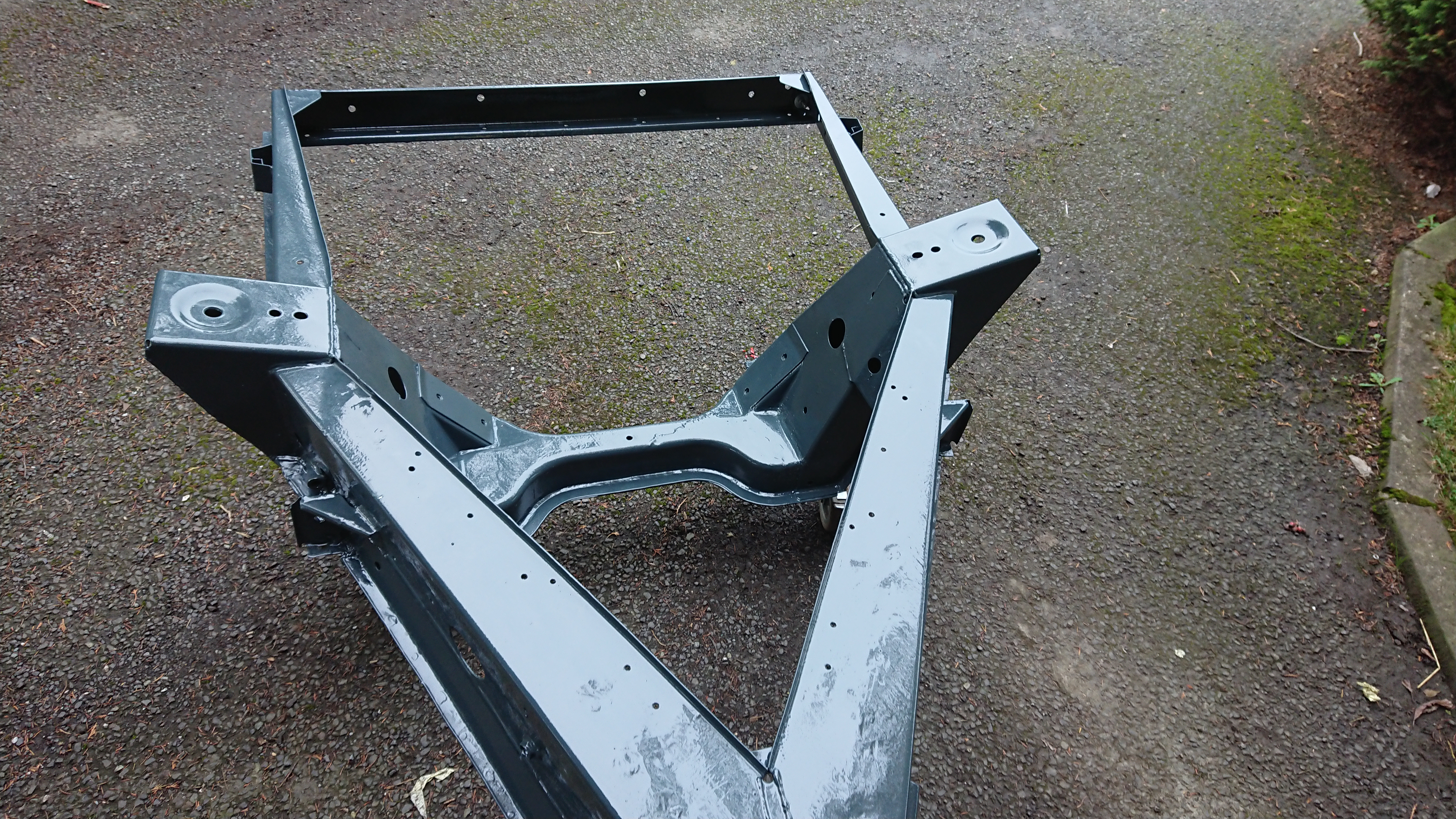

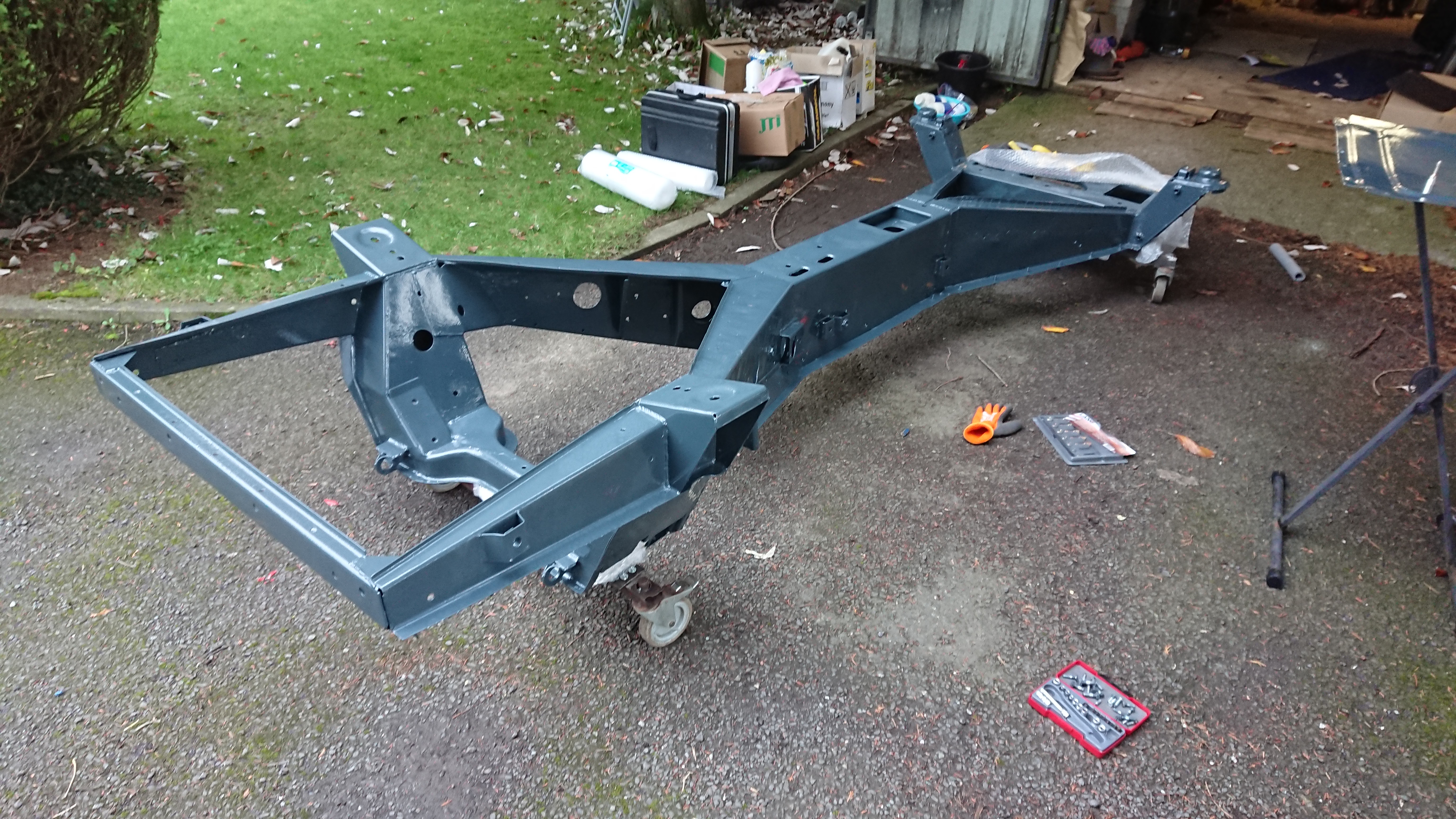

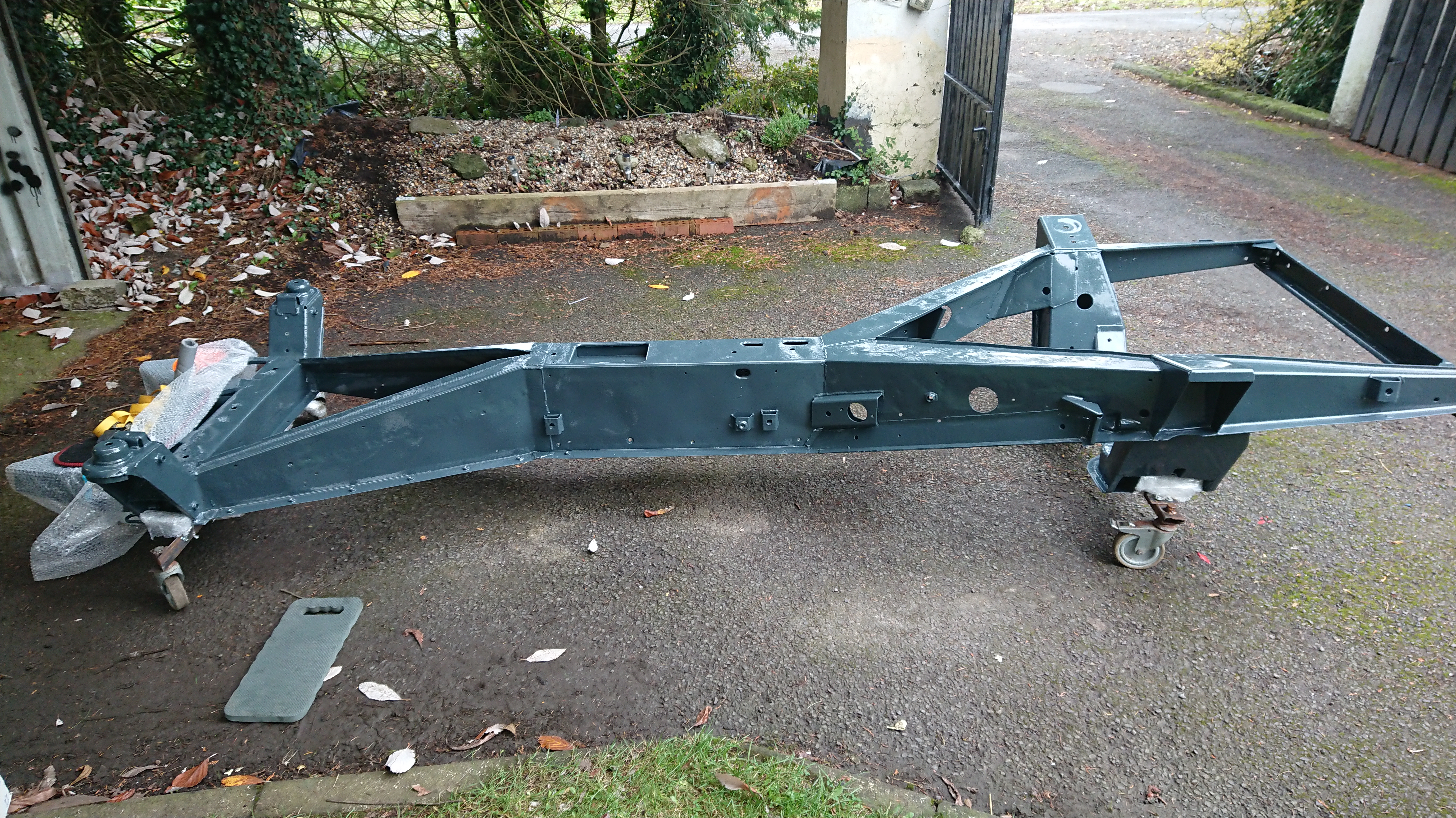

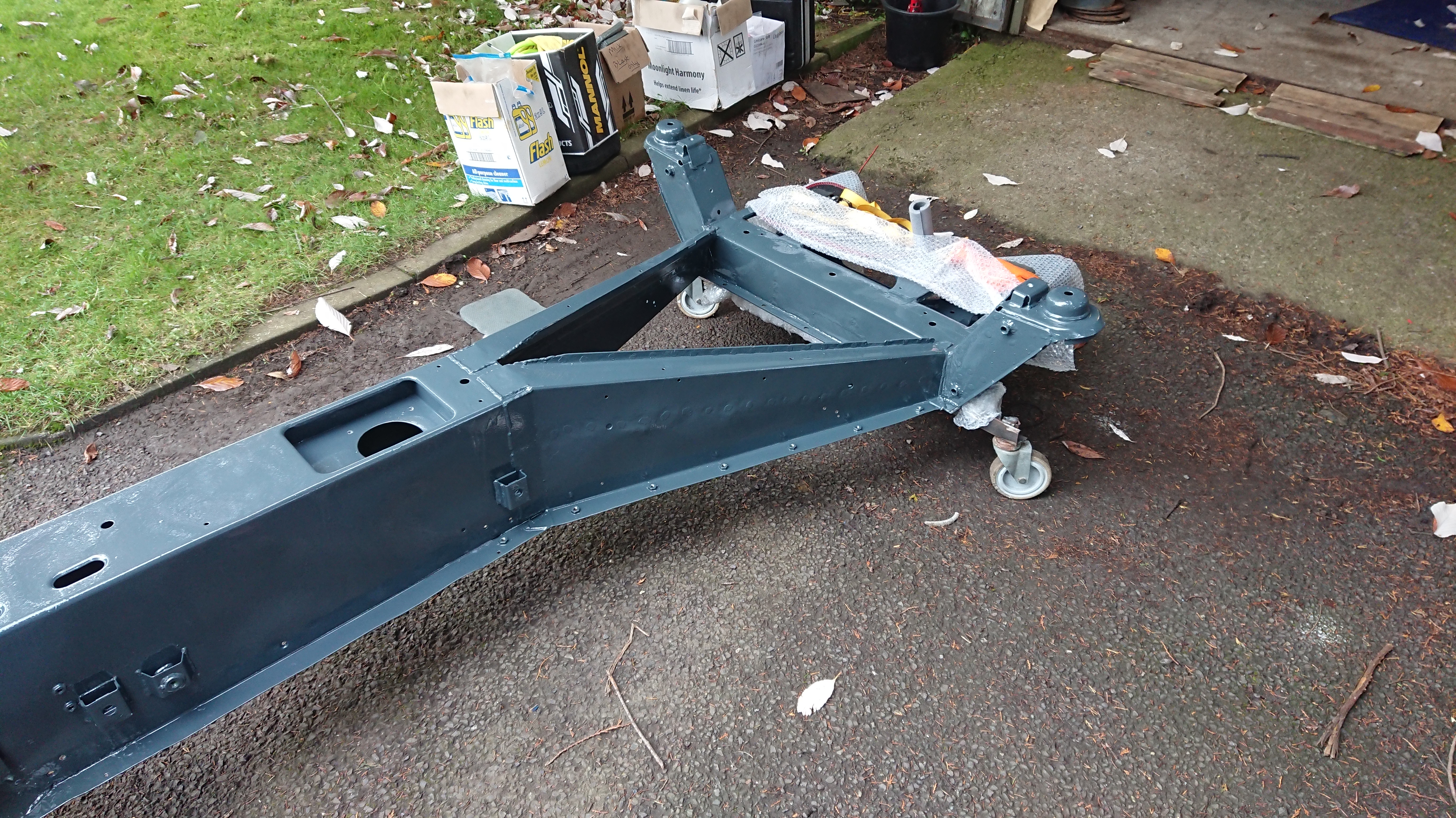

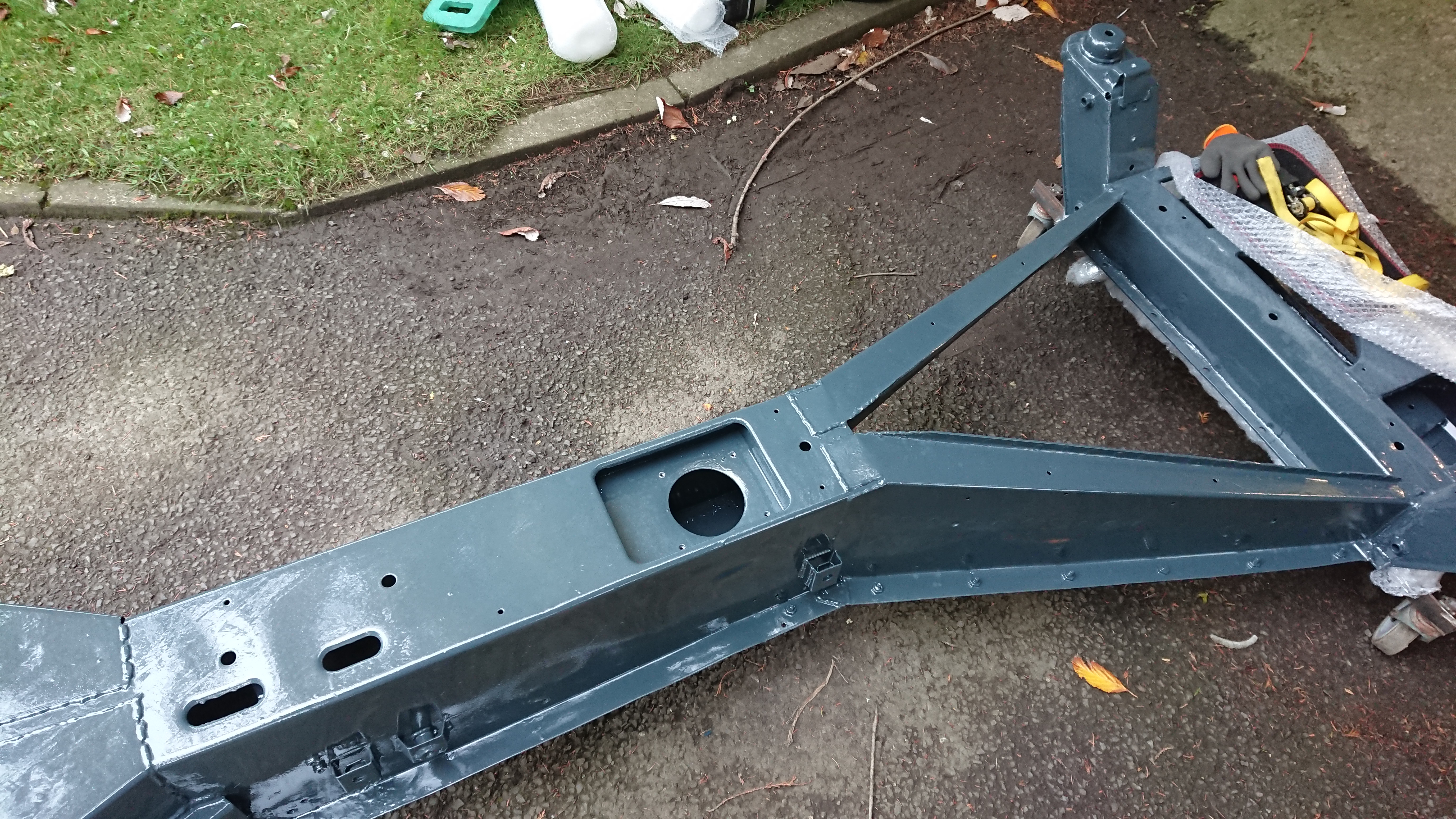

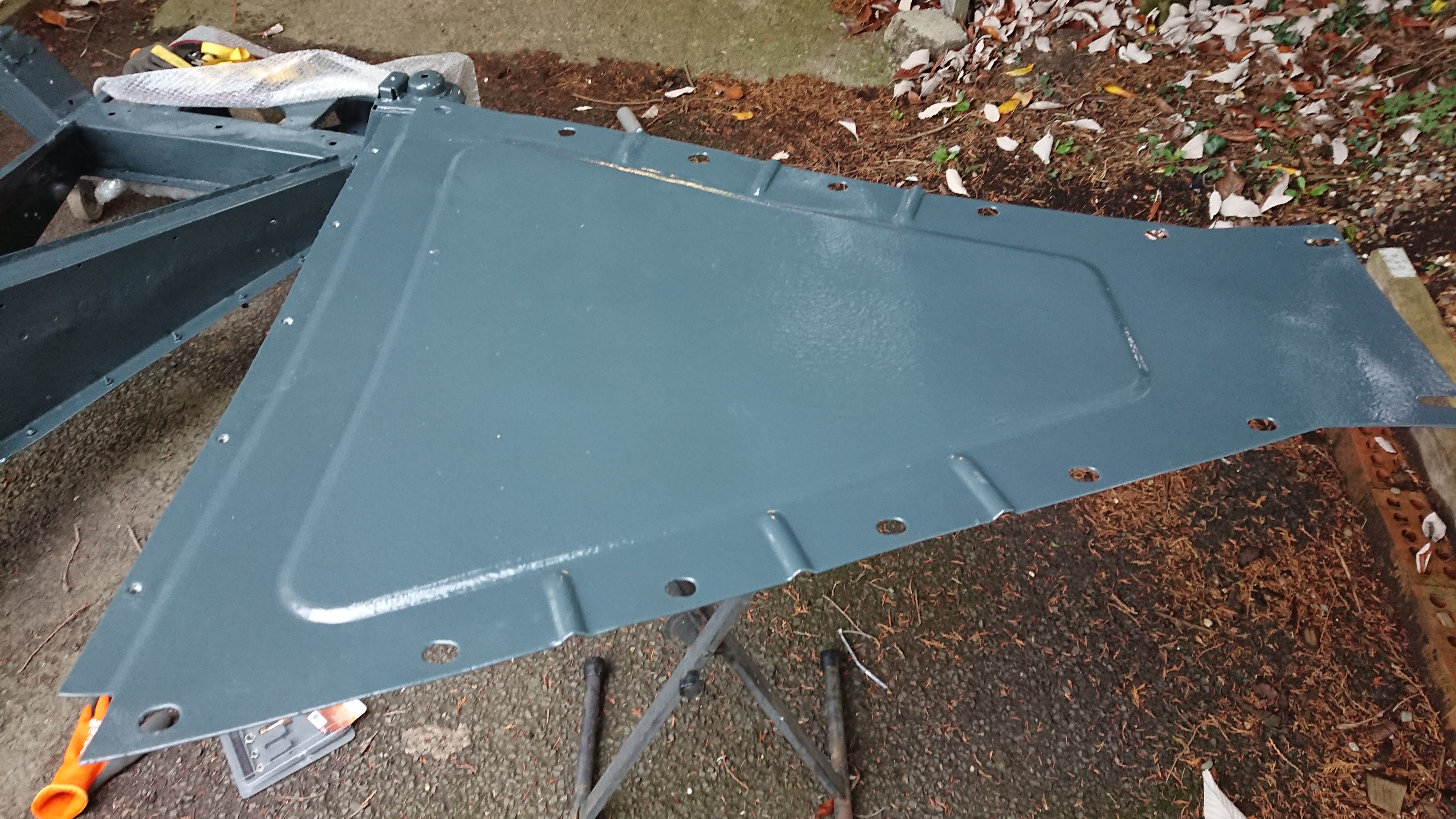

Postby cis6409 » Thu Dec 02, 2021 9:36 pm
Some more pics of it back home

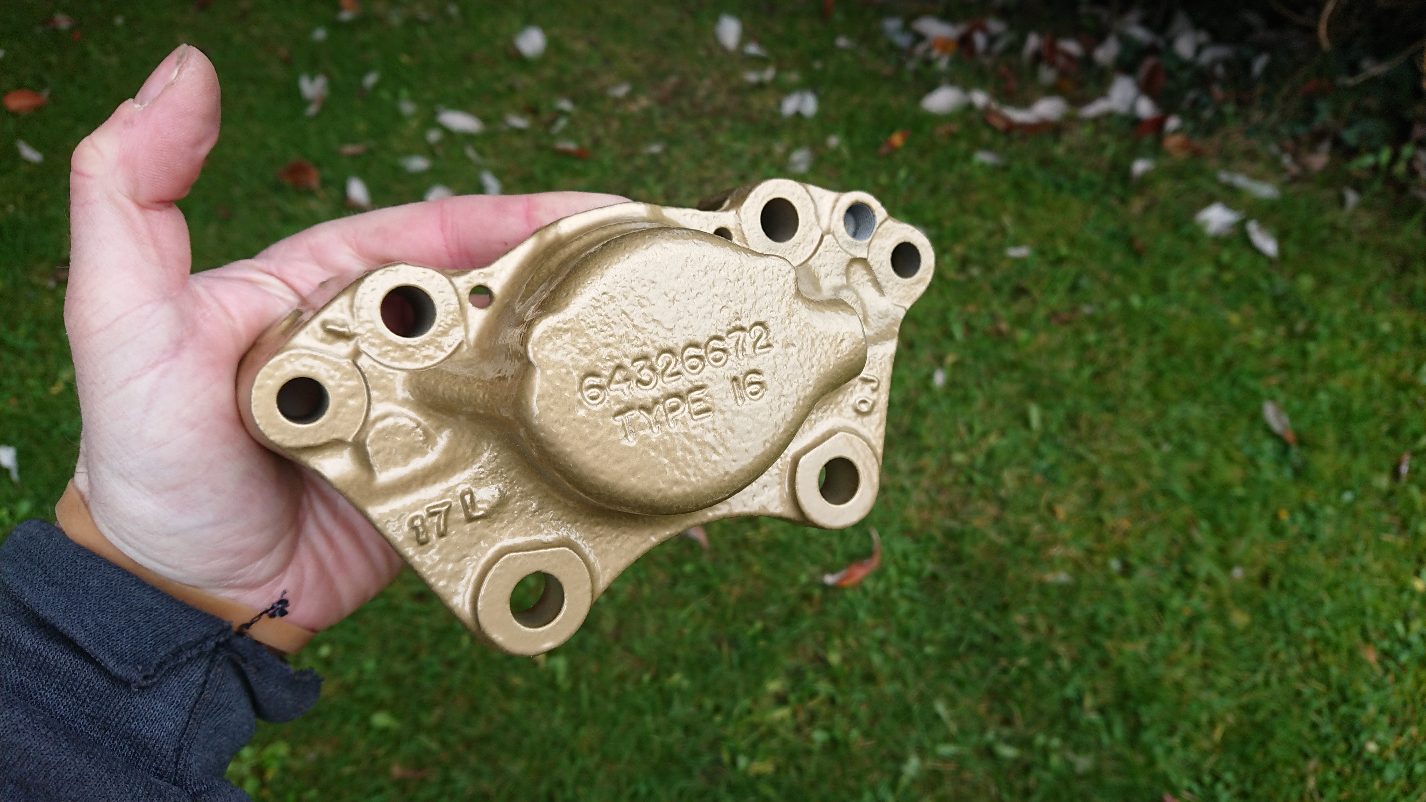

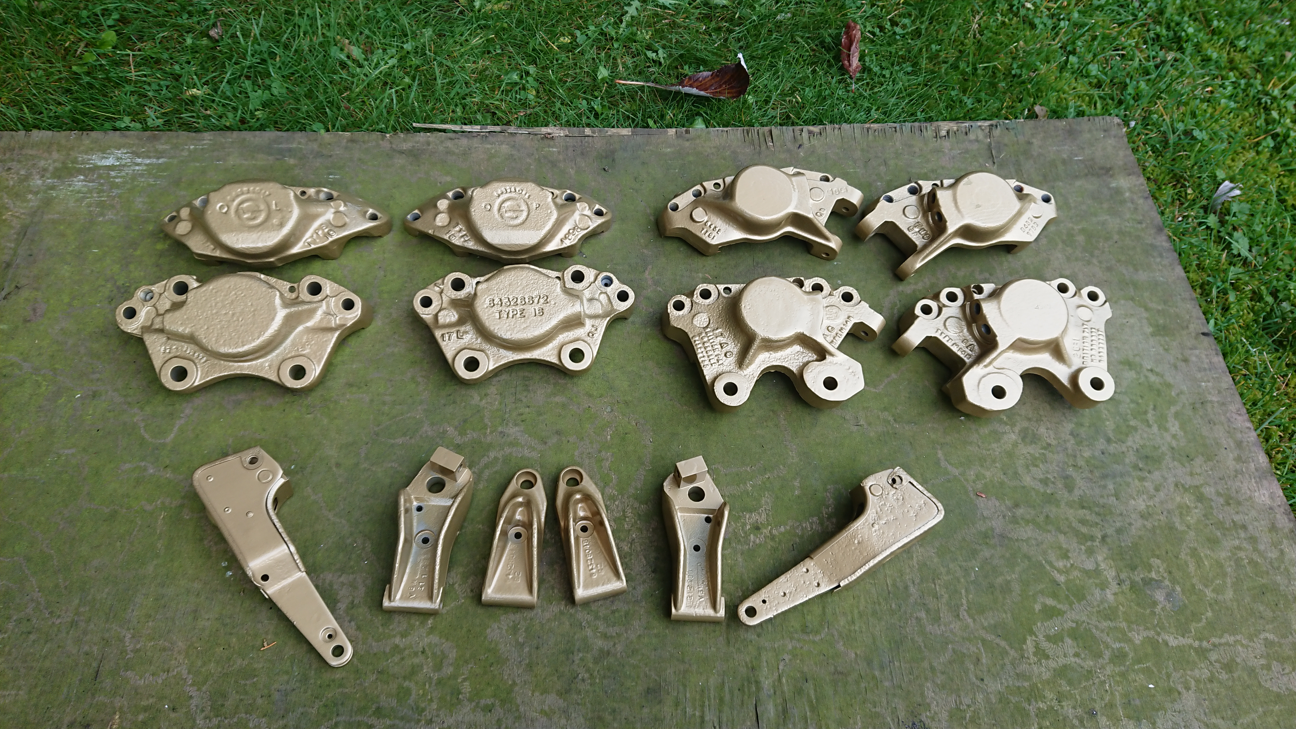

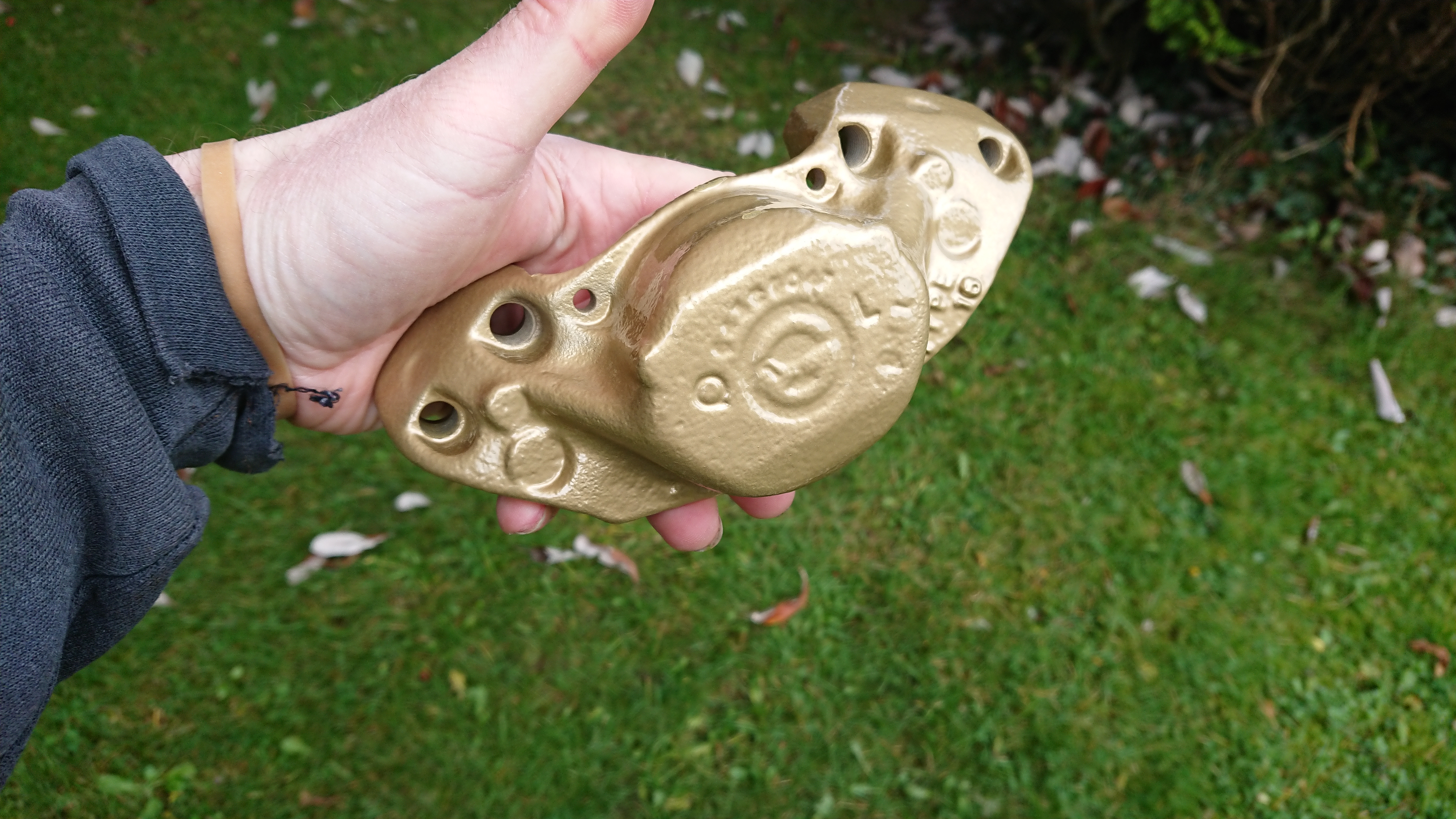

Postby cis6409 » Thu Dec 02, 2021 9:45 pm
With the chassis back got a little momentum going managed to get some other stuff done.

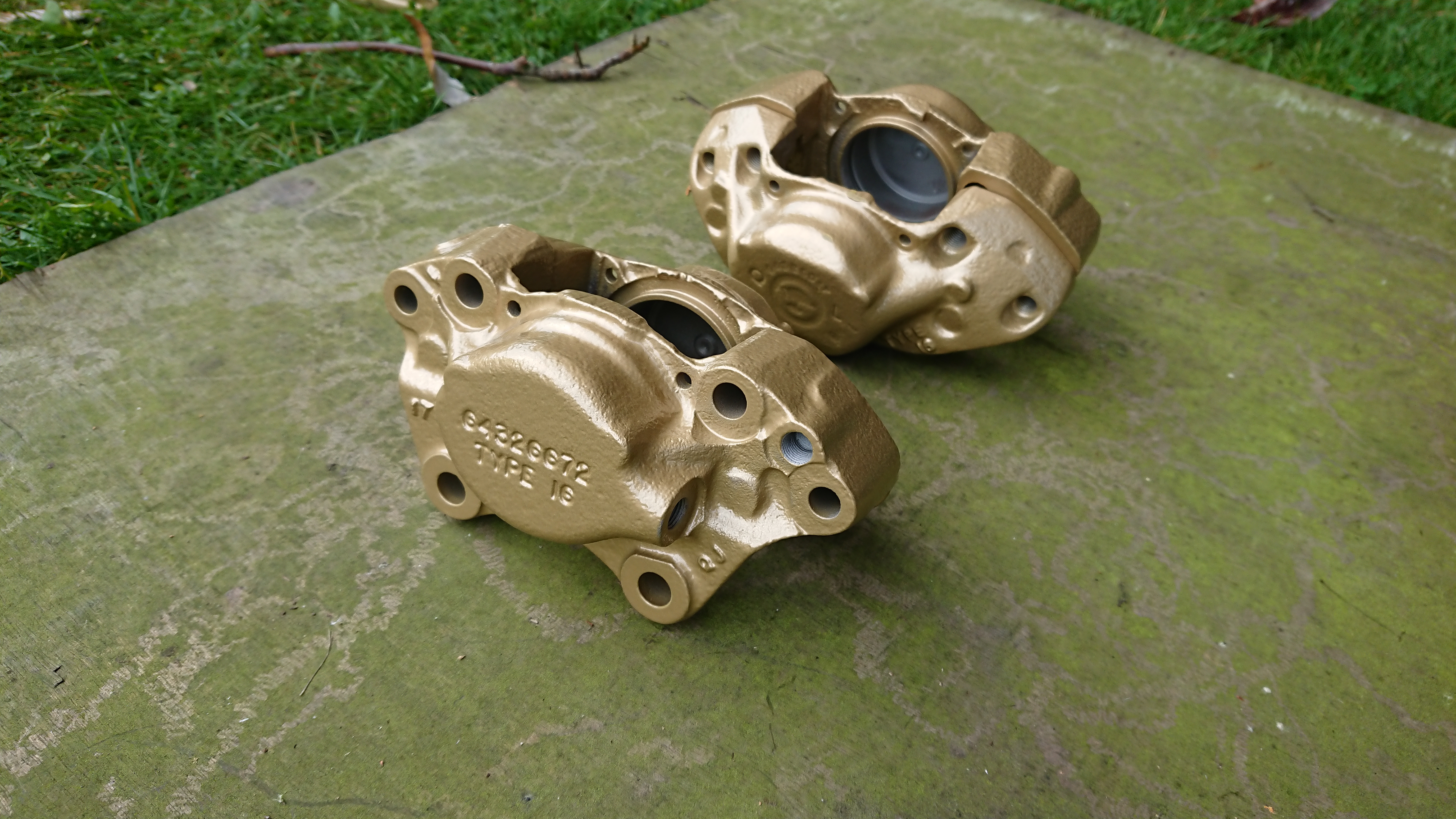

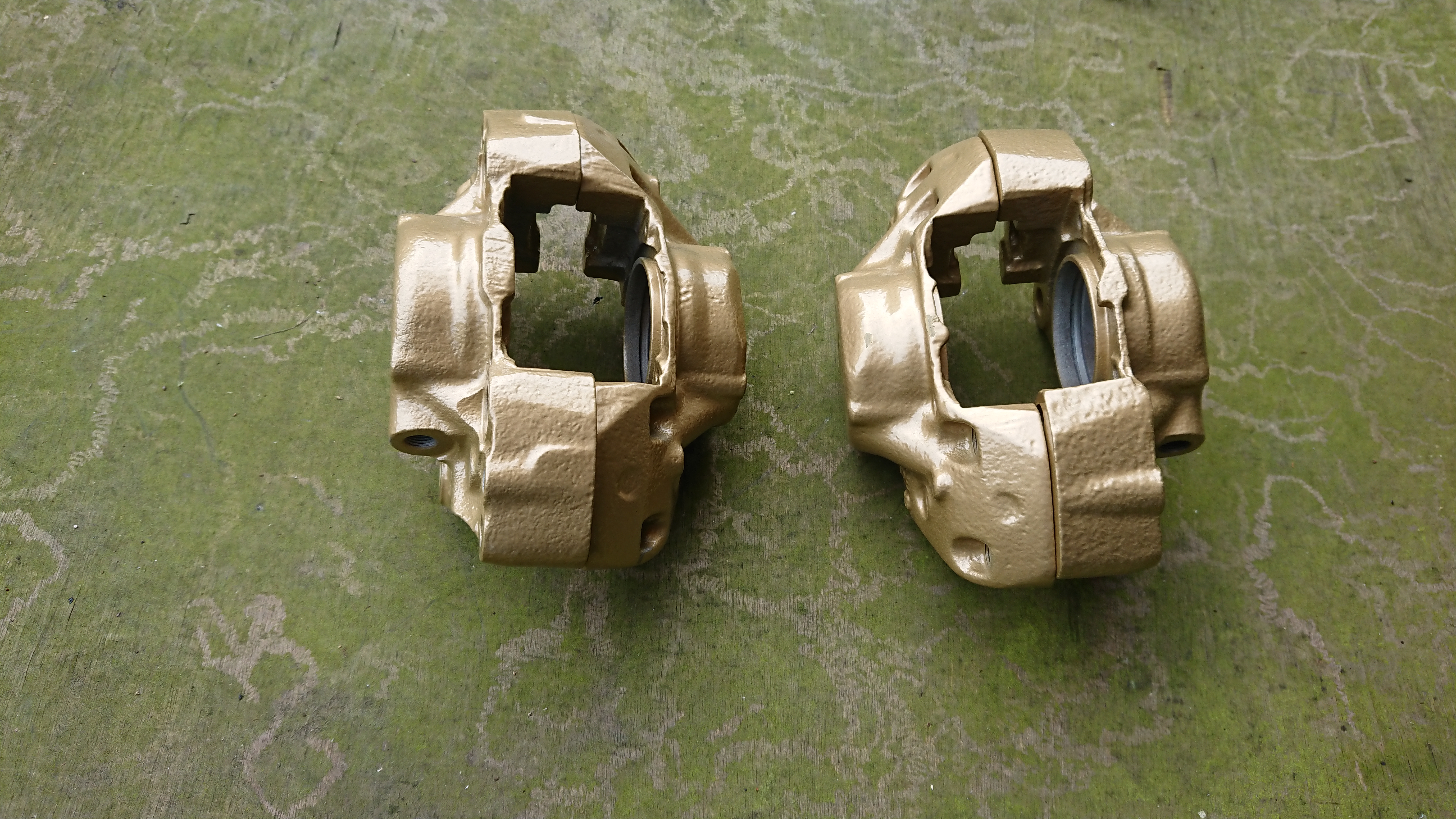

Got the brake calipers back from the powdercoaters.

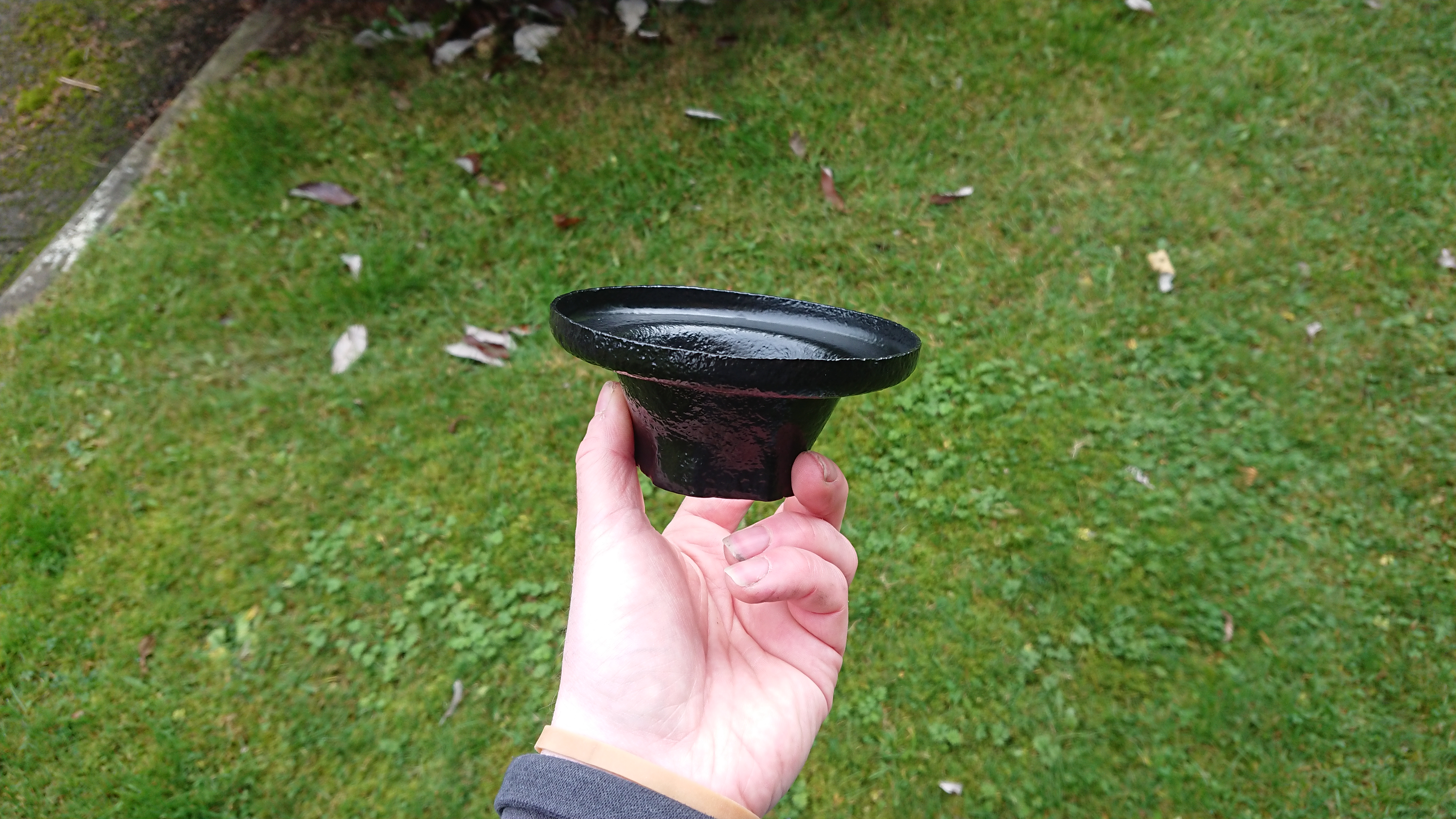

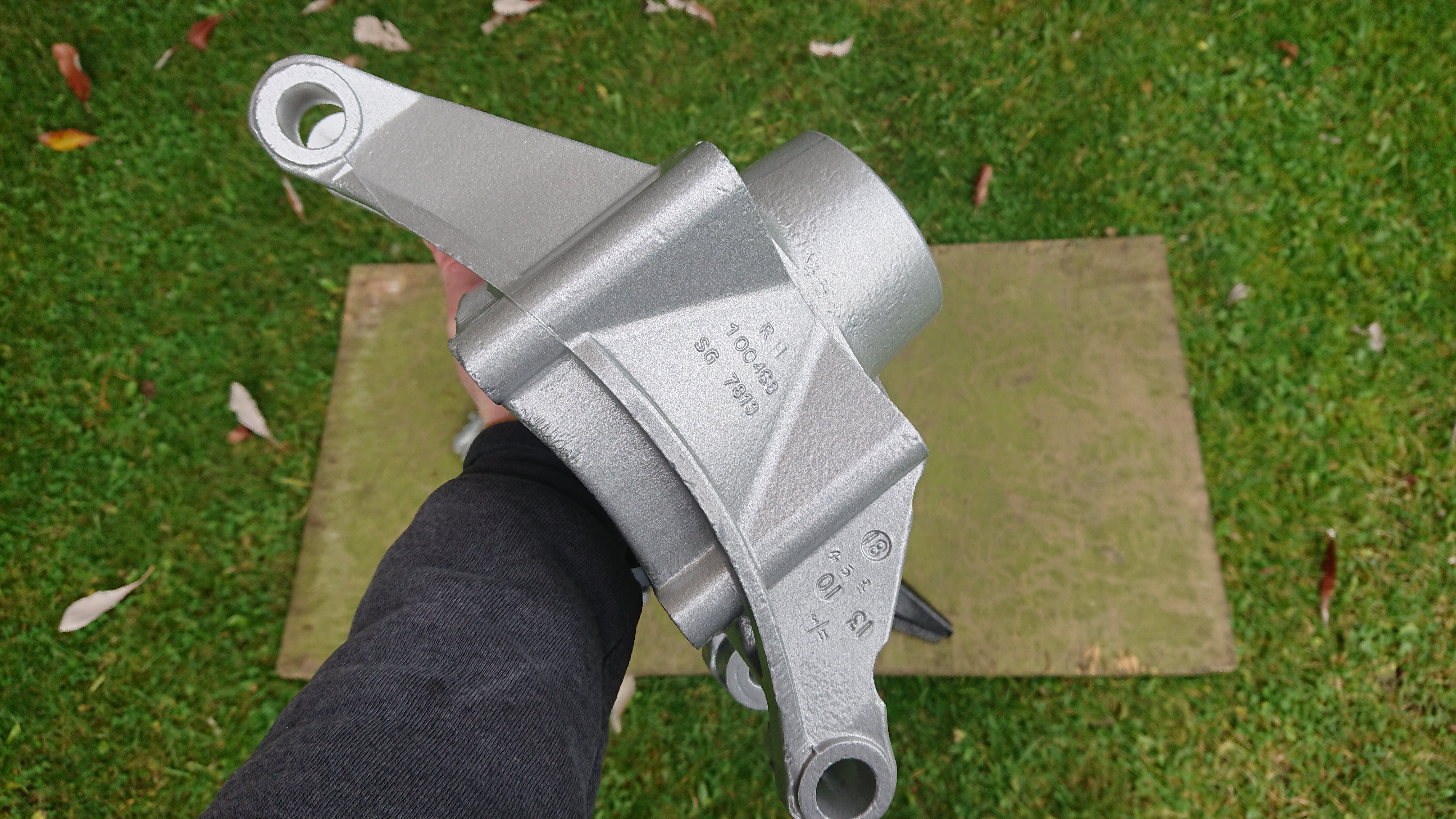

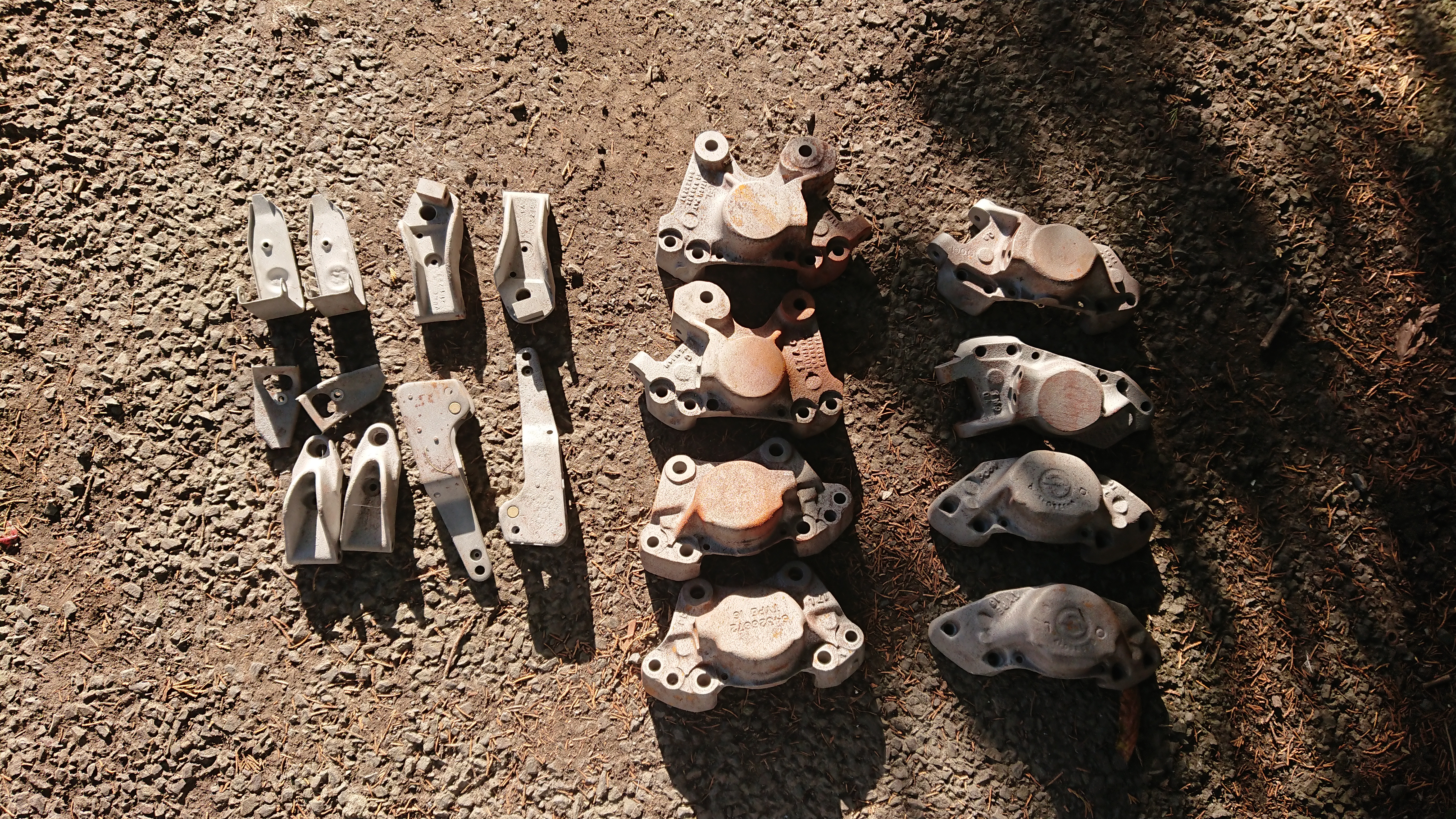

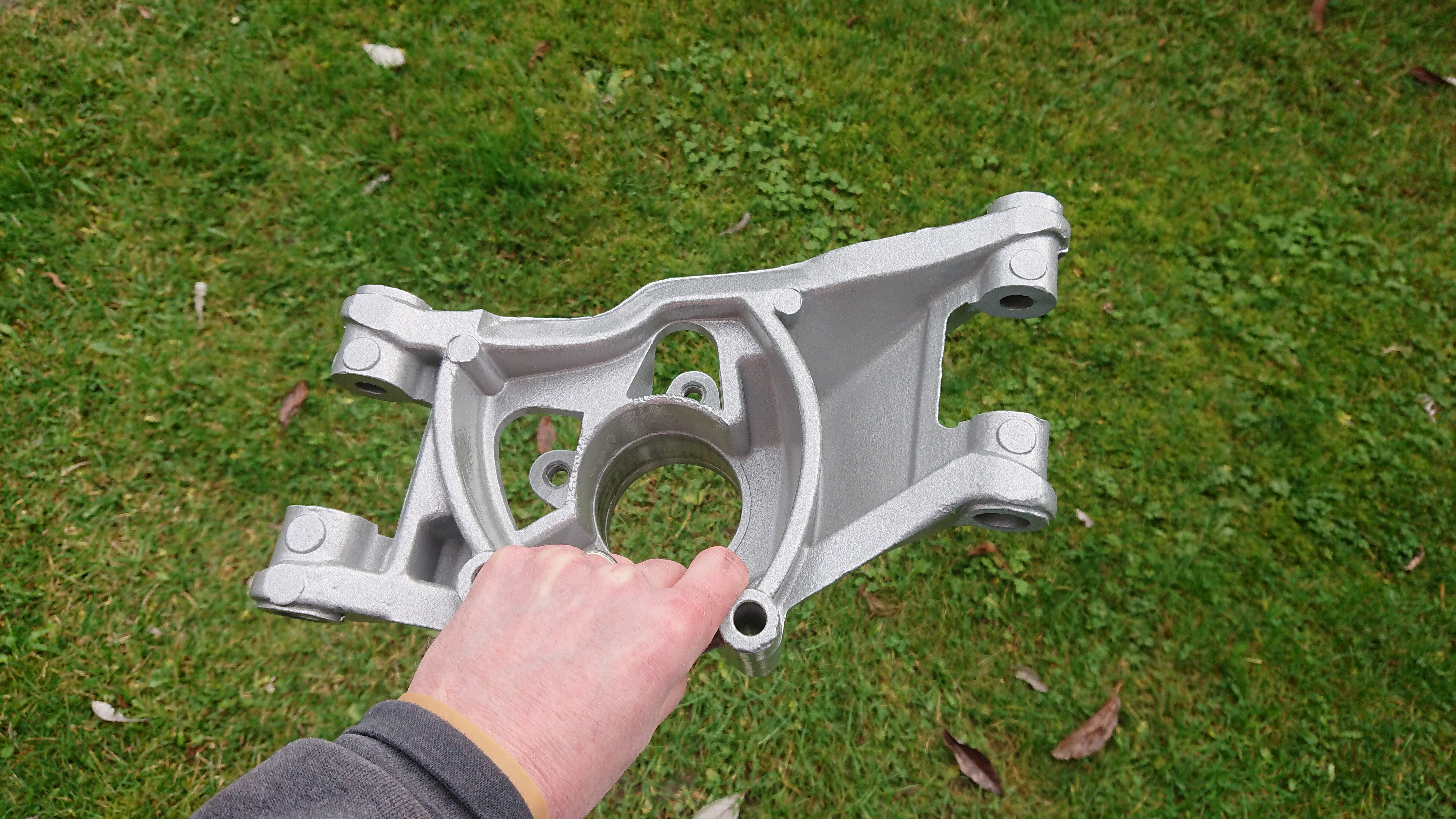

Postby cis6409 » Thu Dec 02, 2021 9:47 pm

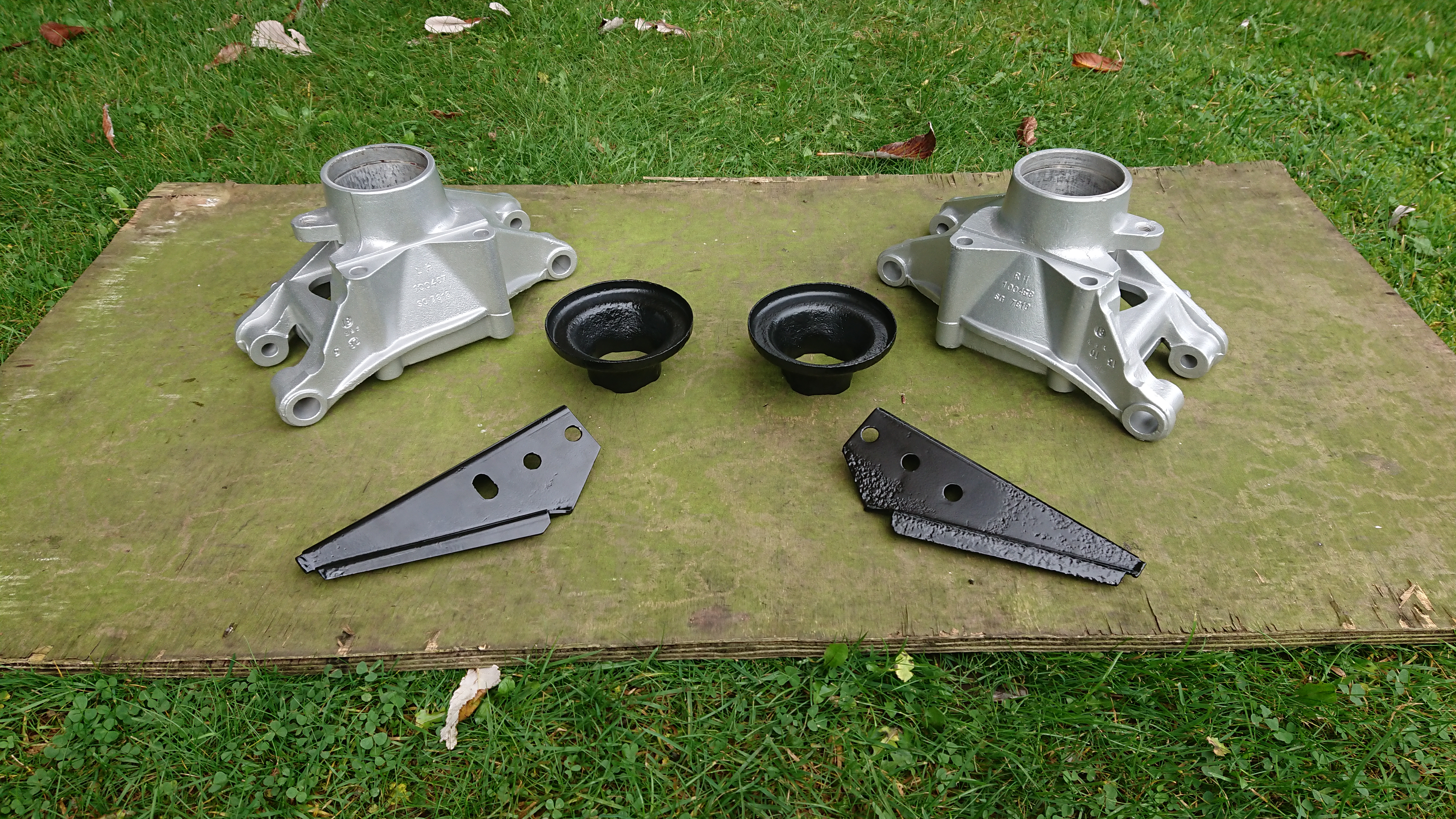

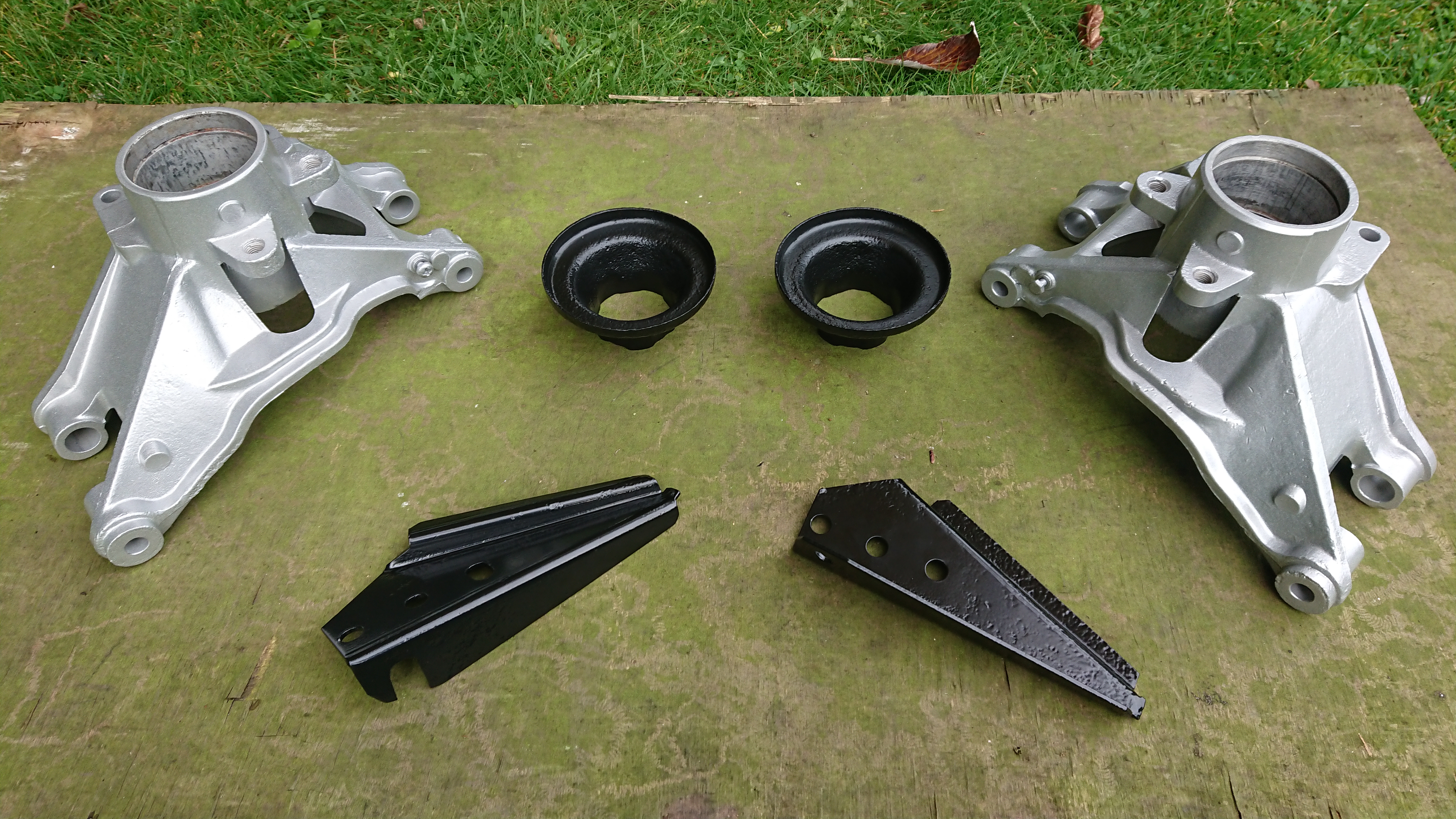

Got the rear hubs and other chassis stuff back from vapour blasting aswell

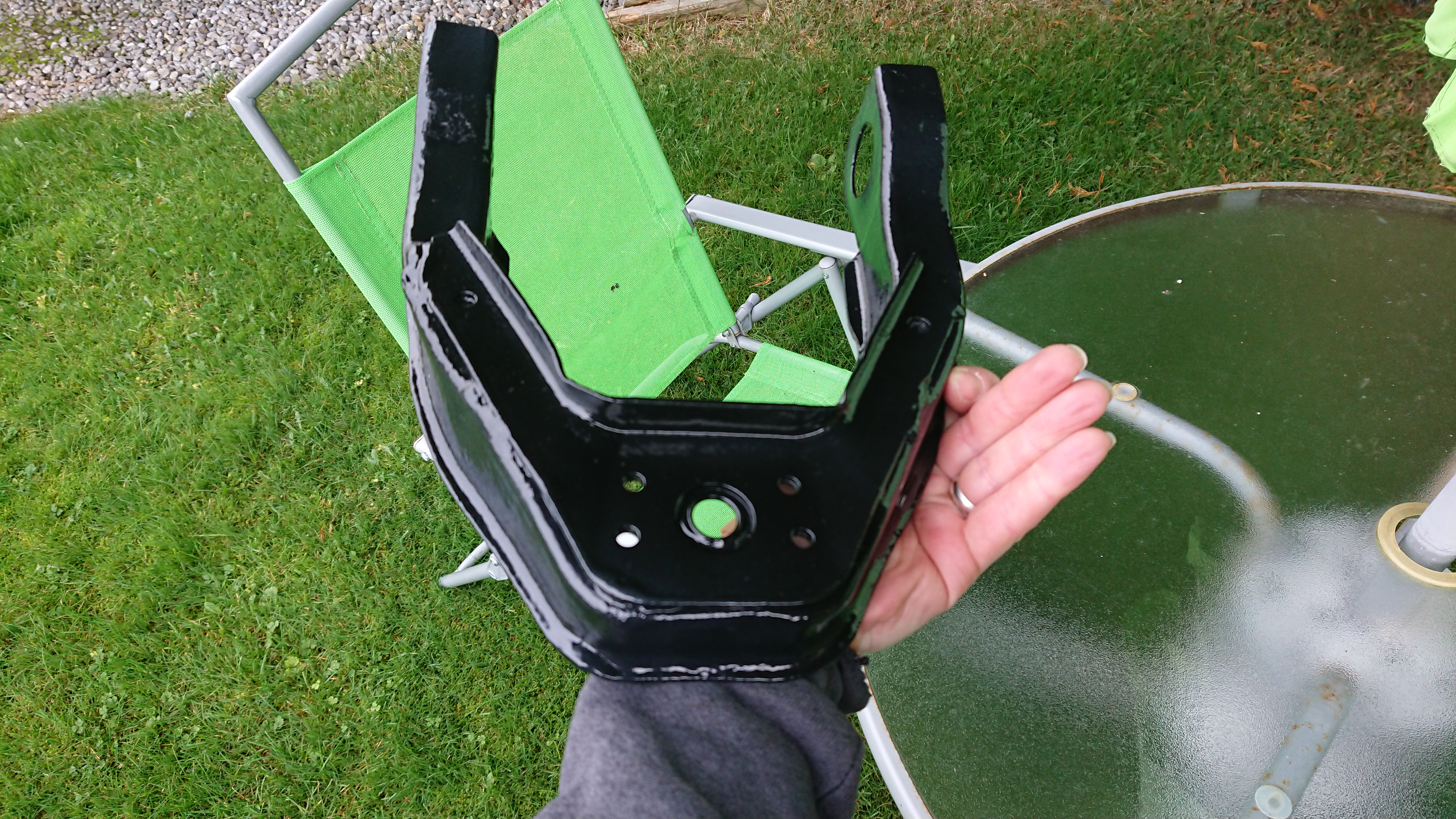

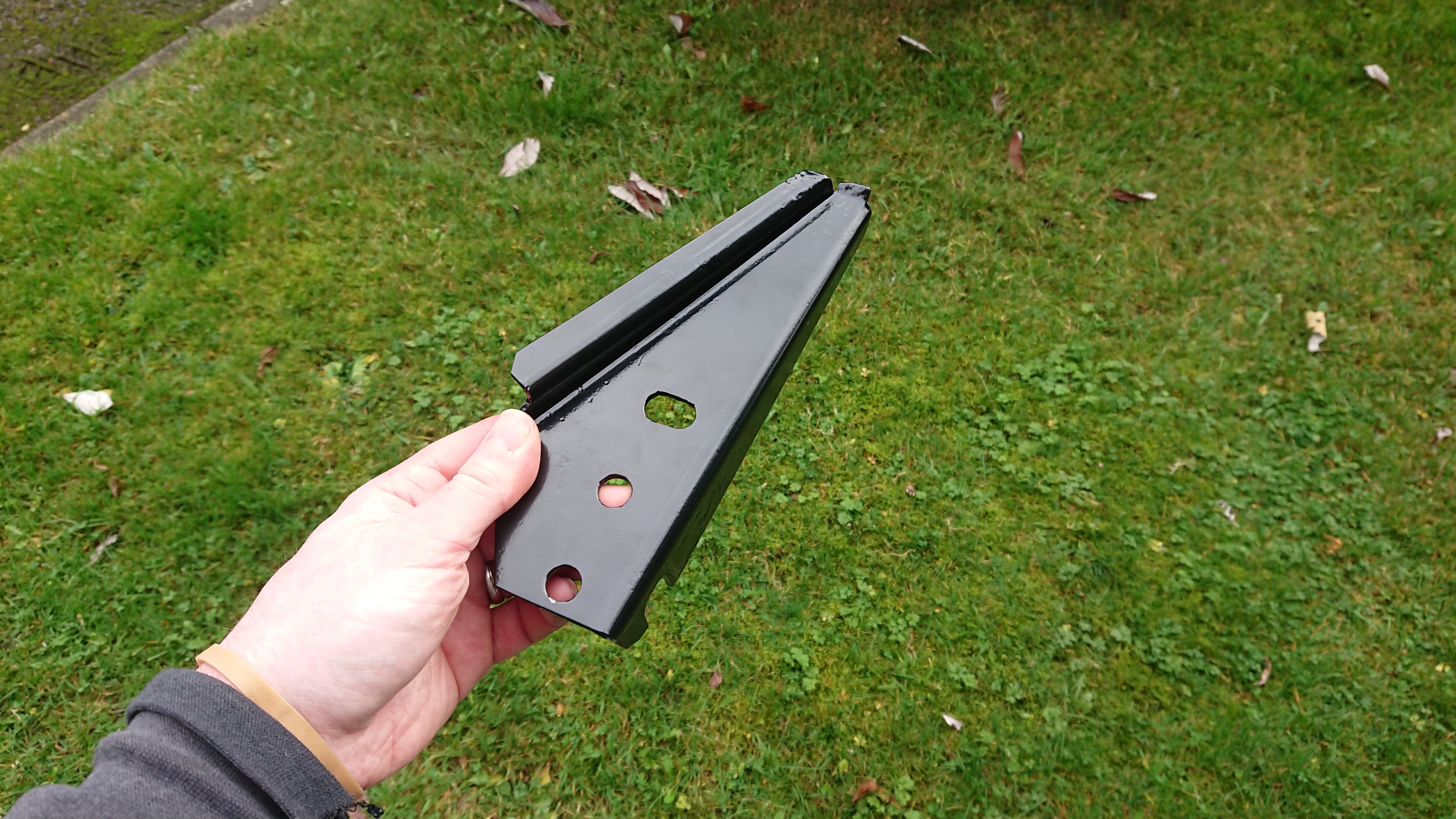

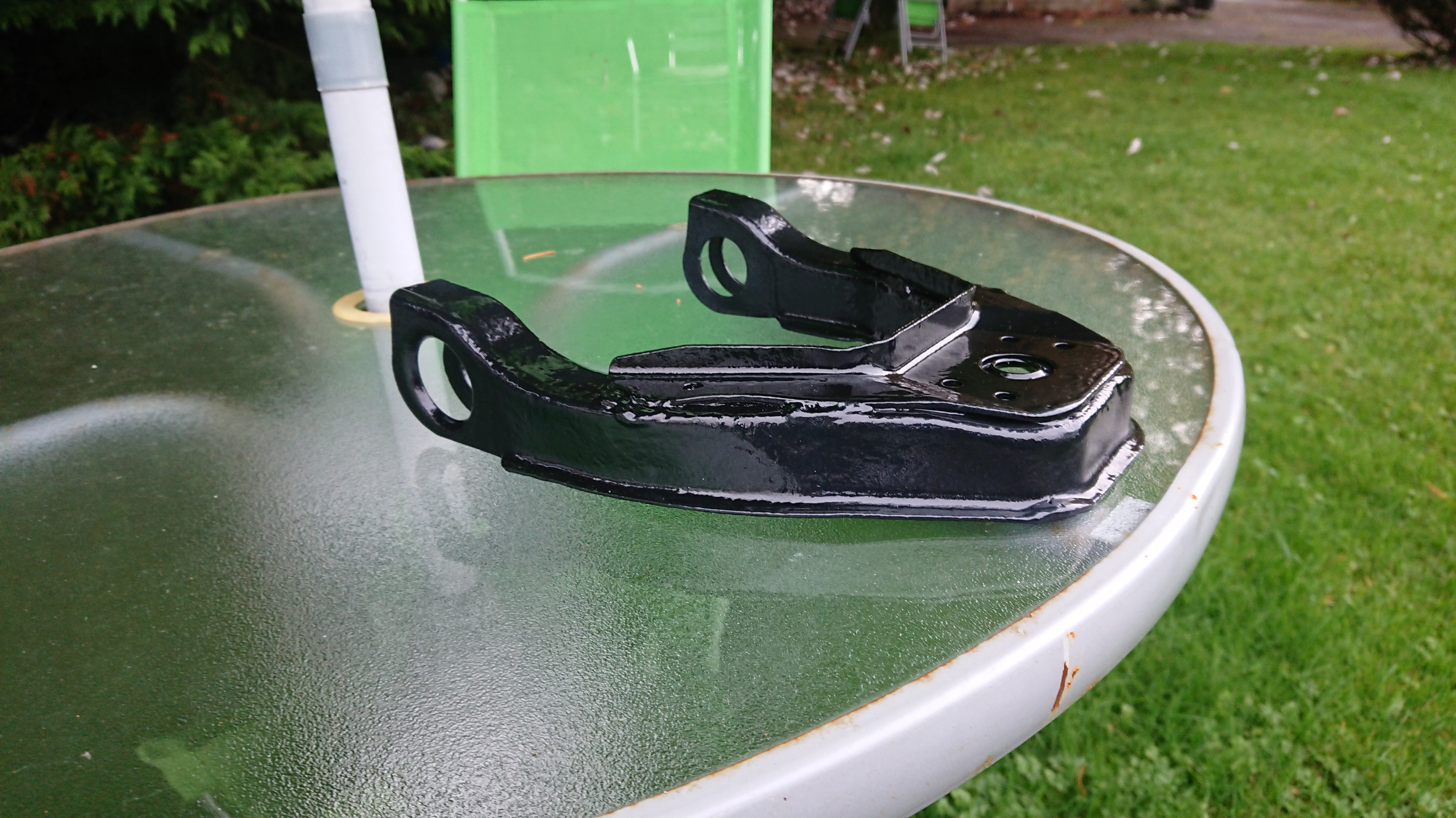

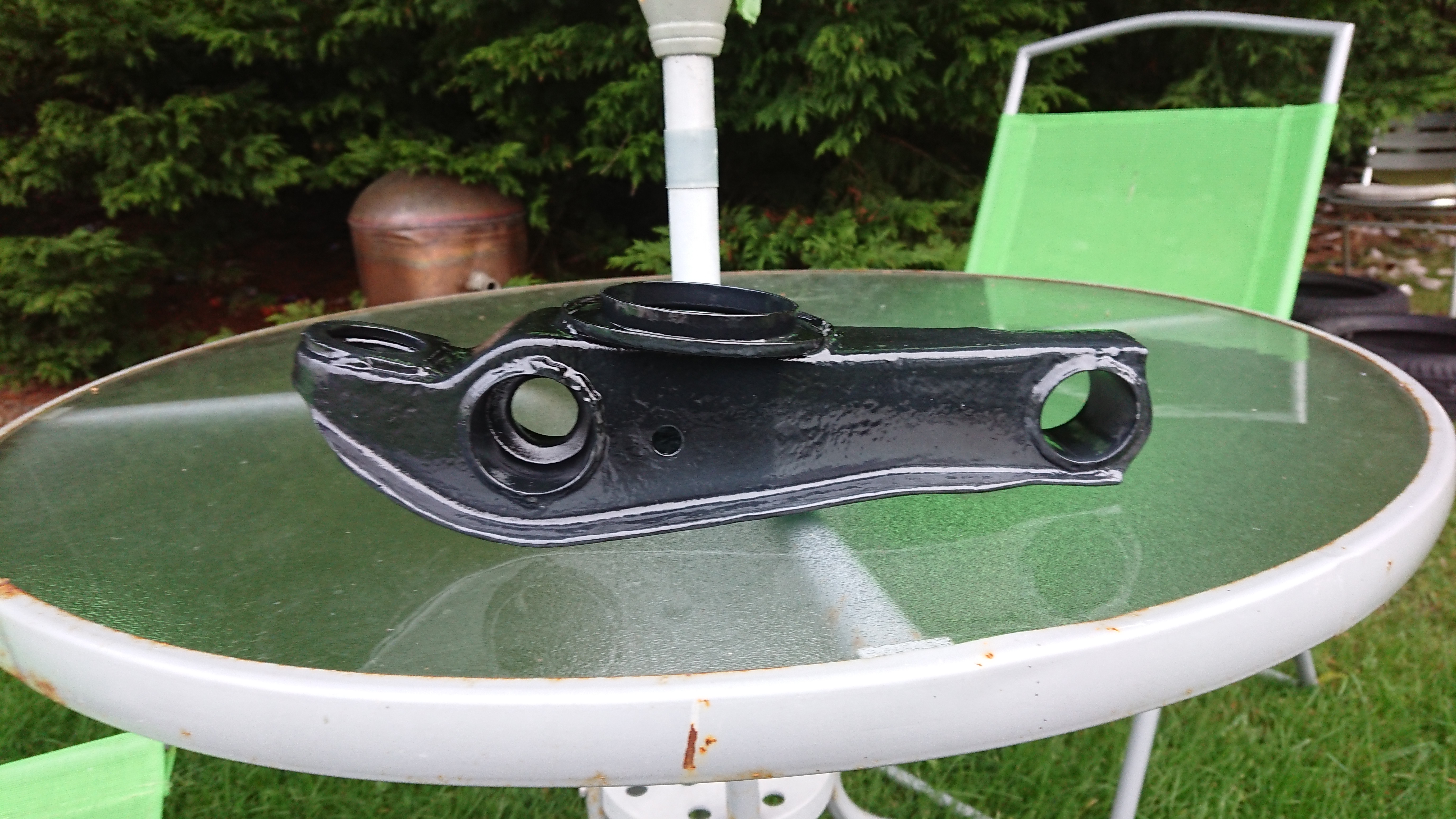

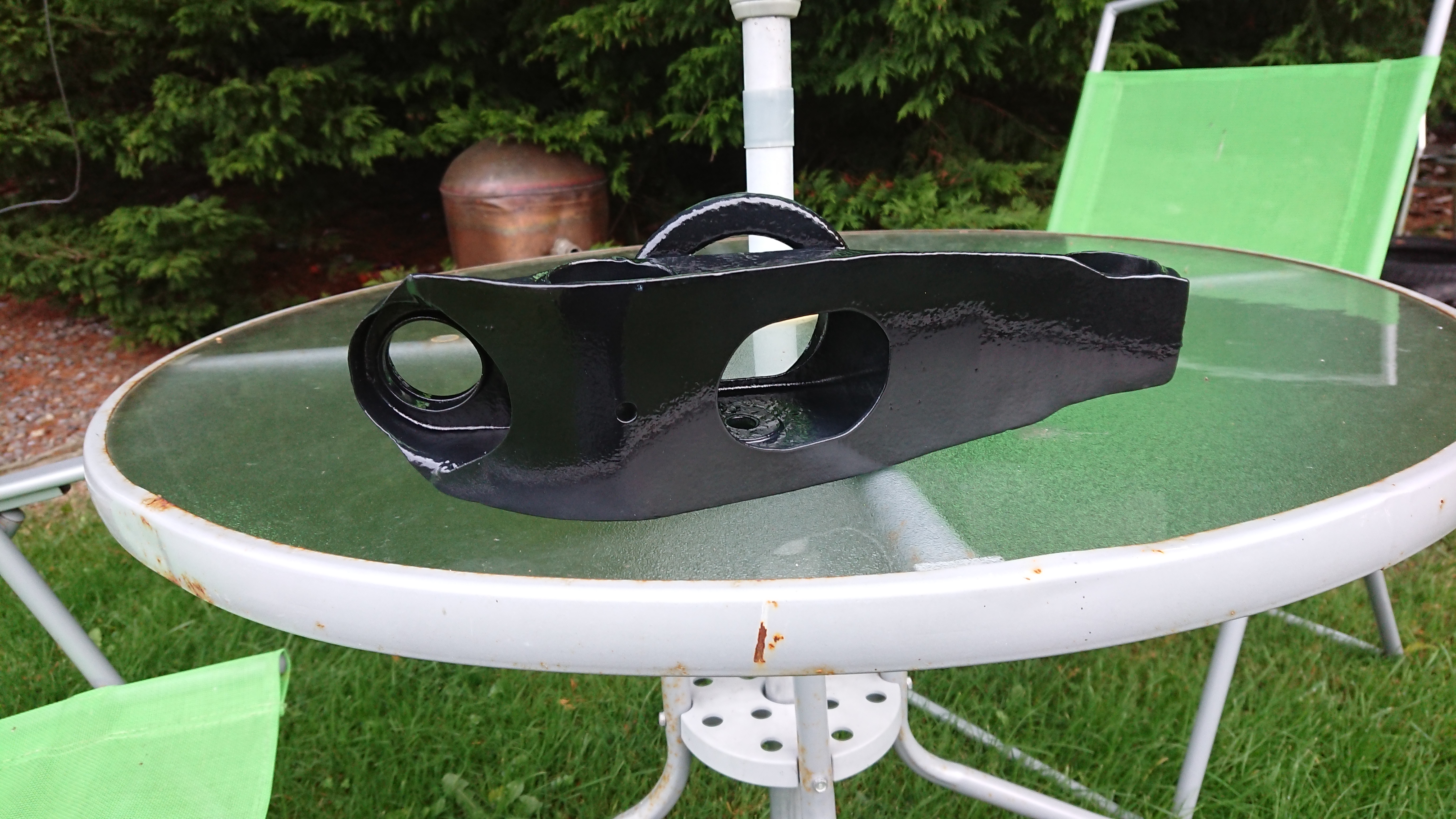

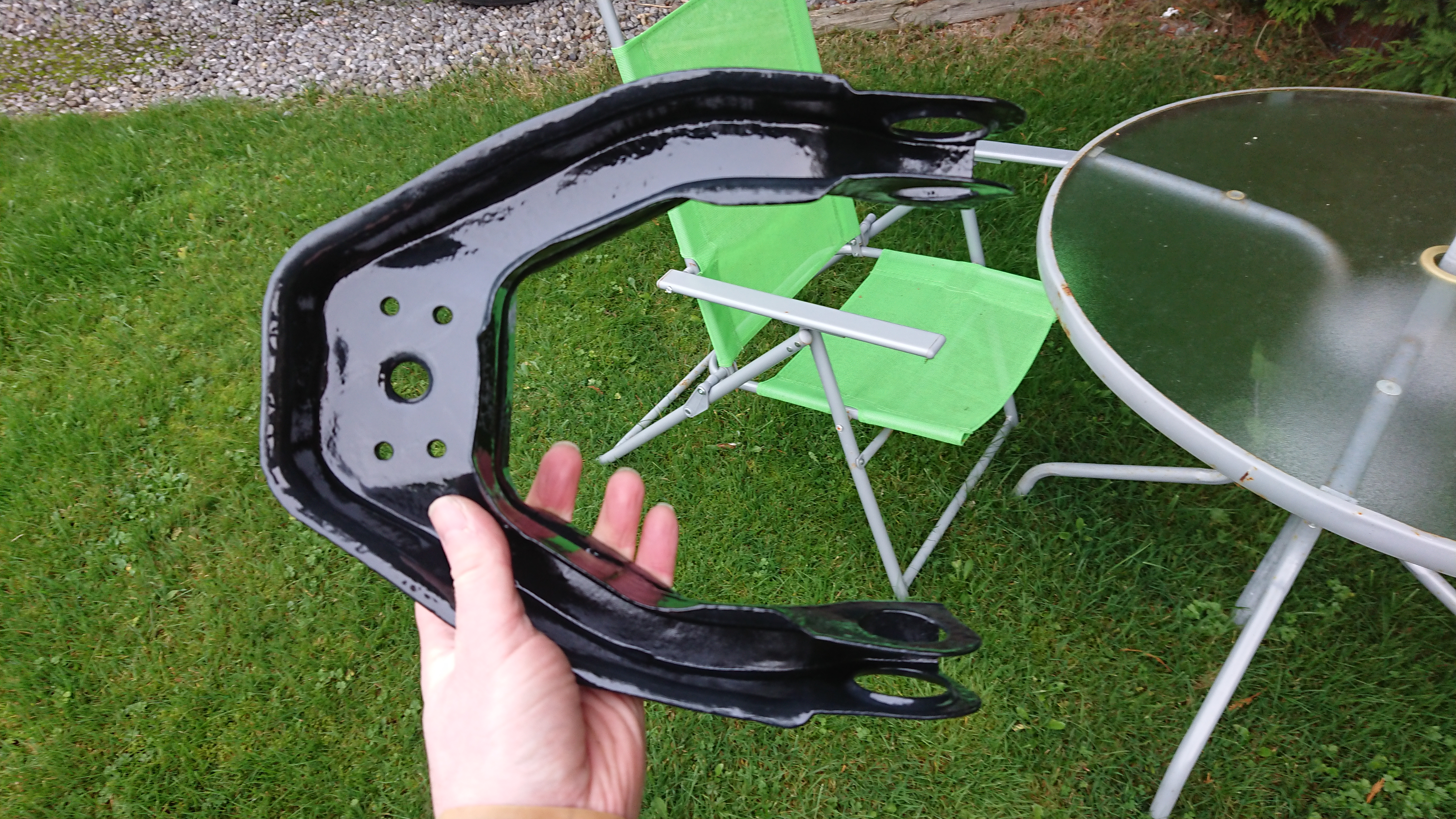

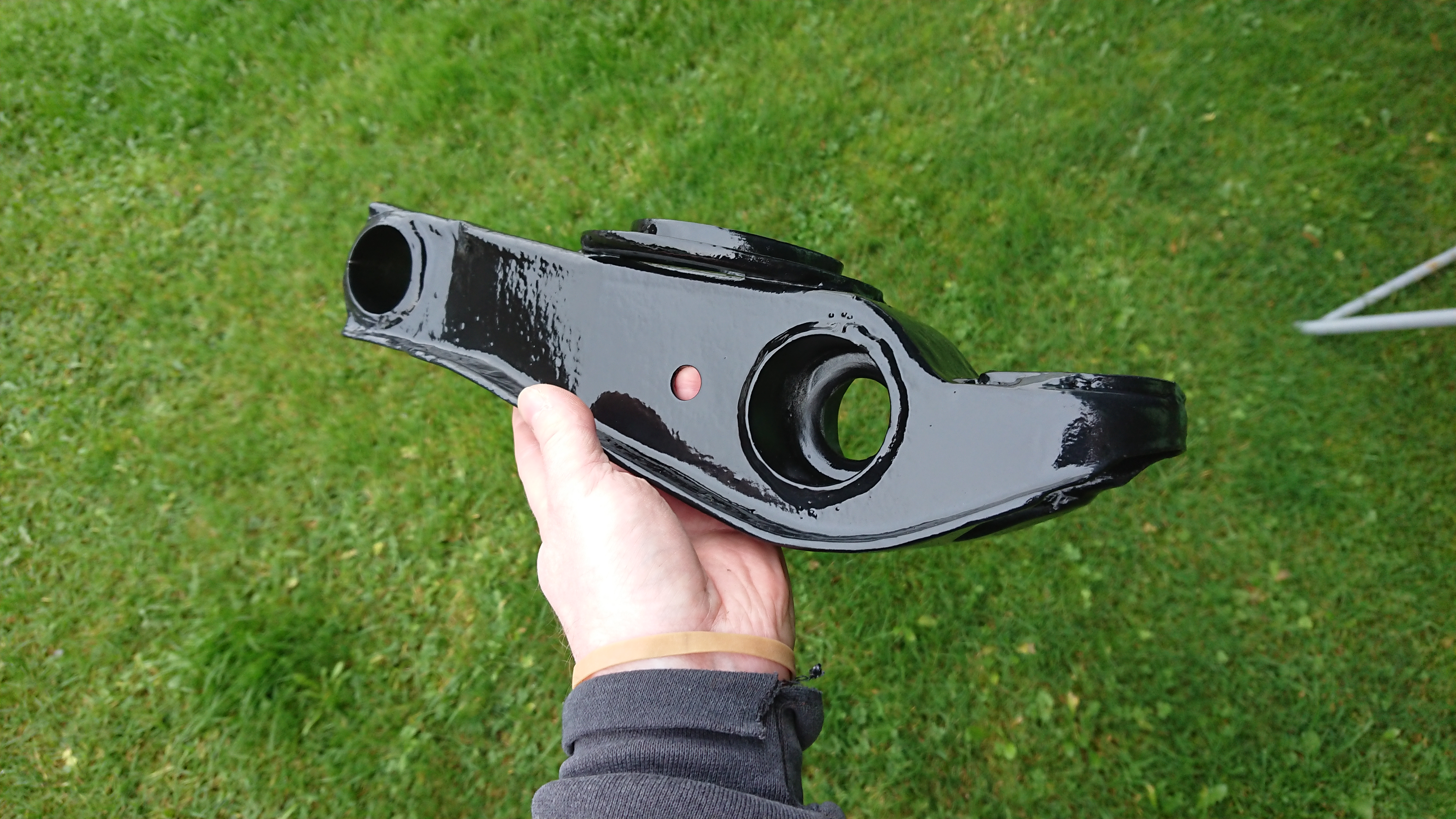

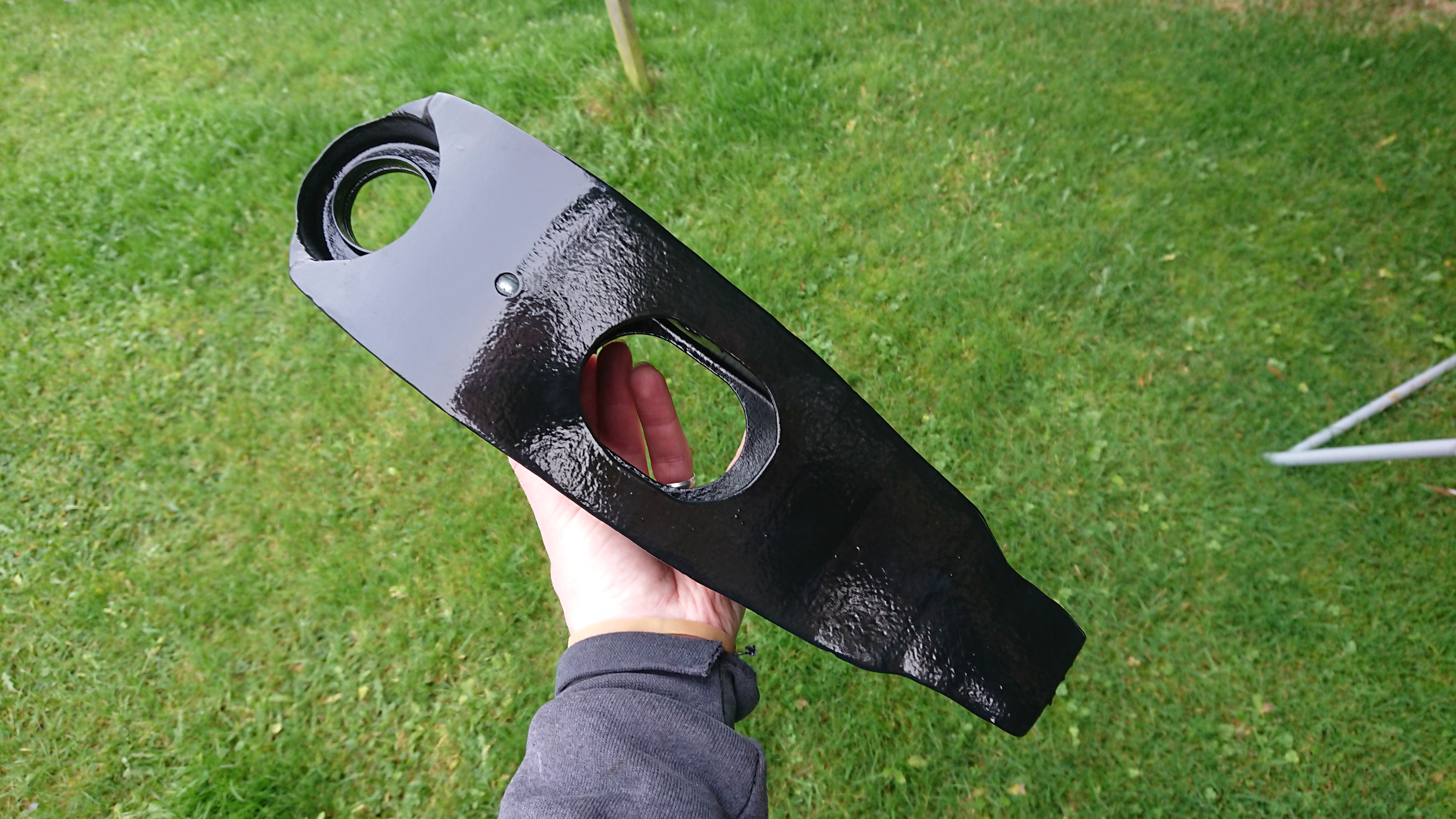

Postby cis6409 » Thu Dec 02, 2021 10:01 pm
Forgot to post pics of the suspension arms with the chassis pictures. Got them painted black while the Chassis was getting done..
