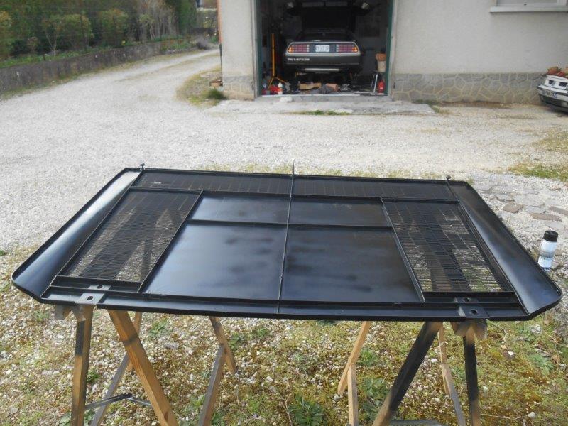

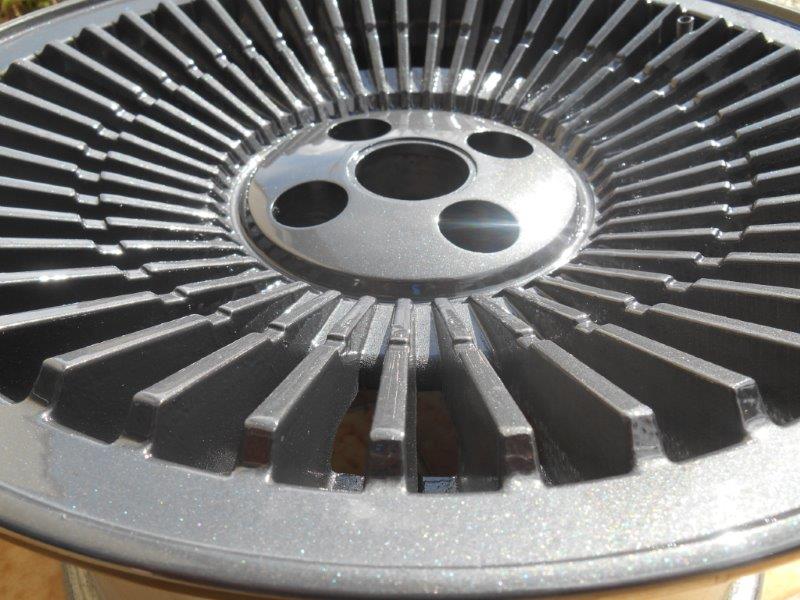

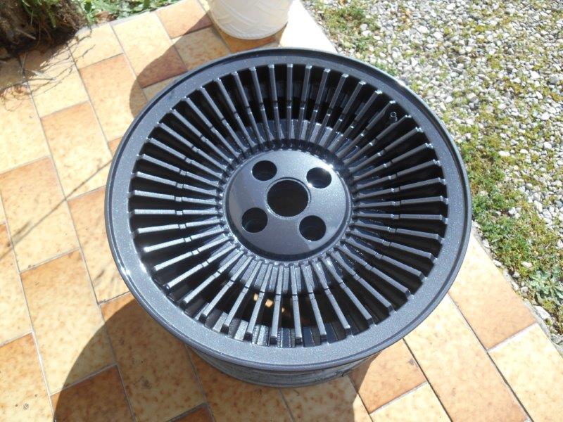

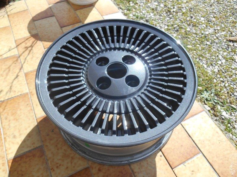

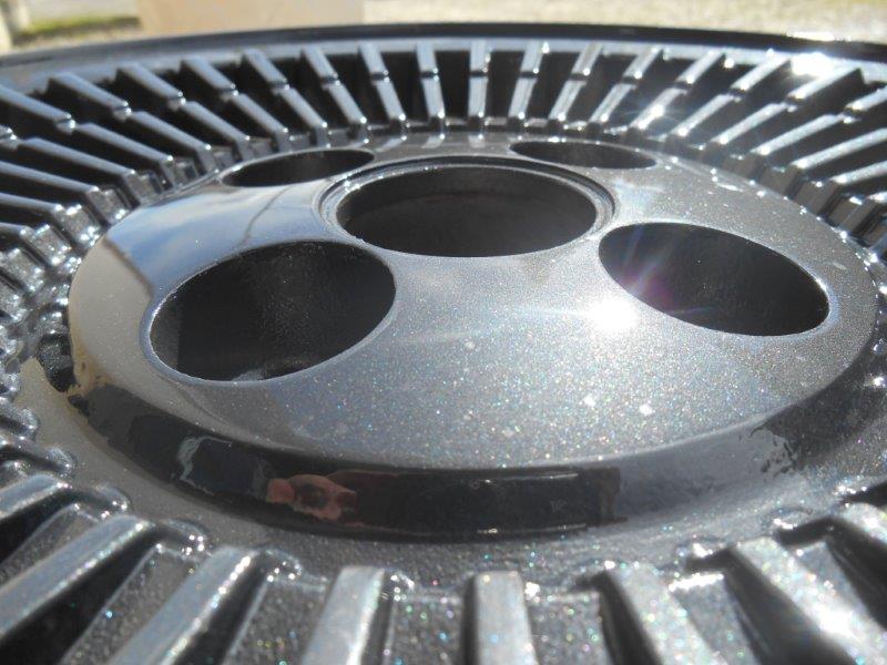

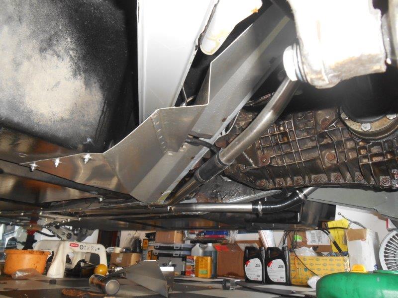

MikeWard wrote::shock: what did he paint them with, rattle cans?
Almost :| He used a spray gun.
We misunderstood, because I thought he would have paint them and use an over to dry the paint, but no.
I will see how long it will last...
Here are a few more pic at the day light

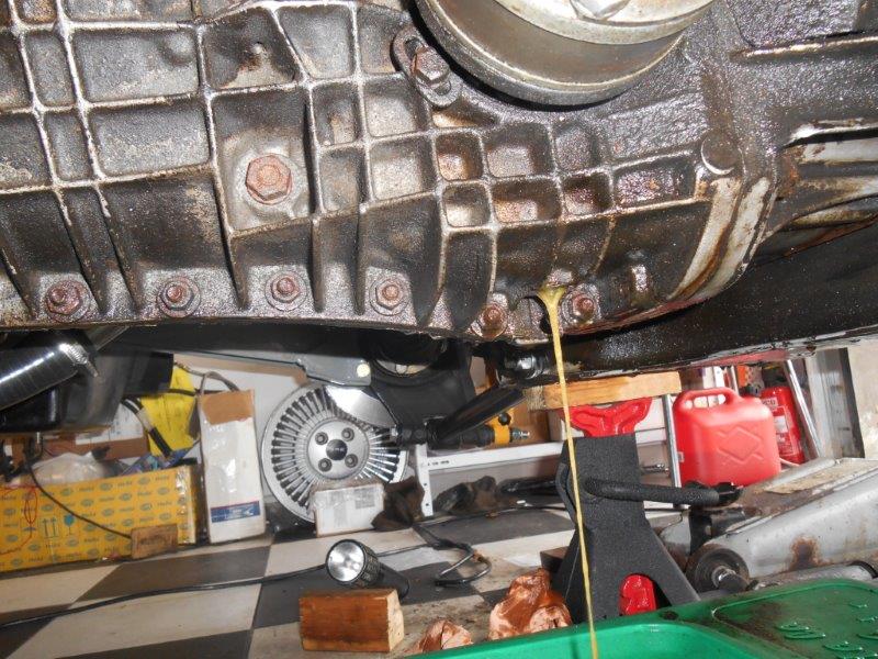

Flushing the old oil

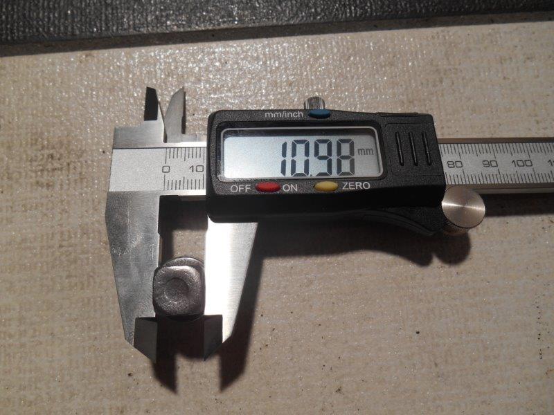

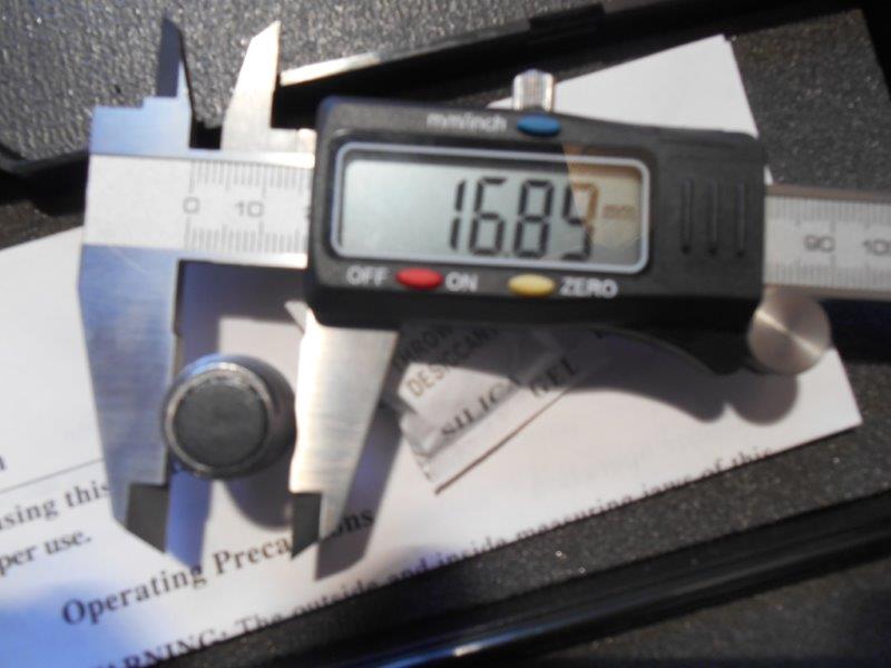

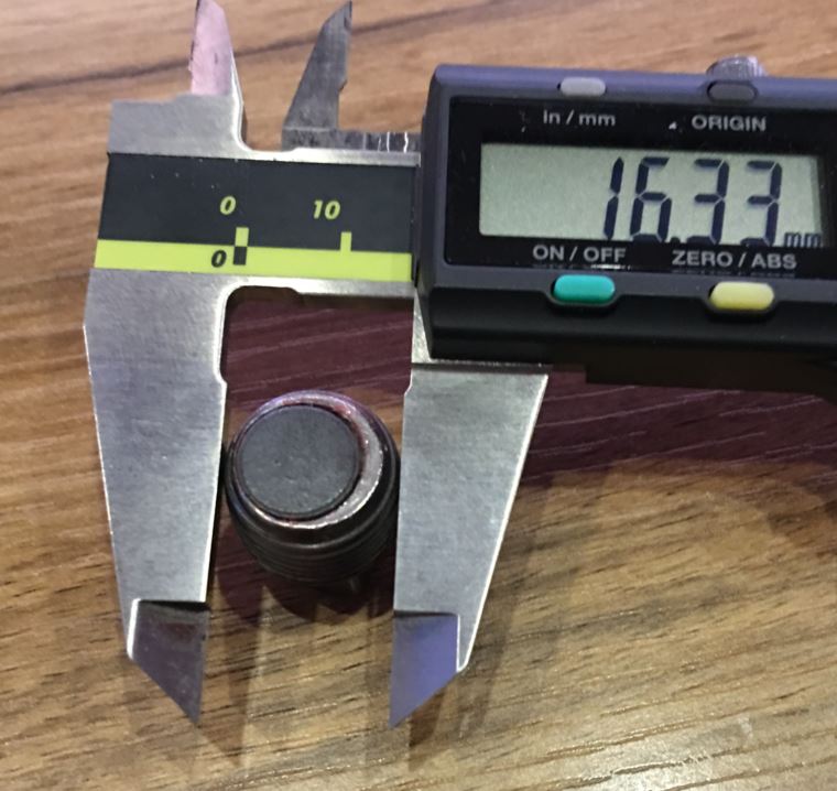

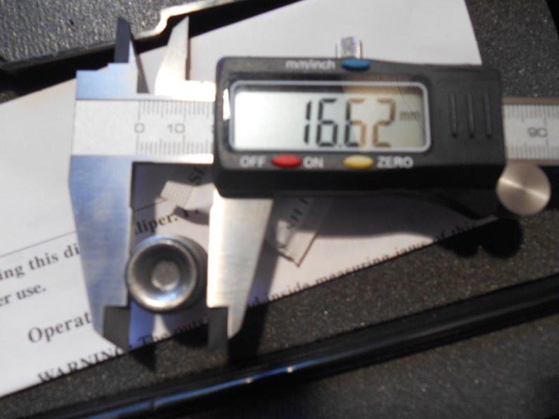

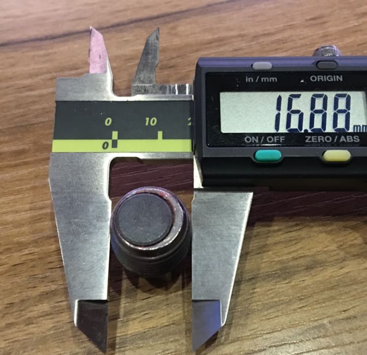

I ordered two new bold from the club to replace them, but unfortunately the size isn’t really the same diameter.
I prefer not to try to insert them, I’m afraid to damage the thread

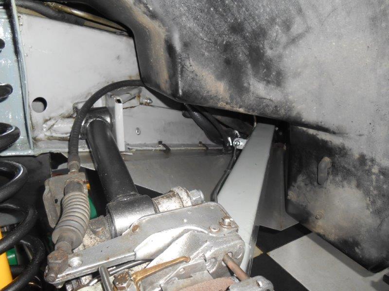

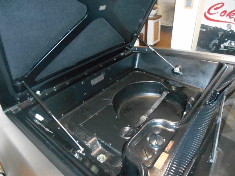

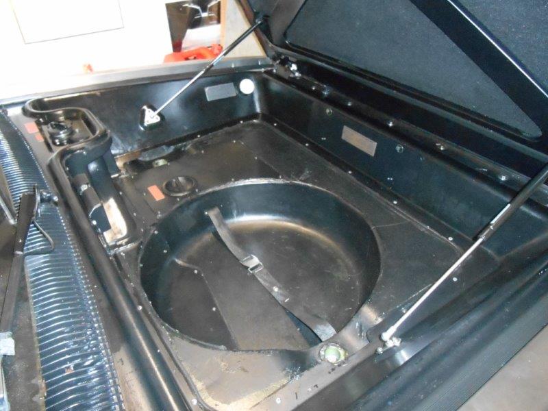

Cleaning the trunk with Rustol and applying stainless steel label

Domi wrote:I ordered two new bold from the club to replace them, but unfortunately the size isn’t really the same diameter.
They are tapered - i.e. the end has a smaller diameter than the middle. Are the number of threads the same on the old vs new? Your old ones don't look original.
Postby Domi » Mon Mar 06, 2017 6:58 pm
Yes, same length
I've never changed them, so I guess there are original?
Postby arranj » Mon Mar 06, 2017 7:12 pm
If the square bit is precisely 10mm, then they are original, if it isn't, then not.
Here is what I mean by tapered. As long as the thread pitch is correct - i.e. the number of threads per inch, then the diameter doesn't matter unless you are measuring at precisely the same point, you screw it in until it stops.
Postby Admin-bloke » Mon Mar 06, 2017 8:47 pm
I'm impressed there Arran !
Postby Domi » Mon Mar 06, 2017 9:02 pm
Yes the square of the old ones is 10mm, but not the new ones.
Postby arranj » Mon Mar 06, 2017 9:07 pm
Domi wrote:Yes the square of the old ones is 10mm, but not the new ones.
Correct - that's how you can spot the difference, it doesn't affect the operation of course.
