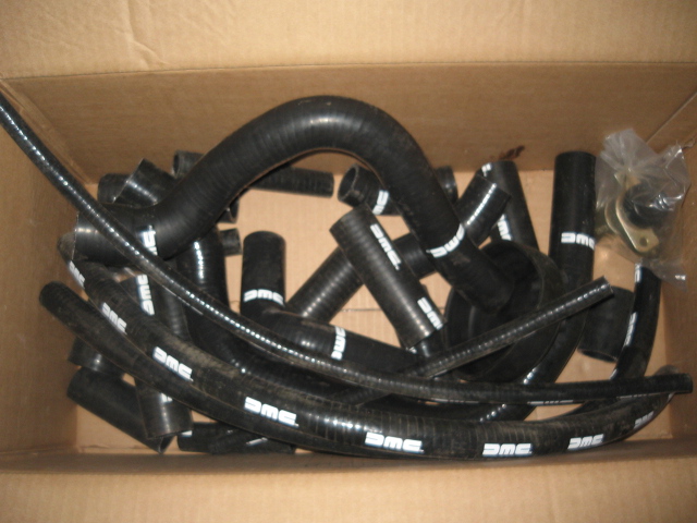

- door strut brackets
- complete silicon hose kit + clips
- fuel pump cover
- Clutch Slave

Lol I just realised I have no idea where all the water hoses need to go! :D Well I can figure out the big ones, but then it becomes a puzzle; I'll give Ed a call one of these days!

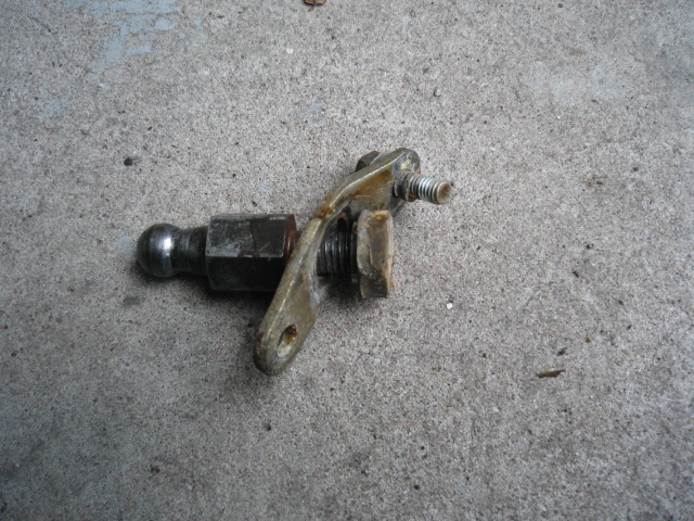

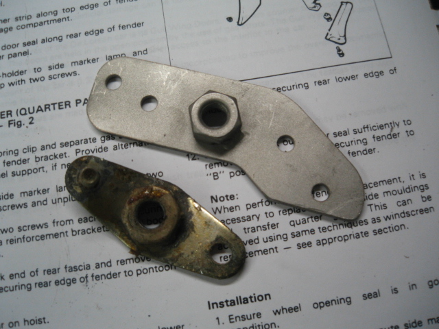

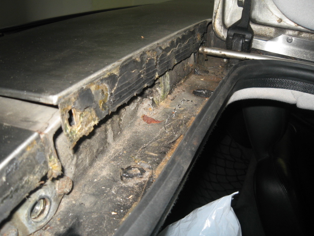

Did some work on the door struts this weekend. Getting of the rear wing was the biggest job. After that I could easily spot the problem: The weld that attaches the nut to the bracket came loose. Not only that: the old tiny bracket was bent quite badly. For reference, i've added a picture from the new bracket from DMC Europe.

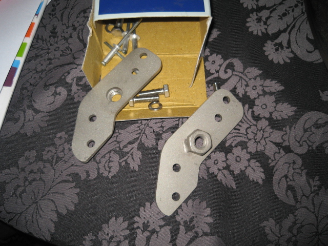

Postby tourettes tony » Sun Nov 14, 2010 3:44 pm
If the fibre glass isn't that great, extend the bracket by welding an extra plate on with more holes towards the inside of the car.
I did mine and it takes away the worry of it needing to be done again TT
Postby RobvdVeer » Sun Nov 14, 2010 3:50 pm
tourettes tony wrote:If the fibre glass isn't that great, extend the bracket by welding an extra plate on with more holes towards the inside of the car.
Thank god my fibre is fine. You may have noticed the extra holes on the new plates. These are for the rivets on either side of the mounting bolts, but I dont have a rivet gun (yet)..
Postby RobvdVeer » Mon Nov 22, 2010 9:30 pm
Last weekend I replaced both door strut brackets as posted above. Took me a little while to get all the old sealant out of the way but all in all replacing the brackets was easier than I thought. All is resealed again now, mighty happy I did em. Now they're good to go for at least another 30 years (i hope :D).

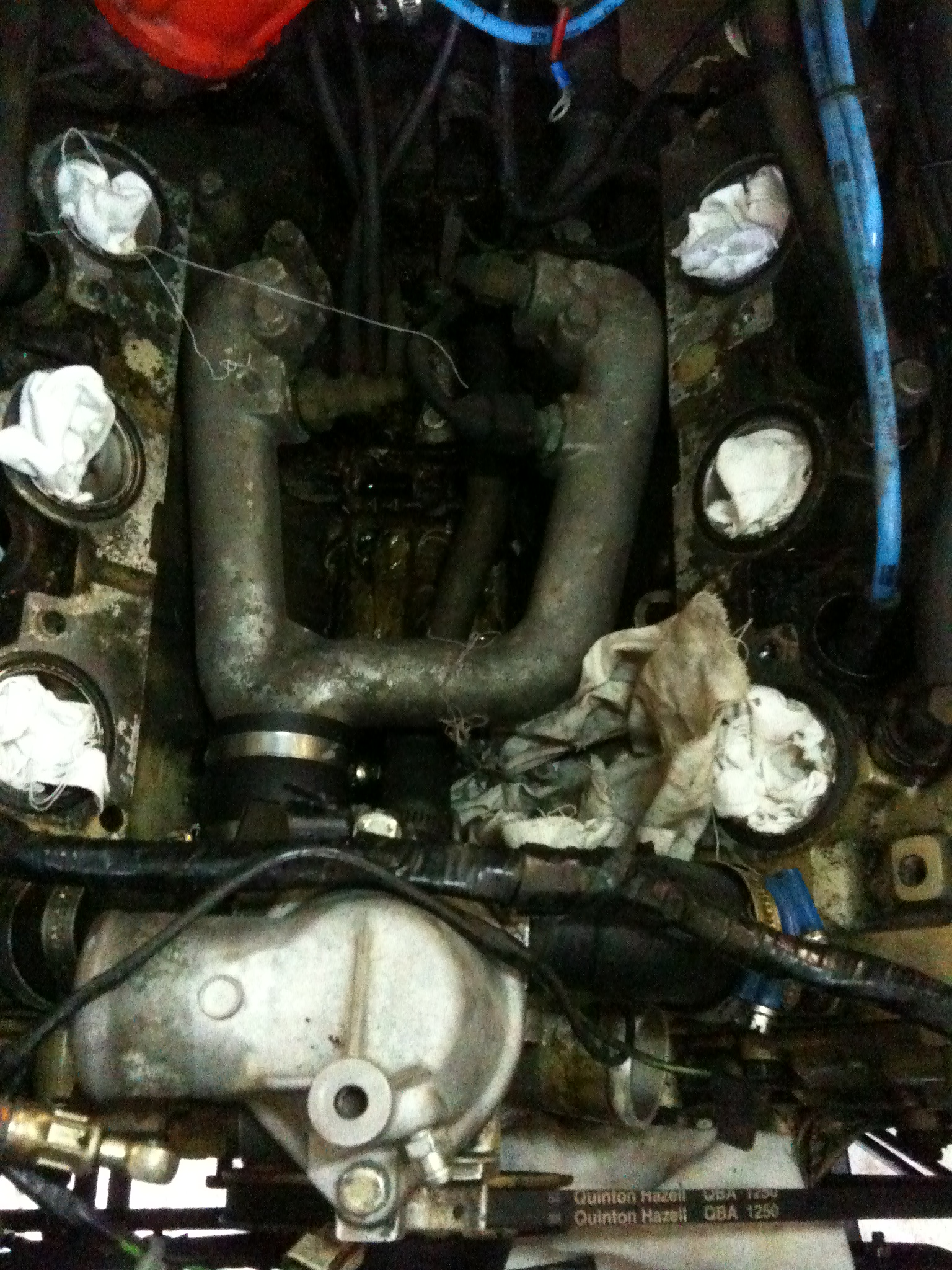

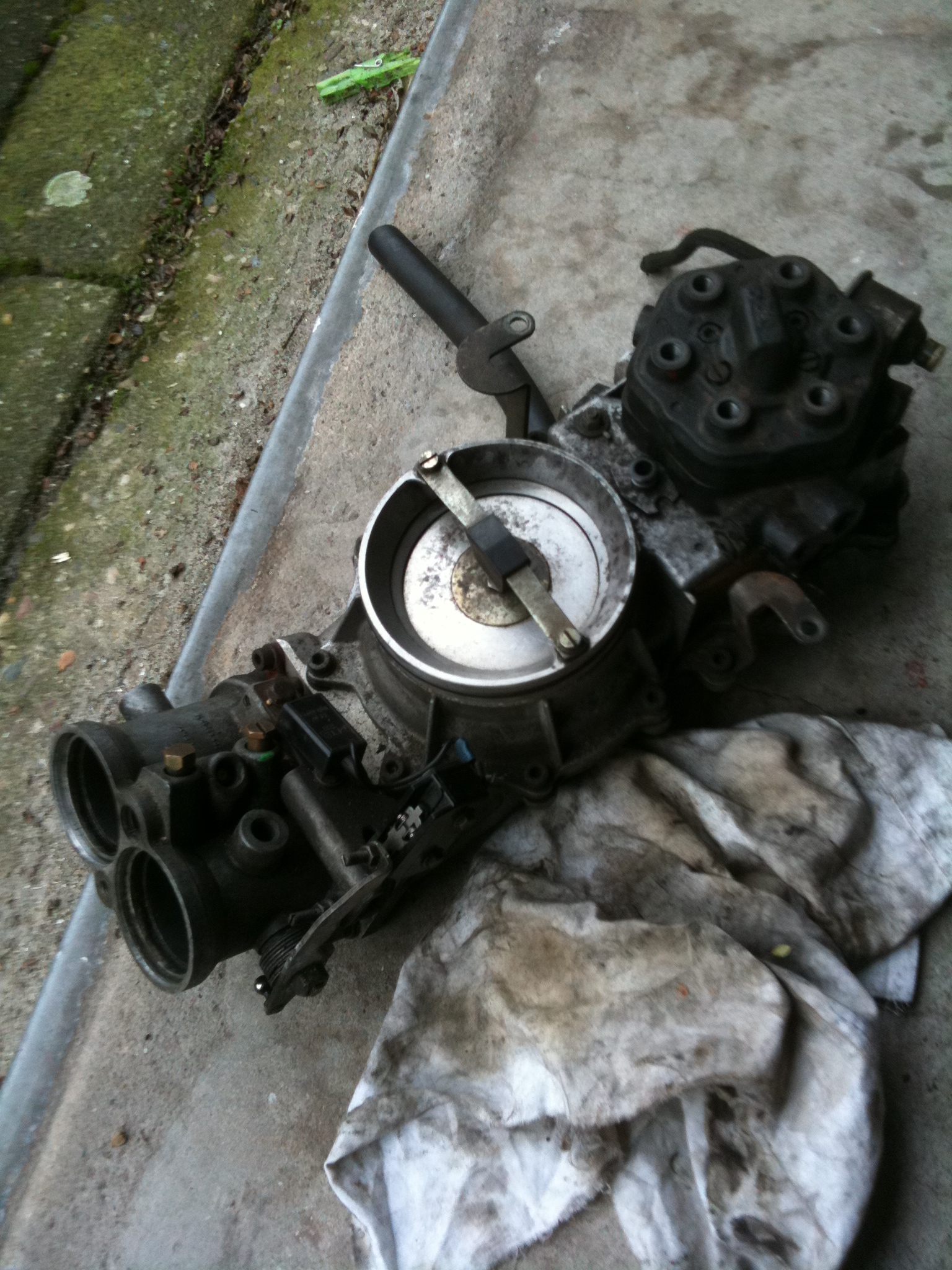

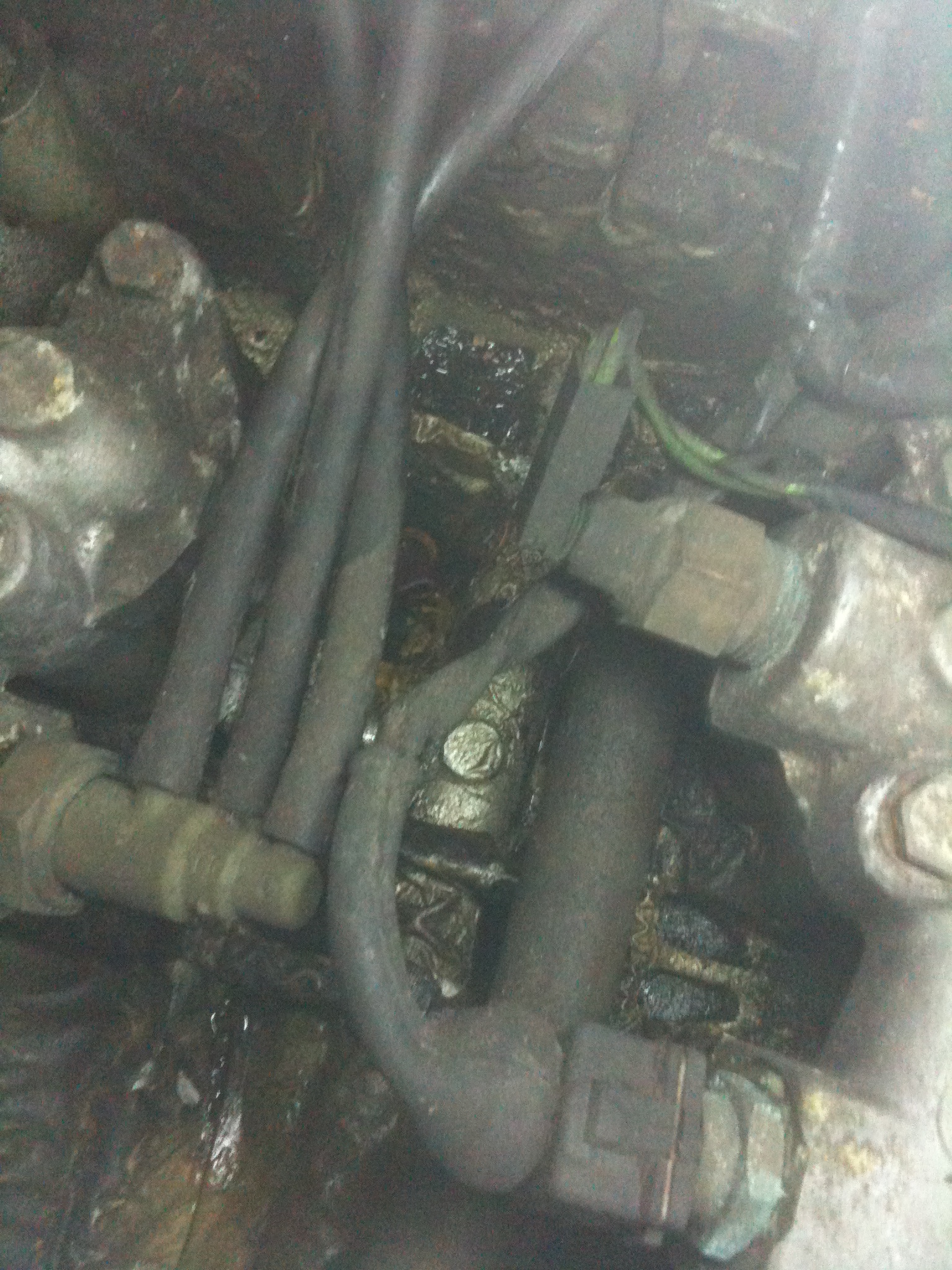

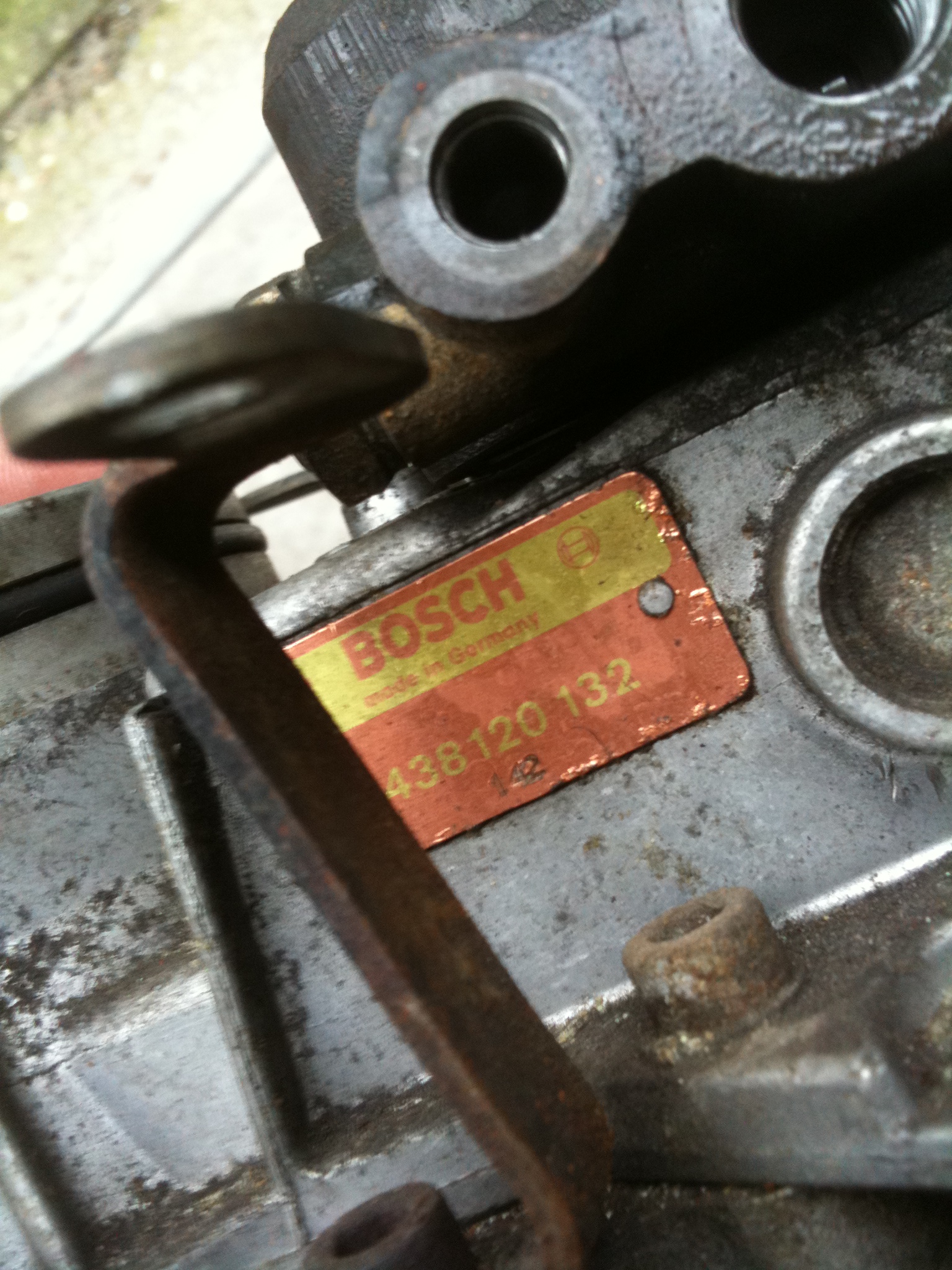

This is a big one, and I am quite proud of myself with todays work. Well pictures say more than words so here they come.
Postby RobvdVeer » Sat Jan 22, 2011 2:37 pm
More
VOD doesn't look that bad at all. And the water hoses at the back of the waterpump look clean and decent. I feel quite good about that.
