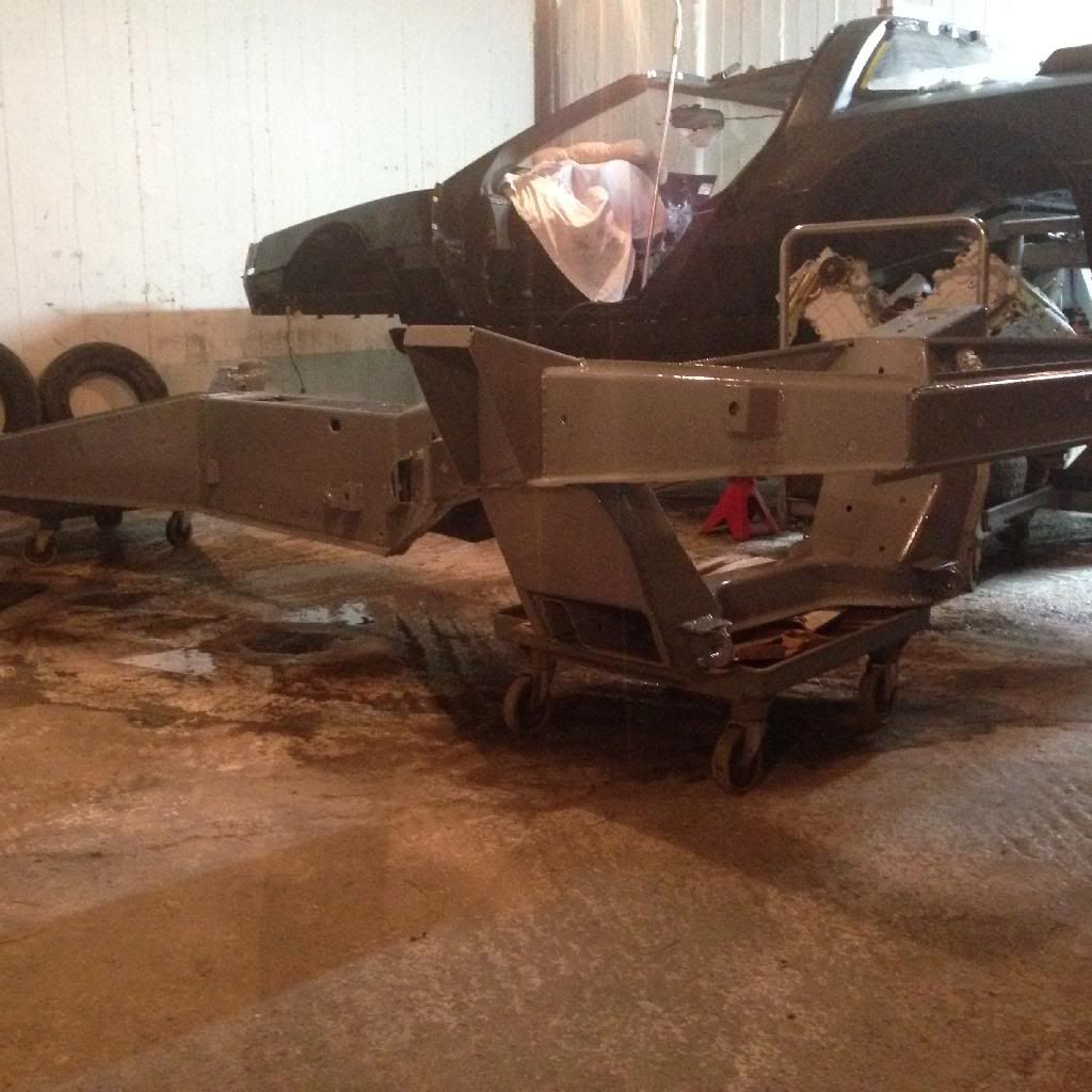

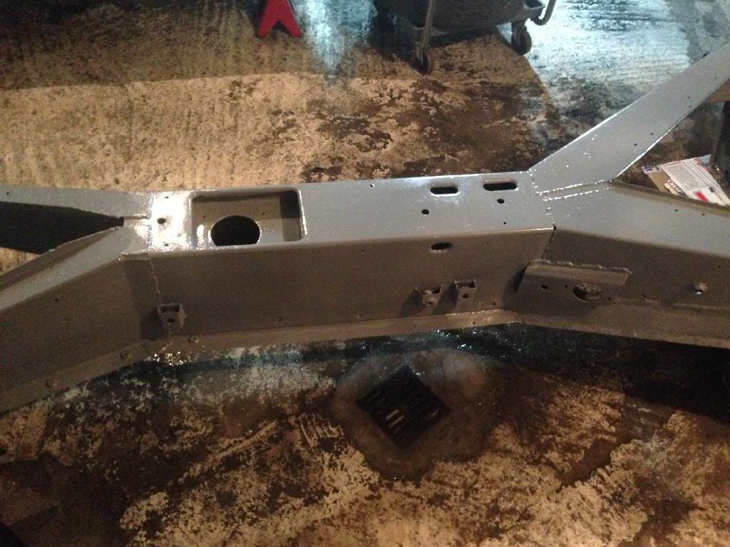

After countless hours of cleaning, cutting, patching welding smoothing out and painting the frame is finally done!!!!
Images posted with before and after :)
Image[/URL]
Patched sides with new metal

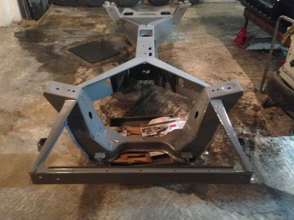

Engine bay

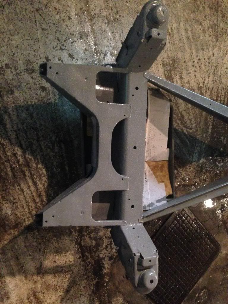

Centre

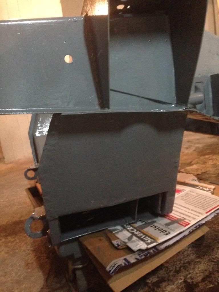

And front

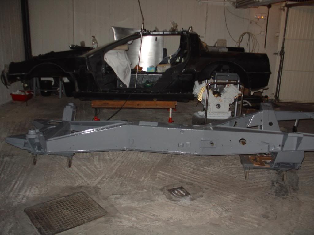

Here are some better looking images of the finished frame:

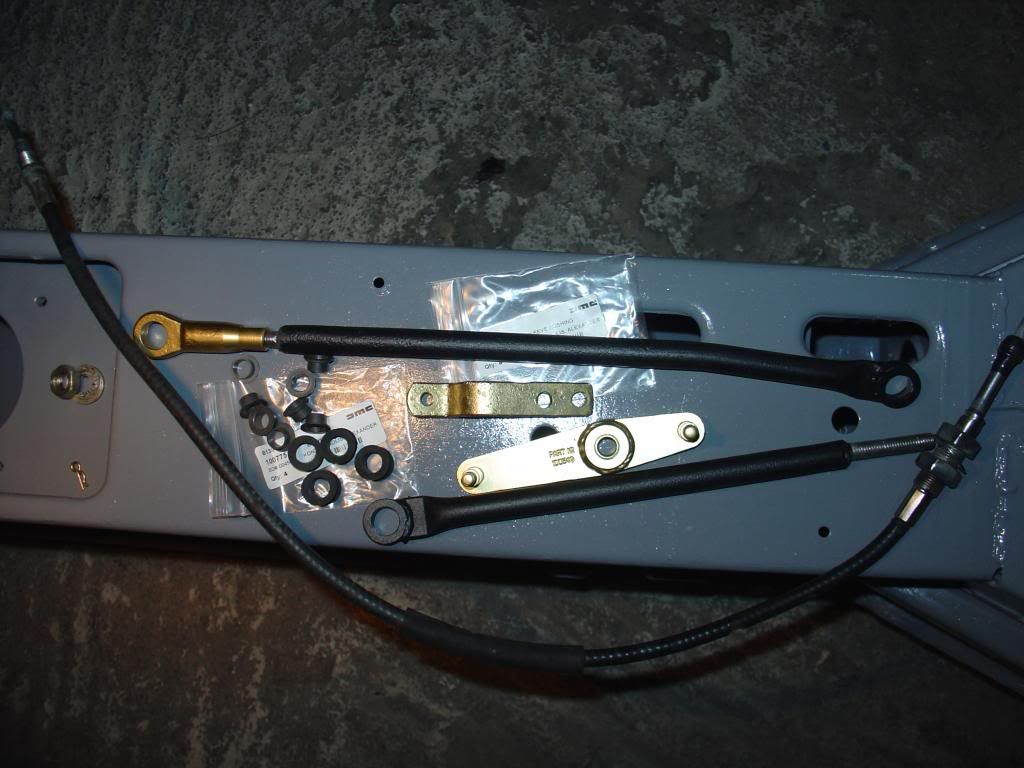

First was the Gearbox shifting linkage
bars were powder coated mat black
and stick

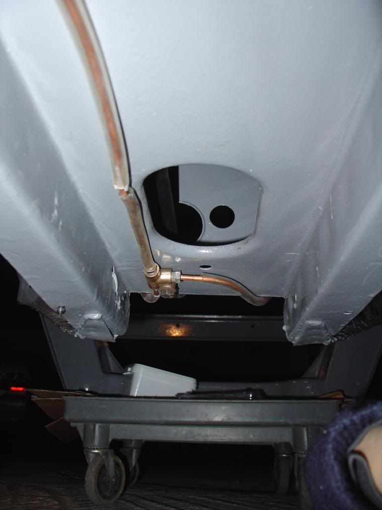

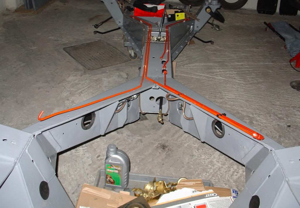

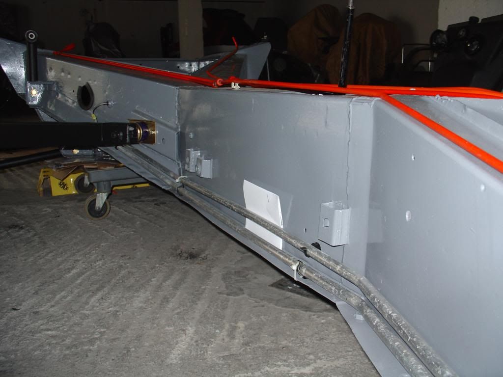

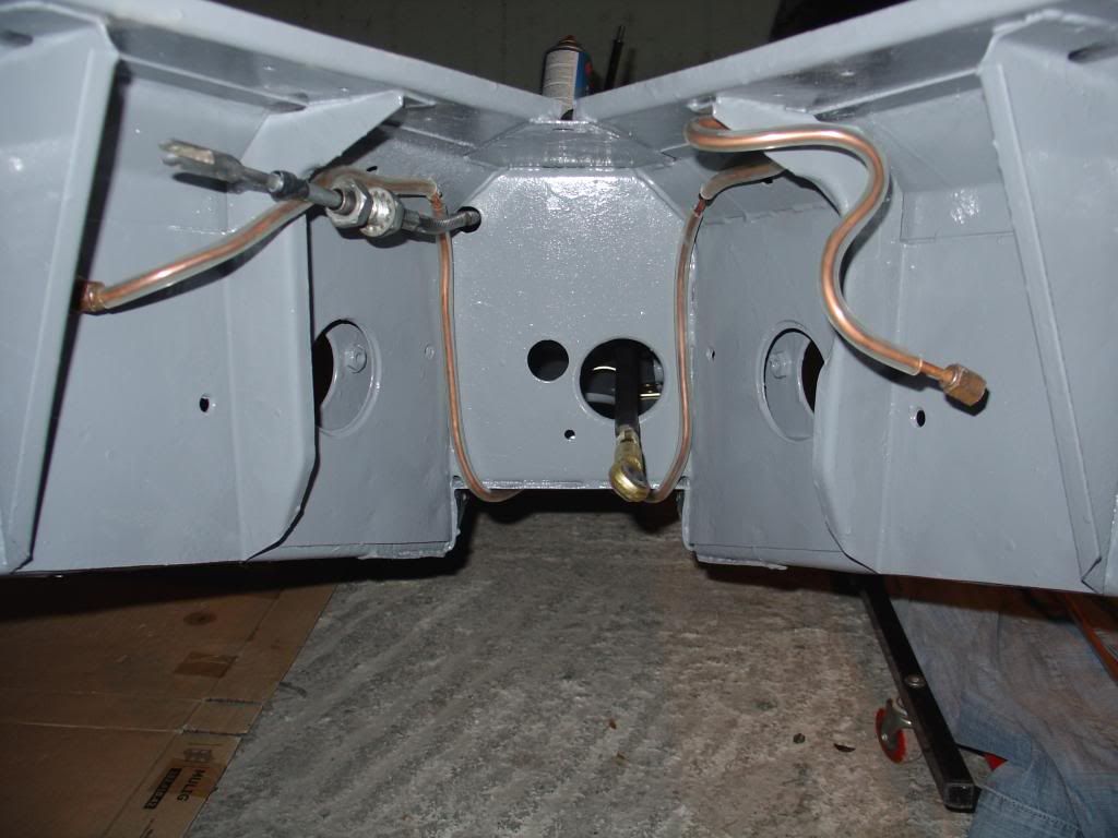

Next were the brake lines.
I had them redone and added a transparent silicone tubing to help me bend them without snapping, Plus it adds protection from corners and rubbing against the frame.
Going out to the rear
Front T connection

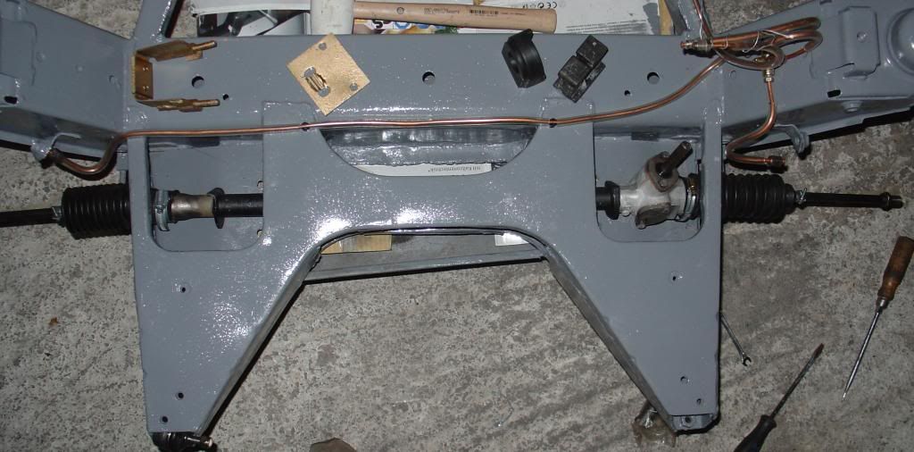

Front complete and got to put the steering rack back in place.... Buy what a task...:dead:

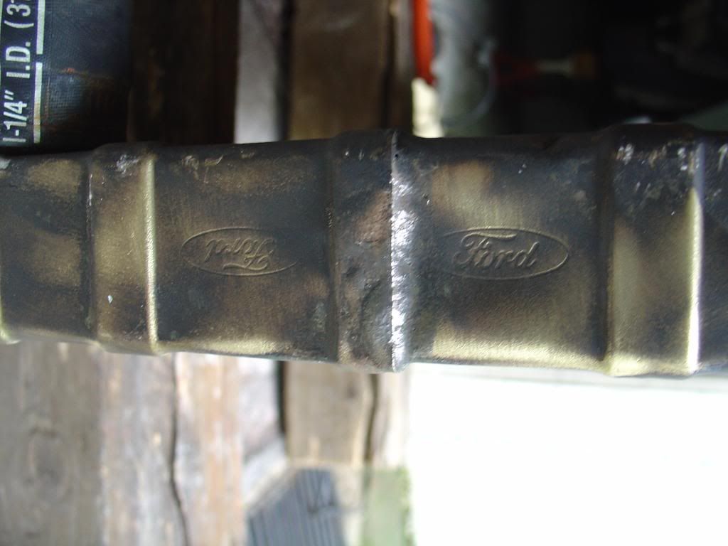

Cleaned my radiator and fixed a couple broken bolts.
Another cross used part from a European car.... But I guess ya'll knew that already....

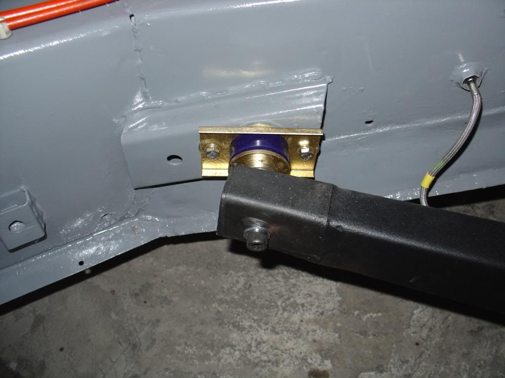

The radius arm masterpiece.
Black powder coated radius
DPI Poly bushing with special poly grease
DPI Tab
Stainless mounting bolts
Stainless brake lines

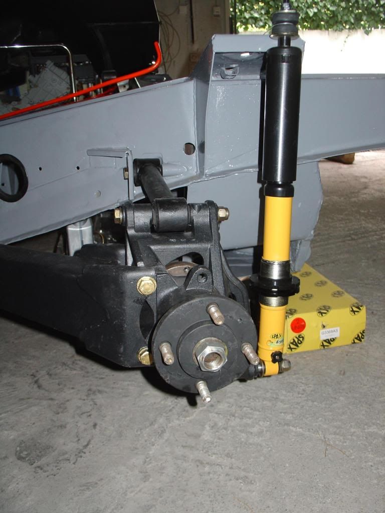

Complete rear system with SPAX shocks. New bushings and all black powder coated.
I know you fellas prefer the radius arm stock gray, But I preferred the powder coated solutions and the black color matching the rest of the set up keeping the X frame at its unique gray.

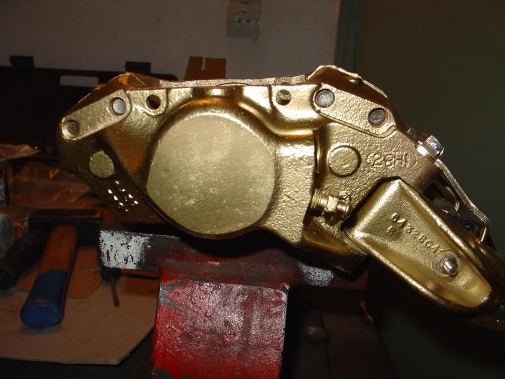

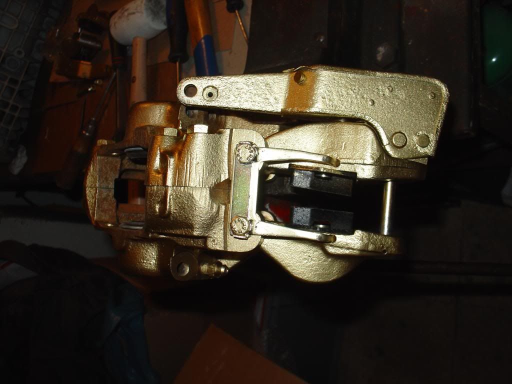

a couple of hours work, mounted the calipers after refurbishing them with handbrake assy and pads.
They are next to be placed on the frame.
