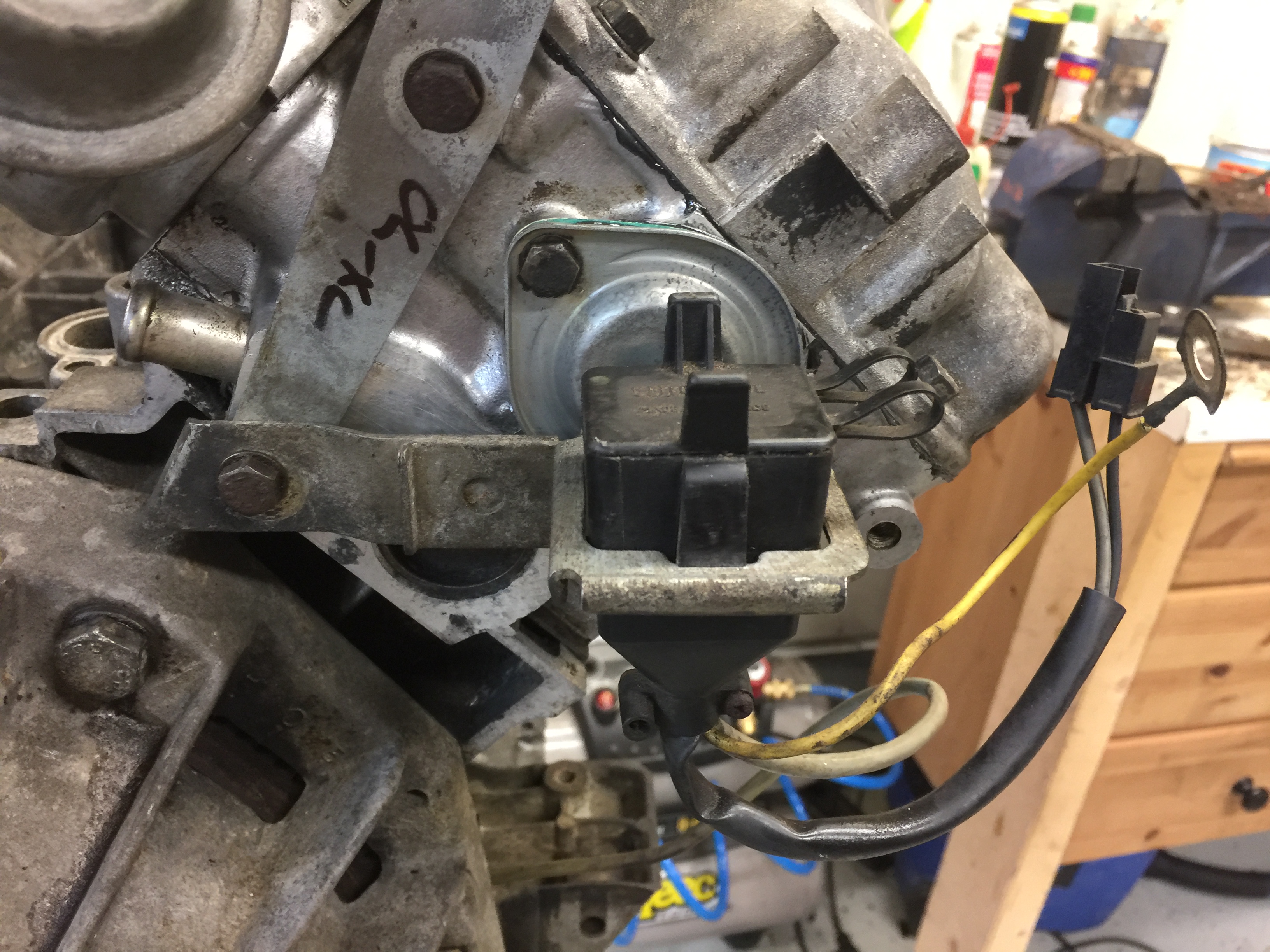

They are all temperature sensors:
Blue - temperature sender (instrument cluster) 102450
Yellow - Lambda switch 102478
Green - Vacuum Switch 102405
Red - idle speed thermistor 102480

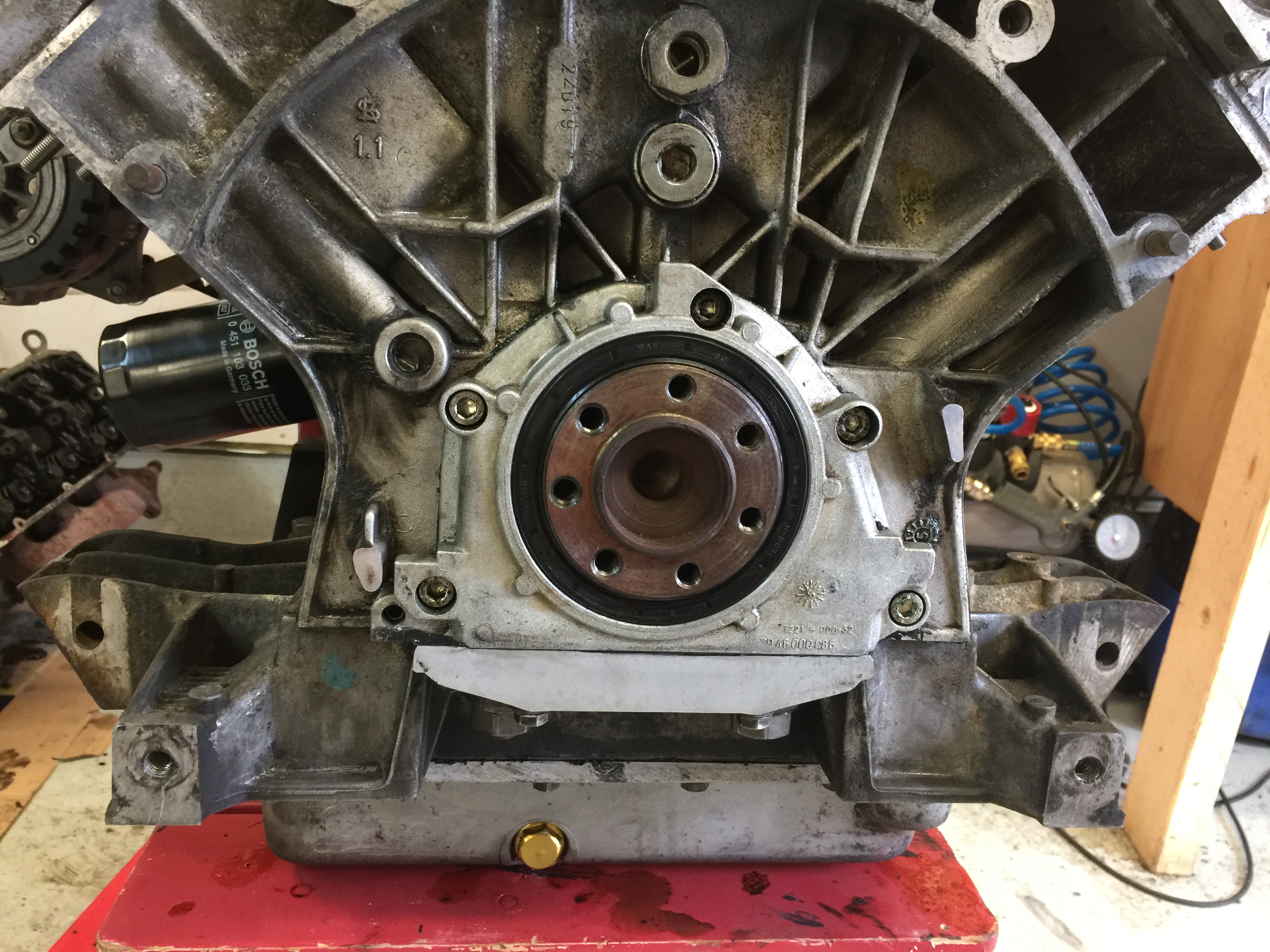

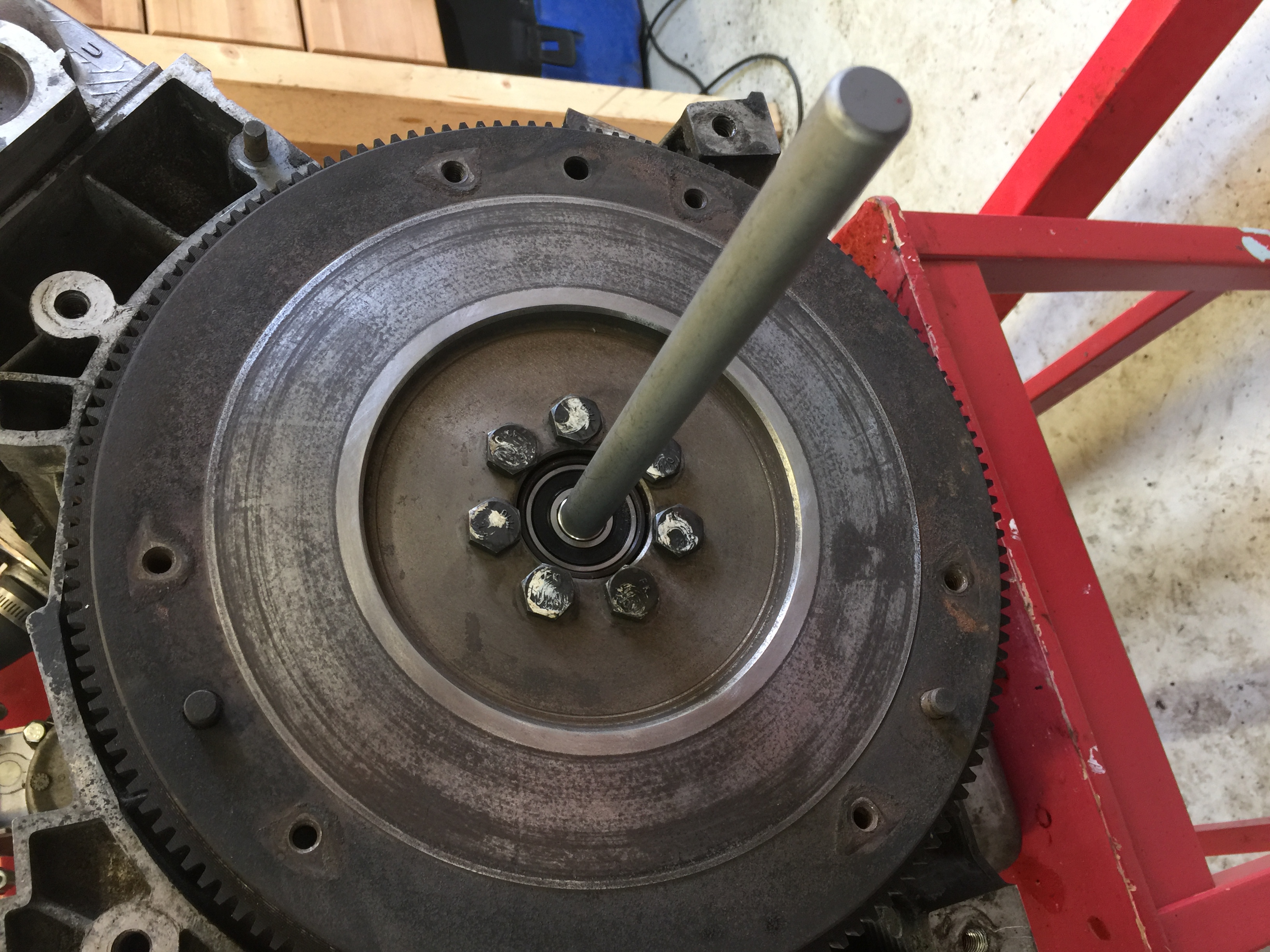

Some garage time again, after some time doing other unnecessary things :)

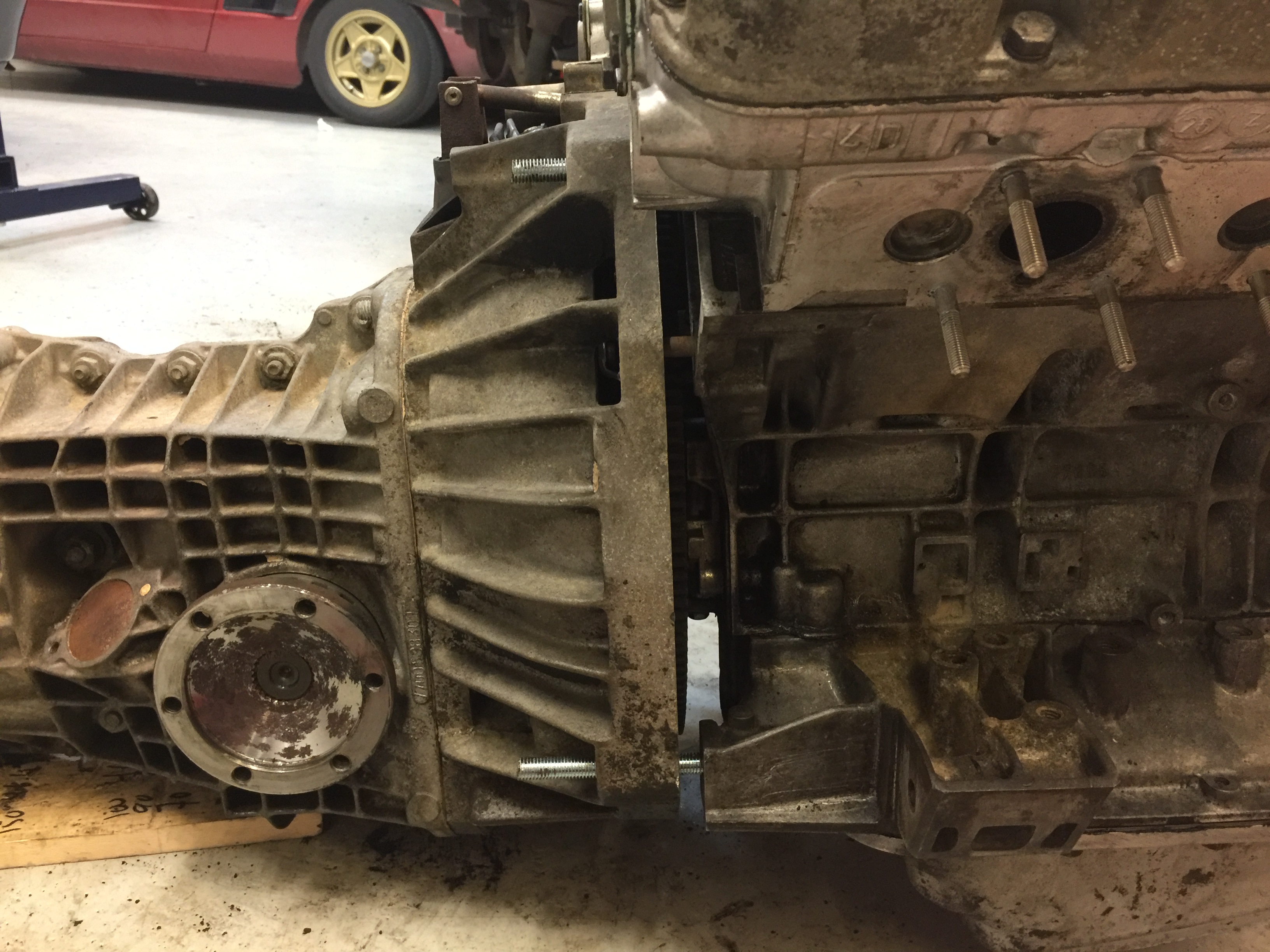

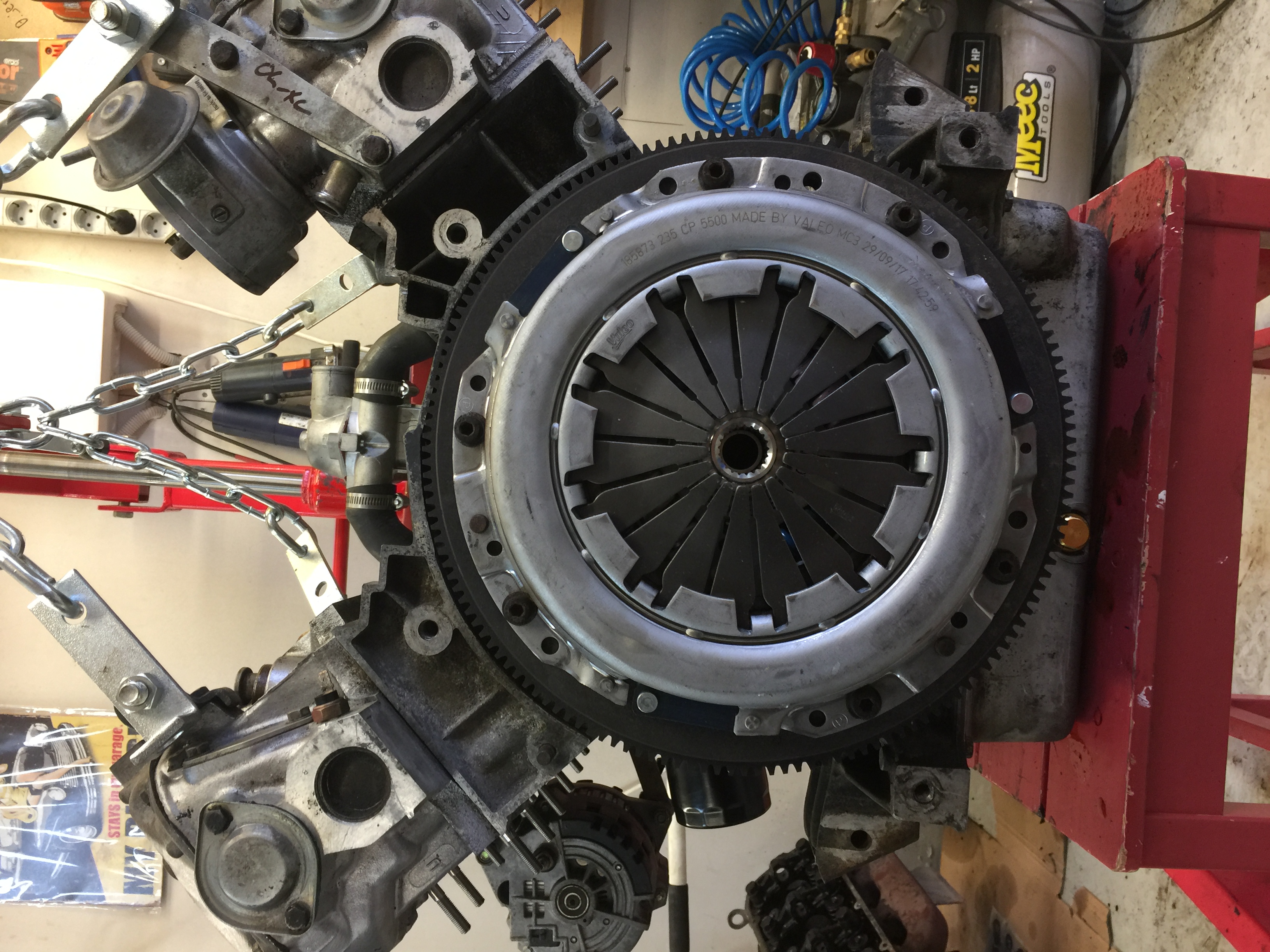

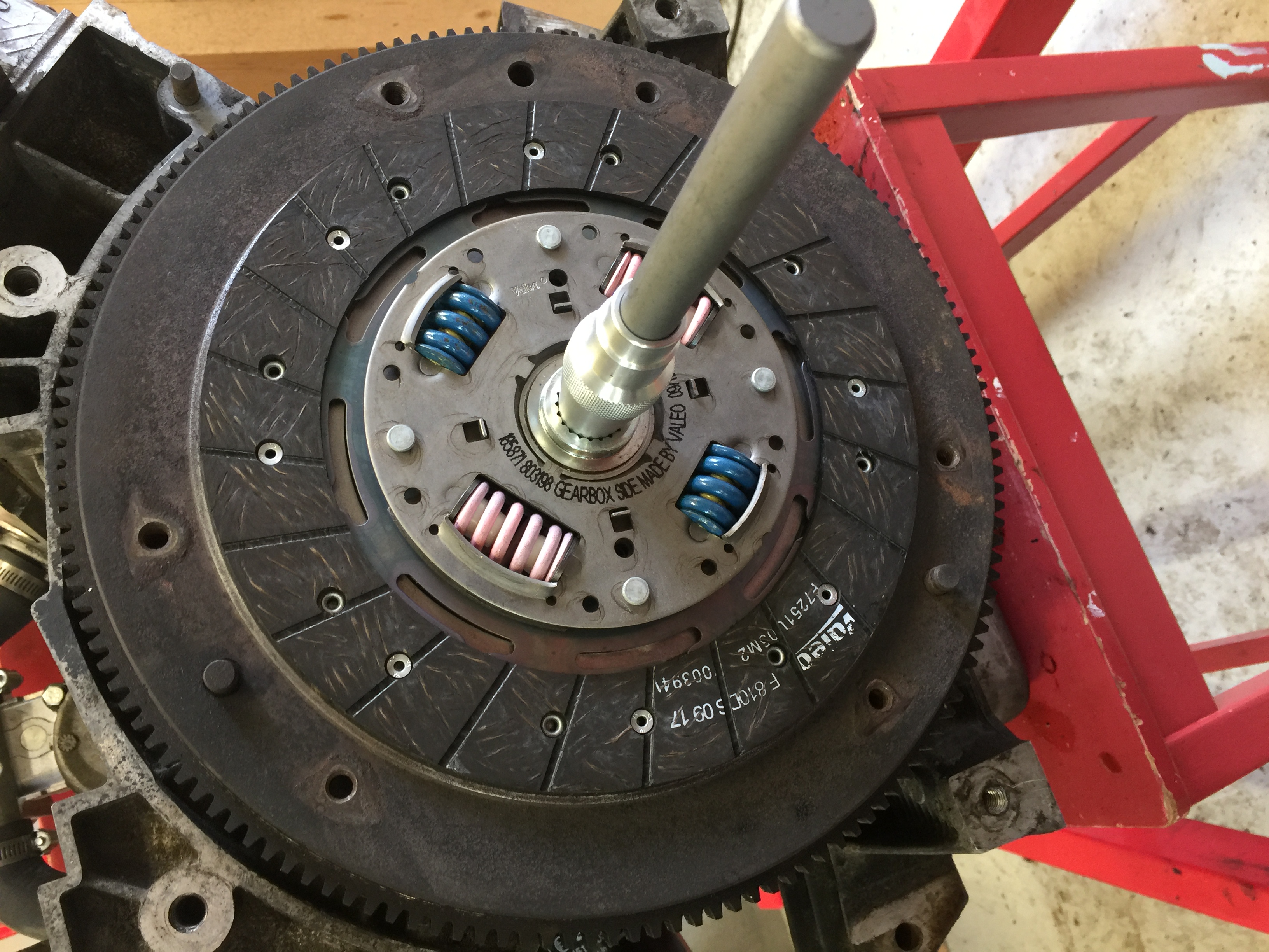

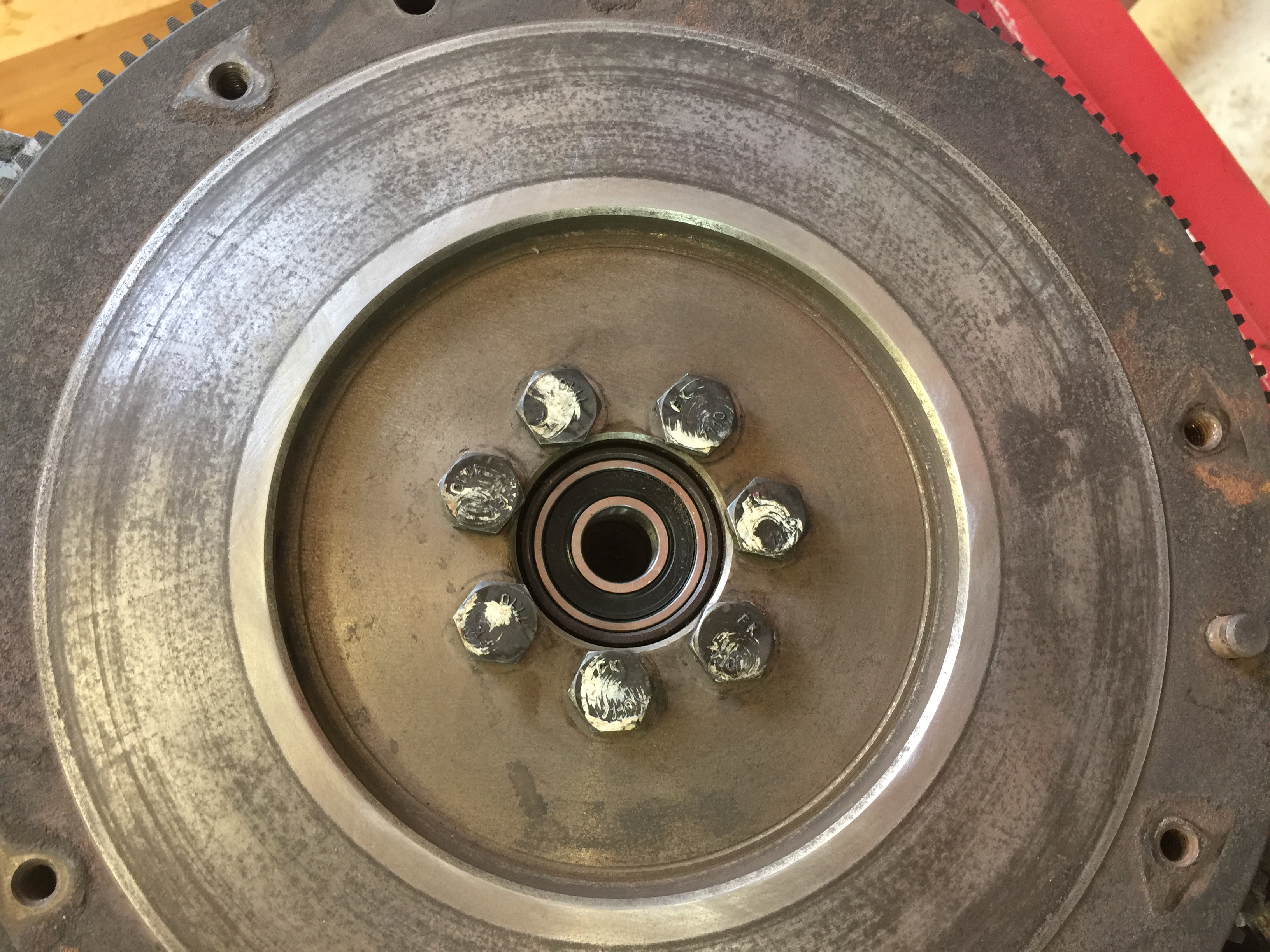

Long story short I got the rear main seal installed, flywheel and clutch.
Next up is the starter before I mate the engine to the transmission.
Rms in
Torqued and pilot bearing in
Aligning
Done!

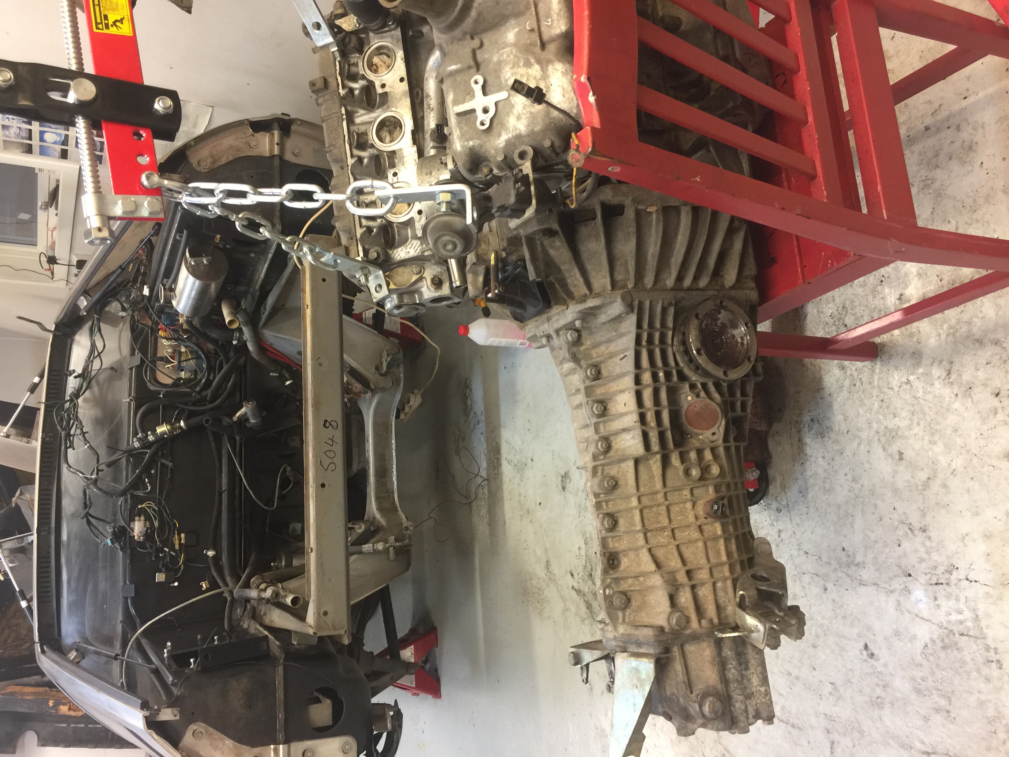

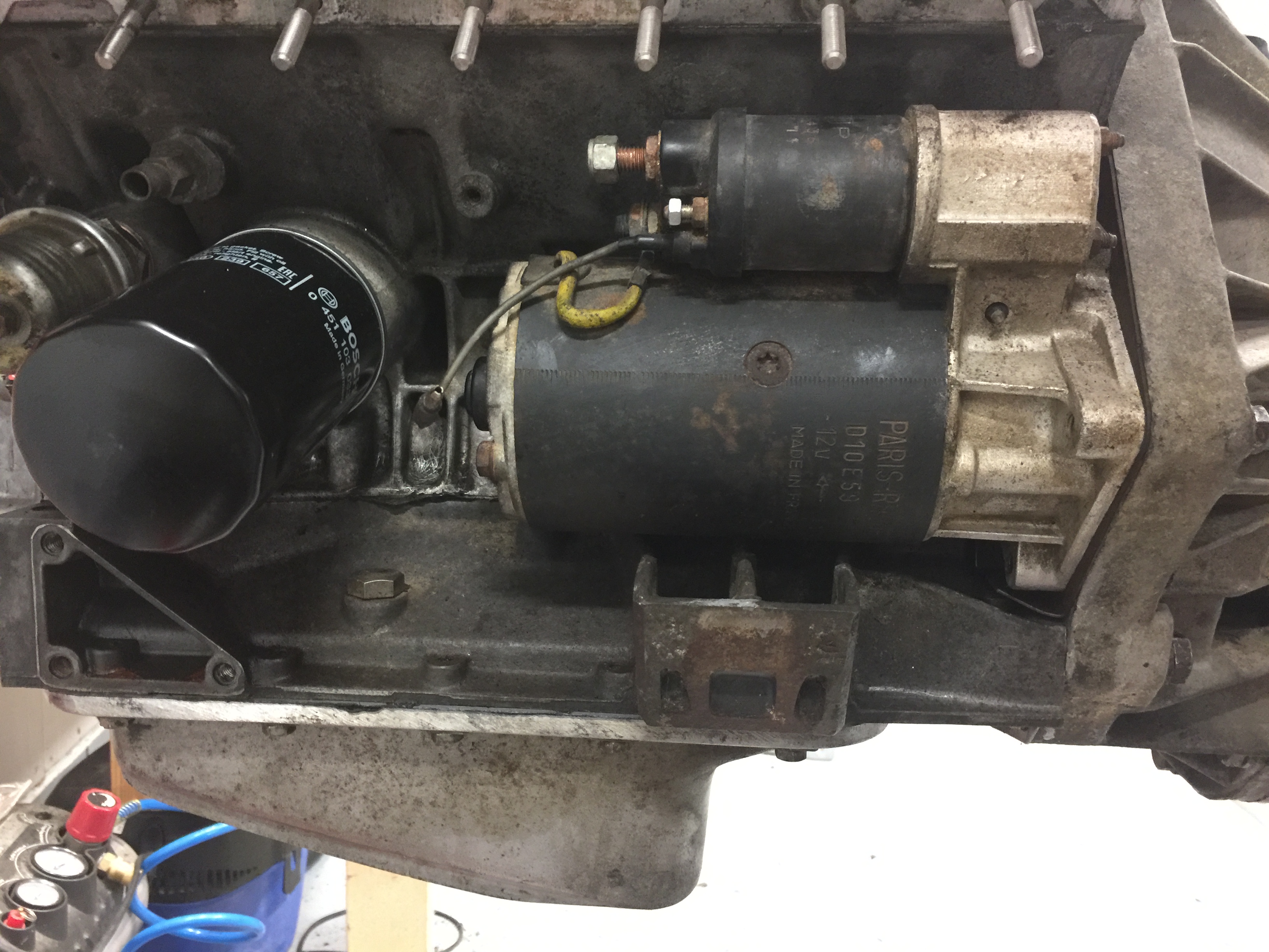

Postby gruffalo » Sun May 06, 2018 9:06 pm

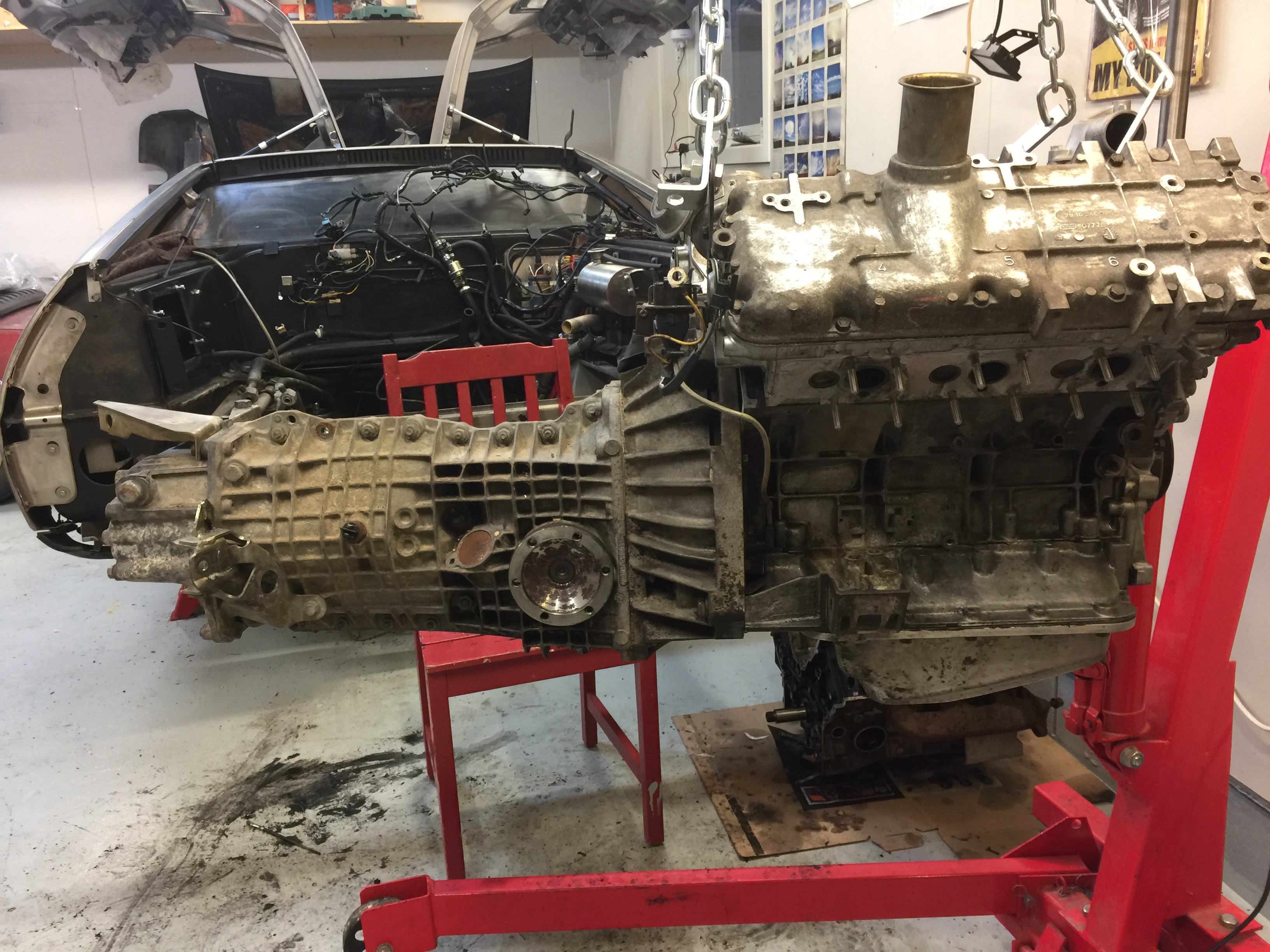

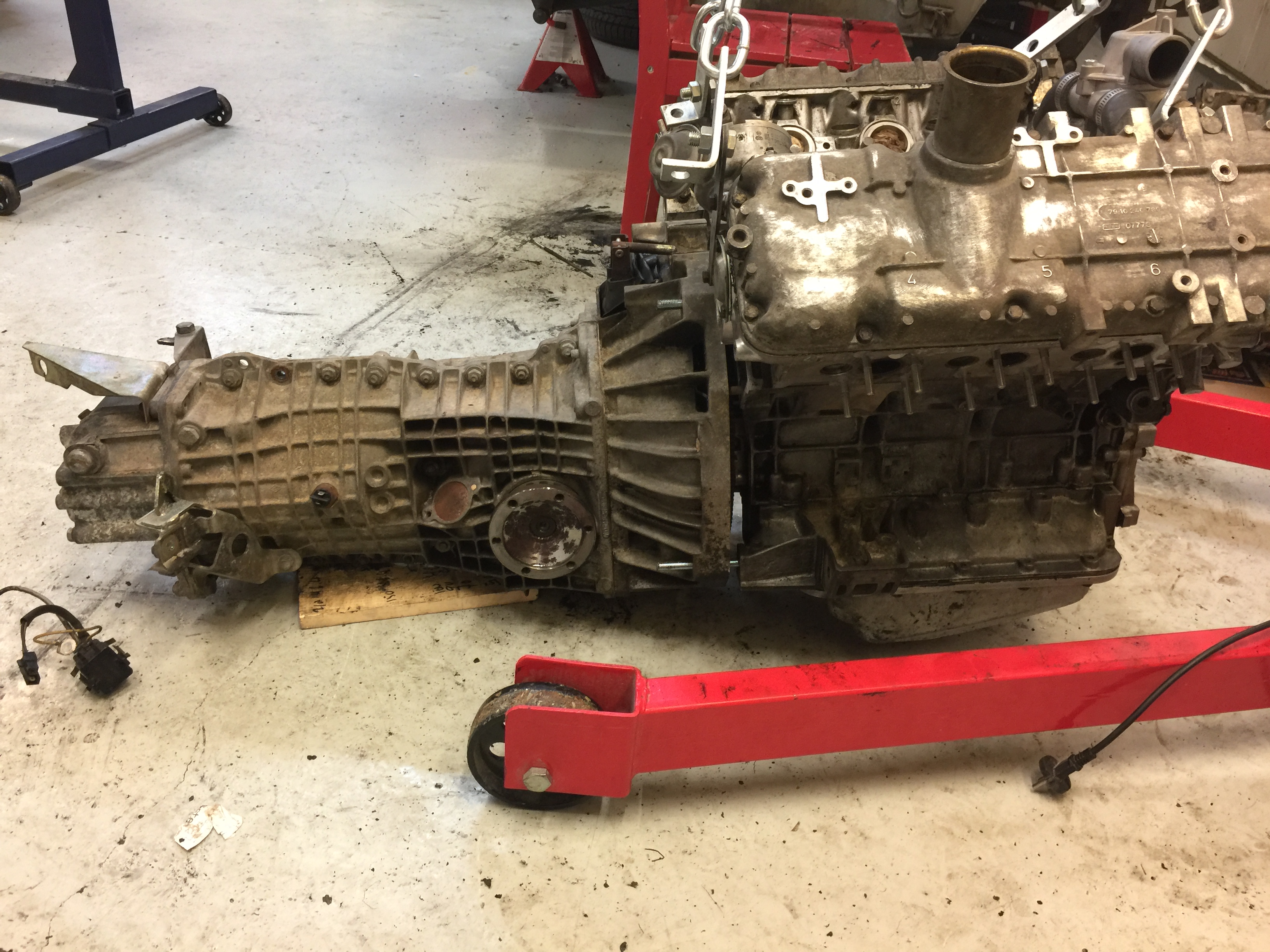

Got shitloads done today! The whole lump is ready to go in. :)
Docking is easy using studs to align
Getting there
That
The lump
Starter
This

Great work, and thanks for the pic that will help me as I need to change my clutch too...
Did you find all the necessary torque?
Posts: 1000
Re: Vin 5063
Postby gruffalo » Mon May 07, 2018 8:30 pm
I torqued the flywheel, but found no mention of a torque spec for the clutch itself, so I just did it by feel.
Come to think of it, I need to check the four bolts that fix the transmission to the engine...

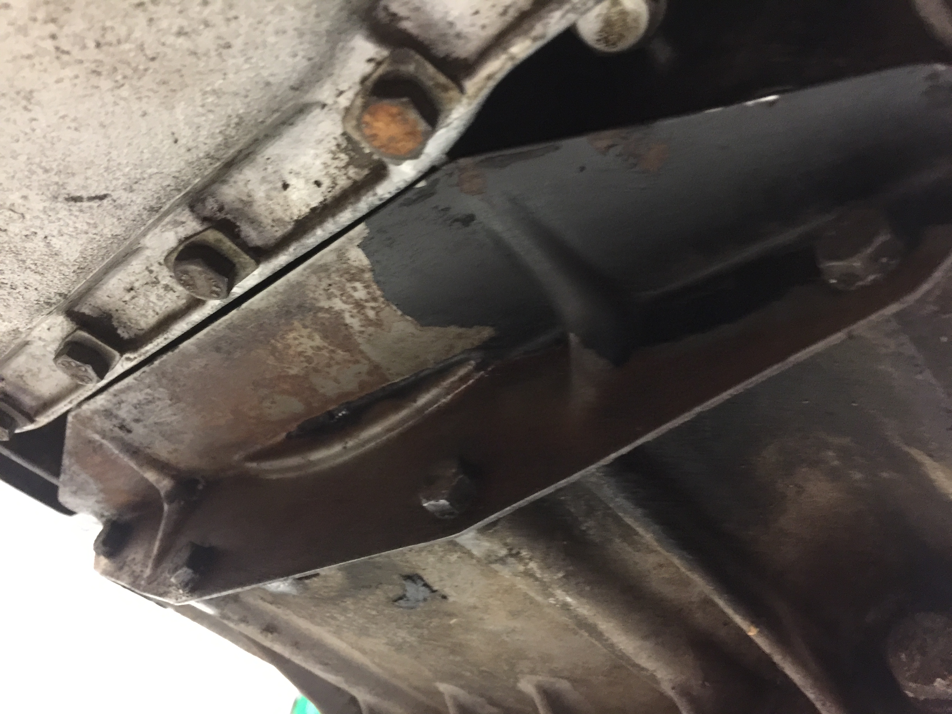

Postby gruffalo » Mon May 07, 2018 8:32 pm
I guess the bracket for the diagnostic socket is in the wrong place.
Needs to go one bolt up

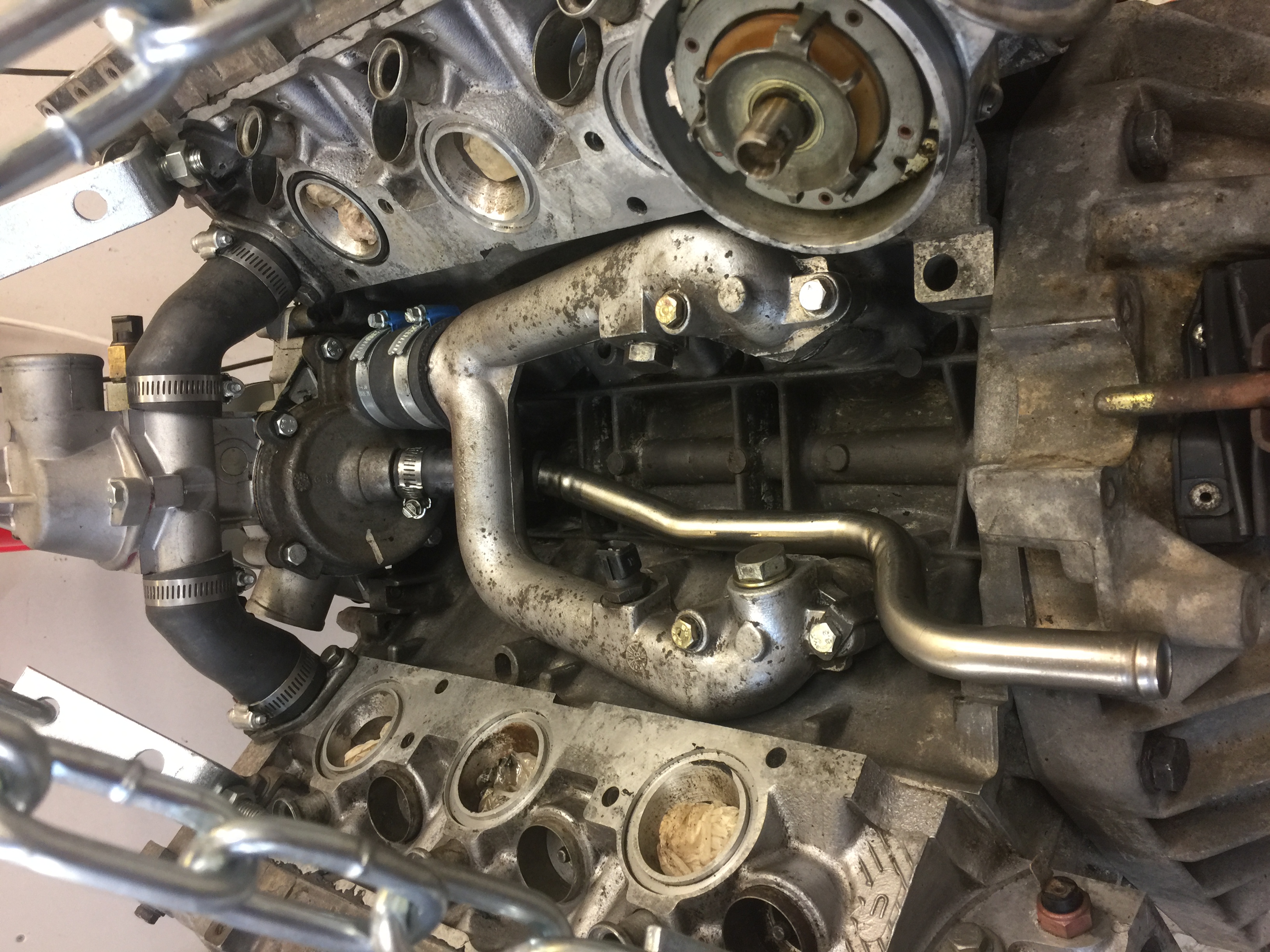

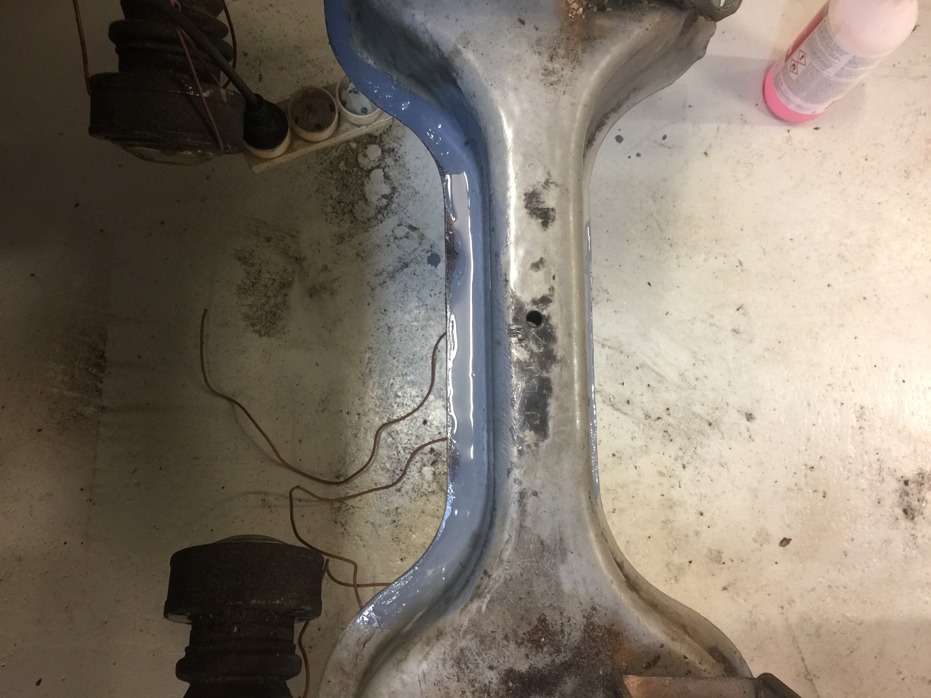

Postby gruffalo » Tue May 22, 2018 9:28 pm

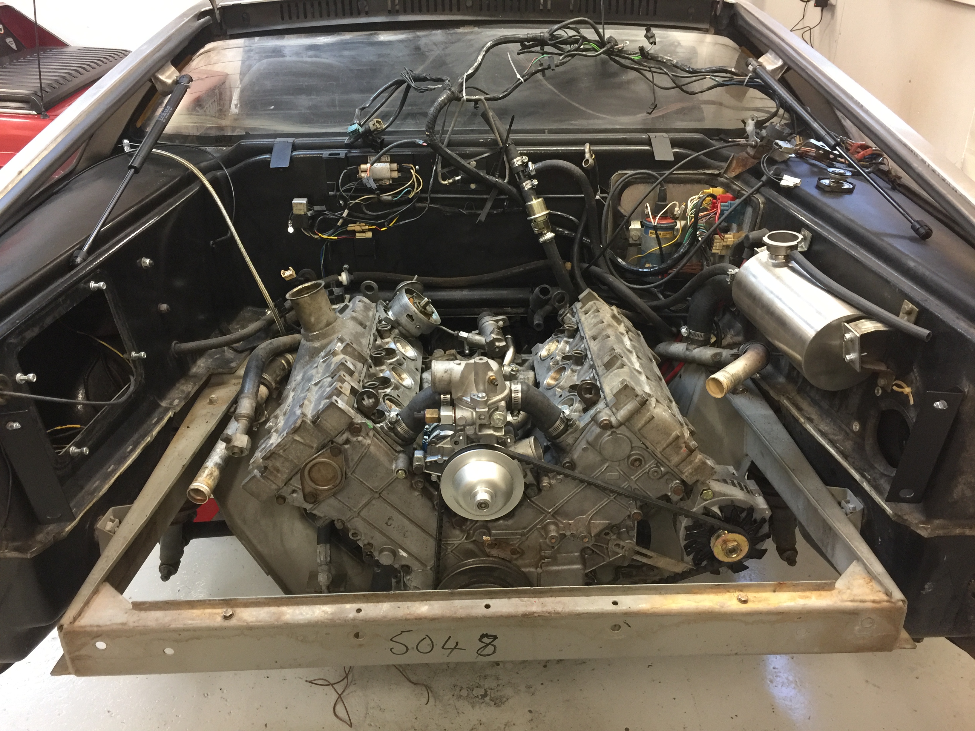

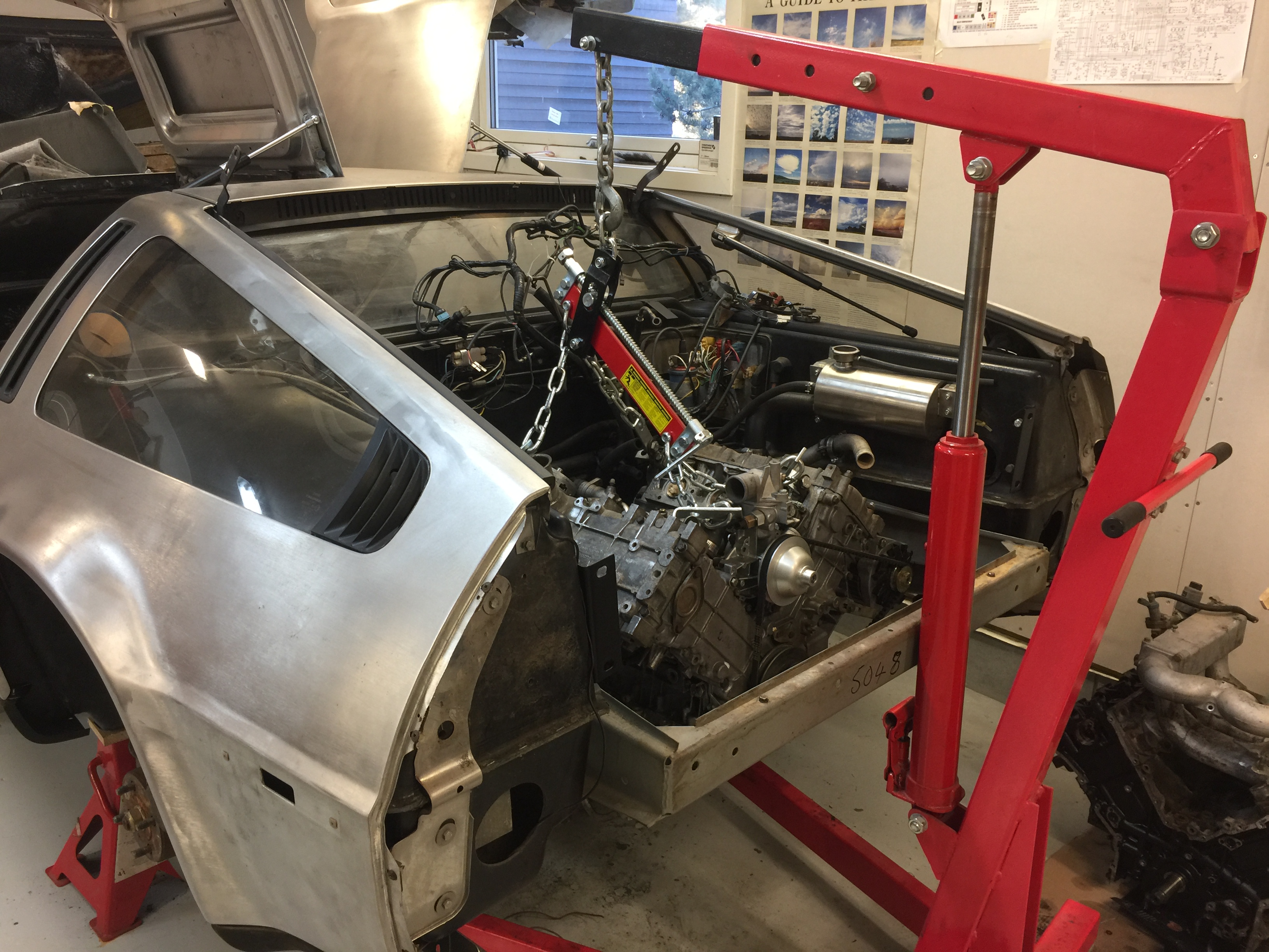

Summer came unexpectedly early, and I’ve been occupied doing everything apart from working on the car.
Got a little session in today, and installed some water pipes and treated some minor frame surface rust.
Next step is installing the whole engine ! Exciting.
Trying to start the engine is going to be too exciting to bare...
Por 15 treating some surface rust
Did this...
Lump ready

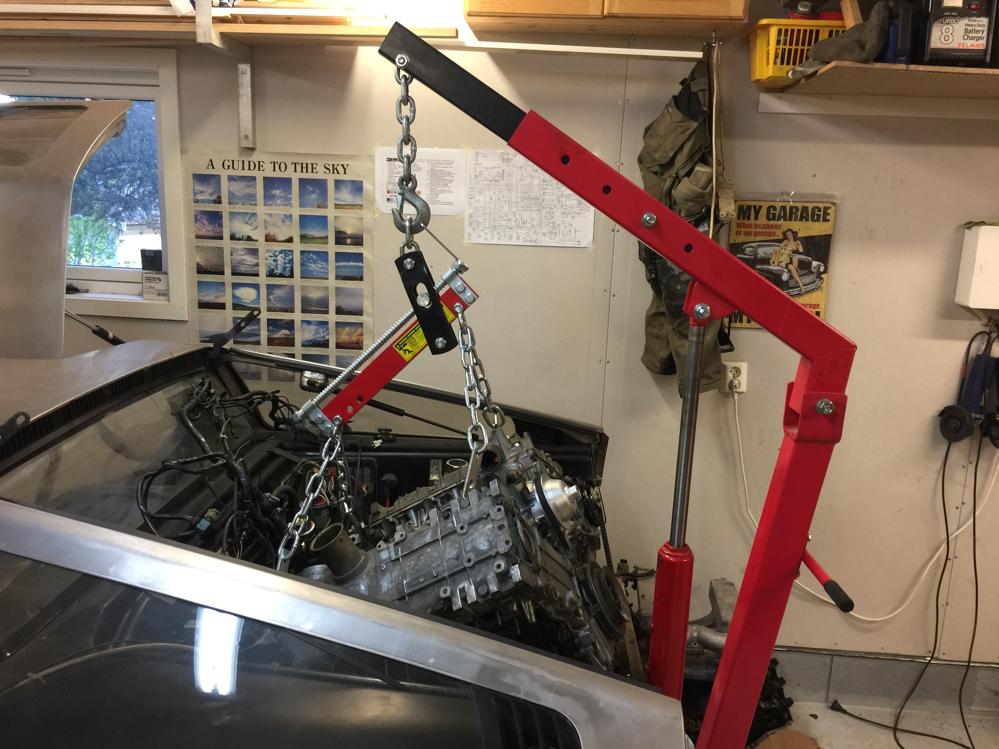

Postby gruffalo » Tue May 29, 2018 8:35 pm

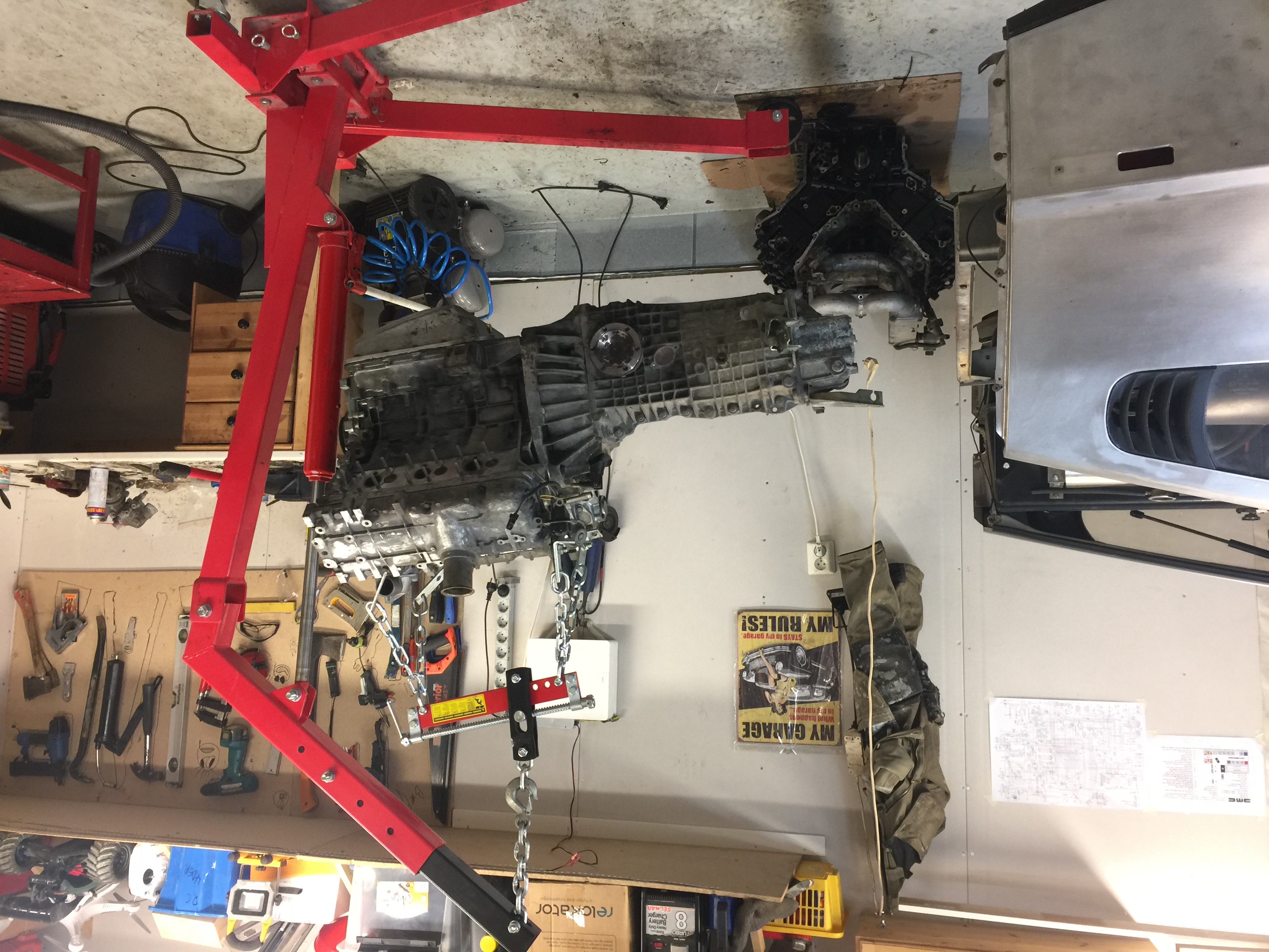

Ok, time to brag! Today I did this. All by myself. In approximately 20 minutes. Without ruining or scratching anything.
1 up you go
2
3 like a glove
4

Postby gruffalo » Tue May 29, 2018 8:37 pm
I could hear a sigh of relief as the frame once again took the weight of the familiar PVR.
