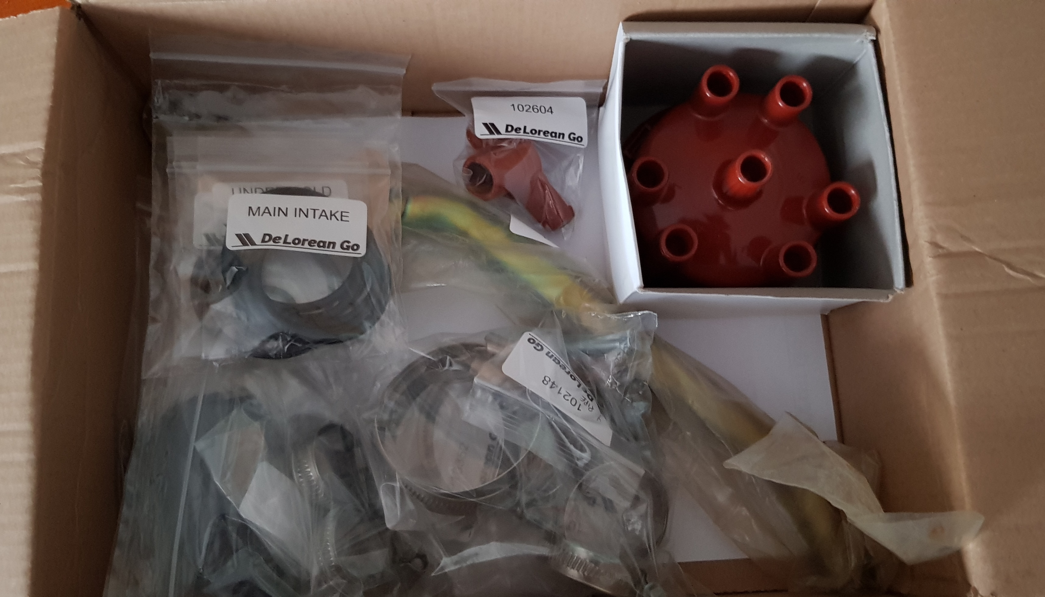

New hoodie just arrived from the states. Yeah im sad :D
Also, parts to change the long overdue distributor cap and rotar arm and whilst i have the intake off, a few bits for the VOD. I already have spark plugs and HT leads. Can anyone recommend what paint can be used in there please?
Re: VIN 5219
Postby MikeWard » Wed Mar 18, 2020 2:36 pm
POR engine enamel. The VOD must be absolutely pristine clean otherwise the paint will not adhere.
Re: VIN 5219
Postby Dan 6511 » Wed Mar 18, 2020 2:48 pm
I personally left my valley unpainted. The way I see it, it has survived nearly 40 years unpainted then in theory it should go another 40 after it has been cleaned back to how it left the factory. I was concerned if the paint cracked or blistered a year down the road then moisture could get trapped under it.
Re: VIN 5219
Postby DMC1983 » Wed Mar 18, 2020 2:58 pm
Cheers guys.
Dan i doubt you would have to worry about paint cracking as you need to drive the car :lol: i guess it should be a concern for me though.
