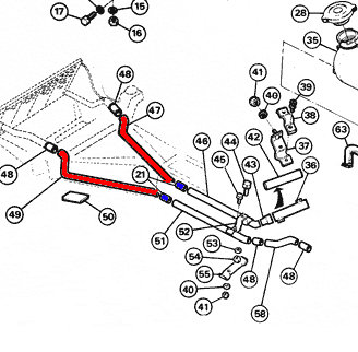

Postby RobvdVeer » Mon Jan 31, 2011 11:54 am
Admin-bloke wrote:Keep up the good work Rob...
Thanks, it is a hard job, and I go slowly, but i have to do it, and I have no major problems (like bolts breaking, or tapping required) It feels like i am almost there. I am glad I am doing this now, and not when it's too late. After this the engine should be good for another couple of years to come.
In the image, I have marked the last bit of connections blue. I am thinking that if I loosen the jubilees at the radiator side, I should be able to move the red ones towards the back of the car so I can reach those last hoses without having to remove the floor panel (or tank plate). I just hope there are no more brackets inside.
Postby RobvdVeer » Thu Feb 03, 2011 7:27 pm
Well I managed to get the blue bits off, the red ones wouldn't shift so they must be fastened somehow behind the tank plate. To get them loose, i loosened the tank plate sufficiently to get a tool in.
I also loosened the 2 pipes that go to the heater, tricky stuff because they are bundled with an air-conditioning line and I really don't want to damage that one. Also the jubilees were fastened from the top when the tub was not yet on the car.
I feel extremely satisfied now, because I can now start to replace all that crap with new hoses and jubilees. More bits of 30 year old crap in the bin!
As a final summary; all the pipes are clean and solid, no goo or gunk inside. No cracks, no damage. I won't even bother to repaint them, fack it. Only the small t-sections near the engine that controls the heater valve contained a little goo and rust on the outside, presumably from when I bled the clutch slave. I cleaned them thoroughly to stop it from corroding.
